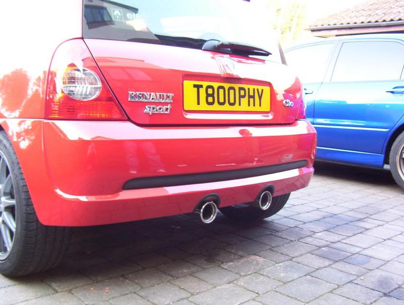

Yozzasport Exhaust Fitted :)

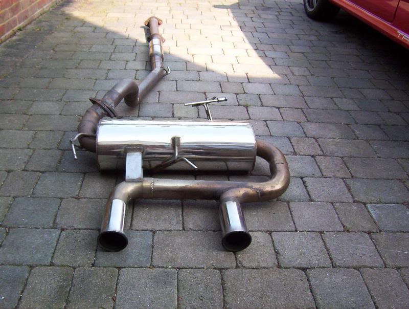

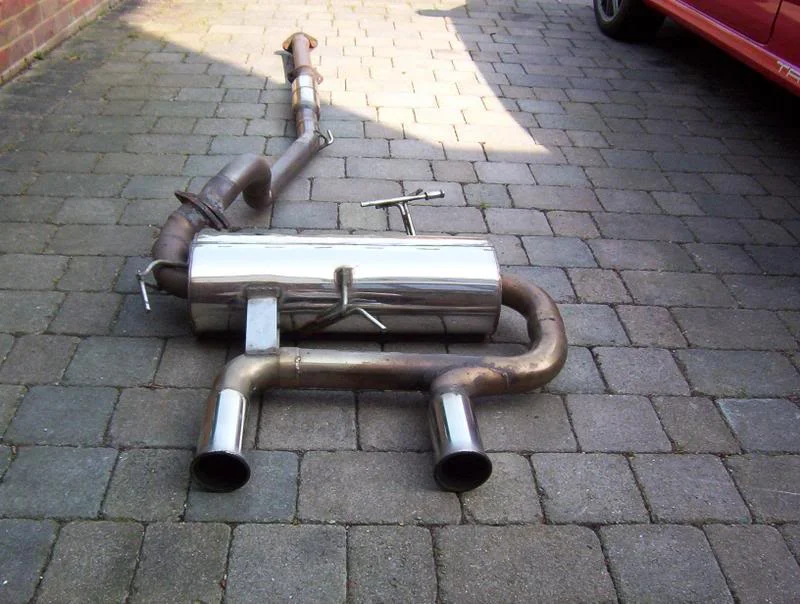

Ok,
as requested...
http://www.yozzasport.co.uk/upload/182Exhaust/yozzasport_clio_182_exhaust_01.JPG
http://www.yozzasport.co.uk/upload/182Exhaust/yozzasport_clio_182_exhaust_02.JPG
http://www.yozzasport.co.uk/upload/182Exhaust/yozzasport_clio_182_exhaust_03.JPG
http://www.yozzasport.co.uk/upload/182Exhaust/yozzasport_clio_182_exhaust_04.JPG
http://www.yozzasport.co.uk/upload/182Exhaust/yozzasport_clio_182_exhaust_05.JPG
http://www.yozzasport.co.uk/upload/182Exhaust/yozzasport_clio_182_exhaust_06.JPG
http://www.yozzasport.co.uk/upload/182Exhaust/yozzasport_clio_182_exhaust_07.JPG
http://www.yozzasport.co.uk/upload/182Exhaust/yozzasport_clio_182_exhaust_08.JPG
http://www.yozzasport.co.uk/upload/182Exhaust/yozzasport_clio_182_exhaust_09.JPG
http://www.yozzasport.co.uk/upload/182Exhaust/yozzasport_clio_182_exhaust_10.JPG
http://www.yozzasport.co.uk/upload/182Exhaust/yozzasport_clio_182_exhaust_11.JPG
http://www.yozzasport.co.uk/upload/182Exhaust/yozzasport_clio_182_exhaust_12.JPG
http://www.yozzasport.co.uk/upload/182Exhaust/yozzasport_clio_182_exhaust_13.JPG
http://www.yozzasport.co.uk/upload/182Exhaust/yozzasport_clio_182_exhaust_14.JPG
http://www.yozzasport.co.uk/upload/182Exhaust/yozzasport_clio_182_exhaust_15.JPG
I took these this afternoon with my 3.2 Megapixel Camera phone.
If anyone wants to come down just to take a look at them, they are more than welcome.
Our systems are made in England and are made to the highest standard - hence why the chap who started this thread was happy with the two year old development system that he purchased from ebay... There aren't many systems that are as good as new when they are two years old.

Nice exhaust but lots of nasty looking welds. Probably good welds, but I just hate seeing welds. :)

as a qaulified welder i do give "the nod" (honnestly, not taking the piss) to the BTB, its a MOTORSPORT product from a well respected exhaust manufactuer (and also to Joe, he's got engineering qualifications and knows his arse from his elbow)
IMO every exhaust should be TIG welded, back purged etc etc etc, but hey i'm a fabrication snob, i hate mass produced exhausts, thats just me and we carry that attitude onto our product

those are nice welds....:)
The perfect exhaust is the one that has welds only between the pipes and the silencers connections,and nowhere else.:)
Without welds you get the optimal flow without any turbulence.;)
Sounds logical to me. Is it only the Orbisoud that is like that?
orbisoud joints and welds are ironically not that neat, especially around their 'on the piss' cat element.
You could weld all the way down the exhaust system with 30 joints, if its back purged then you wont have any problems with turbulence and powerloss.
Absorbtion type silencers with perforated innards are far more likely to cause a power loss than a weld.
Back purging is only to prevent oxidisation. You need root penetration for strength/integrity.
yes, and with oxidation you get impurities and surface irregularities

i am a qualified welder/fabricator i weld and fabricate stainless steel all day every day,and have welded duplex stainless/aluminum all lloyds registered. not the same as an exhaust but i am sure to a very good standard.back purging should be standard on s/s with full pen for the smooth exhaust flow. the less steps and bends the smoother the flow. the orbisoud system is favoured by me. i am not keen on the pipe orientation on the yozza system.
this is only my opinion.
please dont shot me.
