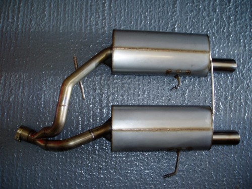

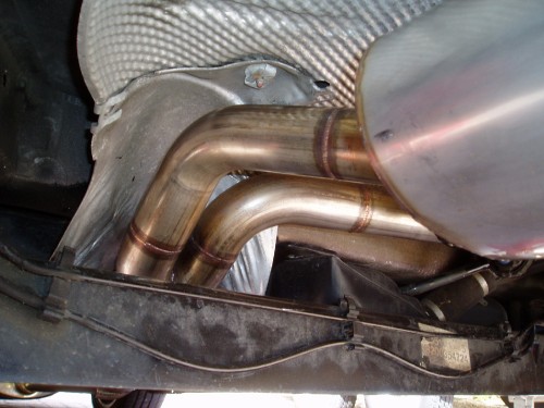

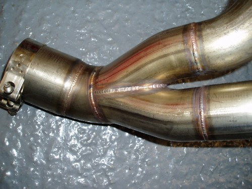

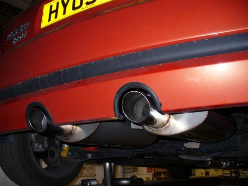

Now this is what you should be getting for around the £500 mark, check the quality of manufacture out on this! Sorry for the thread hijack!

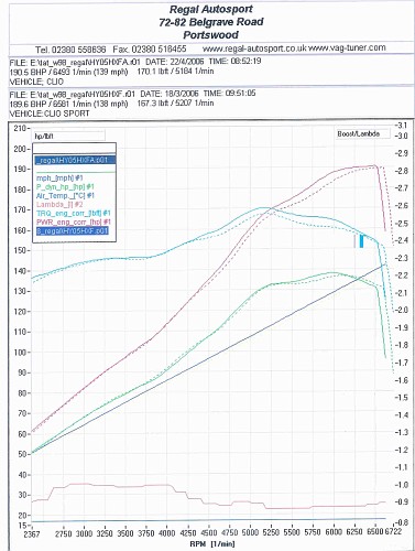

And something else that no one else seems to offer, a before and after power graph, you can really notice the increase in the midrange.
The results were taken from an entirely standard car.
The prototype thats shown has a resonator in place of the cat, this wasn't carried through to production due the high cost of this section.

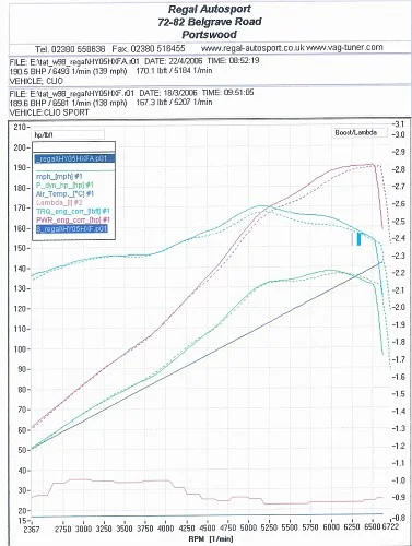

those are nice welds....:)

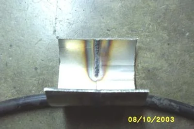

You could weld all the way down the exhaust system with 30 joints, if its back purged then you wont have any problems with turbulence and powerloss.
Absorbtion type silencers with perforated innards are far more likely to cause a power loss than a weld.
  cup 182 mit stripes
Back purging is only to prevent oxidisation. You need root penetration for strength/integrity.
yes, and with oxidation you get impurities and surface irregularities
