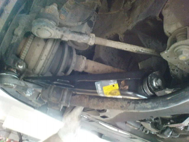

front wishbones ( as the handling had gone very bad!)

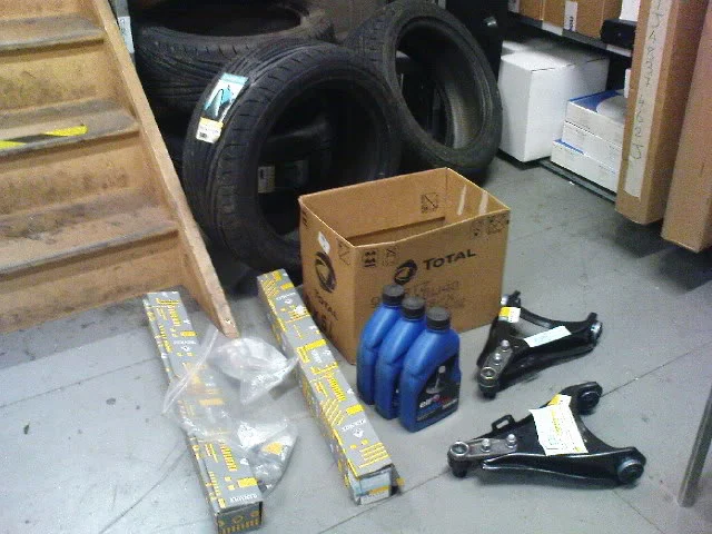

So i ordered 2 new rear shocks and two front wishbones from renault, as well as 3 ltrs of gearbox oil and on oil filter:

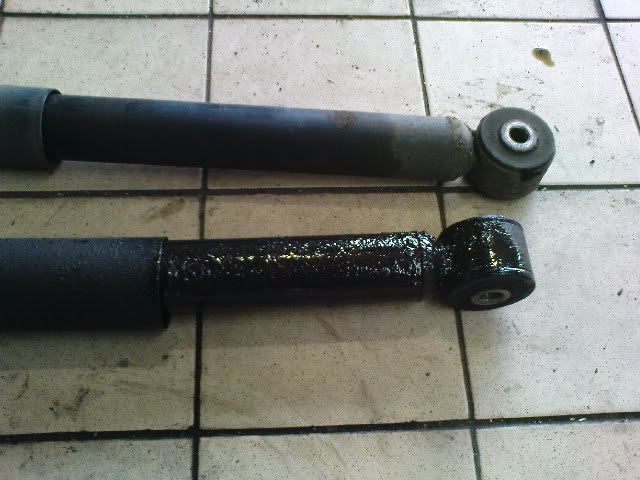

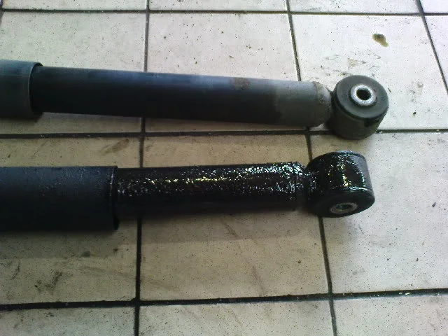

while that was draining i changed the rear shocks, good job by the puddle under the car, have a look at the state of the old ones once they were off and on the floor:

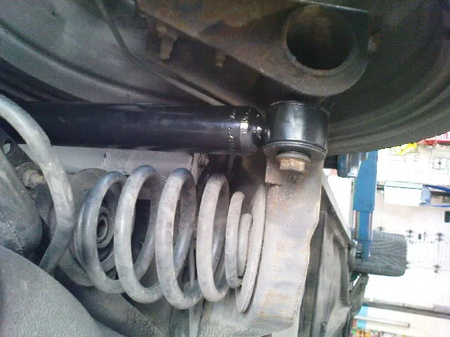

new ones on:

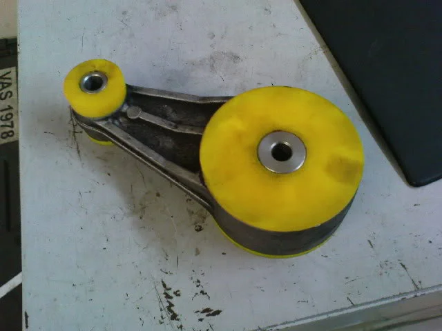

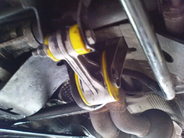

next i took my dogbone mount off and fitted the poly bushes i had ordered from K-terc racing:

I knew the wishbones were going to be a pain as the rear wishbone bushes had sheared from the metal sleeve, and caused us no end of problems, after what seemed like a million years of trying with air guns, breaker bars etc, we resorted to oxy bottles!
We burned the bushes away lol and got the bolts out adventually, and the new ones popped in right away.
