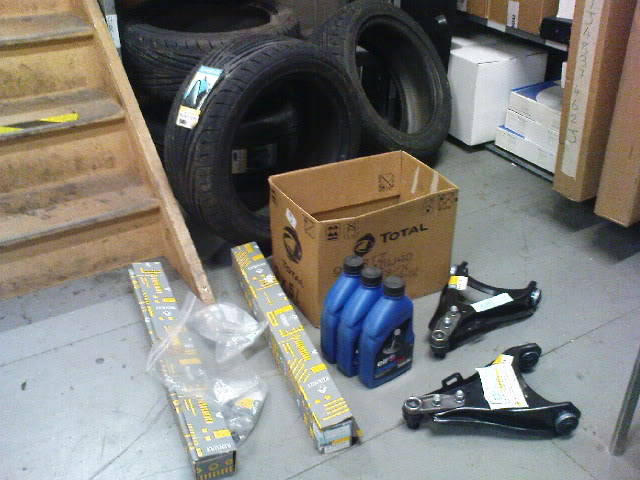

So i ordered 2 new rear shocks and two front wishbones from renault, as well as 3 ltrs of gearbox oil and on oil filter:

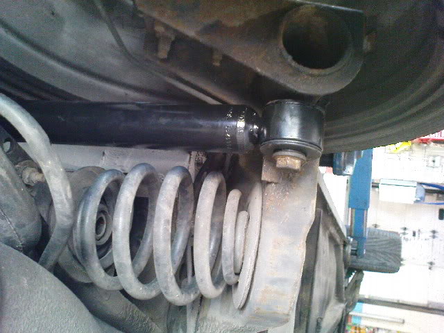

while that was draining i changed the rear shocks, good job by the puddle under the car, have a look at the state of the old ones once they were off and on the floor:
new ones on:

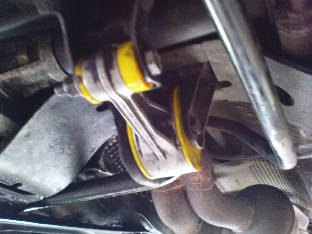

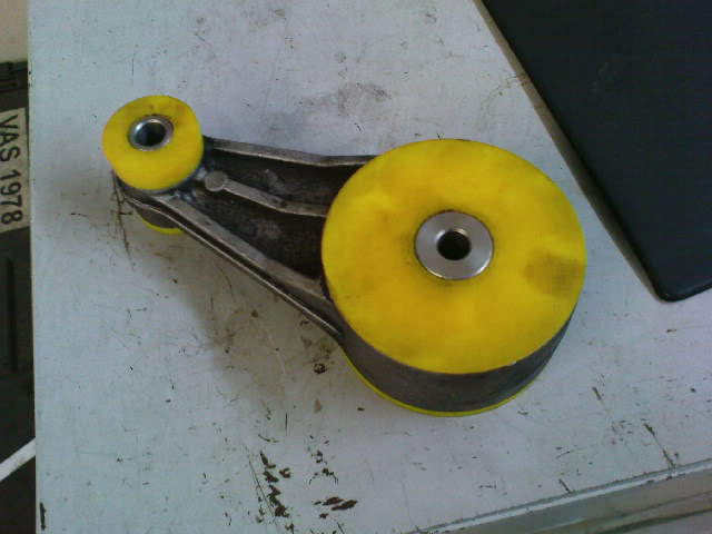

next i took my dogbone mount off and fitted the poly bushes i had ordered from K-terc racing:

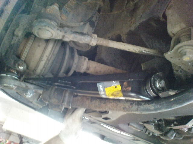

once these jobs were done the hard one was started.
I knew the wishbones were going to be a pain as the rear wishbone bushes had sheared from the metal sleeve, and caused us no end of problems, after what seemed like a million years of trying with air guns, breaker bars etc, we resorted to oxy bottles!
We burned the bushes away lol and got the bolts out adventually, and the new ones popped in right away.

Looks like some good work there. How much difference did you notice from the dogbone bushes?

How hard is it putting the poly bushes on? just take off dog bone mount?2 bolts?
The hard bit is getting the old bushes out mate, you will need a press. The new bushes push in by hand.

what are those poly bushes like,another thread said that they make load of noise,and they revert back to the old rubber ones. was just interested as i wanted to buy some
The noise is no difference at all mate, if you drove it you wouldn't be able to tell any difference noise wise i think, nice and tighter now.
Yeah there is a difference mate, gearchange feels better, and slightly less movement from the engine on gear changes

nope, that was ok chap, suprised me really as the wishbones were the originals, so thats 127,000 miles!
Did alright then mine only on 77 & the off side needed doing, so thought best just change them both, piece of mind and all that lol
