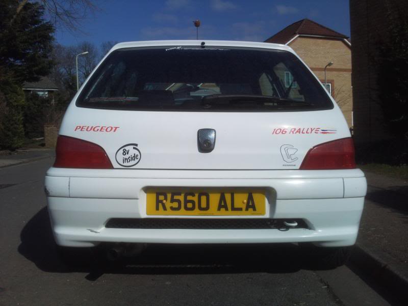

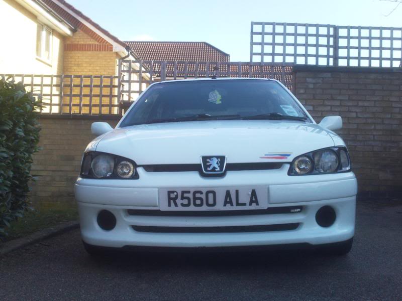

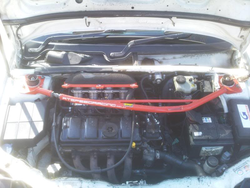

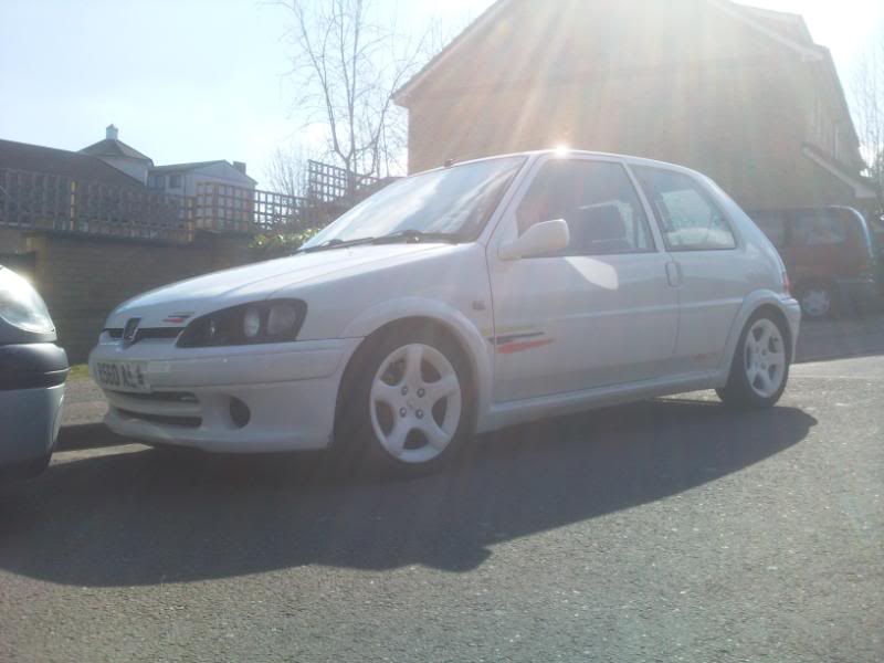

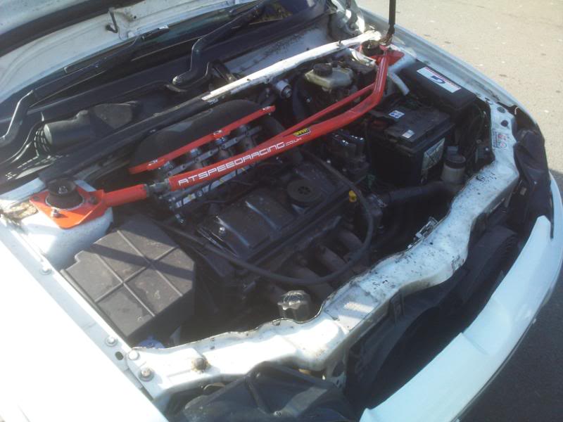

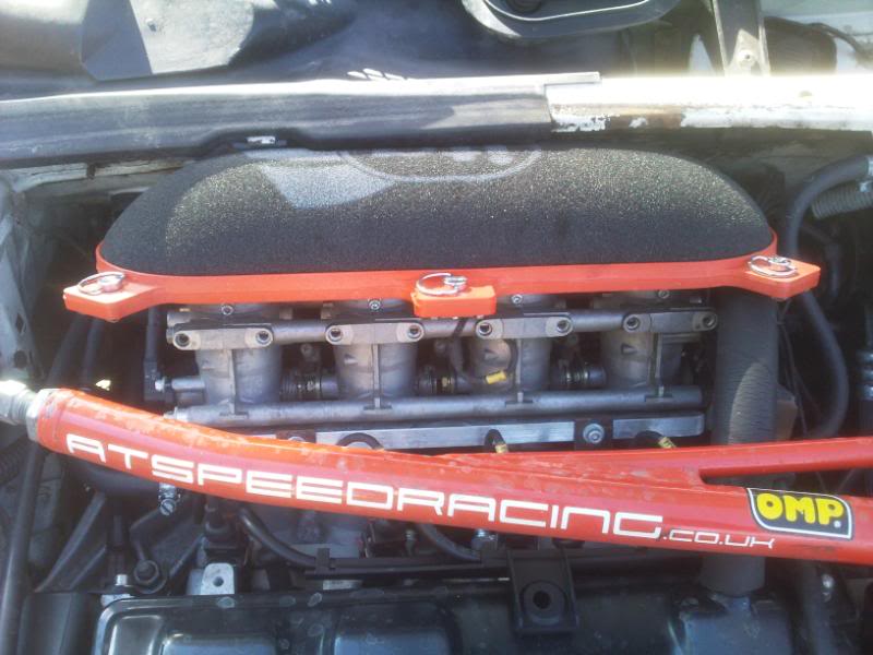

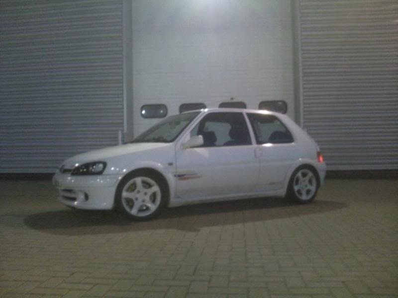

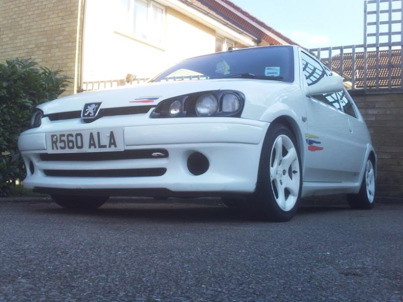

Took couple pictures after i had the Rallye a wash. thought i'd best be quick as the weather was bloody brilliant and knowing this country wouldnt last long. Hopefully get vids up in next week or so. Pics taken on a Samsung M8800 Pixon Camera Phone. 8.1Mega Pixel. not too bad i thought.

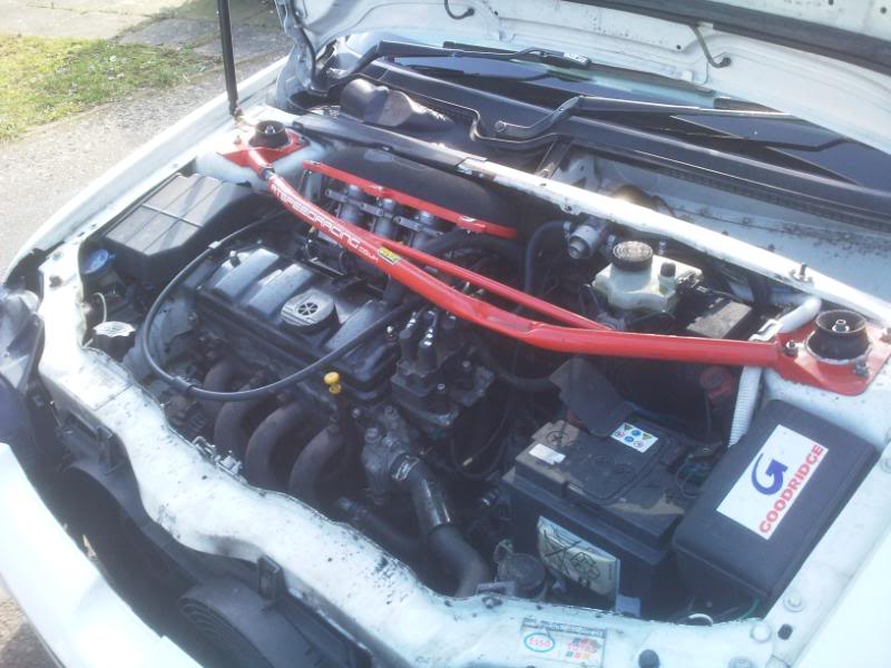

Full Spec List
Peugeot 106 Rallye S2 Bianca White 1.6 8v.
GSXR 1000 K2 Throttle Bodies – Sandy Brown/Colin Satchel Set up
ITG ‘Sausage Type’ Air Filter
QEP 8v Head
Omex 600 ECU and Loom – Mapping by Atspeed Racing
Peugeot 406 2.0 16v ‘Pink’ Injectors 190cc @ 3 Bar
Cat Cam 4900645 & Cat Cam Vernier Pulley.
OMP Inox Grp A 2 inch Exhaust System
Janspeed 4-2-1 Exhaust Manifold
Atspeed Racing Map - 158bhp & 129ft/lb at the Fly Wheel.
Mocal 13 row Oil Cooler
Peugeot 306 Gti-6 Callipers & Black Diamond Drilled & Grooved Discs & EBC Green Stuff Pads.
Goodridge Steel Braided Brake Hoses.
Griffith Grp N Gear Linkages
Peugeot 306 Cyclones in White with Toyo Proxes T1-R - 195/45/15.
Bilstein B8 Dampers lowered 40mm
Group N Suspension Top Mounts
Powerflex Polybush Front kit.
BBM Group N Fast road Gearbox mount & Spoox Group N Race/Rally Engine mount & Peugeot Sport Group N lower engine mount, BBM Grp A Fork Bush
Omp Front Upper Strut Brace.
Morettes Head Lights - Gloss Black
H.I.D Lighting 6000k.
Sparco Aero Windscreen Wipers
Soon to be.
Hi Comp Pistons
Forged Steel Con Rods
More Head Work – Porting, Matching Ports etc
Further Mapping @ Atspeed Racing
Try out some different size Trumpets for comparison
