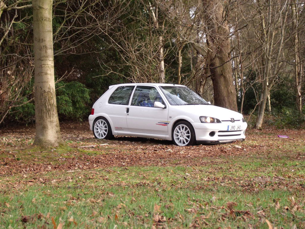

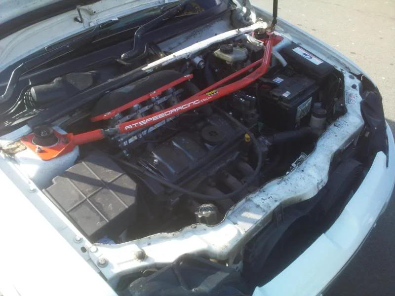

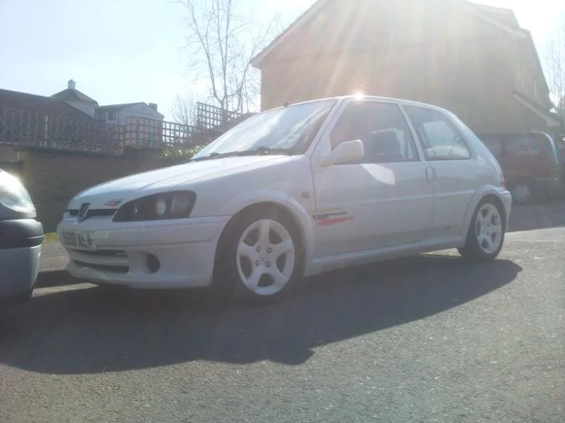

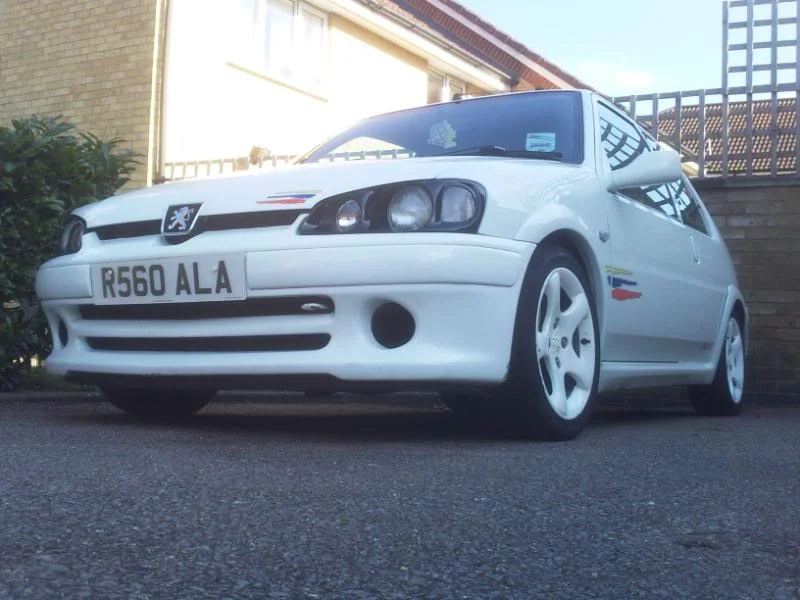

Took couple pictures after i had the Rallye a wash. thought i'd best be quick as the weather was bloody brilliant and knowing this country wouldnt last long. Hopefully get vids up in next week or so. Pics taken on a Samsung M8800 Pixon Camera Phone. 8.1Mega Pixel. not too bad i thought.
Full Spec List

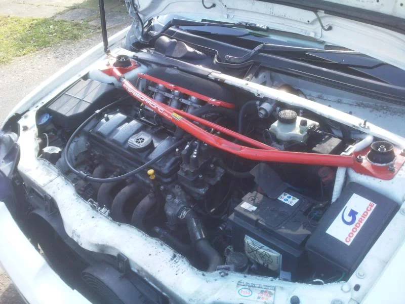

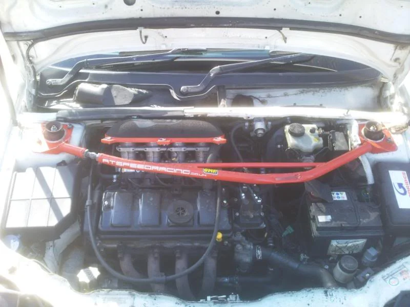

Peugeot 106 Rallye S2 Bianca White 1.6 8v.

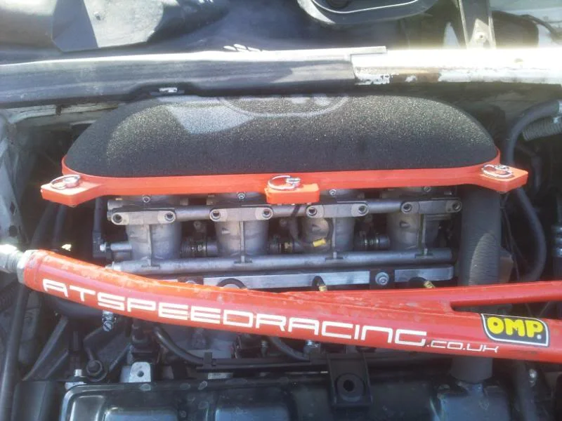

GSXR 1000 K2 Throttle Bodies – Sandy Brown/Colin Satchel Set up
ITG ‘Sausage Type’ Air Filter
QEP 8v Head
Omex 600 ECU and Loom – Mapping by Atspeed Racing
Peugeot 406 2.0 16v ‘Pink’ Injectors 190cc @ 3 Bar
Cat Cam 4900645 & Cat Cam Vernier Pulley.
OMP Inox Grp A 2 inch Exhaust System
Janspeed 4-2-1 Exhaust Manifold
Atspeed Racing Map - 158bhp & 129ft/lb at the Fly Wheel.
Mocal 13 row Oil Cooler
Peugeot 306 Gti-6 Callipers & Black Diamond Drilled & Grooved Discs & EBC Green Stuff Pads.
Goodridge Steel Braided Brake Hoses.
Griffith Grp N Gear Linkages
Peugeot 306 Cyclones in White with Toyo Proxes T1-R - 195/45/15.
Bilstein B8 Dampers lowered 40mm
Group N Suspension Top Mounts
Powerflex Polybush Front kit.
BBM Group N Fast road Gearbox mount & Spoox Group N Race/Rally Engine mount & Peugeot Sport Group N lower engine mount, BBM Grp A Fork Bush
Omp Front Upper Strut Brace.

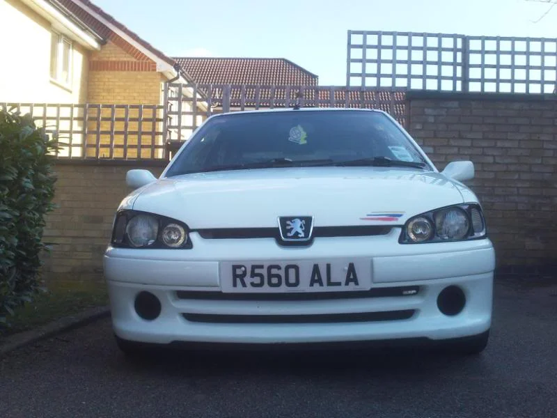

Morettes Head Lights - Gloss Black
H.I.D Lighting 6000k.
Sparco Aero Windscreen Wipers
Soon to be.
Hi Comp Pistons
Forged Steel Con Rods
More Head Work – Porting, Matching Ports etc
Further Mapping @ Atspeed Racing
Try out some different size Trumpets for comparison

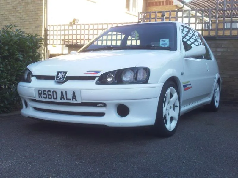

Looks and sounds awesome mate. Cyclones look the dogs on 106s imo so ignore the haters. Its funny how on here its the turini/silvervisons brigade, and even people on here think there is only one way to mod a 106.
Mod it how you like. You are obvisouly proud of it and I think it looks ace.

I've always thought morettes are awful. They'd look better the same colour as the car but not a shade on standards.

Car nice, shame about the cyclones though, Has to be steeles or motorsport wheels for me on a rallye IMO

the Steelies came off because they were total ditch finders. The cyclones were free and allowed a 195 tyre.
The morettes look much better than standard. imo. for Track use which the car will get the inner lights can be removed for extra air flow and cooling.

lol at all the people moaning at you for not keeping it pure, its a 8v rallye, far purer than all the 16v pap floating around these days ... 158bhp is some going ... but well, i see the words Sandy Brown/Colin Satchell & that says it all about the build tbh. Its proper.
Re: the morettes, Ihad them on both my 106s - they serve a purpose imho. The standard lights are sh1te & those would light up an airport!! Cyclones, well id rather have comp mo's ...
Btw OMP inox exhaust. Ummm jealous :eek:

the OMP is a rare sight and well worth the doh i paid for it. even if it was second hand never been used!! sounds EPIC!! But no match for Bodies on full chat!!

Morette main beam > standard headlight main beam by a million miles. Definately a worthwile mod.
