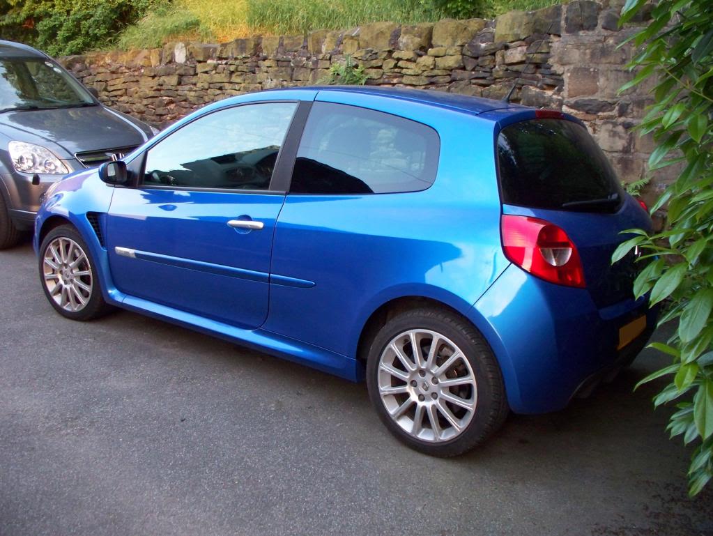

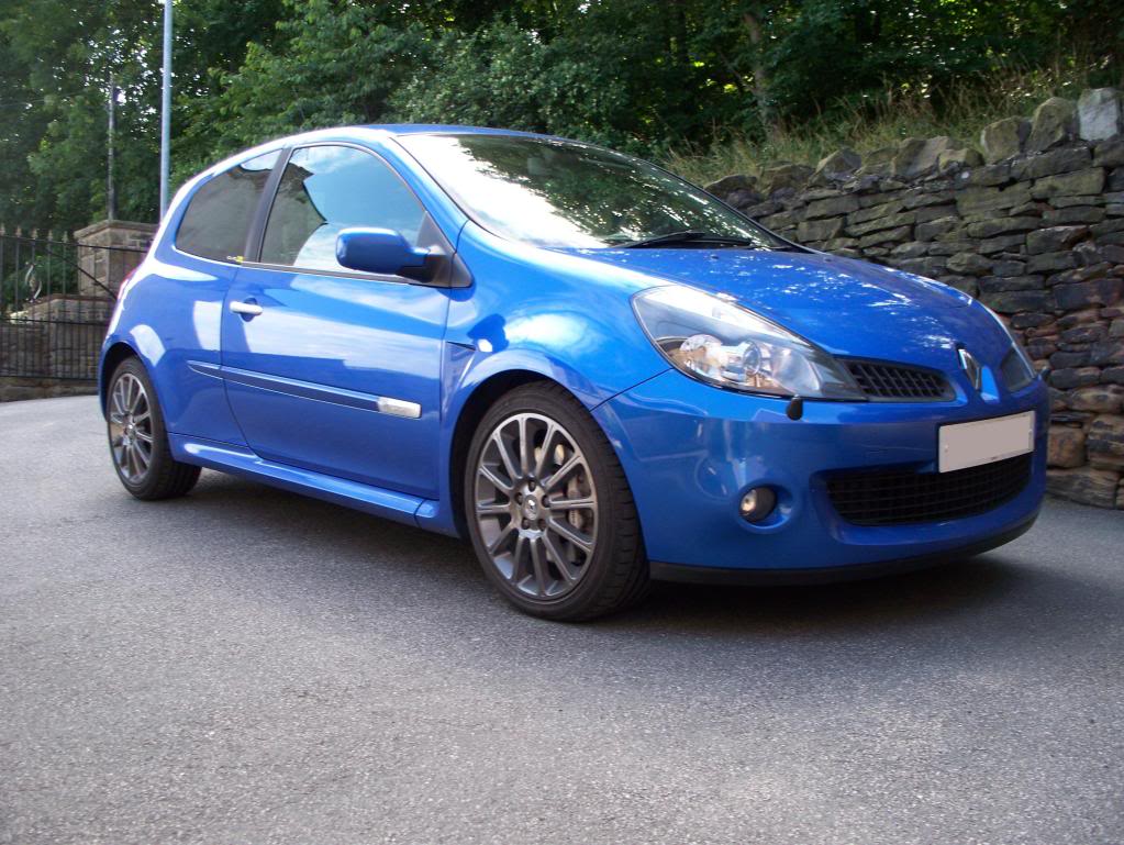

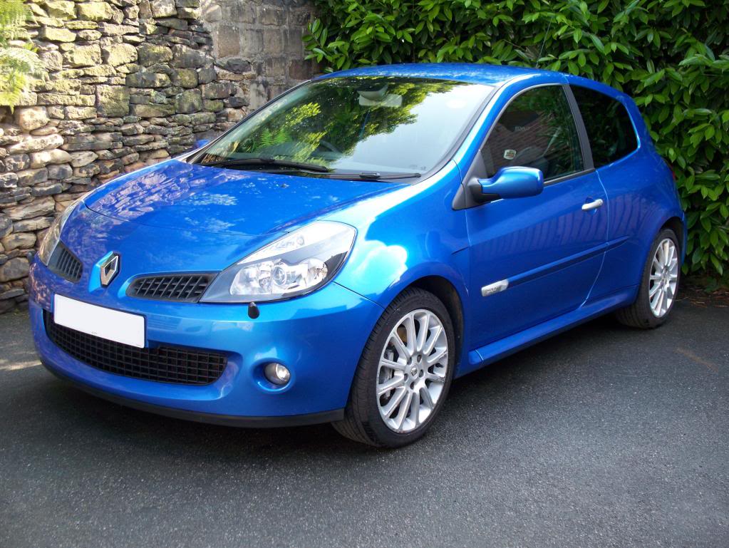

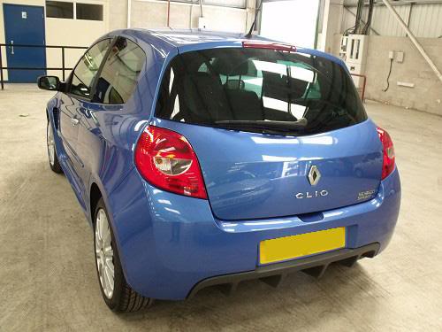

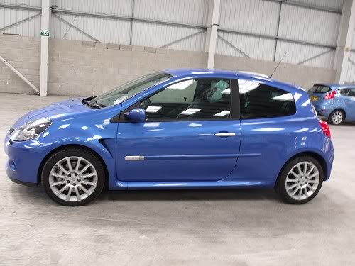

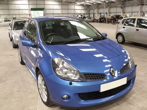

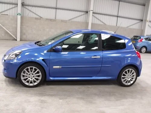

Haven't done anything to the exterior yet, but here are some pics anyway, just in case anyone has forgotten what an Albi blue one looks like...
The bodywork has worn really well (hopefully I won't come to eat my words when I wash it...), but the interior fabrics seem very prone to pulls. Also the bolsters aren't as durable as they might be, but that seems to be the case with the Recaro's too.

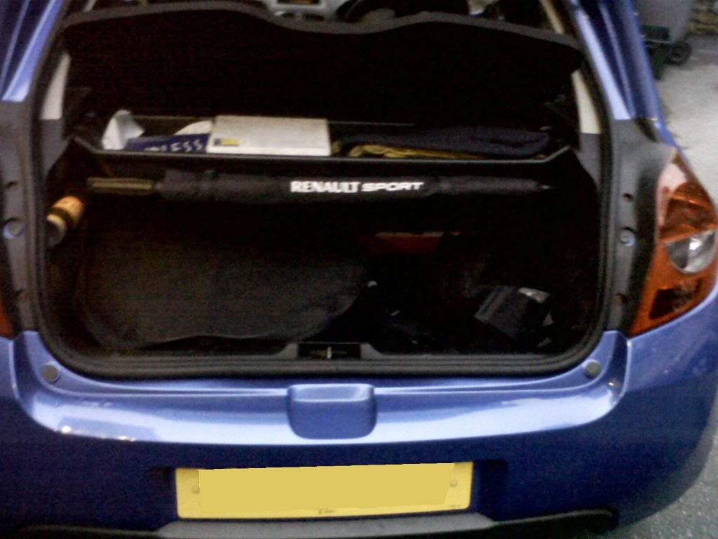

So, quick trip to the garage this morning saw the exhaust joint repaired and the thermostat replaced. However it still doesn't seem to go over around 85C; I doubt it is doing any harm though, so will probably just leave it for the time being, and see how things go.

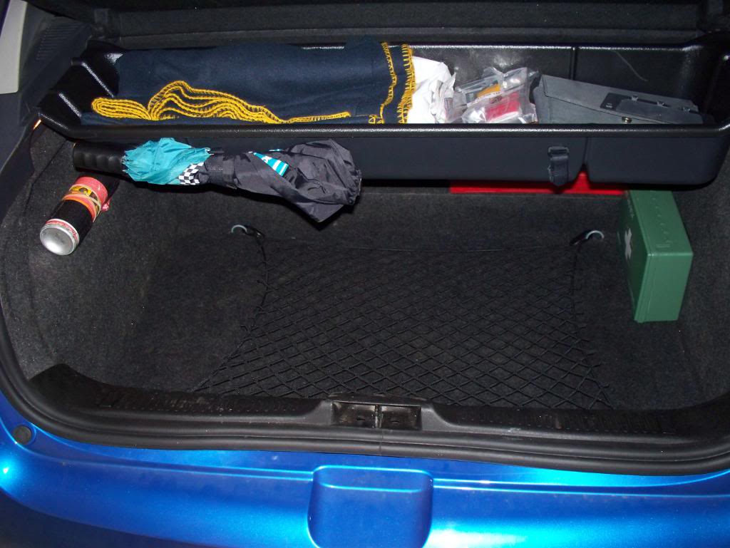

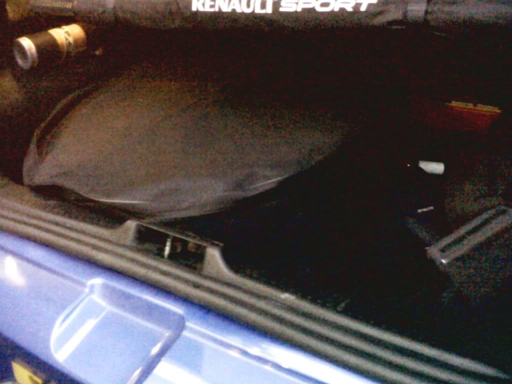

Also fitted a boot tray, used boot mat (old one had oil on it, and I could not stop it feeling greasy, no matter what I did), and a used low mileage gear knob (stitching was coming out on the old one).

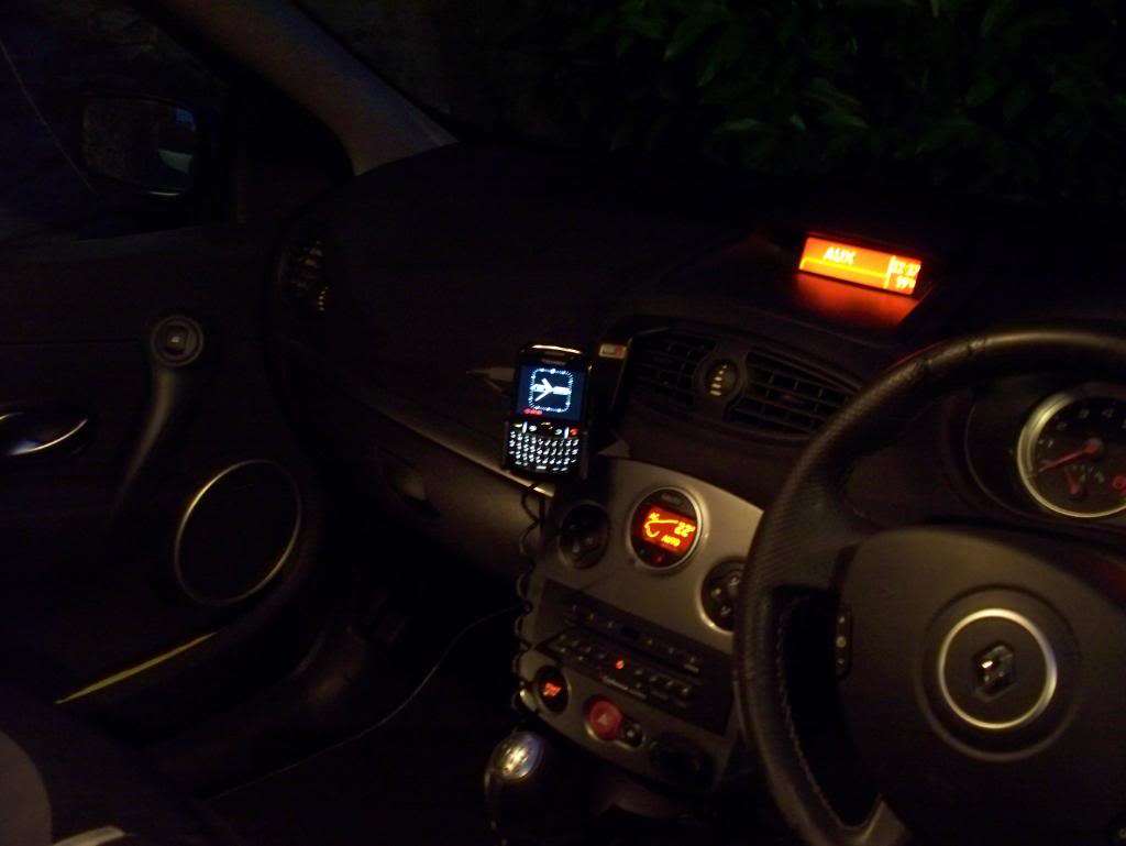

Finally, a few pics;

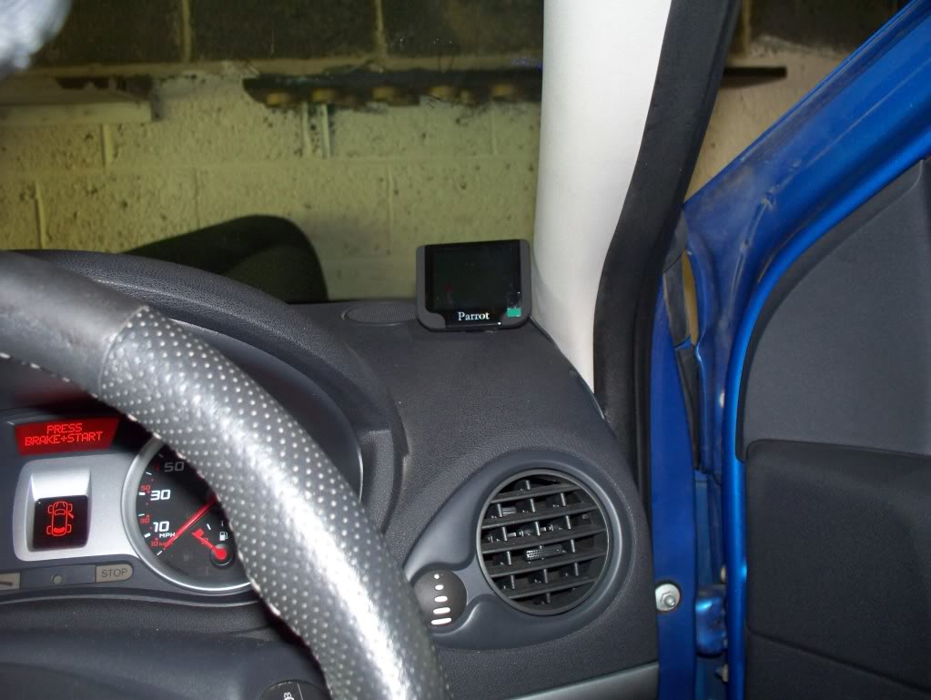

Parrot kit display;
Controller;
Wiring into glovebox;

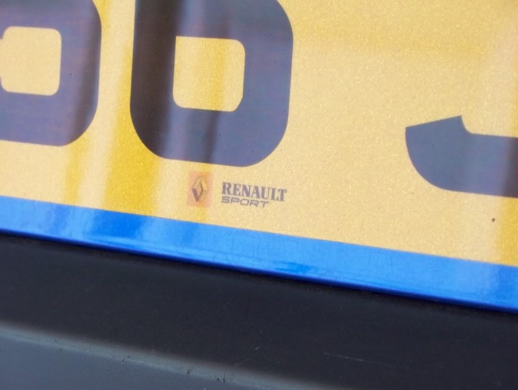

RenaultSport registration plates;

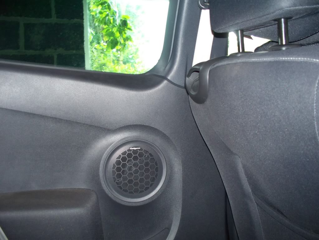

Cabasse rear speaker grilles;
Tidy boot!

Interesing placement for the mki 9200 screen an remote
Nice bit of kit though I've got a 9100 my screen is on the center consol with the remote on the wheel I've been unable to find a better place is it not to low where you have it ?
Was it quite hard to fit as I lernt with my cabasse it's quite complex with it's wireing
  Clio 197
Remote location is fine, you rest your hand on your knee, or the gear knob, plus it is accessible by the passenger if necessary. I wanted the screen to be as close as possible to my eyeline, for minimal adjustment in focal length.
Fitment was pretty straightforward to be honest, though had I not removed the drivers seat, it would probably have been a lot more awkward.
The Cabasse is nothing to be afraid of, you just need to think about it differently.
With mine I have wired the line out from the Parrot directly into the red plug on the Cabasse, which seems to work quite nicely.

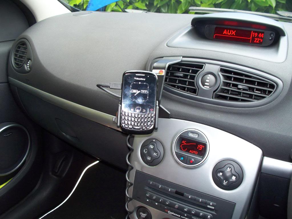

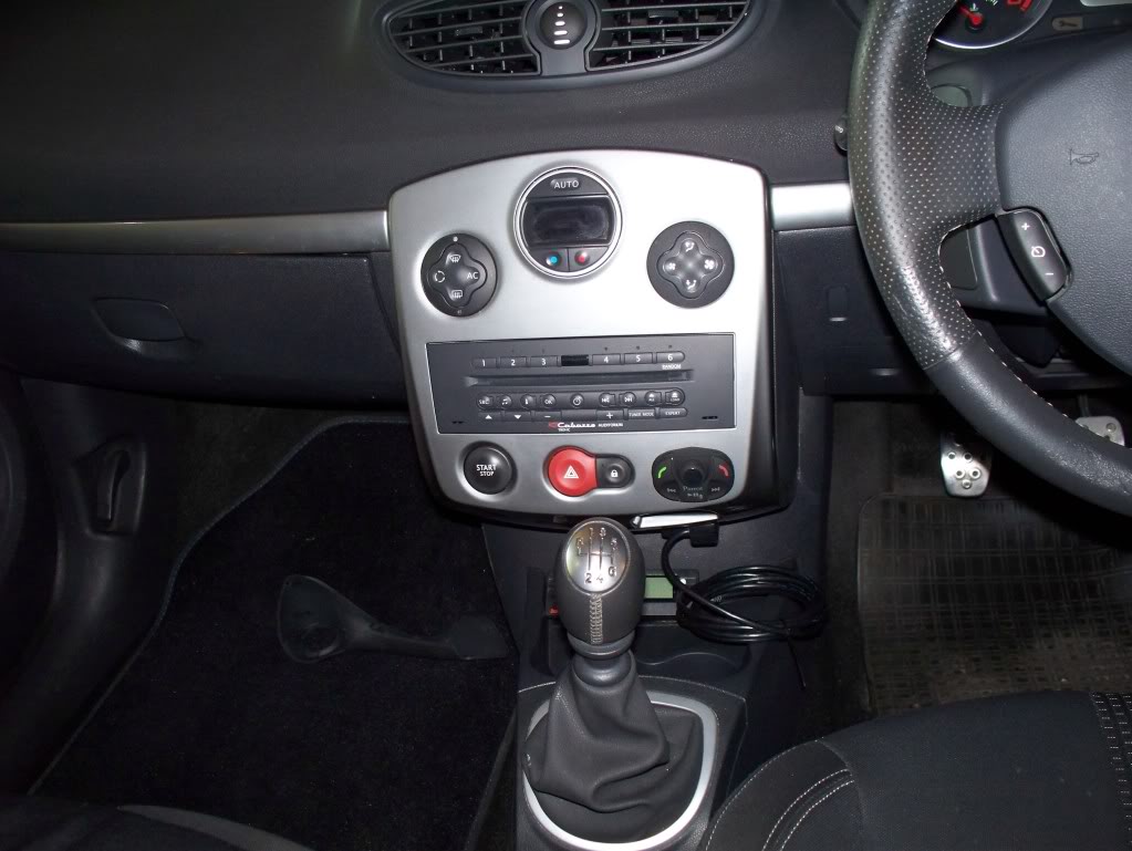

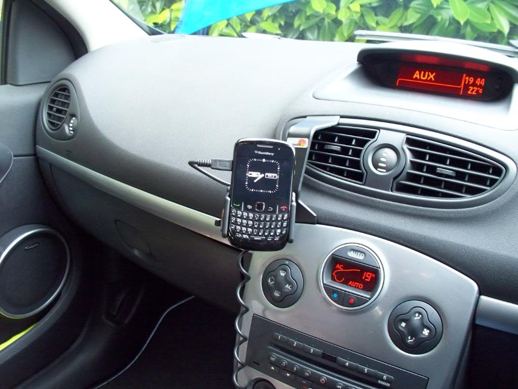

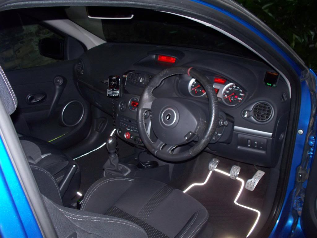

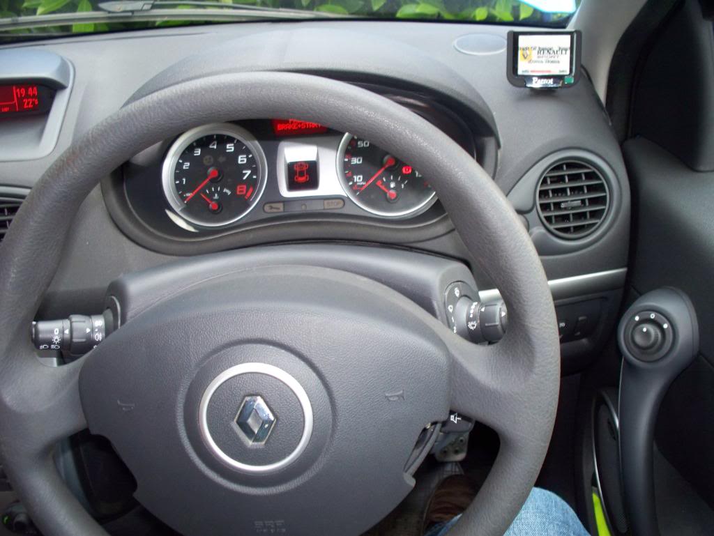

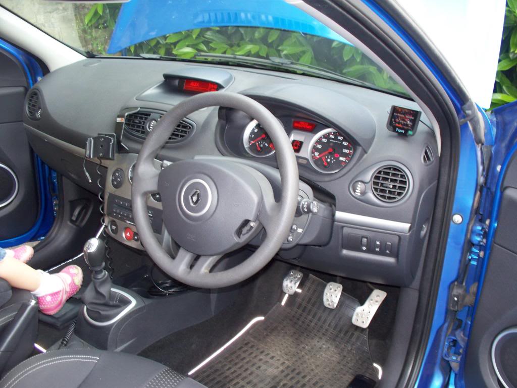

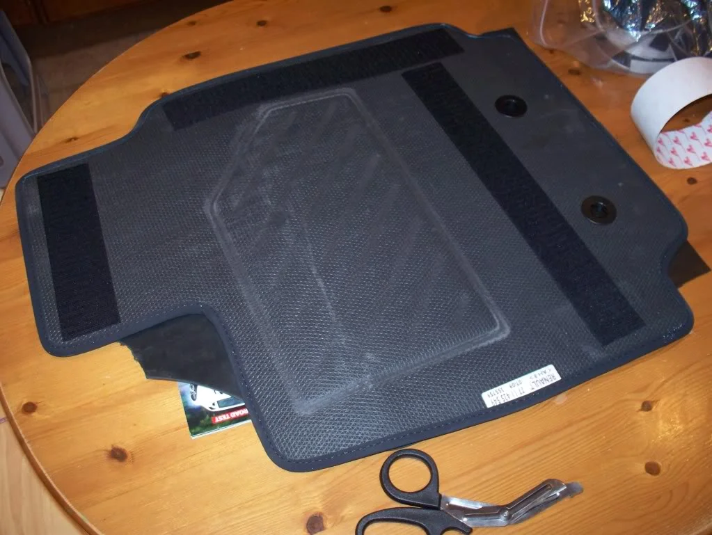

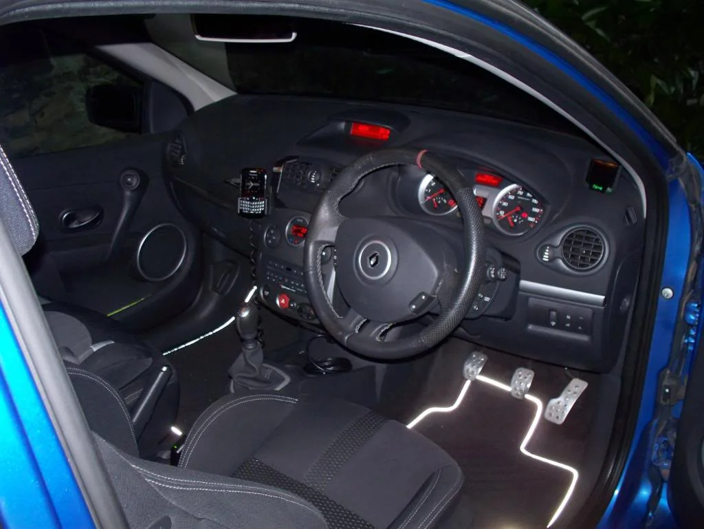

Fitted the phone cradle last night, and got my RS mats in too.
The phone cradle needs to be hard wired, but in the meantime, because I didn't have the time last night to do that, and need to work out what else needs wiring in, I have just fitted it using a cigar lighter power adaptor, hence the trailing wires.
Phone cradle

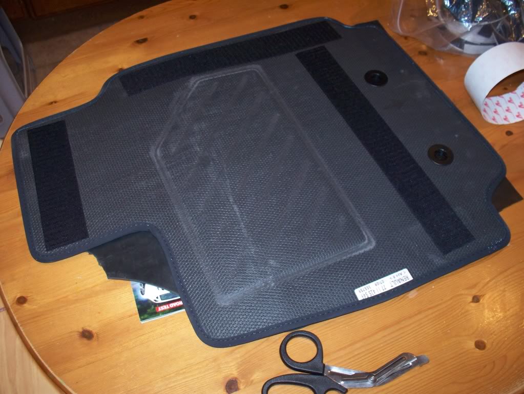

Self-adhesive velcro on the rear of the drivers floor mat; if I was doing it again, the bit at the very end of the mat, near the pedals, would be put somewhere else - I had forgotten how far the plastic heel pad goes.

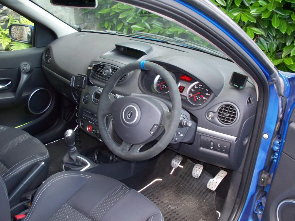

Interior, showing mats and phone bracket

Ok, some useful info, and today's progress;
Just thought this might be some useful info for anyone with Cabasse, thinking about adding an external device.
The Parrot kit has a line-out, in the form of four loose wires, representing right +, right -, left + and let -. When I fitted the same kit to the Honda, I was bemoaning the lack of plugs, but with Cabasse, it is actually handy as you can wire these (need to extend them first) directly into the red plug into the underseat stereo unit.
For reference, the rellevant pins are as follows;
27 ground
28 right
29 ground
30 left
If you remove the grey clip from the plug, you will see that one side is already partially populated. We are interested in the other side, where position 30 is the diagonally opposite the populated area, i.e. the opposite side, and opposite end.
Rather than cutting the plug, I cut up an PC internal audio cable, fitted insulated connections, and inserted the brass sockets from the PC cable into the red plug.
The parts that I used to fit the Parrot kit were;
Parrot Mki9200
2.5m double ISO extension loom
5m dual core wire (to extend line-out)
2.5m single core wire (to extend phone mute)
Various bullet type insulated closures
PC audio cable, with four pins populated
Stereo removal tools
Various cable ties
Disconnect negative terminal of battery
Remove & disconnect dash mounted head unit
Remove & disconnect Cabasse unit under drivers seat
Remove side access panel on drivers seat
Disconnect airbag plug
Detach seat wiring from rear of Cabasse mounting
Undo 4 x torx bolt securing drivers seat
Remove drivers seat
Remove interior trim at bottom of drivers door, to kick panel
Remove door rubber alongside drivers A Pillar
From the Parrot kit, take the microphone, remove the self adhesive mounting and instead fit the slide clip mounting, fit the mic above the rear view mirror, guide the wiring just inside the headlining, around the top of the A pillar (this is tricky) then down the A pillar and refit the door rubber here to secure. Run the wire down to the drivers footwell area.
Assuming you are going to fit the screen where I put it, this is also a great opportunity to do that and again guide the wiring, behind the door rubber, down to the drivers footwell.
Take the Parrot wiring loom and connect it to the ISO extension. The mute wire isn't populated on the extension, connect it to the the extra single core wire with an insulated closure, then along ISO extension to extend the phone mute. The line-out wires also need to be extended, so take the 5m of dual core wire, cut to 2 x 2.5m, and use to extend the line-out wiring. You can now fix these additional wires to the rest of the ISO extension harness. Take note of the mute wiring on the Parrot loom, the Clio (like most modern Renaults, I believe) uses mute position 3. Confirm which wire this is at the stereo end of the extension, and you will need to chop the existing wire (it doesn't do anything as that wire isn't populated on the car loom) and join to your extended mute wire, so it connects to the headunit.
Take your PC audio cable, chop the connectors out of the plug, join them to the extended line out wiring, and push into the respective positions on the unpopulated side of the red plug.

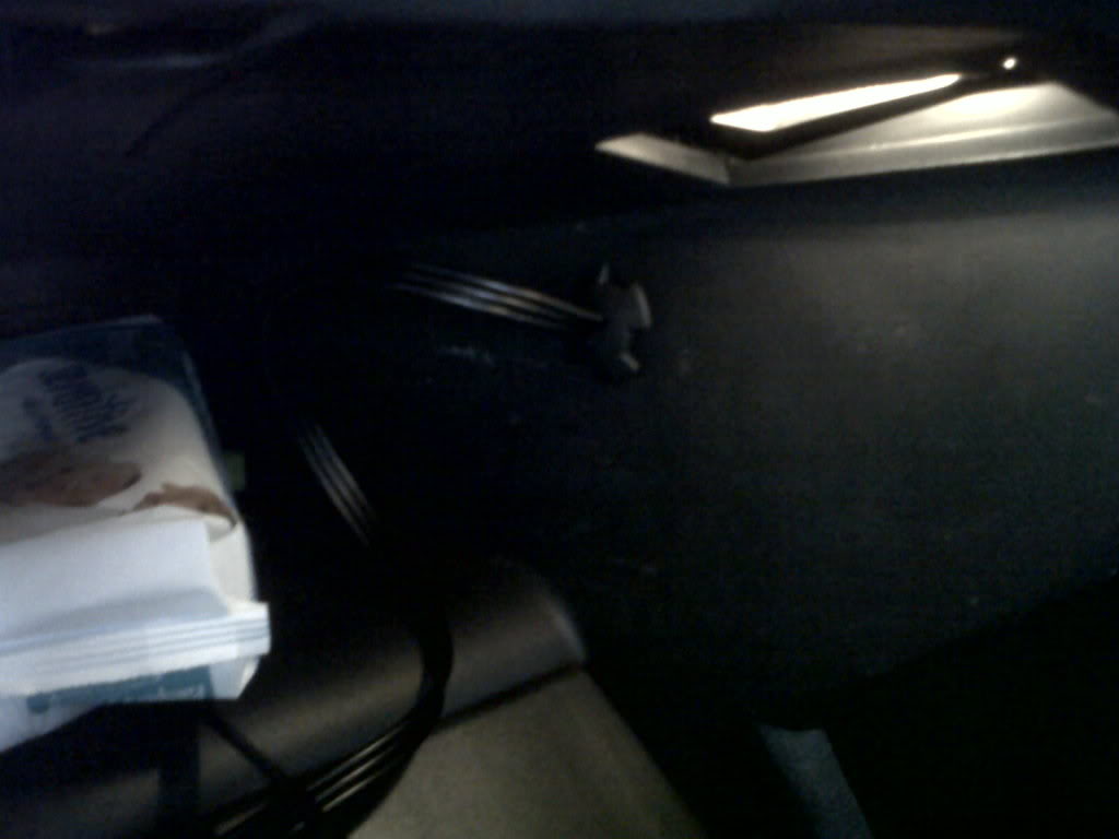

Connect the ISO extension to the car loom, run it under the carpet, along the bottom of the door aperture, and up the drivers kick panel. Secure using existing clips where possible.
Reach down through the stereo aperture, while reaching up from the footwell, and pull the Parrot loom into the stereo aperture. This is awkward, I cheated by pushing the cable for my Scangauge down through the hole, and taping it to the Parrot loom so I could pull it up. Do the same with the wiring for the microphone and screen. Connect up to the Parrot blue box.
Using a conical hole saw, drill a hole in the side of the glove compartment for the input wiring. Push the plug through and pull if from inside the stereo aperture. Connect to the Parrot blue box.
There is enough space to mount the Parrot box to the rear of the audio aperture, tuck it away, reconnect the head unit part, and refit.
Tidy up the excess loose wiring and secure to the bottom of the dash using cable ties, so it is all nicely tucked away.
Refit drivers seat, reconnect airbag (it is awkward to get the wiring back into place), push stereo wiring through the back of the Cabasse aperture, to the front, and reconnect Cabasse. Push Cabasse unit back into place, with a hand at the back to try to keep the wiring tidy. In all probability you won't be able to refit the rear cover on the Cabasse unit, due to all of the ISO plugs, etc. but this shouldn't be a problem.
Reconnect battery, enter radio code, pair phone, connect iPod, marvel at your success!

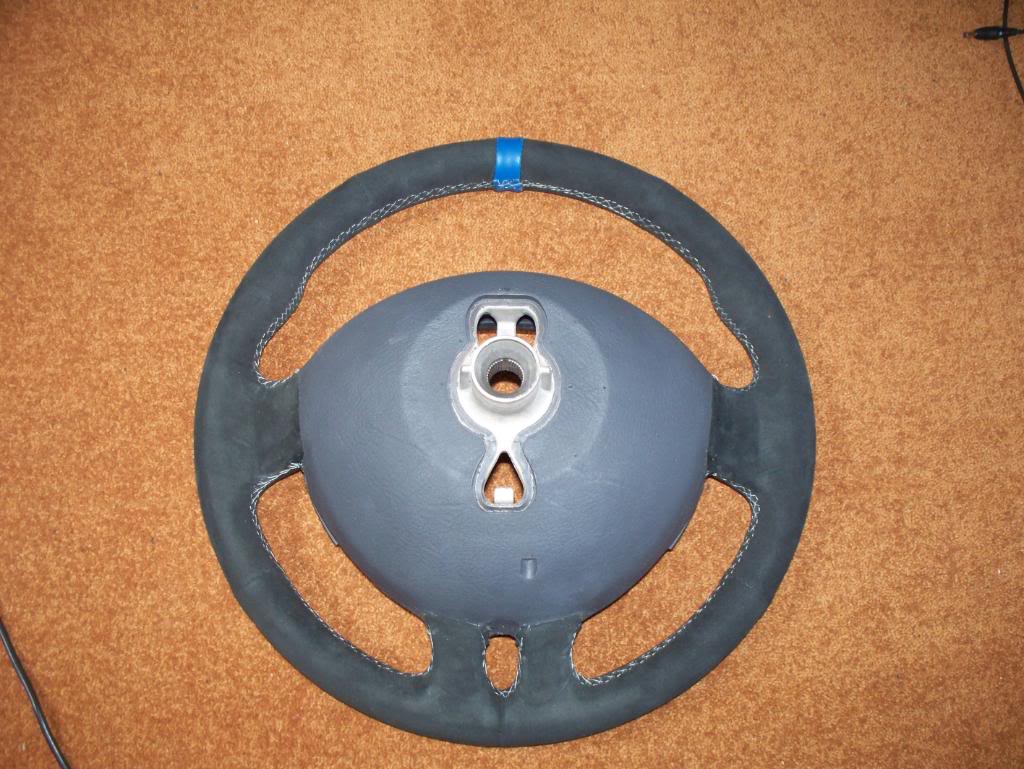

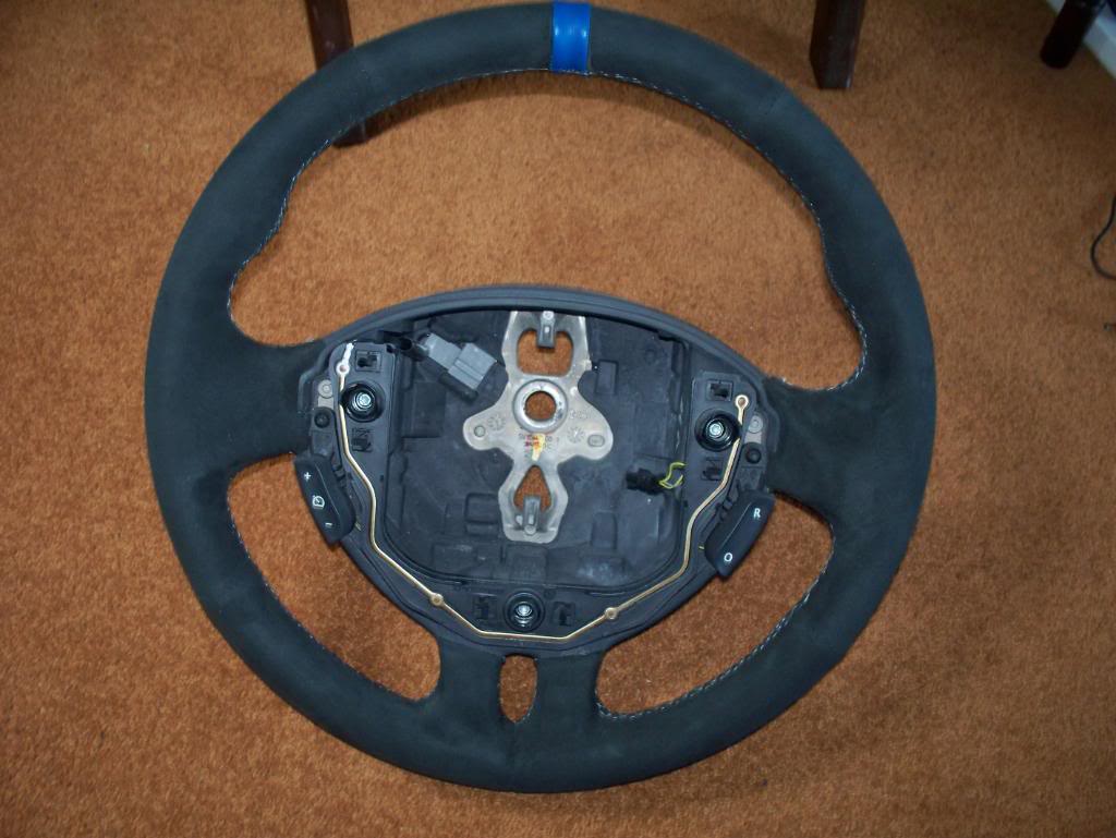

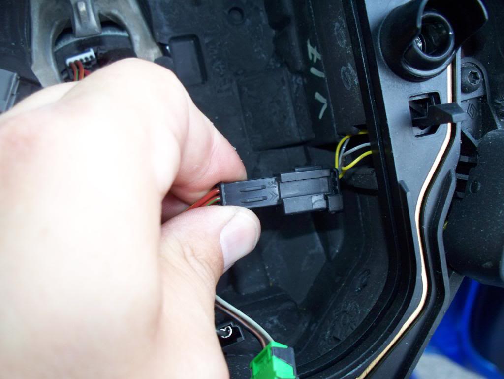

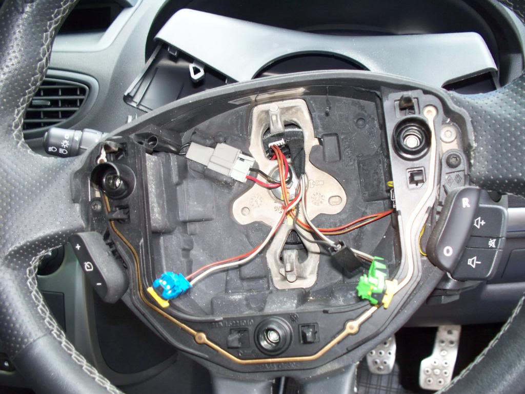

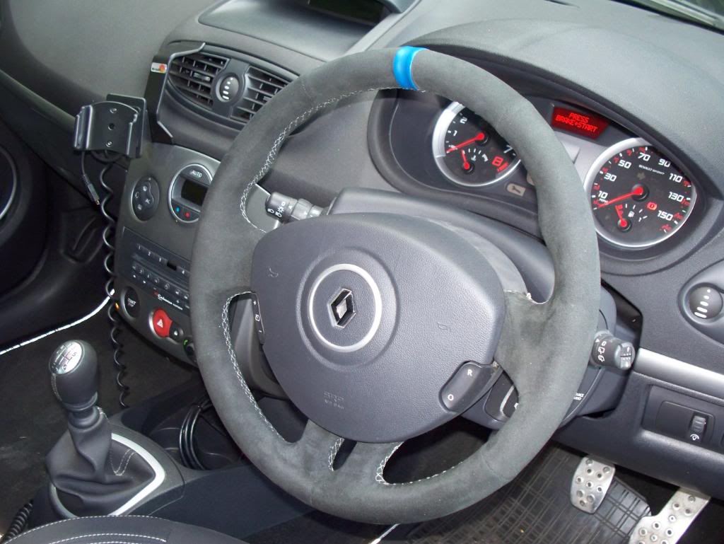

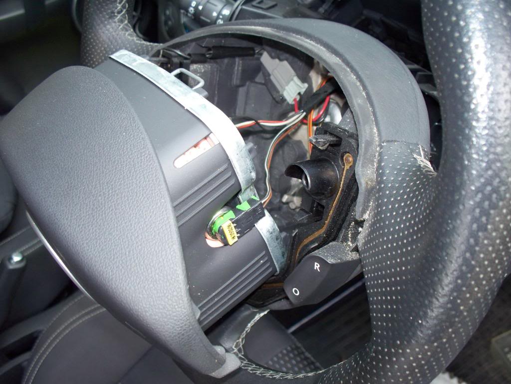

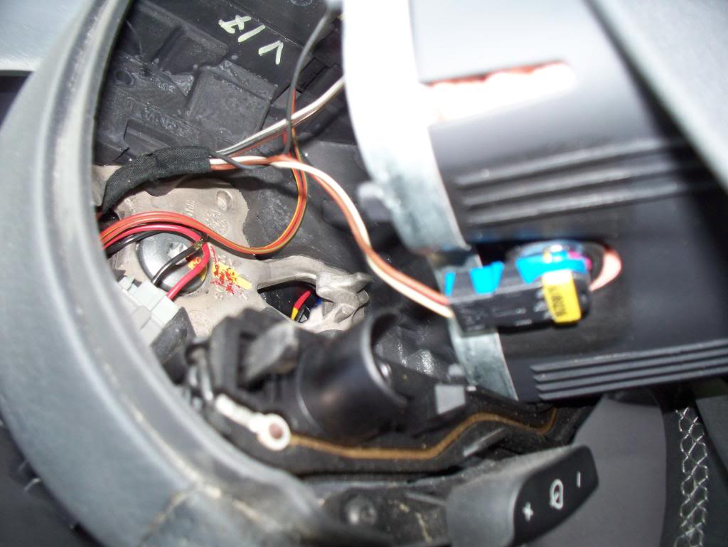

So, that was last week, today's progress has centred around the steering wheel. As you can just about see in the pic above, my wheel has gone a bit nasty, which I think is typical of RS wheels, from what I have read. I had found someone to retrim my Puma wheel, but sold the car before getting around to it, so clearly he was my first thought when I first got the 197, complete with nasty wheel. With this in mind, I hunted out a plain rubber wheel, to use while mine as being retrimmed. This evening I finally got around to swapping them over, so I could get the original retrimmed. Thanks to Ryan197 for his info.
Disconnect negative terminal of battery (I actually just disconnnected the two wires going to the negative, rather than disconnecting the bracket)
Wait 20min or so
2 x torx under the steering column, then tug down and remove, carefully, lots of wiggling necessary.
Using a large flat screw driver, poke into the bottom hole of the wheel, and lift the metal retaining bar, while pulling sharply on the airbag
Disconnect the plugs to each side, and the rear of the airbag, the side ones have a retaining clip which needs releasing before they can be disconnected. There is also an earth to the back of the airbag.
Disconnect the CC buttons (small black plug on the right) and horn (larger grey plug on the left).
Undo retaining bolt using T50 Torx
Remove wheel, guiding wires through the top hole.
Refitting is the reverse
Pics! Not necessarily in a good order;
I haven't swapped the cruise switches over as that would necessitate removing the horn switch, and I couldn't work out how to get them off!
Any questions, please shout!

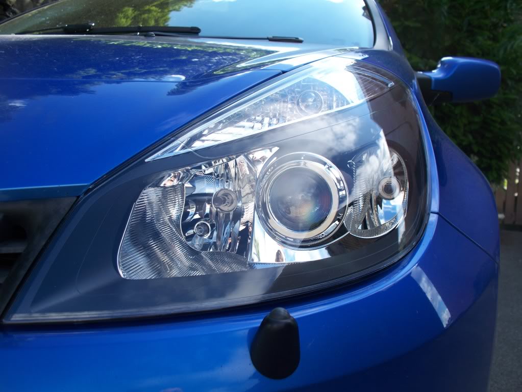

So, today's progress...
I had purchased a new replacement n/s headlamp, unfortunately when it arrived, two of the clips had broken; I did a deal with the seller and bonded them back on this morning, before swapping the headlamp earlier this evening.
So, n/s arch liner off (struggled with some of the clips), bumper off, so far, so good, headlamp out, still looking good, swapped the height adjust motor, feeling very proud of myself, swapped over bulbs, etc. then took it back to the car, and spotted that I had managed to scratch the new headlamp while changing everything over. To say I was cross, was an understatement!
Anyhow, I plugged it in, and everything worked, which was a plus. Then spotted that there is a bumper support fitted to the original headlamp, which was riveted on. Riveted on? Did Renault not expect the headlamp to have to be changed at some point? Anyhow, drilled out the two rivets, swapped them over, refitted bumper, struggled with the o/s arch mounting bolt, but got it all sorted eventually. What a lot of work just to change a damn headlamp!
Rant over, any tips for getting scratches out of headlamps gratefully received, I have some Meguiars PlasteX which I am hoping might work, but any advice would be great.
  Clio 197
Scratches can't have been that deep, barely waved the Plastex bottle at them and bingo, it actually looks like a brand new headlamp, rather than a brand new scratched headlamp. Huge sigh of relief!

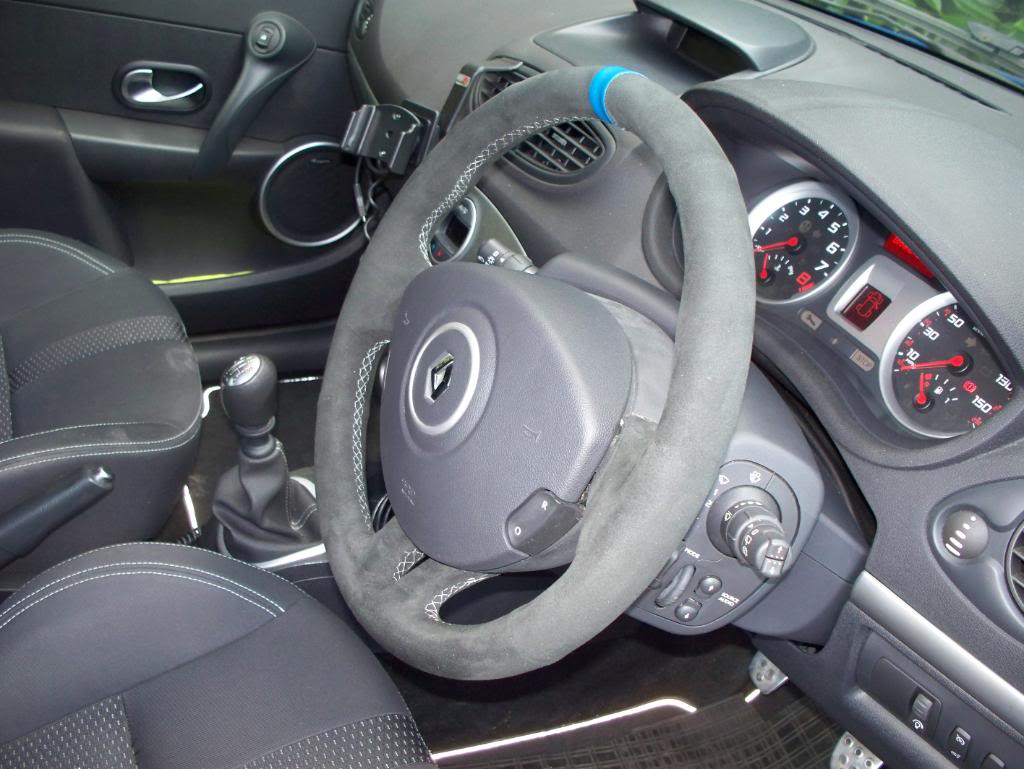

Ok, just got the new wheel today, and fitted it earlier this evening;
Overall I am really pleased with it, there are a couple of small creases, but for £145 I am not complaining. If nothing else, it is unique!

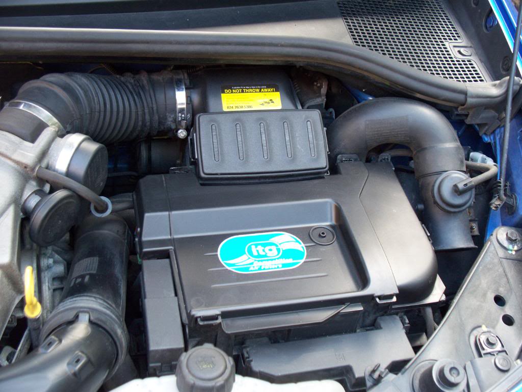

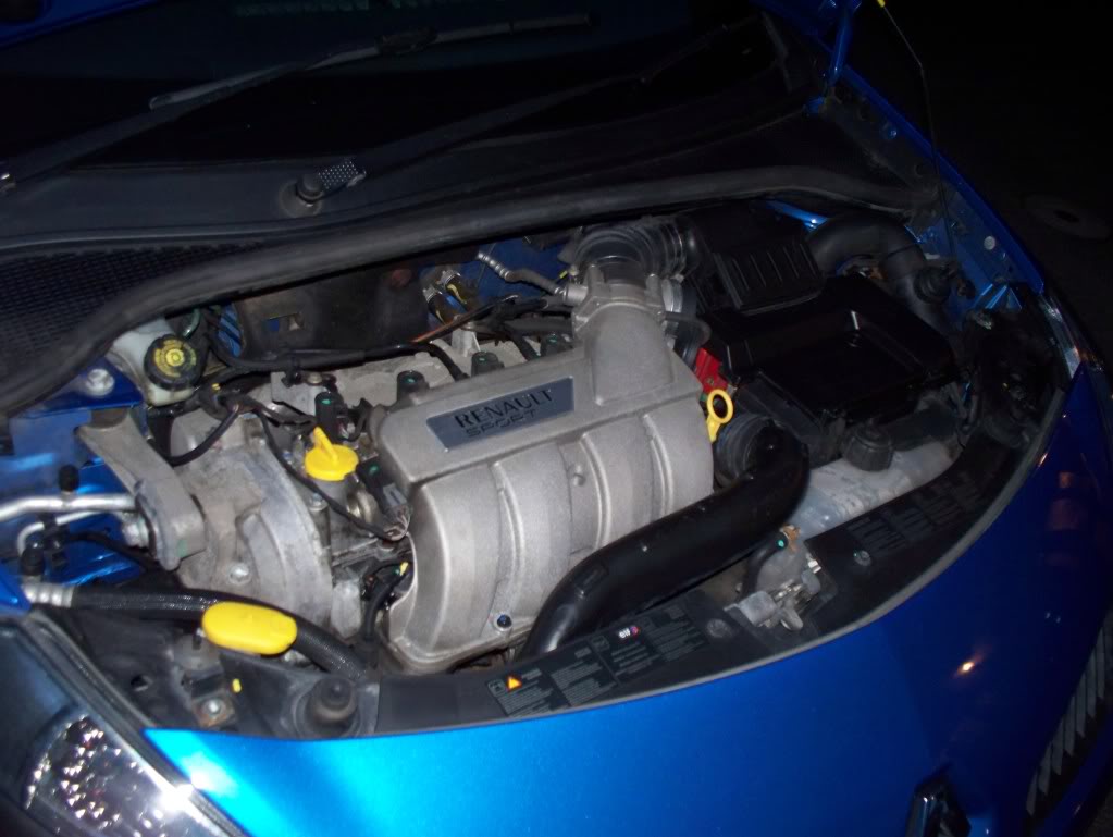

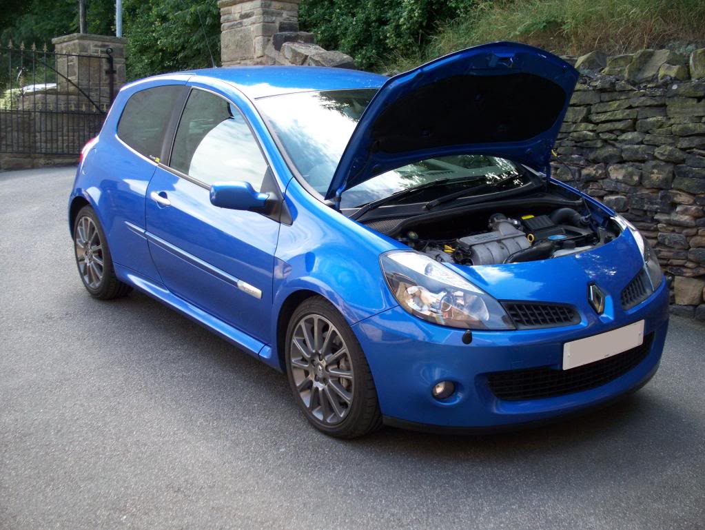

Nothing exciting, but gave the car a wash - the rear diffuser is massive! Also cleaned the engine bay;

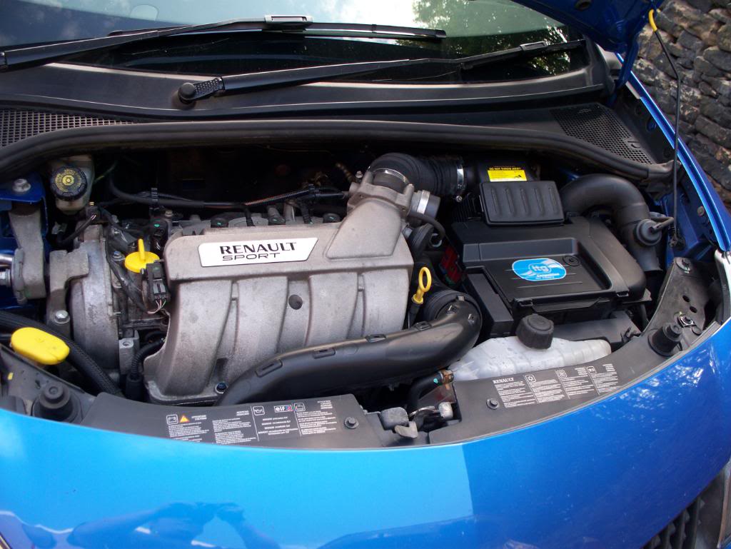

Engine bay is by no means perfect, but looks a lot better than it did. If only I could find my ITG stickers - I put them somewhere safe when I fitted the filter, I just don't know where!

  • RenaultSport tax disc holder
  • Repaired o/s headlamp wash - the valve inside had blocked, but I didn't find this out until I had put the airline on it, and split part of the hose - d'oh!

  • Fitted ITG stickers on the air filter housing and battery cover

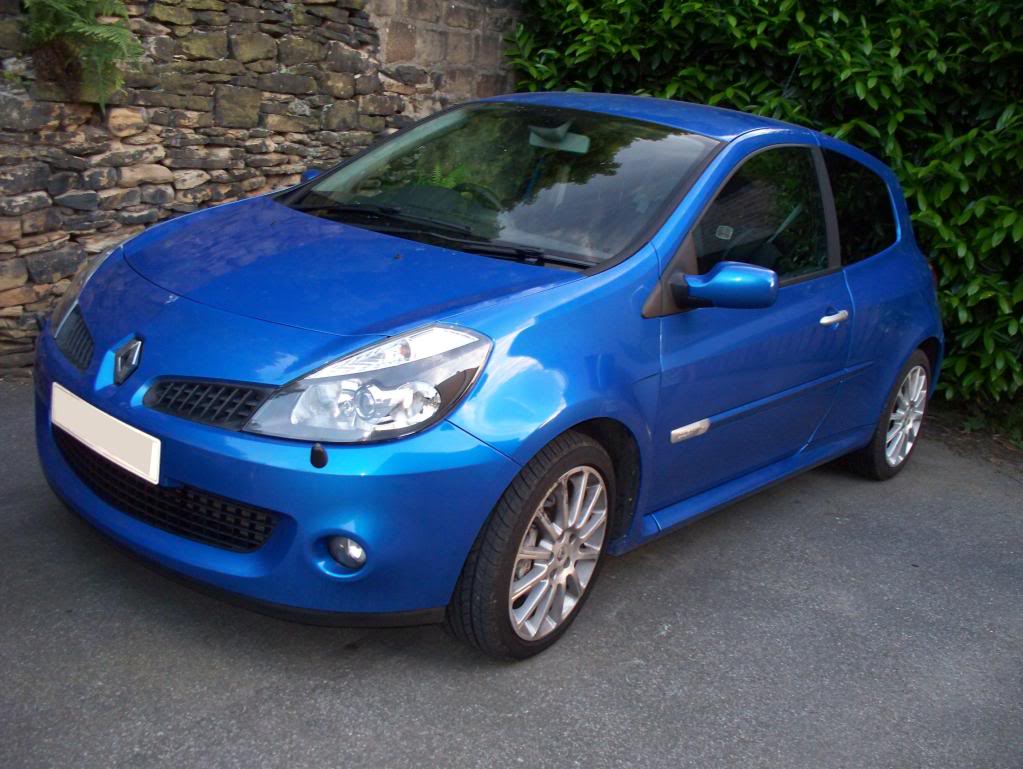

  • Fitted a set of used anthacite wheels, with Conti tyres, they are by no means perfect, but now I have a spare set, so I can get the others refurbished - just need to decide if I want them silver or anthracite; I liked the way the silver went with the trim, but the antracite wheels do look that bit more mean!
The car is a bit grubby at the moment, but I will try to get some pics when I have next given it a wash.

Received a bag for the spare wheel today, it is a touch big, but was quite cheap and looks quite tidy.
Very little room in the boot with the storage tray and the full size spare wheel;
Apologies for the rubbish pics, camera on my blackberry isn't that bad, except in low light.

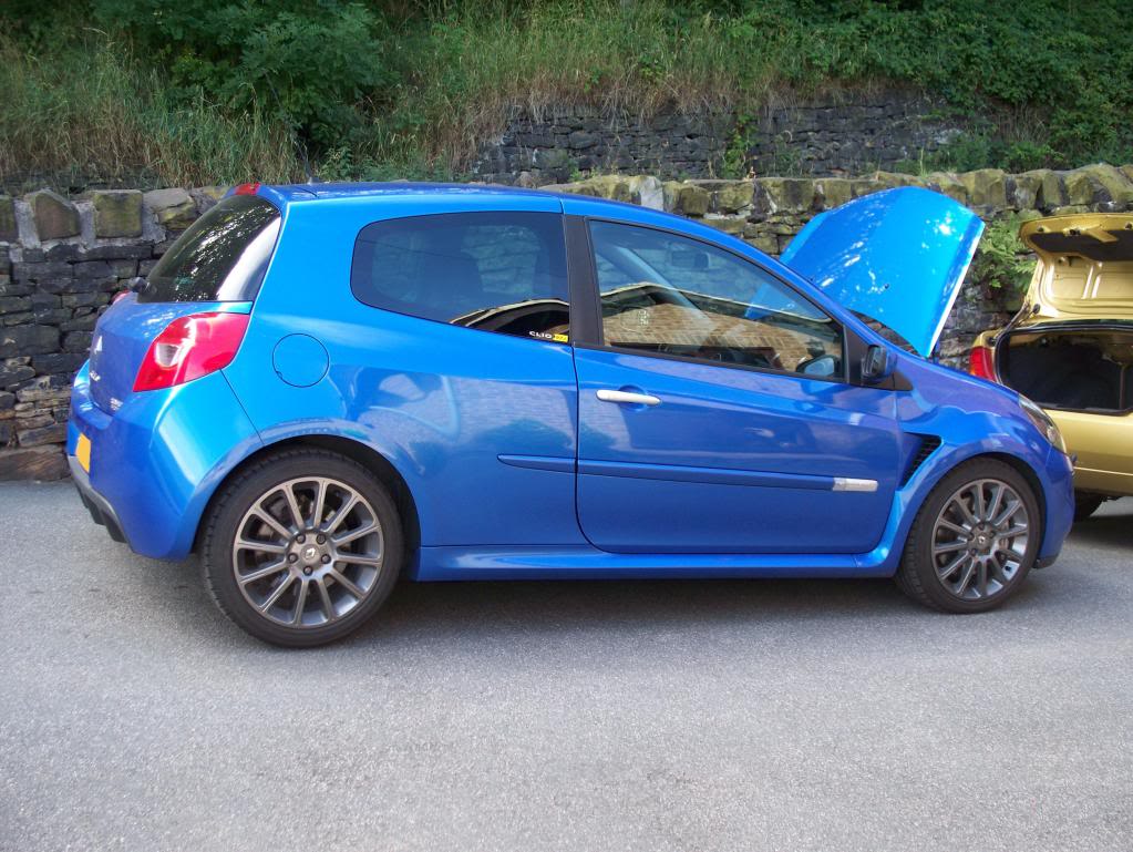

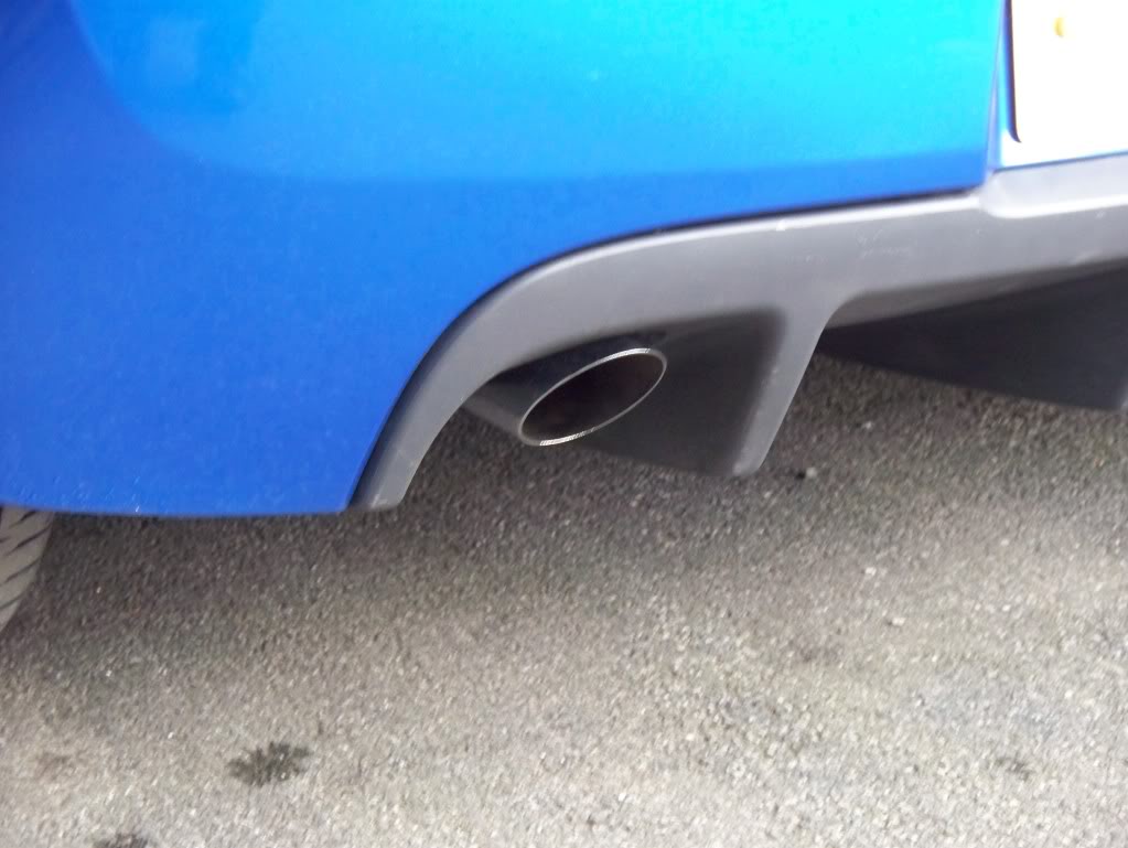

At a bit of a loose end on Saturday, so I decided to remove my diffuser and try to repair the clips; when I got the car, the diffuser wasn't level, and it appeared that some of the clips on one side might be broken.
Found the guide, removed the two torx screws, then proceeded to shear off one of the captive retaining bolts at the front, which then meant that I had to get the other one off two so I could actually remove the thing, so that one got sheared off too.
Removed the diffuser and found all of the clips at least partly intact, but many were folded down, suggesting that the previous effort to fit had been a bit half arsed. Cleaned up the diffuser and took the car to the garage this morning, where I also had some chromed slash cut tail pipe trims fitted.
I think I quite like them, but it would appear that the back box needs adjusting slightly to level them out, which I guess will have to wait until I am brave enough to remove the diffuser again. I wanted something to draw a bit of attention to the exhaust, but was reluctant to go for the RS trims as they aren't cheap, and some have suggested "wheel barrow handles", so I figured some slash cut trims would look ok.
Also this weekend it got it's first polish in my care, just a quickie with SRP, mostly just to get rid of tar spots, but it came up well. Also had another small dent removed that I had noticed last time it was on the lift.
Any comments or criticisms always welcomed, especially with regard to the exhaust.

  Z4M
Great effort with the thread, lots of detail!
I prefer the pipes being flush, if I'm being critical. The wheels however, trasform the car!
Nice work.
  Clio 197
Cheers, I know what you mean with the exhaust, I just wanted them to be a bit more noticable. Had these been the same profile as originals, that would have been ideal.
It's funny about the wheels, I am still not 101% convinced! I must be getting old, I really like silver wheels on a car, but that seems to be at odds with pretty much everyone else!
Gally
The wheels make the car now mate, the standard ones don't do the car any favours and i'm a silver wheel fan these days!
If it's half as sorted as that Puma it'll be one of the best.
Any more plans afoot?
