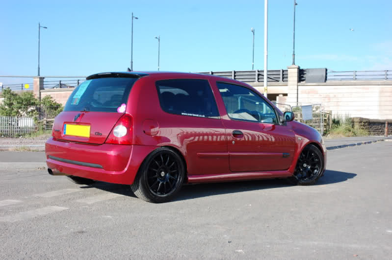

And even though i had a sun roof most people thought it was a real sport, you cant even get a 172 in the colour of my clio and still people thought it was for real ;)

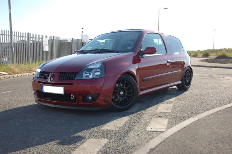

Just to give you an idea of the stance problem,
This is mine with RS arches, the same dynamique wheels as you had AND 25mm spacers:
As you can see they still look very lost, so pick some low offset wheels!
