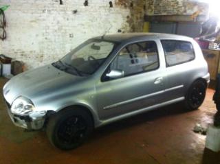

I've not long fitted mine , 2 fronts with 4 small holes and sliders and 2 rears. Had to spray a 2" black border round the rears just bit like standard glass but for the money compared to plastics4performance (they come already with border done) they are a bargain buy! Not the best of pics but kind of show them on my car.

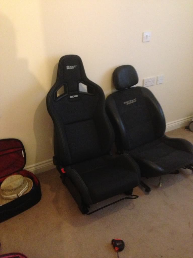

Getting car back 21st dec to fit new recaro seats and Polycarb windows front.

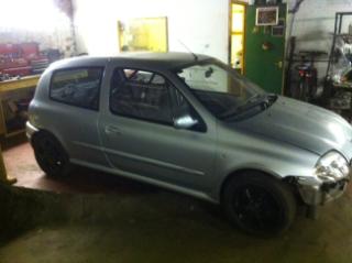

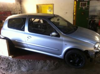

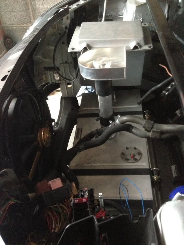

if this was the car i was looking at down at ktec beginning of this month it looks fantastic, alot of detail and engineering has gone into mounting the engine in the boot, hat of too ya bud for attempting it.
Will put pics on tomora .
some new bits done
front windows(with sliders )

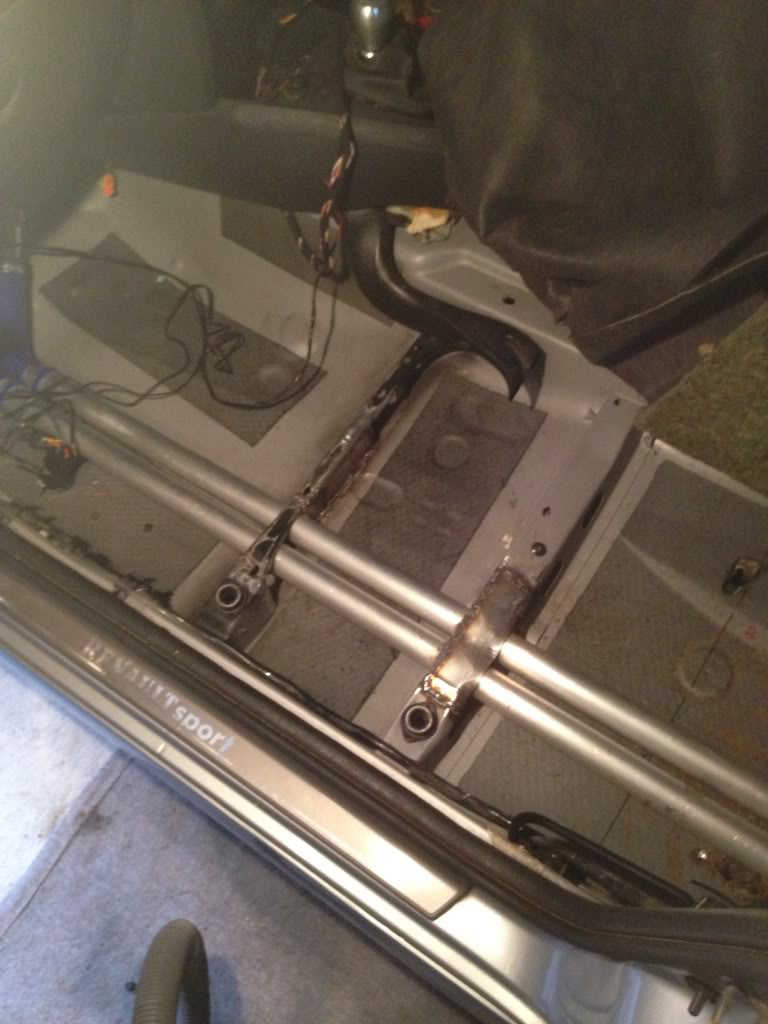

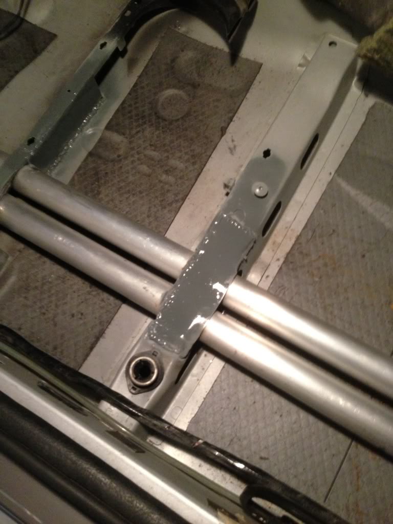

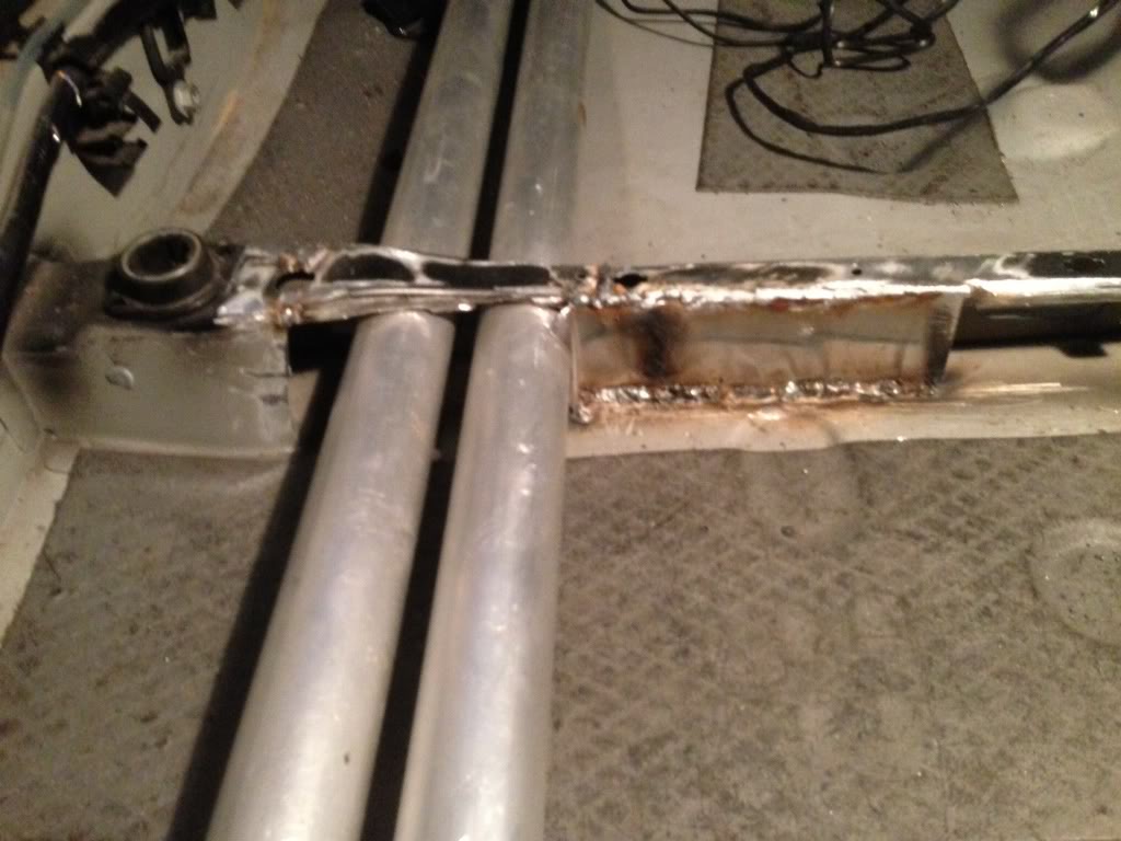

welding repair around water pipes.
