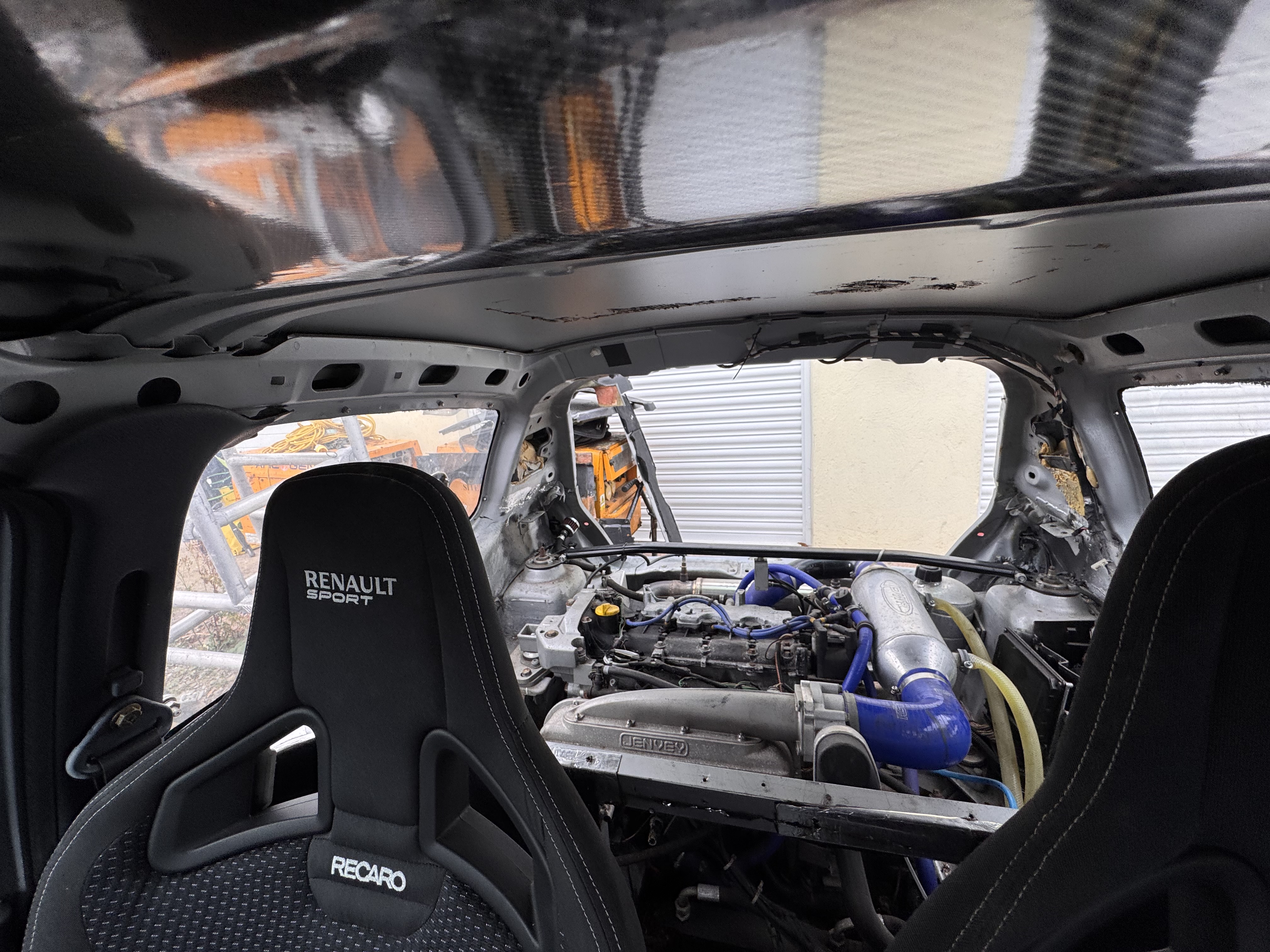

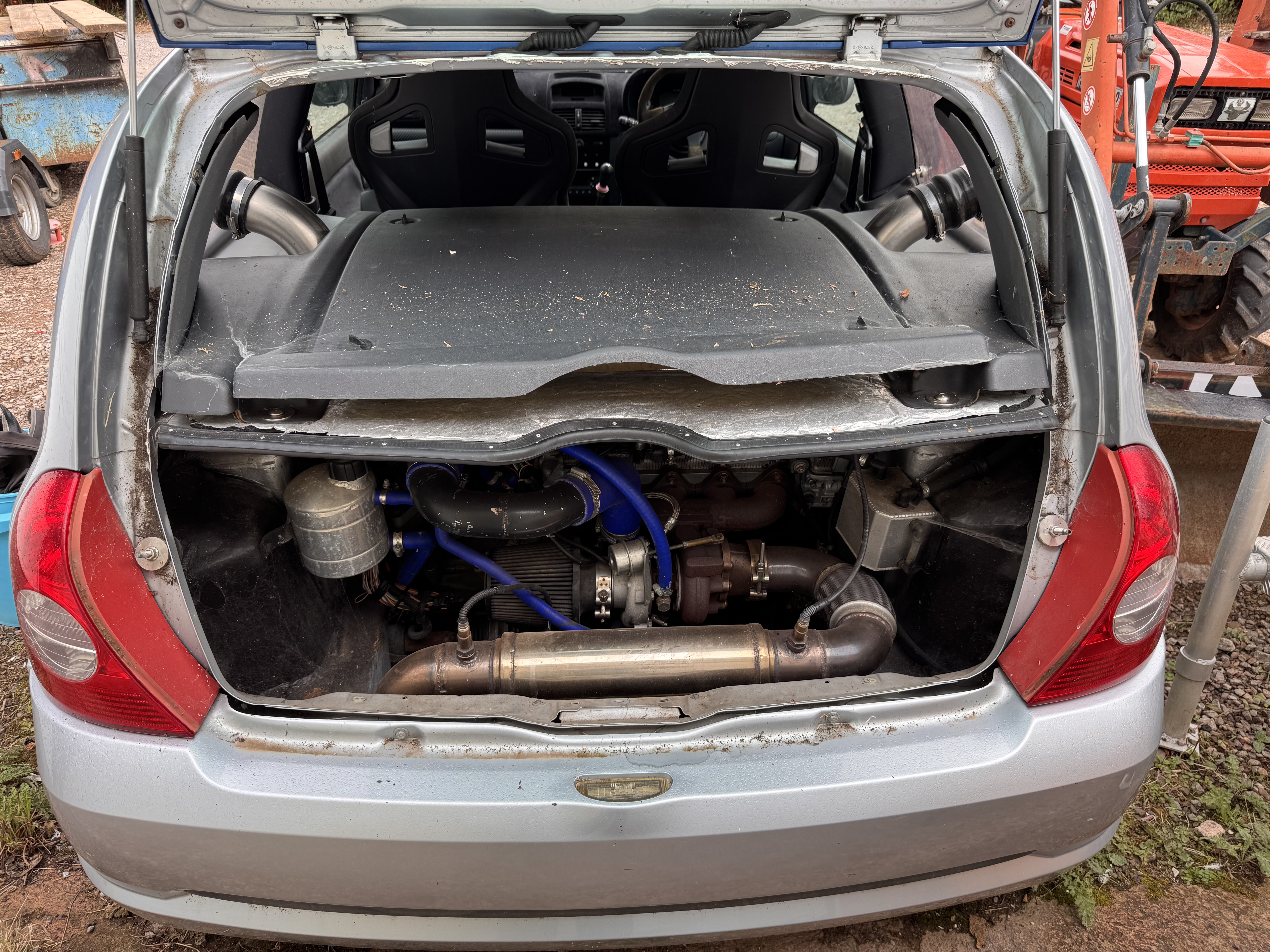

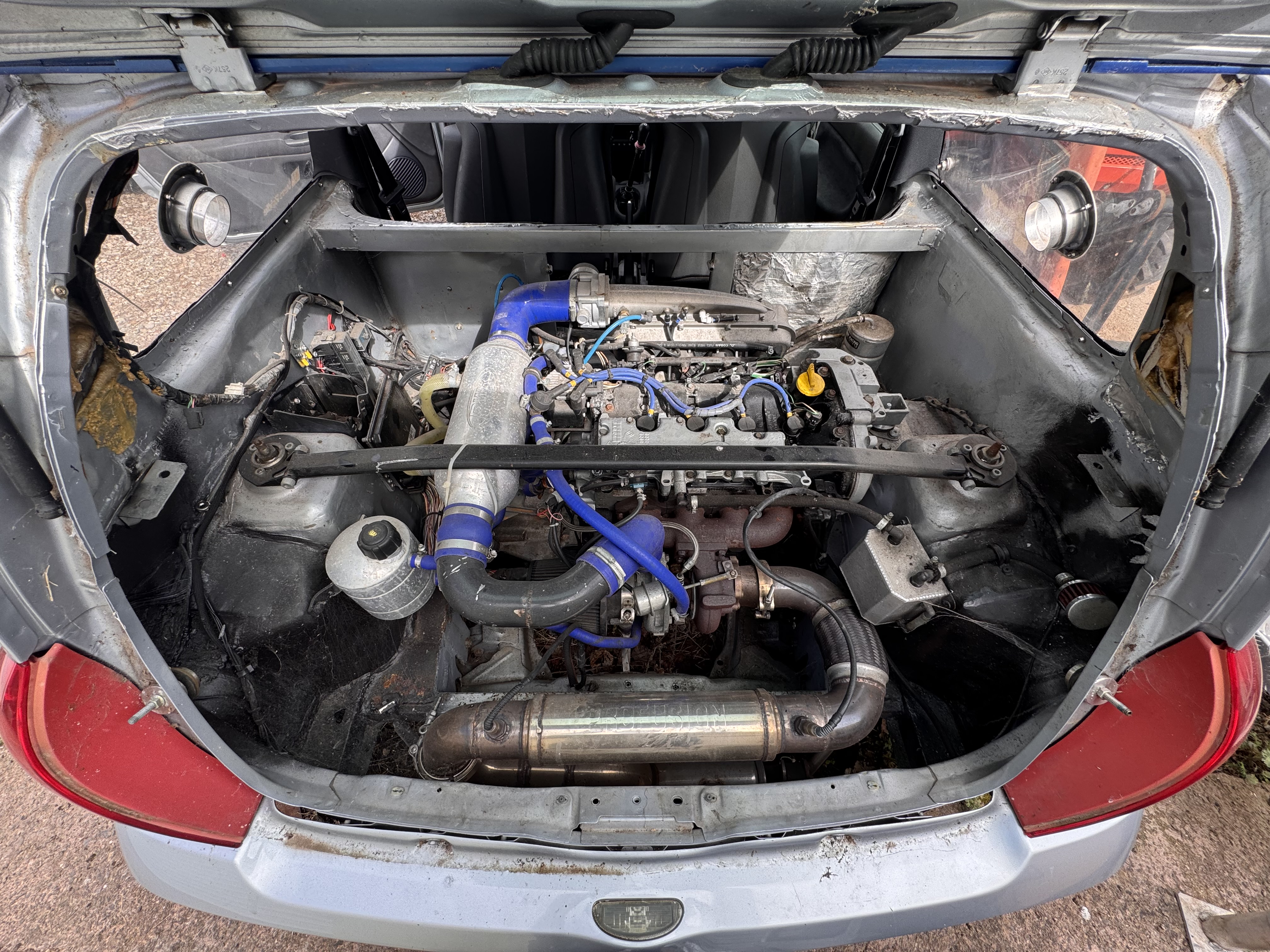

100% complete 172RWD! - updated

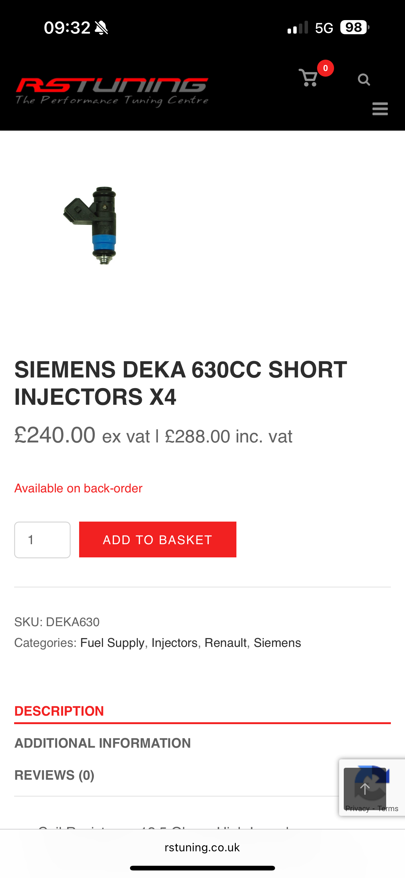

The EV14's are supposed to have a better spray pattern than the Deka's. A few years back Deka 630's were the go to, but equally they were so popular there were a bunch of shitty knock offs so you never really knew what you were buying.

I have had them since 2006!!!! Original bbpt engine dynamics turbo conversion
Kam racing had them in stock, I picked up a set the other week
Not sure how many left as I know they’re not benign made anymore
