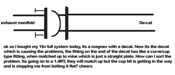

well got it, and got problems allready.
pic of my diagram, its annoying as fook.
ARRGHHHH
Cut the cup off (angle grinder or something) just an idea.. Glad you've done this before as i was gonna get a valver exhaust to put on my RT lol
got it fitted today down at my local garage, the zaust from cat back was fine fitted great, but they couldnt fit the decat due to the cup fitting... i am going to buy a new decat with a flat gasket and that should fit fine...

b****cks, just been out with it on... i absolutley covered the joins in gun gum, all over it, and its blowing again?!?!?!?!?!?!?! Could it be that my actual Cat is blowing?

the join is my magnex middle section, joined to the original cat, flat to flat!

did you clean the flange up? I use either the grinder ansd wire brush attachment or drill and wire brush attachement.
you uise new botls and nuts and tighten it properly and not like a girl?

yeah, cleaned it up before putting it back together. i think i will take it off again tommorow, as i want to cut some of the rear pipe down so it will sit further back...
will make sure bith contacts are clean and then re tighten up, yeah new bolts were used and never tightened like a girl, pain in the arse to do it though when i only have the car jacked up, neck ache.
