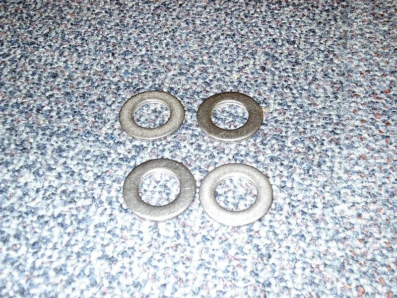

Got mine back today when i got home from work made out of stainless will be puting them on tommorow nice job that laser does
i assume acrylic is too soft? Does it have to be metal - is there are fair amount of stress on it?
I only ask as i can get some acrylic done for nowt :)
I would say it would be to soft not sure of the load it will be taking i got mine free in stainless you need to know someone in the sheet metal business with a laser i evan got 4

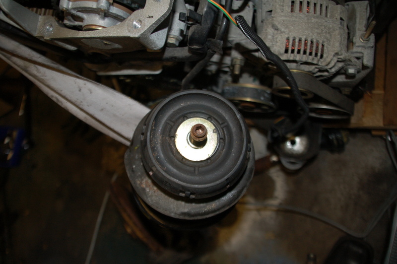

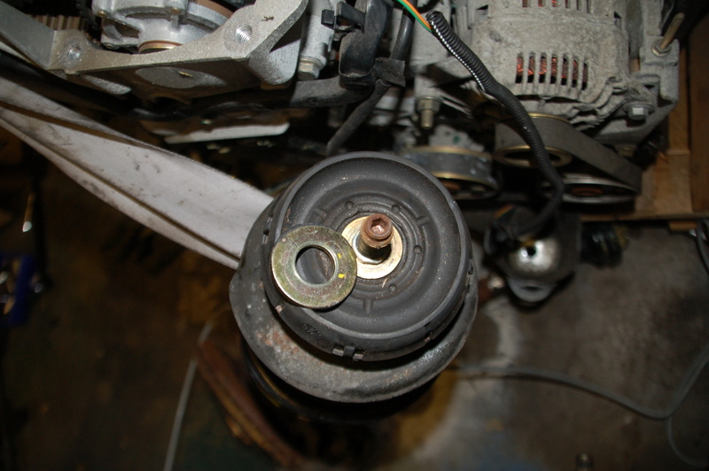

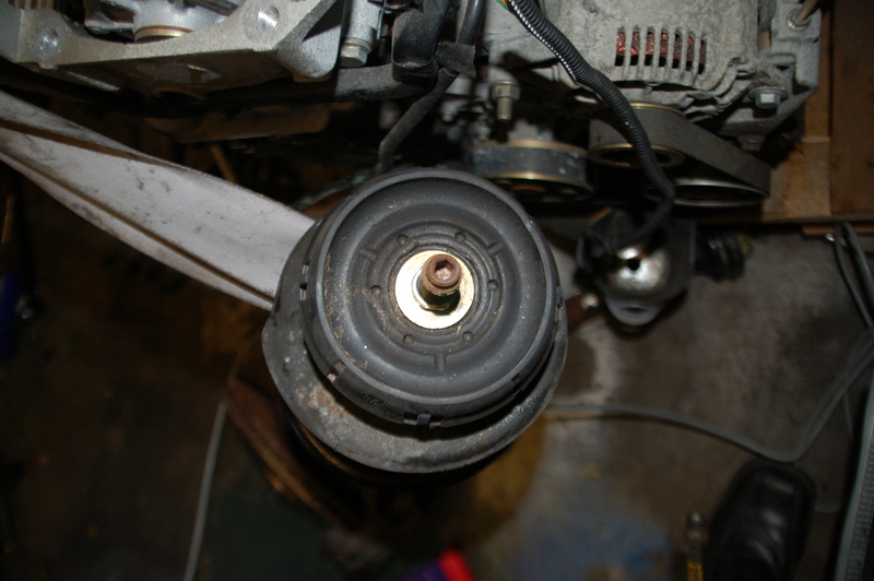

some pics
before
spacer
spacer fitted

Do you think these will do the job??
SS 34mm x 19mm x 3mm

i see, thanks for the photos fred, i got some of them washers ini the garage will fit them over the weekend and see if it works

Mine seemed to work had a little drive around on the weekend to see if they work trying the turns that it happened without them it sounded OK

Just incase anyone is unsure how they work or how to fit them see the following -
Thanks to Justin for the washers - Credit where its due :)
Measurements -

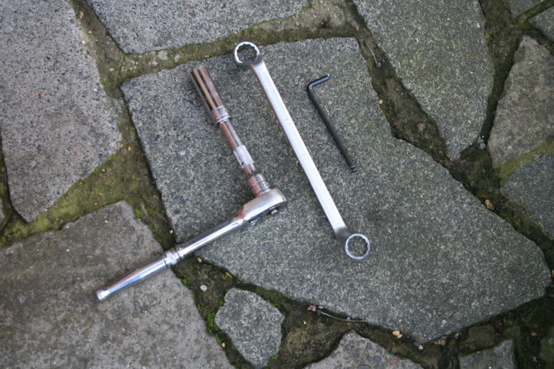

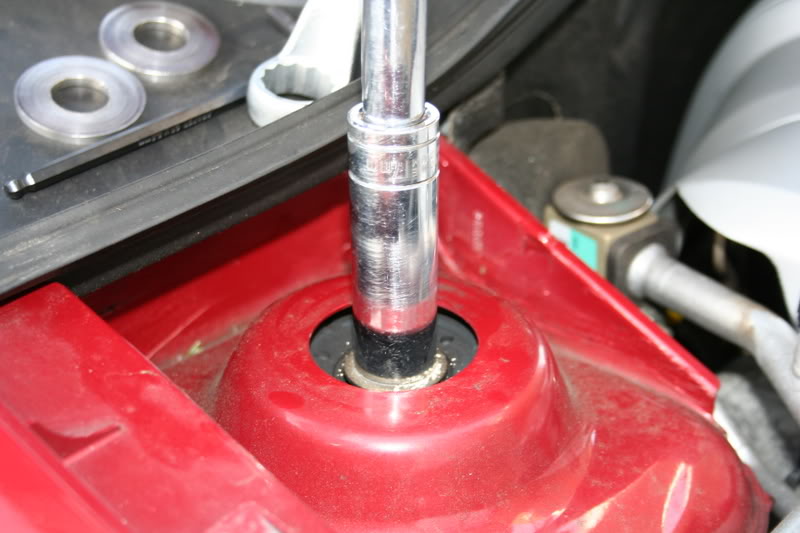

Tools you will need for this -
5.5mm Allen key
21mm Deep Ring Spanner
Rachet with 17mm Deep Socket.
So in pictures.
Tools all lined up ready to go.

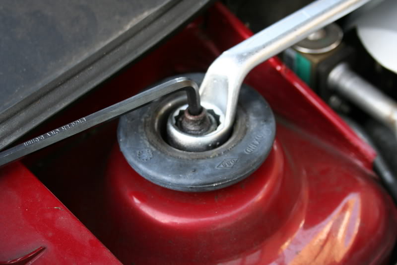

Need to undo the top nut - The Allen key is vital here - So do not attempt without it.

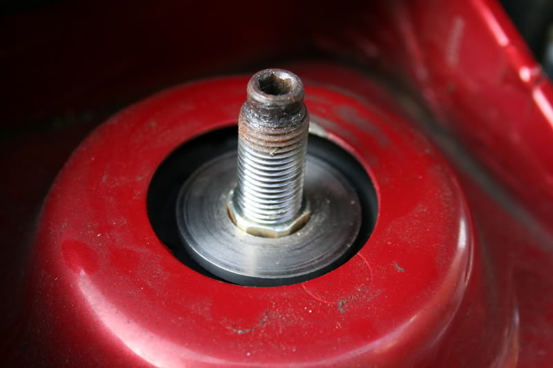

17mm Compression nut needs to be undone -

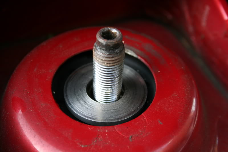

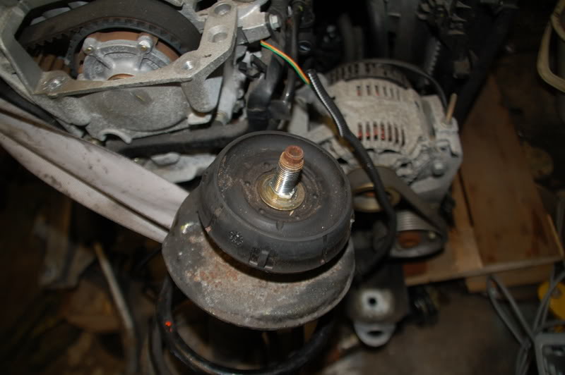

Put Washer in place.

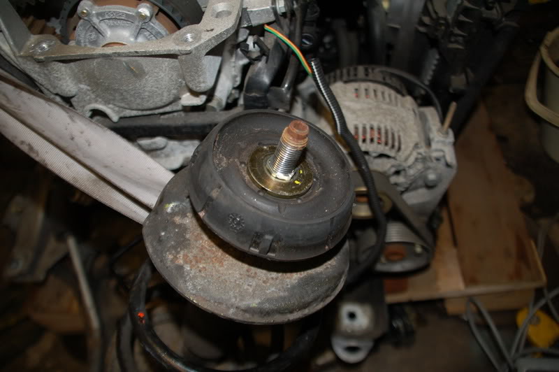

Do the 17mm nut back up again - This is how it should look.

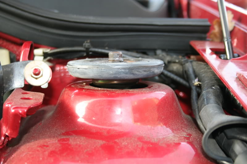

Put the rubber doughnut thing back on again as well - The 3mm Washer clears the doughnut off the turret as seen above.

why did u undo the 17mm compression nut, ??? also its a 6mm allen key we dont want no stripped heads
Because the size of the internal diameter wouldn't just fit with pushing it on top - it kept going at an angle - So by quickly undoing it and redoing it up again it fits perfectly.
I was using a 5.5mm And it fitted fine - A 6mm was to big.
oh rite mine just fitted over the compression nut, didnt know yours was tight, so is ur compression nut sitting on the washer ? mine was a 6mm lol as fred said befour lol

the compression nut still sits in the middle - But when I tried putting it on over the top it just caught the edge, I undone it and put the washer down and then done it back up and its fine (You can see it in the picture). May just be my struts but a 6mm was to big and the 5.5 fitted fine (You can see that in the pictures as well :))
Anyways its only a rough guide to show people as there have been a few questions about it.

That looks proper ropey with the top nut floating around above the bodywork, under track conditions is this not gonna cause play in the strut tops - looks dodge!
Gal
  A Clee O
Well I thought I should show you that as well considering like you say it does raise it up above the bodywork - Personally I have no idea - But it does stop the knocking - Personally I will be taking everything back off when coilovers go on.
