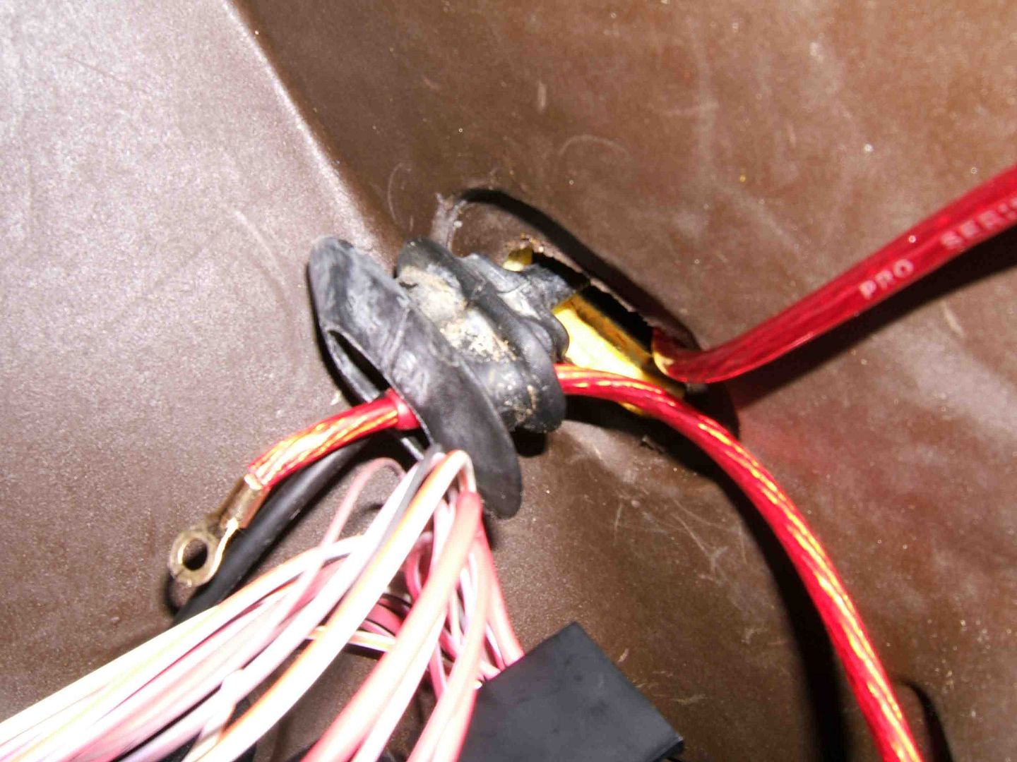

http://i26.photobucket.com/albums/c124/brasseye_1970/grom.jpg
I found it was easier to remove the gromit behind the glove box (gromit is for cable release on bonnet) then use wire cutters to cut the engine side of the gromit ,just below the hard wire casing of the cable release,then push the cable thru and replace the gromit.

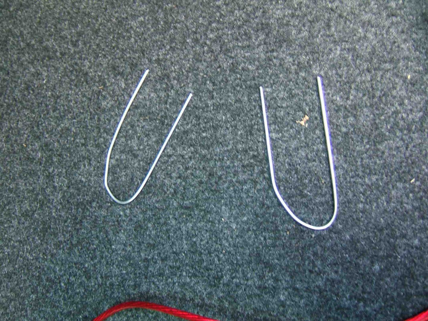

found these bits of coat hangers ok to remove the cd player in dash

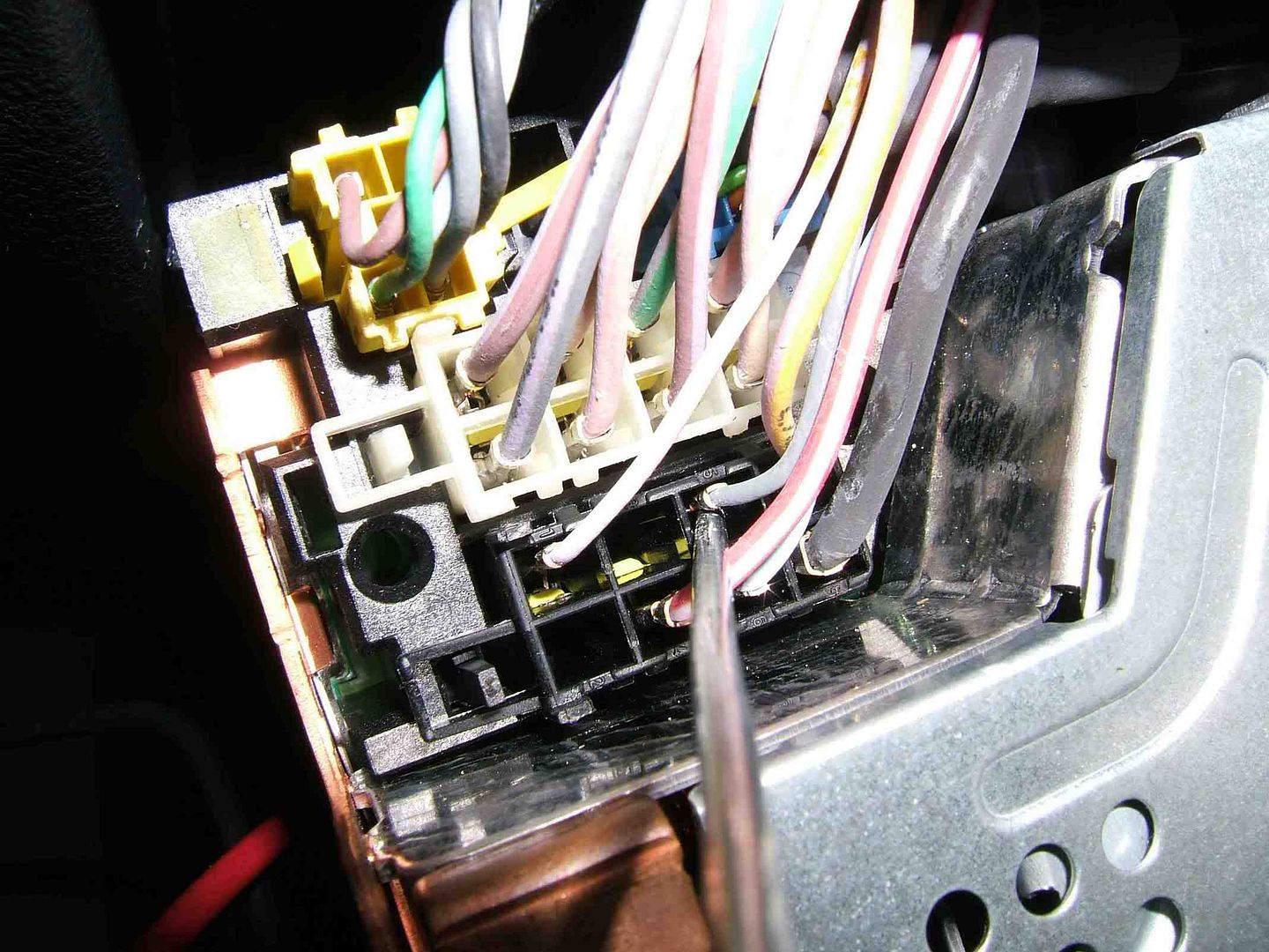

http://i26.photobucket.com/albums/c124/brasseye_1970/remote.jpg
Right then ,the GREY wire shown here next to the metal probe is the switched live on my renault standard cd player this is going to my amps remote switch line via a half amp fuse.I didnt cut this wire just used a "scotch lock" connector.

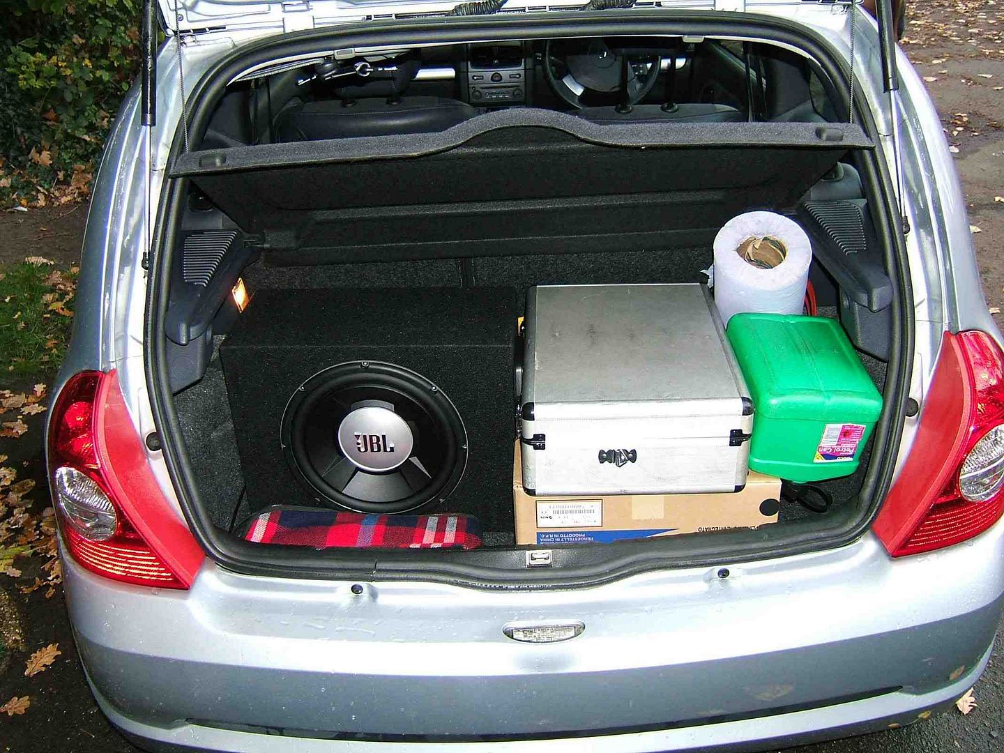

http://i26.photobucket.com/albums/c124/brasseye_1970/bootfull.jpg
here it all is tucked in....
Not bad for a cheap sub....
could you cut the wire to use as the remote line? please bear in mind im using a JVC headunit with these cables....
If you run an amp of the standard h/u you need an rca adapter.
Did you have to lose a set of speakers?
