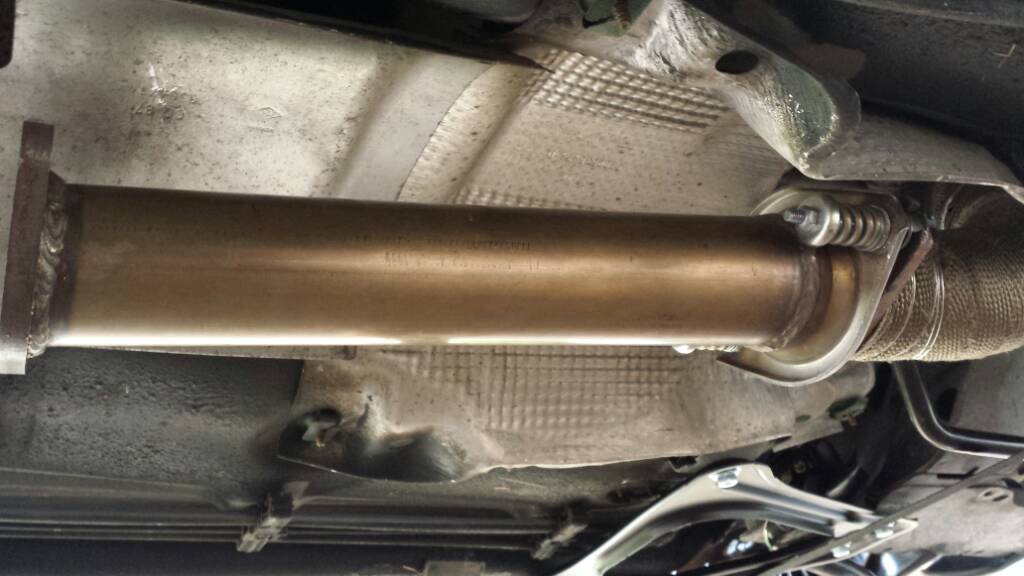

Fitted a cat yesterday to replace decat, nice an easy on your back on the drive....
Started car up all is fine, drive off the drive and up road and still, all is fine. When I put my foot down and u dear some load it's blowing like f**k from that joint.
What have I missed or done wrong?
Fixings go. Bolt > Cupped bolt seat > manifold > cat > spring > washer/cup > bolt.

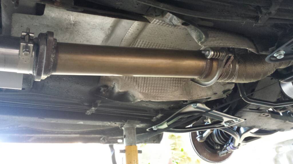

Should go like this dan.
  SQ5
That's a 182 one, looks exactly like that join though just further up, I just put everything back on that came off
Mr R.
  A special one.
Yeah it is mate, makes no difference though.
The order of parts stays the same dan.

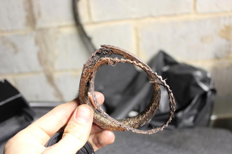

Of course I didn't! Ha! But the old one never blew with the same bits.
The nuts got as far as they could on the bolts.
Mr R.
  A special one.
Id say that's going to be your problem.
The old one has spent years in one position and the 2 part's have worn in together.
You have now taken it to bit's and fitted a cat that doesn't mate with the old gasket.
Motorspares sell them apparently.
I re-use kits lol, last one the washer had broke down & that was the cause!
If your struggling I'll come help you fit a new one if you get one, I don't have any spares now!
Mr R.
  A special one.
You could try taking it off and cleaning up the mating face of the cat and fit it back.
Thing is though that it's not the best job to do.
Id rather take it off and fit a new kit.
