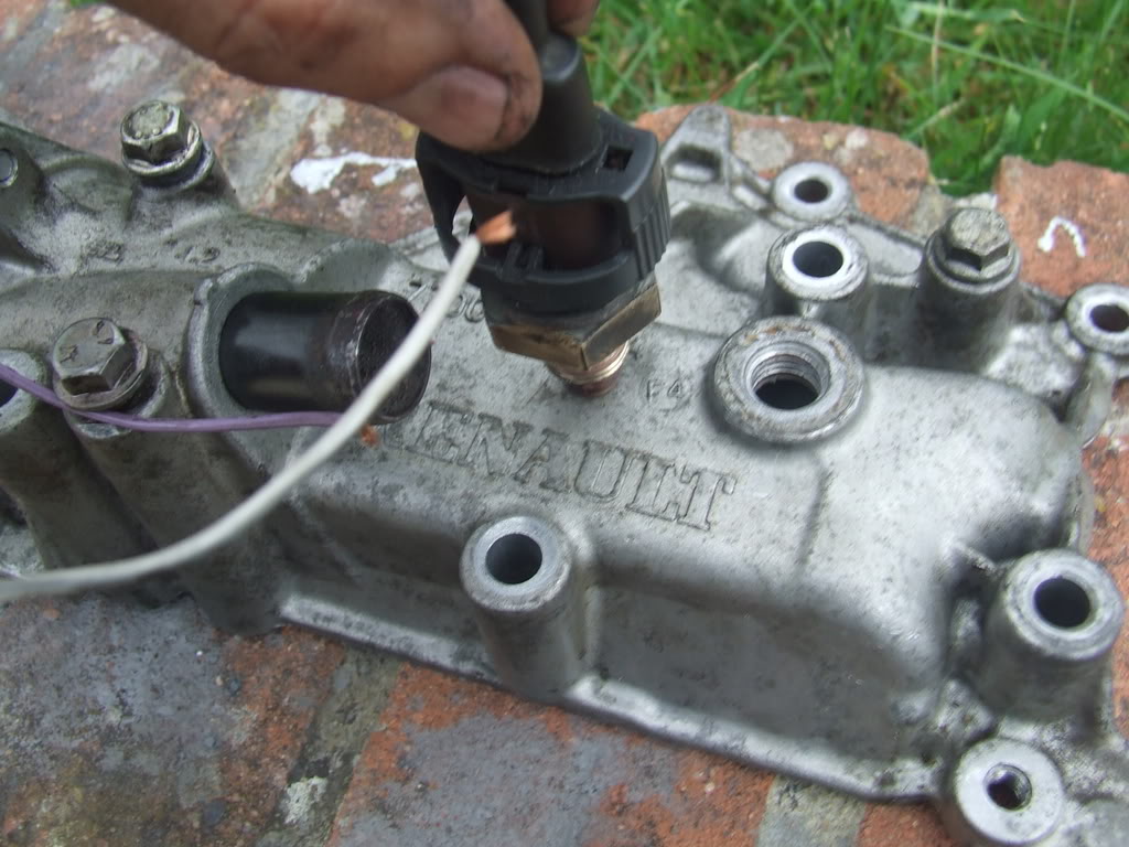

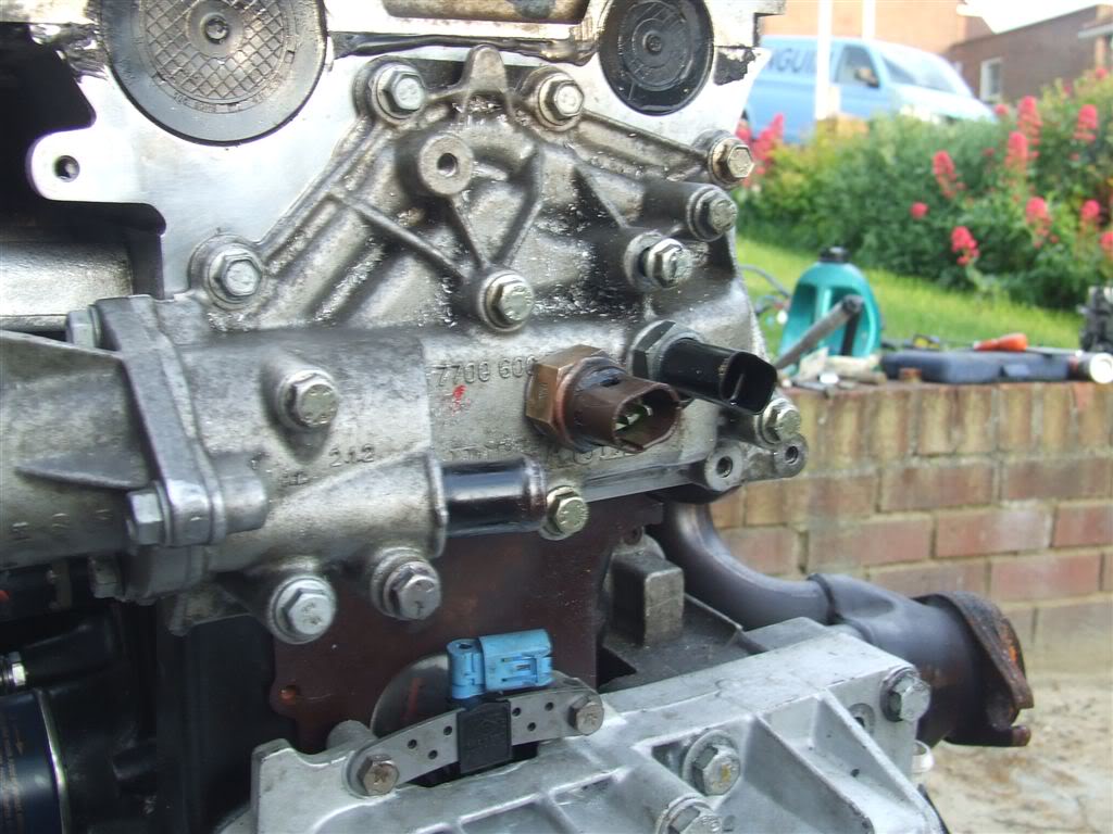

have a read through mine and f0xys thread for the temp gauge solution. we plumbed in the mk1 clio dash temp sensor in addition to the 172 item.. i presume you can do the same with the 5.
the 172 rad fan should work properly provided you have the relays in place still as well as connecting up the speed sensor and 172 coolant temp sensor to the ecu... atleast mine does anyway :D

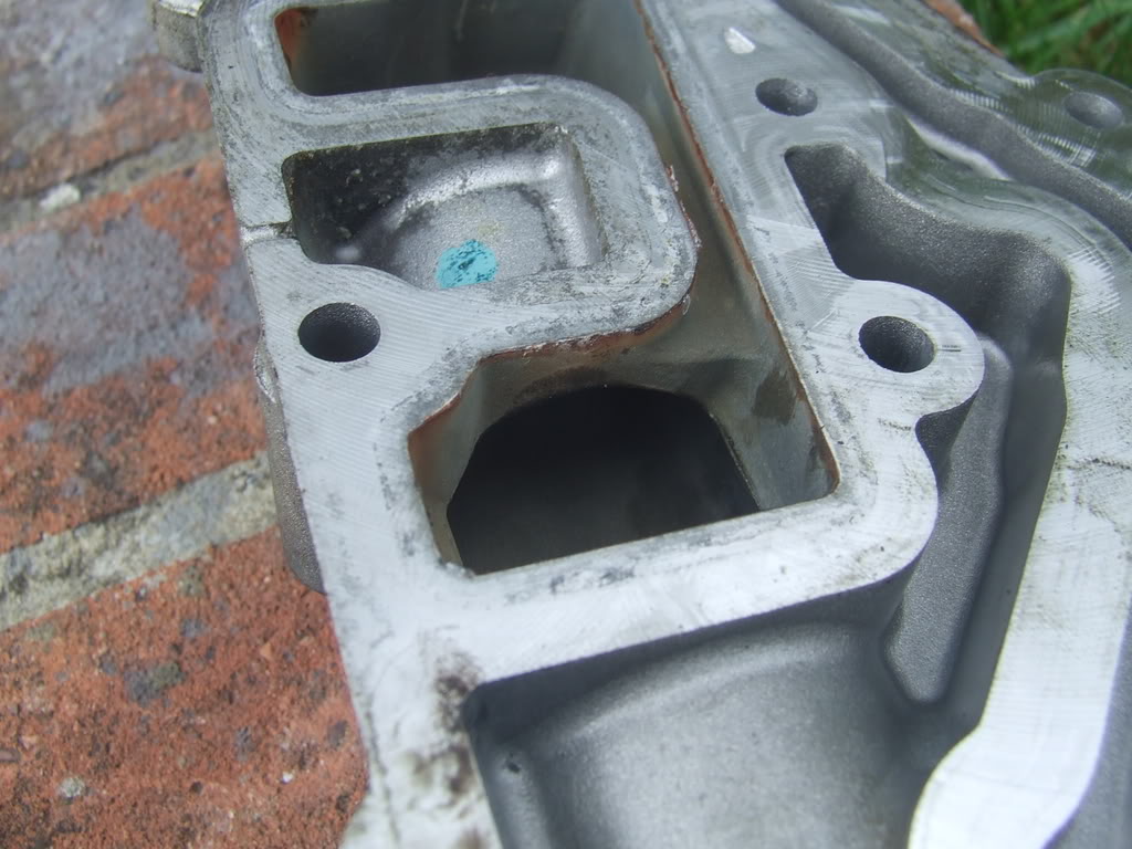

mk1 coolant temp sensor into mk2 thermostat housing
drill through the housing and slot the sensor in. then secure it from behind with a suitable thin nut. also worthwhile using some sealing washers and silicone to stop it leaking :) - mines been fine up till now. careful with your placement as you will need to leave room for the coolant hose
the mk1 clio sensor has 2 pins, one for the warning light and one for the gauge. just hooked them up as they originally were!
the mk1 used an additional sensor for the ecu...
Cheers for that I was going to do the same thing but use my orginal GTT temp sender again this is a 2 wire connection and i still have the original connection in place so just be a case of drill and tapping and then extending the cable to get it fit.
