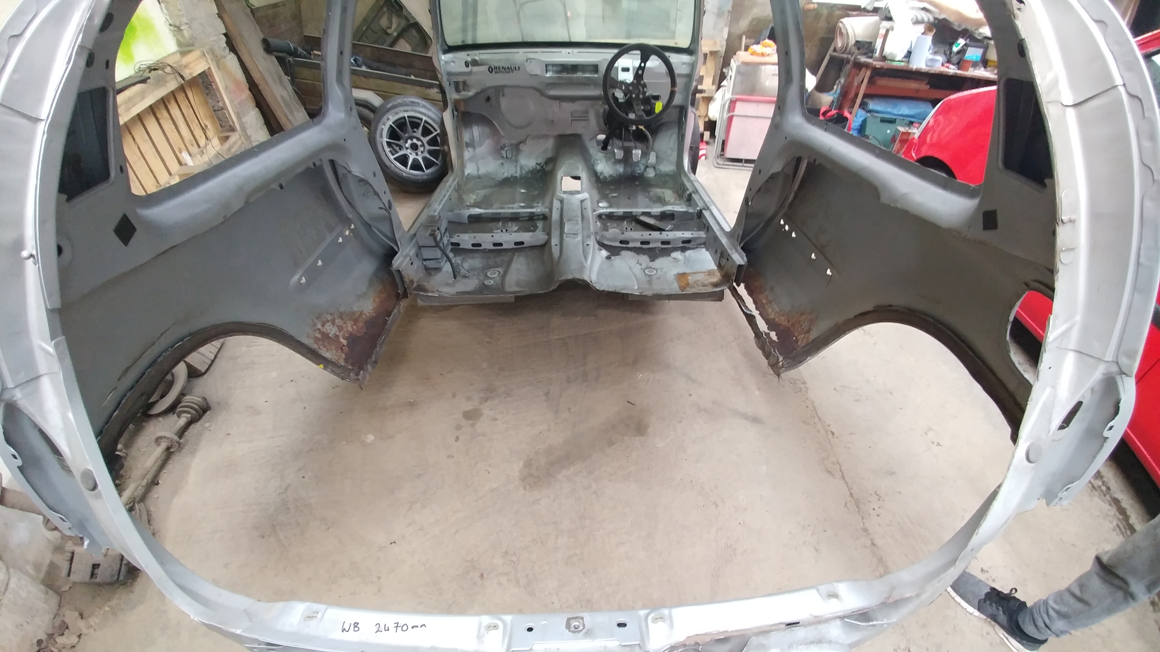

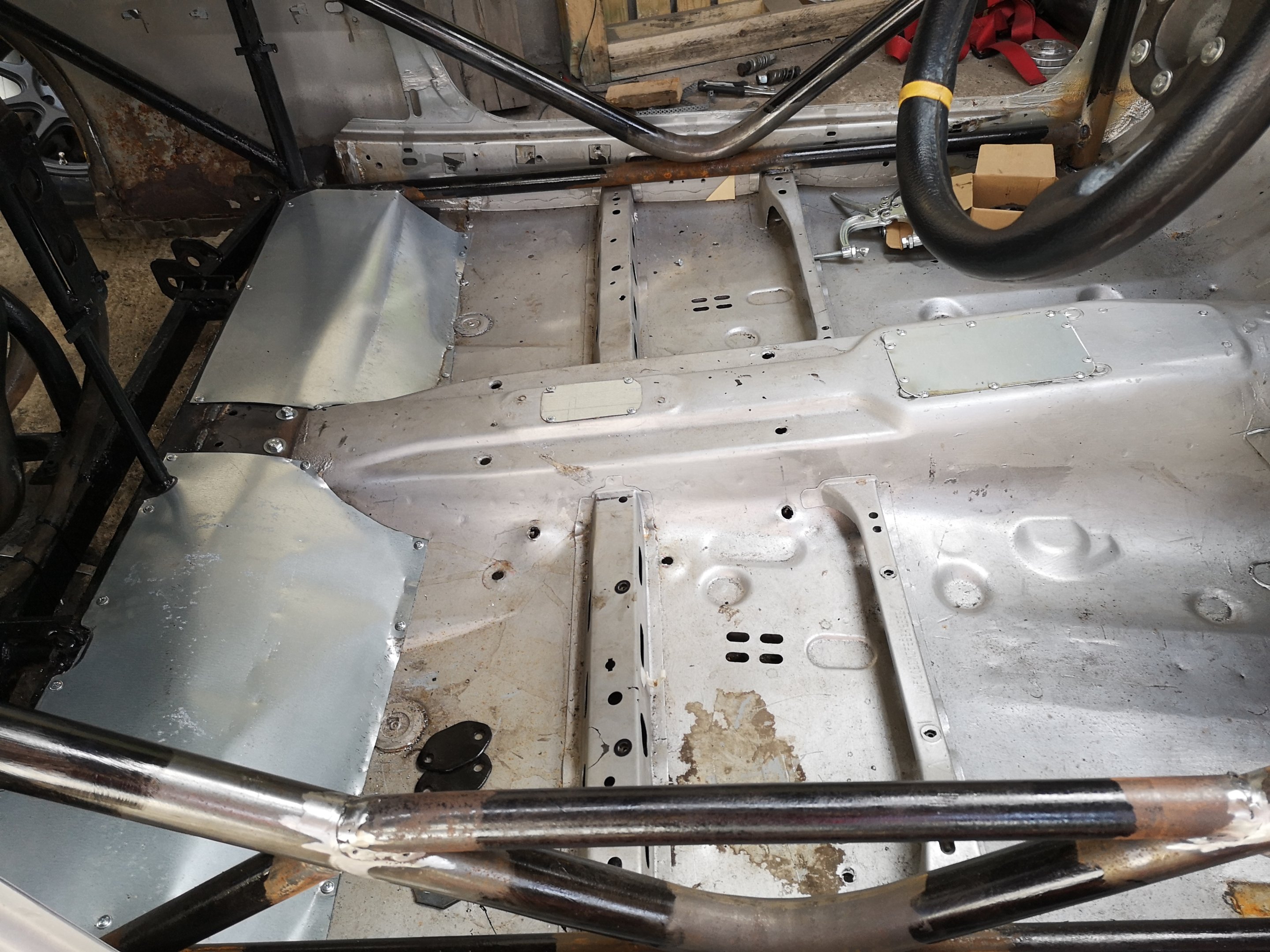

Cheers bud, have a fairly blank canvas to play with....
