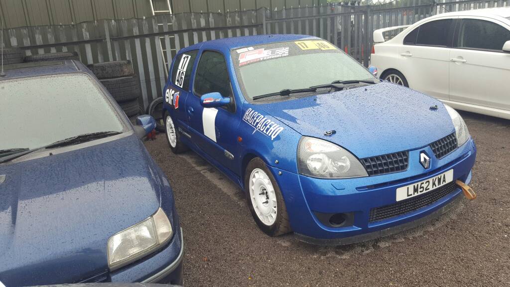

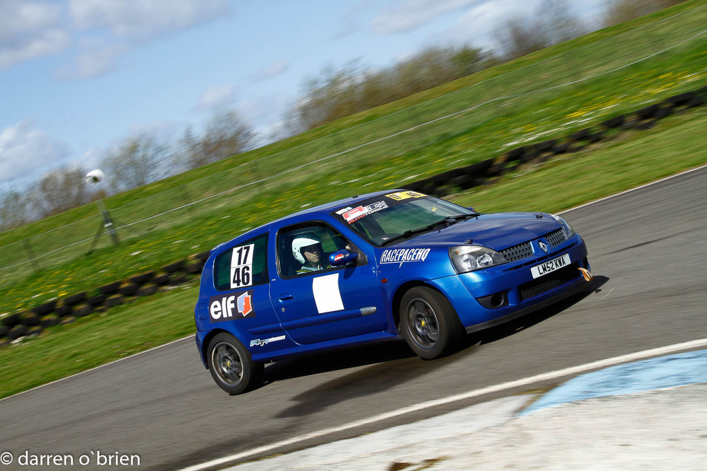

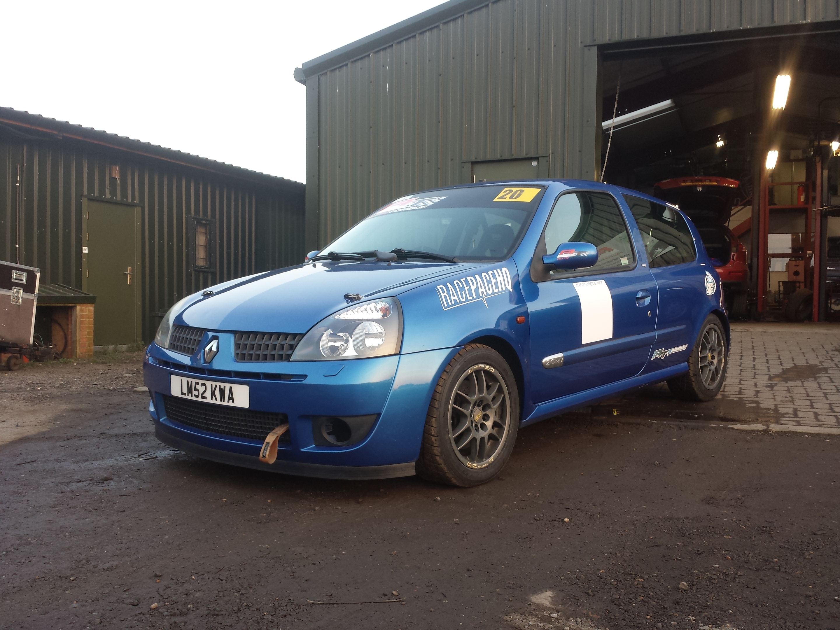

I thought I would share some photos of my car with you all. As I'm finally pleased with how it's come together.
Had this Cup four years and taken her out 5 times! Going out tomorrow to Pembrey for an MLR Sprint, so looking forward to that.

Car felt great. First dry outing on the new setup with Bilsteins, camber and PMS shifter. Felt like a different car.
I personally struggled to find time during the day after a good start. My mate was sharing the car with me and he got quicker and quicker.
Great events and very cheap to enter.

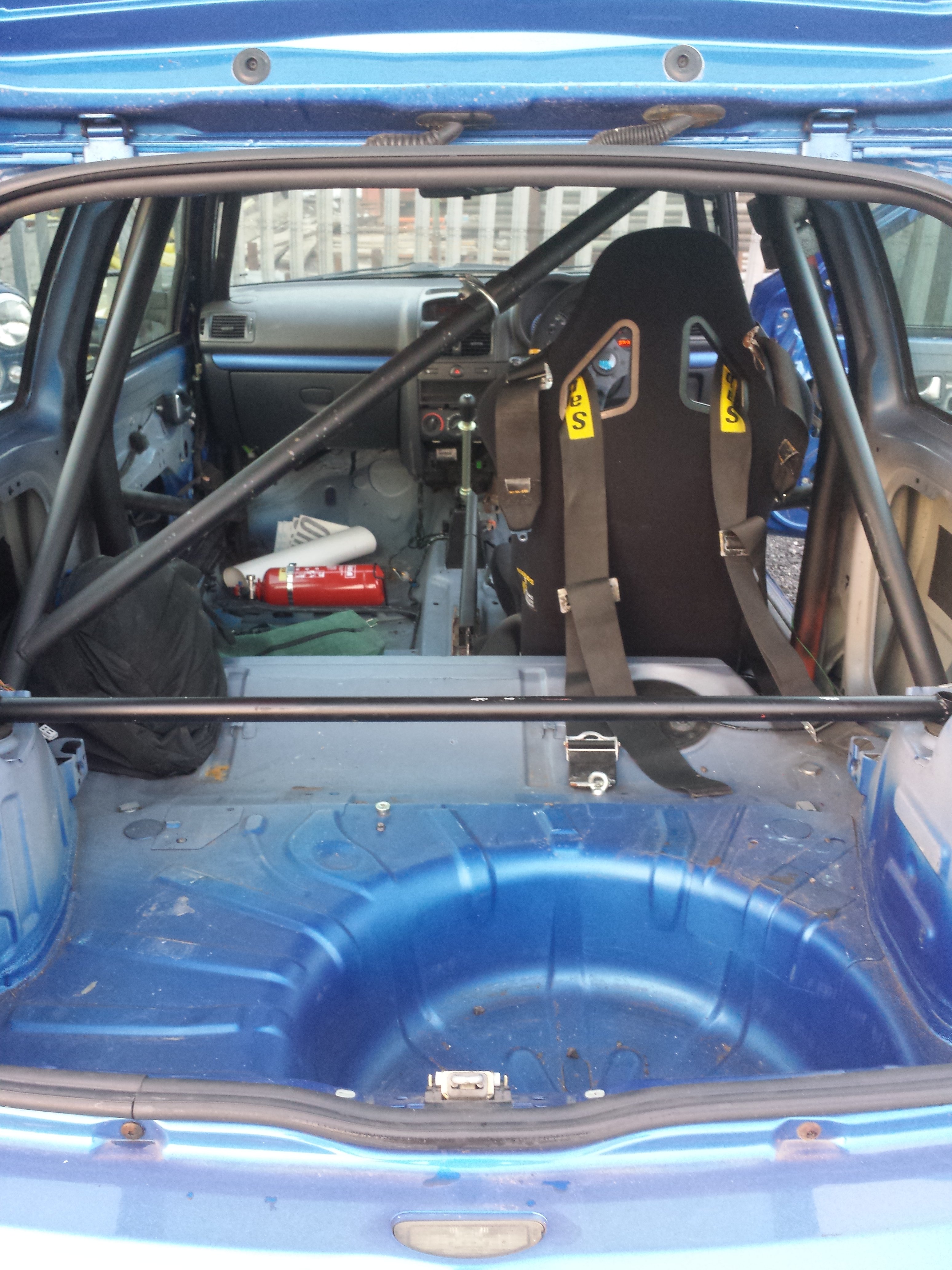

Guessing you might be in modified prod class unless you put the seats and interior trim back in?

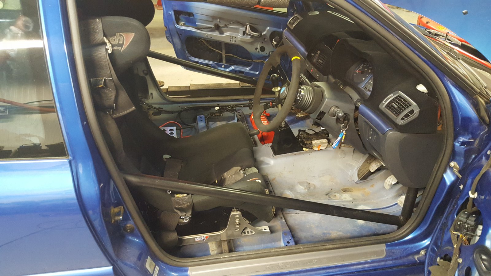

I bought the car standard in 2011 and have carried out the following modifications;
Bilstein Coilovers with solid top mounts
Camber Bolts -2.25 1.5mm toe out (please advise if I should try an alternative)
Strut brace front and rear
DS2500 front pads, braided lines and drilled discs
BMC CDA air filter
K tec manifold back exhaust with carbon trim in bumper
Ktec engine mounts and Powerflex Dogbone
PMS Shifter kit
PMS Stud kit
OMP Seat and Sabelt harness, welded seat rails
6 point cage fully welded (was a sparco or OMP from memory)
15 x 7 OZ F1's with Toyo R1R
Fabricated Oil catch tank
Ali Bonnet pins

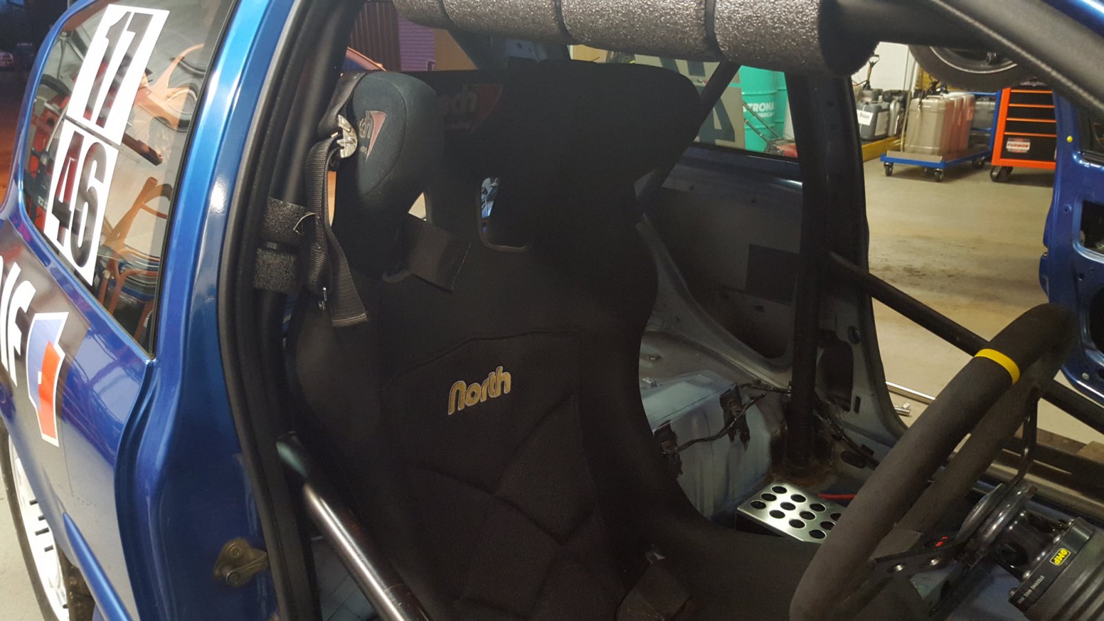

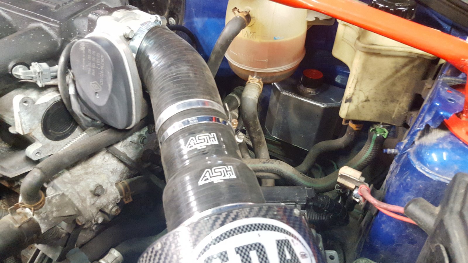

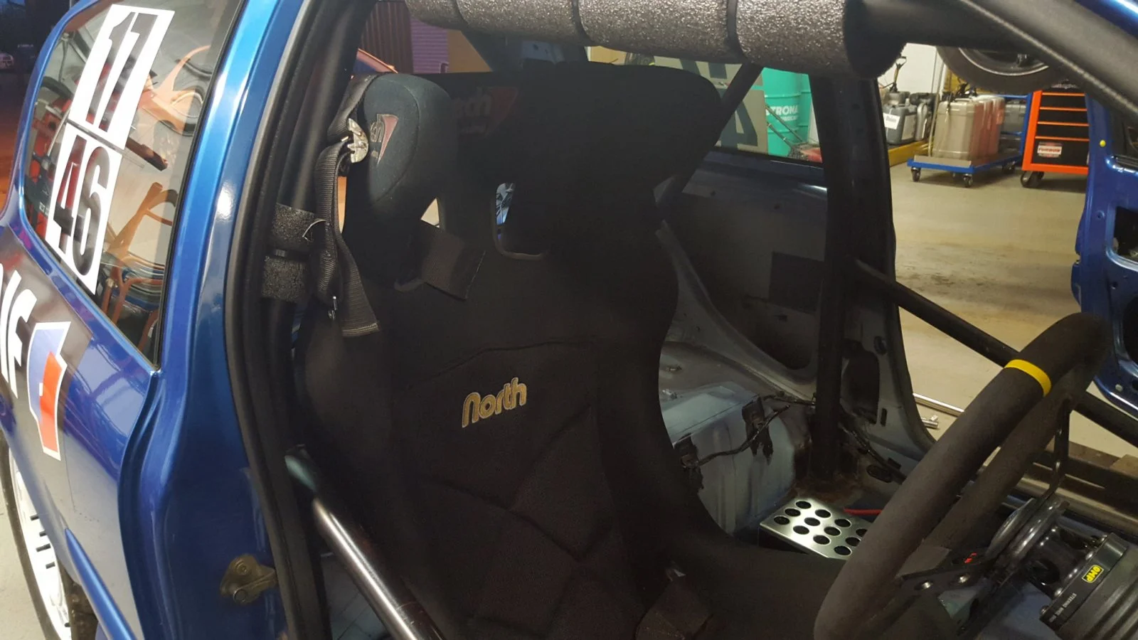

Just renewing my membership and thought I would add the latest additions to the car:
A-tech North drivers seat
Flocked Dash
Air intake relocated behind headlight
Battery moved to boot
Clio Turbines
I'll upload some pics when I can.

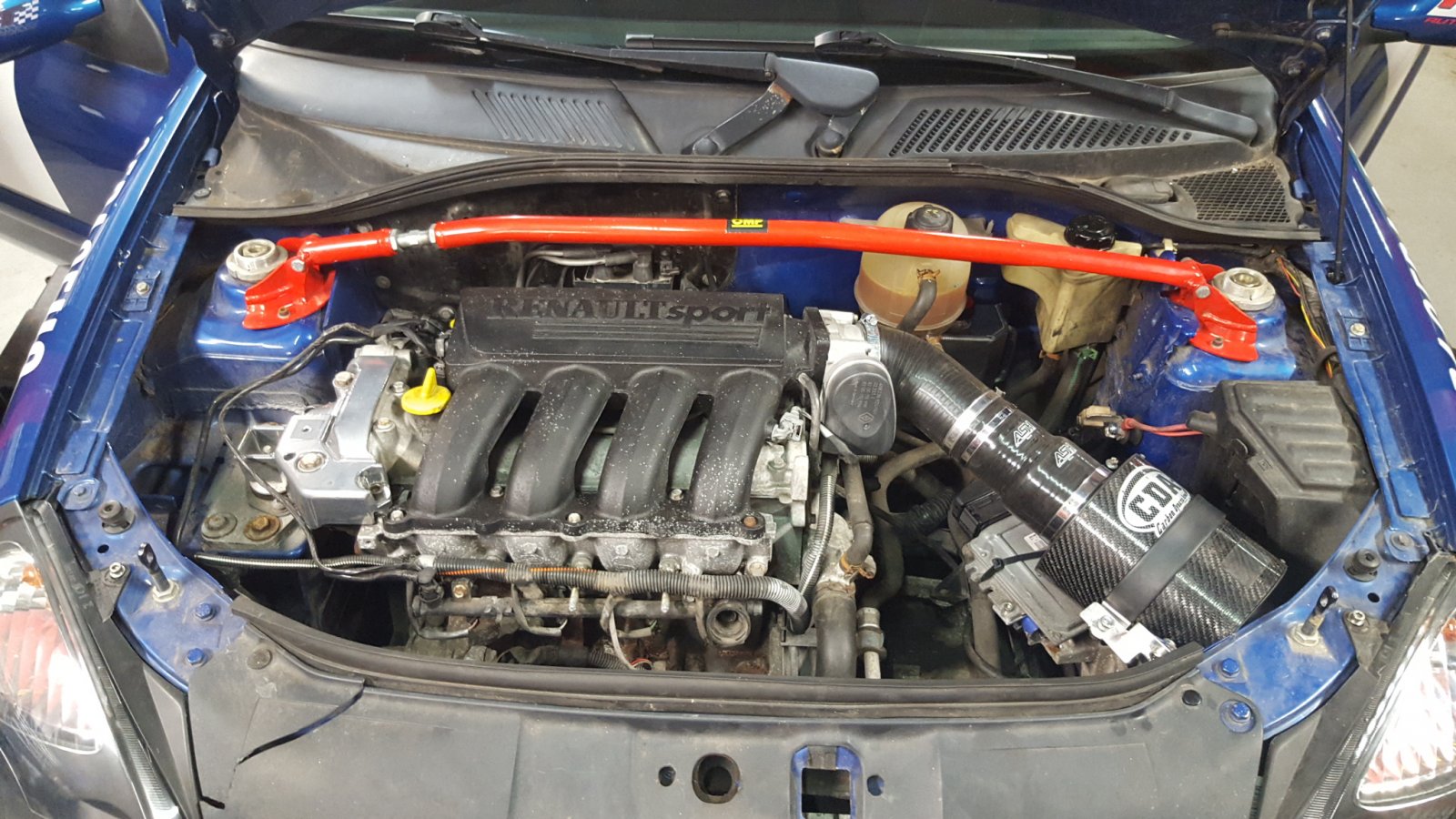

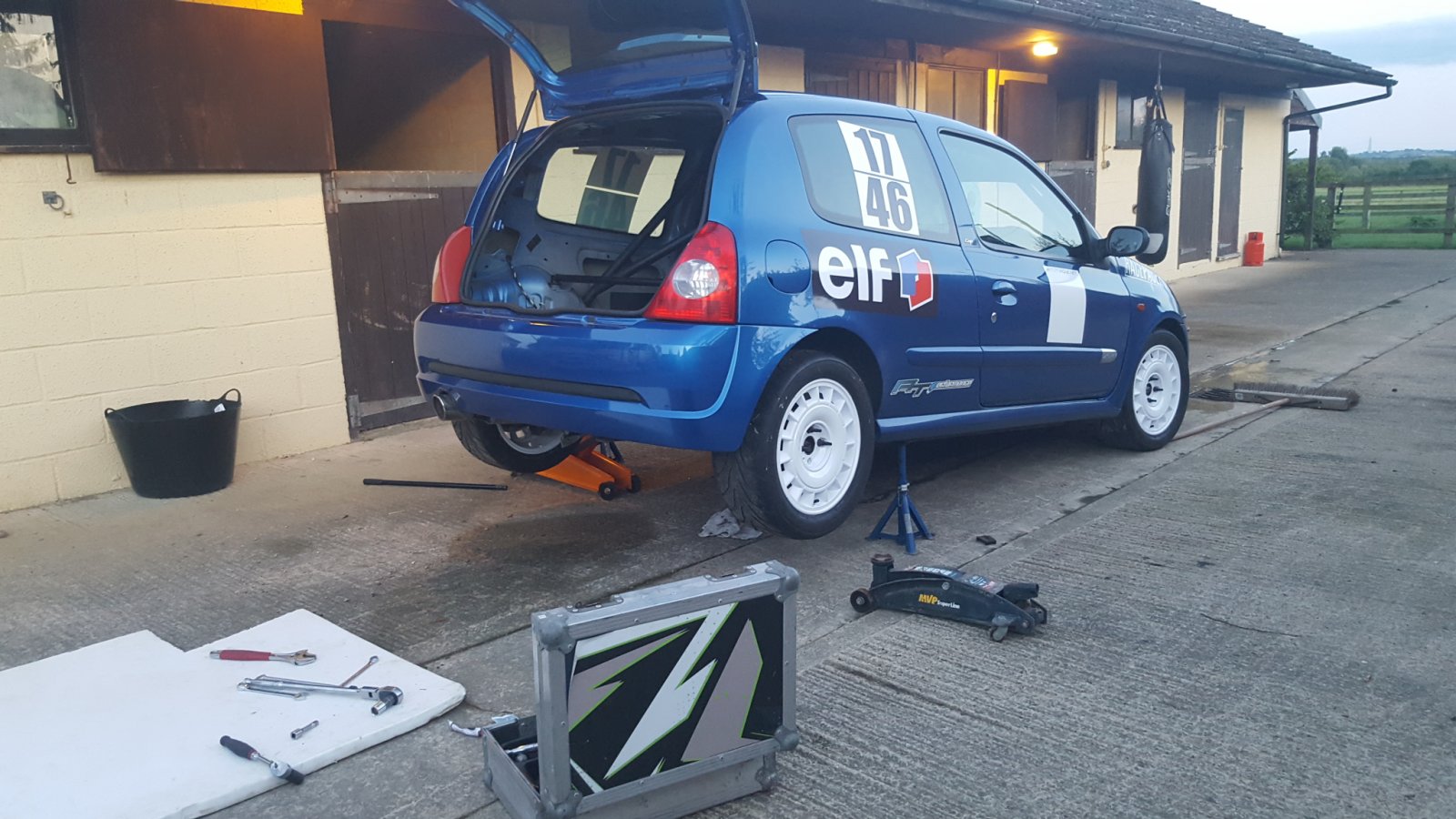

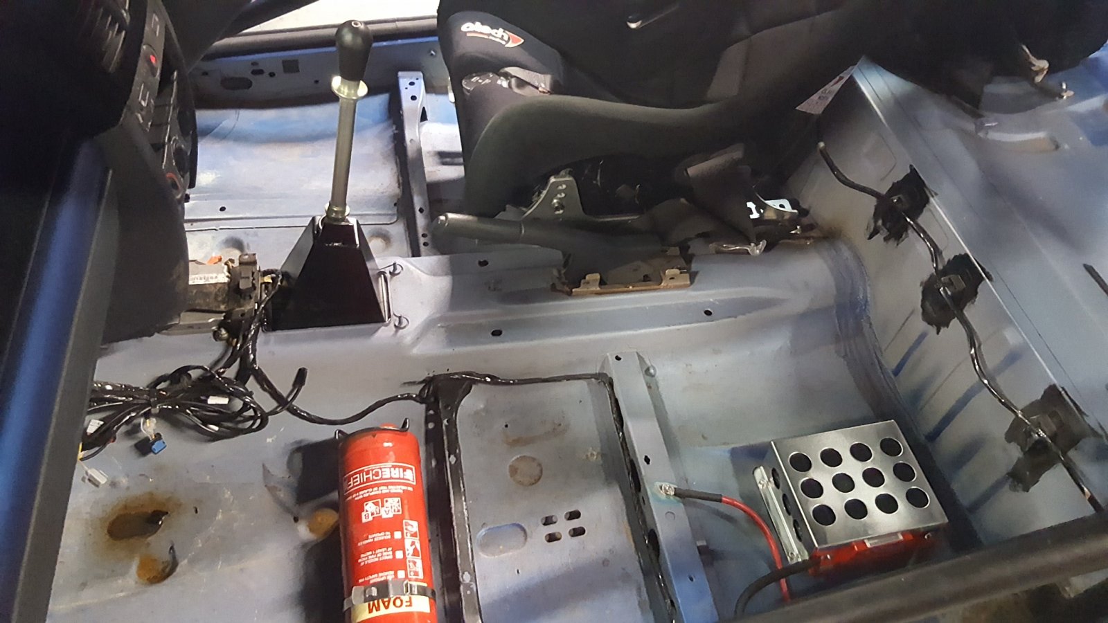

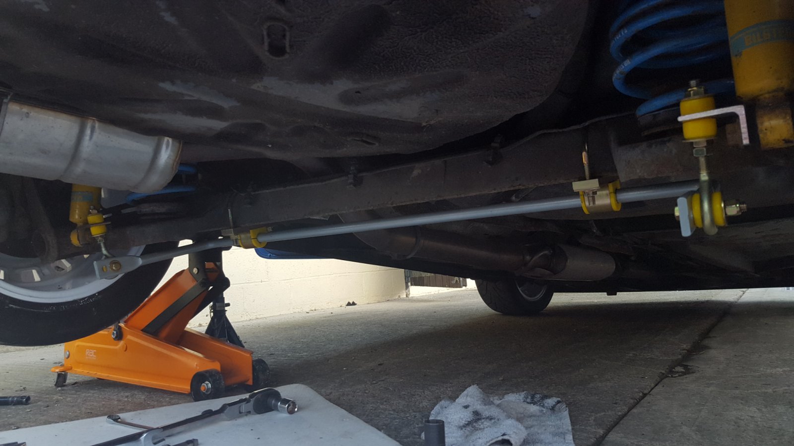

Nice session on the car today. Updated thread for my benefit/reference.
New Aux belt, re-tensioned
Coolant replaced.
ECU remounted in engaine bay under air filter
Cable run to the rear of the car, just waiting on battery arriving this week.
Brake fluid change this week coming, Geo check, fit 16mm front spacers, RARB link preload, Source replacement driveshafts, change gear oil
