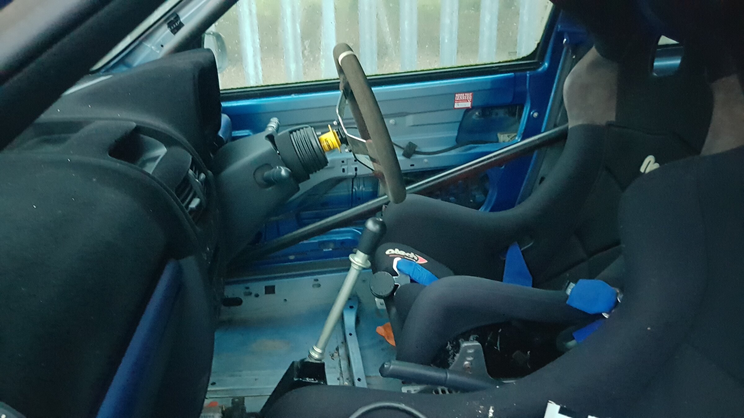

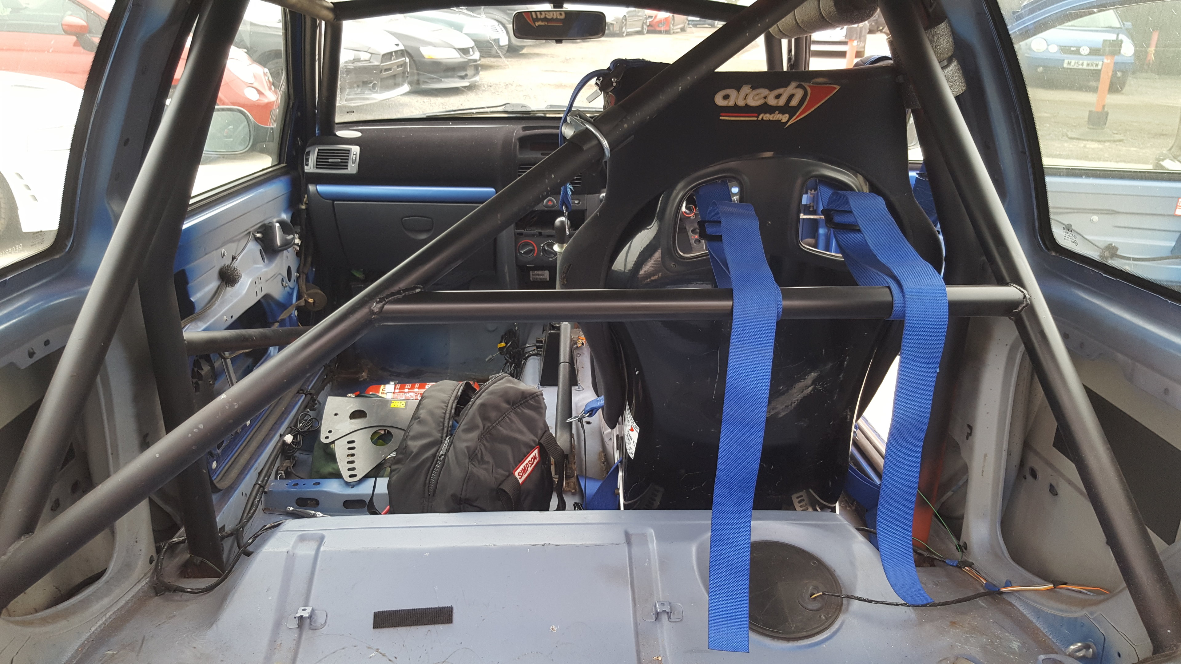

New boots and a harness bar added to my Sparco cage. A length of 38mm CDS tube and a couple of hours to scallop and stitch it in.
Ready for it's annual outing, next week. This yea,r Brands Hatch!

6 point Sparco Cage fully welded by Elweld Fabrications
OMP Seat with side mounts and Sabelt harness, welded seat rails
1.5L Fire Extinguisher in passenger footwell
Odyssey Red Top 30 Battery with cage, relocated to passenger footwell.
Flocked dashboard, cut around cage neatly
Deep dish LMA steering wheel and boss kit

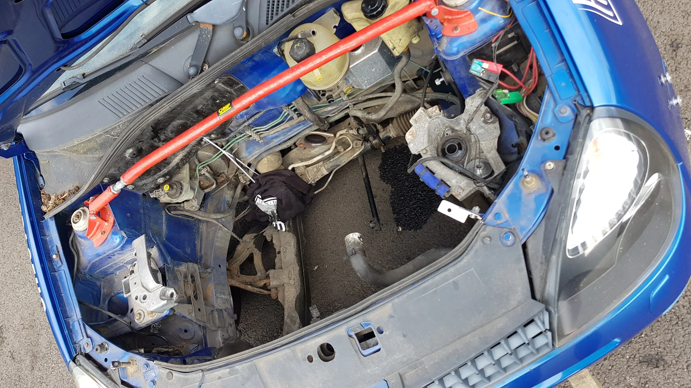

Some updates for this one!

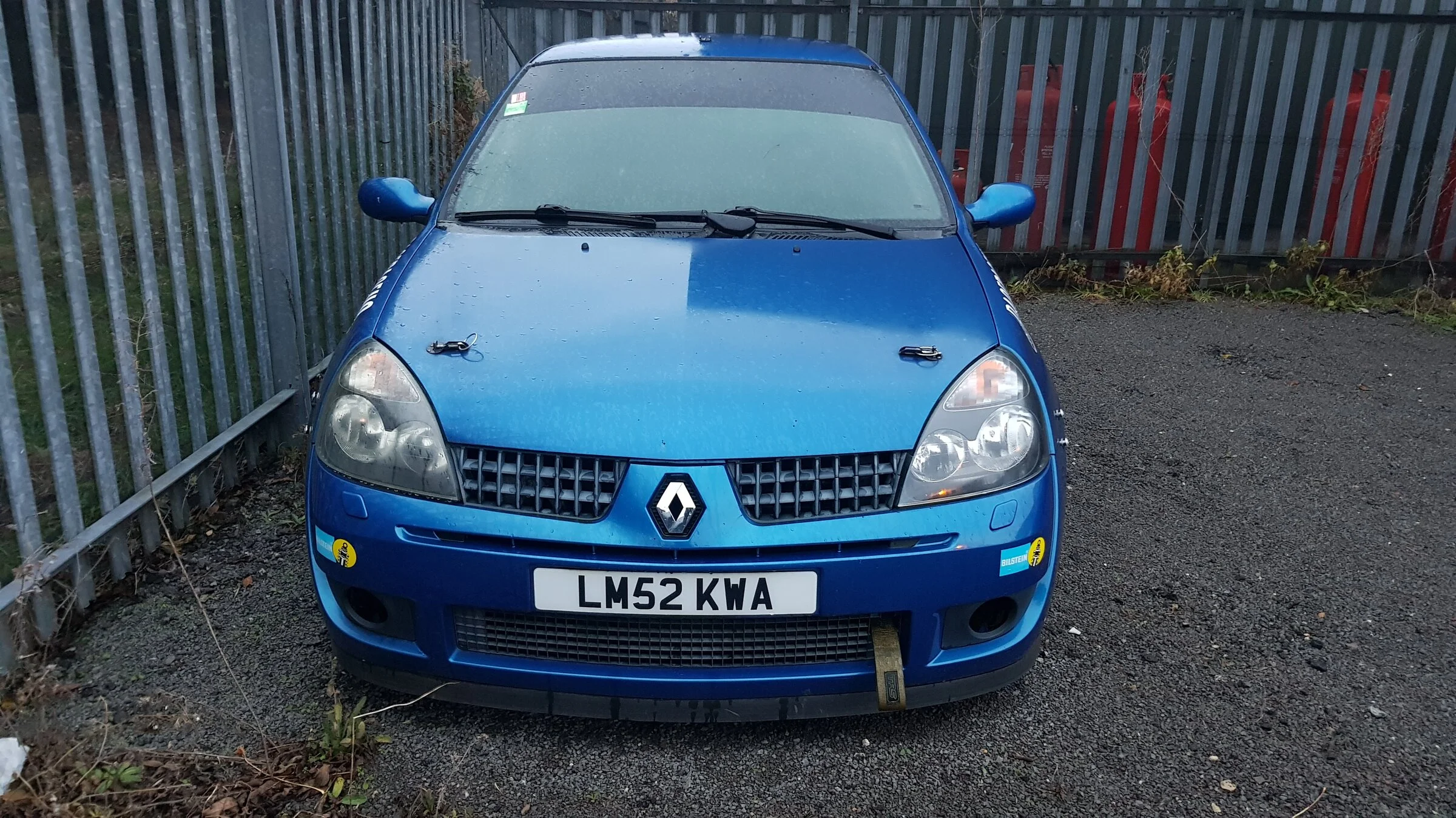

Having stood still for 2.5 years and at times forgetting its sat there, it was decided that the Clio makes a comeback.
As it sat in my compound -
Spare parts storage bin essentially! -
I'm buying the necessary parts and the guys in the workshop nextdoor are carrying out all the work required in exchange for driving it on track.
The job list includes;

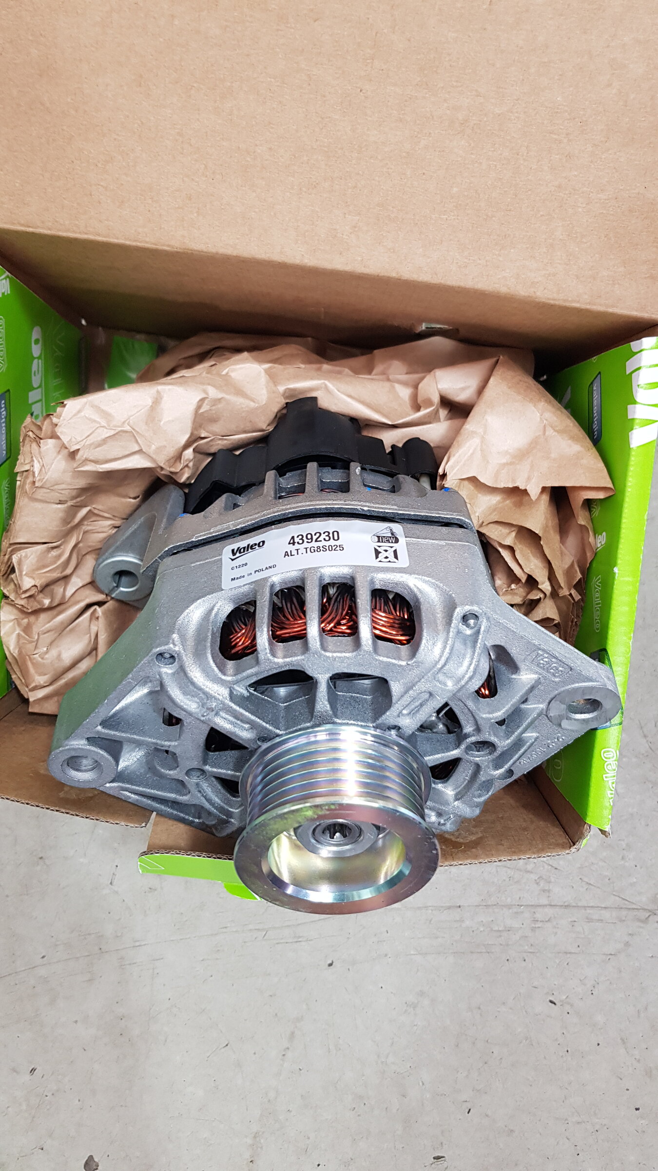

Replace alternator due to overcharging and knackering a dry battery.

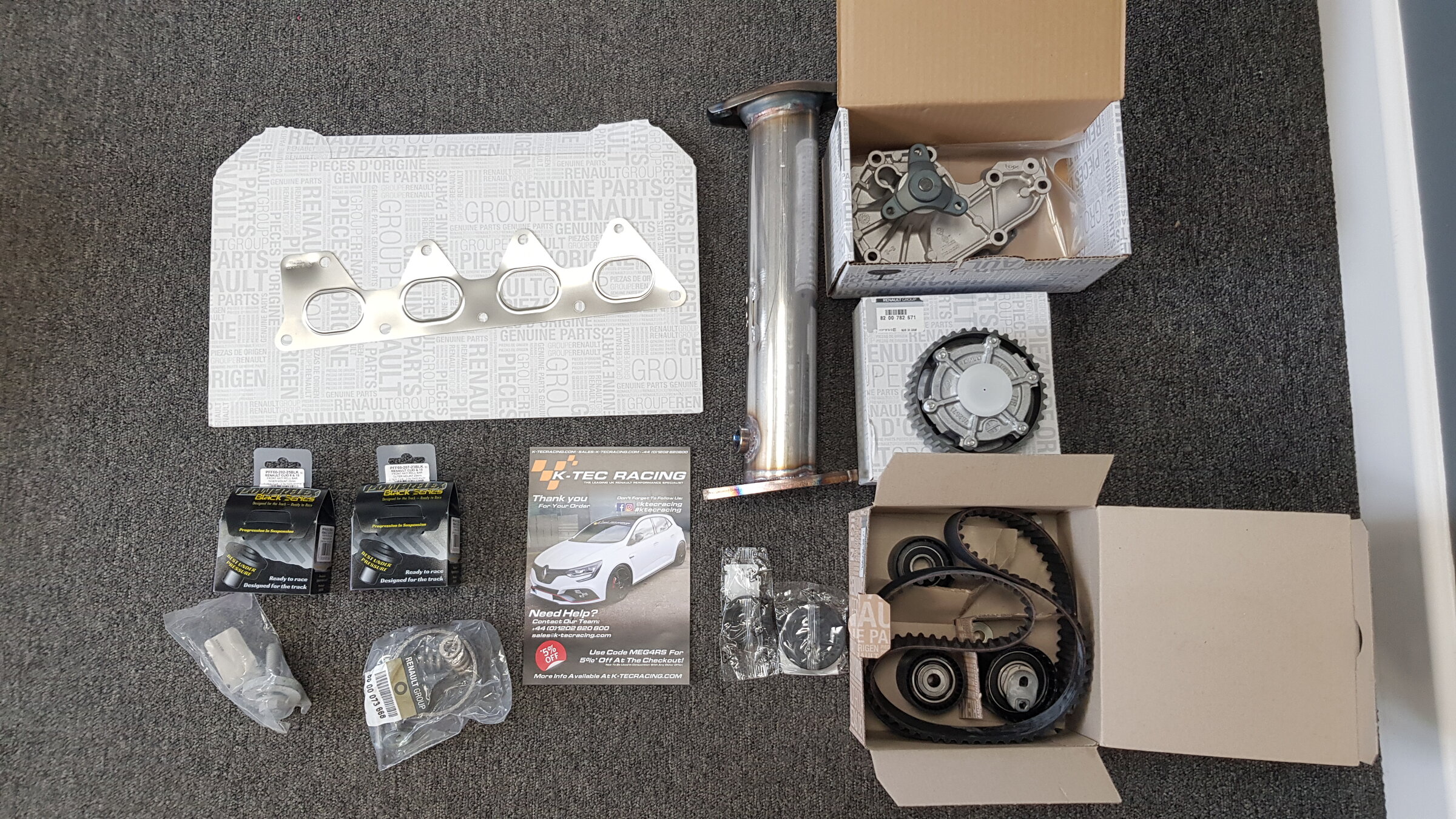

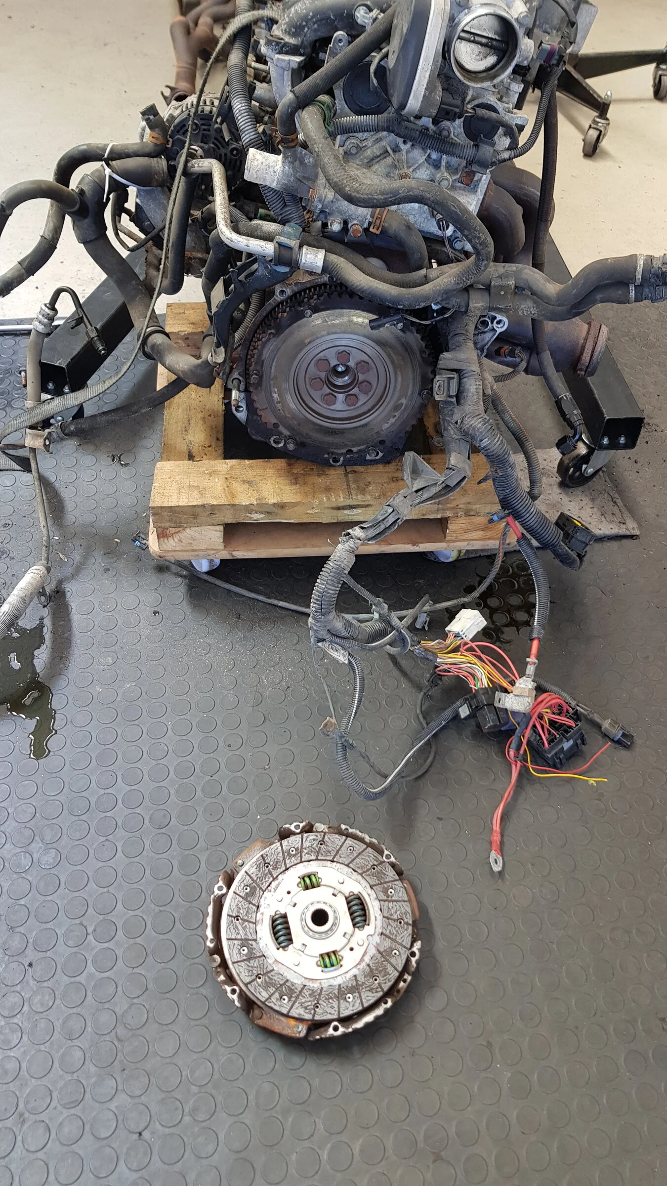

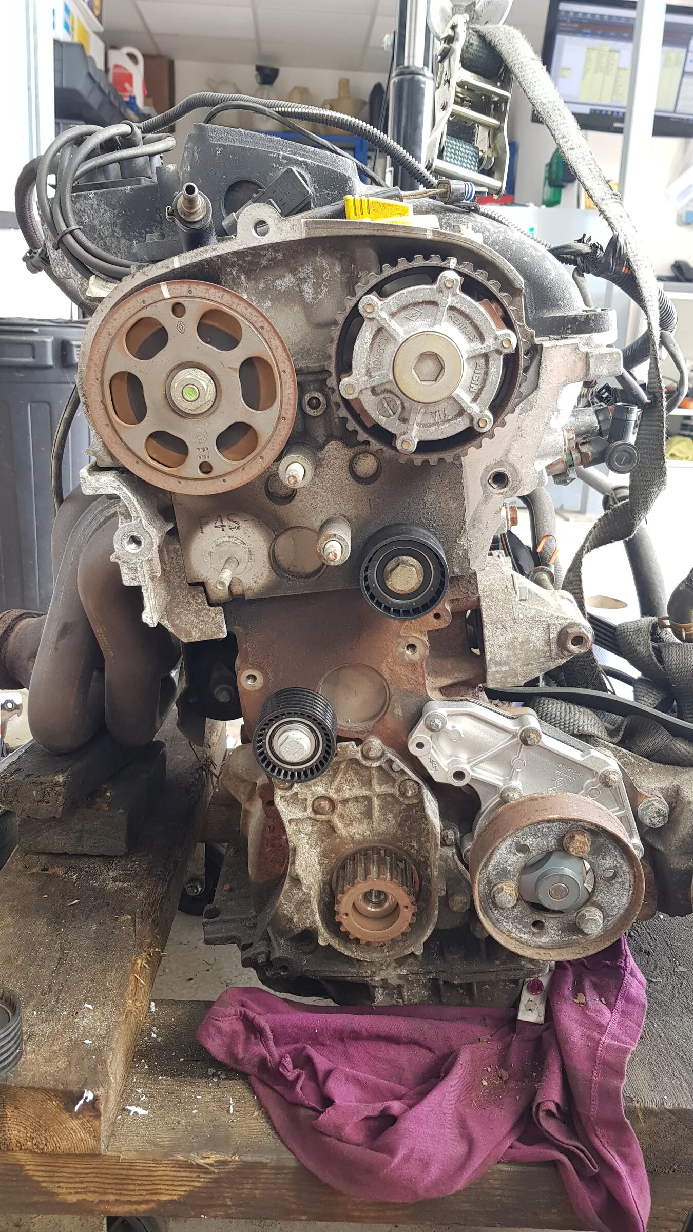

Replace cambelt kit, dephaser and water pump.

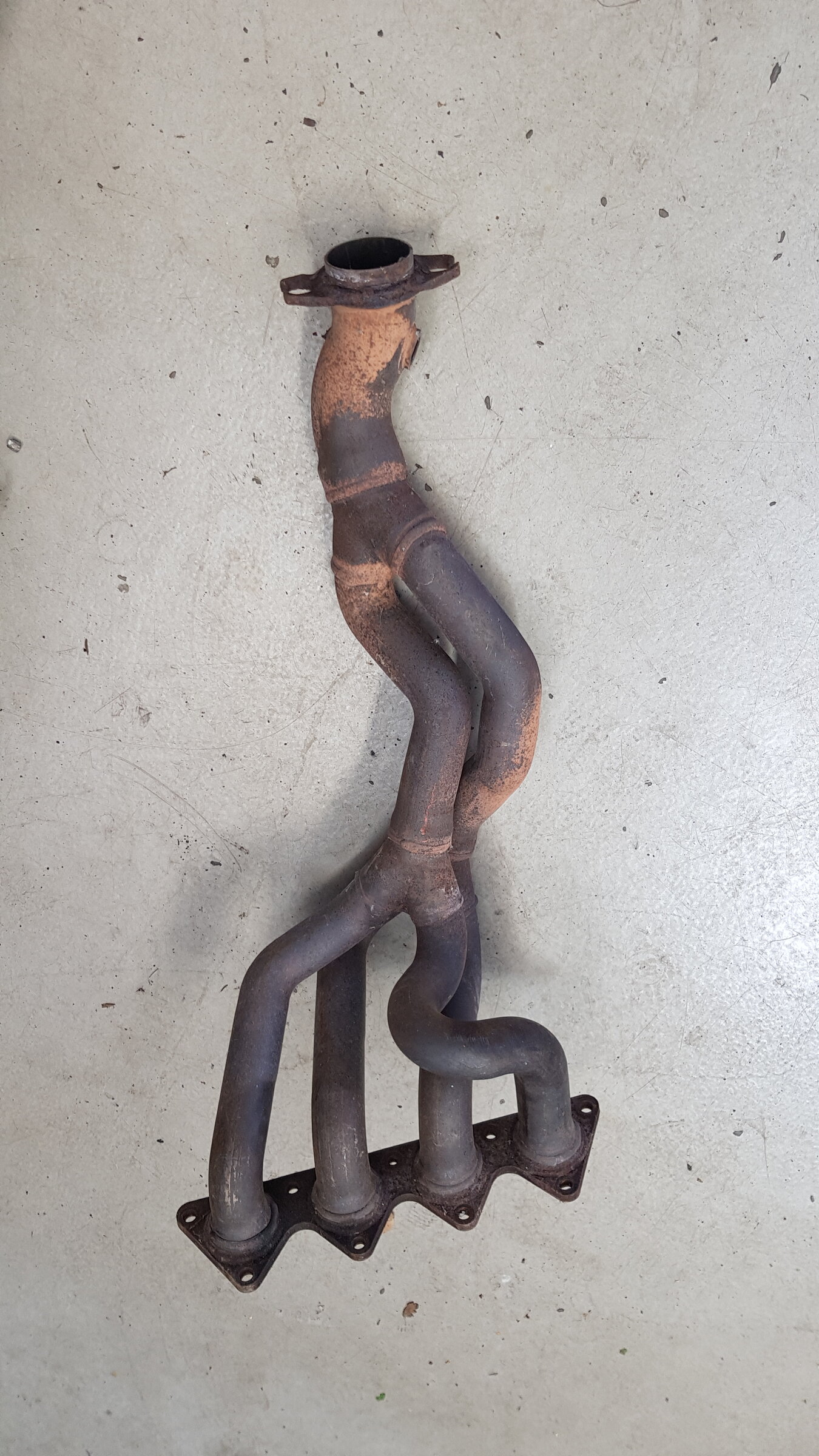

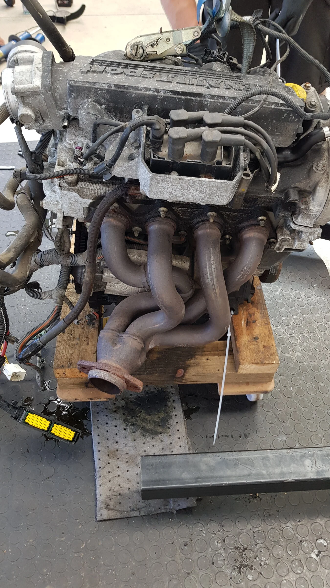

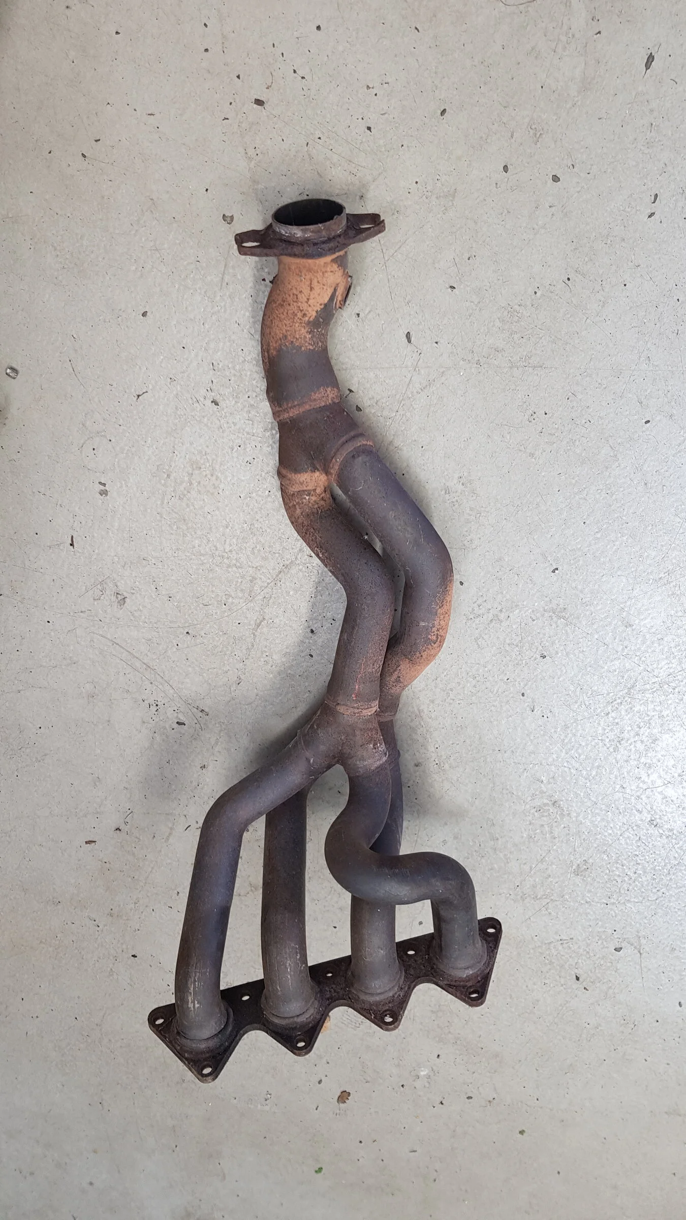

Fit 182 manifold and K-tec link pipe
Replace front ARB bushes

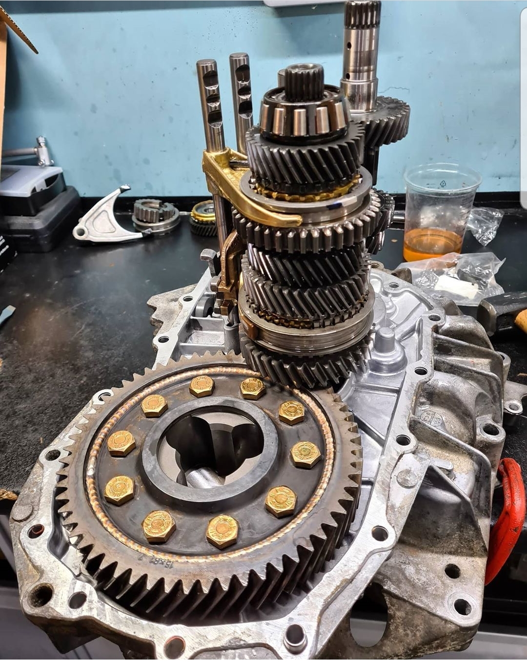

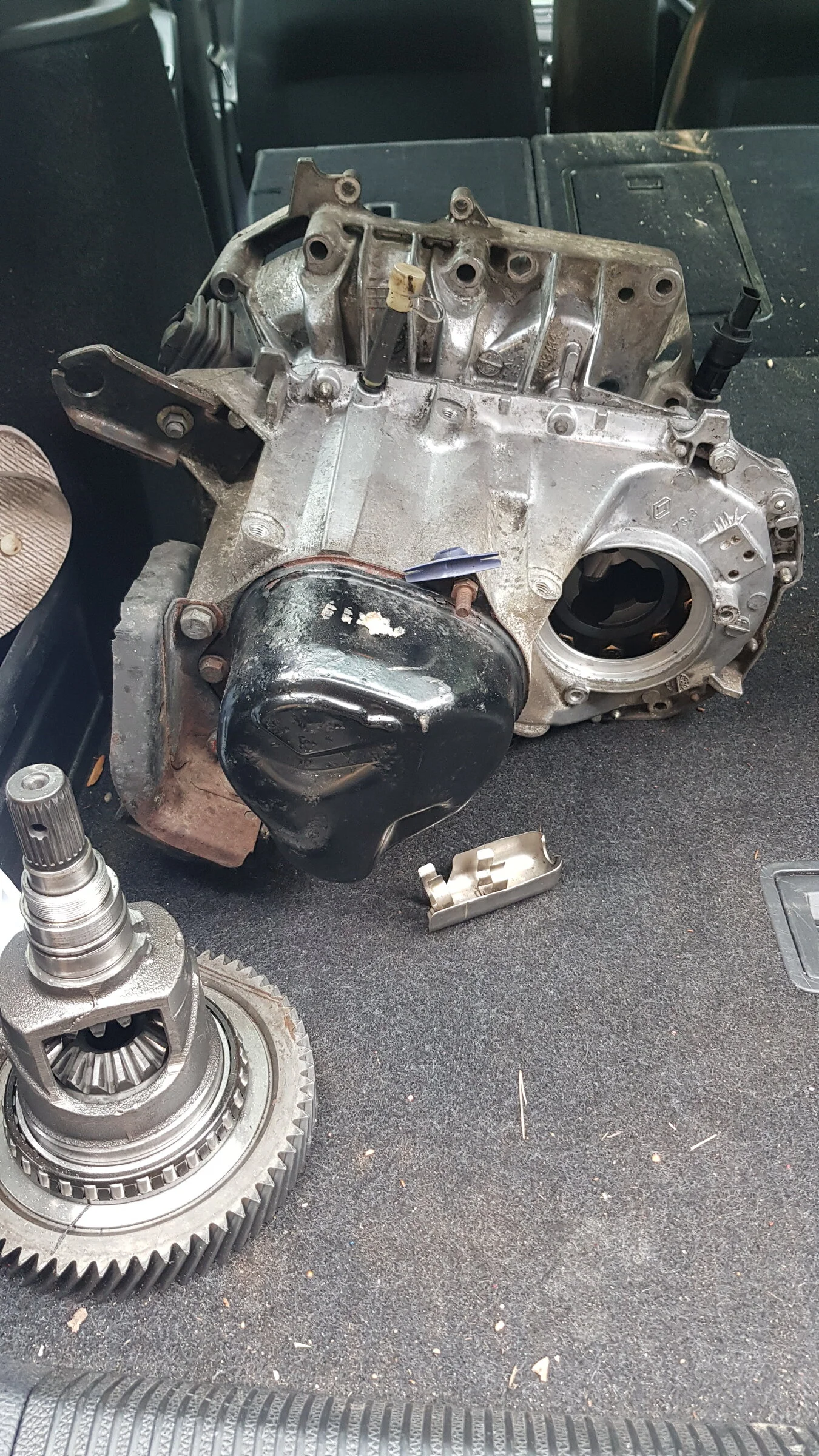

Fit Gripper diff to gearbox
The aim was to complete the car in time for Bedford on the 19th June but unfortunately a delay in receiving the diff from Pure Motorsport and then a lack of bearings meant the car wasn't ready in time.

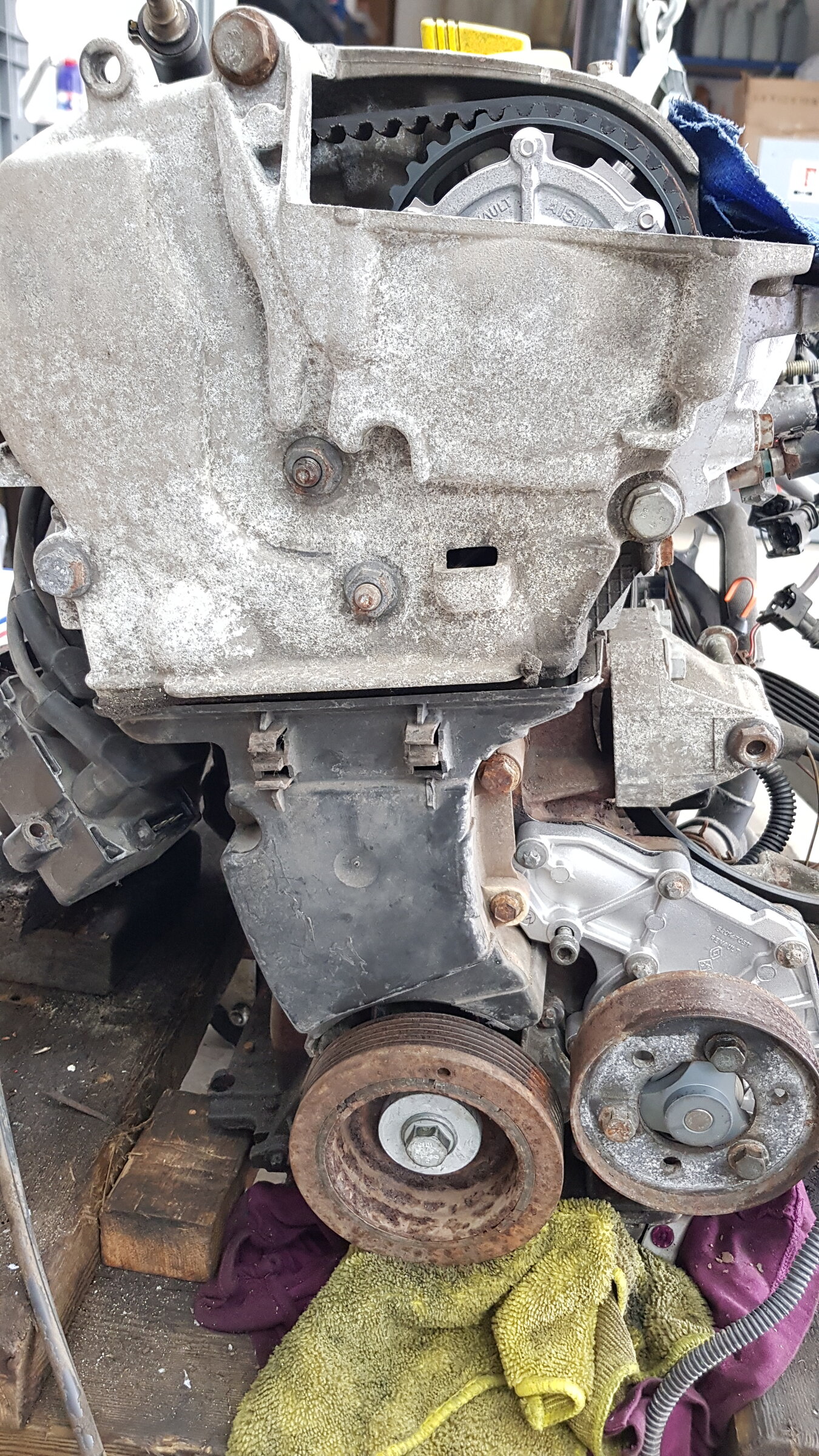

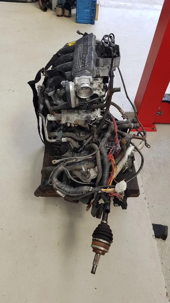

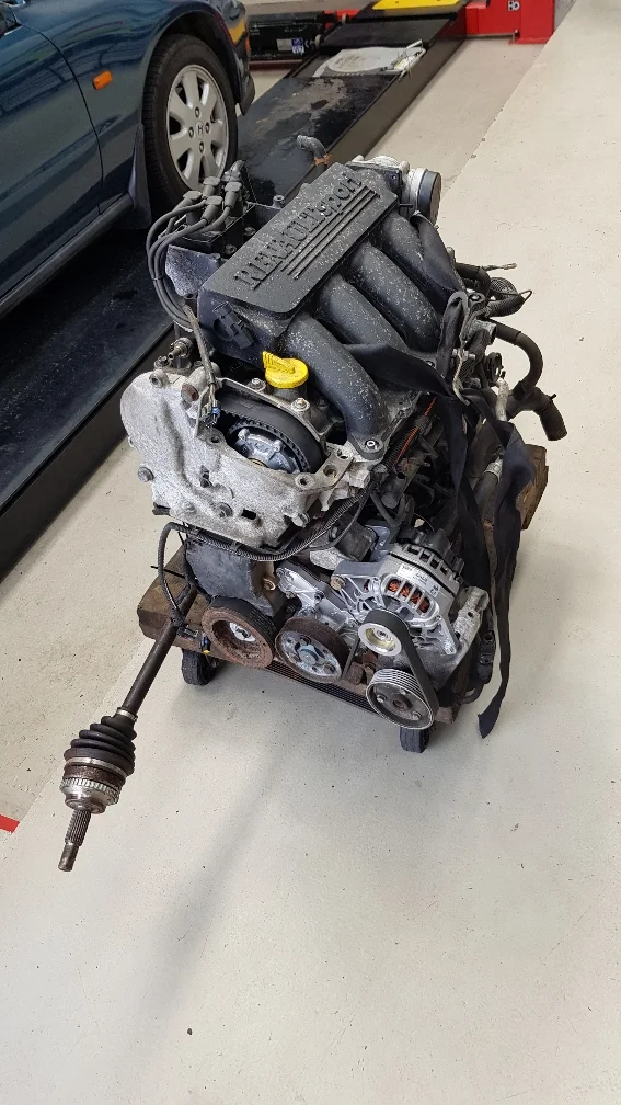

Engine out
The gearbox is still with Select motorsport who have installed the gripper diff, I am planning to pick this up tomorrow and then the guys can continue work.
Engine on the floor ready for the cambelt -
172 manifold coming off -
182 Manifold I purchased in 2015 for £50 ready to go on -
Gearbox off and ready to go for diff install -

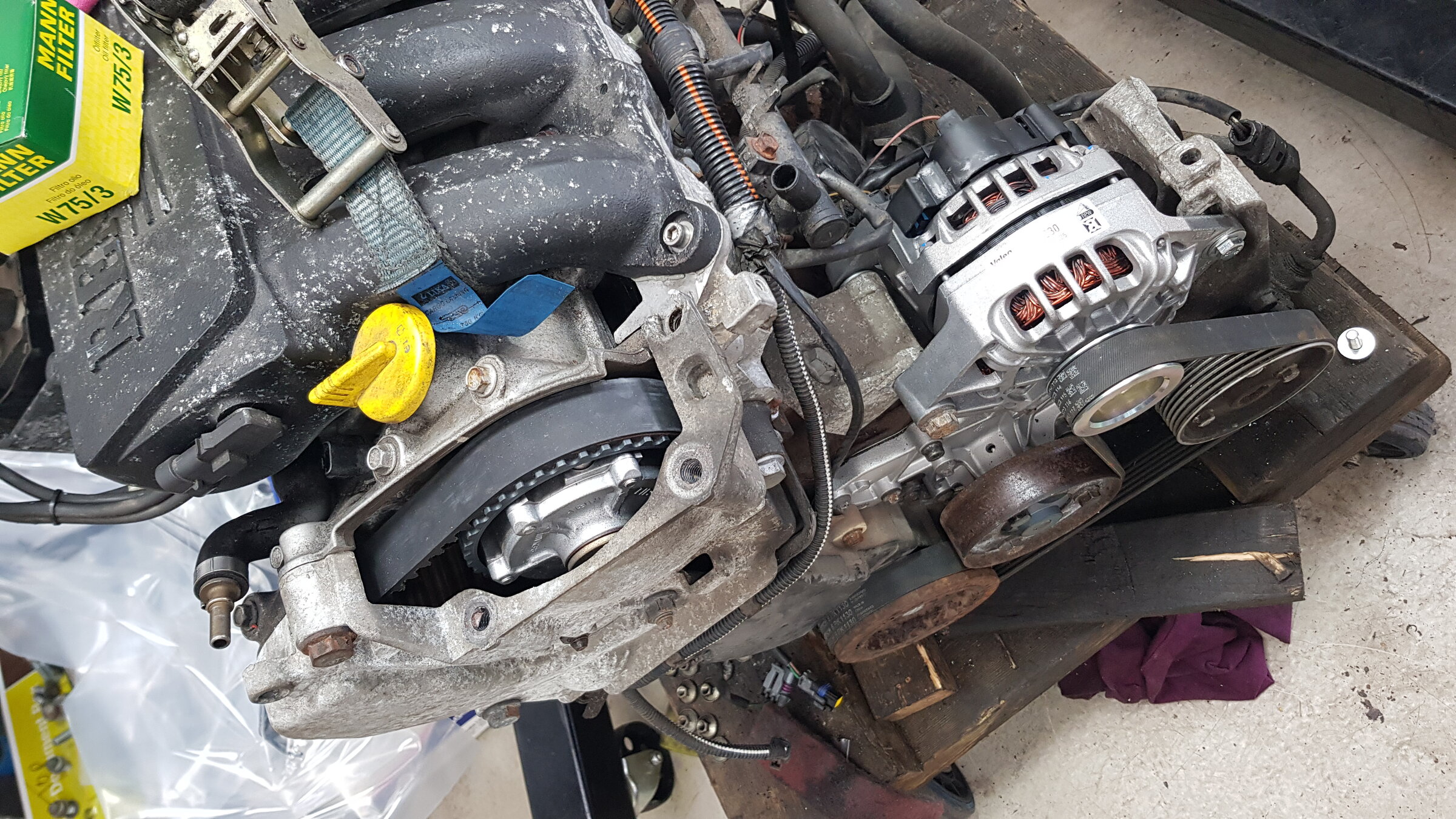

New bits arriving -
Old belt off -

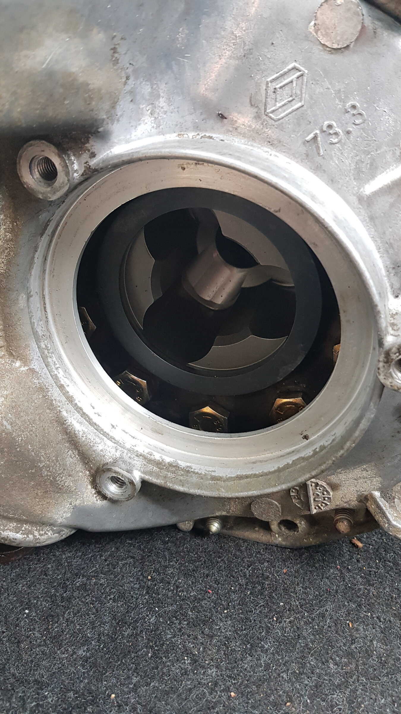

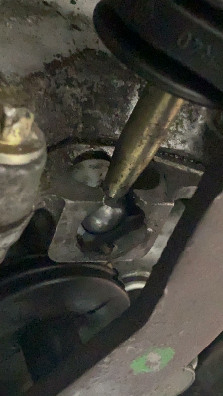

Upon reinstallation we discovered the bush that locates in here is no longer fit for purpose and requires replacement.
Could anyone suggest if the Yanoo Bush will fit with the PMS shifter?

New Valeo Alternator
New Gripper Diff with correct oil
New Cambelt kit with Dephaser

182 manifold fitted (and a brand new one in box can also go with it)

Gripper Diff installed by Select Motorsport
