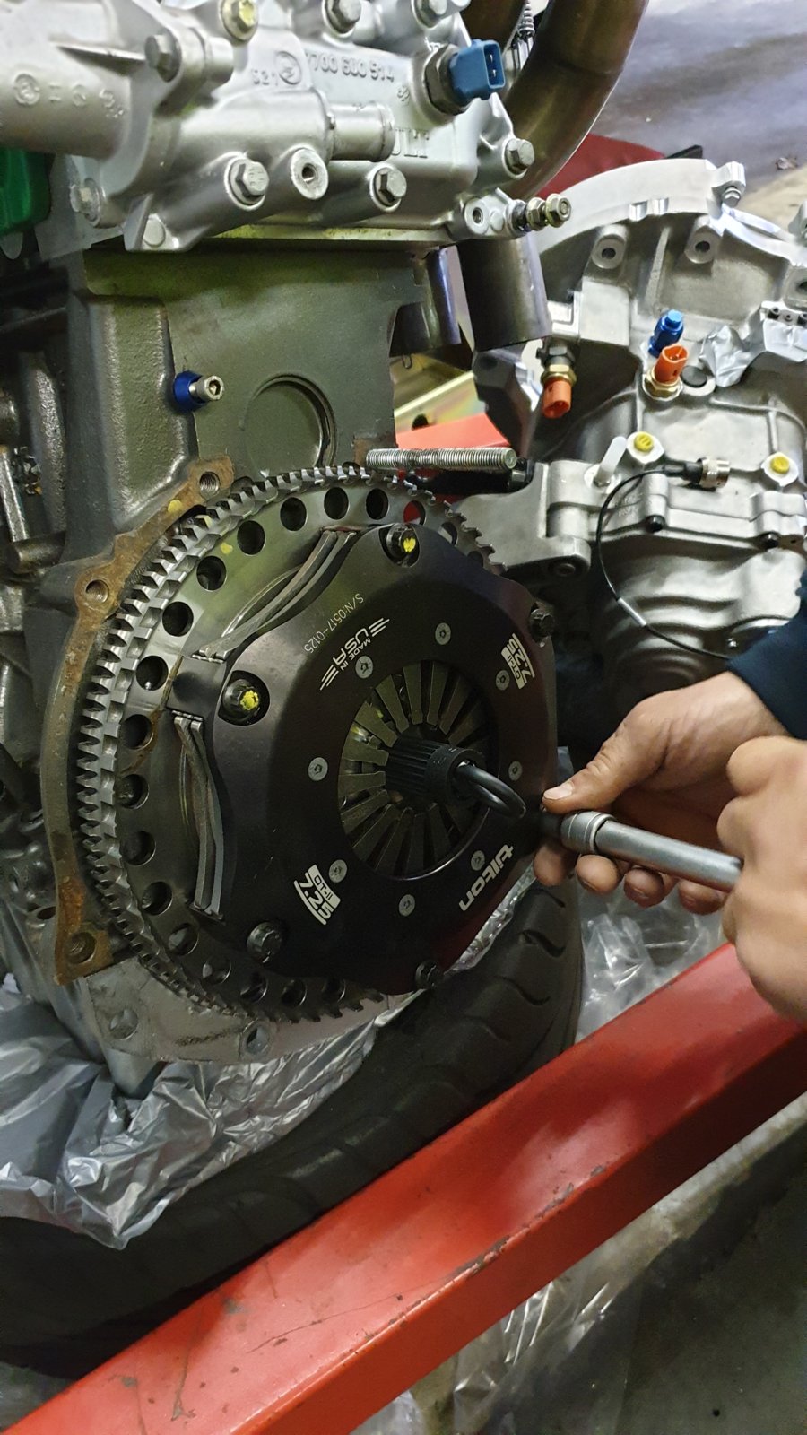

That's mega. My new favourite CS car methinks. I loved @NorthloopCup's car, but the engine moving into this is next level. What type of flywheel is it running? I know it's a revvy engine and close ratio box, but the way the engine builds revs on the dyno is mental.
Can't wait to see it in action, should be a properly quick little car.
NorthloopCup
It’s running a pms 7.25” clutch/flywheel combo now, but I’m pretty sure they’re the same 2.9kg weight that the one I had fitted was.
