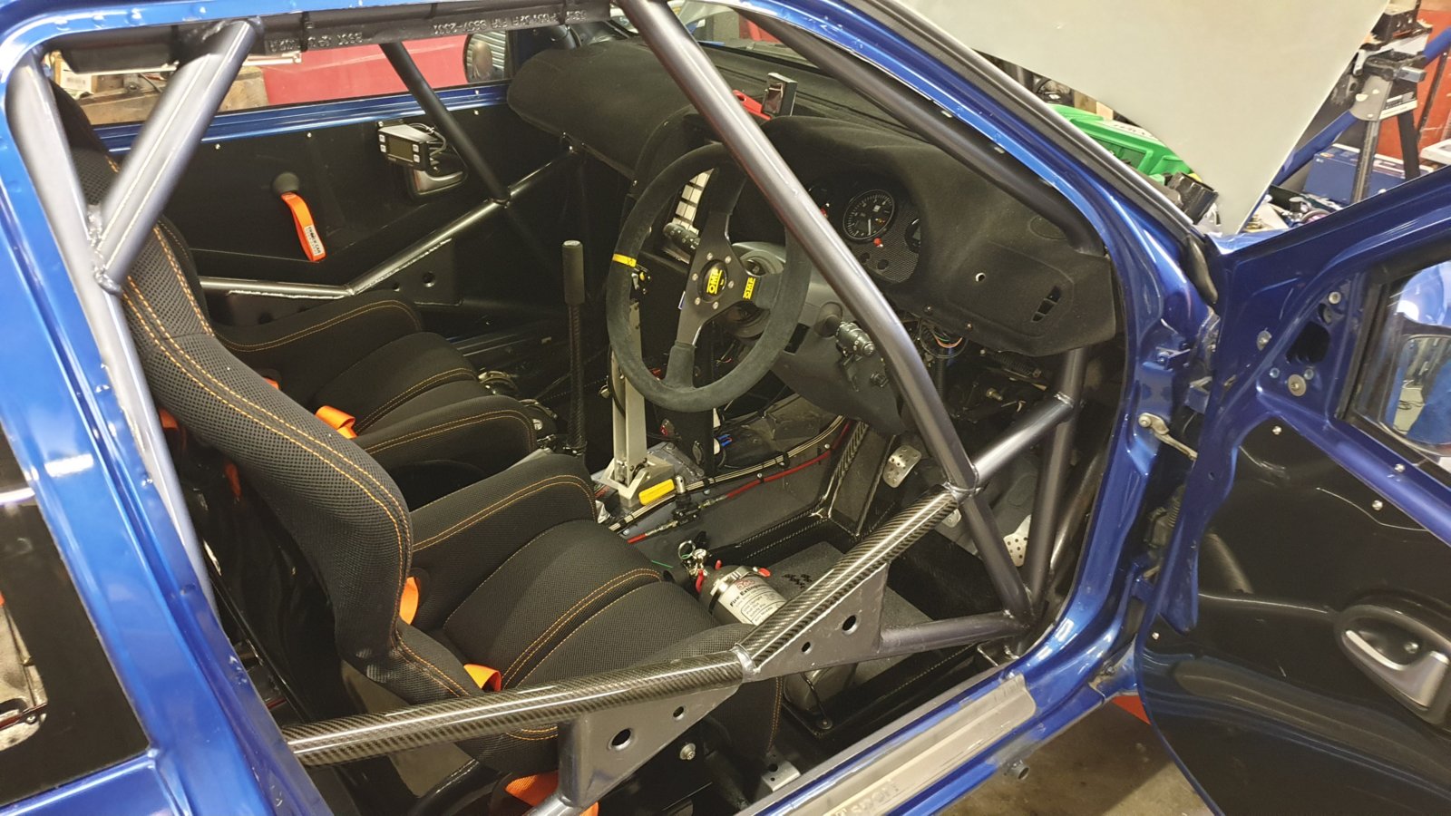

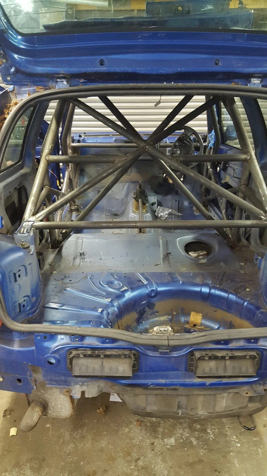

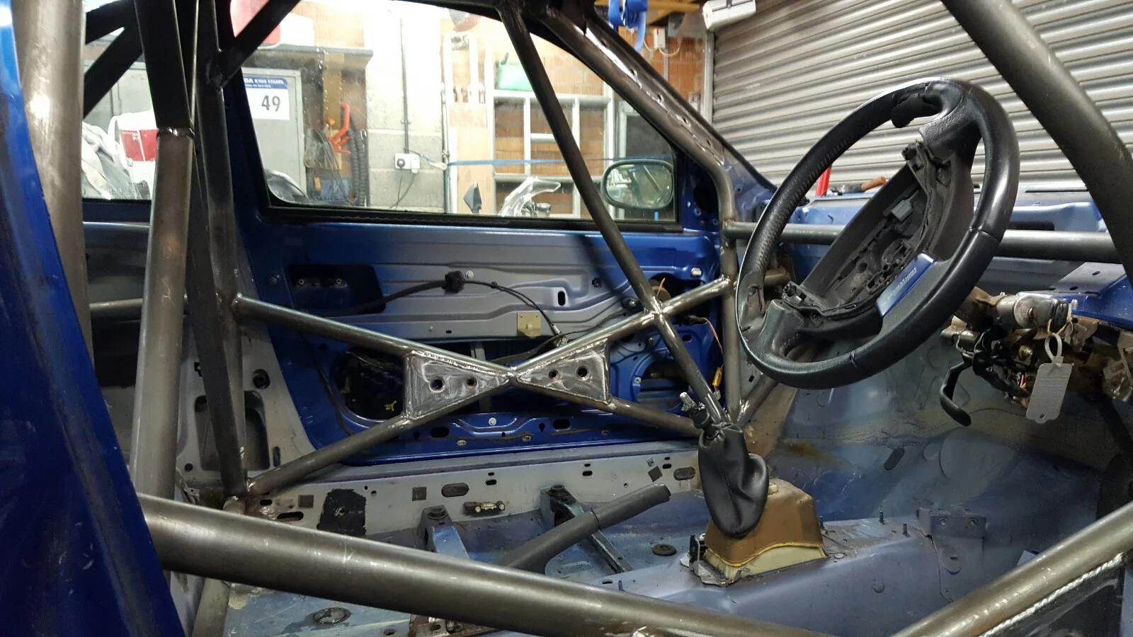

While looking at different cage options I stumbled across the advert that Tom Johnson had listed for a 172 cup shell with a fantastic cage already done. As it was only 15 minutes up the road, the decision was made. This was followed by the purchase of a MIG welder, a selection of Pure Motorsports upgrades and some sill stands. This brings us to today and rain meaning an early finish at work so into the garage to make a start.

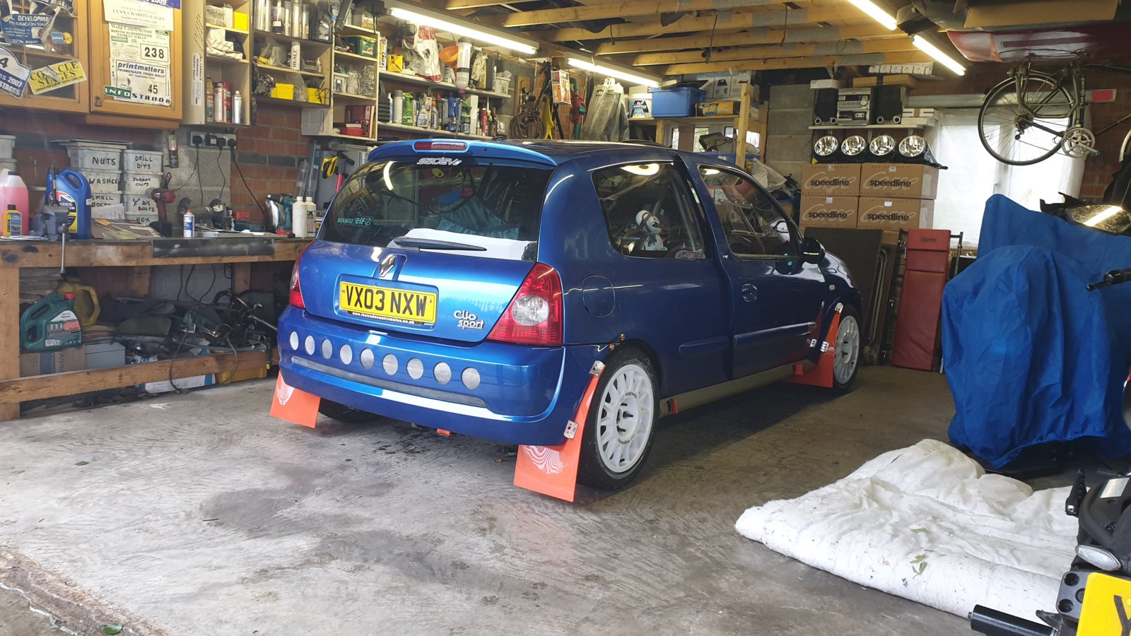

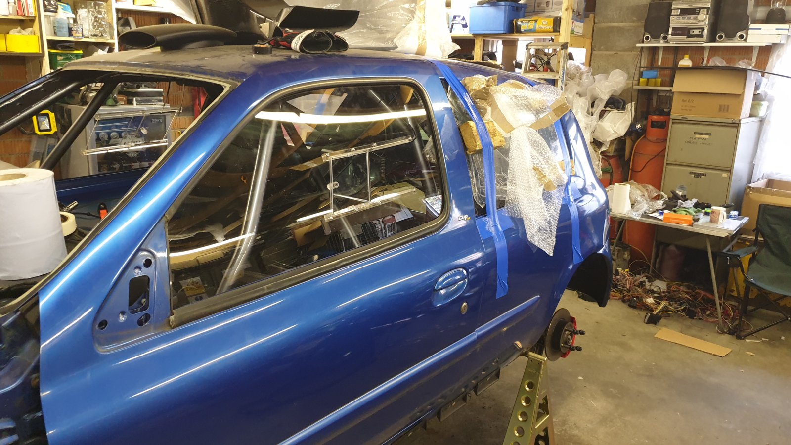

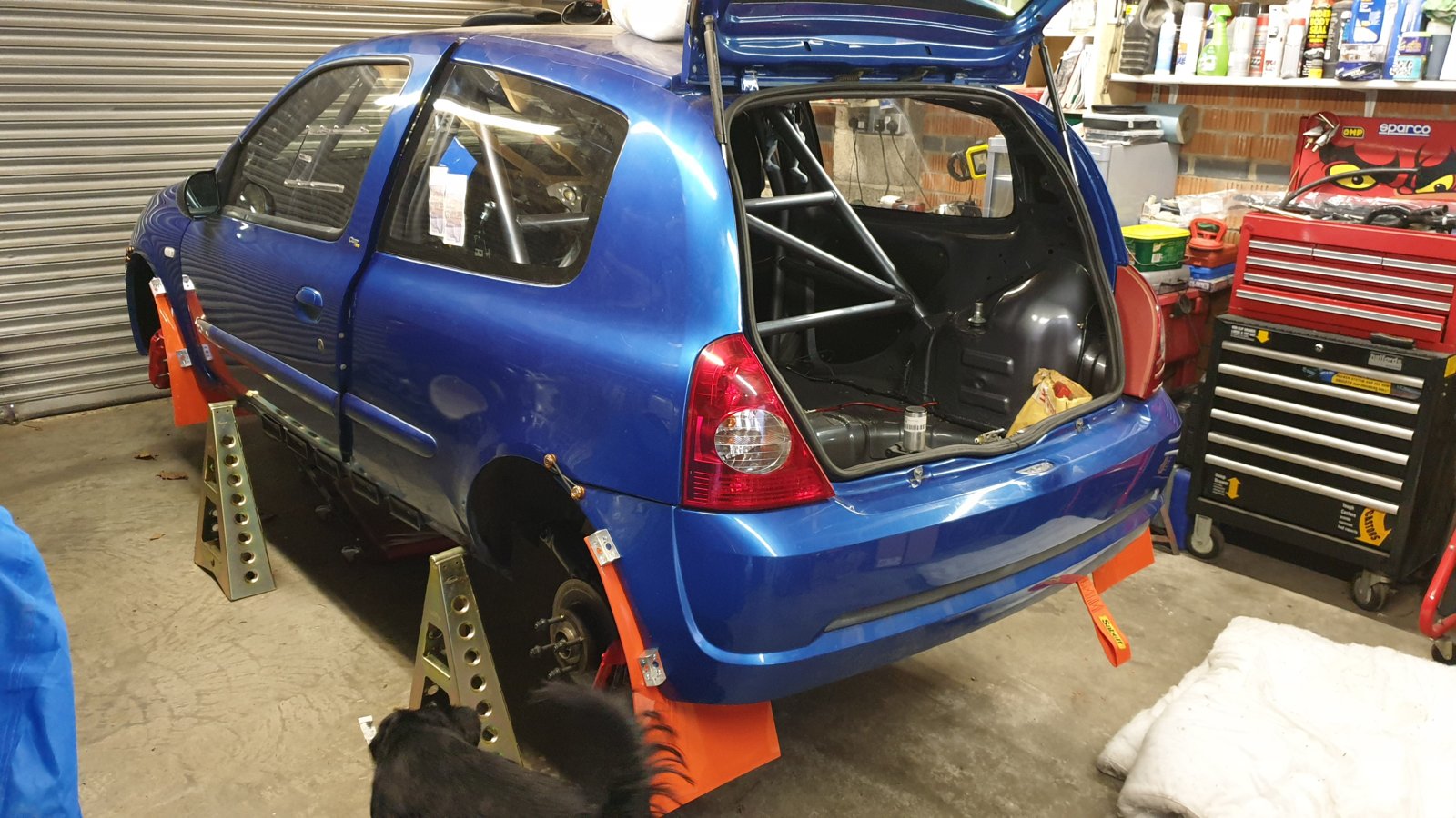

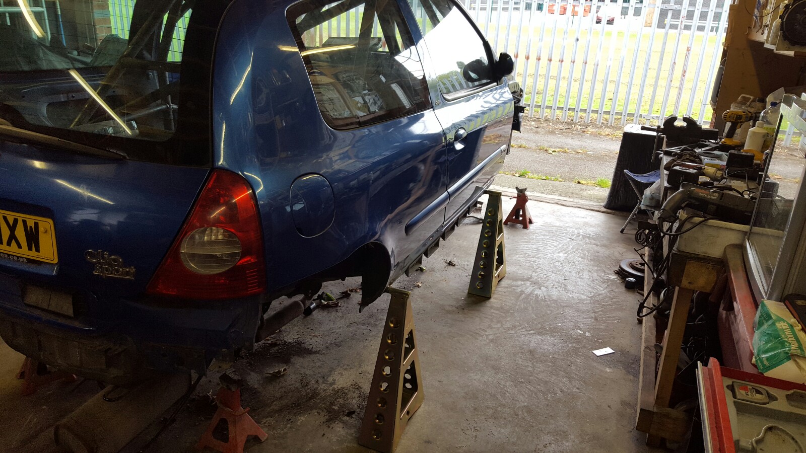

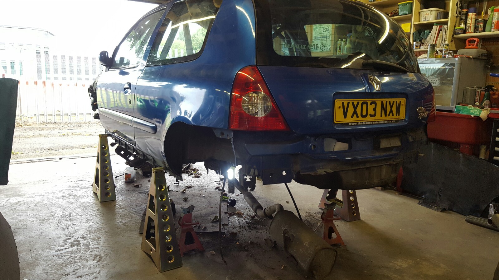

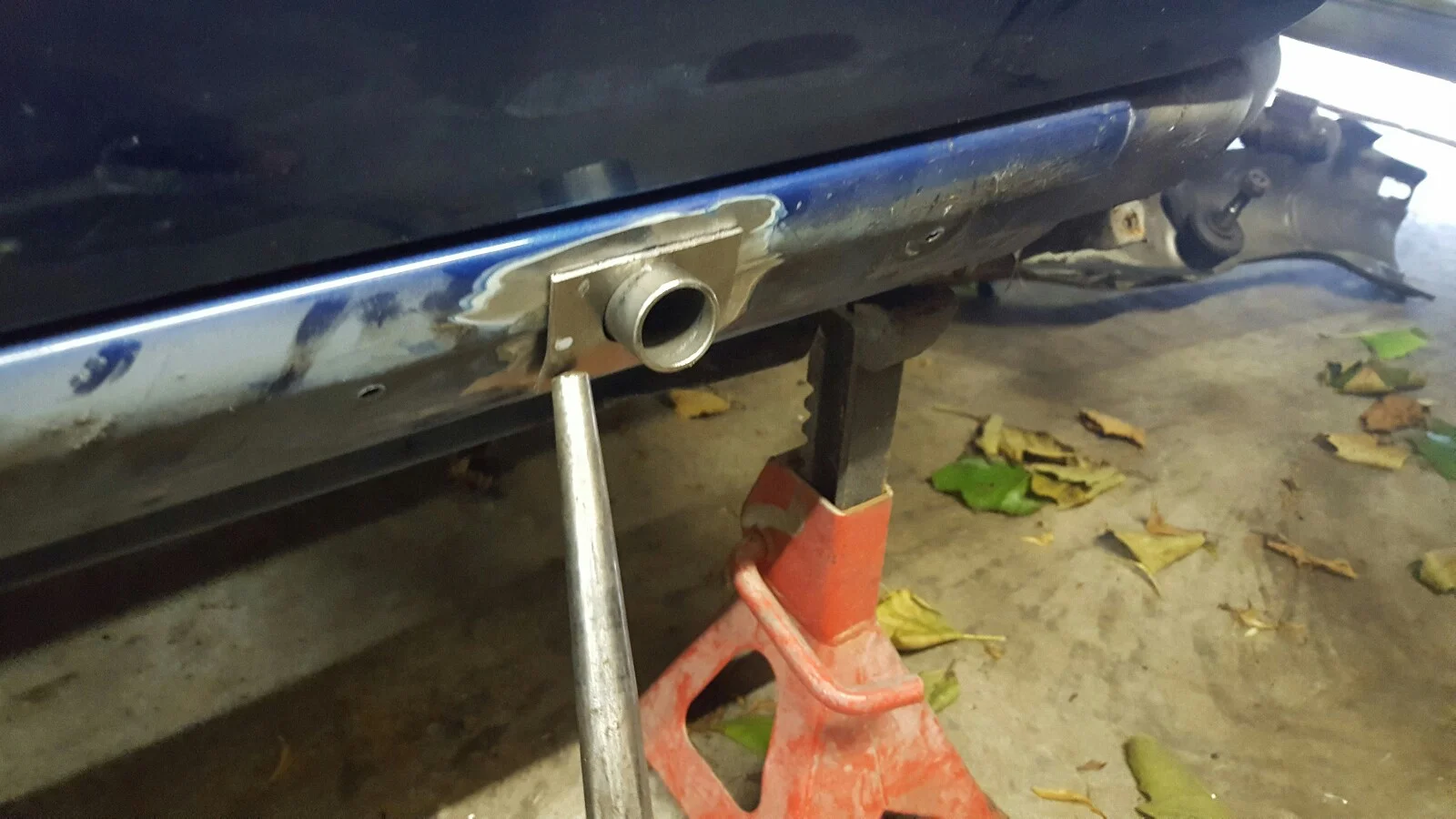

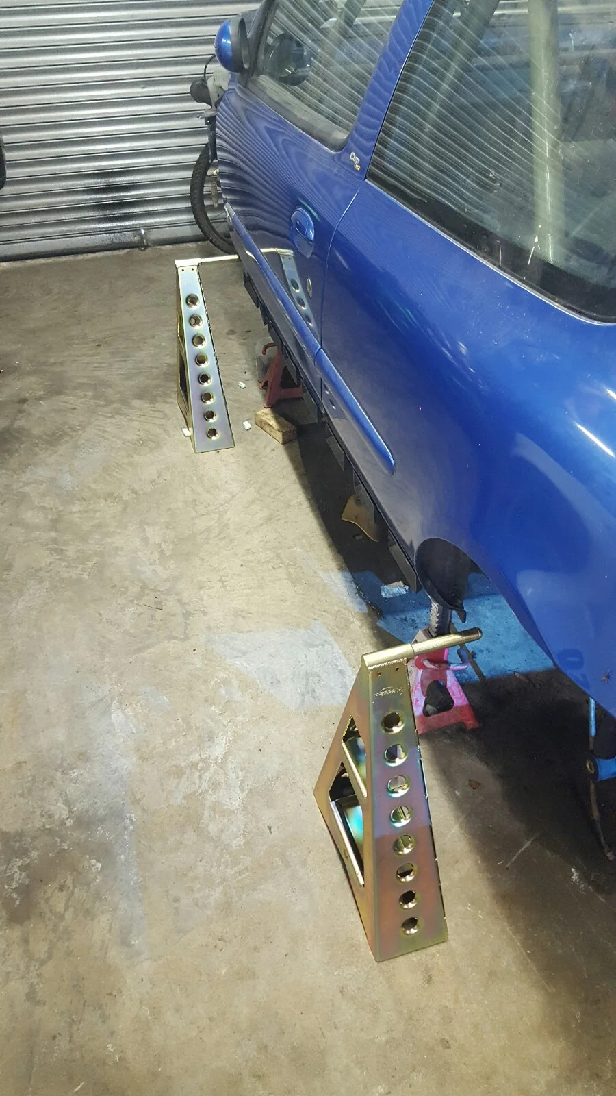

Weather was much better today so had to put a full day's work in. Just managed a quick hour to finish off the sill stands tubes though
Much better for access and safety.

Those sill stands are monsters!
Nice to see someone else rallying a Clio. Would love to convert mine, think it would make a cracking little car for not a lot of money.
richard1764
  172 cup, R33 GTR, UT
The sill stands are the tallest I could find, 580mm to the centre of the pin. At just over £200 for the set thought they were pretty good value when you see the work involved. Much easier than having to kneel down to locate conventional stands in a suitable place especially in wet or muddy service area.

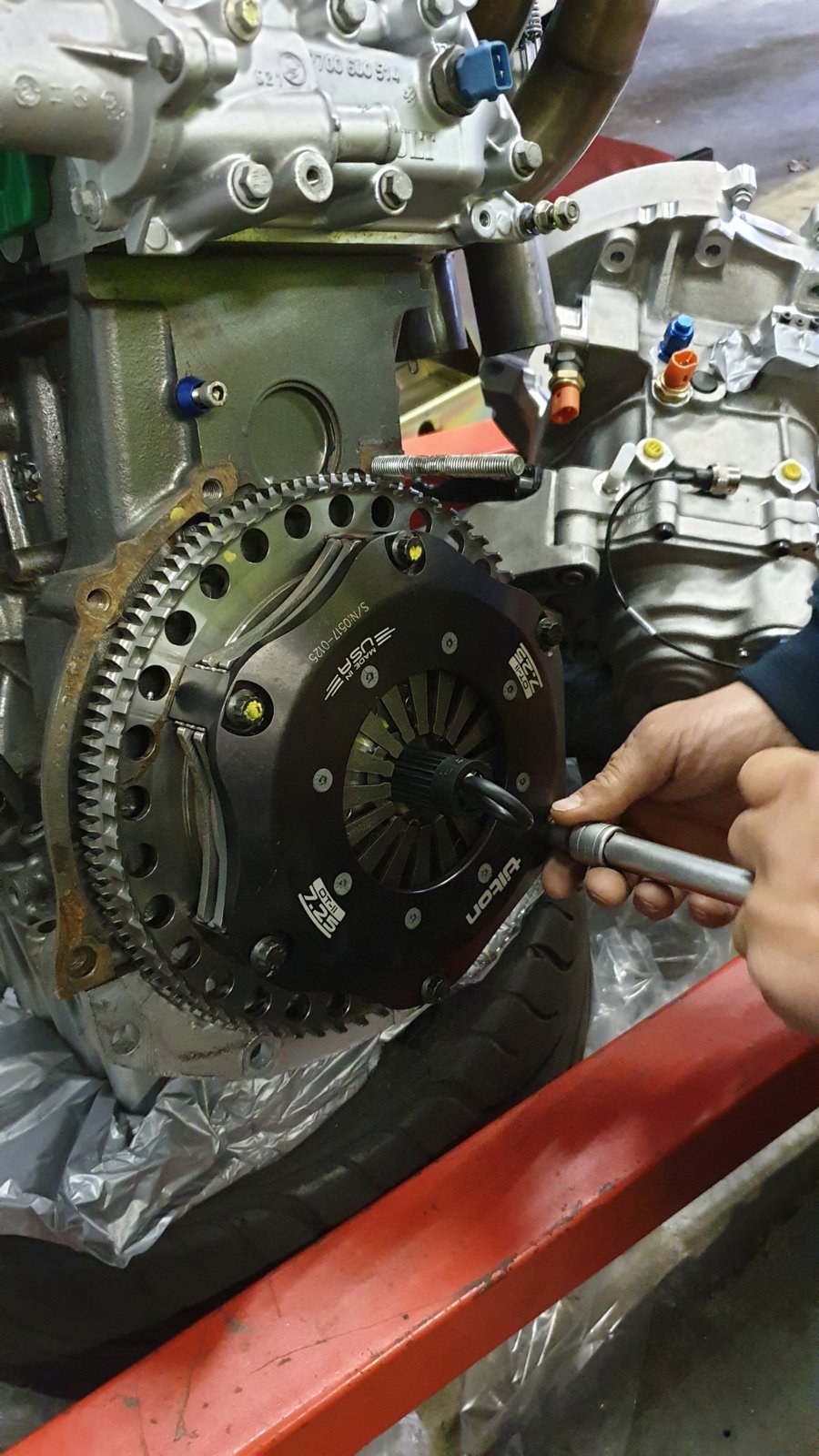

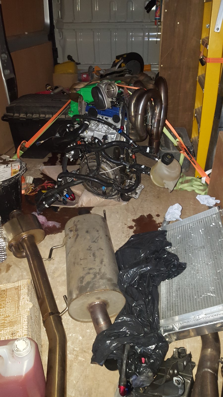

Unfortunately work has been really busy so no real time on the car recently. However the upside of being busy is being able to do a little shopping. Was quite late when we got home so not a great picture I'm afraid. However, we now have a rather nice engine completely setup on a Gen90 ecu, PMS manifold and BTB stealth system and various other nice bits and pieces.
Plans for a Samsonas dog kit for the gearbox have gone up in smoke as they are not currently producing them due to high demand for their other products. So it is looking likely we will be biting the bullet and opting for a Sadev sequential.
Will try and get some more progress updates when we can get some garage time, the beers are in the fridge ready.

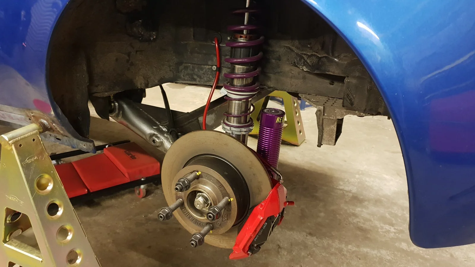

Finally managed to get back in the garage tonight to start putting a few bits back together.

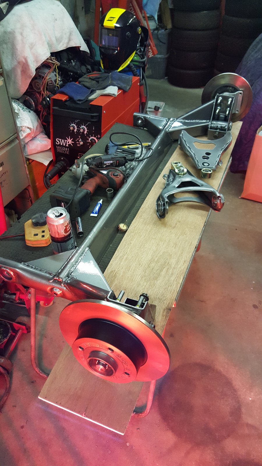

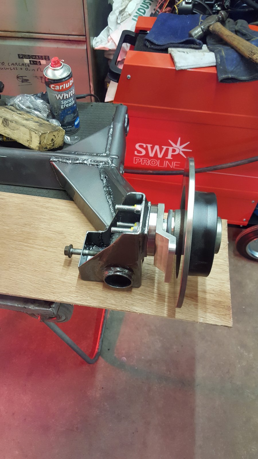

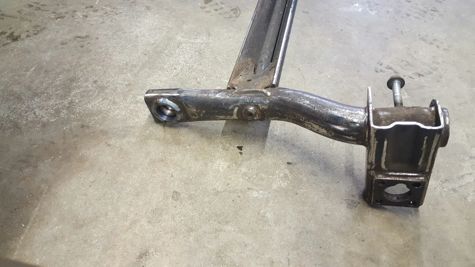

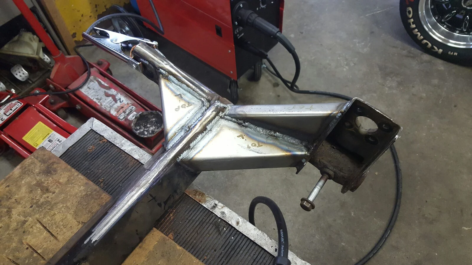

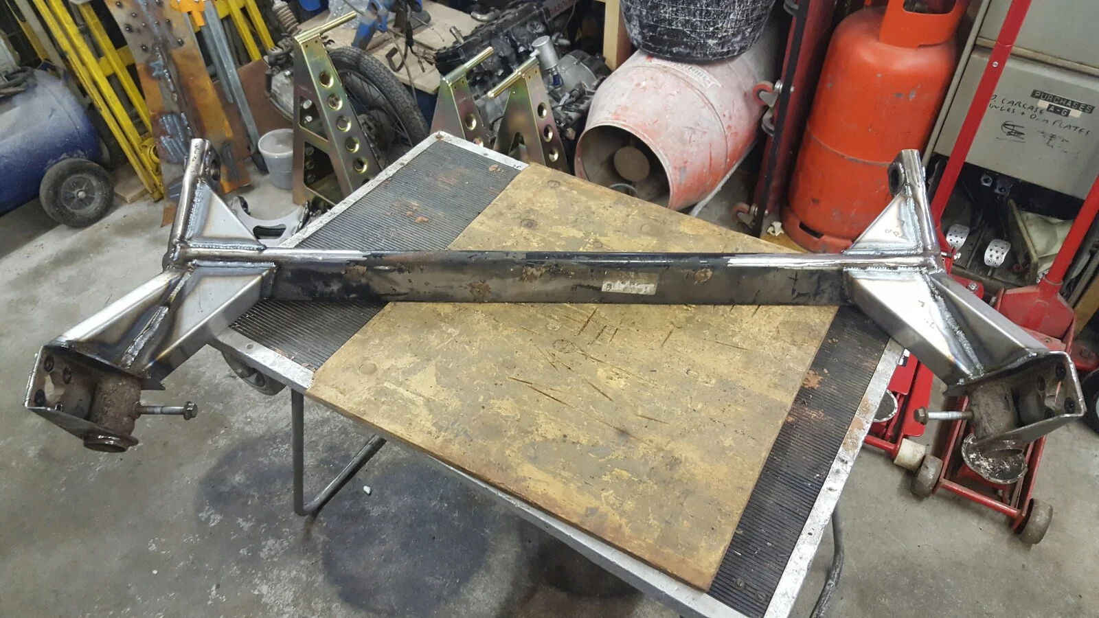

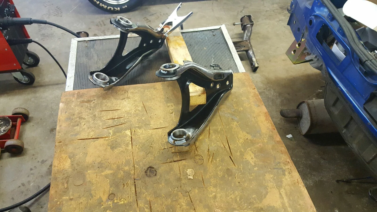

Rear beam, subframe and wishbones have all been powder coated so fitted the PMS uprated rear stub axles to the beam, cleaned up the front hubs ready for new bearings and painting. The Reiger suspension has been paid for so should be here next month and just received the PMS top mounts to go with them.

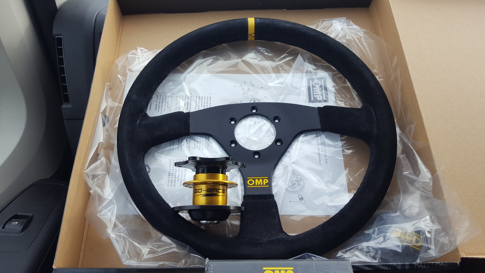

Will hopefully have a few bits from CM Composites by the weekend too. Found ourselves in Wrexham last Friday so popped into Tweeks and picked up a steering wheel and quick release boss so we can finalise the position for the seat rails. Hopefully with the darker nights shortening our working days we can get things moving on a pace.

By heck that's a good looking cage :laughing:
Wish you had come to me to weld the Pms kit on the rear beam though :grin:
Good progress Rich
It's a fantastic cage mate, will be painted shortly. Lad we had working for us was a welder so we got him to do the beam when we got rained off a job. Not as neat as you would have done but it's strong and won't be on show unless we stick it on its roof!

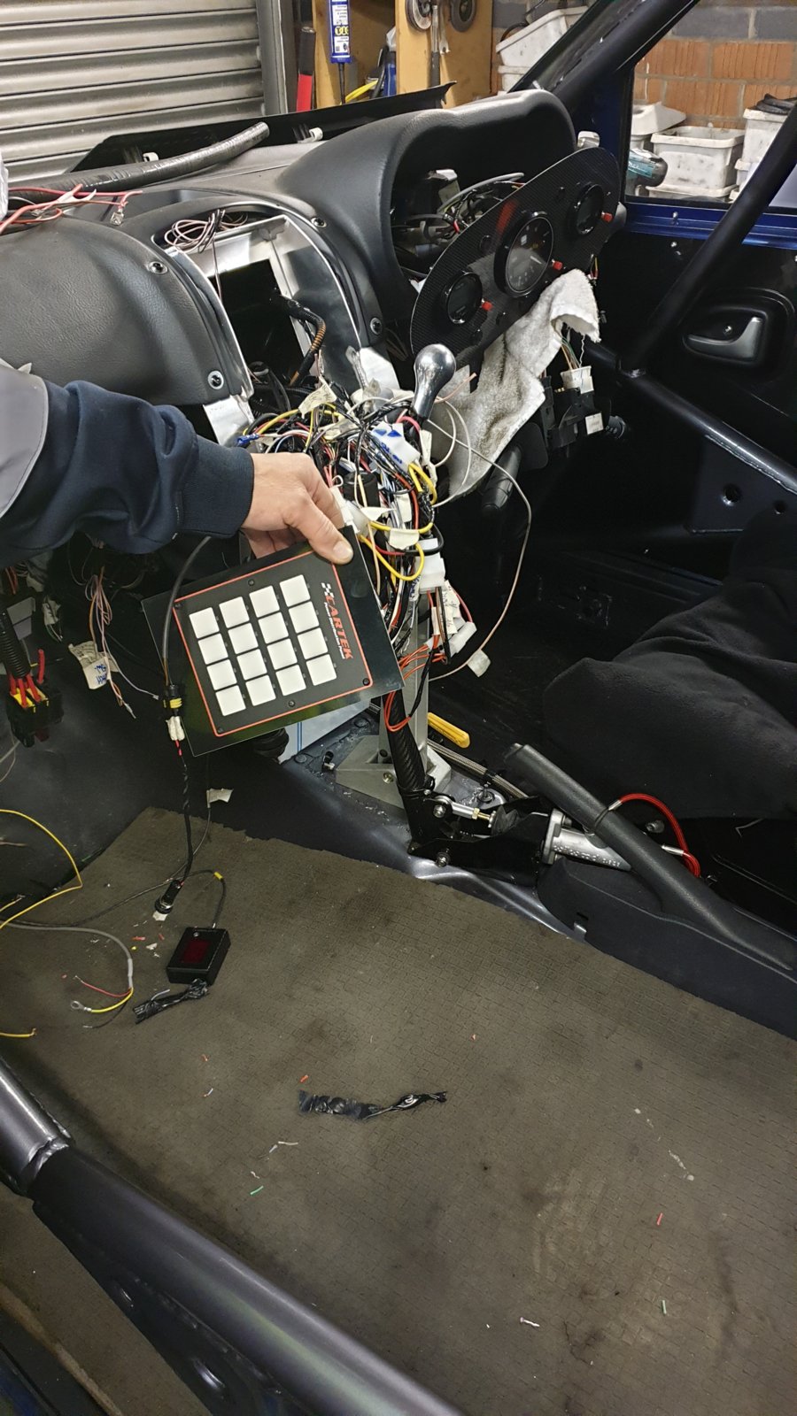

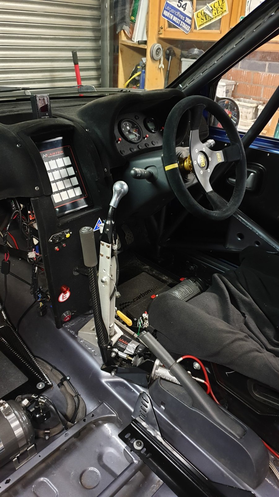

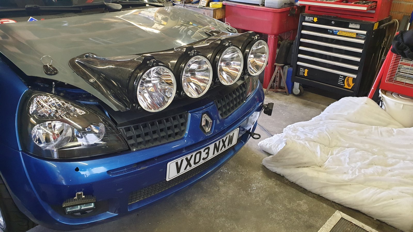

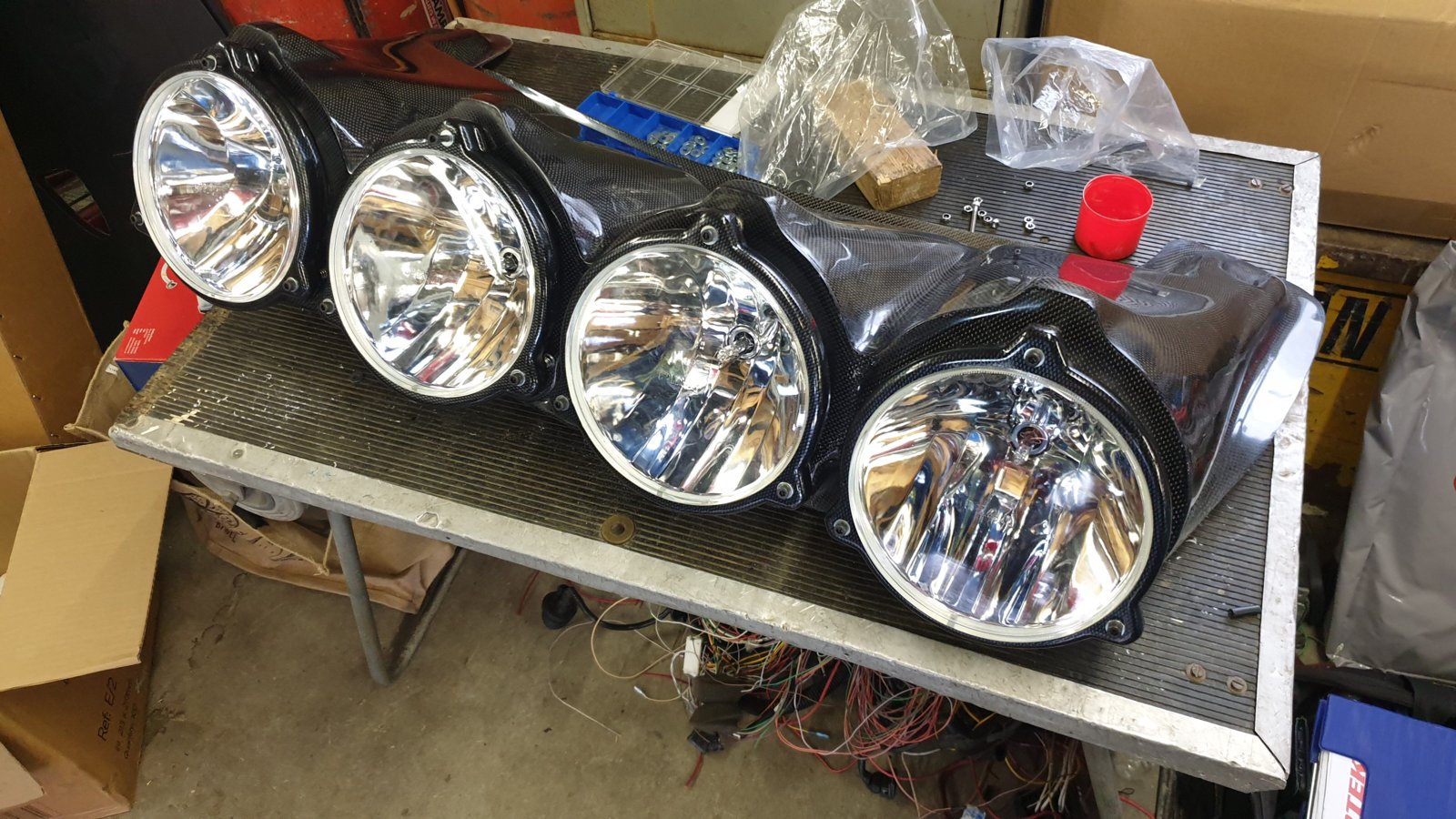

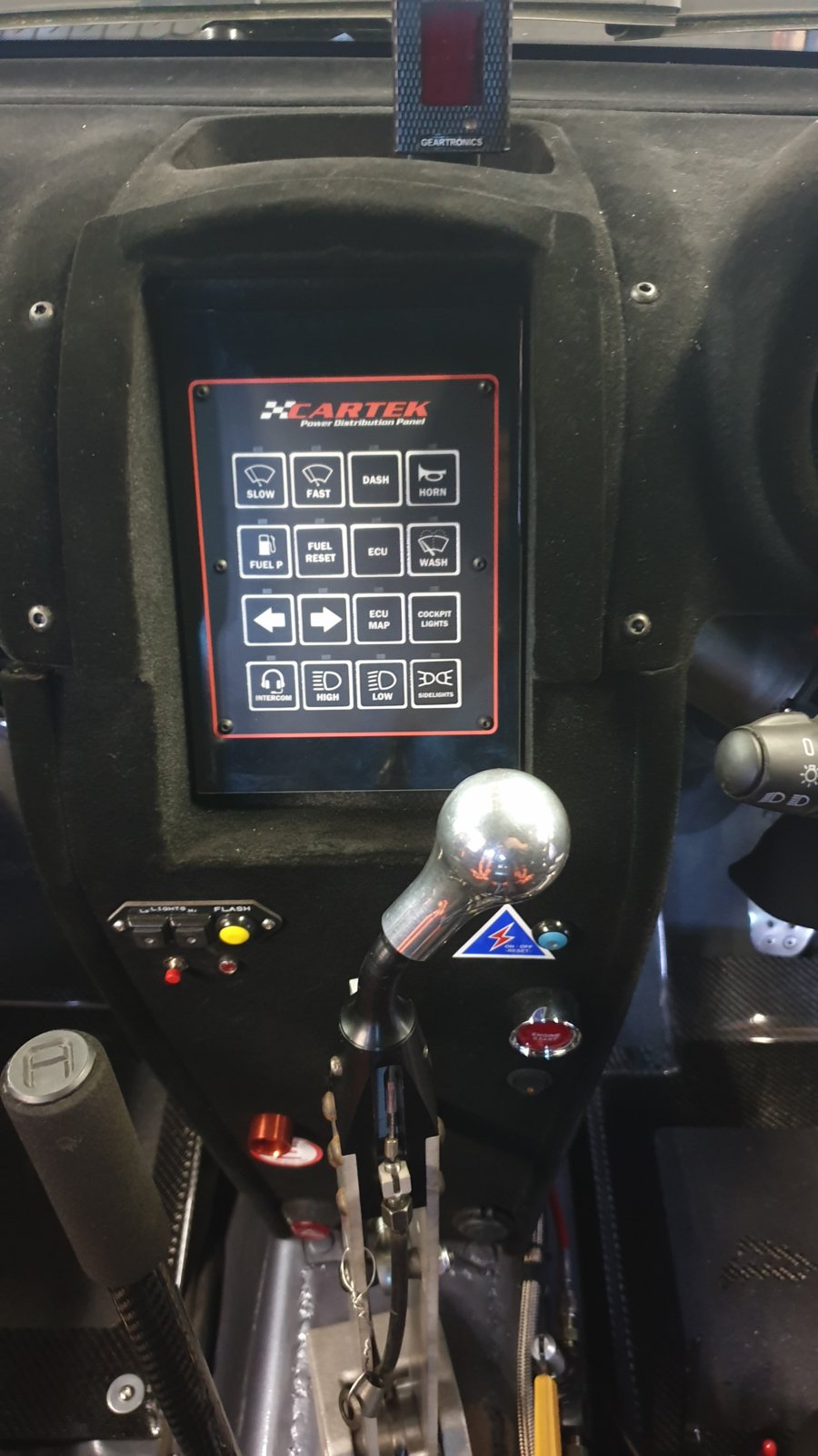

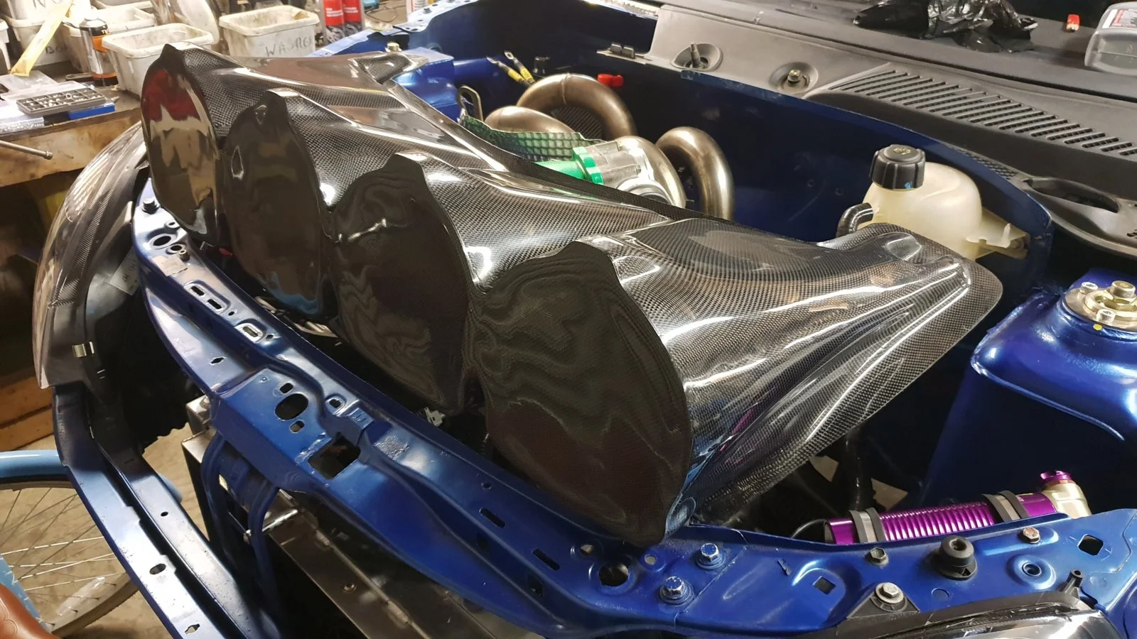

Well, that has taken a while! A combination of work and a few complications stalled progress but the finish line is now in sight. The original idea of a dog box having gone up in smoke lead to a brand new Sadev box and a philosophy to try and incorporate the best of components. We have ended up with a Sadev ST75-14, 3 way Reiger dampers, a Cartek PDM to bin all of the fuses and relays, a Liteblox carbon battery, Ricambi carbon lamp pod with PIAA WRC spot lights etc. There are a number of very quick Clios out on the rally stages so hopefully we can compete.
richard1764
Thought it was time for an update as we are finally coming to the end of the build. I'll get some more pictures up tomorrow as these are a week or two out of date but give an idea of how it's looking. MSA scrutineer coming to log book it on Saturday, all we have left to do is put the navigators seat in, sideskirts, mudflaps and tow straps to fit and paint the bonnet and we are there. Booked in at Efi on the 15th June as he reckons there is a bit more to come from the engine now it's purely a competition car and also map the flatshift.

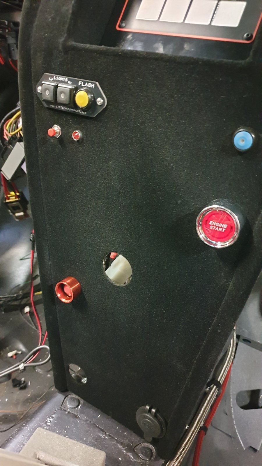

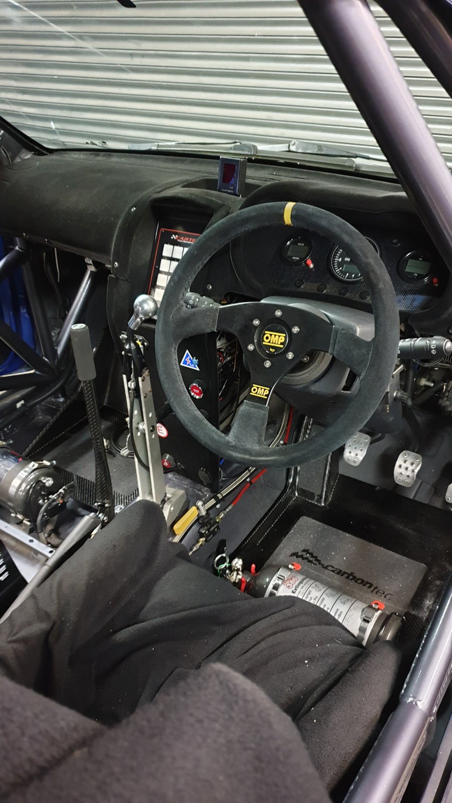

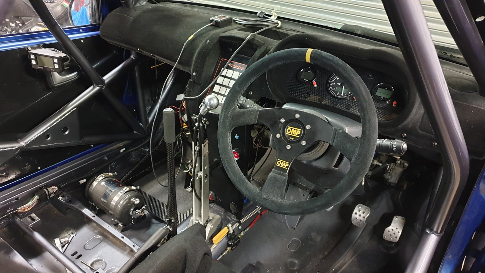

Can you reach the Cartek panel once you're strapped into the seat ?
Yes it's within reach, we still have stalks for wipers and lights so we shouldn't need to be pushing the Cartek buttons that often anyway.

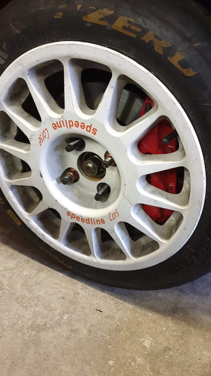

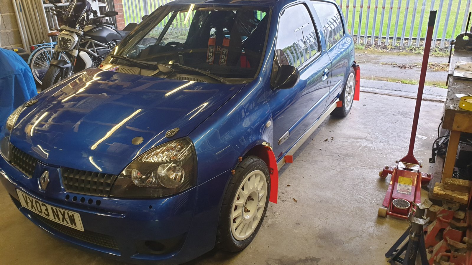

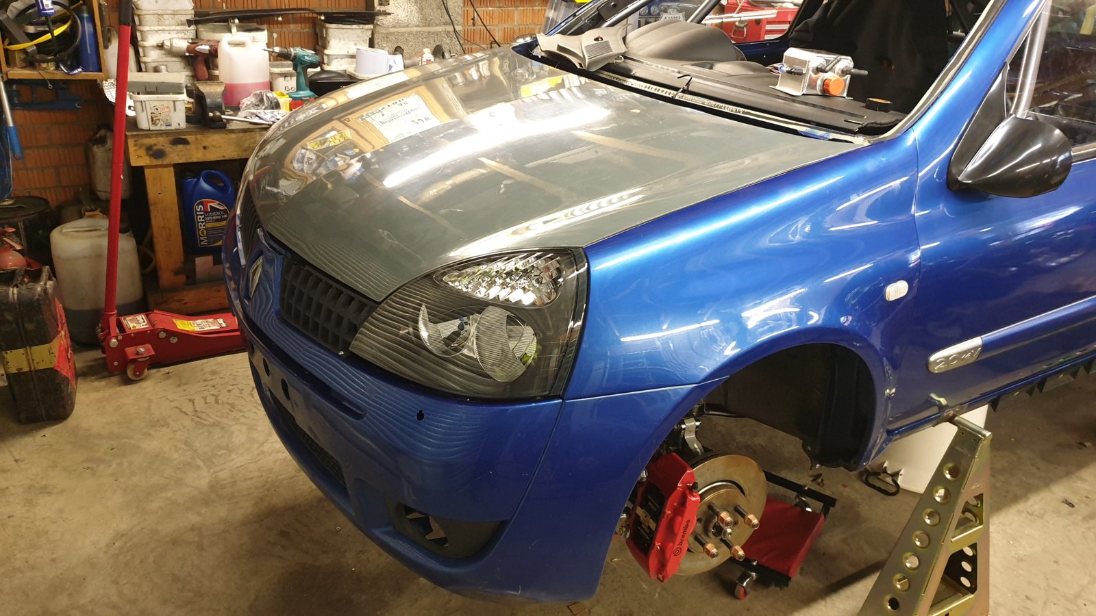

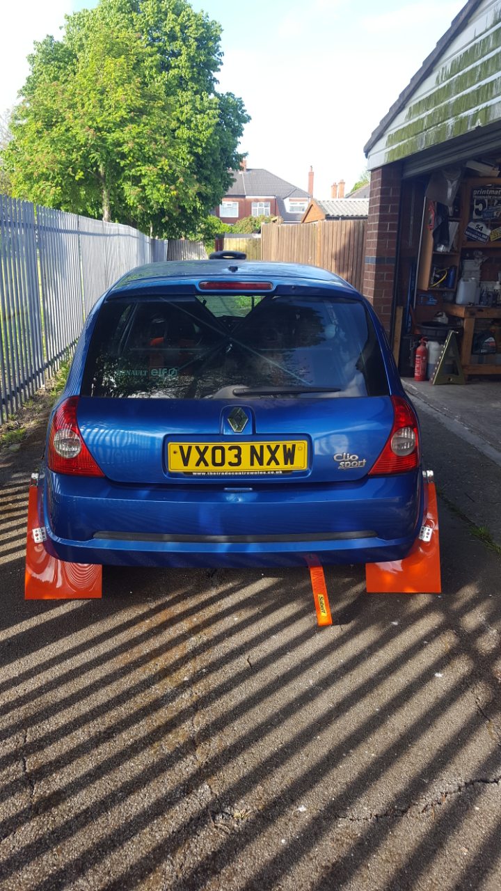

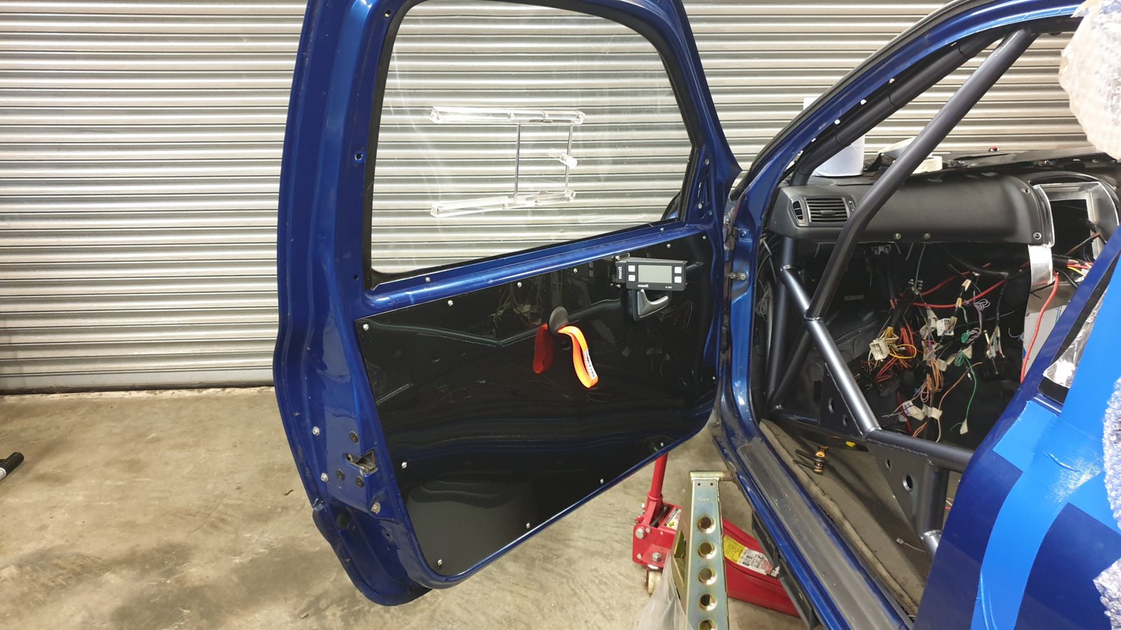

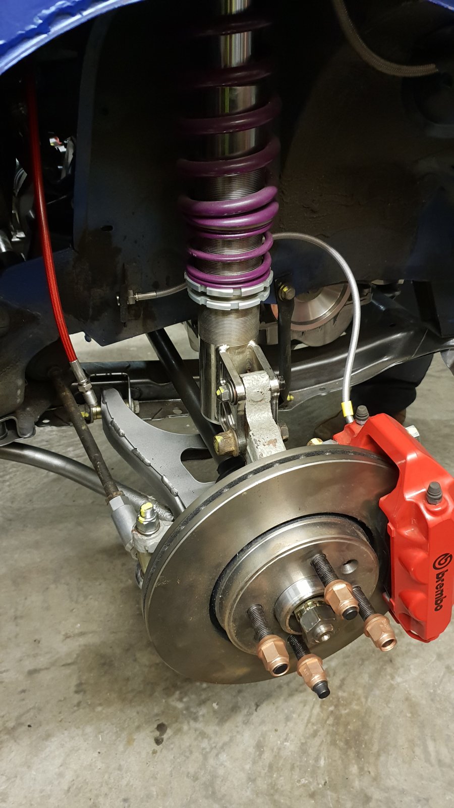

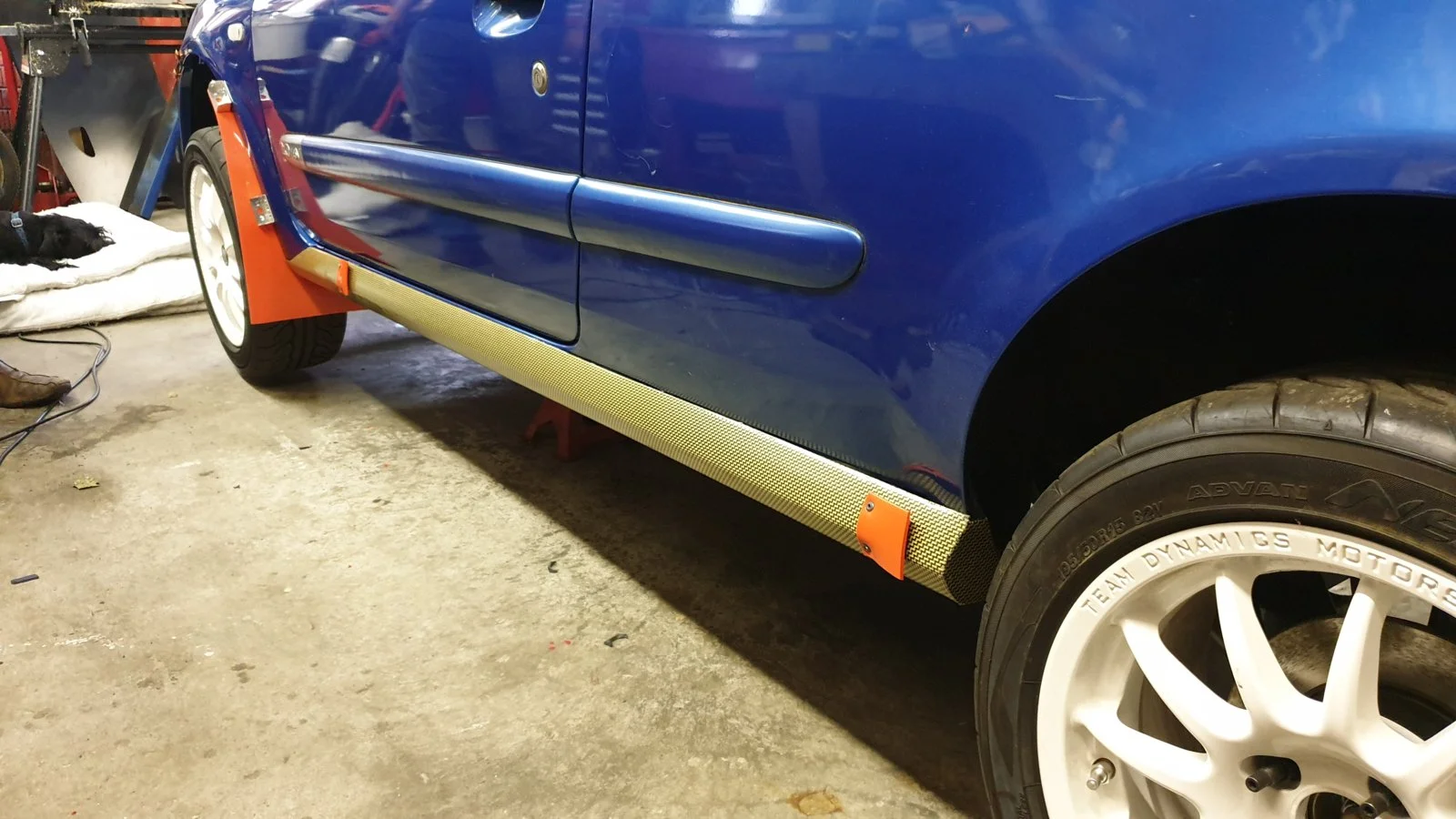

Things all coming together now. Booked in @ Efi on the 15th, Tracktorque for suspension setup on the 19th and trackday booked at Blyton on the 23rd to give it a systems check. Fellow Clio rally pilot kindly lent us a 2118 to check caliper clearance worked so got to order a few of those tomorrow. Got the side skirts on yesterday over the sill stand tubes and fitted the kevlar protection to keep them tidy. Also got the tubular carbon cage protection cut and fitted and the lamp pod mounted on the bonnet. Bonnet and front bumper getting sprayed by the body shop tomorrow and the it's good to go.
richard1764

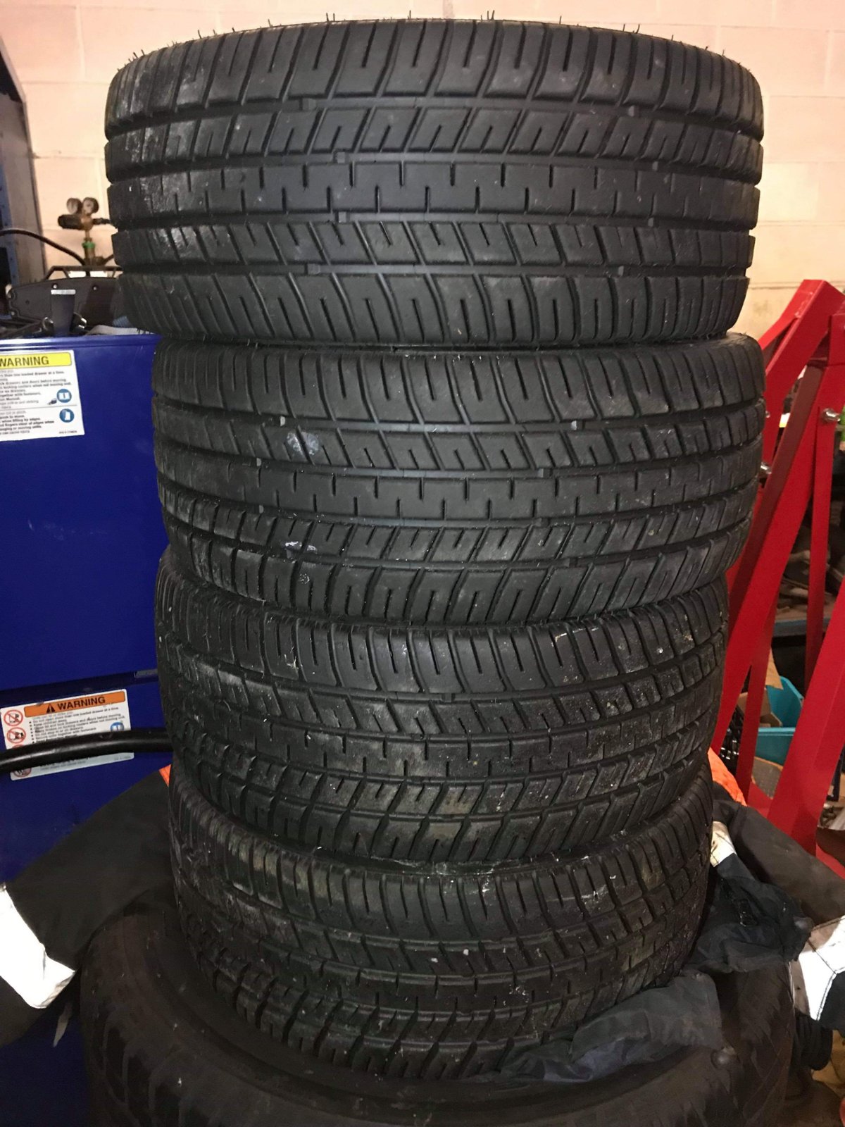

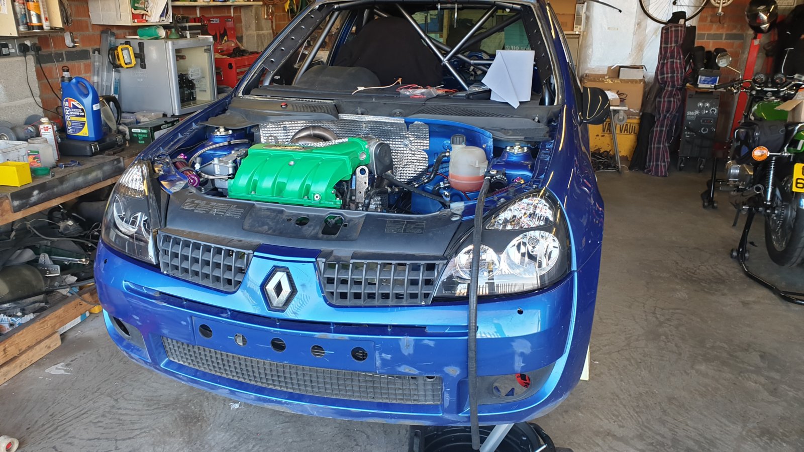

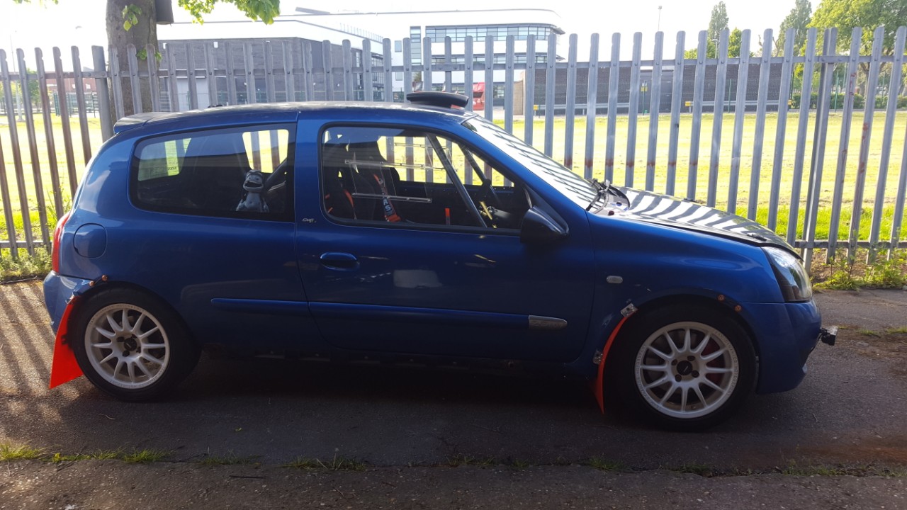

Managed to get some tyres on one set of wheels temporarily so we can take it to Efi on Saturday. Refitted the bonnet and bumpers after a trip to the paint shop and labelled up the Cartek panel. Final inspection performed by Dave ? and he said he was happy ?
