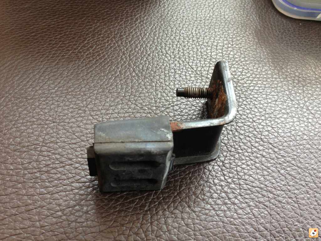

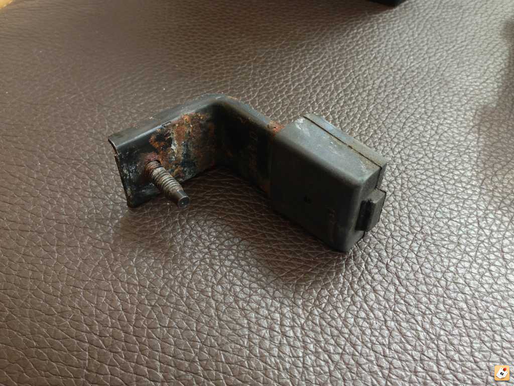

I have got two sat here doing nothing.
  Cup In bits
Neither of my cups have a radiator fixing like those pictured, both mine have an 'L' shaped bracket with an M6 stud on one end and rubber grommet in the other that slips over the moulded plastic pins at either side of the radiator and a 10mm nut secures it to the slam panel via the stud.
no pics sorry
See, that makes more sense to me.

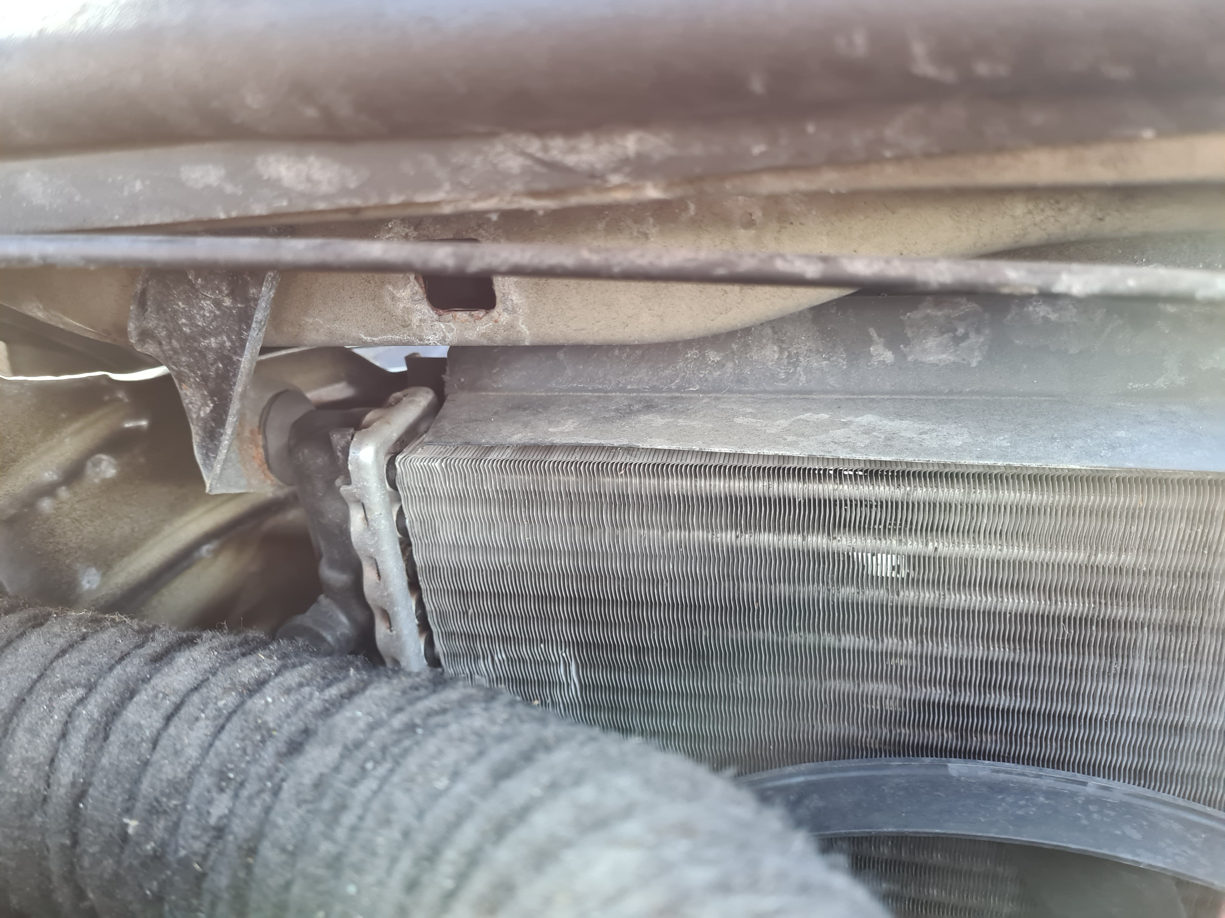

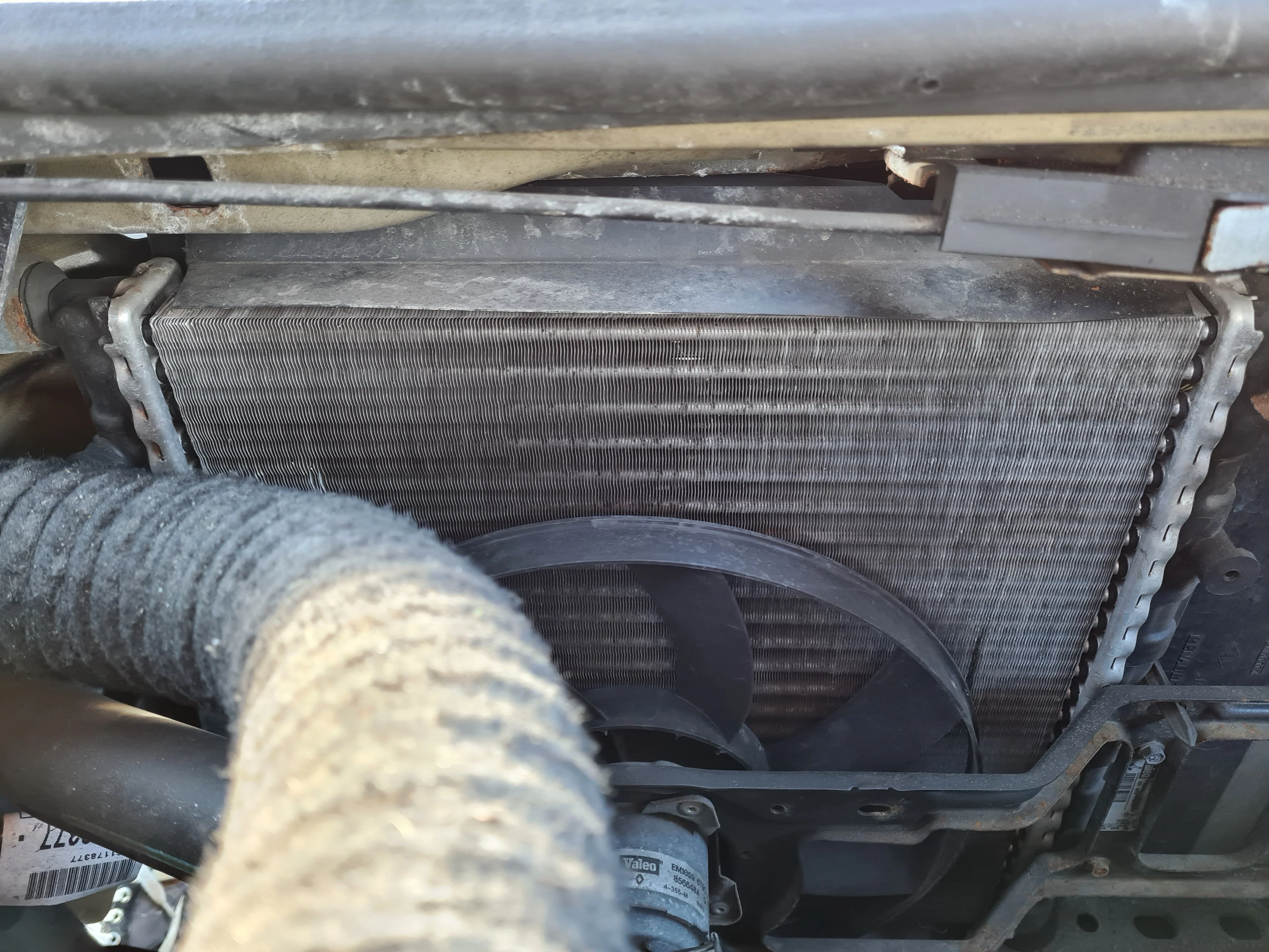

Just checked a neighbours petrol non sport mk2 and that looked like this:
