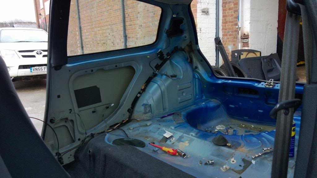

Anyway I thought I would post some pics of my first day of tinkering...

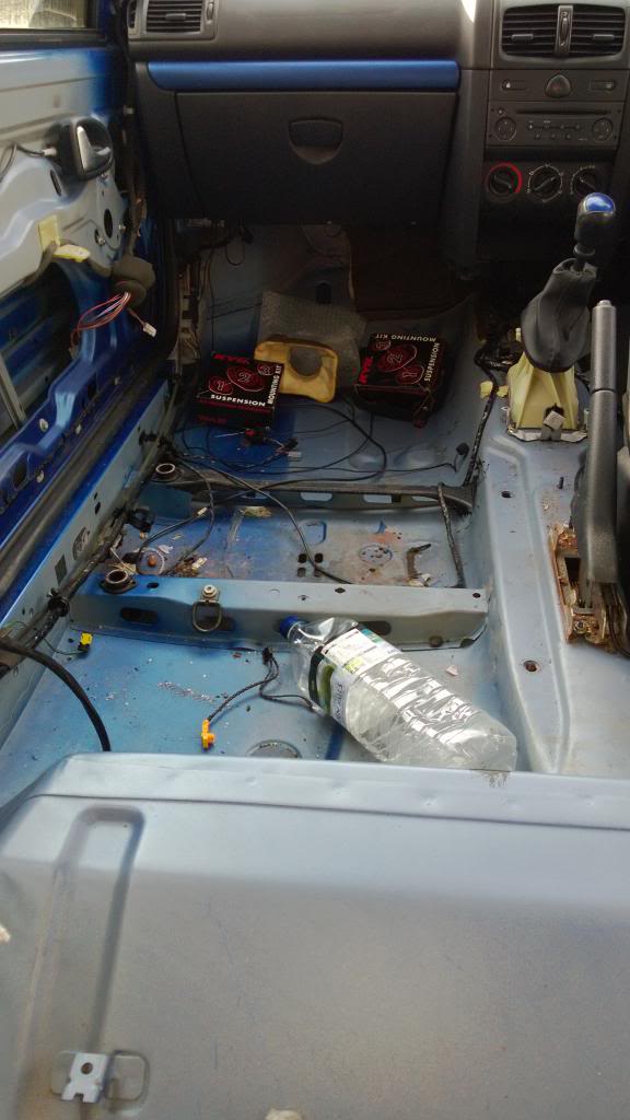

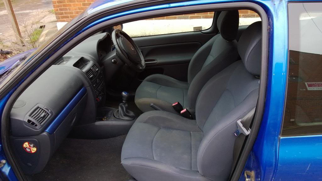

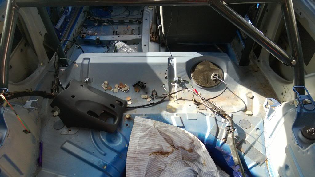

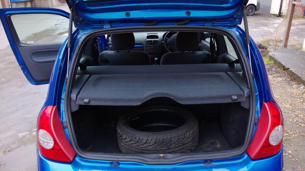

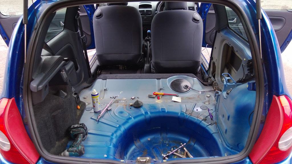

Full Trim...
After an hours of spannering...
Another hour...

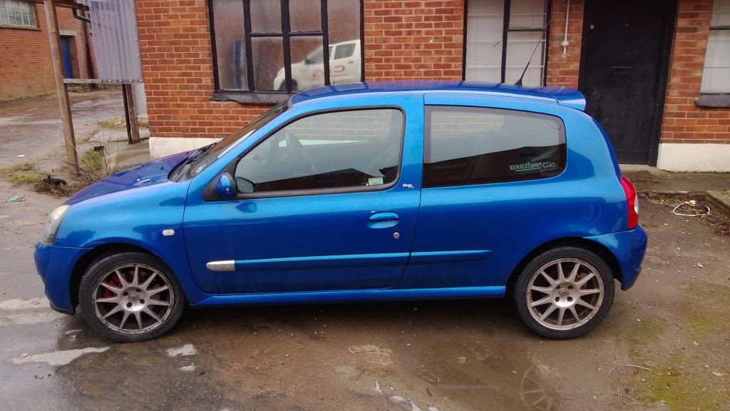

Had to get one shiny bit on...

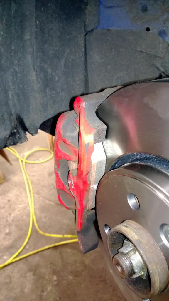

Brakes - Maxtorq Group N Fronts, CL RC6 Fronts, Brembo OE rear discs, Mintex M1144 Rear pads

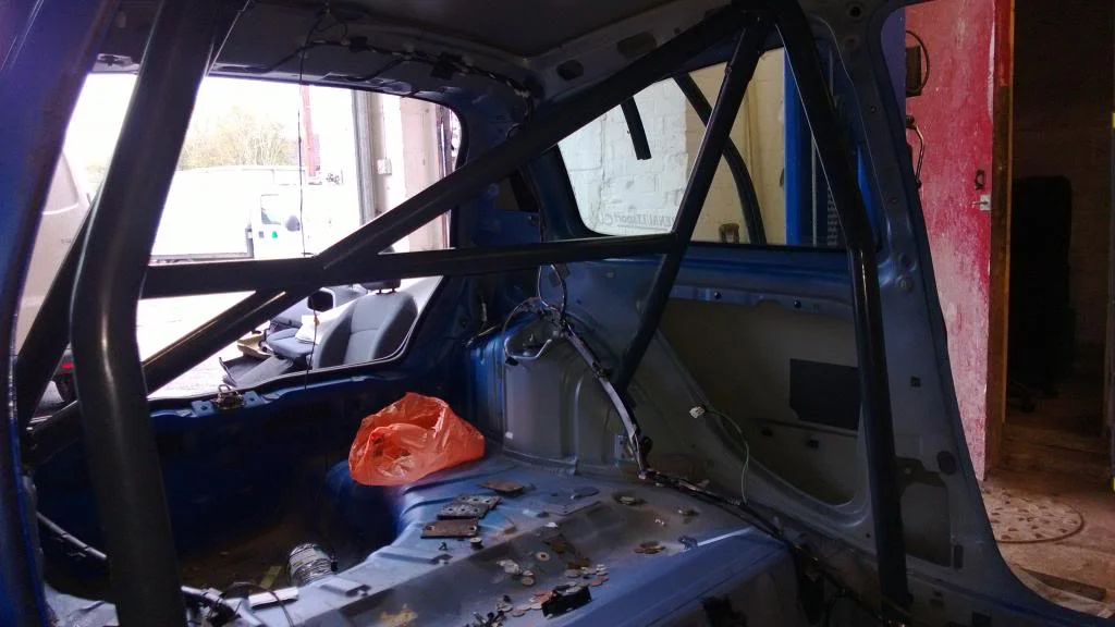

Hi all,
Quick update:

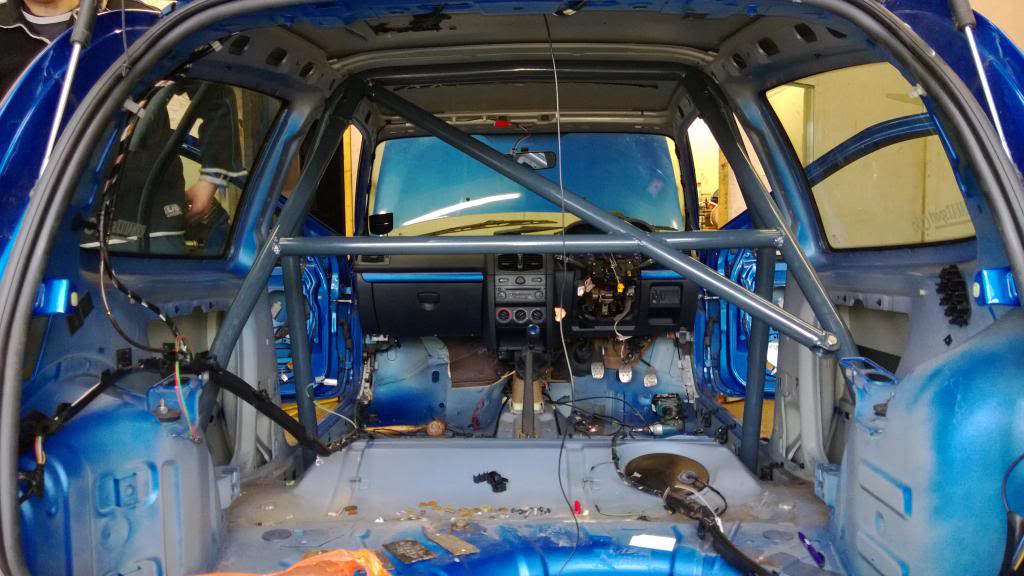

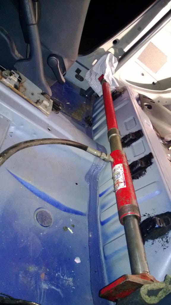

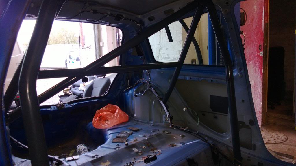

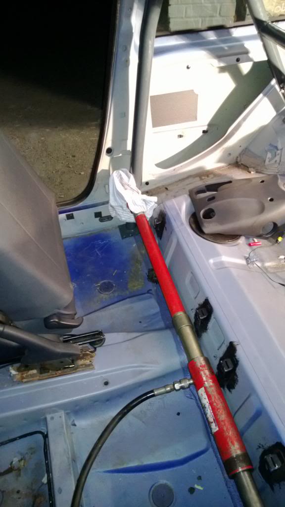

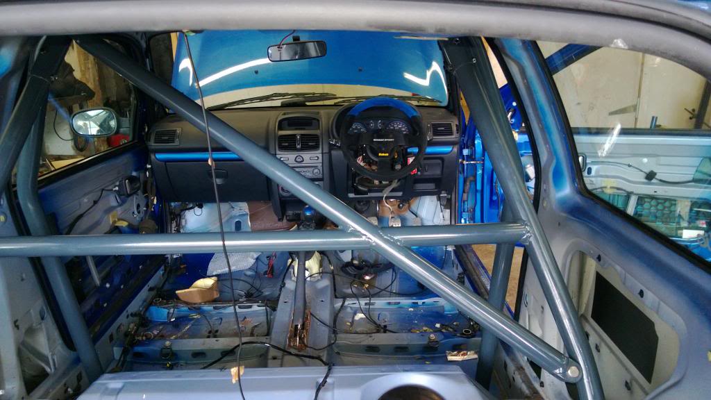

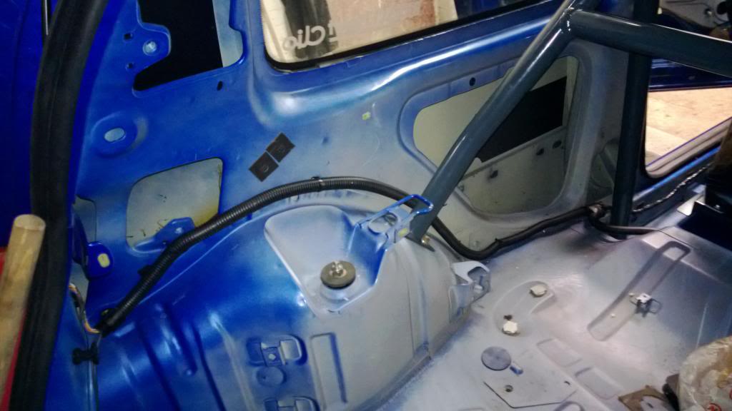

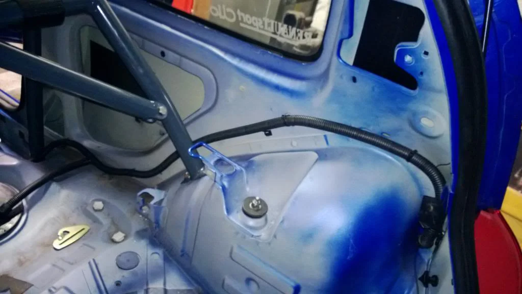

Roll Cage being fettled into position...
Before tidying...
After...

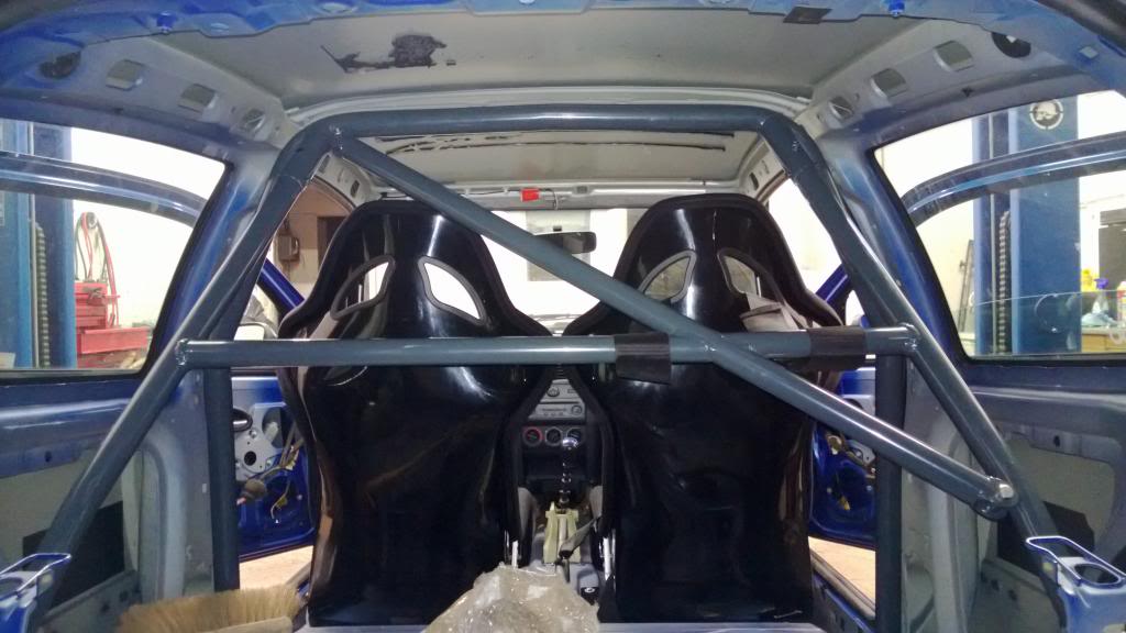

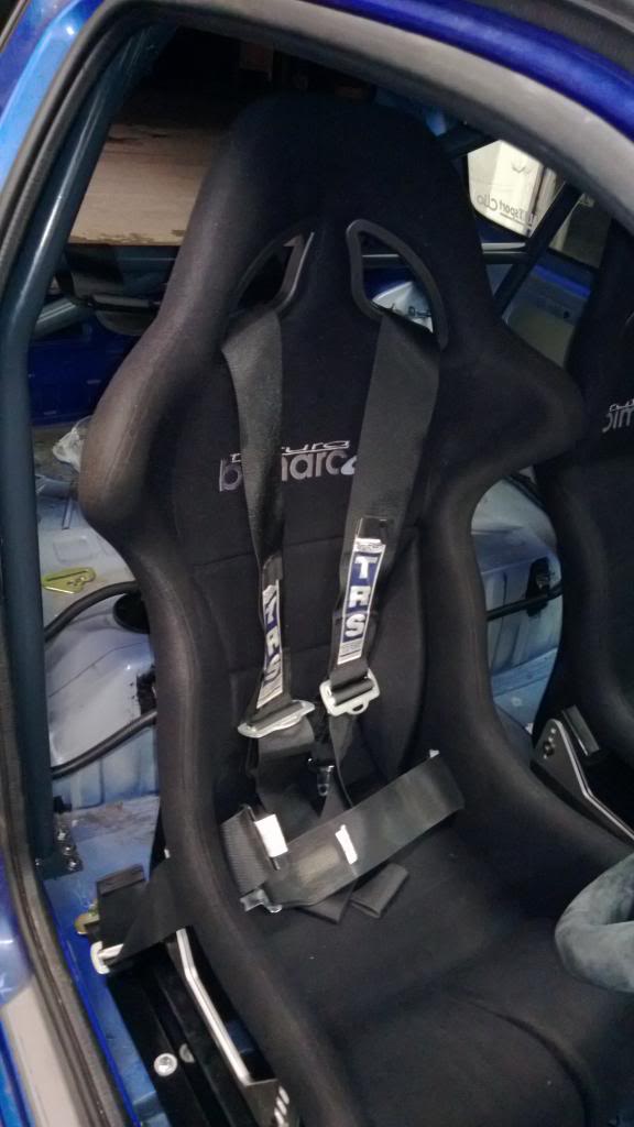

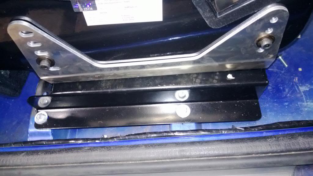

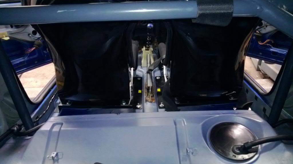

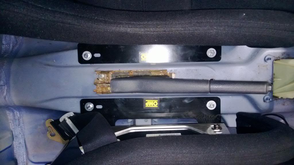

Seats, Altho the passenger side looks a tad wonkey for some reason?!!...
OMP Lower brackets...
Harness in position but not mounted yet...
The OMP subframes lean in towards the transmission tunnel slightly ( I have the same frames). I used some metal spacers (washers) on that side to level it out a bit.
Seems a bit odd tho doesn't it. You would of thought that a company like OMP having designed a specific product for a specific vehicle it would of been spot on!! Unless the cup is slightly different, probably unlikely tho!!

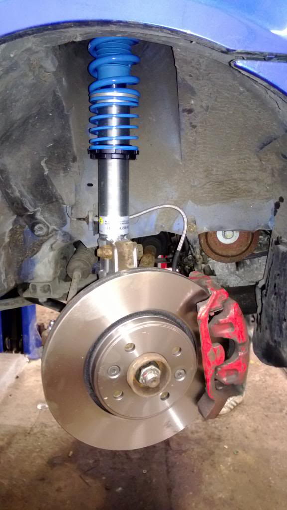

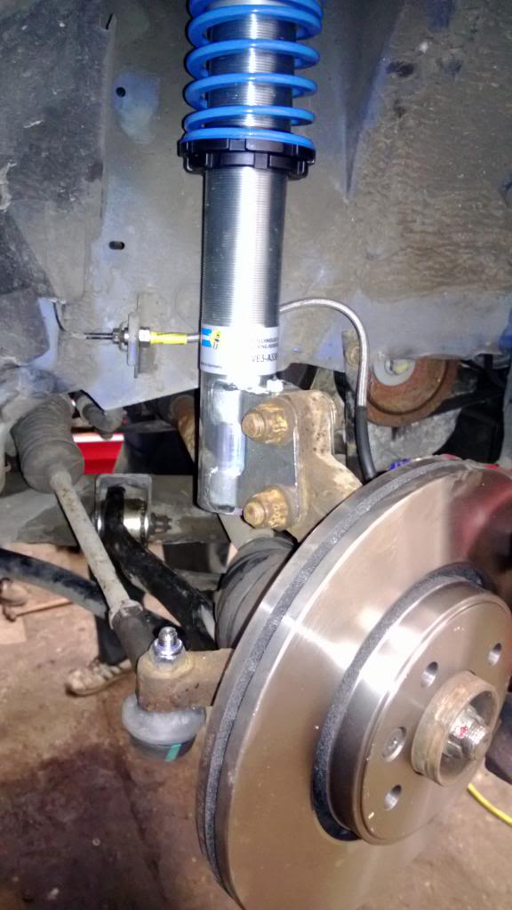

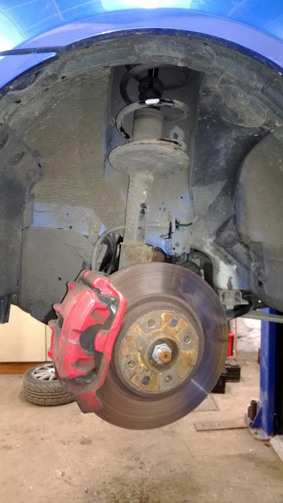

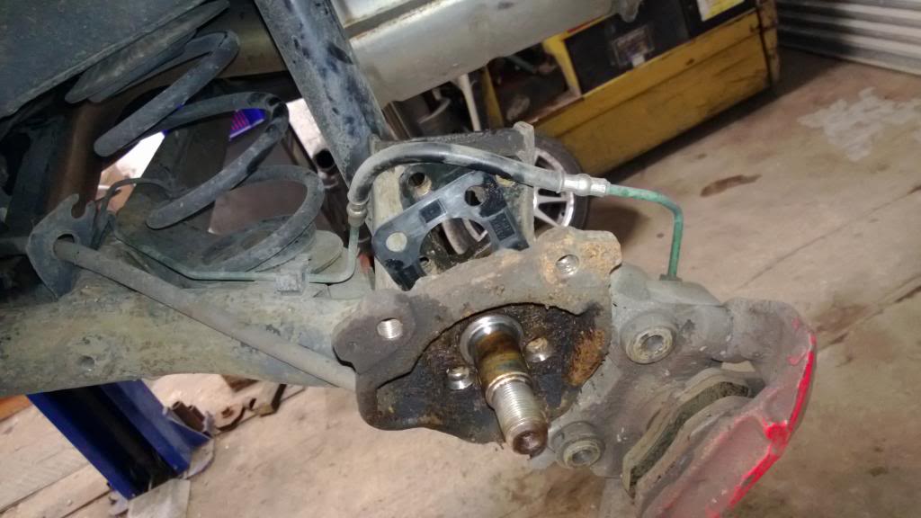

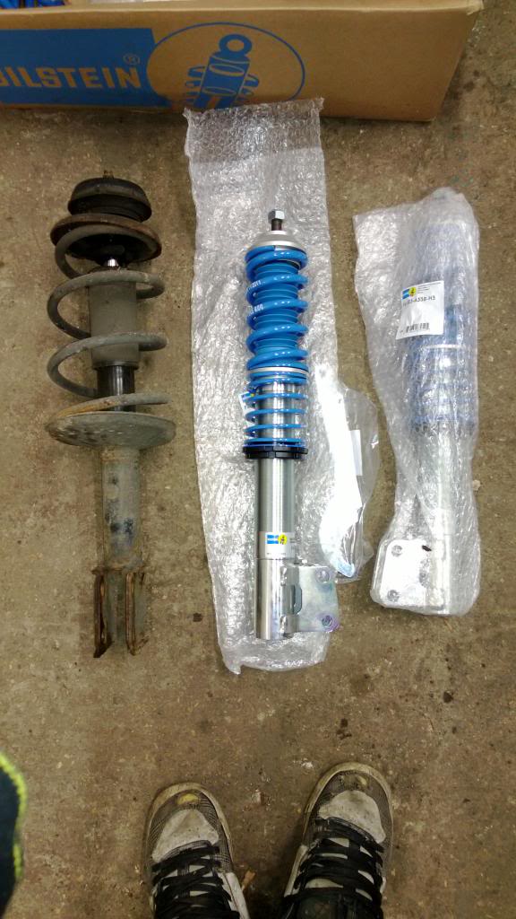

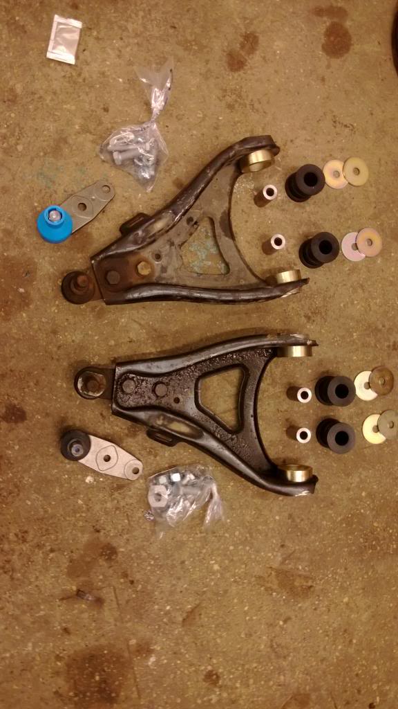

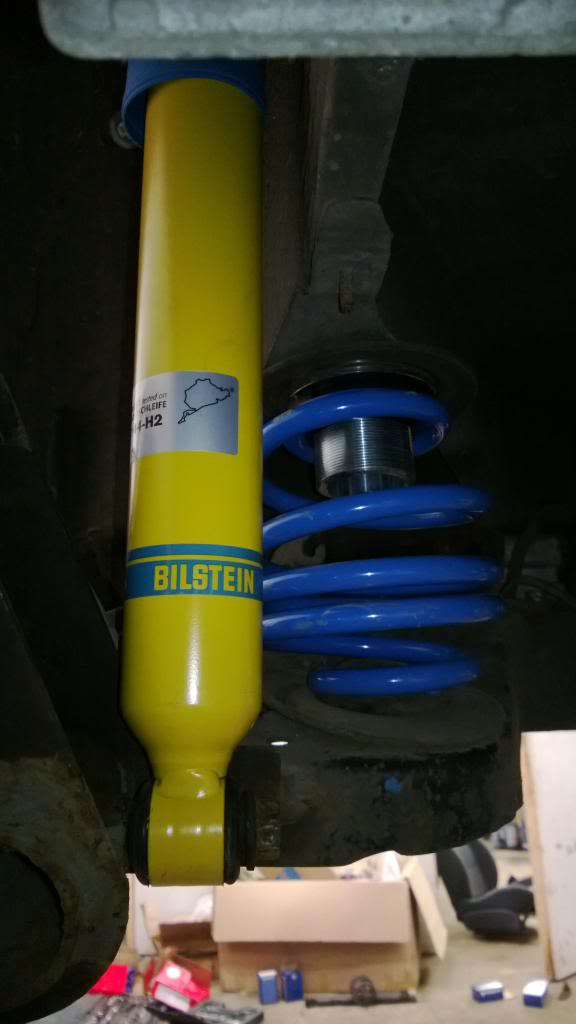

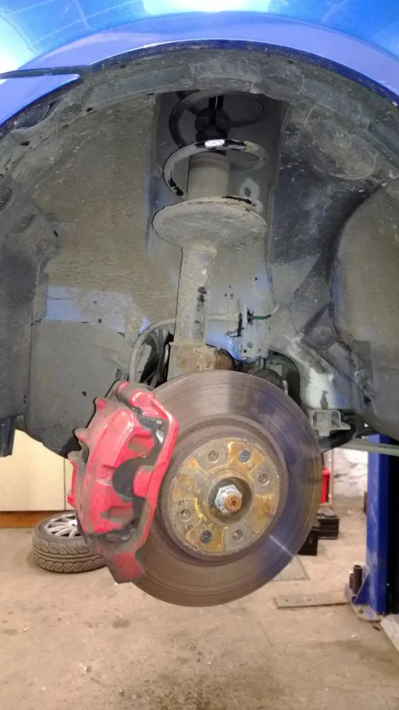

Front struts before....
off with the old ready for shiny shiny!!!

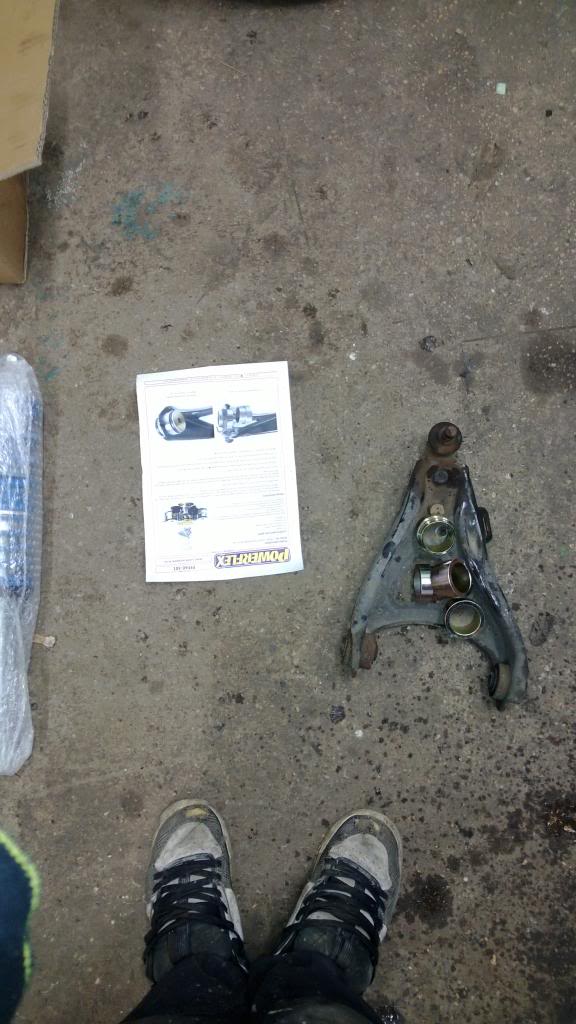

Arms off ready for new bushes...
ready to be built up n fitted, spot the deliberate mistake...

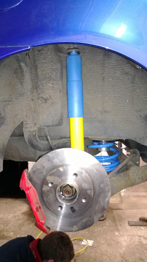

rear camber shims 0.5's
rear nearly complete...
Fronts done...
CL RC 6's noisy as hell but very effective!!!...

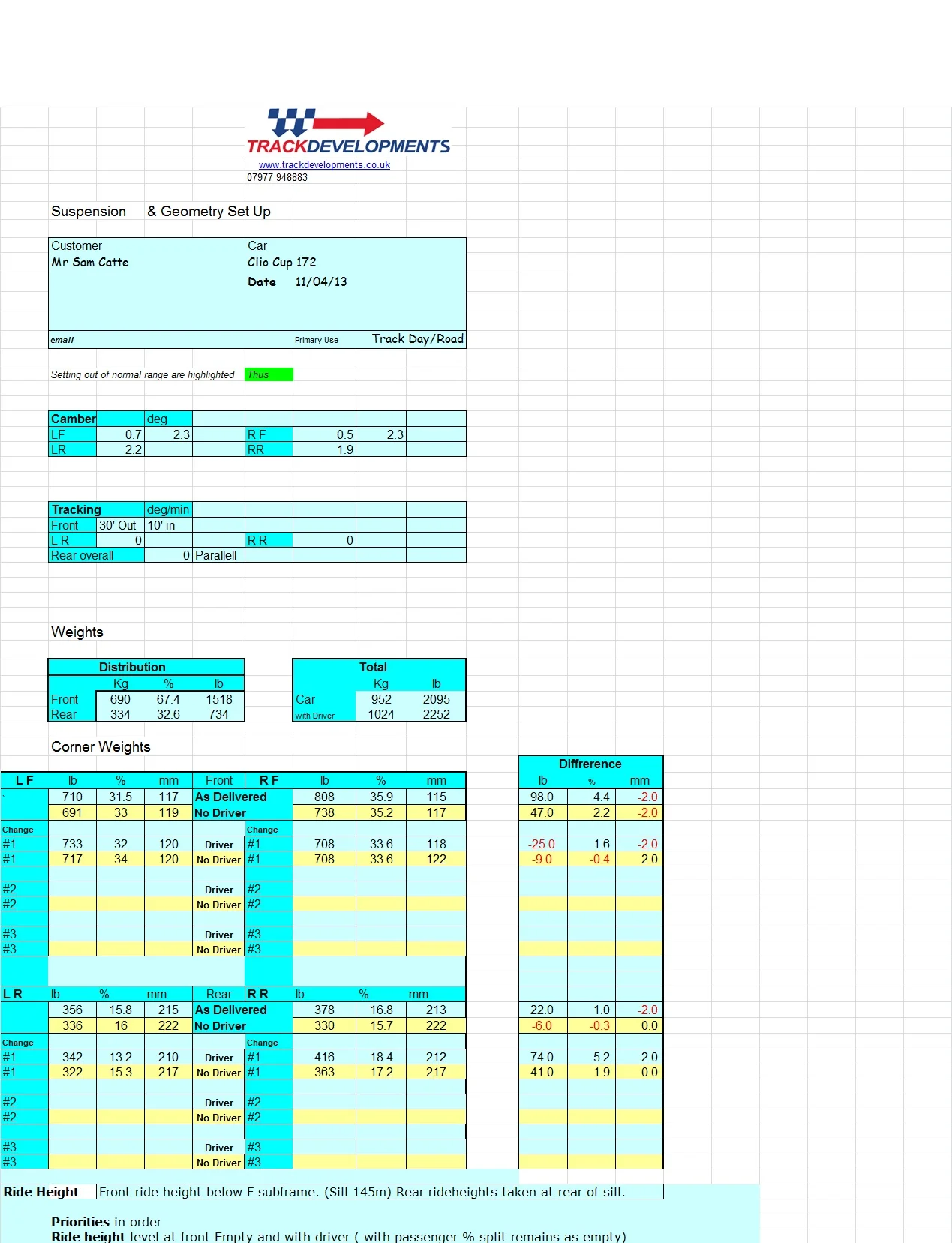

Yep, definitely a no nonsense build. I have literally fitted everything that I deem essential for tracking it. Then just build and tweak as bits arise from here on. Since I had the geo setup at Track Developments it is certainly a different kettle of fish, its probably the single biggest improvement in terms of performance so far! Dave gave me a few pointers with regards to roll centres on the front arms which will have to be addressed at some point, he certainly knows his onions.Clio Setup.webp Can't fault the yokies on the road, same as the B14's really, altho the Bilsteins may be a tad soft for out and out track use. The only thing I do have an issue with with the suspension is the rear ride height, I've got it on the lowest setting but could still do with another inch (couldn't we all!!) I'm heading to Castle Combe on the 24th for the first official outing, so should have a better idea how it all comes together as a track package then. Hopefully the yokies will last for more than one track day!! :D
