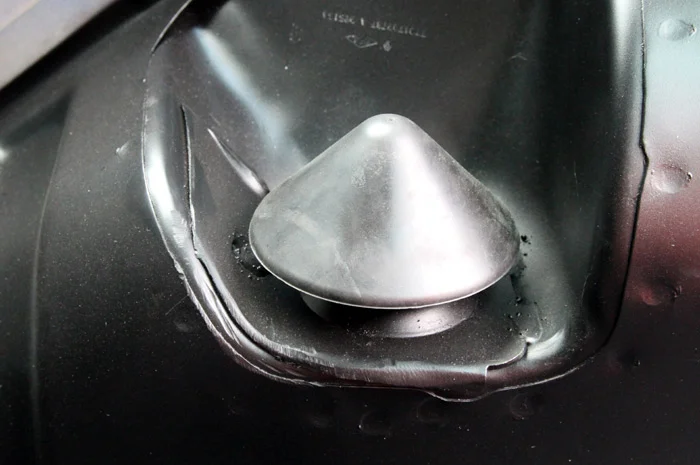

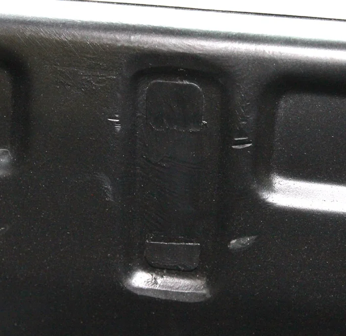

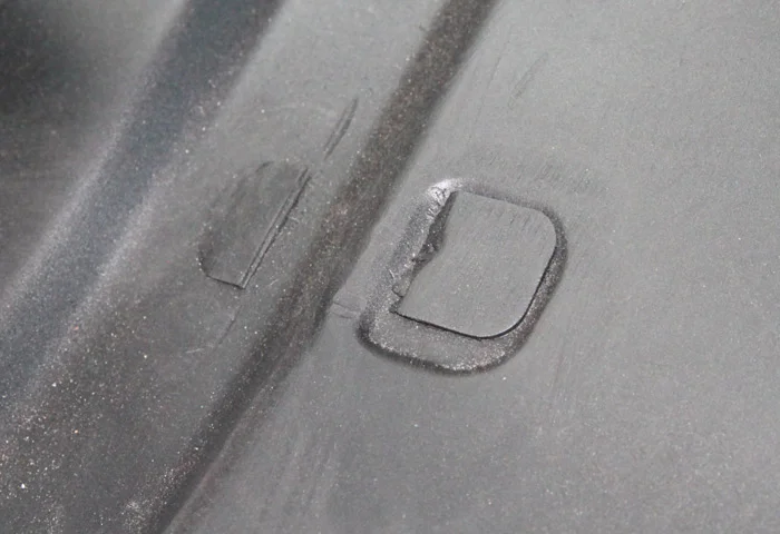

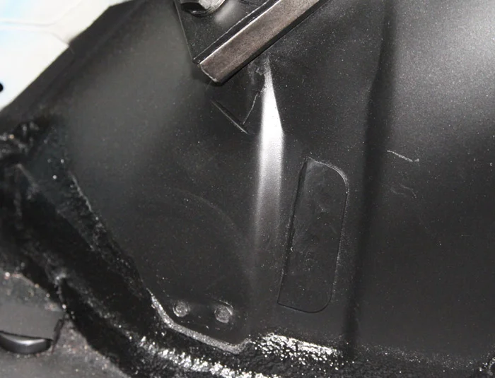

I'm gutting the interior out of mine today and want to try to remove any brackets and smooth them over before I spray all the interior matt black :)
Here you go.
Top one on arch:
Bottom one on arch:
And the ones that the rear seat pan mount to.
'Vertical' (just behind the front seats, 4 of them from memory):
'Horizontal' (on the flat bit where the rear seat pan goes):
You can work out pretty clearly where they are tacked on, then just cut around with the grinder and bend/flex until it snaps, then tidy up with flapping disc. I didn't bother removing the bits that are left over (clearly, duh!) as it's tidy enough for me, but with time/patience you could do it.

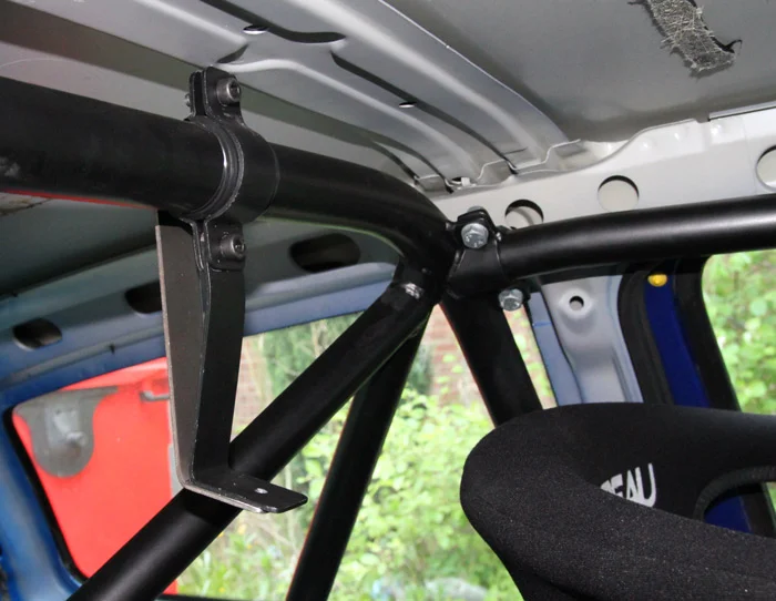

And another quick pic cos I forgot to get one after I'd made it... Pretty solid, but still need to spray up that extra 'brace' and possibly beef up the bottom bend as it has a habit of oscillating and making the footage a bit shaky on bumpy stuff.

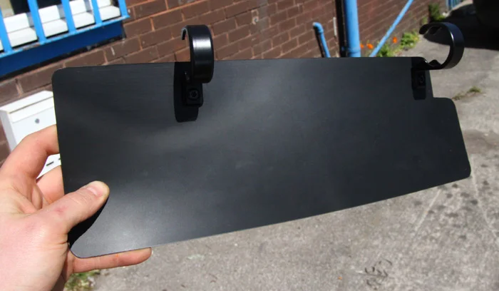

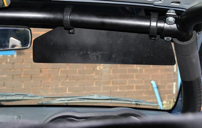

Clip on sun visor for my roll cage. Can make 2 for under a fiver!
I've put a thread in the Guides section which should hopefully be approved soon...
love the work tartyboy making your own stuff is brilliant the visors is something i never got round to in my old hybrid :(
Thanking you! More to come I'm sure... haha.

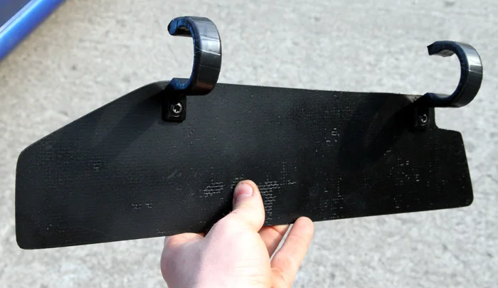

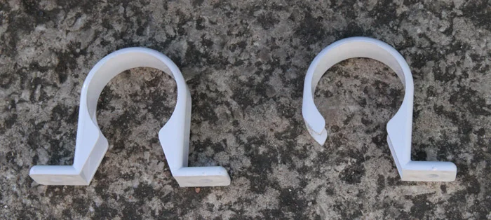

Actually made some new visors yesterday, a lot easier and neater this time. The B&Q '32mm pipe clips' are actually 35mm and this is the perfect size to clip on without any sort of 'shim' (cage is 38mm).
The main sheet is 1mm HDPE this time, much neater. They are about 1" deeper too which seems to be a better size, much better coverage!

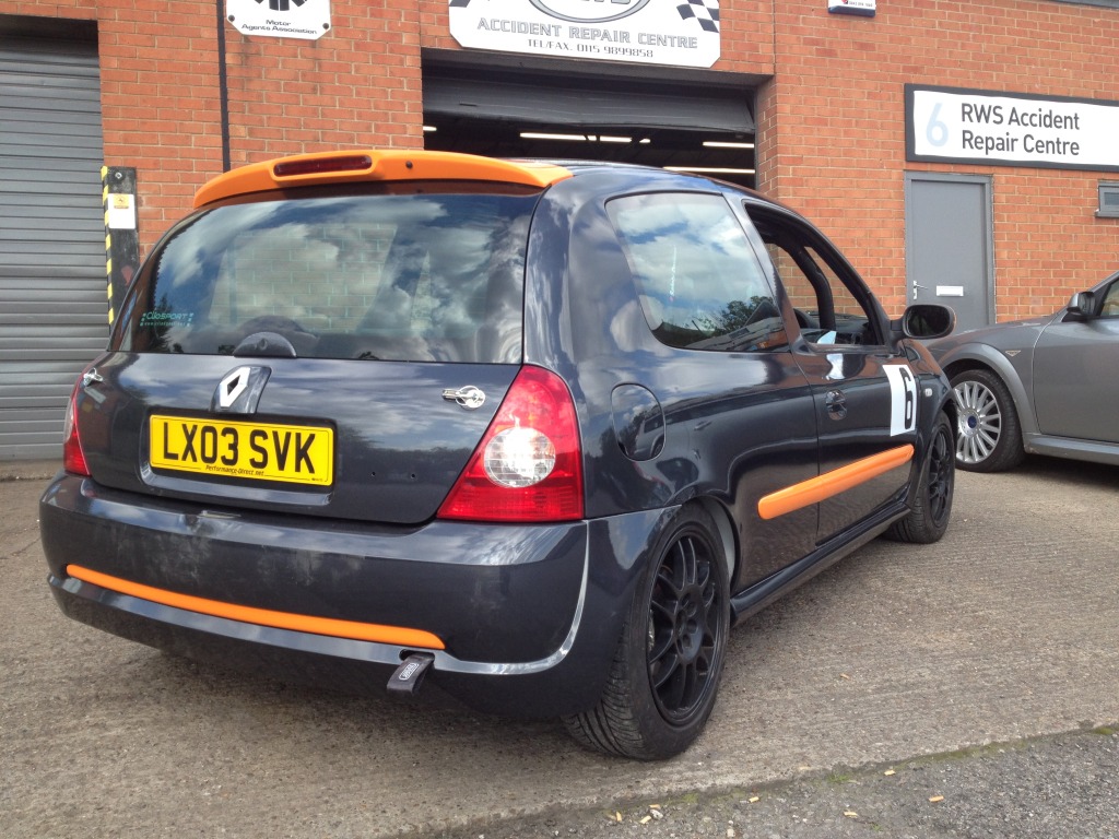

Hope you don’t mind Adam, but thought as I have now bought your car, I would carry on the thread where you left off.
Major news on the car is we have had a few electrical problems. Started out of the blue one day with the management light coming on! Tried new pedal, new TB etc etc. Booked it in to Diamond Motors, but in the mean time, did some checks as recommended by Mick at DM and managed to sort the problem!!!
Anyway, the car has now had quite a bit of work done to it, which I will bring you up to date on after the first trackday which is booked for the 26/7 at Donnington.
Here is a pic of the car as it is now as a bit of a teaser.

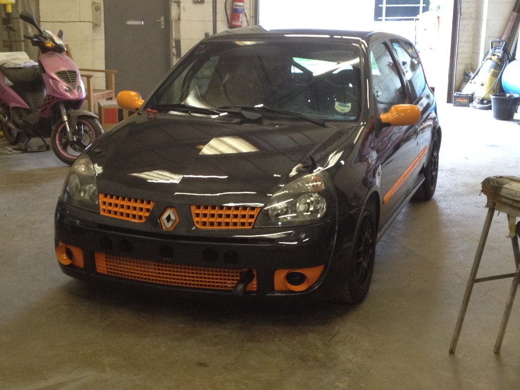

Got a bit giddy last night and booked another track day! 2/7 at Donnington. My friend Stuart has been putting the finishing touches to the car today. All the insides are black now apart from the roof. Stu's mate is making up the vinyls for the tow loops, number boards and my name for the side windows. Shame the tyre sure system isn't working as this would have been really useful. Will probably use the feed from it to power the on board camera recorder instead.
Cant wait to get it going around Donnington, just hope for good weather. Also looking forward to meeting my race engineer on the night. The team is starting to come together. Just hope my driving is up to scratch.
Promise more pictures and an update after Monday night. Will spend the weekend fussing over the last bits and pieces and making sure I have everything to take to the circuit.
All we need now are some sponsors!!! :-)
Looks good from the rear but the center grilles painted orange are too much. Apart from that keep it up :)
