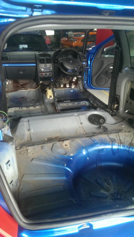

I'm planning on going through it with a fine tooth comb as I'm very fussy and some of the modifications by previous owner are shall I say interesting :poo:

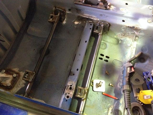

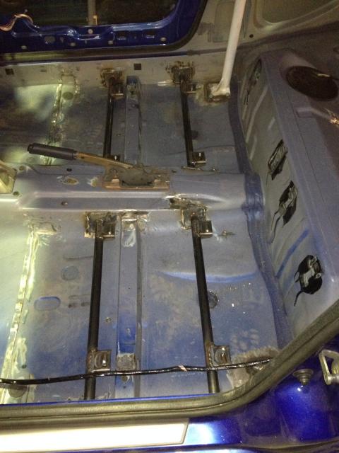

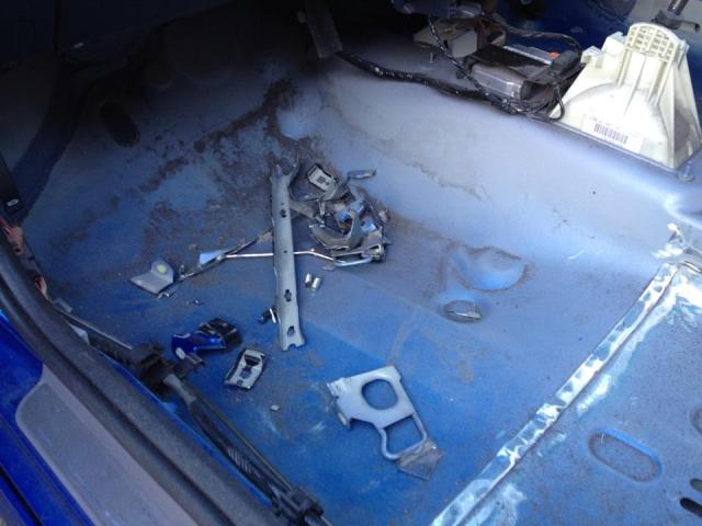

I've already stripped out dodgy seat mounts and cut any unseassery brackets ready for interior to be painted.

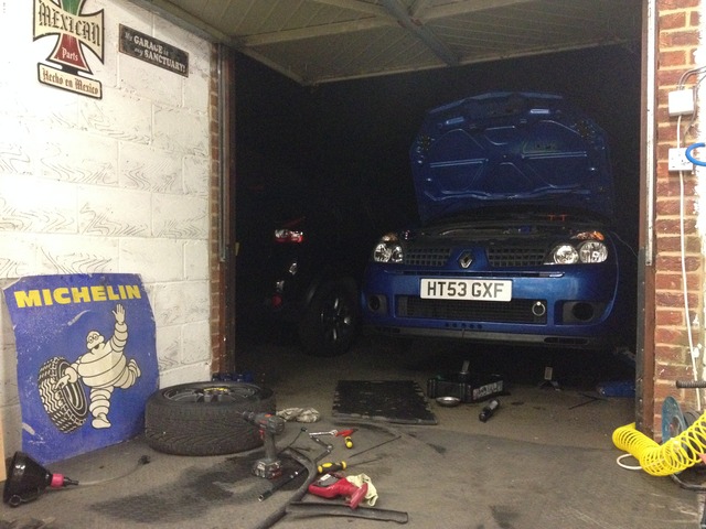

Car is now at my mechanics to have cam belt de phaser and water pump change.
Plus if they get time full brake change.
Then off to the body shop for interior paint
Well clio still at the garage obviously

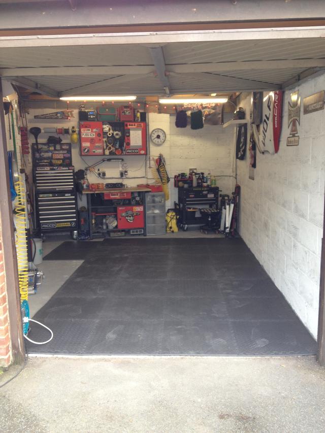

But finally the golf has been collected having the garage empty means if been able to put some new flooring down and give it a good clean.
Plus finally able to update build board and the list is long lol
Still waiting for garage to work on the car as I did drop it off spur of the moment.

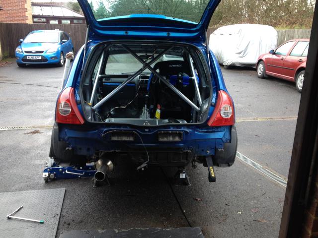

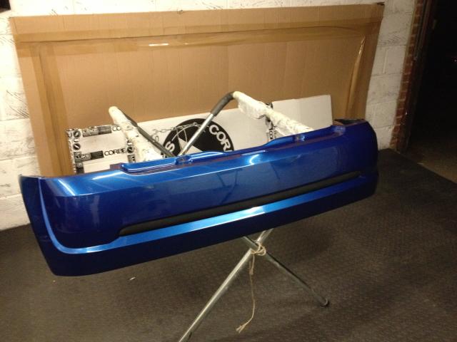

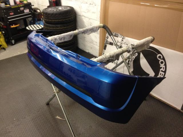

So my ebay "good condition" :poo: Rear bumper arrived to replace the butcherd one currently on the car.
So after a good few hours and a little spit and polish it's respectable enough to fit to the car.

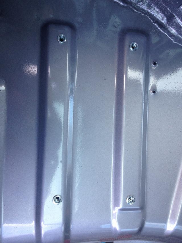

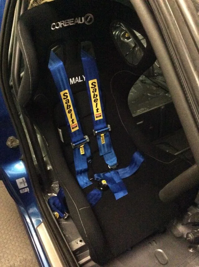

So my paint guy is collecting car for me so finally we can get custom mounts in for the seats and get the interior painted.

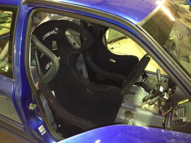

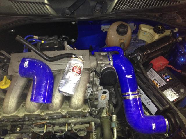

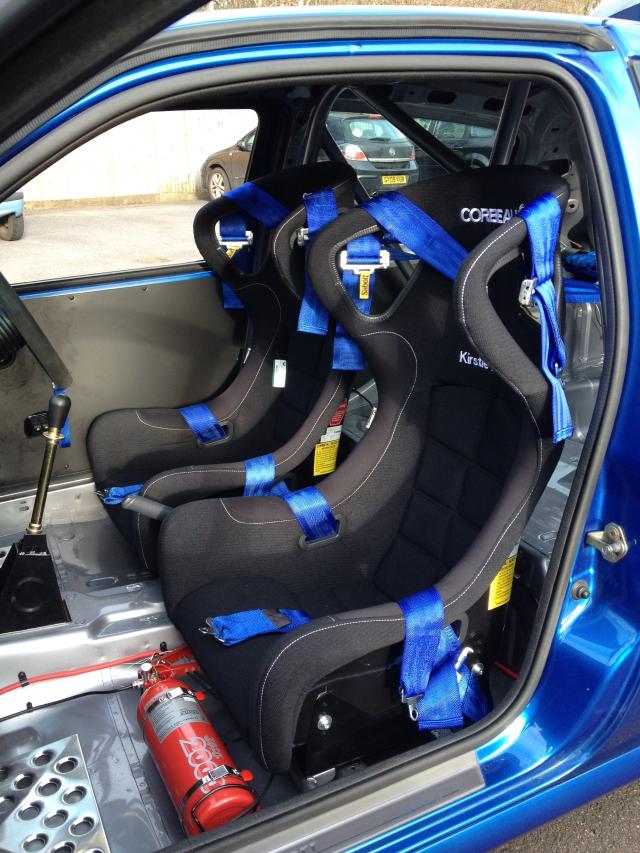

Got rid of previous owners "catch tank" with proper samco hose.

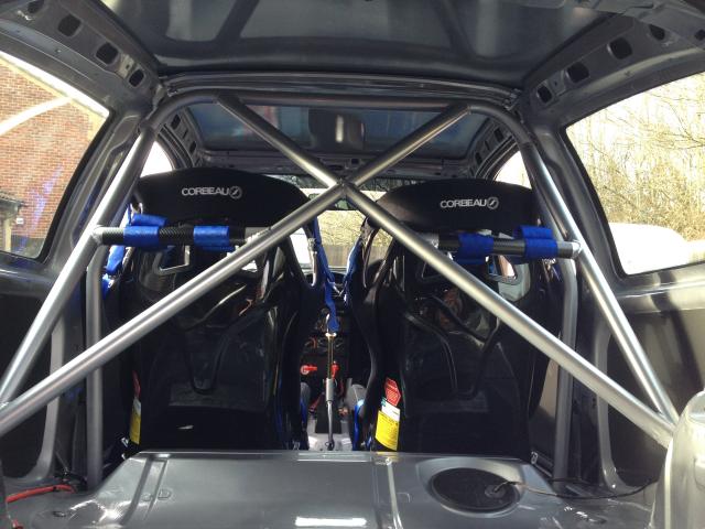

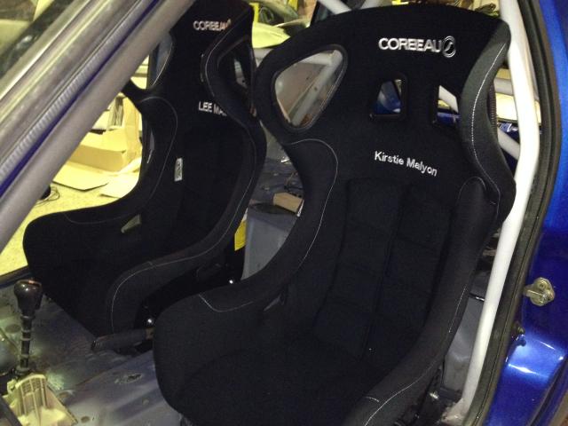

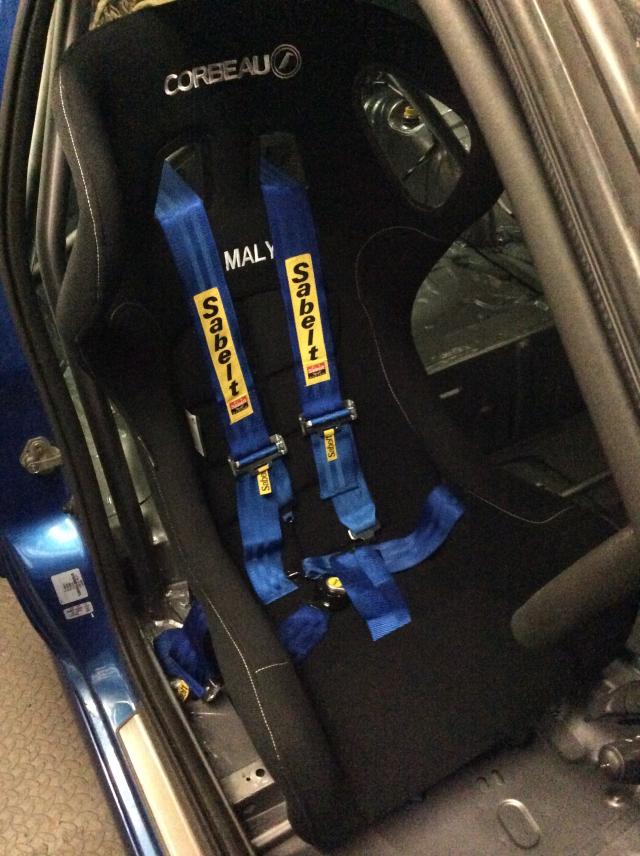

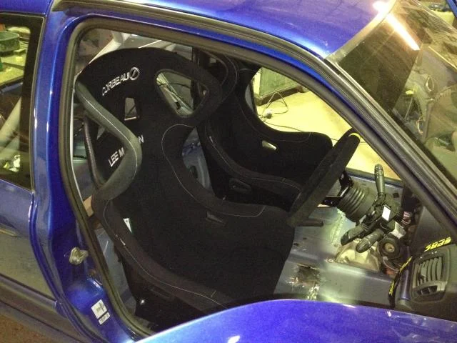

And fitted the seat mounts and putting seat in position I can acctualy fit in the car :smile:
So now it's up to my painter to get the interior painted :smiley:

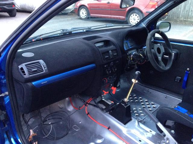

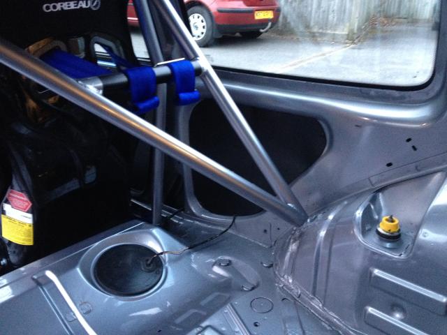

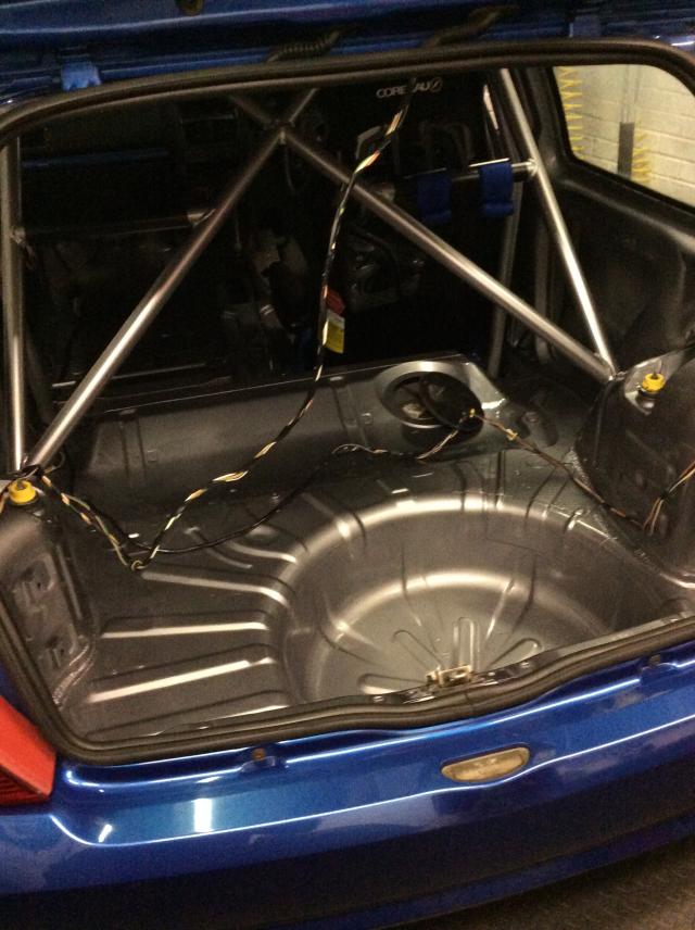

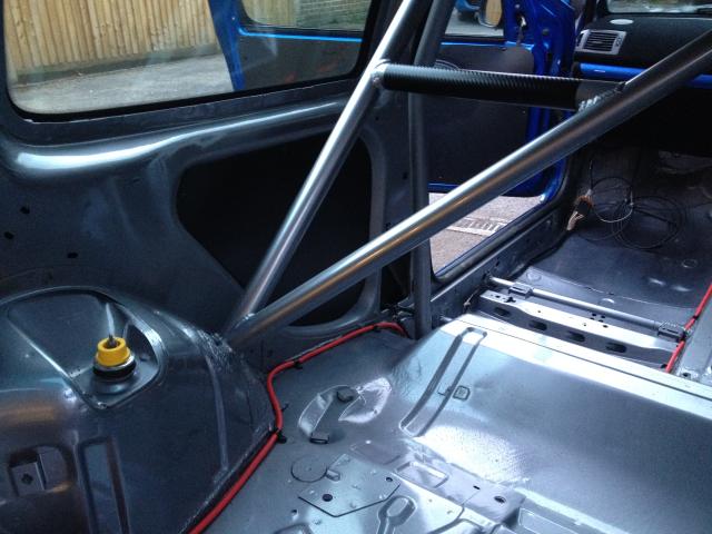

Well a lot has happened. Car back form interior paint looks shell of a lot better glad I can now fit seat perminatly.

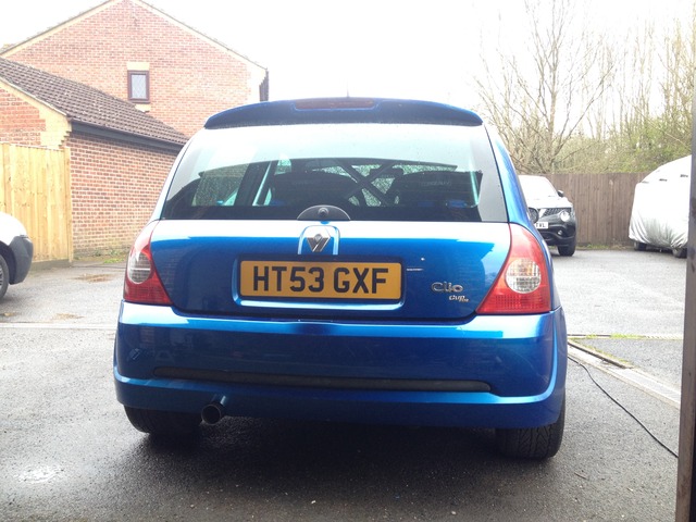

Changed rear bumper over but not got pics of new one on as it was dark at the time.
Rear studs back in after brake change.

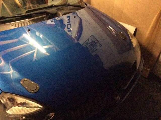

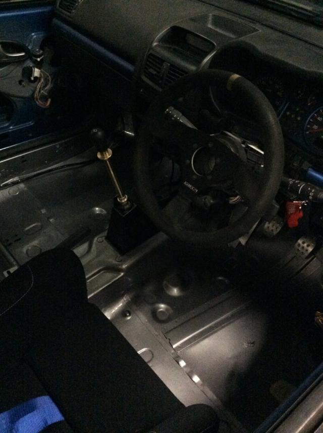

Areo catches installed.

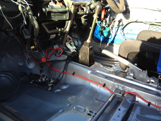

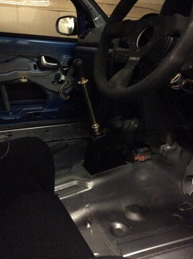

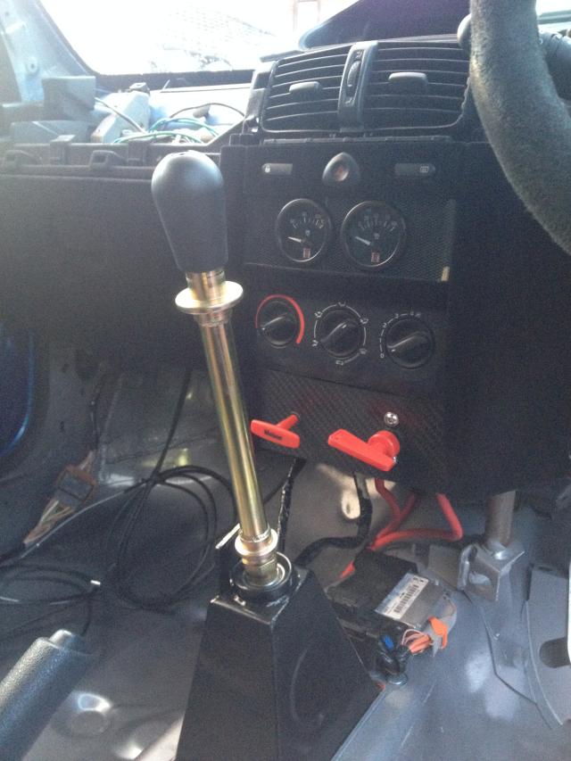

And best of all PMS shifter kit installed and what a great bit of kit.

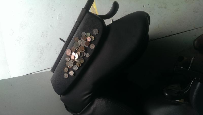

Looks sweet mate, can't beat a stripped out interior. I found over £13 in loose change under the carpets and sound deadening in mine! Any weight saved helps

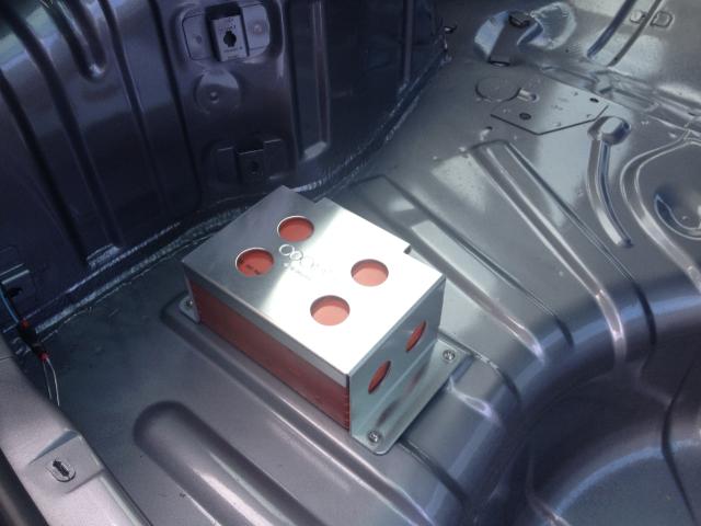

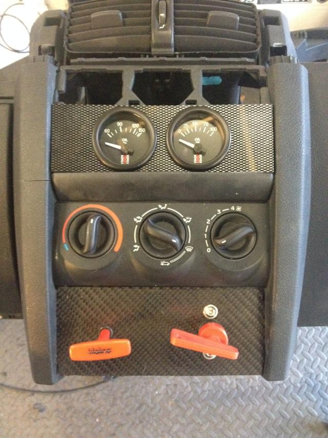

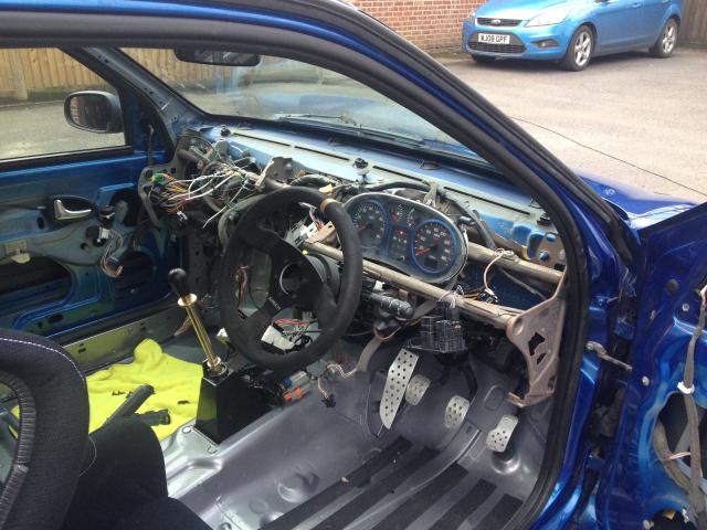

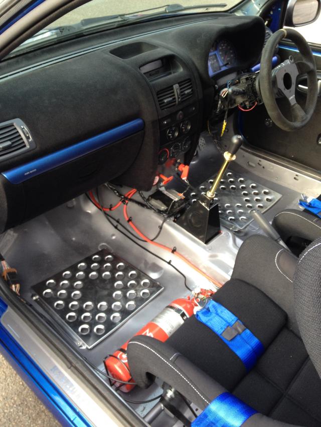

Right been busy I've mounted the new race battery and got the dash mocked up with new gauges and kill switch and fire extinguisher pull.

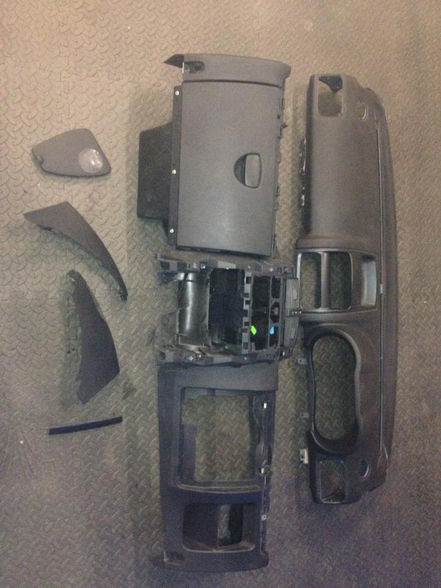

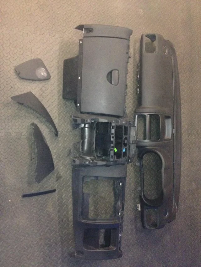

Now it's all stripped down and has been sent off to be flocked.
Sorry forgot to get pic of bonnet pins
  • Like
Reactions: Chi

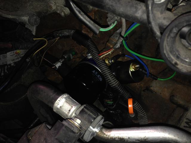

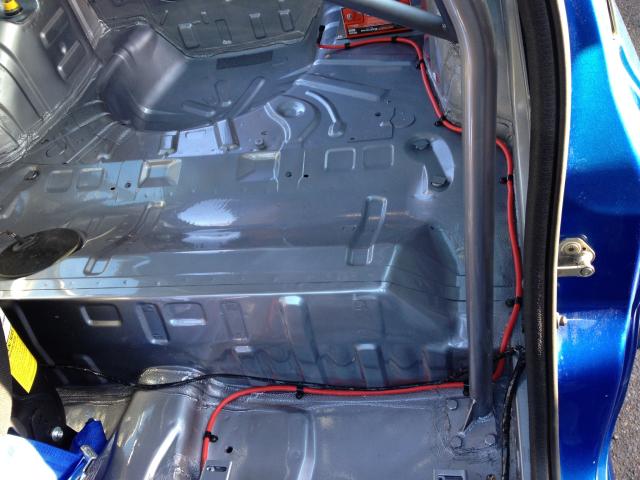

It's been a while scince a update but a lot has been done if run the main power cable for battery relocation, got the dash back from flocking and mounted the lower section ready for raw motorsport to do final connections and get gauges working.

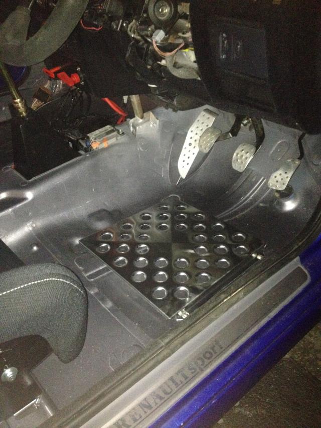

Also fitted drivers side foot plate as I didn't like grip tape.

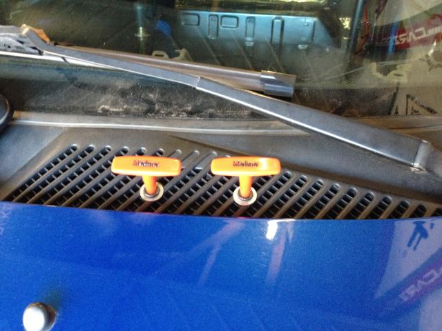

And mounted external pulls for kill switch and fire extingisher and fitted gauge sensors.

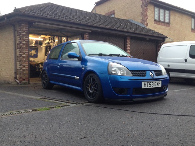

Think the boy likes the car to :smile:

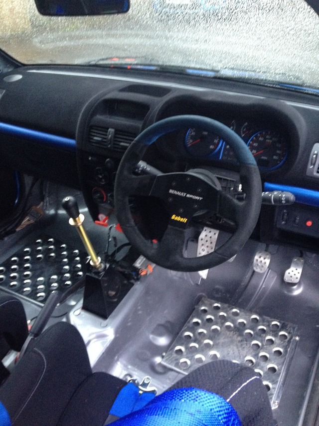

Good progress today.

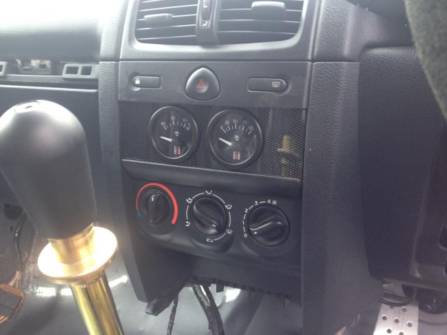

Dash finally back in now that raw motorsport have wired kill switch and oil temp and preasure gauges.

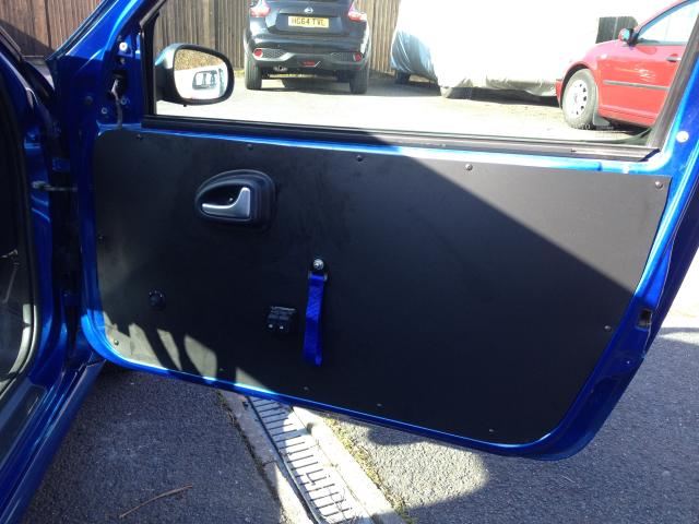

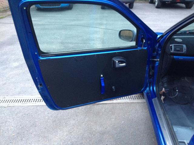

Also made some door cards today to tidy everything up. It has also really helped keep noise down abit.
What did you use to make the door cards? The flocked dash looks brilliant against the painted interior shell. Looking good. Like the photo of your kid, get them hooked young ha ha.
Thanks chaps.
Yeh really happy with dash and switches were pot luck lol
The door cards are made from foamex really light and can just be cut with a Stanley.

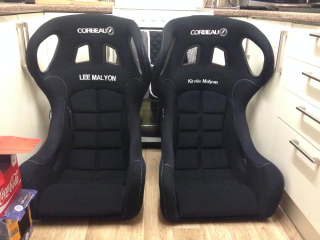

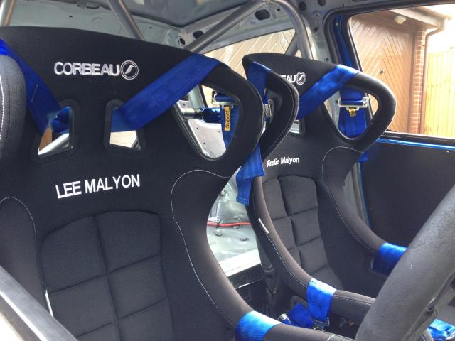

It's looking great. Had me laughing that you got your name stitched in capitals but for some reason not hers ha ha. Being the alpha male lol.
What size board did you require for making up the door cards with foamex? Really interested in doing this.

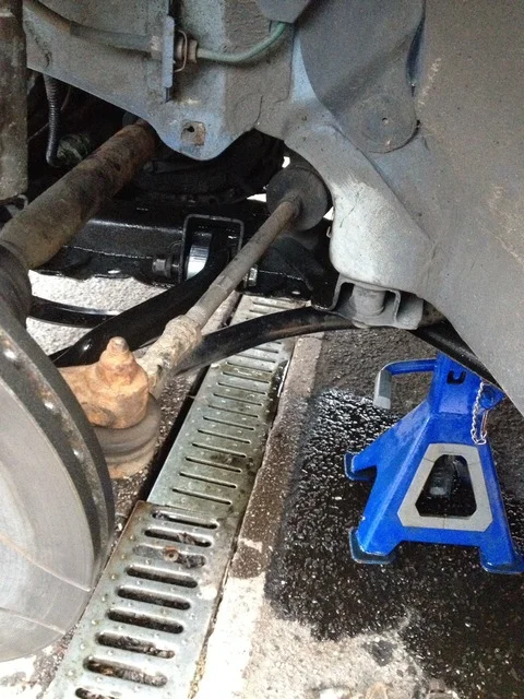

Iv made good progress over th last few days.

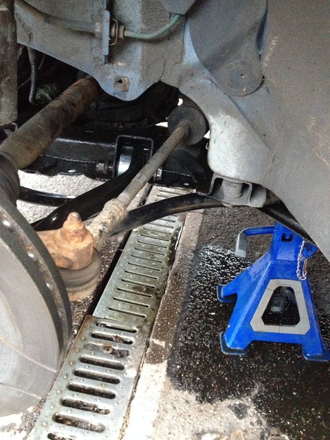

Even if I did manage to accidental you'll the drive shaft from the box dumping all it's oil on the drive :angry:
Changed both front wishbones with new ball joints and bushes.
Fitted ktec solid top mounts.
Change box oil
Give engine a oil change

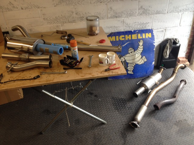

Fit new PMS 172 de cat race exhaust

And finally get round to fitting Renault sport steering wheel.
