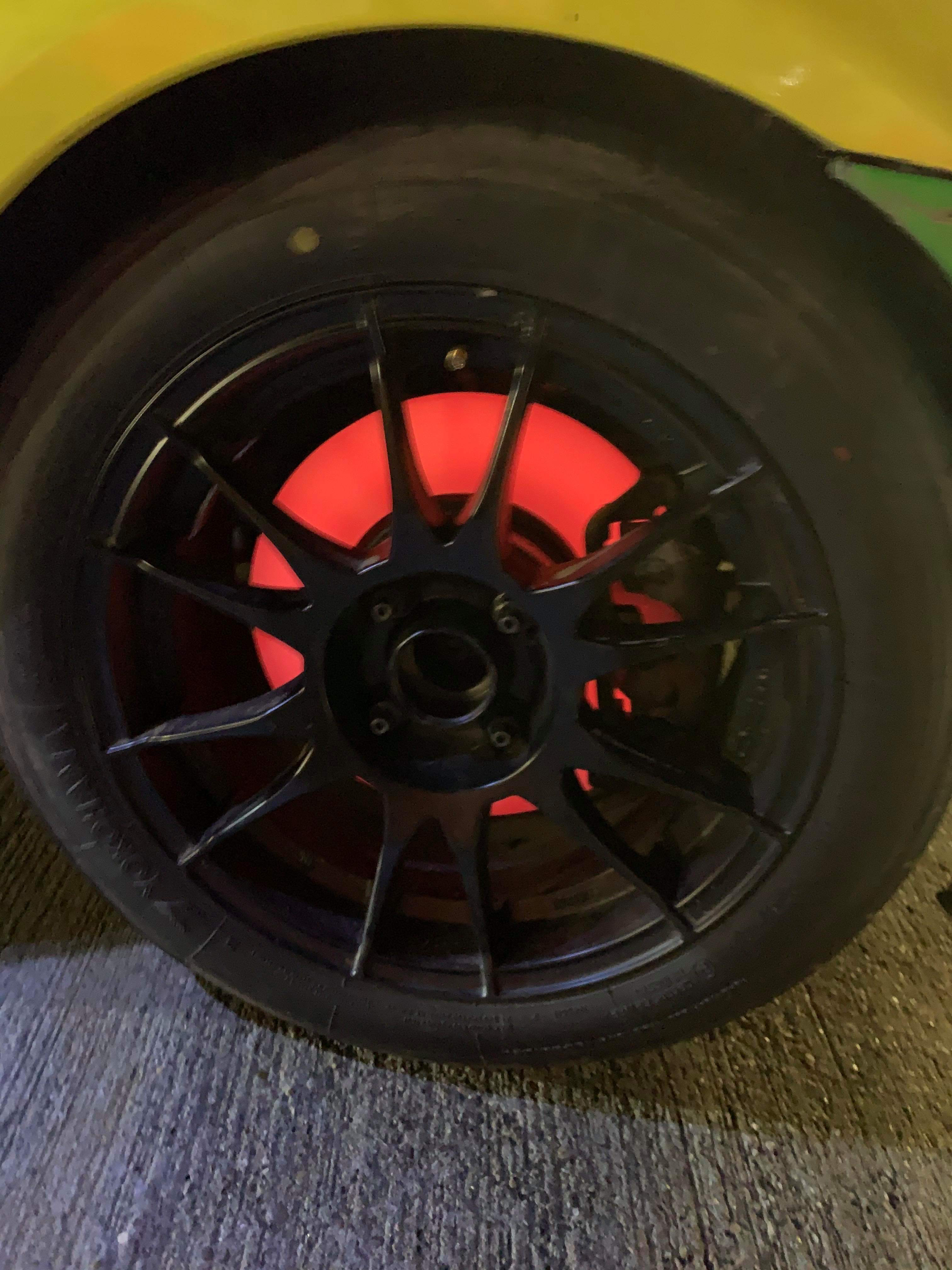

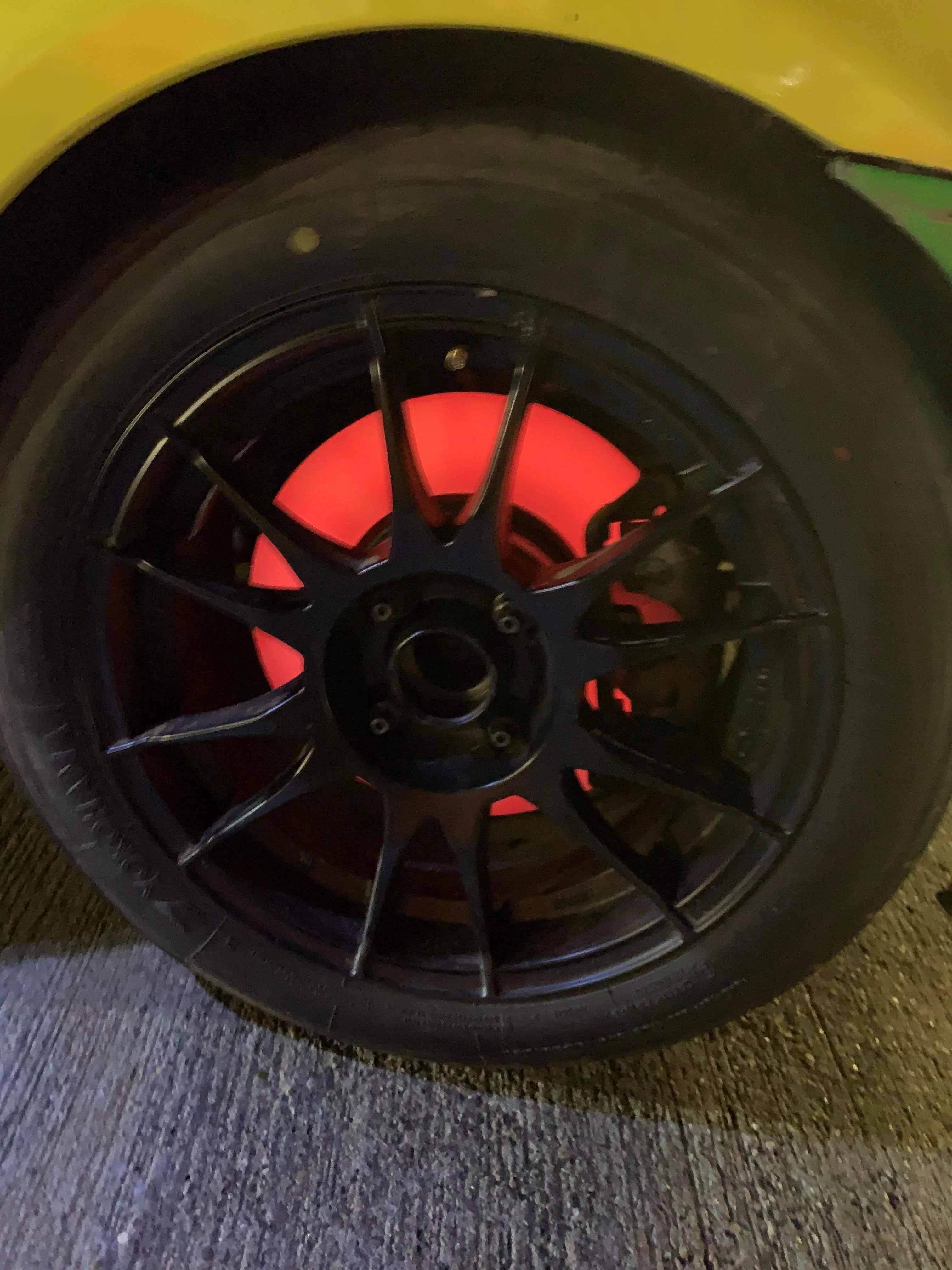

I've been using Brembo HC discs and CL pads for the last 5 or 6 years of racing. They get hot under race conditions yes, but never had any significant fade or long pedal in the 40 minute races we do.
This photo shows how hot they get but they still work. Only this year am I upgrading to a custom set of AP calipers and 2 piece discs but that's as much to reduce unsprung weight as improve braking
