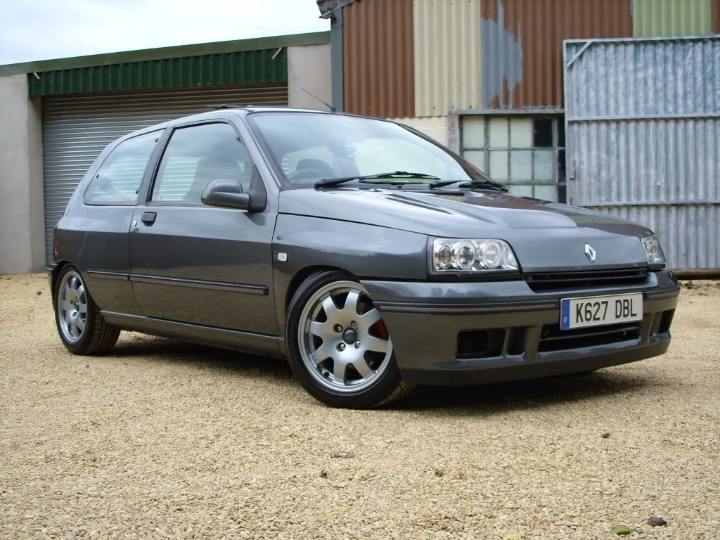

So i've had this car for nearly 4 years. I bought it from a member on here, Brad Harding, back in sep 2008.
1993 K plate Clio 1.8 16v with a Hybrid 2.0 bottom end.
This project has taken a long time (and still isn't finished! lol) owing largely to the fact that I have two small children, a wife that will be ill for the rest of her life and two businesses. Basically, I don't get much time! But this car is my baby and I don't care if it takes another 4 years, as long as its done properly.
I first saw the car on here way before that and as soon as I did, I sent him a pm stating that i'd buy it as soon as he was going to sell it. Two years on, he pm'ed me and I jumped in my wifes car with my dad and was off to Leicester as fast as possible...

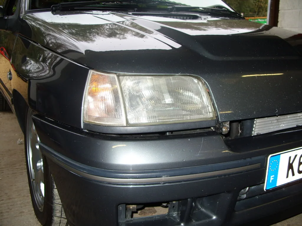

Now, whilst it was a nice looking car, I can honestly say I bought this thing with rose tinted glasses.

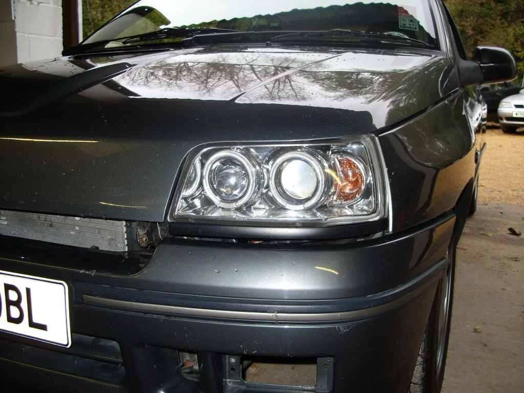

SO I drove it round like that for about 6 months. I changed the headlights from the awful angel eyes back to the originals.

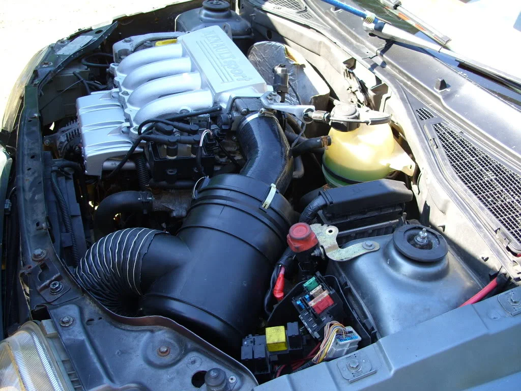

So it was decided (during some stupid piss up!) that me and my mechanicwould do the engine swap from a 172.
So I went and bought a ph1 172 from a member off here that had been written off (lightly!)
We then transferred the following bits into the mk1 shell...
172 engine, Gearbox, clutch, driveshafts, bottom arms, discs, calipers, radiator, alternator.... I basically wanted a 172 in a mk1 shell.
Whilst doing it, I hounded Jordan Fox and chris Whiteley (off here) as they had already done the conversion so massive massive respect to them. When I eventually meet them, the beers are on me! My mechanic hates renaults, I am a car valeter so in the grand scheme of things, we needed help! lol.
Eventually, after one evening a month over the period of a year, I ended up with my mk1 172...

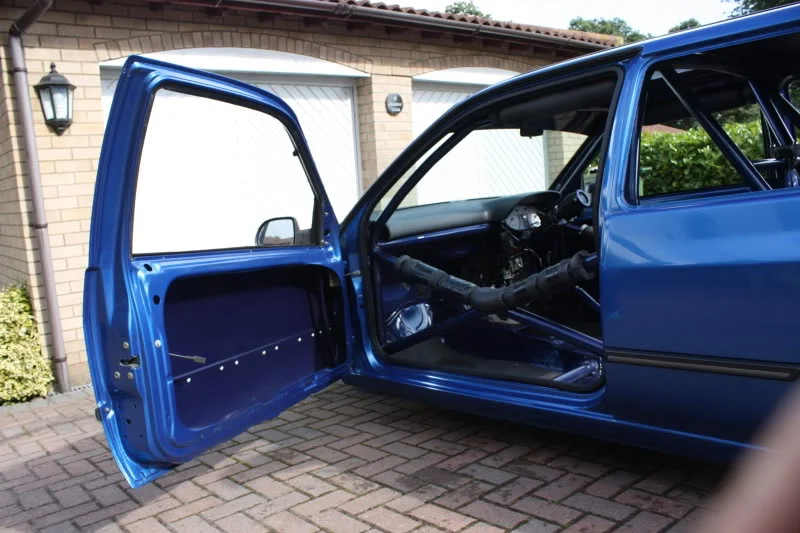

But then, Whiteley from this very forum advertised his bare shell, complete with cage.
So I was watching it on ebay, it got to the last 10 seconds and I stuck in a cheeky bid...
But i'm a prick and lost it by £20. FFs. :(
Down trodden and disheartened, I just put the clio to the back of my mind and got on with life. Even bought myself an Impreza to cheer myself up!

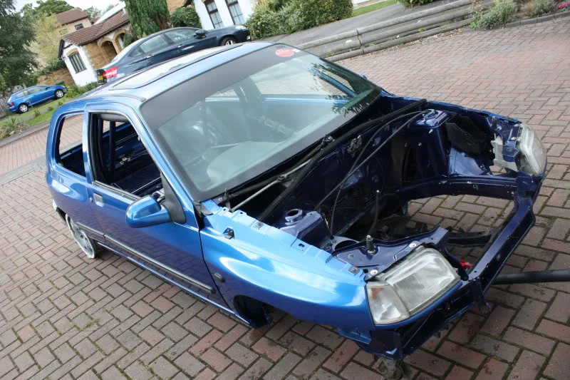

Then, out of the blue, the new owner of Whiteley's shell had a change of heart! :D:D:D He wanted to sell me the shell as he had too much going on to carry on with it.
So, with no hesitations, me and sam jumped in the truck and drove the (very!!) long way to get my new shell.
So thats as it stands, I have a fully functioning clio mk1 with a 172 engine but a rotten shell, and a 95% rust free shell with no running gear.

And the lovely new shell that its all going in to this saturday/sunday.
I have booked a track day for the 7th of june and have booked two days off work this week to get the grey car re-shelled...
Got my work cut out! lol.
So plans are...
This weekend: Paint engine bay gloss black, reshell car, scrap grey shell after stripping it for spares.
