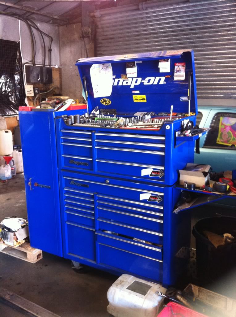

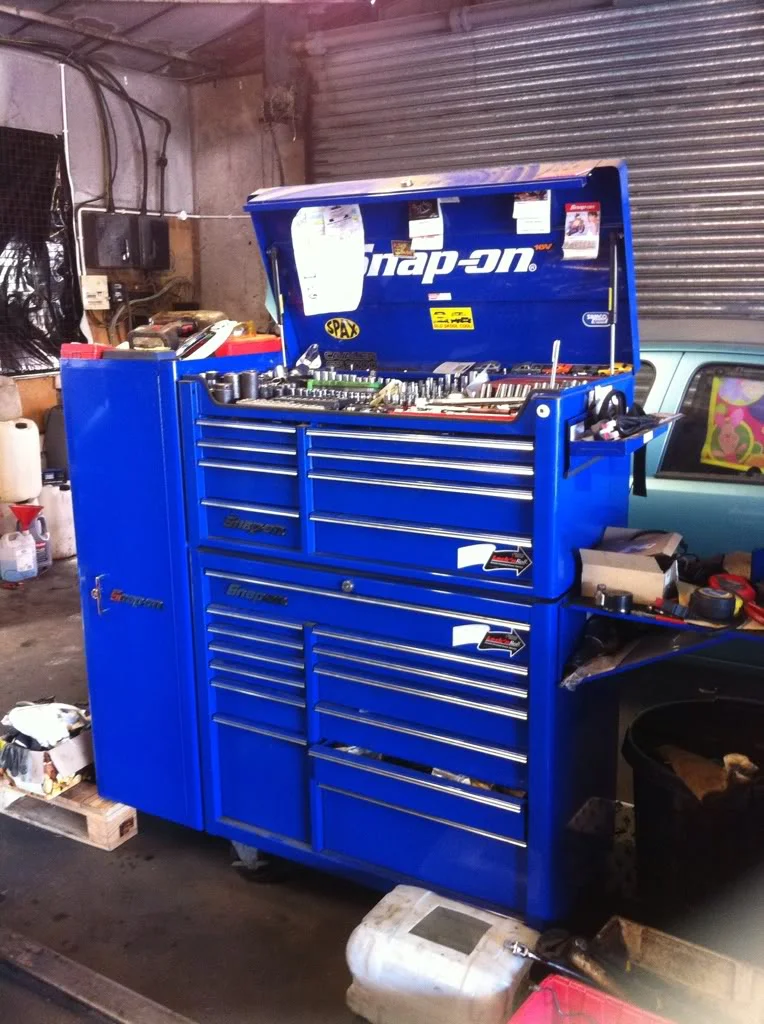

Up at my mates garage, RCK mechanics in soundwell. Literally 2 minutes from my place.
Ramp, roof, lights £20k's worth of snap-on and loads of space! Makes a change from my garage where i've got a 10mm spanner, some cable ties and a pair of mole grips.
Thats why i've got to do it as fast as possible. He's open 7 days a week and he's very kindly let me have the place for two days while he works outside on the floor with a trolley jack.

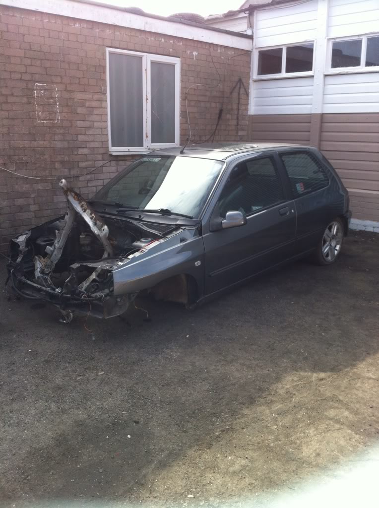

And I drove up to the garage to be greeted with this...
Thats whats left of the old shell. Sadly I can't get rid of it just yet as there's a few little bits left to get off of it but I ran out of time this weekend.
I think we did pretty well in just two days! Please bear in mind that I am a glorified car valeter and Sam is a builder! lol.

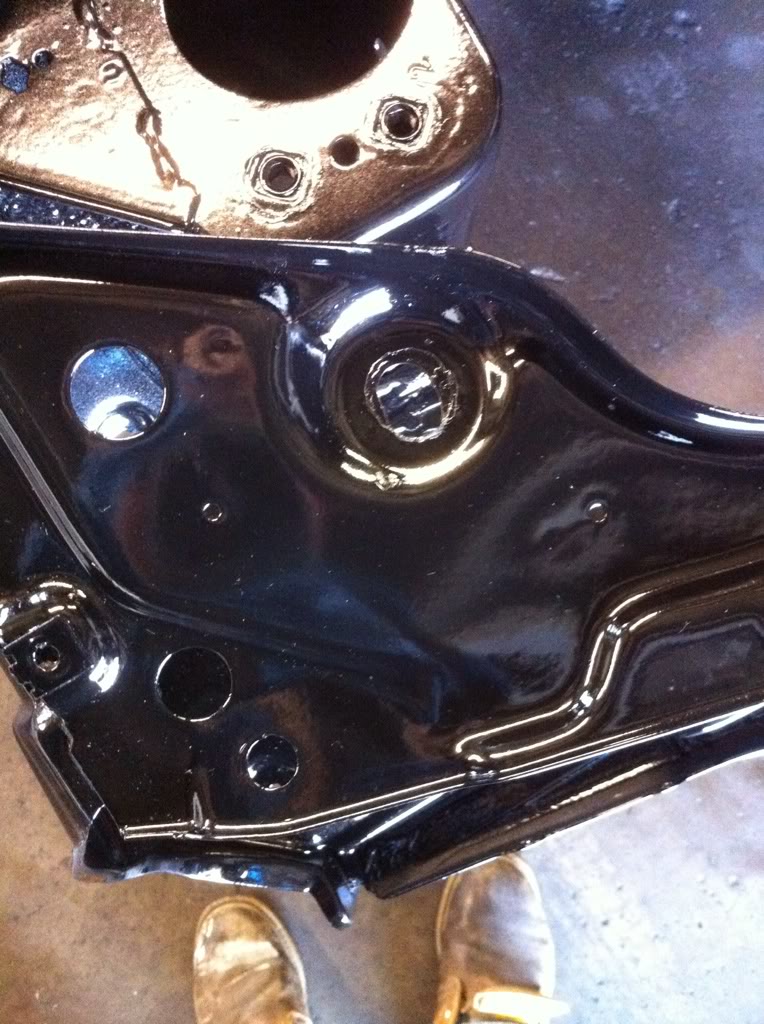

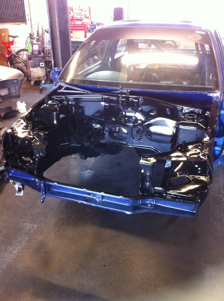

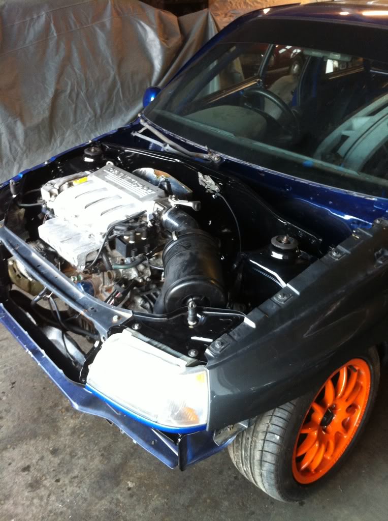

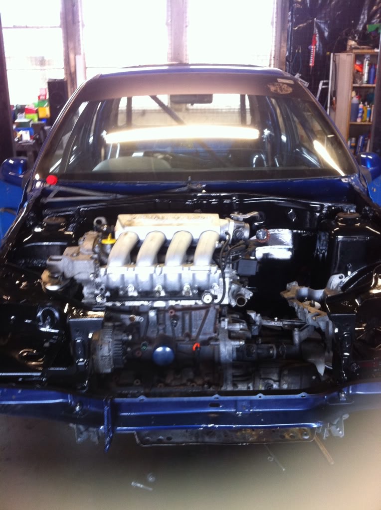

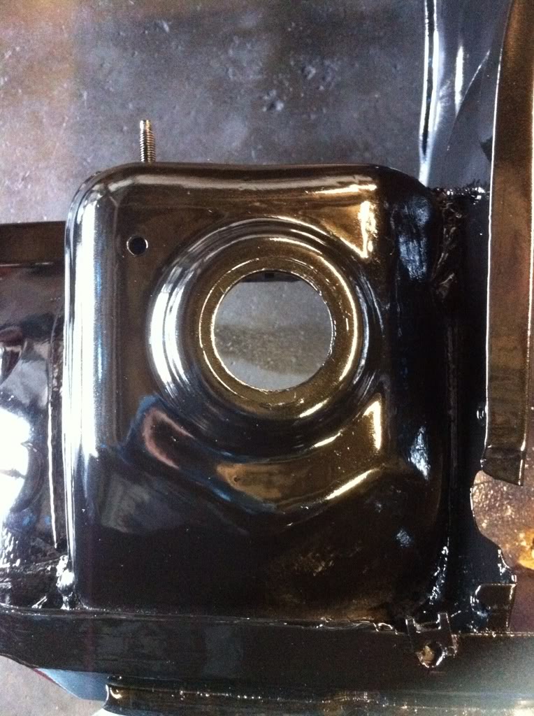

So anyway, Opened up the garage to be greeted with the newly painted engine bay.
This is where me and sam had our first disagreement because he wanted me to get it painted properly at a bodyshop. I wanted to just paint it with a brush and some hammerite. In the end we bought some etch primer, some gloss black and some scotch pads and rubbed it down a bit and painted ourselves.
TBH, I think the finish is outstanding considering this was in a filthy dirty workshop...
I decided then to have a little tidy up seeing as its not my workshop and its not my toolbox so I wanted to make sure I hadn't lost anything as this little lot cost £15,000!!

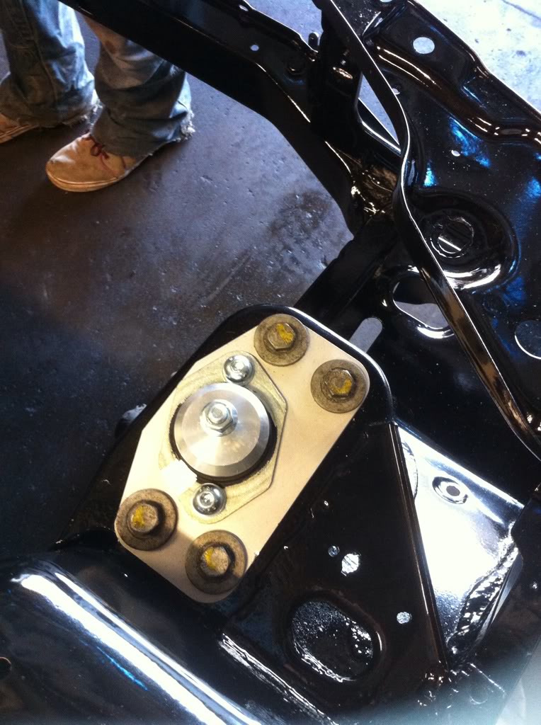

On went Ktec engine and gearbox mounts. I don't need a dogbone mount as I've got a solid welded one down there.

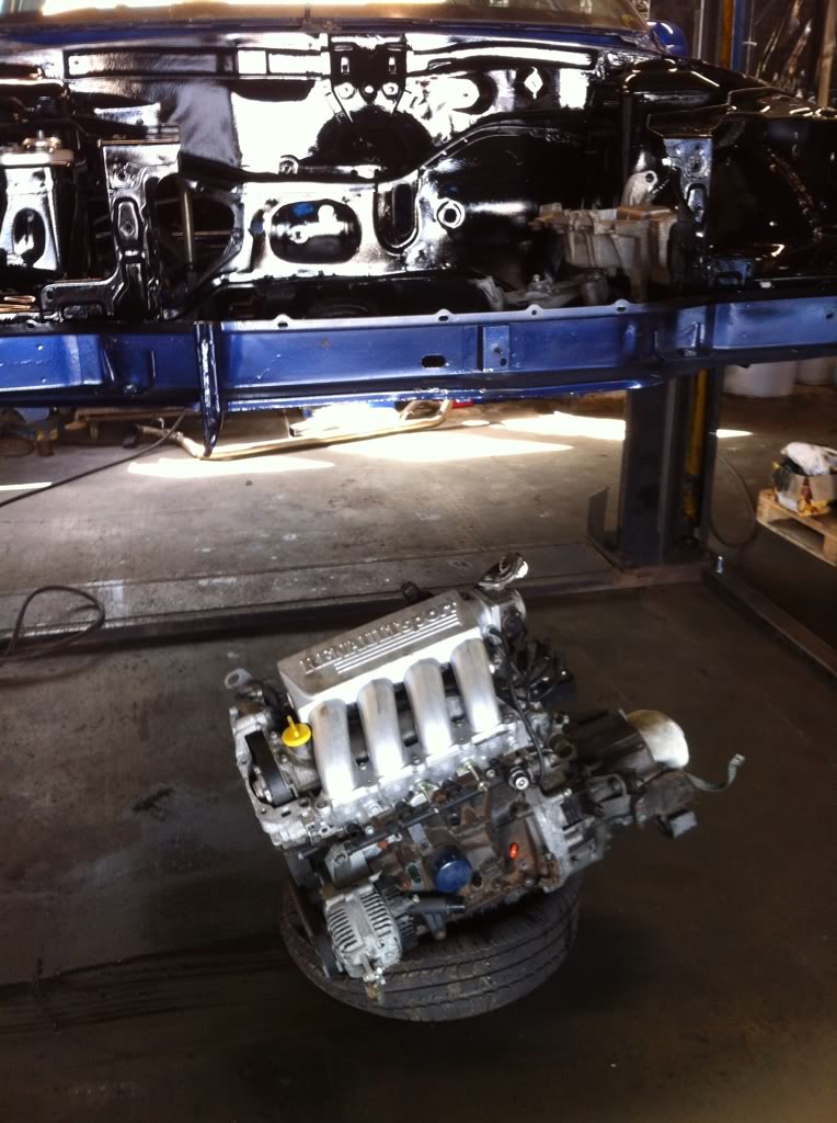

Next up we dragged the engine and the terribly expensive bald goodyear engine stand over and lined it up...
And lowered the car down onto it. With a bit of fiddling, swearing and trying our best not to scratch the new paint, we were in!

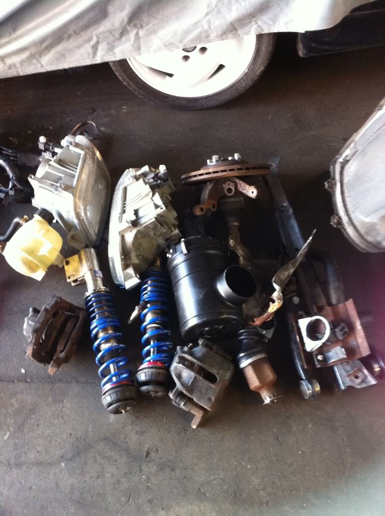

So, on we go. Sorry about that.

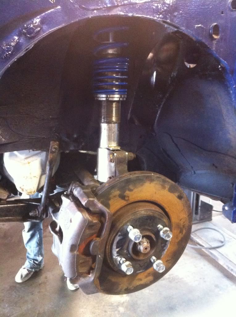

Front coilovers fitted (I've had these about 2 years but they've done about 100 miles! lol)
FK Konigsports in williams fitment, Brembo discs, DS2500 pads, braided lines and 172 calipers:

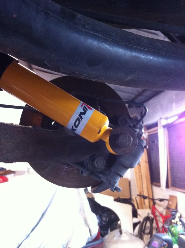

Fitted the rear shocks:
