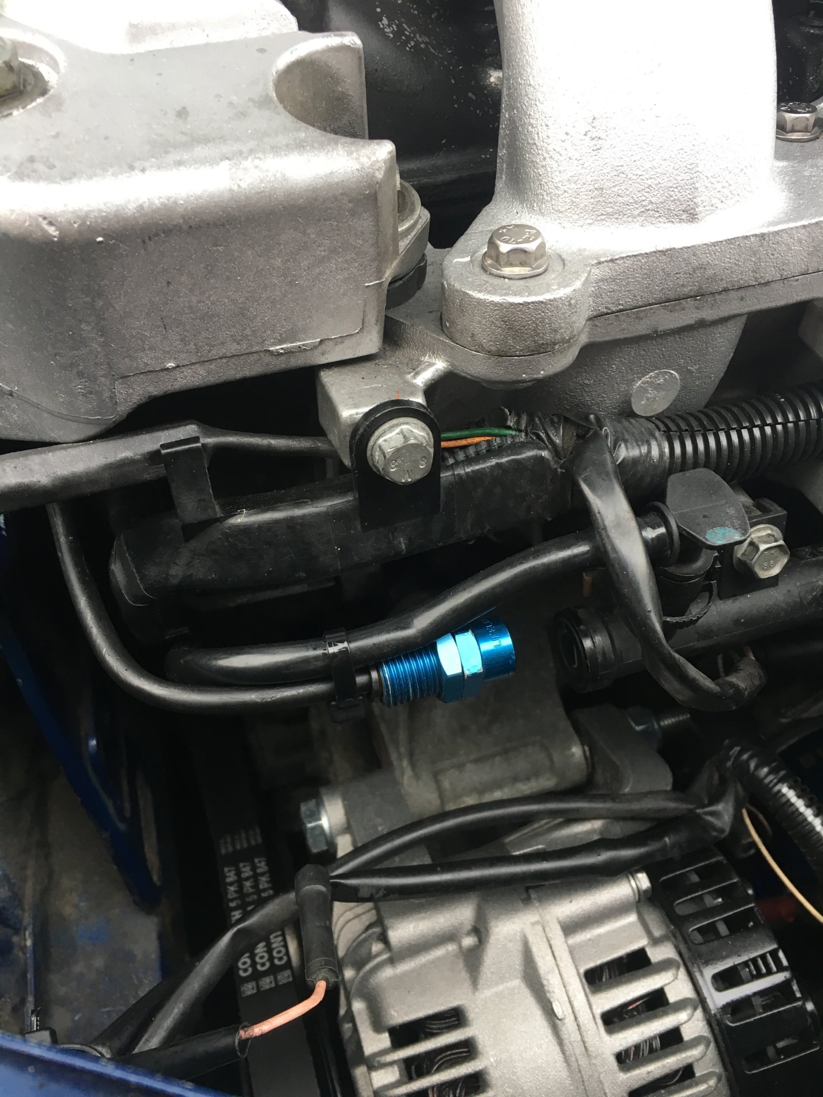

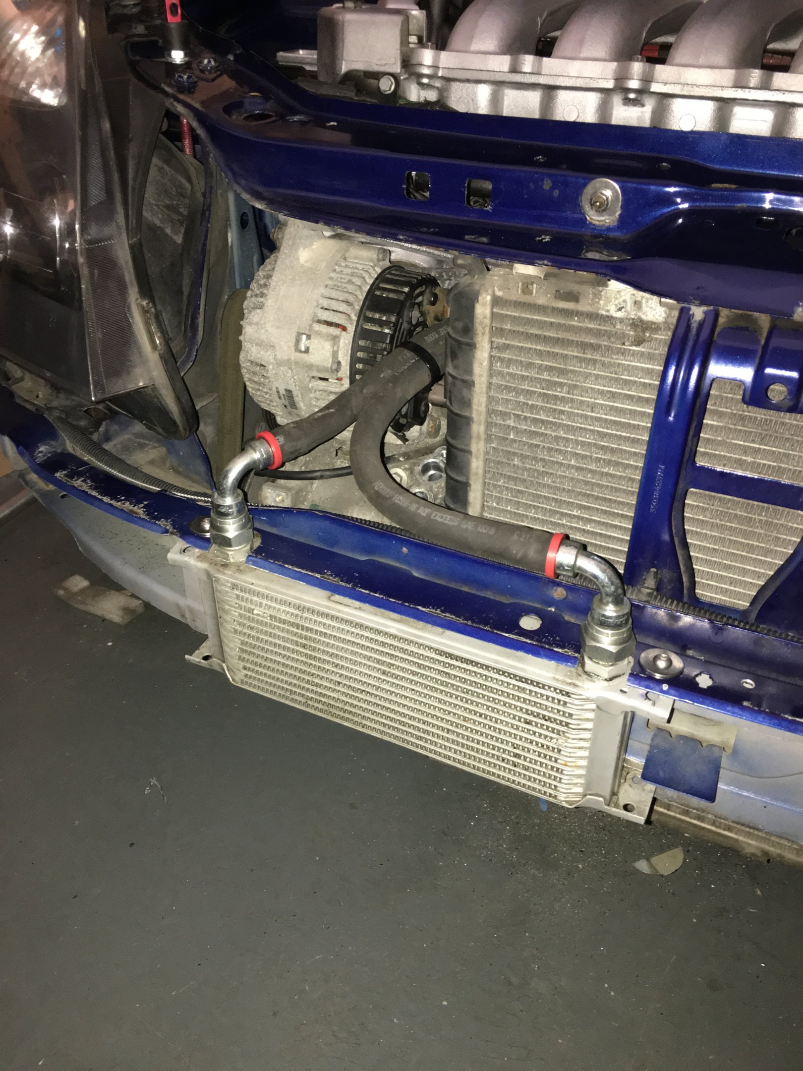

Completed my oil cooler setup, tbh I'm not 100% happy with the position of the oil cooler, it's been a massive hassle mounting it were I did but this was due to the hose length I bought it with. Think in the future I'll look at changing this and use longer hoses.

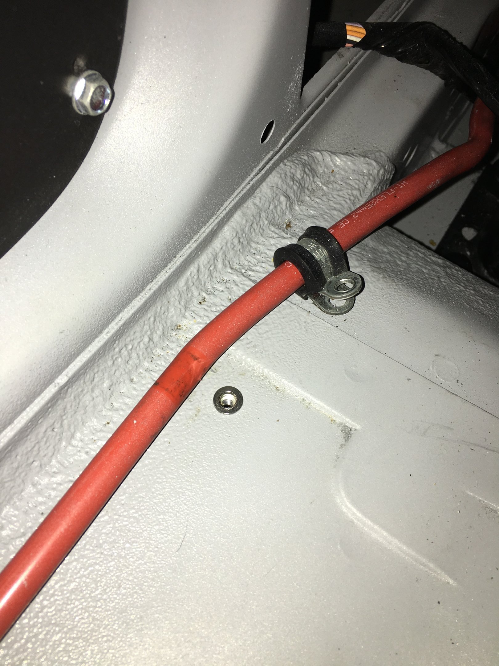

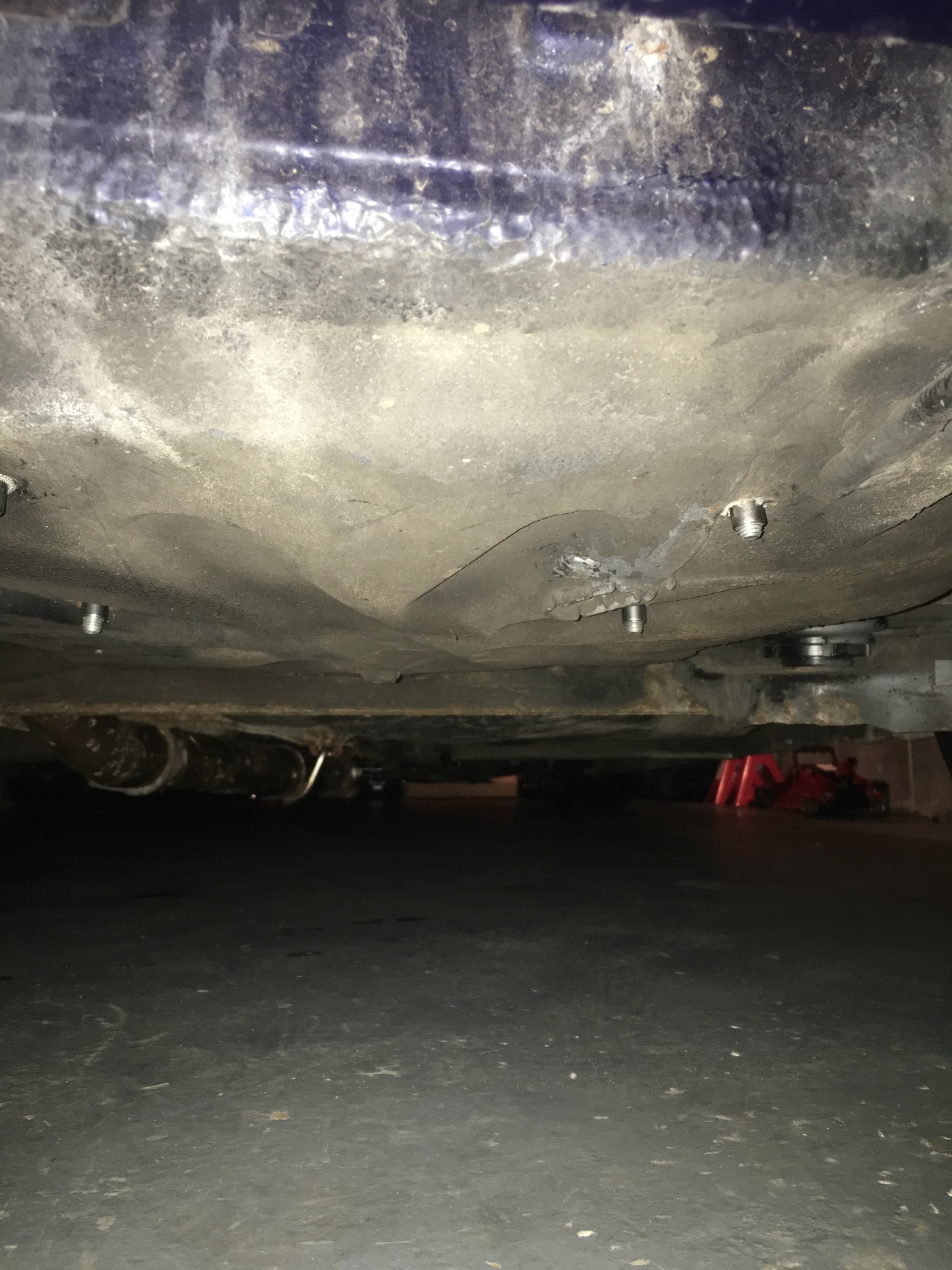

Whilst working underneath the car I realised how untidy and unprofessional Tex screws are, self tappers and cars just don't mix. So I purchased a rivnut gun and went about replacing all the Tex screws to stainless steel rivnuts and button head screws.

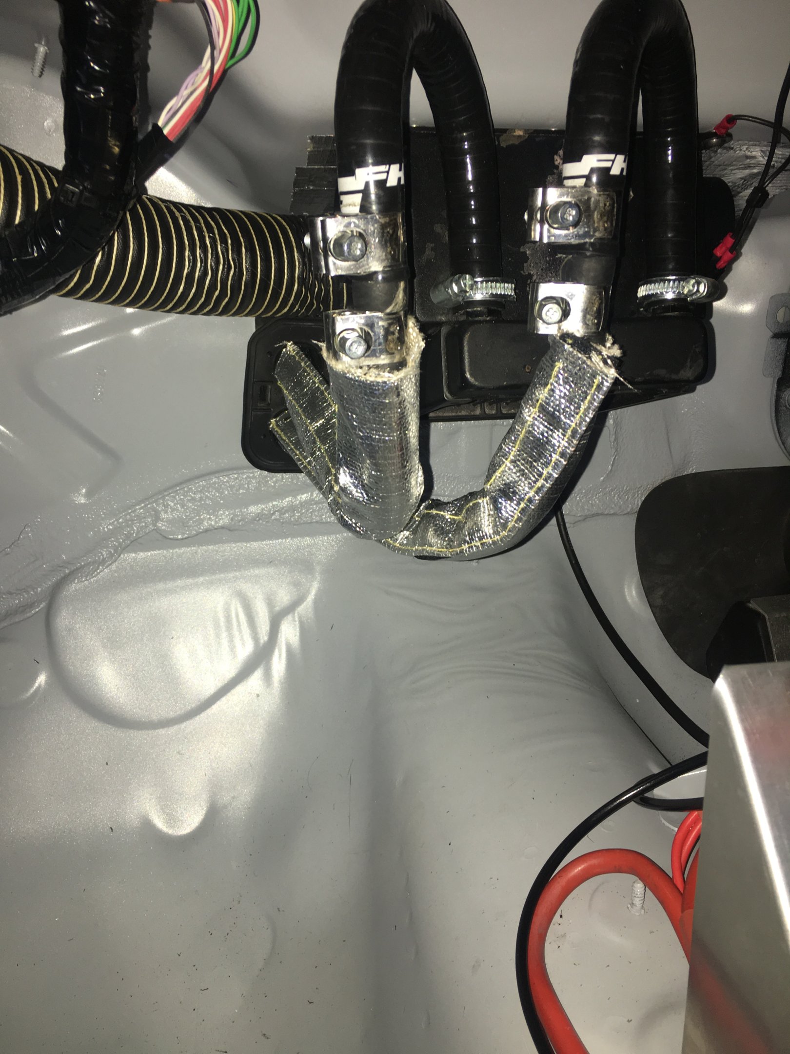

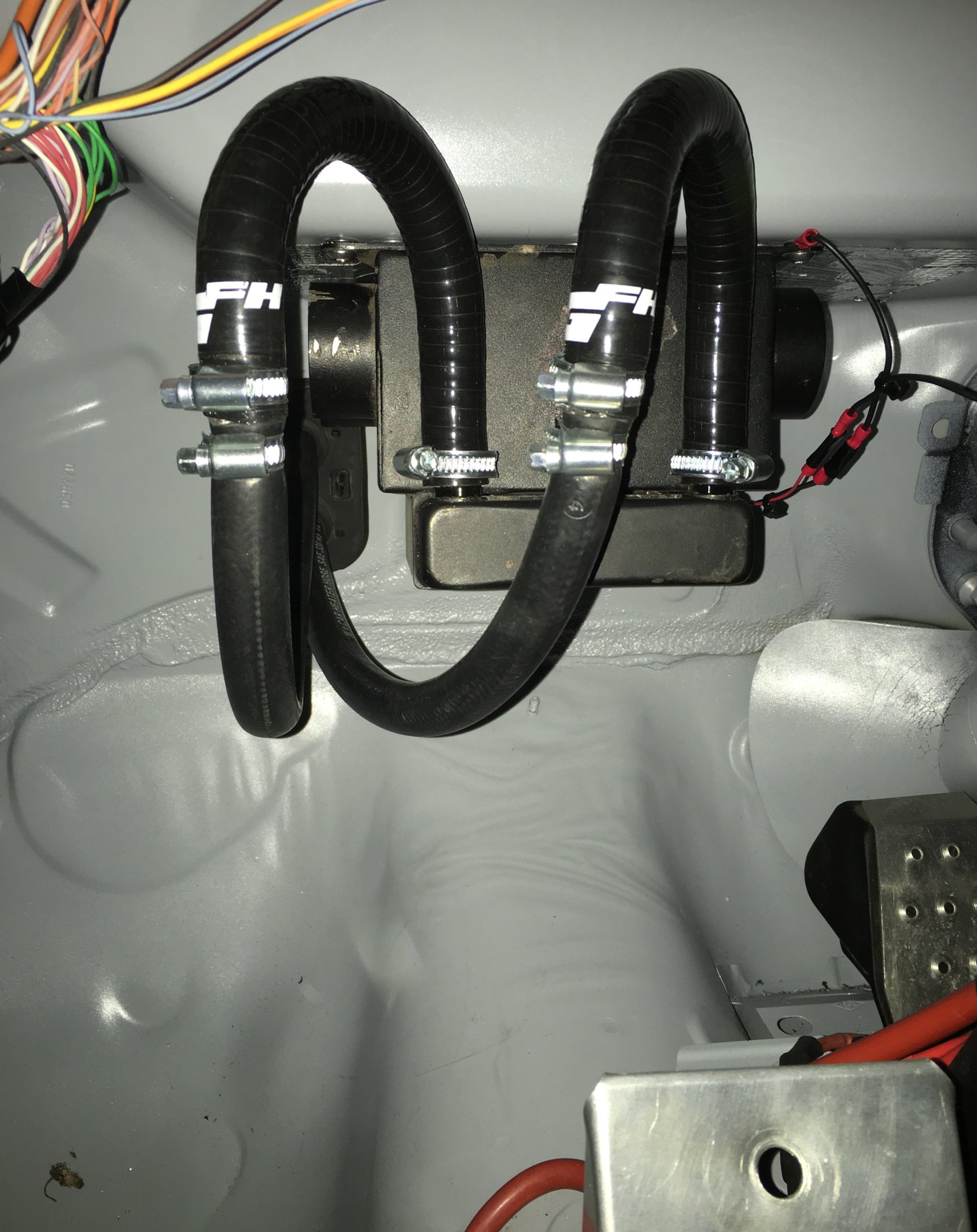

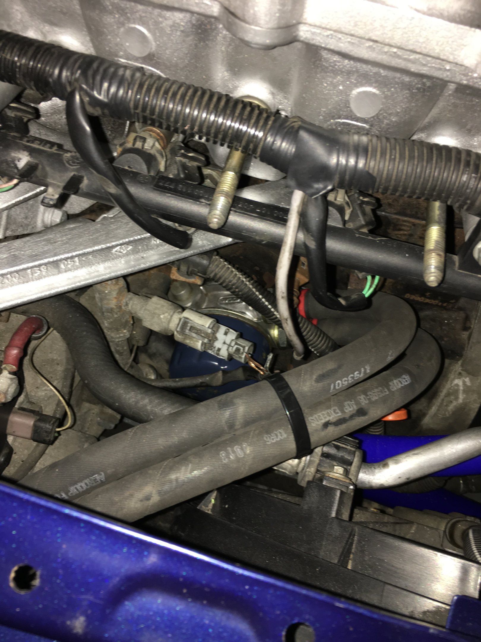

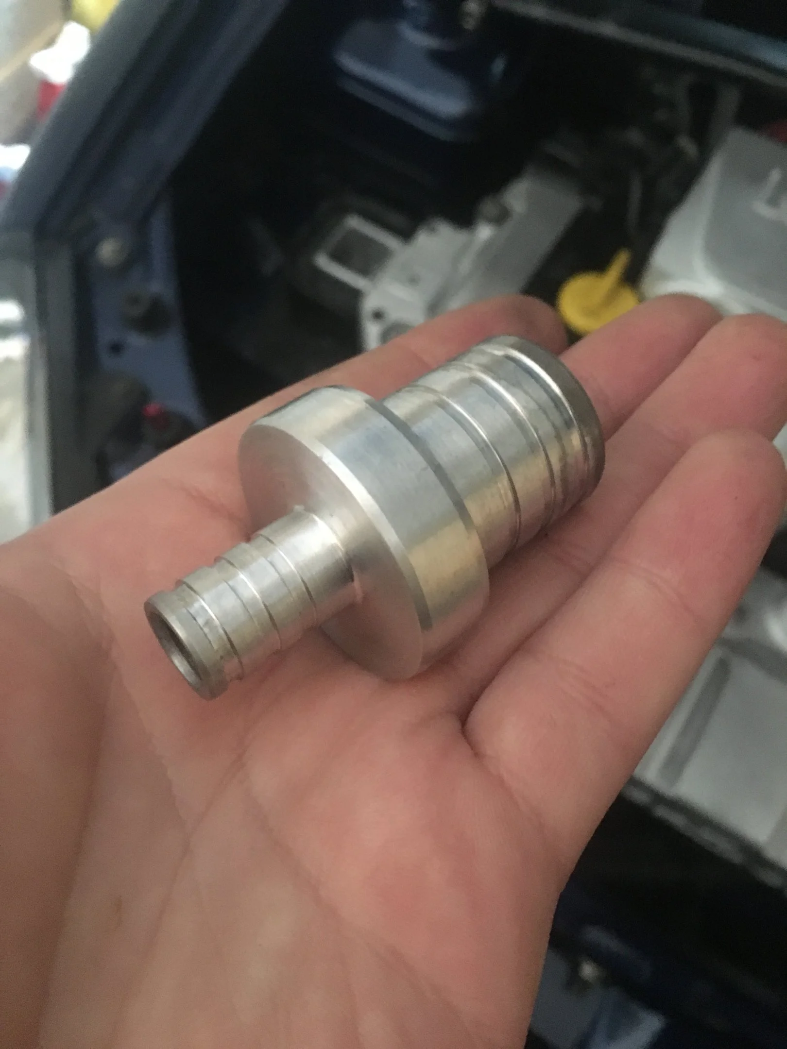

Wasn't planning on fitting a T7 heater for a while but one came up for sale at a good price so decided to make a start plumbing it in. Trying to find the exact size hose reducers was more difficult than I initially thought so ended up making my own at work.
Quite happy with the setup now, ended up changing a few clips to mikalor T-bolt clamps, for peace of mind I'm not going to scald my passenger in boiling coolant! Also added some heat protective sleeving as the hoses can get very hot.

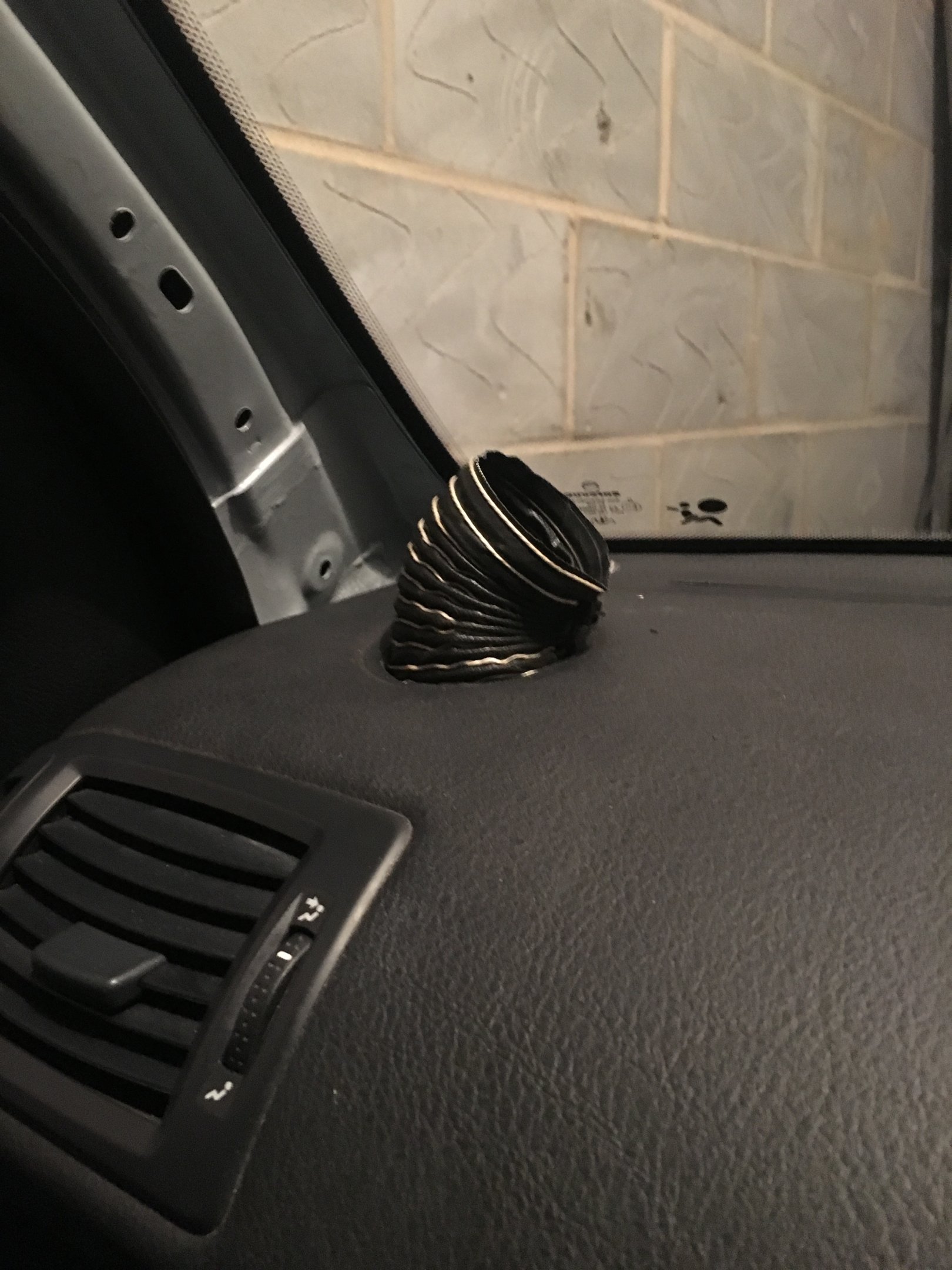

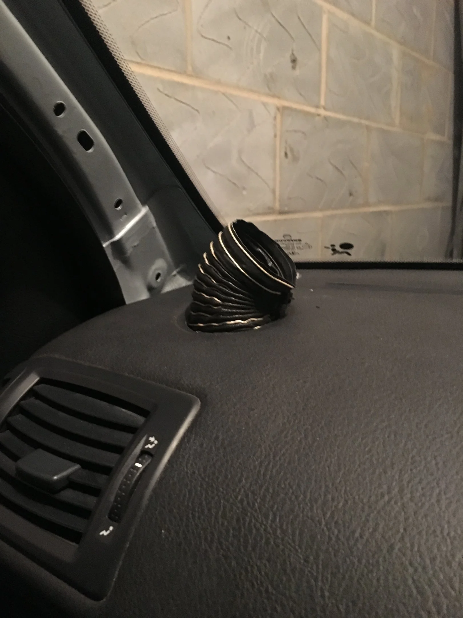

Ran one side of the heater hose aimed towards the windshield I'll do the same on the drivers side, but may need to remove the dash top to run the hose.

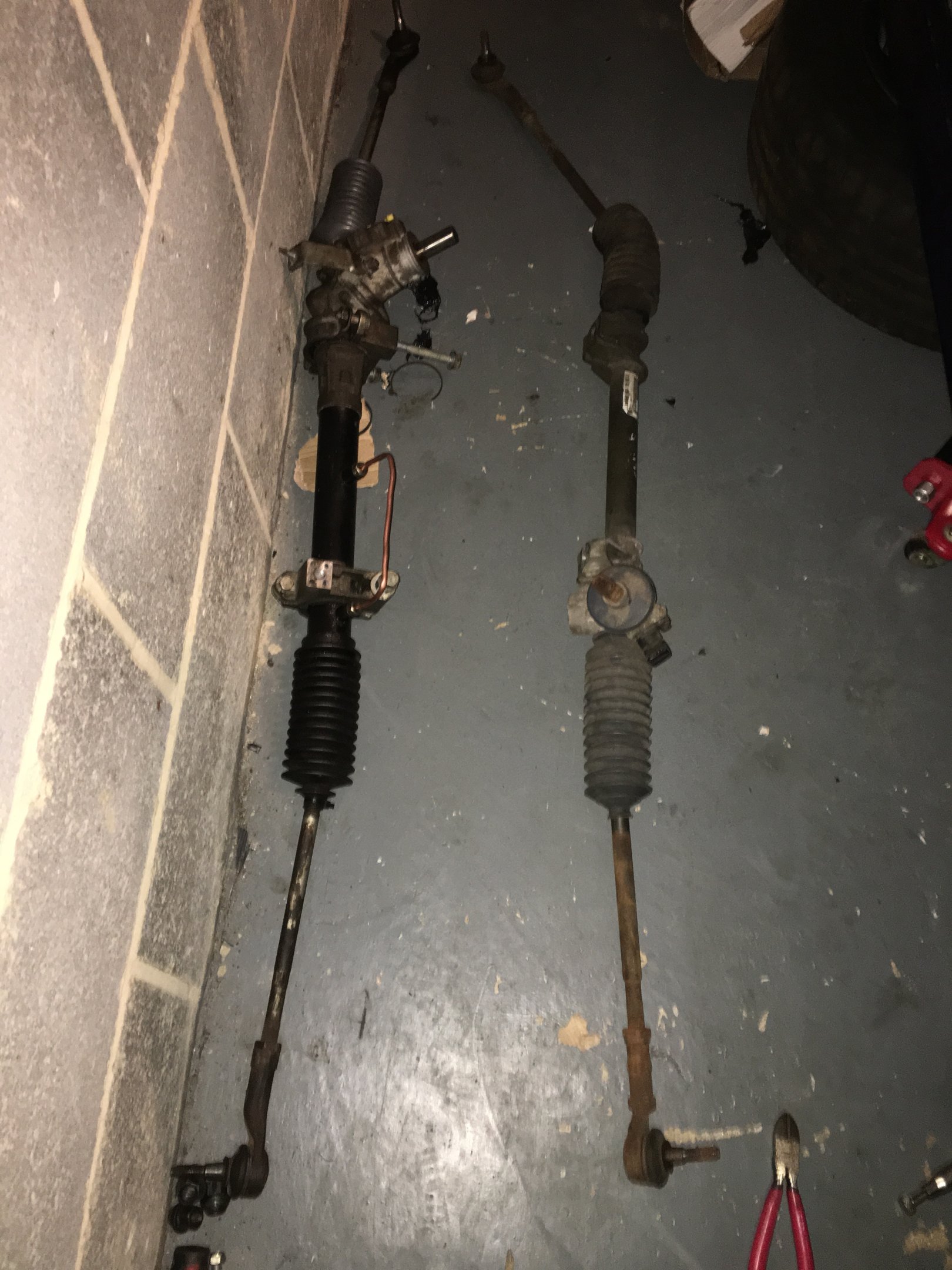

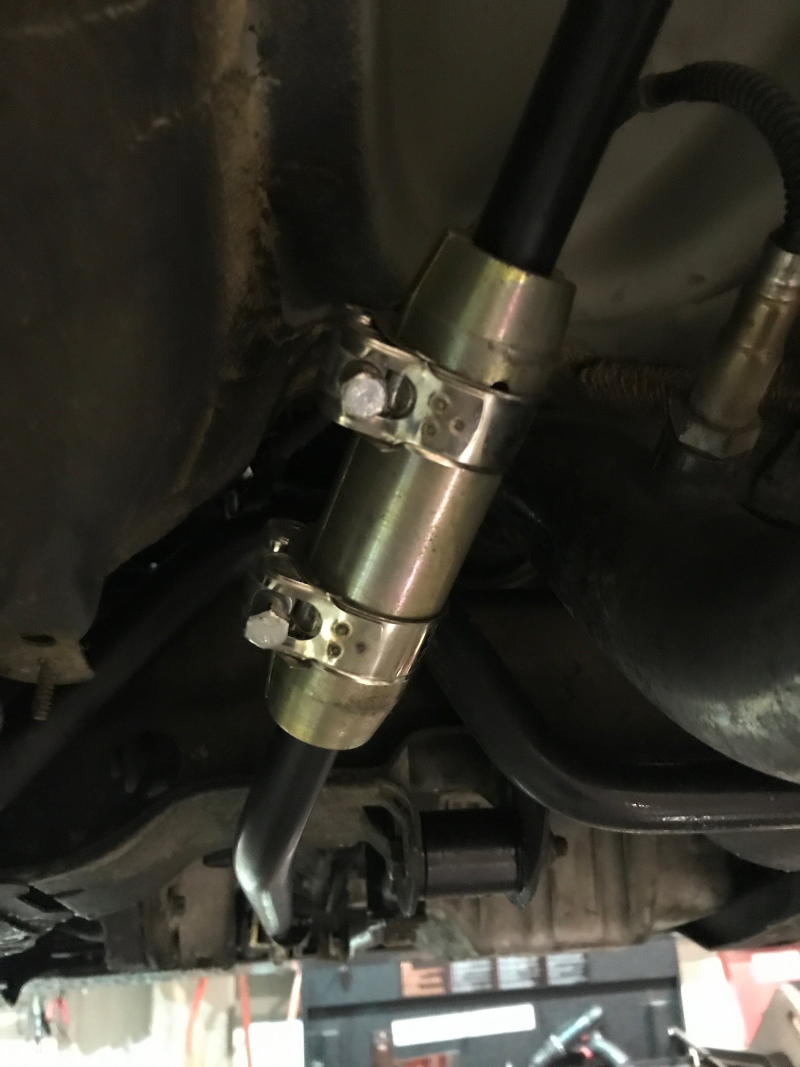

Don't have any photos of fitting the bottom arms but all went well and this got me thinking maybe it's possible to carry out a EPAS conversion myself in the garage. So I sourced all the parts needed and started cracking on.
Cup setup fitted, sourced the brackets from Germany via eBay and after searching part numbers all night I worked out the correct standard bolt sizes needed. Decided to purchase a reconditioned alternator as it comes with a guarantee. Need to remove the brackets for paint at some point.

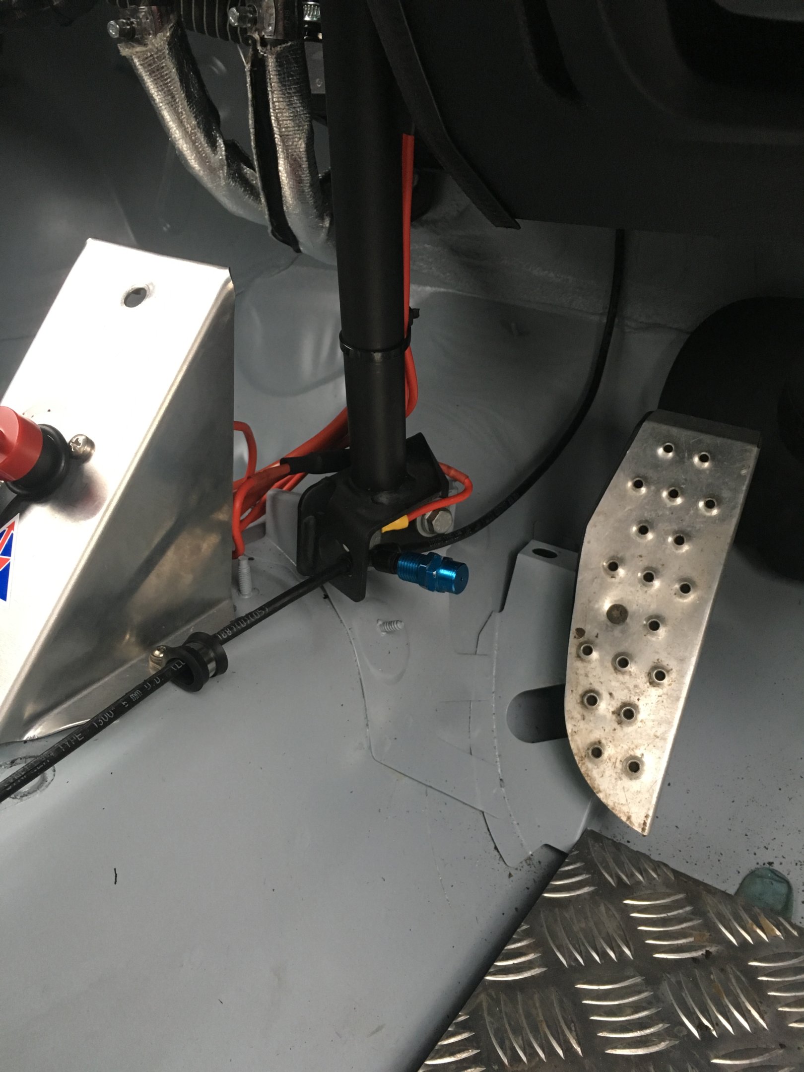

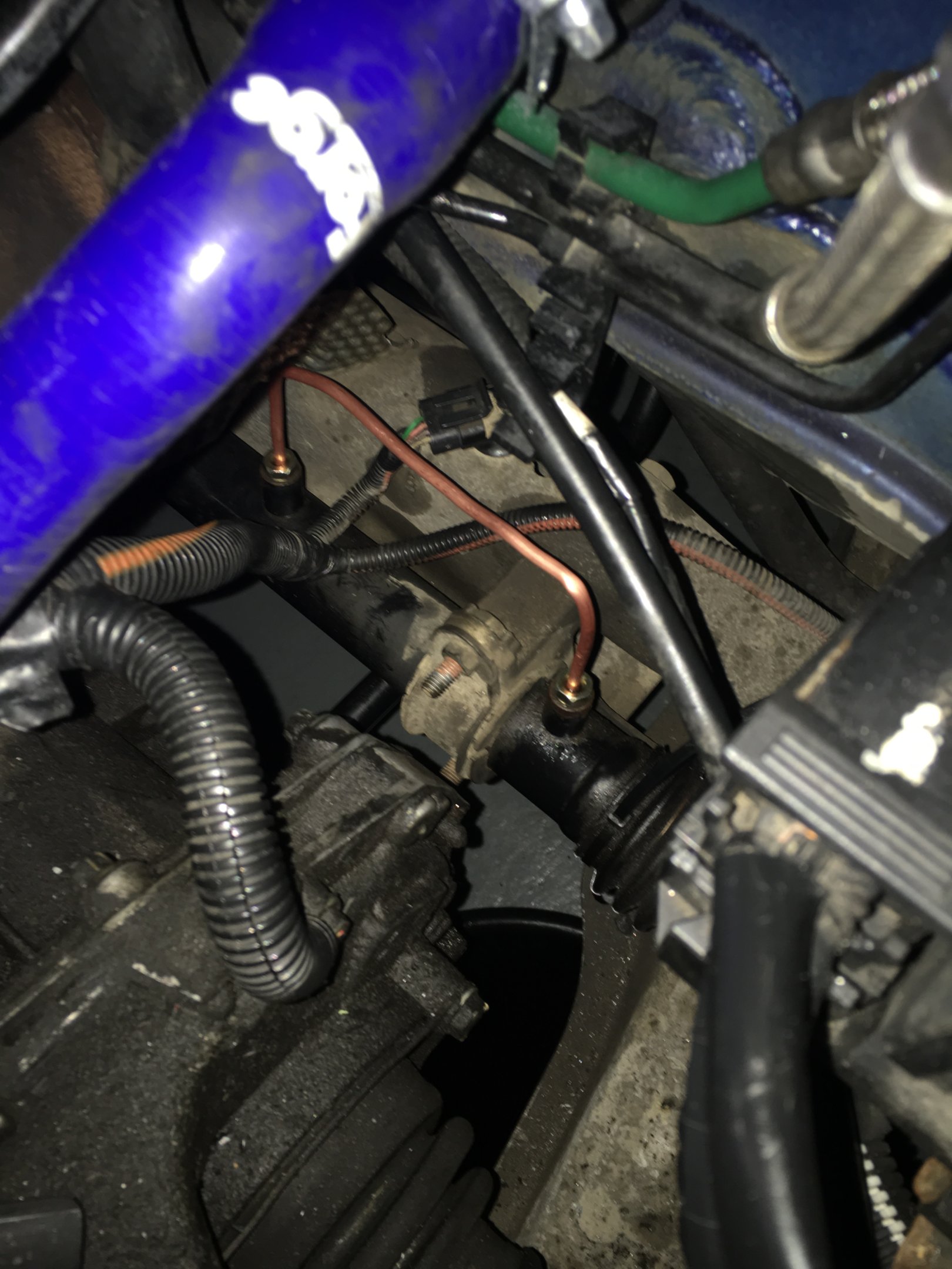

Plugs fitted and rack looped, after finishing the conversion I realised I had a knock when wiggling the steering wheel, I put this down to play in the steering rack so opted for a DCI rack which has solved the problem.

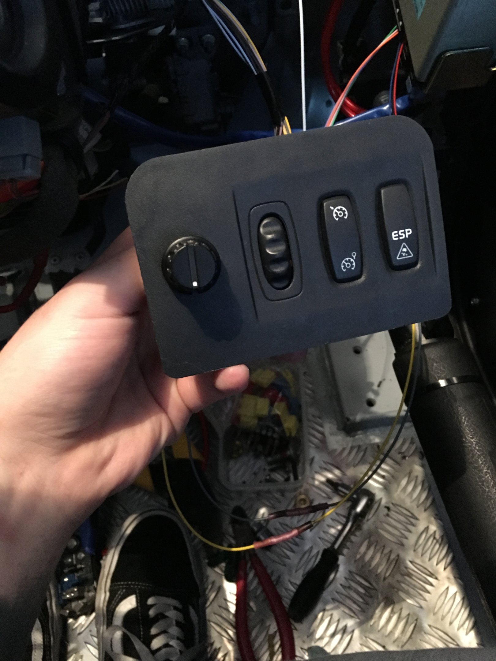

Then moved inside to swap the column and start on the wiring

Really happy with the EPAS and DCI rack! Before taking it out for its first proper road test in almost 2 years! I thought It would be best to give it a full service, new plugs, oil & filter, and gearbox oil. I already flushed the coolant when installing my T7 heater filling it with Renault type D coolant.

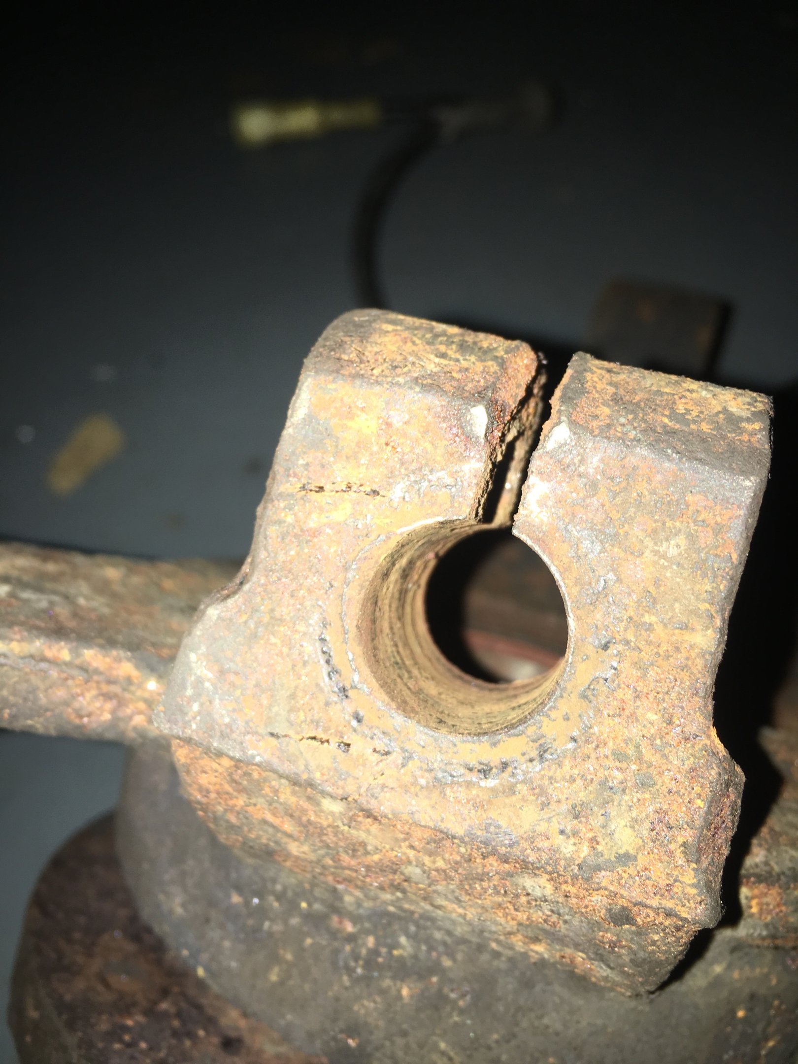

Road test went really well popped to a friends garage to fit some AD08's ready for my first track day of the year. Whilst fitting them I noticed I had play in the drivers side ball joint despite it being brand new, on further inspection we noticed the hub was actually worn causing the slack. I've got one on its way so hopefully get it fitted some time this week.

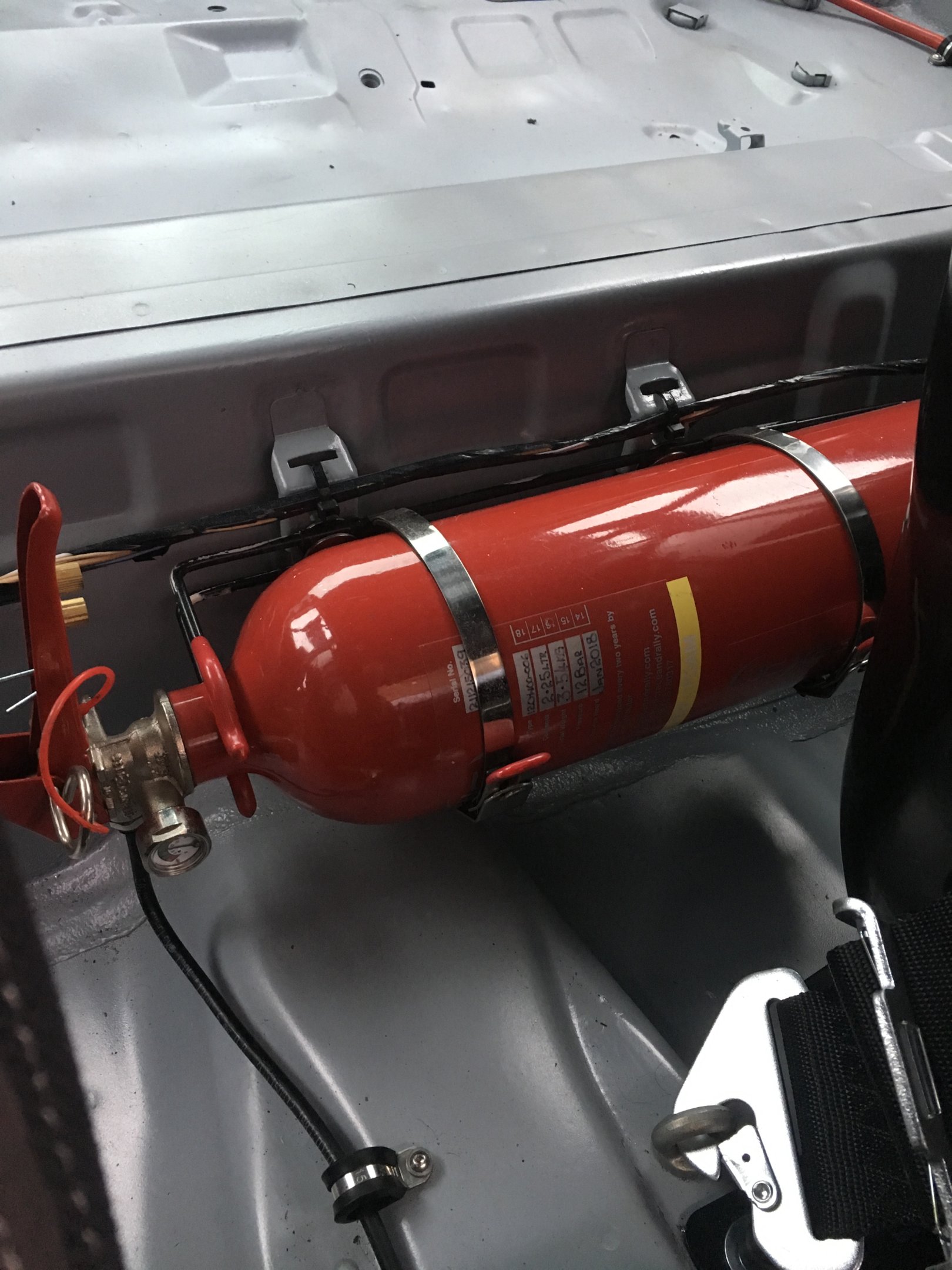

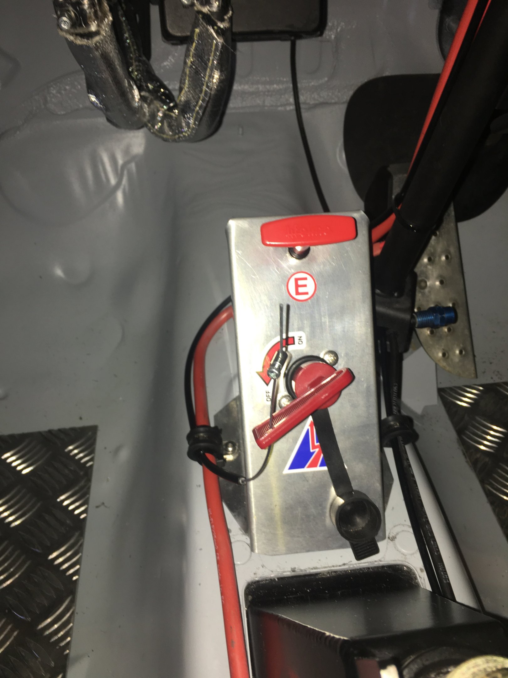

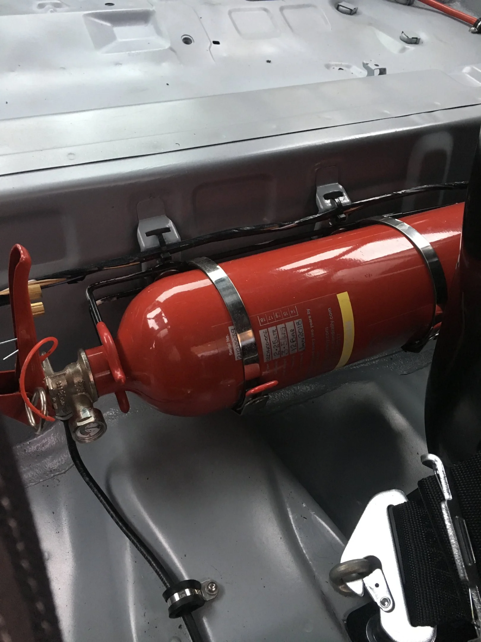

Today I made a start on completing my plumbed in fire extinguisher I mounted a couple month back, I bought some new lifeline pull cables but was about 6" short for the shuttle panel so waiting on a 12ft" cable to finish it off.

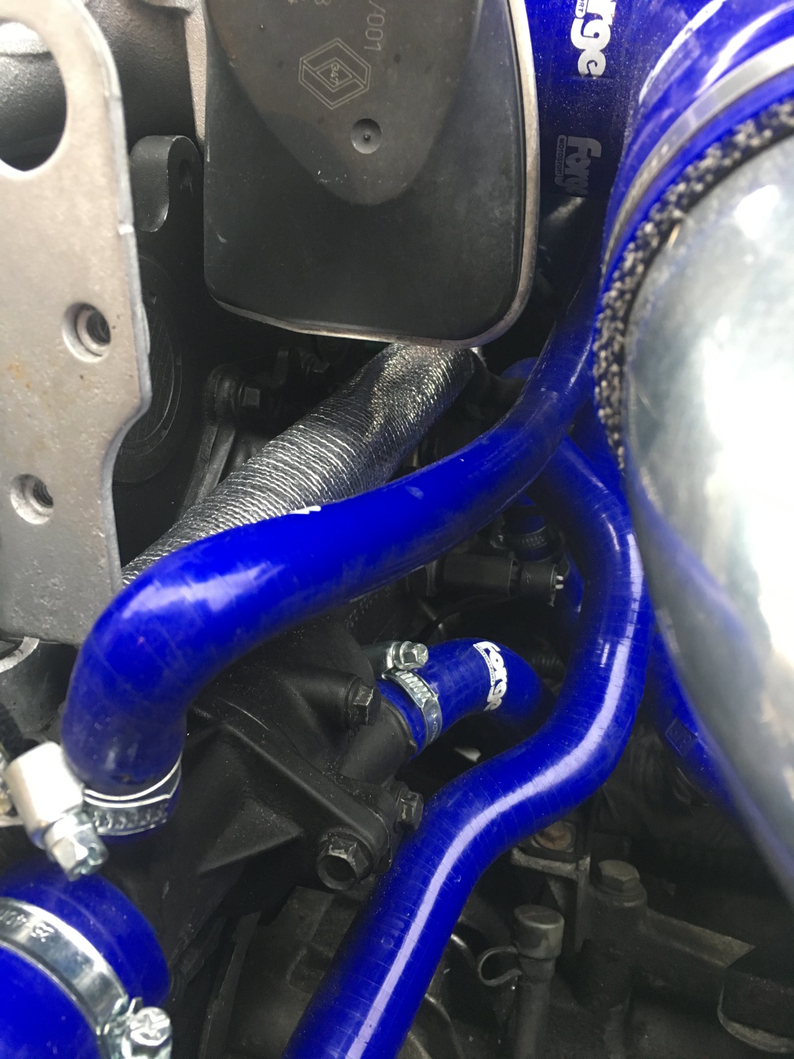

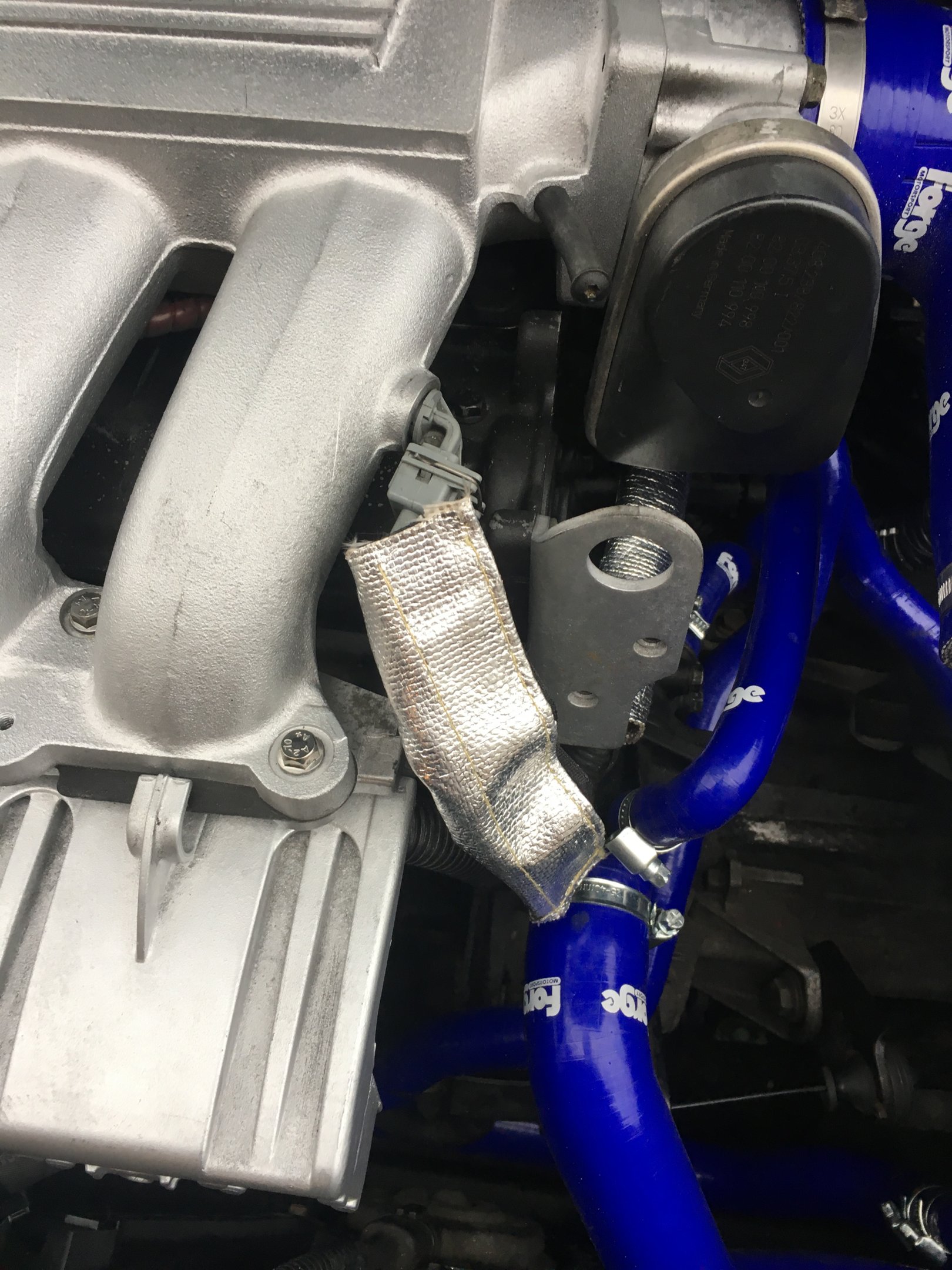

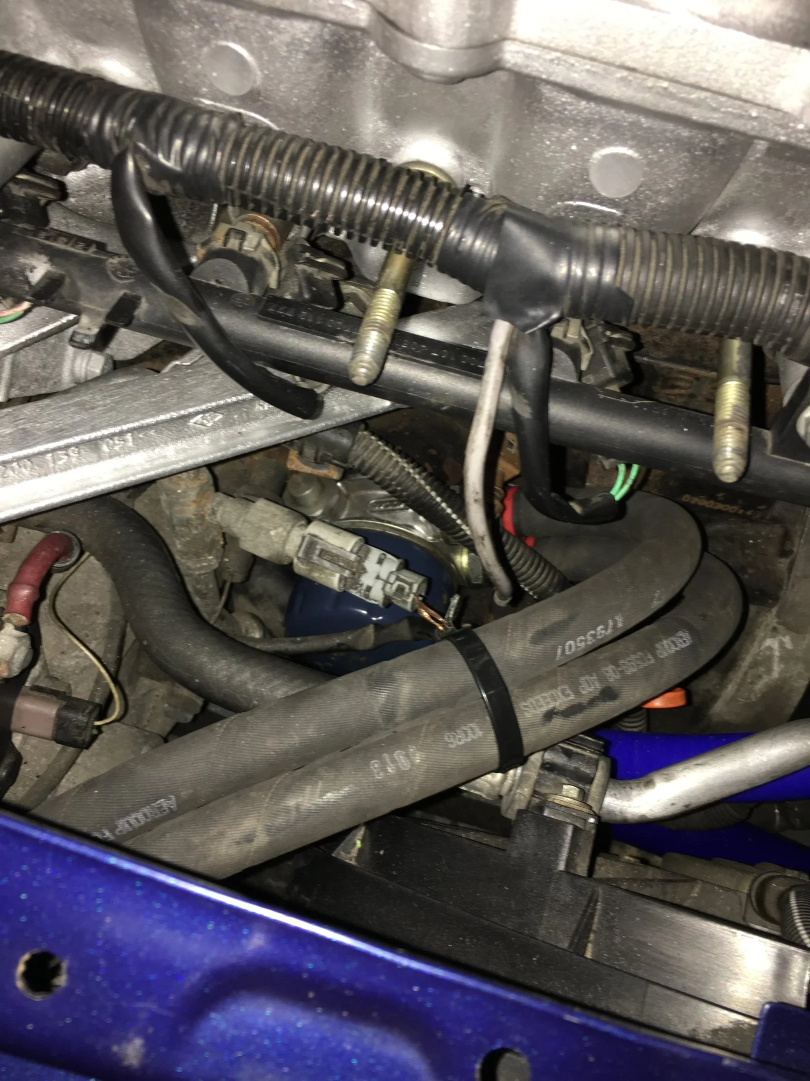

Thought I'd tidy up some of the cables in the engine bay using the heat protective sleeve I bought for the heater hoses.

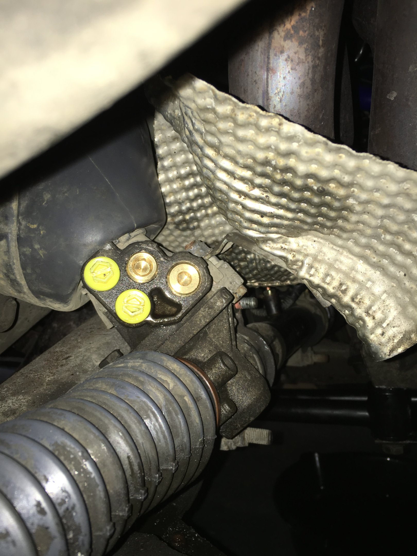

I finished blanking off my steering rack today had a nightmare removing one of the pipes from the rack which are looped! Just got to put my column now.

Yeah I think all them pipes are a nightmare! I bought some stubby spanners a couple weeks ago which really came in handy!

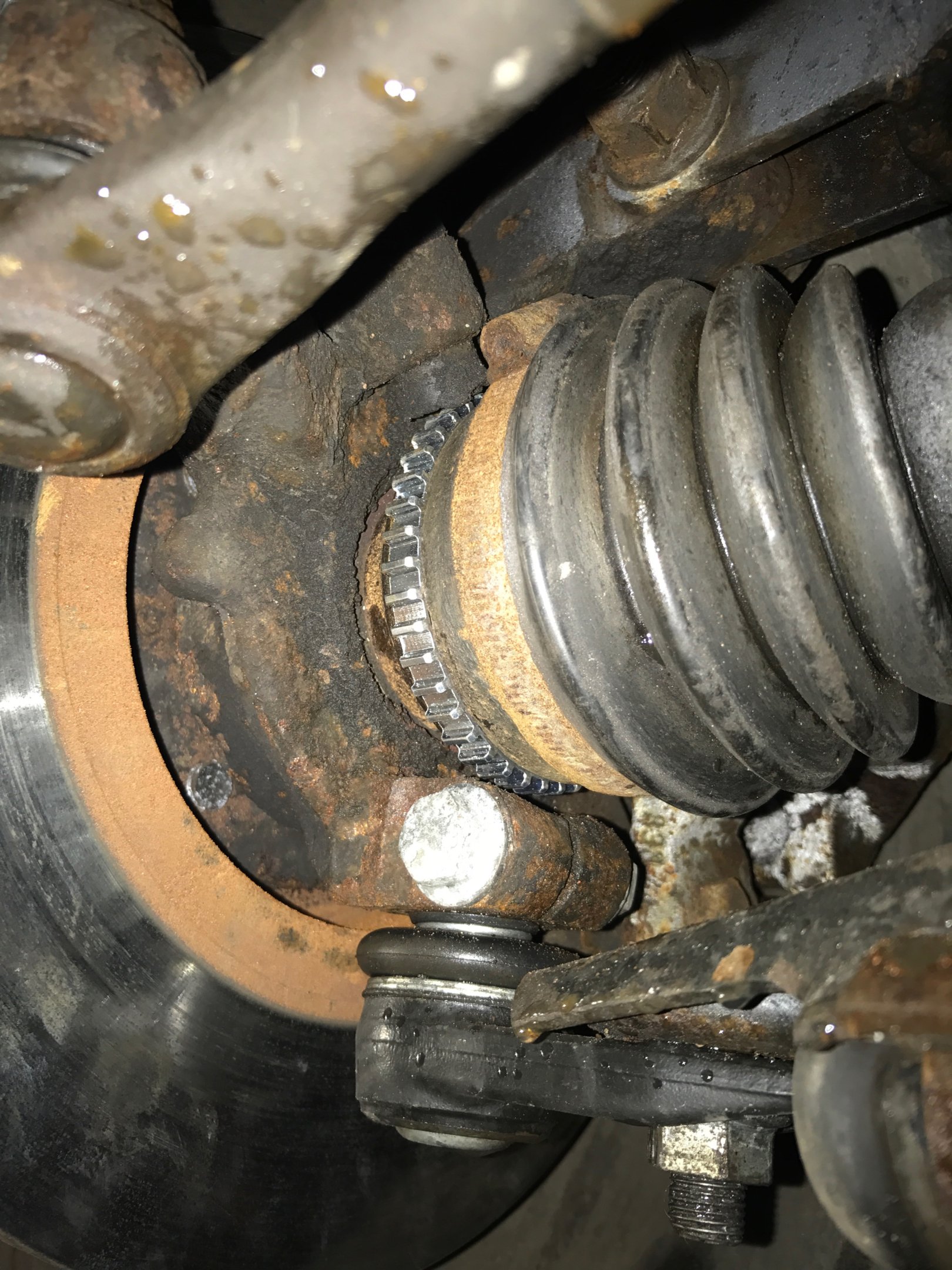

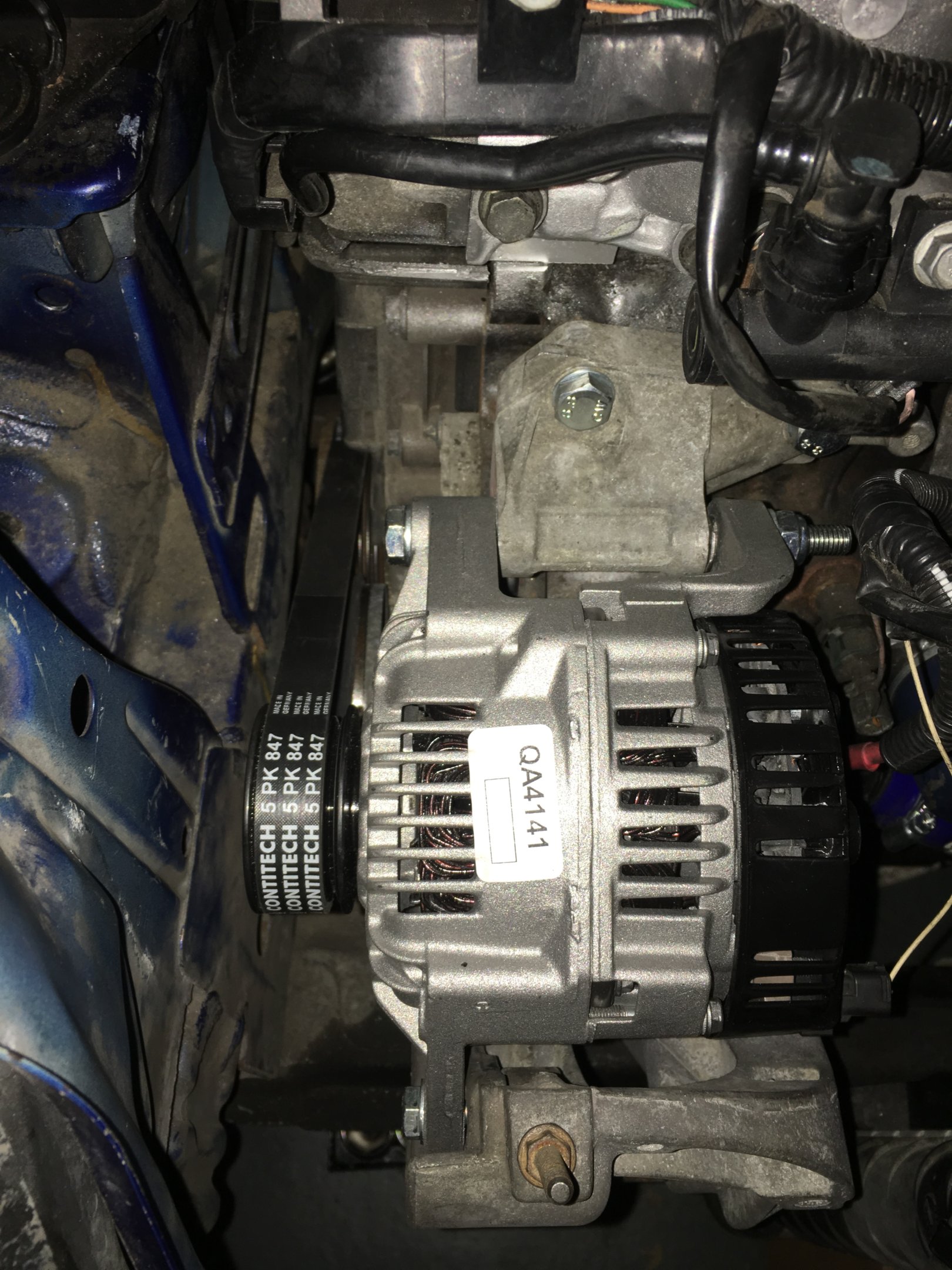

I mentioned in the last update I needed to replace my hub well that's been swapped and definitely needed changed.

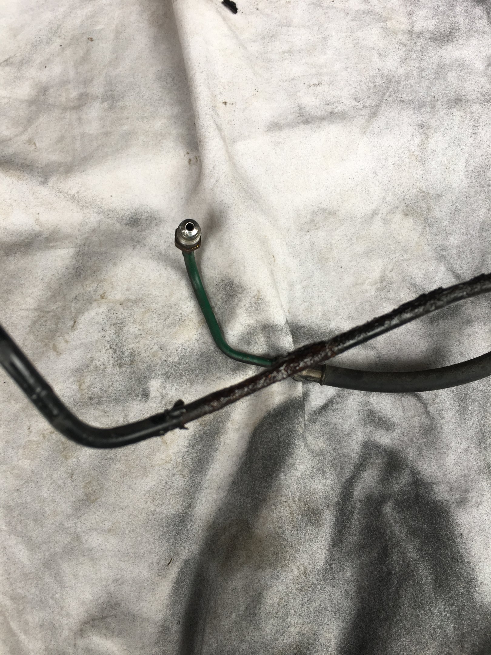

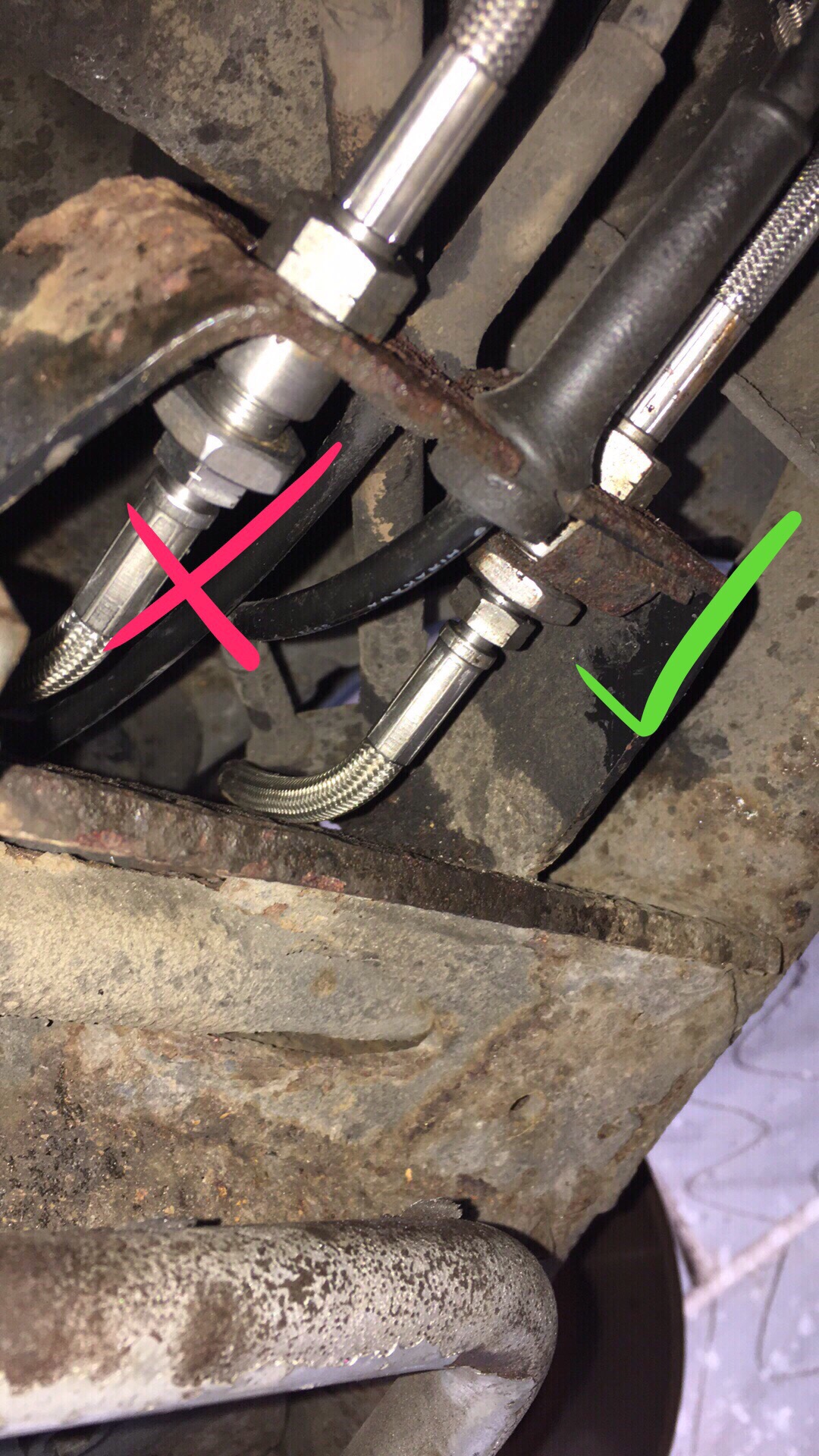

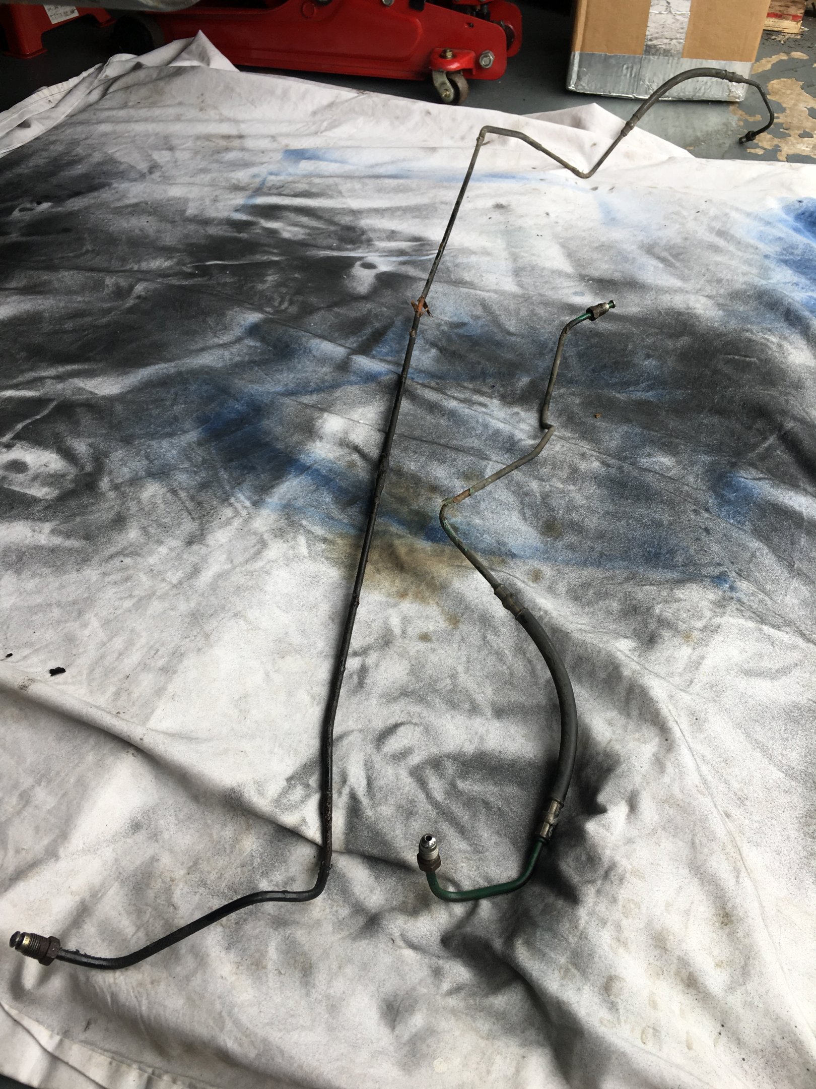

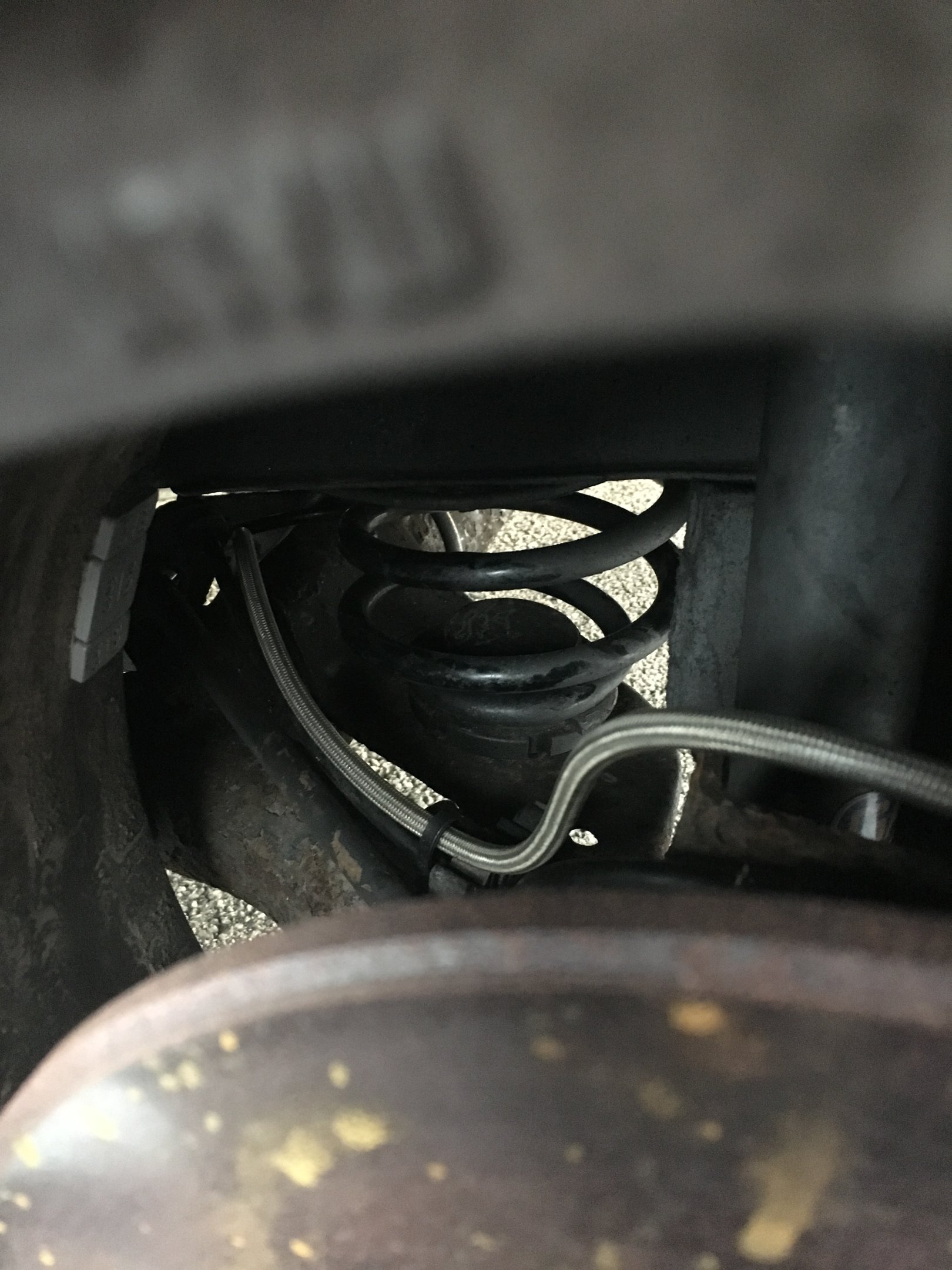

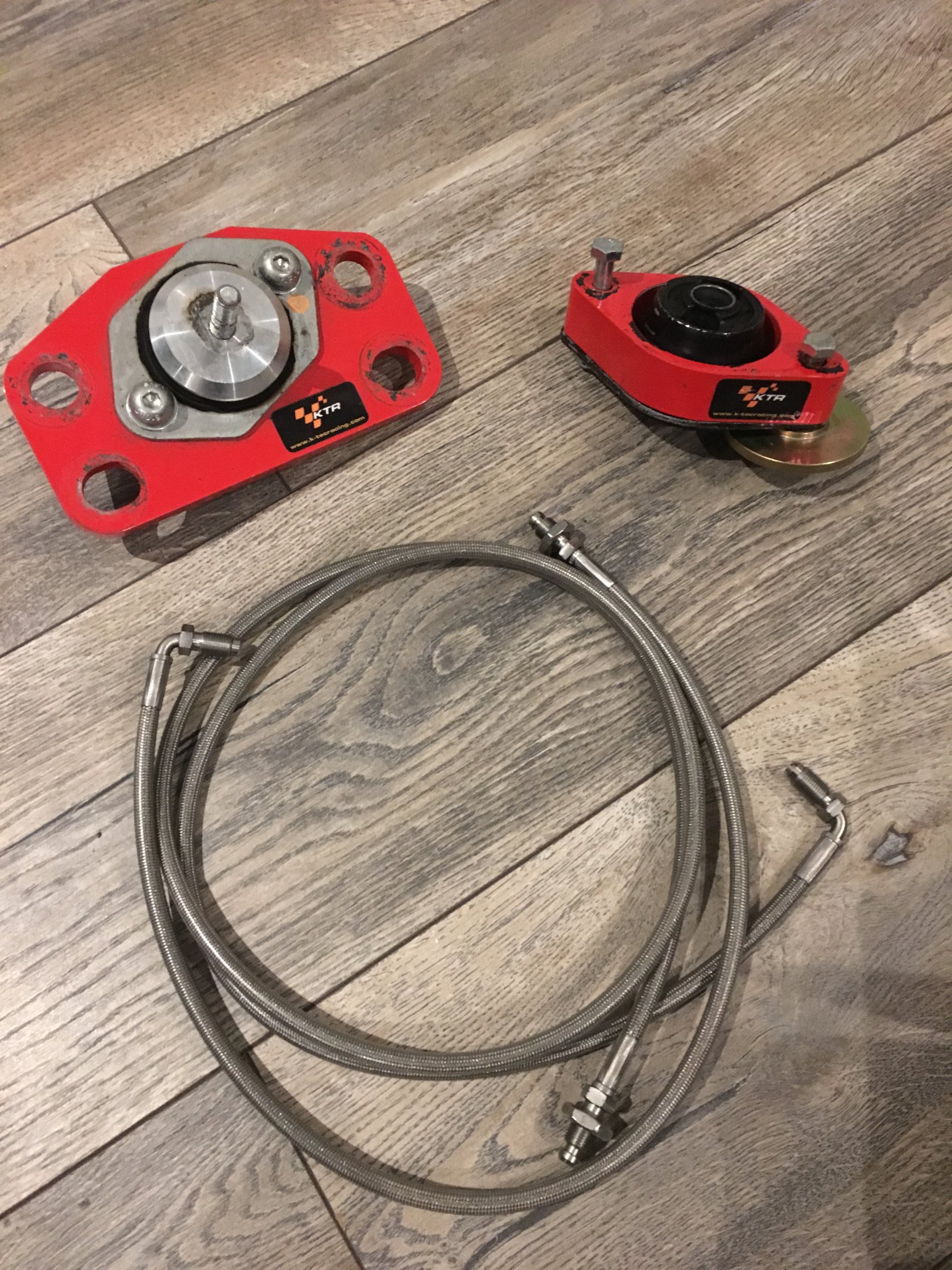

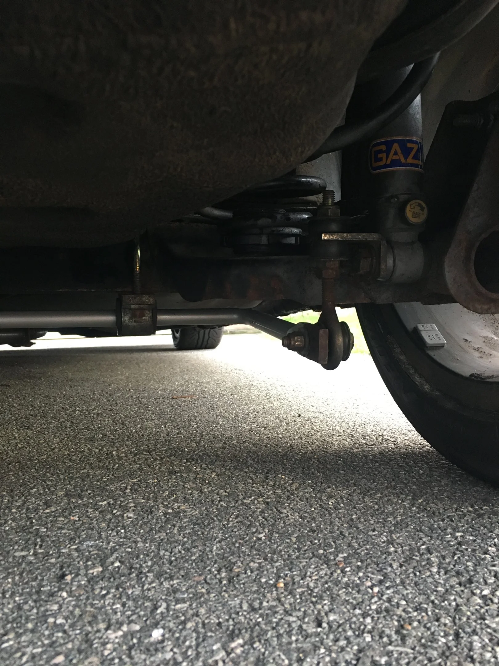

Noticed whilst fitting my Whiteline rarb the solid rear brake line that runs along the axle was corroded, so bad when I moved it out the way it started to leak. Spoke to Pro-line motorsport who sent out some replacements super fast. Fitted them today and I'm very happy heard some good and bad things about their service but I was more than happy. Wasn't sure on whether the standard brackets were needed so contacted Mitch who was more than helpful.

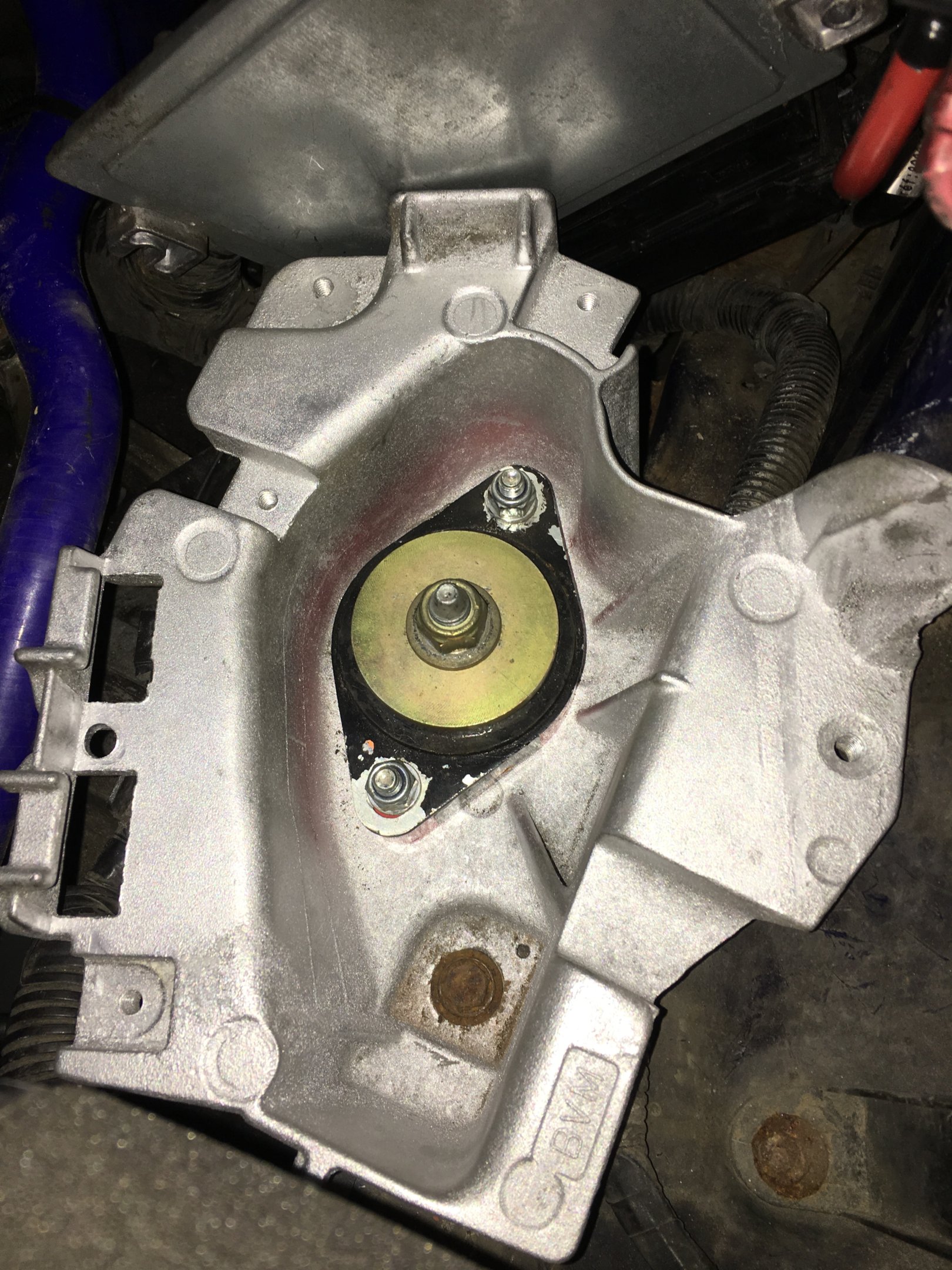

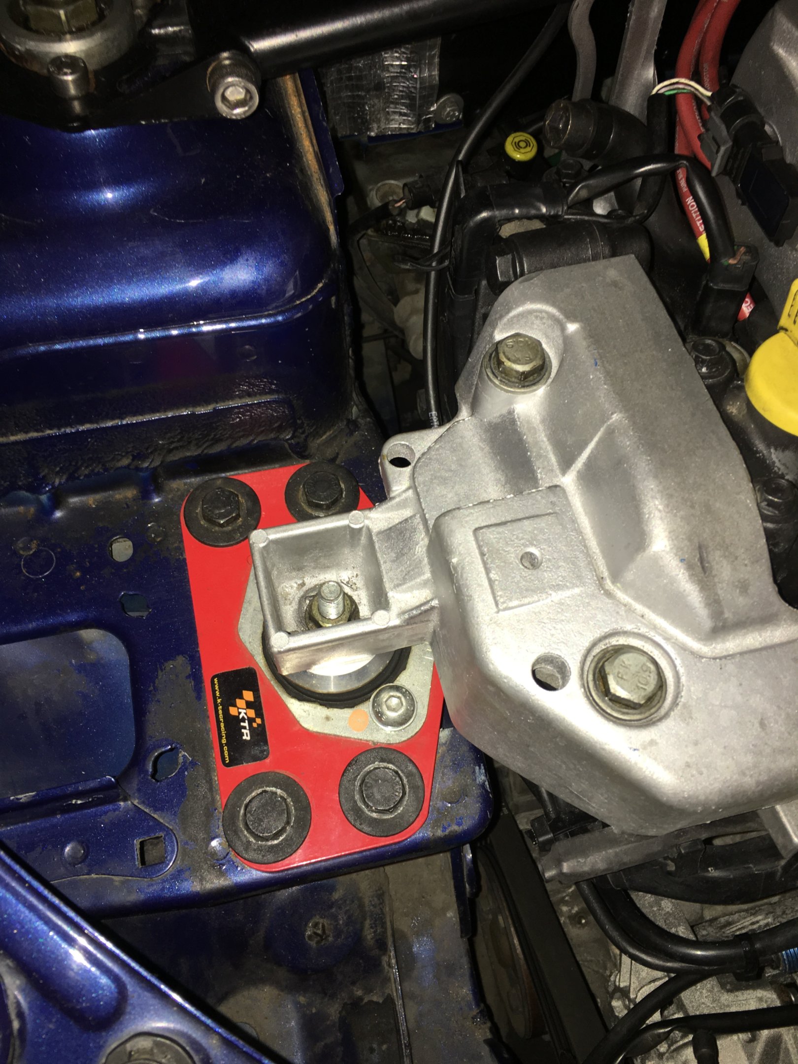

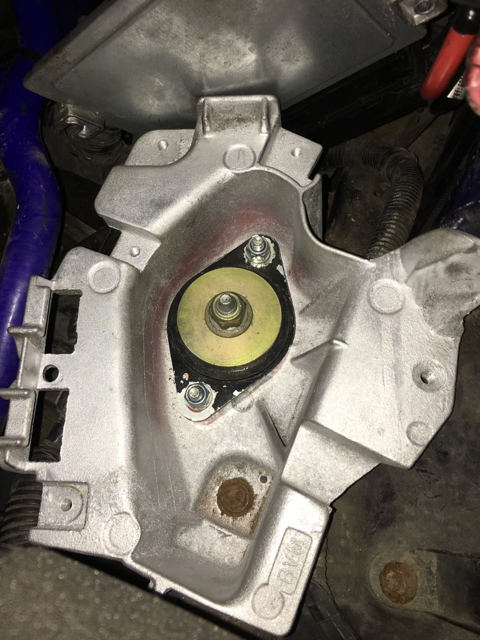

Thank you to @Sonic Boom for his Ktec competition engine and gearbox mounts, went on with no issues and look basically brand new!

How do people go about torquing the rear strut damper bolts when fitting a Whitline? I ended up jamming a 14mm spanner between the axle and L-shape bracket on the N/S to stop it spinning and on the drivers I just guessed where to put the bracket so it ended up in the correct position when tight.

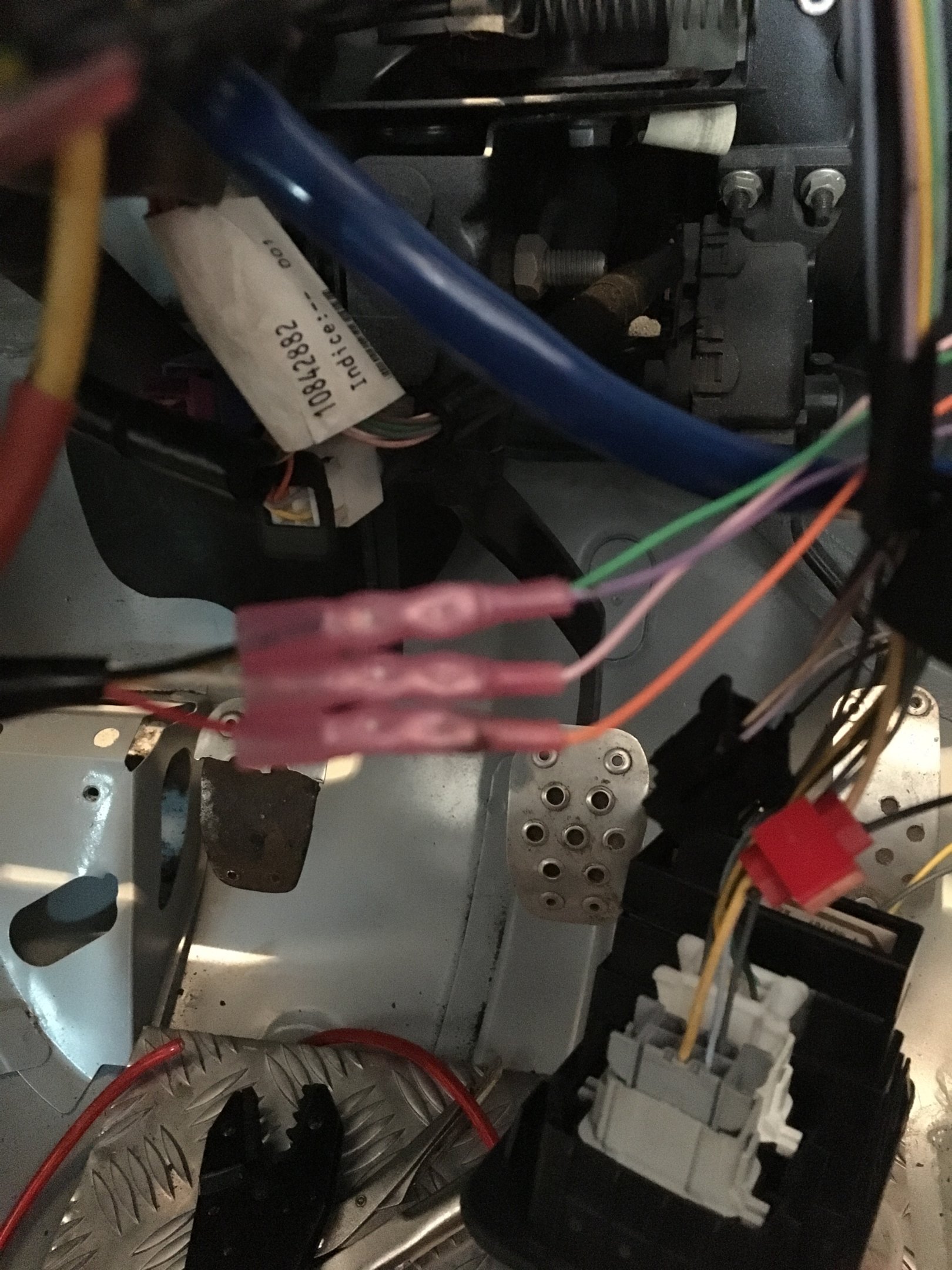

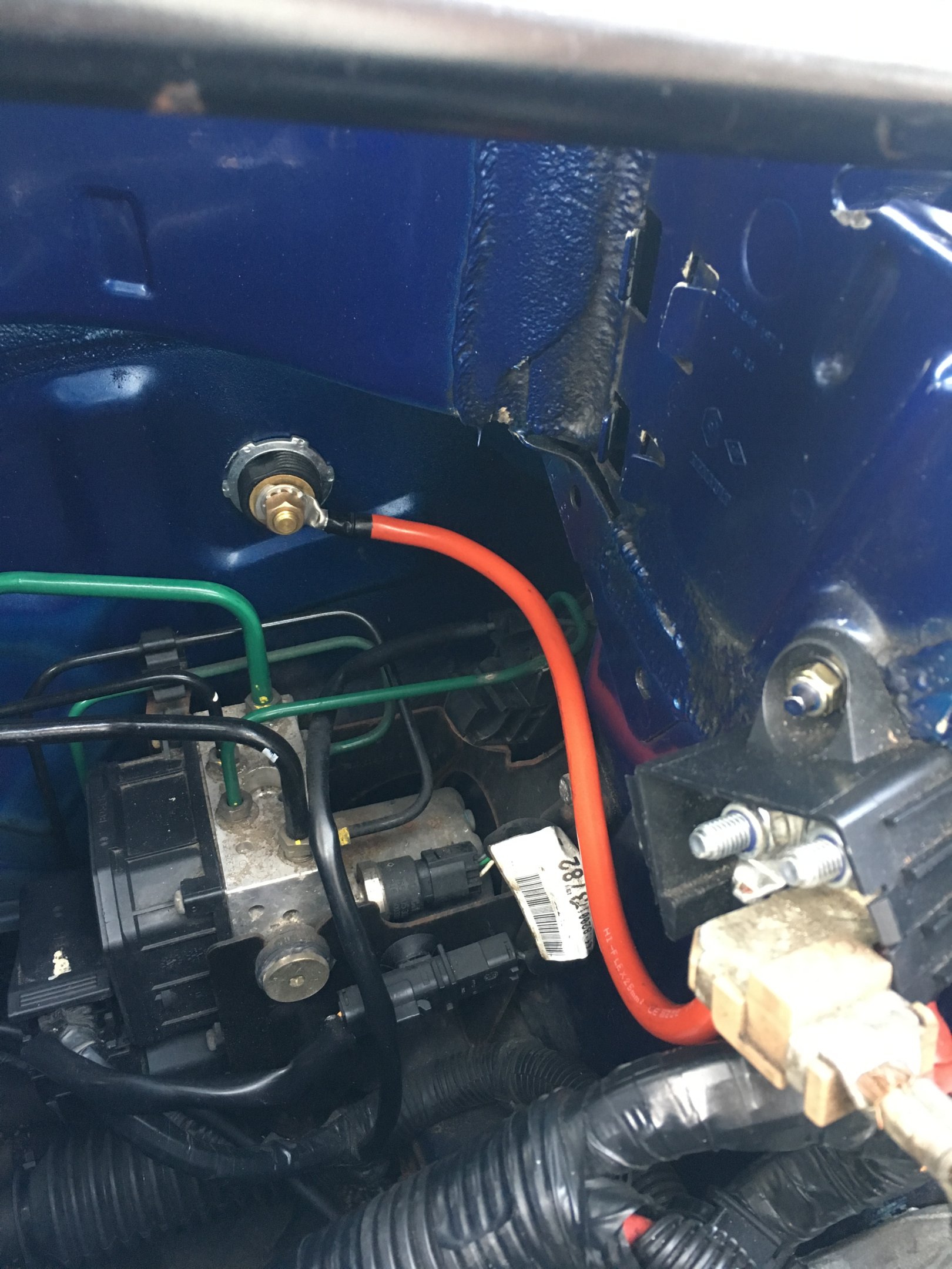

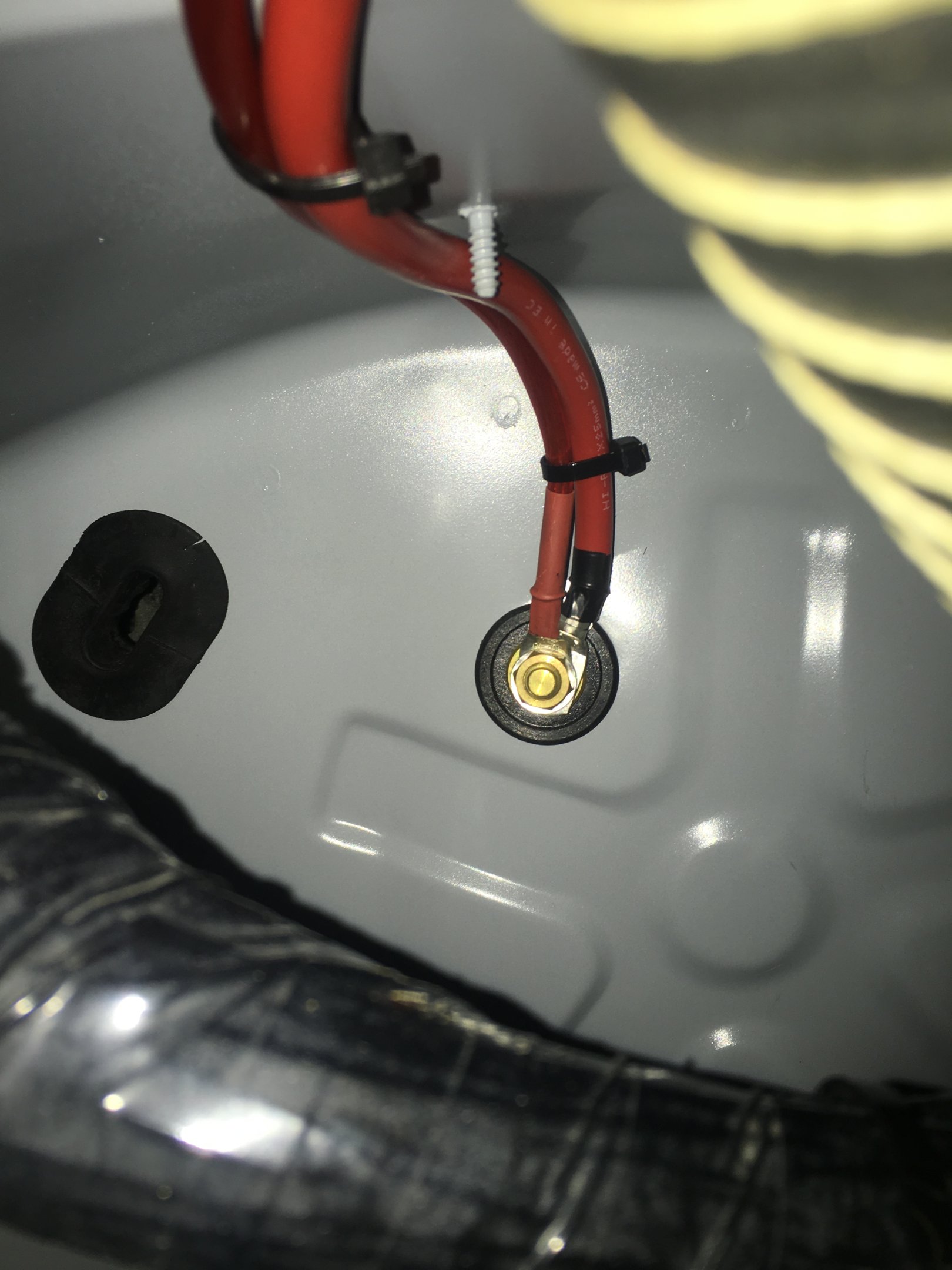

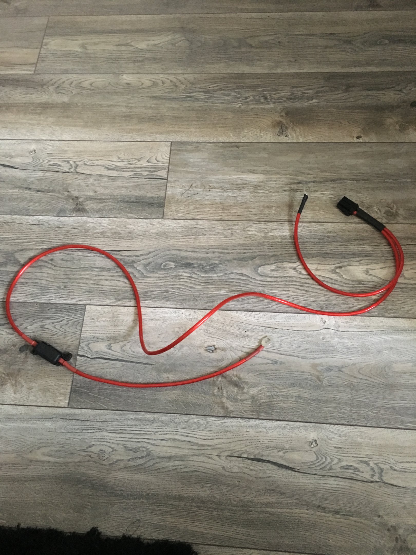

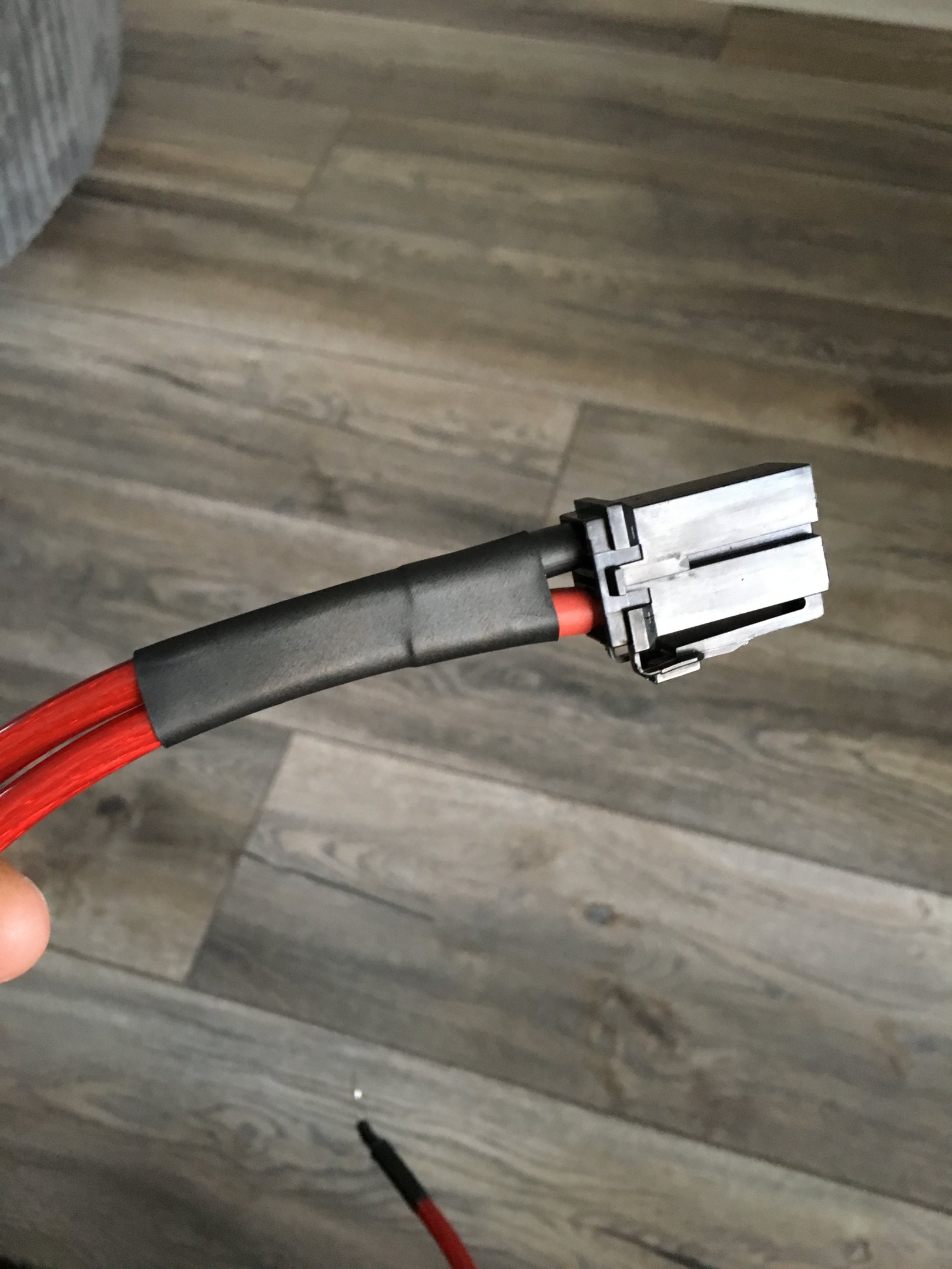

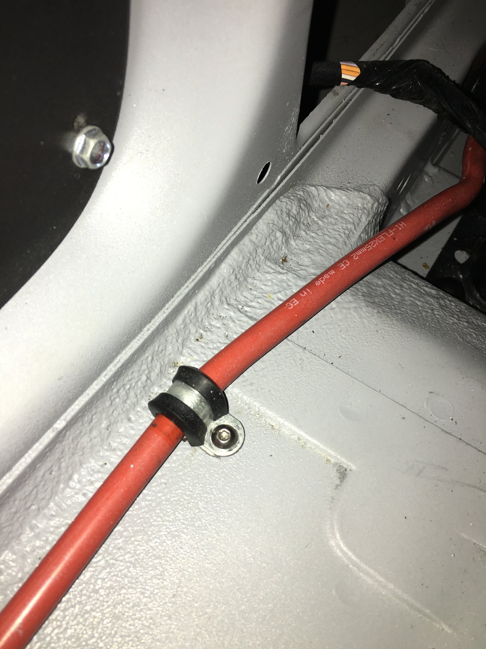

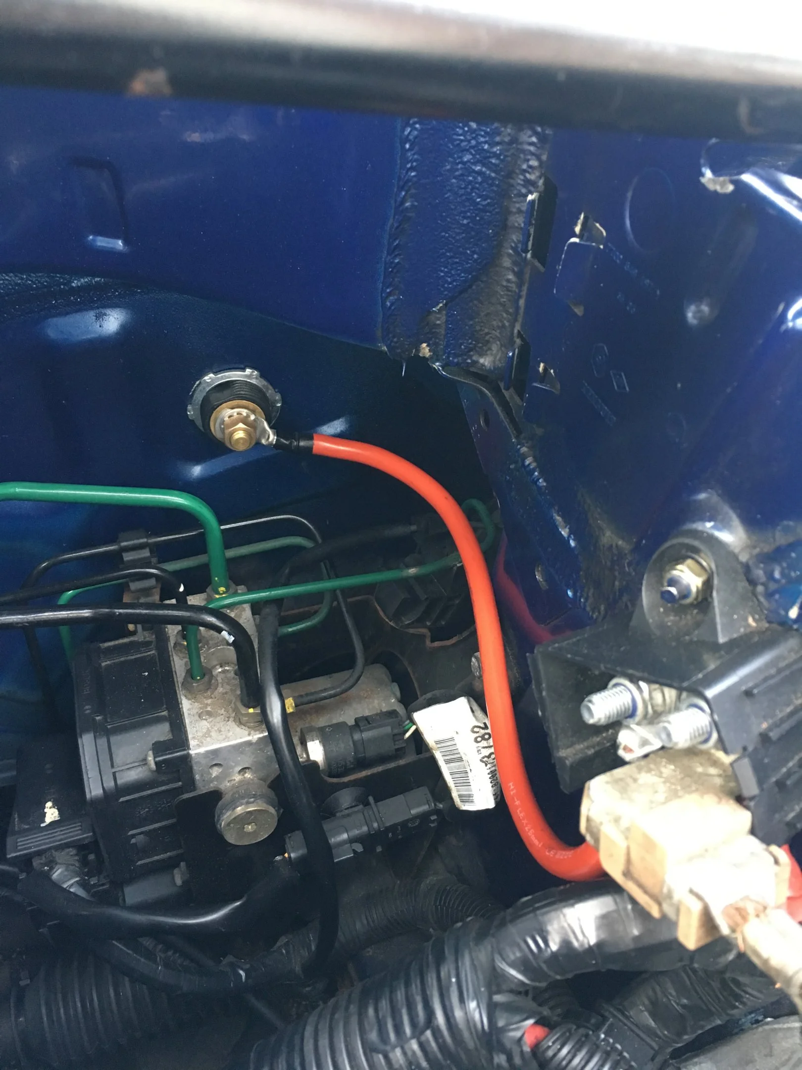

Forgot to mention I bought a Longacre bulk head adapter in the process of fitting my EPAS, seemed silly running two power cables from the cabin into the engine bay.

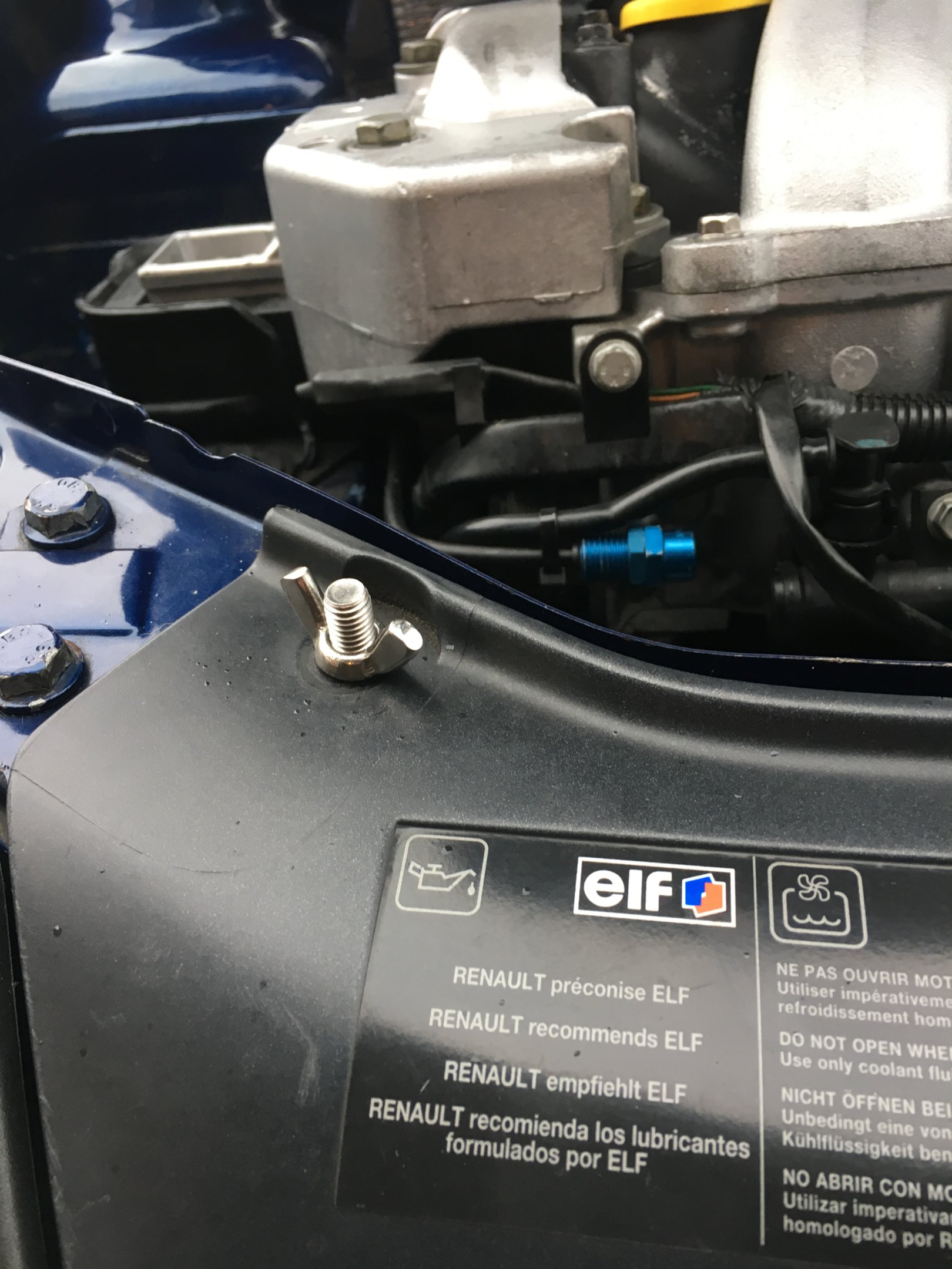

Hate using the standard Renault trim plugs so replaced them with a couple bolts and wingnuts.

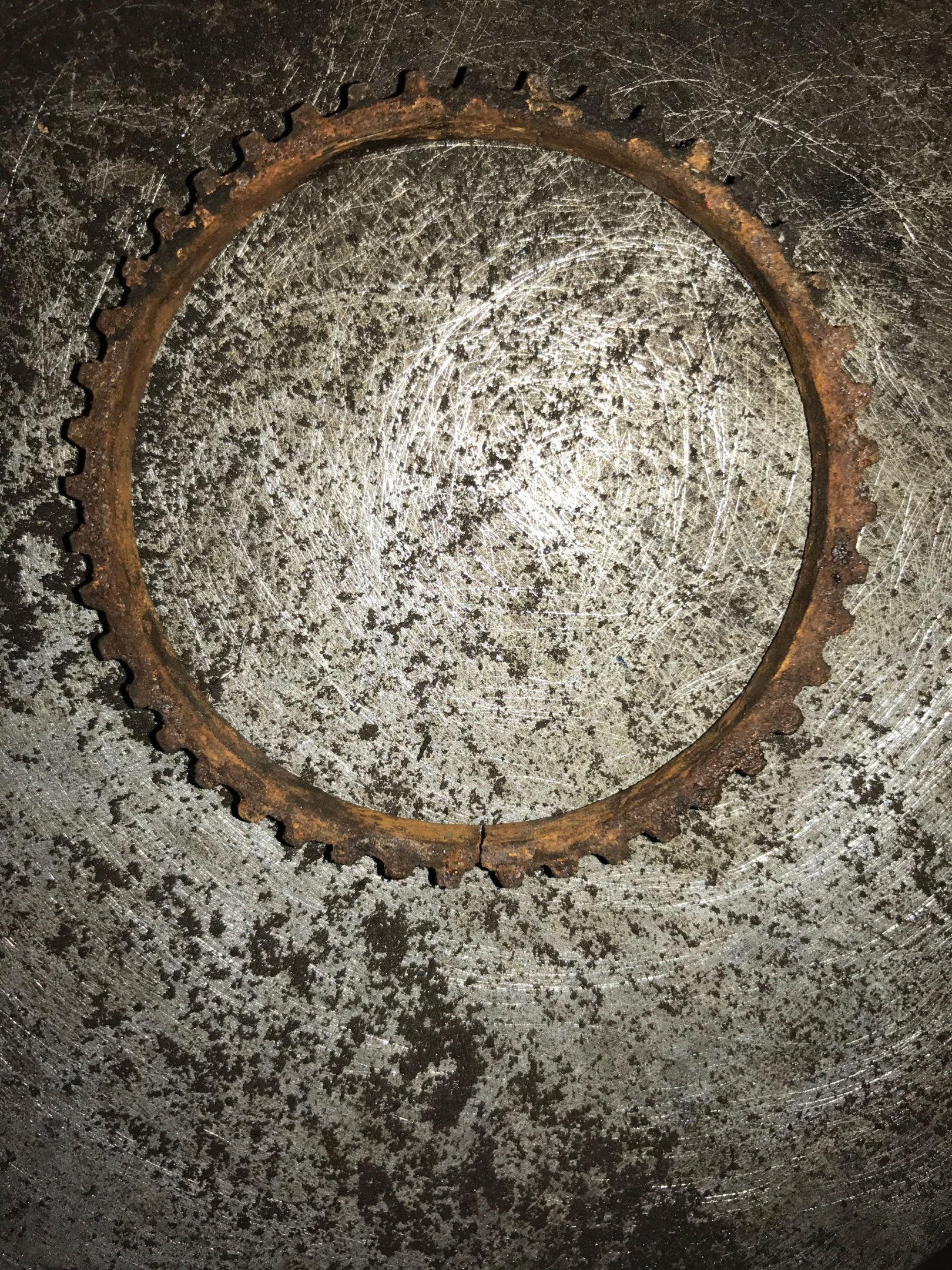

Changed both ABS rings as I could feel it kicking in when coming to a slow stop. I was greeted to a nice crack on the O/S ring so nice cheap fix.

I HATE the Longacre bulk head adapter !, its an exposed LIVE terminal surrounded by everything that's earthed ! Much better to run the cable through the bulkhead sealed with a grommet.
Cheers, yeah I have thought about that, I was just going to order a plastic cap for the nut and insulate the exposed areas of the terminals.

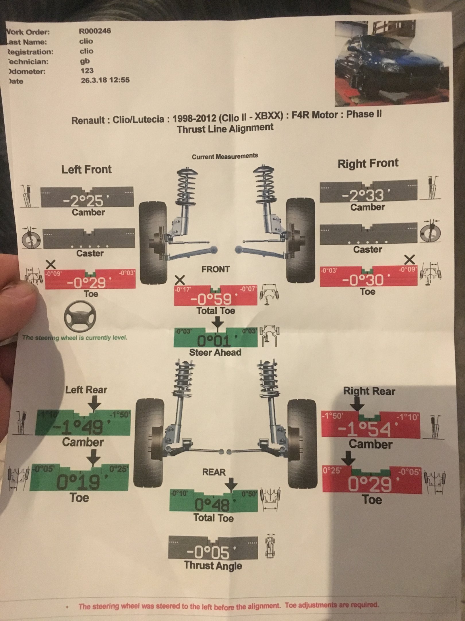

Finally got the Clio aligned today, after doing some searching on here I asked for the camber to be set between 2-2.5deg and around 5 minutes toe out either side.
Looking at the printout I'm not 100% sure that's what I've got, would be nice if someone could give it a look over for me.

Spoke to the garage who did my alignment and the guy got mixed up with what I asked, he thought I wanted .5mm each side rather than 5 mins so going back tomorrow to get it sorted.

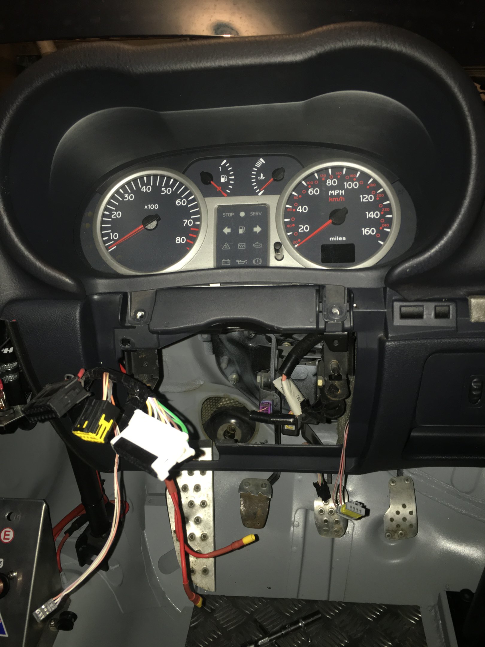

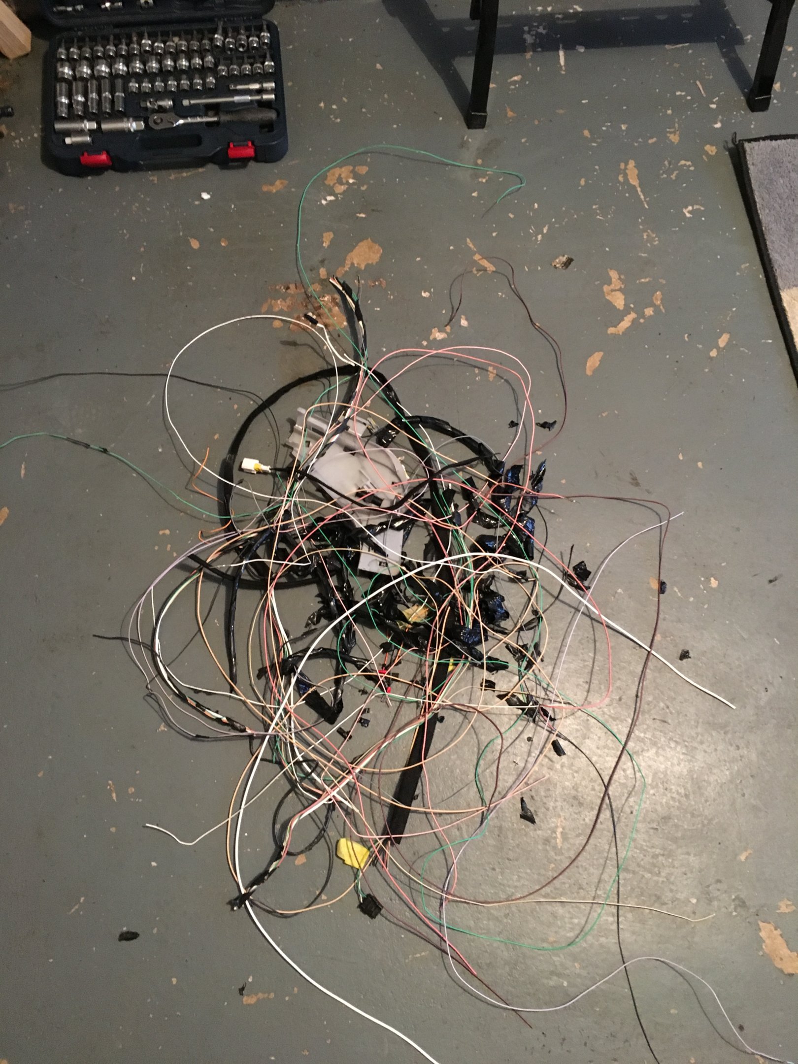

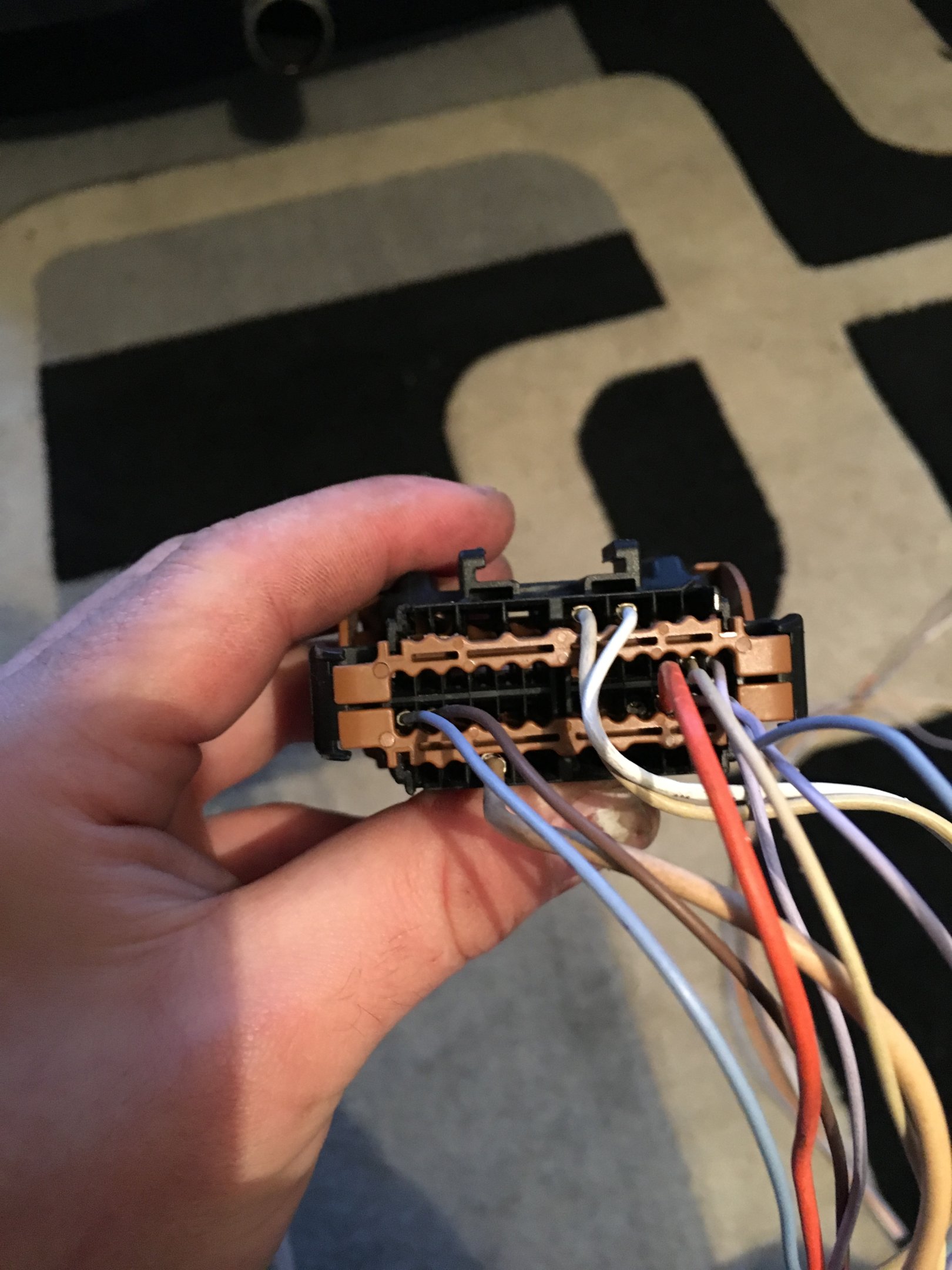

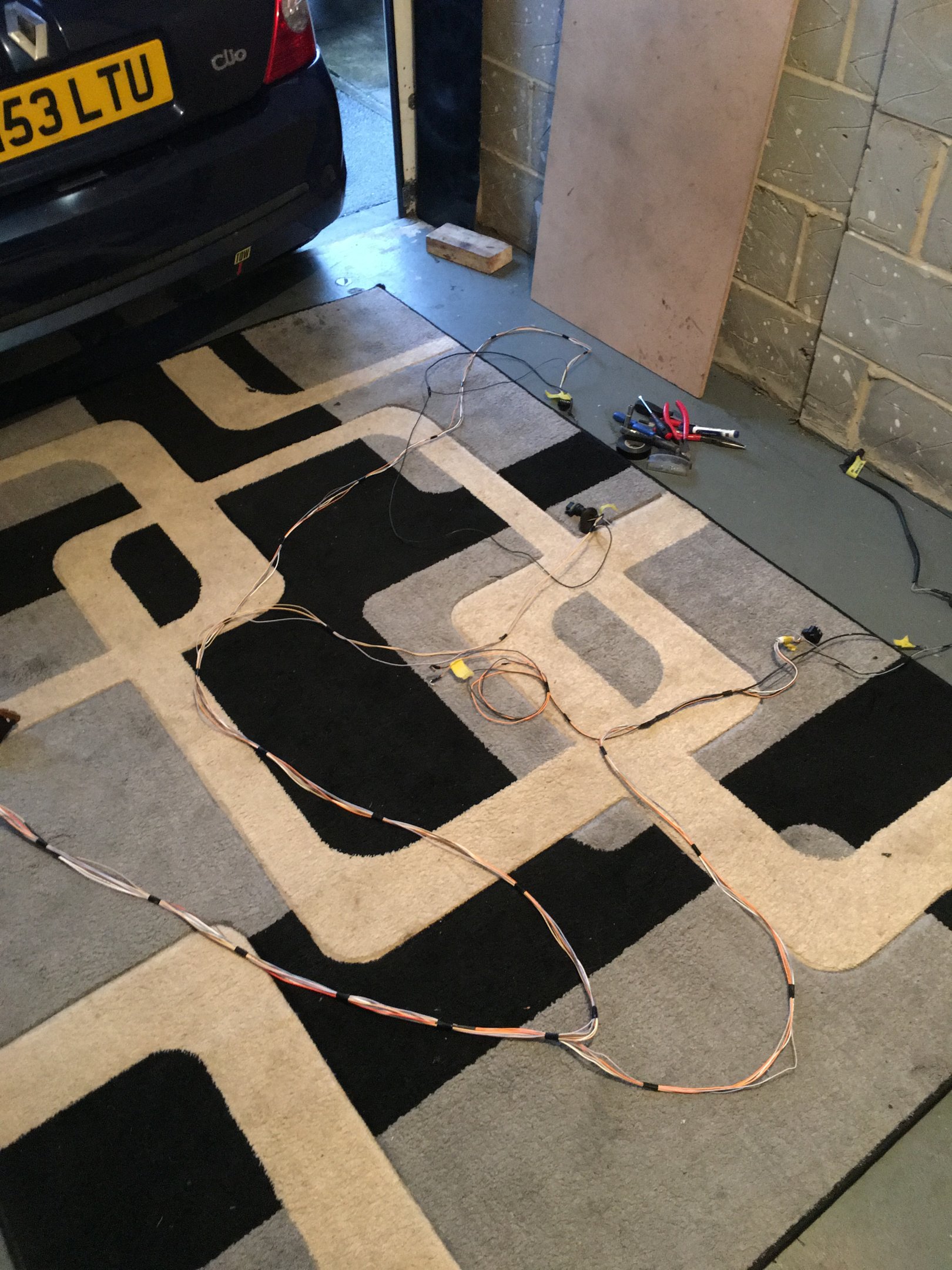

Made the most of the terrible weather today and made a start stripping the looms back. Thought I'd start with the rear as it's pretty basic and once done I can trace the redundant wires back in the main loom from the plug. Wasn't too bad to be honest I think the worst part is getting the old tape off, and trying to stop the wires getting tangled.
Tested the loom back in the car and it works perfectly so I just need to re-wrap it in some raylon self self amalgamating tape, I also decided to get rid of the boot central locking as I have a set of Aerocatches to fit.
I'm going to tackle both door looms tomorrow as again they'll be pretty simply as it's only the central locking cables I want to keep. Then on to the main loom which I'm pretty nervous about, I've been pretty lucky as I've cut a few cables back and removed quite a lot of fuses so I know the car runs fine without them it's just a case of getting them out the loom without upsetting anything else.
