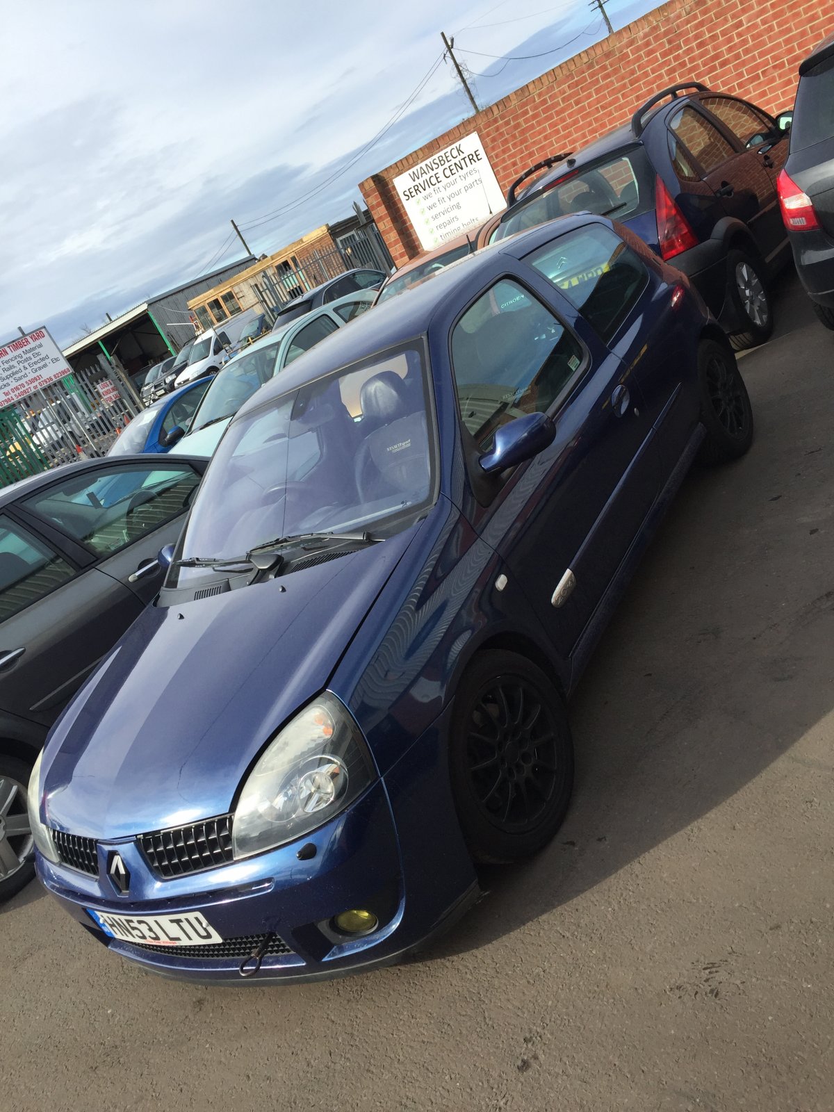

So this how it stood when I first bought it

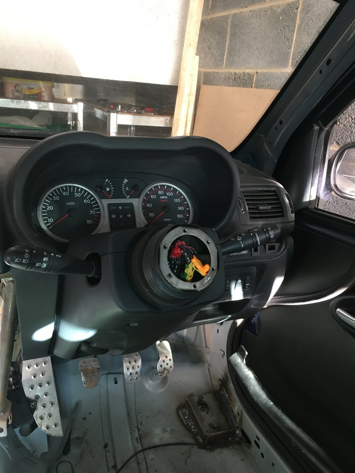

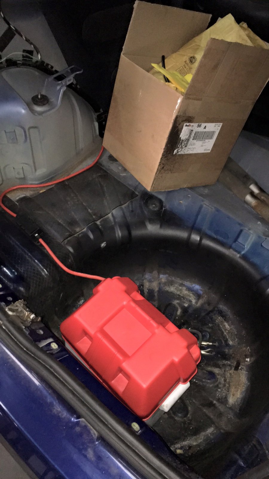

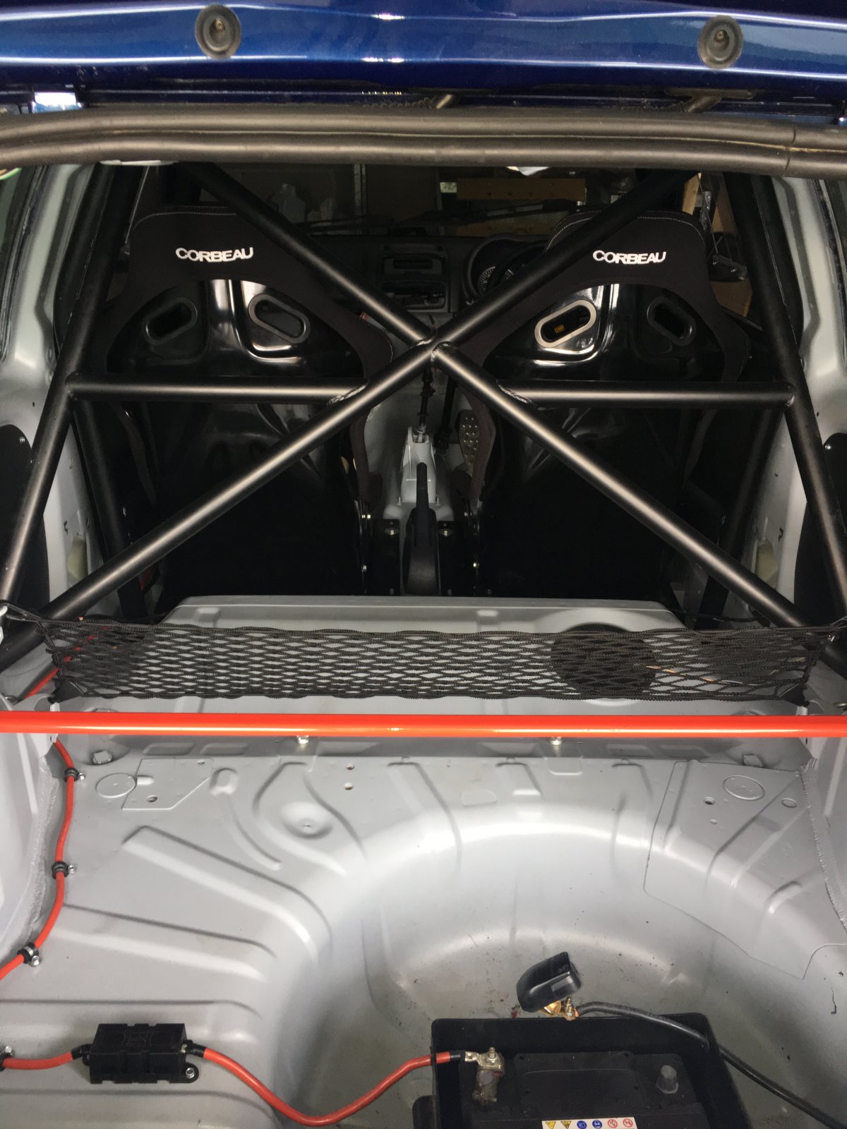

Then on with the mods, first one being the battery relocated to the boot.

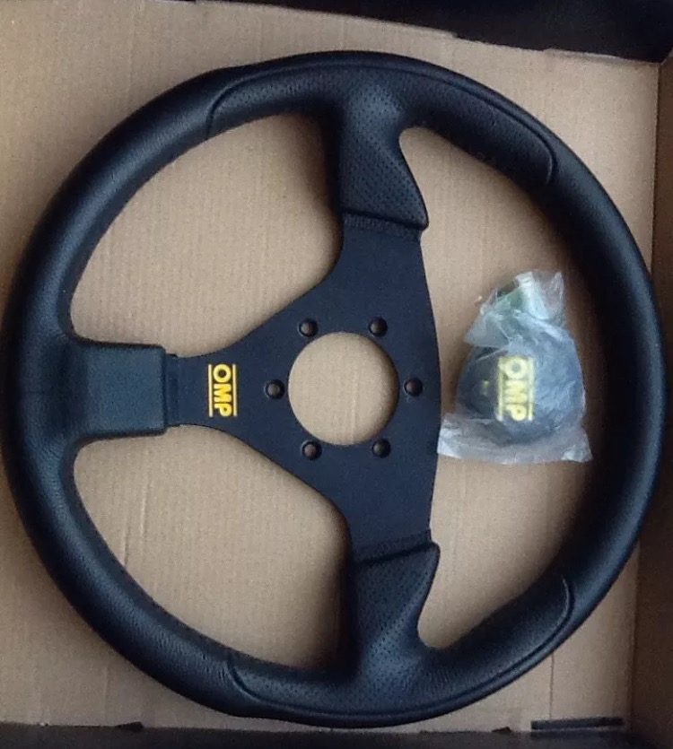

Picked up a momo boss and OMP wheel

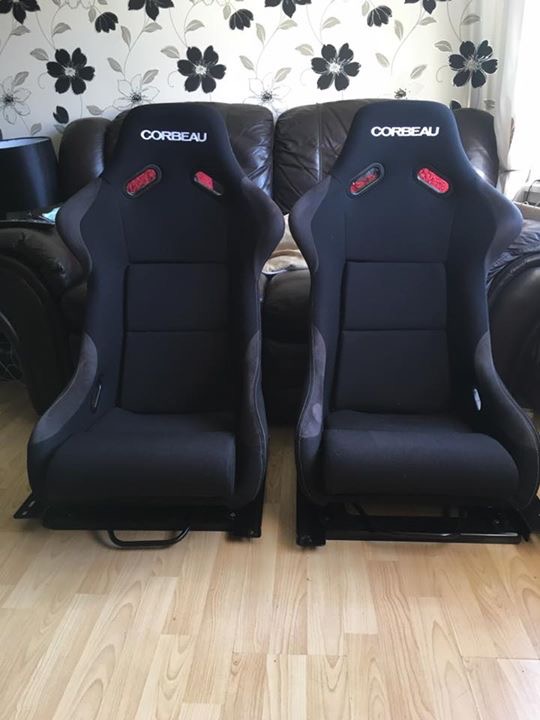

Jumped on a set of Jon foz low subframes and corbeau clubsports that came up for sale for £300

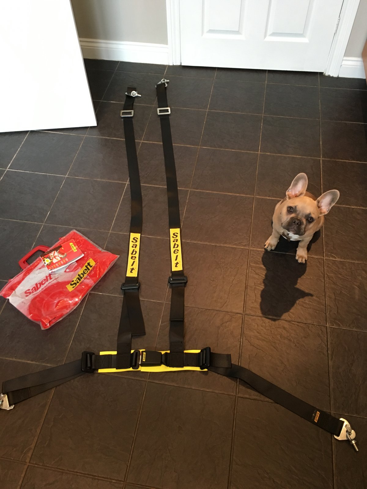

And a 4 point harness featuring our new arrival, I'll probably get rid of the 4 point for a set of 6 points but for £40 it means I can drive it between garages.

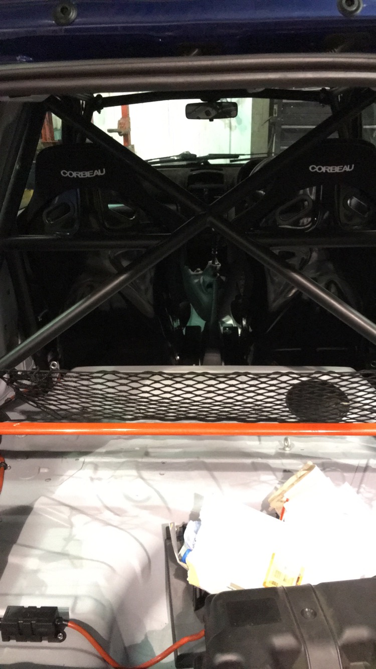

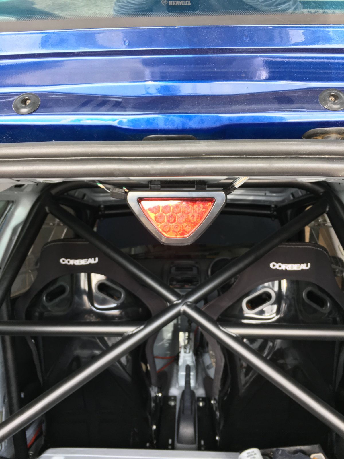

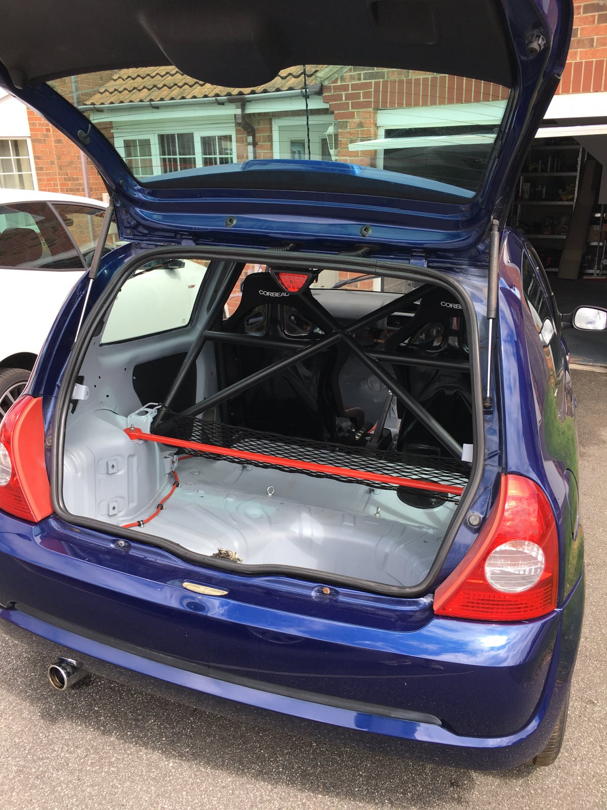

So we're up to Christmas now and I decided to treat myself to a full 6 point Safety device cage with a fixed cross on the rear. Not the greatest photo but you get the idea.

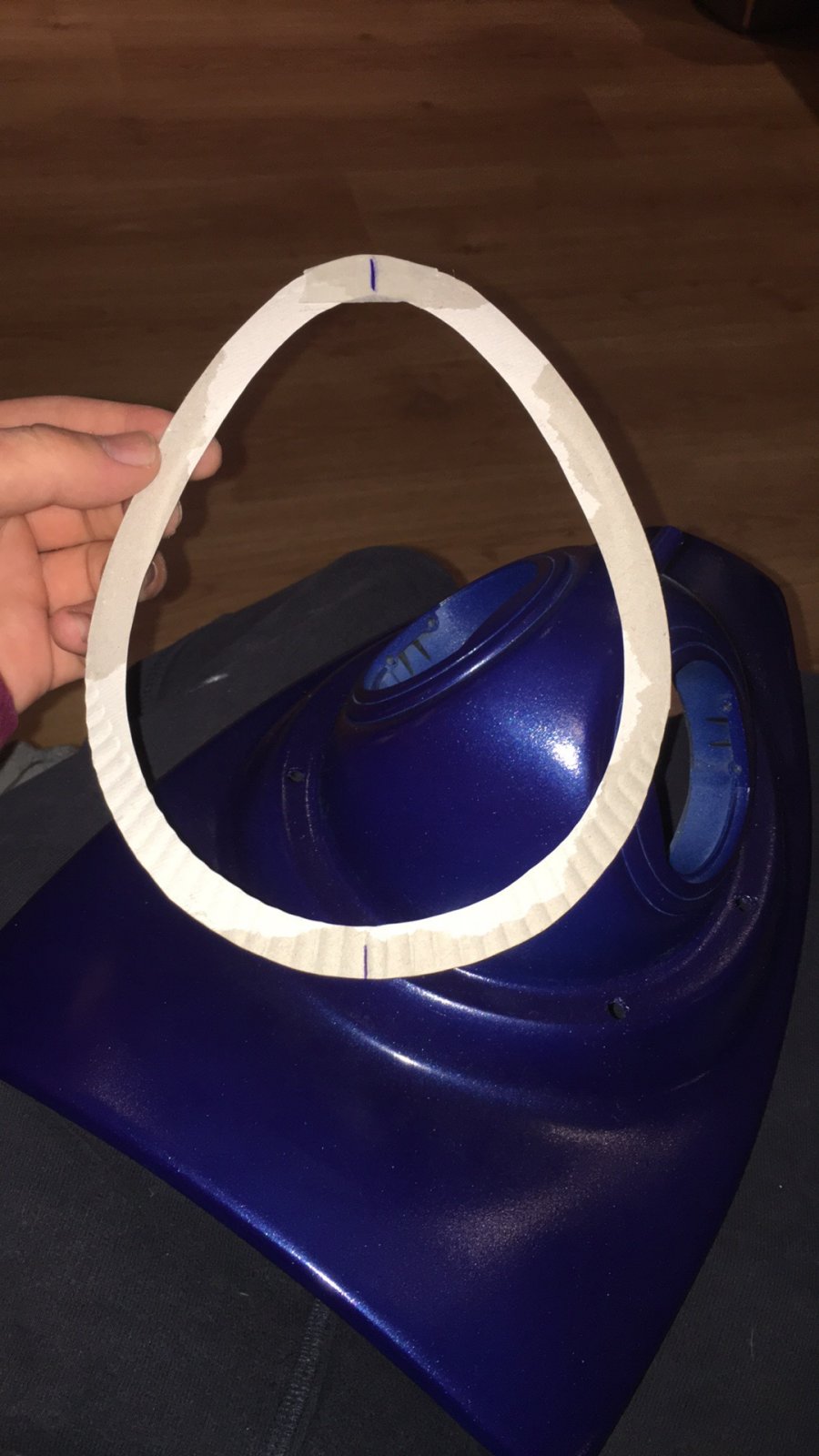

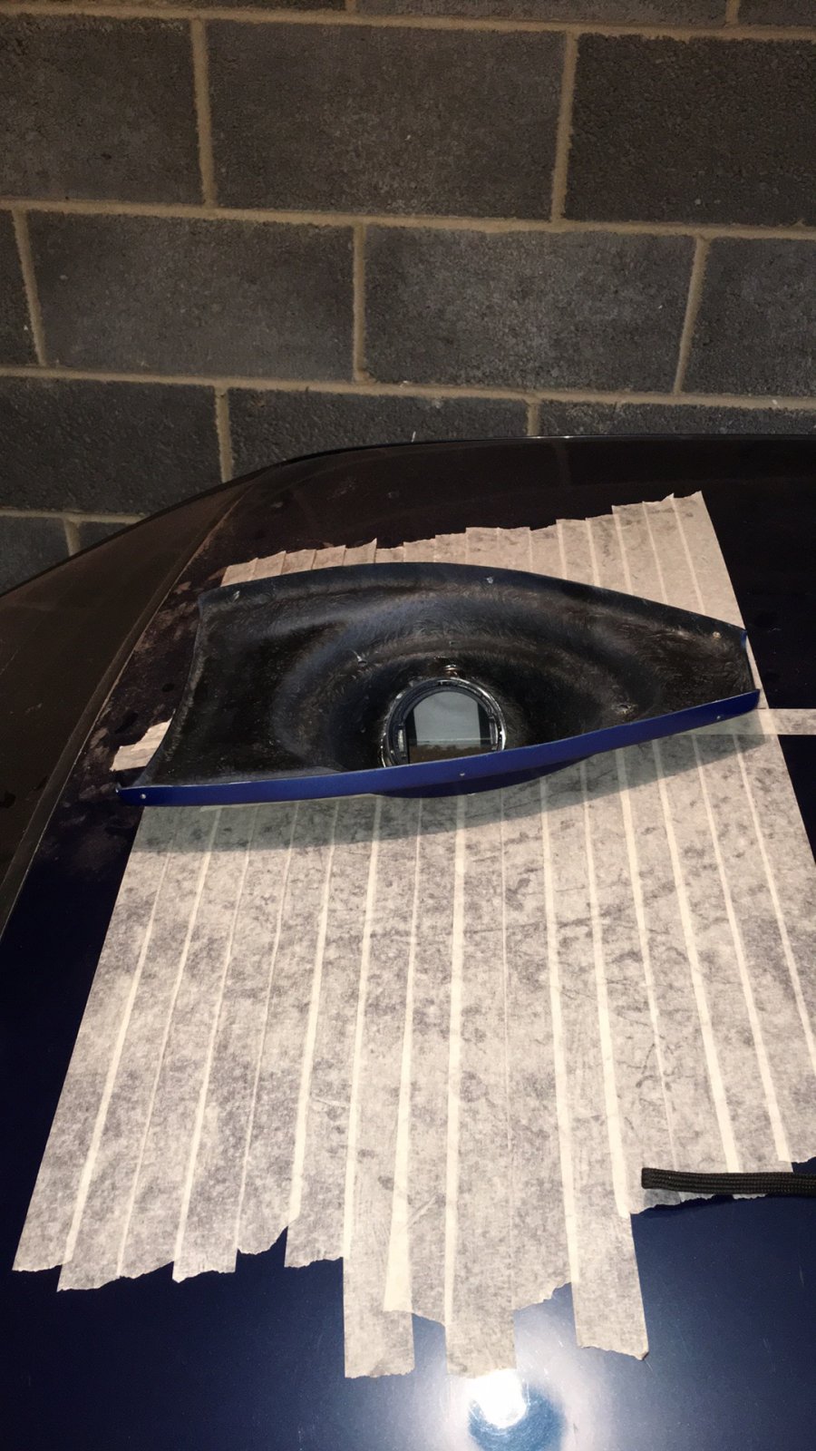

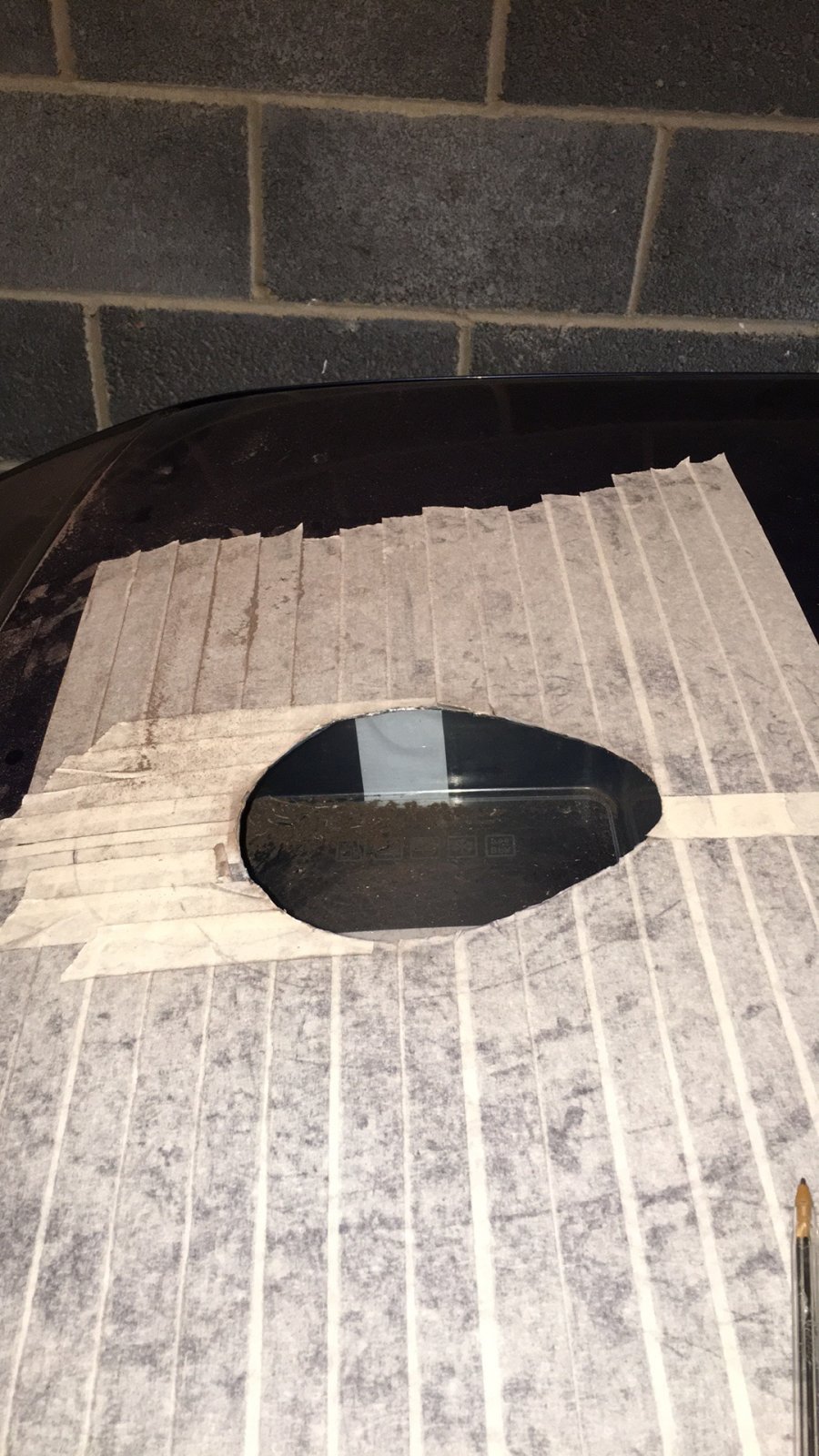

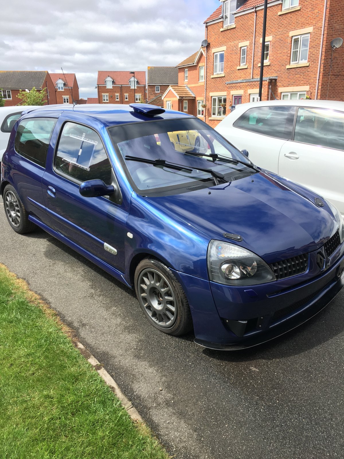

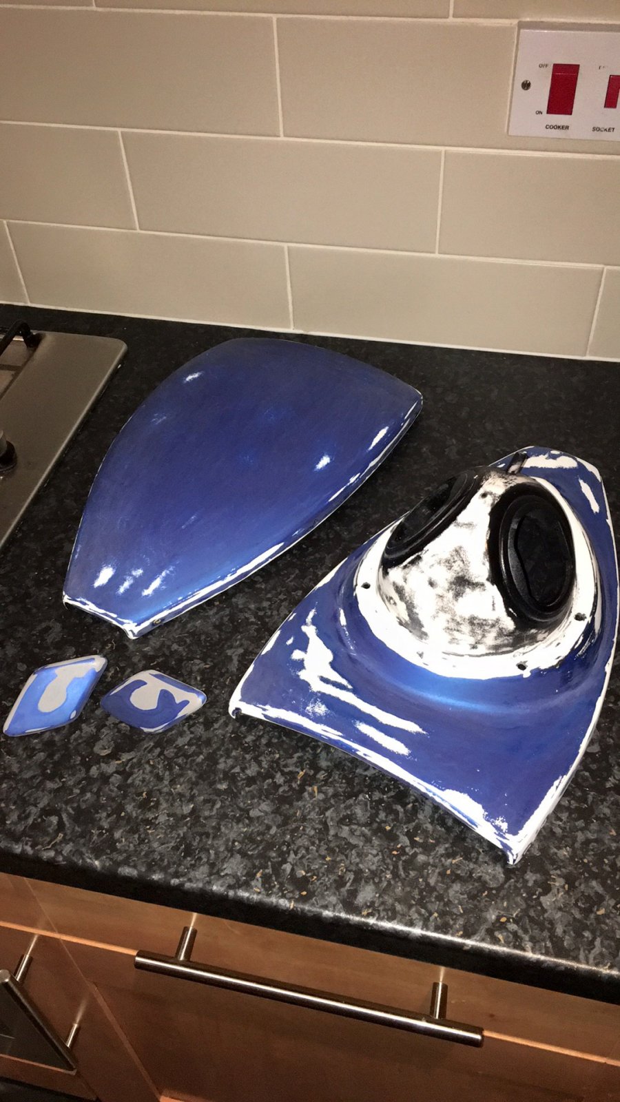

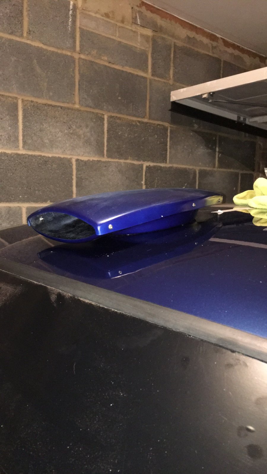

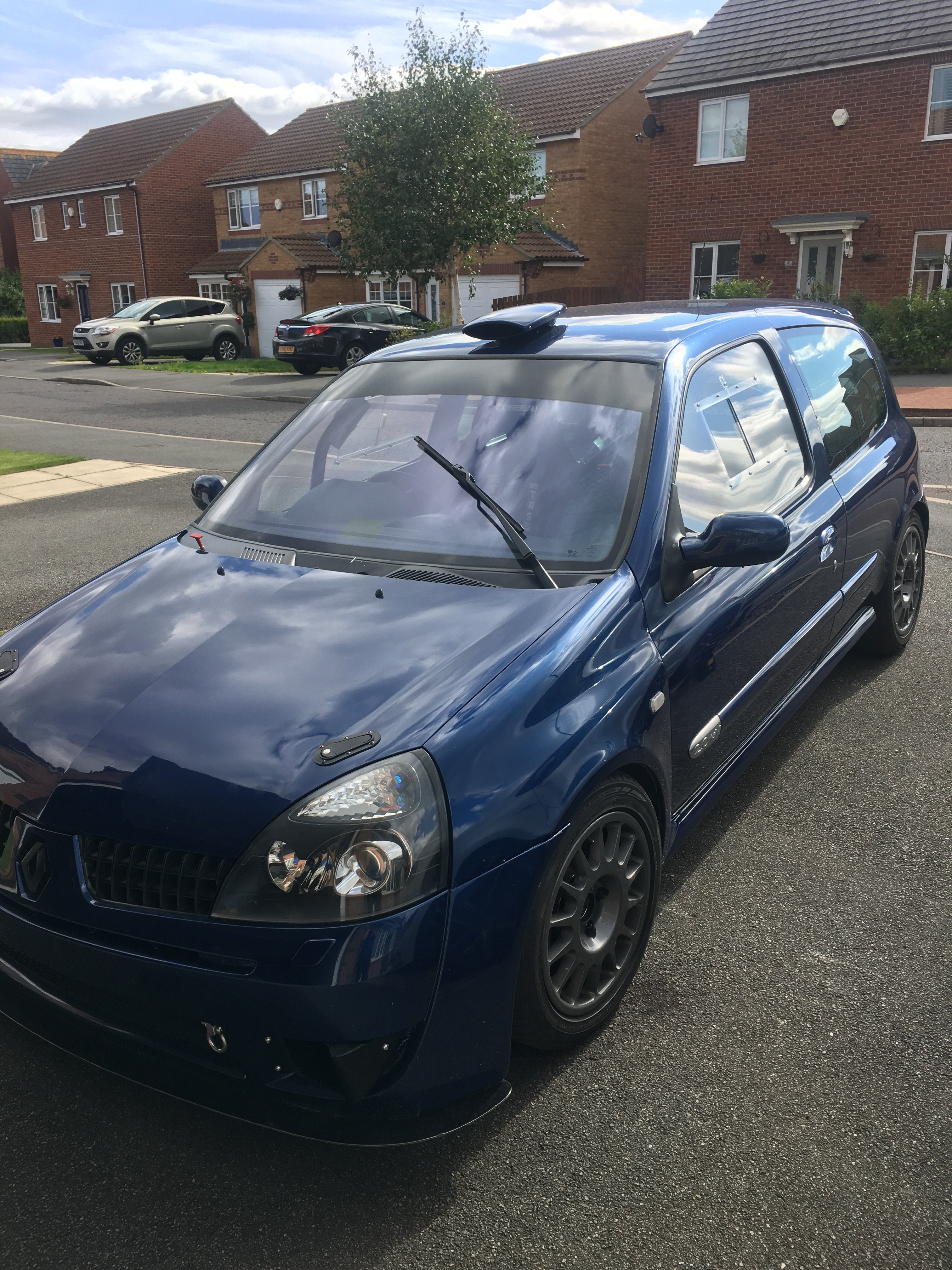

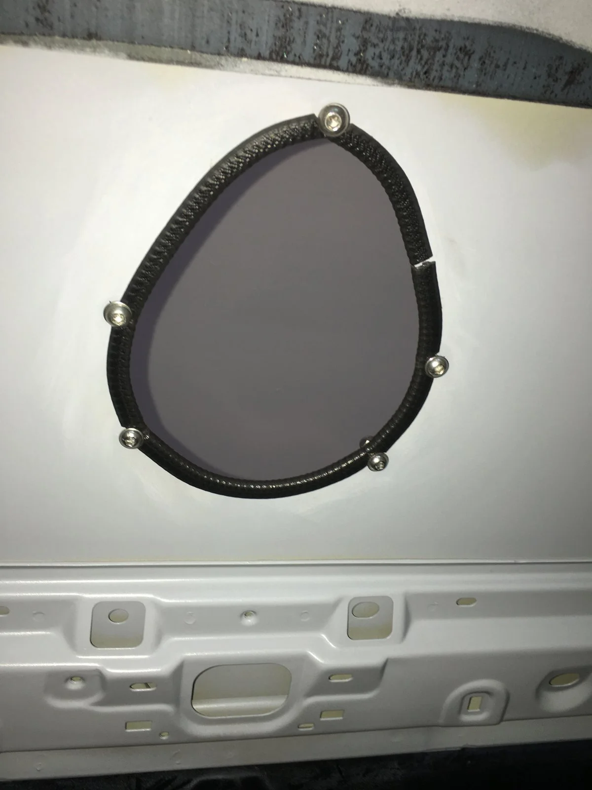

I bought what I originally thought was a clio cup style roof scoop as I was going down the poly window root. It turns out it's a scoop demontweeks sell which is very similar got some fitting photos.
Template I made to mark the hole out on the roof.
Finally fitted! Still needs a clear coat but I was expecting to mark it in process of trying it for size whilst cutting the hole.

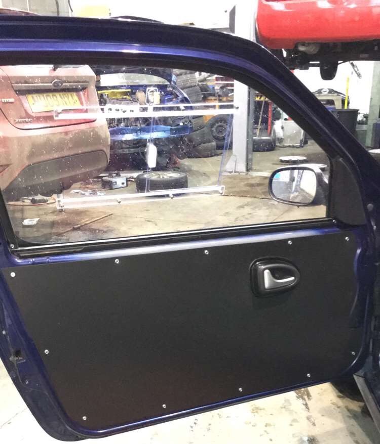

Bought a new set of front poly windows with sliders and locks from AWC Motorsport plastics and a set of door cards, handle spacers to go with them from Chris at CM Composites. I've got door pulls to fit but just haven't got round to it yet.

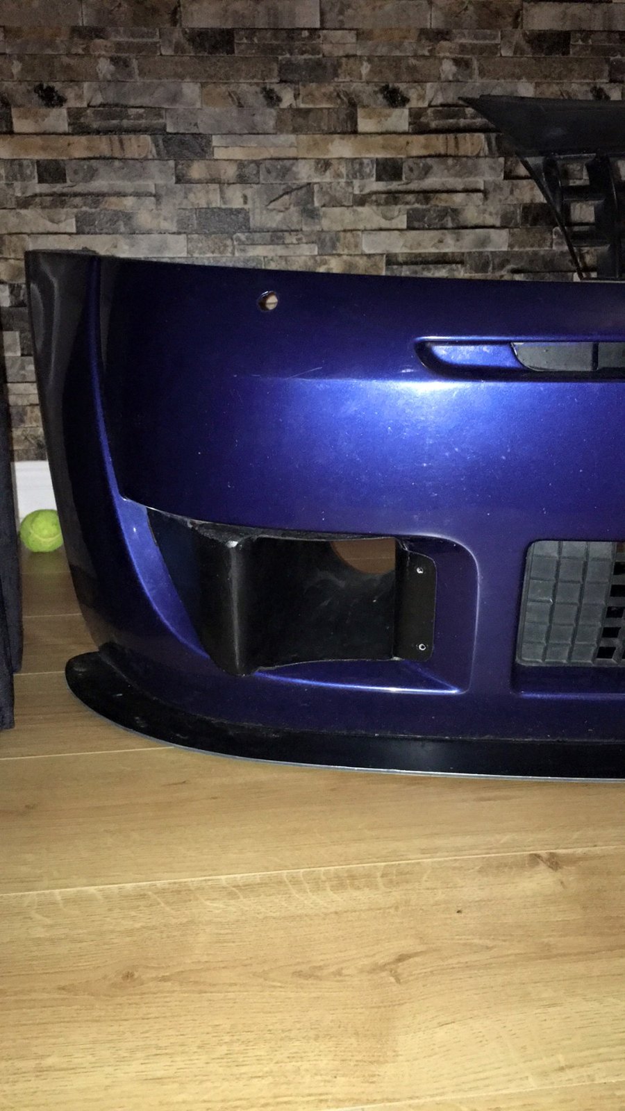

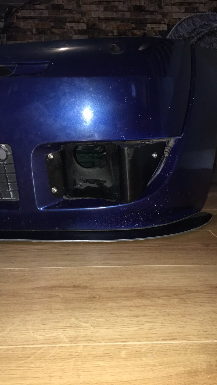

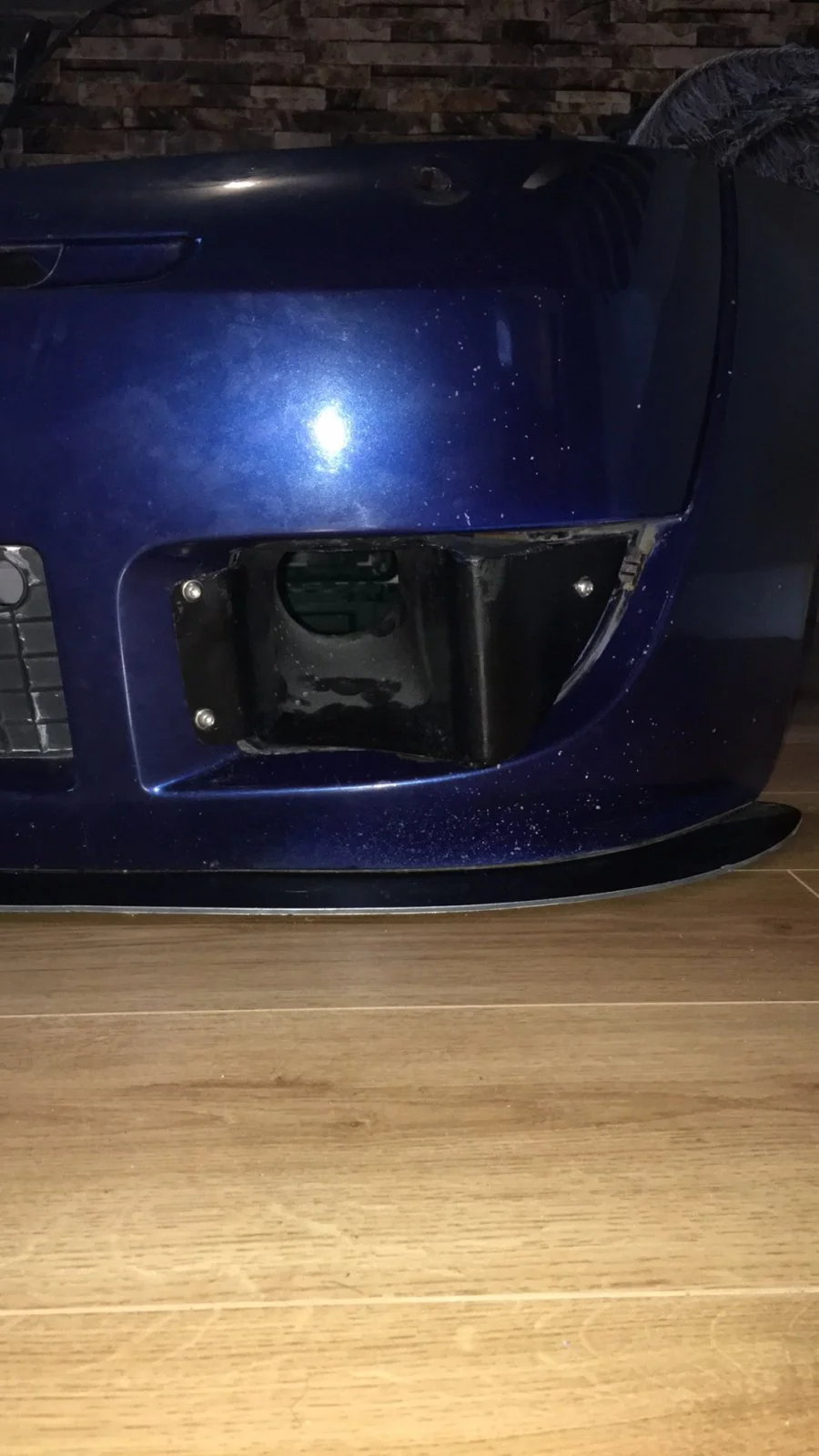

Always liked the look of the cup racer brake ducts so managed to get hold of set through a mate who never fitted them. Wish I knew what a pain they were to fit before starting! There two completely different shapes the passenger side being the wrong shape. I finally got them in and did the best I could.
Notice the CM Composites splitter, I also have a set of washer blanks to fit.

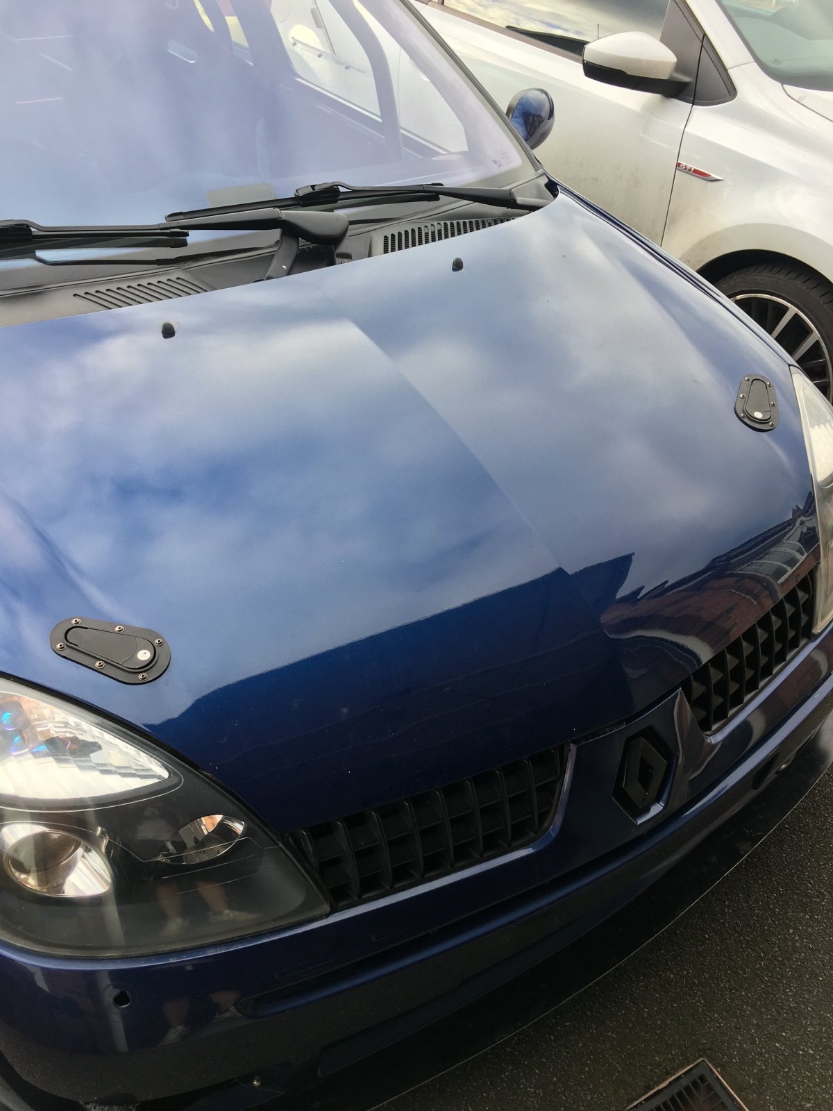

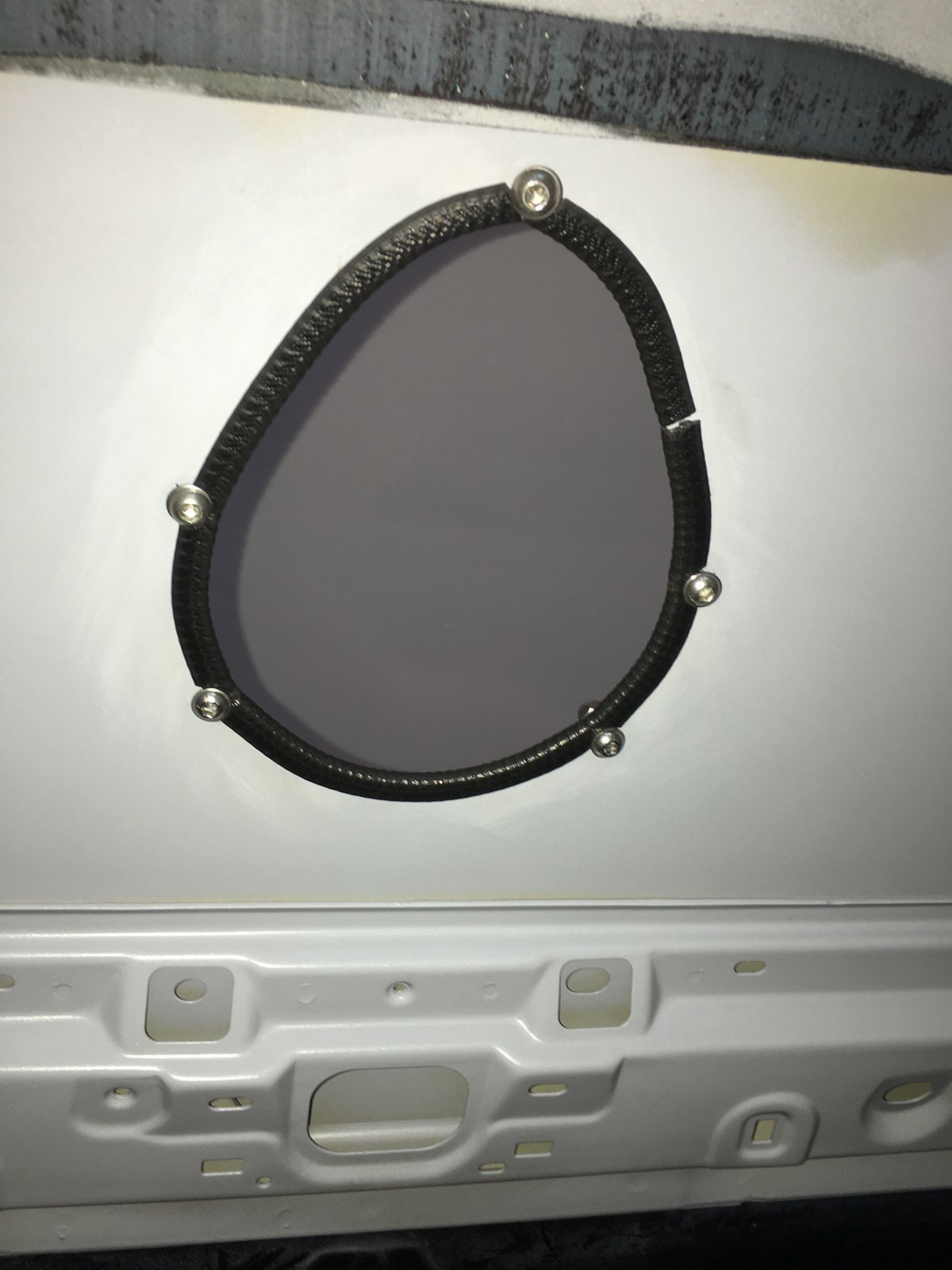

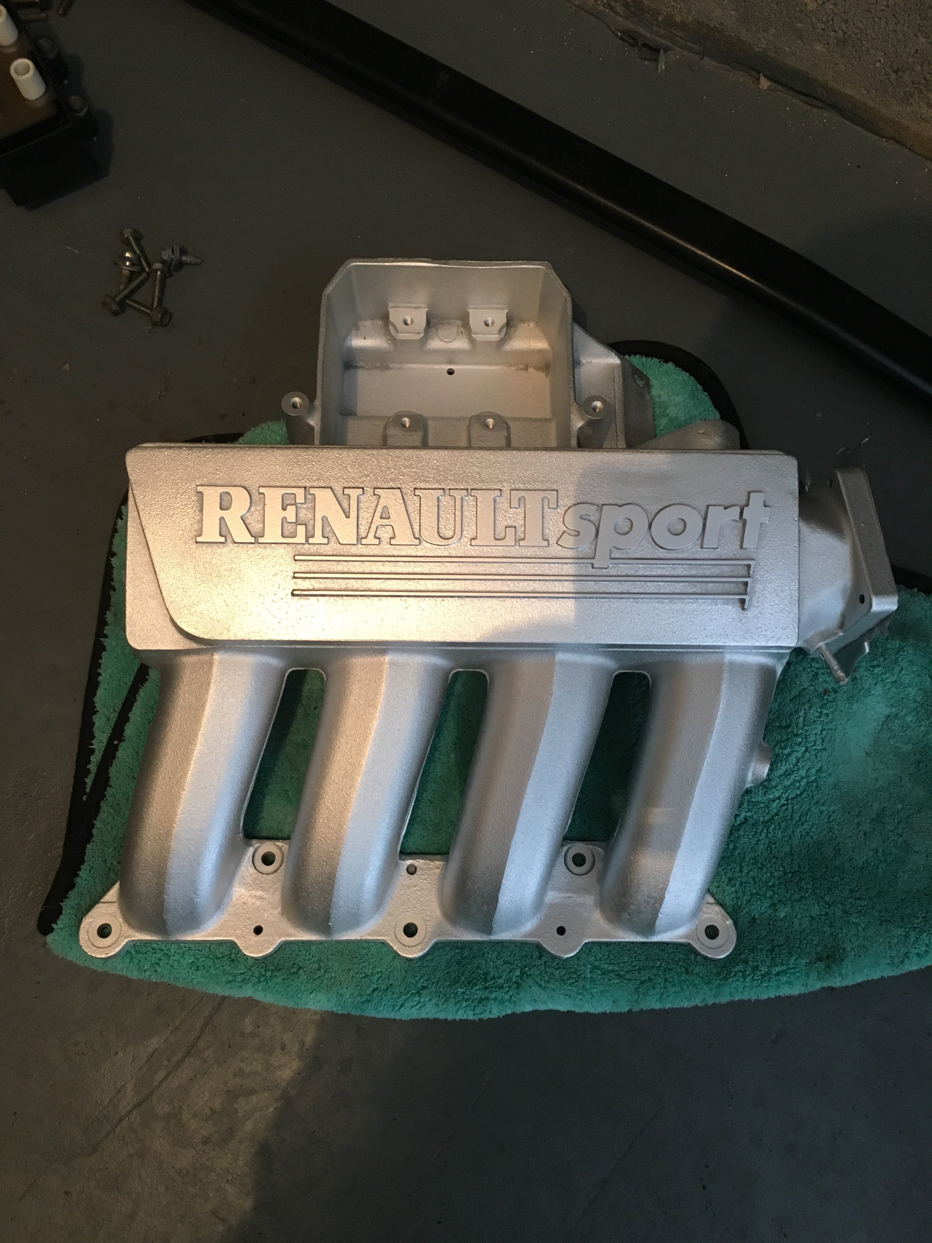

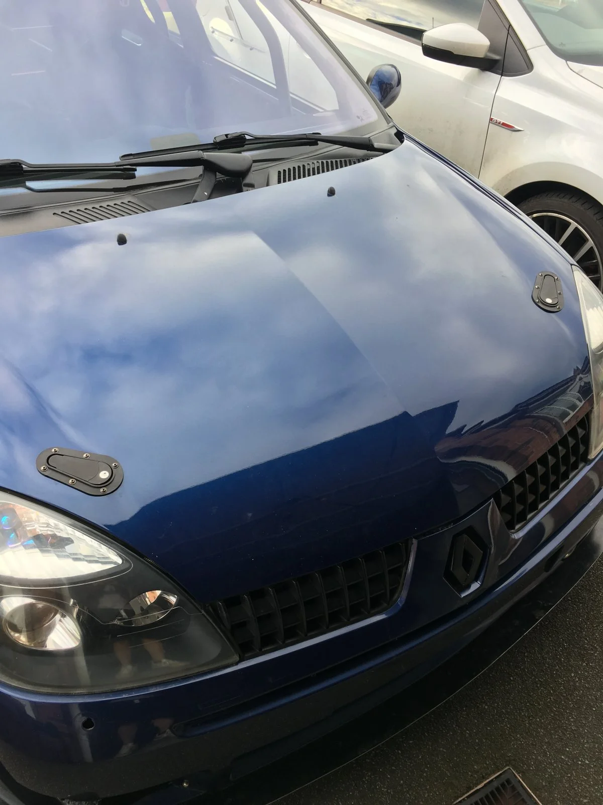

With a RS2 inlet in mind I fitted some aerocatches

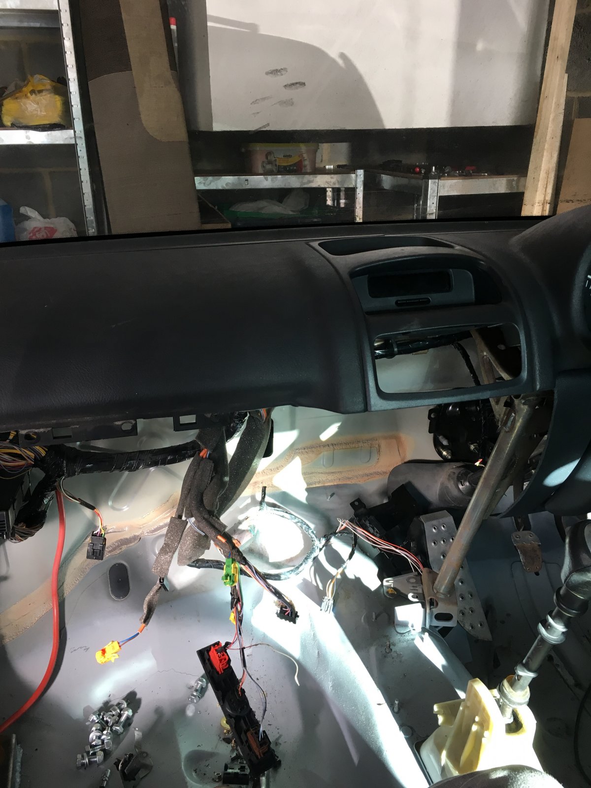

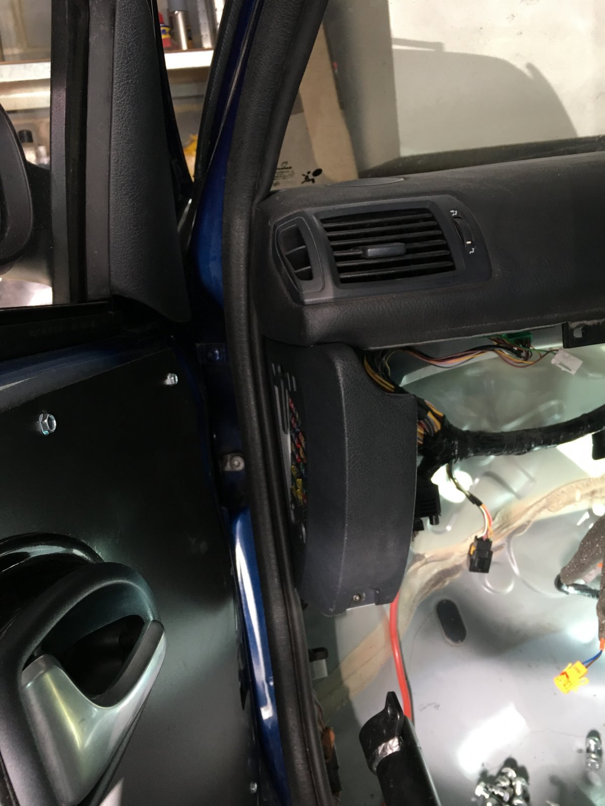

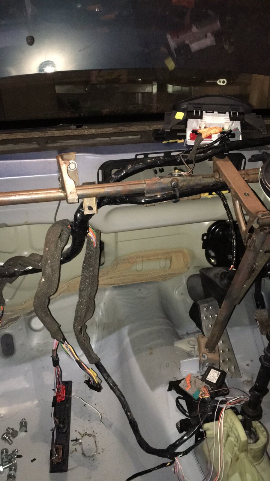

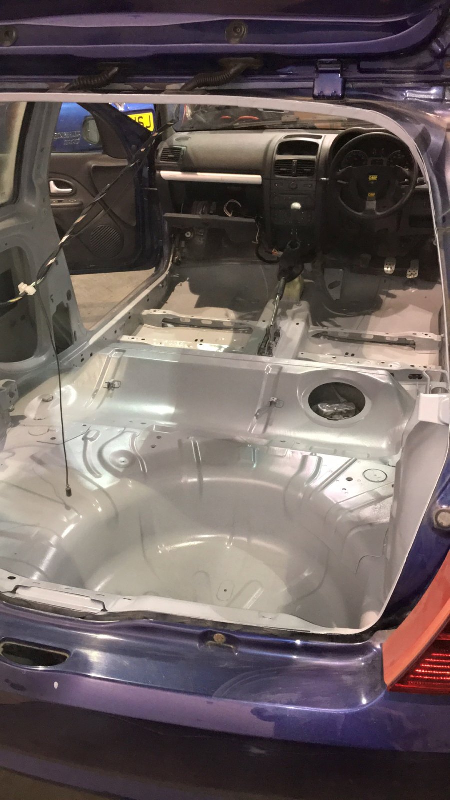

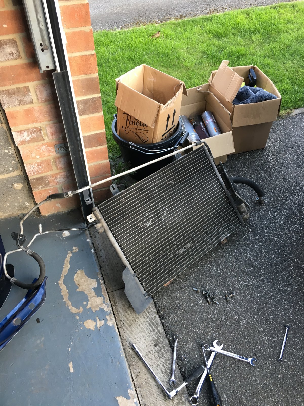

So at this point I decided I wanted to go FULLY stripped out as I like the clean look of track cars, so I took to removing the lower dash with the heater, radio and basically anything else that wouldn't be getting used. After removing the lower dash I had an idea to cut it so I can keep the steering cowling as I didn't want all the cables on show. I also cut the end off the lower dash to cover the fuse box and the trim with the spare fuses just to tidy things off.
Heater removed
How it looks with the lower dash cut

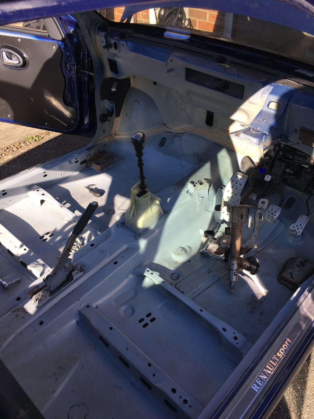

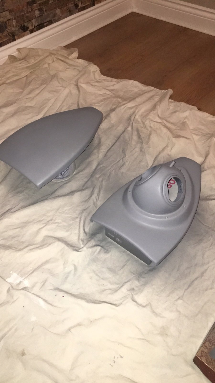

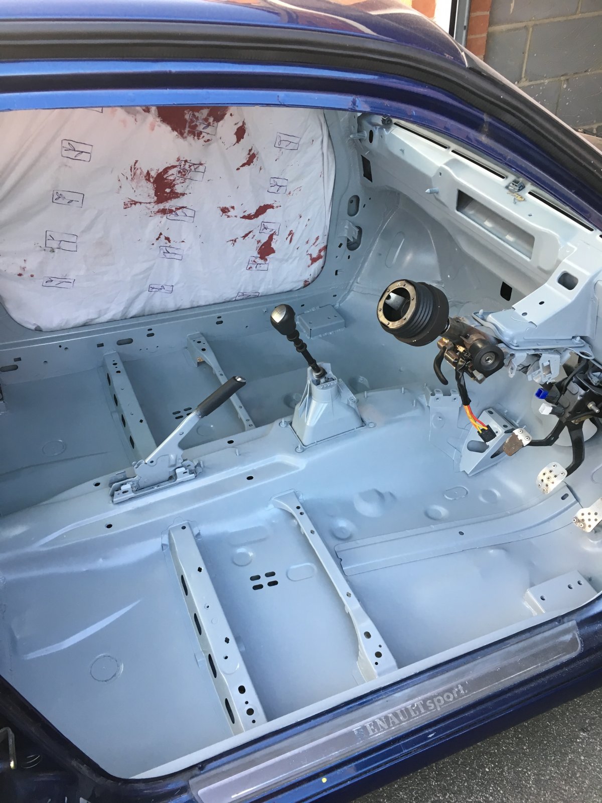

Ever since fitting the roll cage I wanted to re paint the inside as we couldn't avoid scratching the floor and with the dash being removed it revealed more unpainted bits so I decided to strip everything out and rebuild it from scratch.
Fully stripped
Re painted

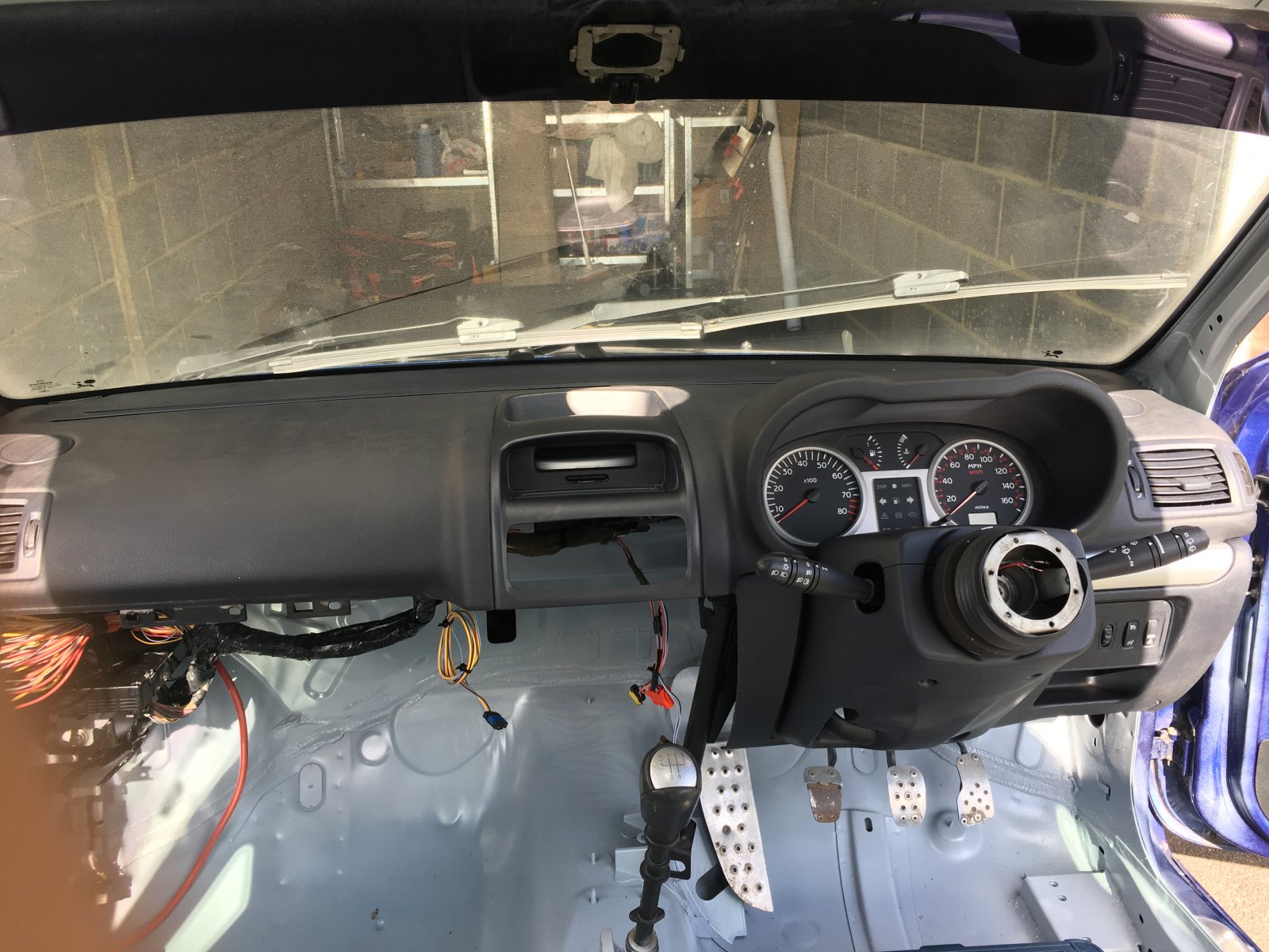

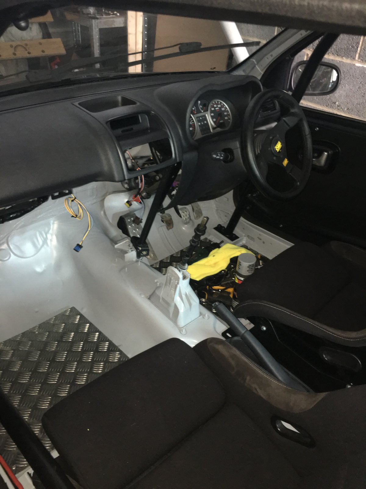

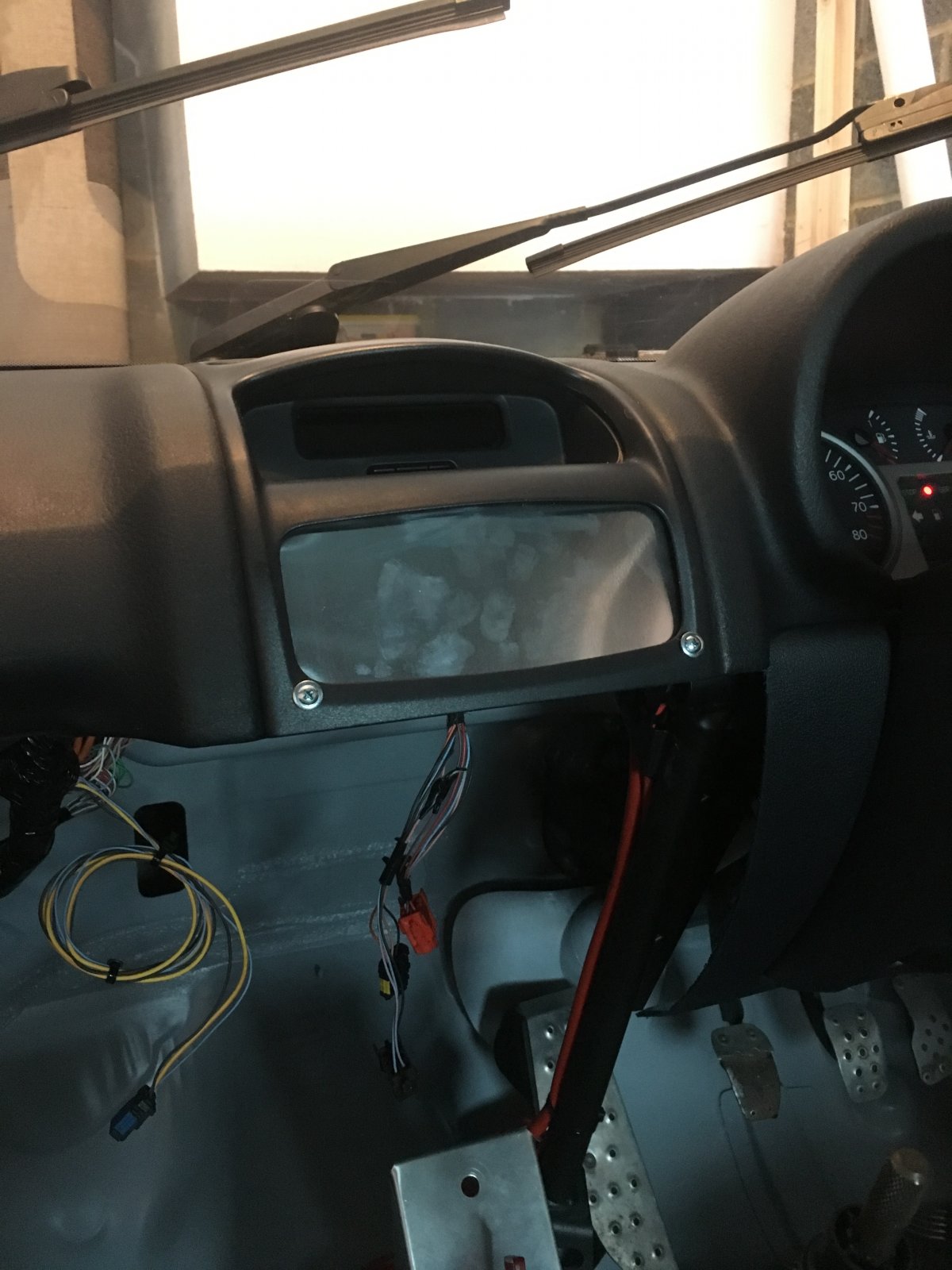

Dash back in, cut some of the loom back the two cables you can see are the 12v plug and hazard switches which I plan on mounting where the vents used to be.

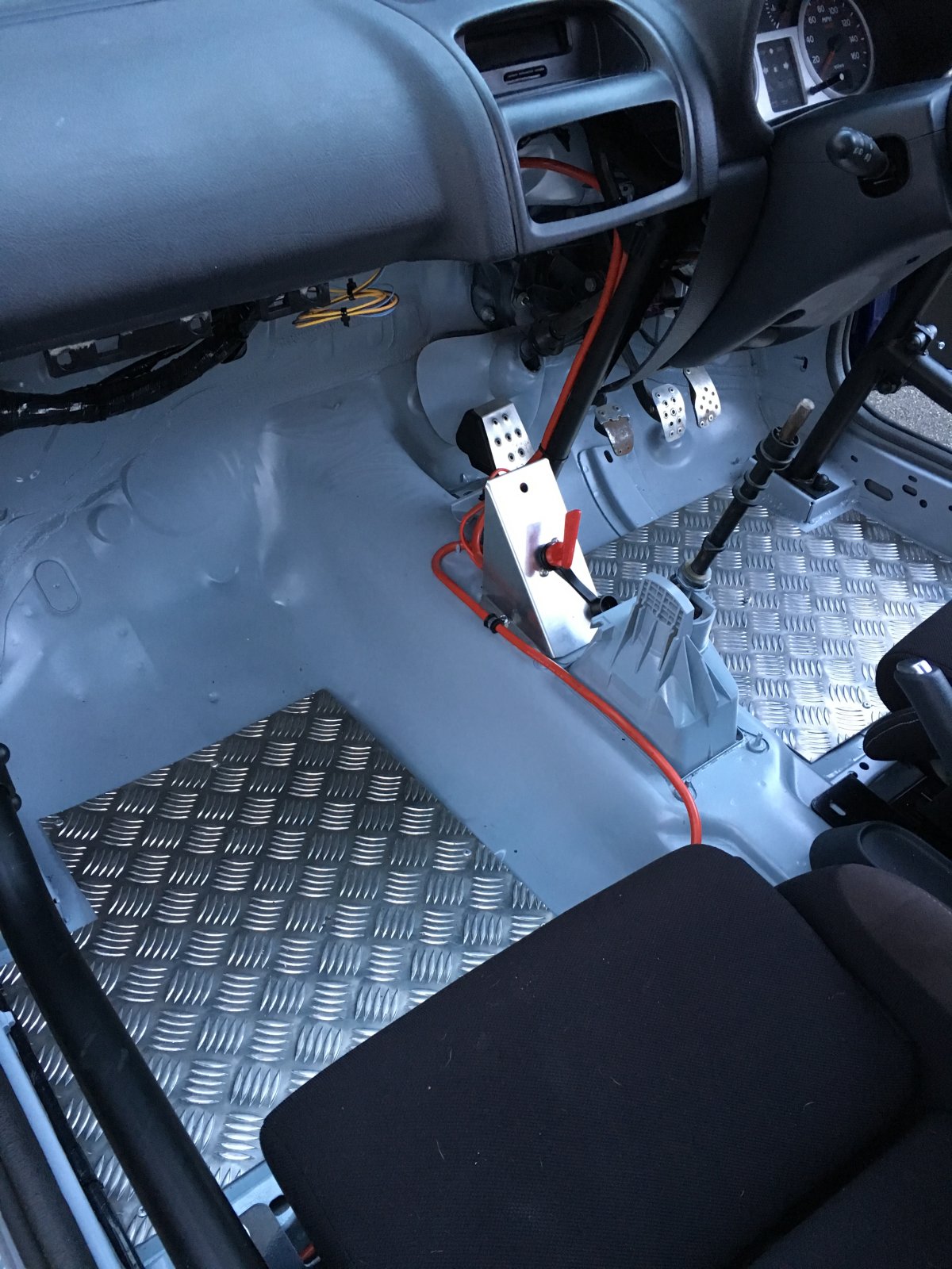

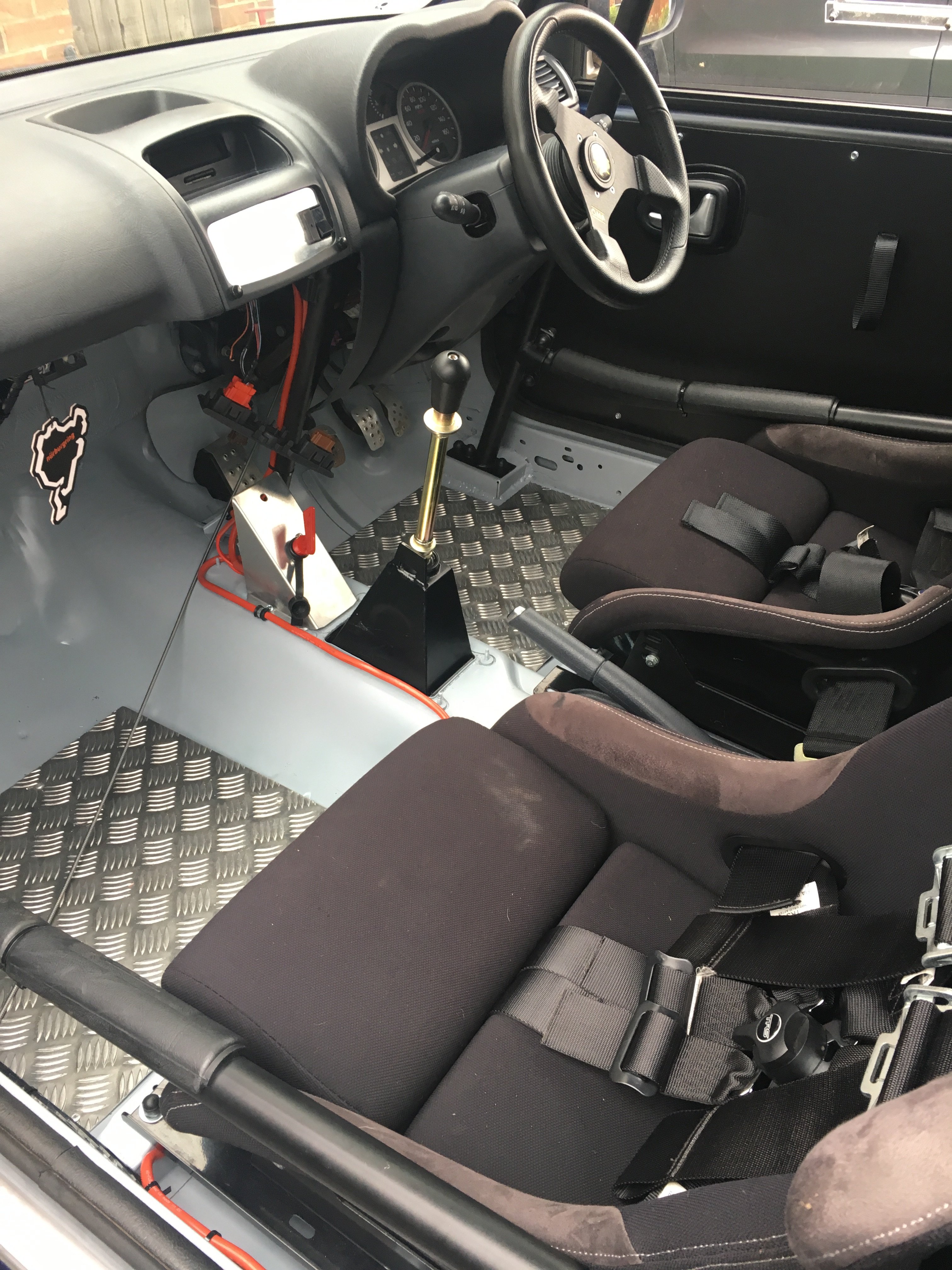

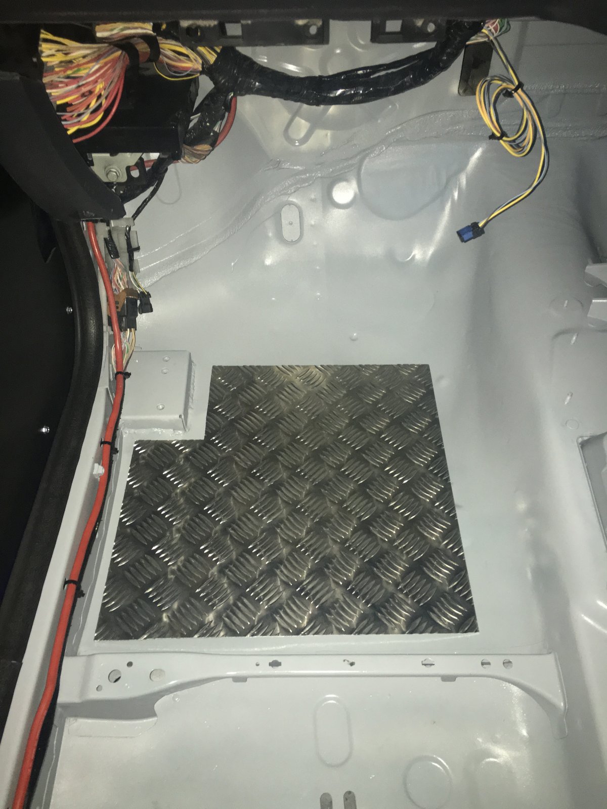

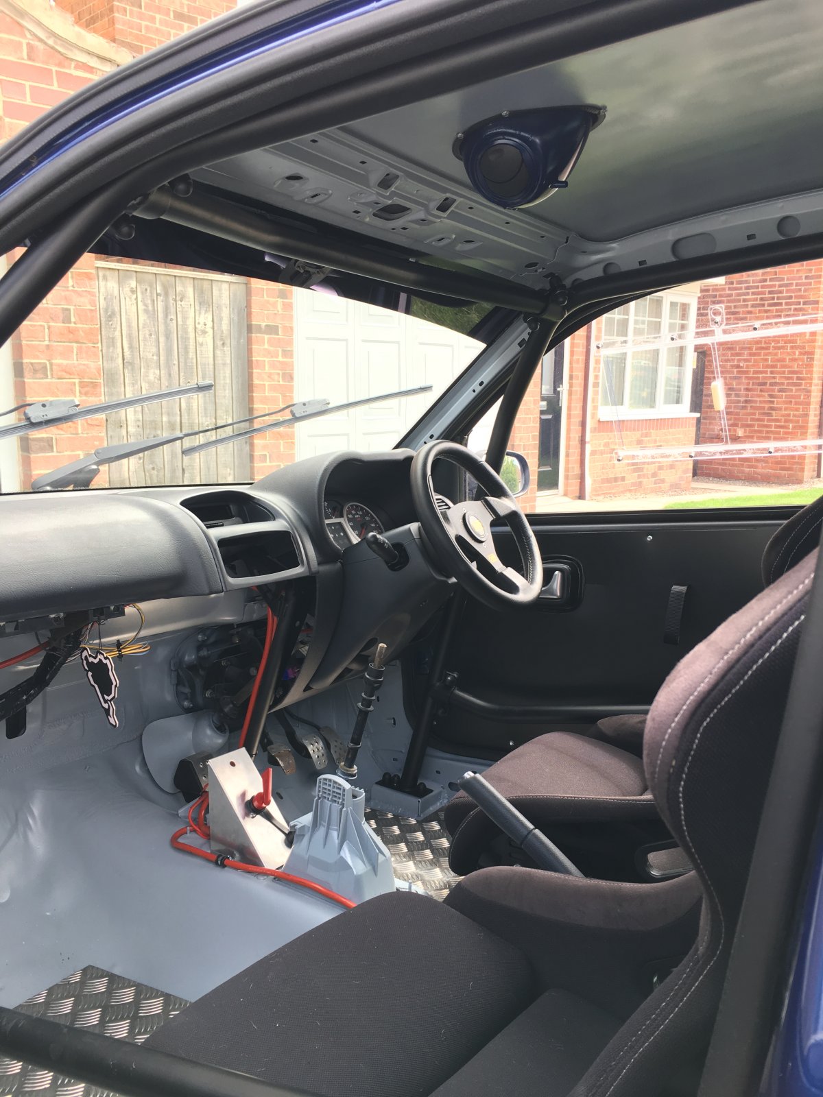

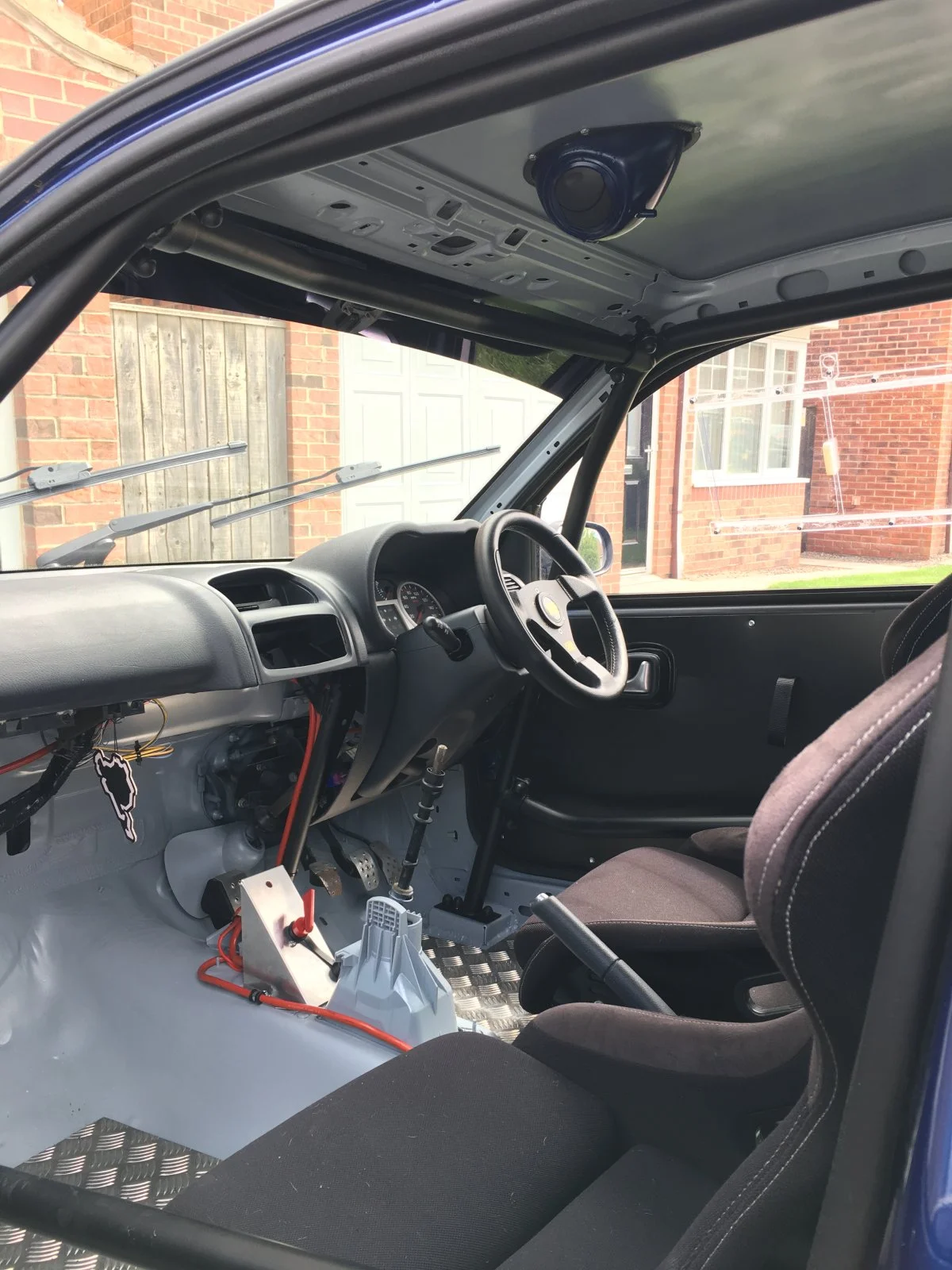

Made some alloy footplates to avoid the floor getting scratched and needing repainted. Really happy with the finish of the interior now, I hate the saying "it's a track car" I like to think putting in a little extra effort will help when selling the car and avoid breaking.

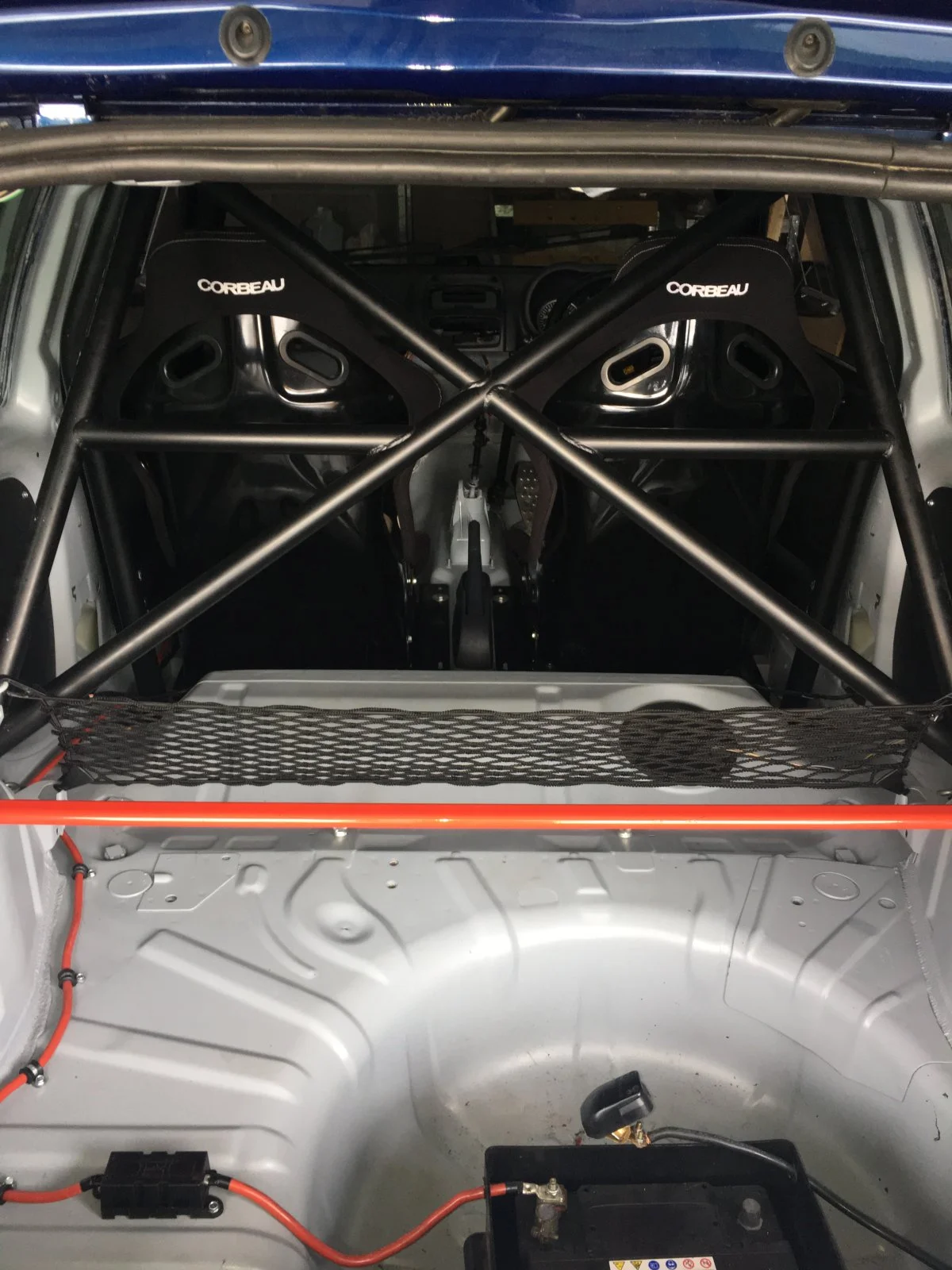

Seats and roll cage back in, and floor plates fixed down. I've bought a black nylon quaife style gear knob but was accidentally sent a stainless so waiting to get that sorted, a PMS shifter is on the list but a scenic one will do for now.
So that's how the car currently stands! 1 year later, 0 track days and around 20 miles driven but very close to getting it finished.

OMP steering wheel
Momo boss

Race rear brake light - Need to fit

Nice - looks great. Does the dash top fit without the bottom without any mods? Im planning to do similar to mine but need to work out where to put the UCH and fusebox as my cage legs are in the way.
Thank you! I believe so, as the dash can be secured down by the 3 screws underneath the windscreeen, not sure about the clocks though. I think most people also remove the metal dash support as well, surprising it's really light and it seemed like more hassle trying to find a new home for the fuse box and UCH than what's it's worth. By cutting the dash where I have I've kept the housing for the centre clock and speedo clocks.

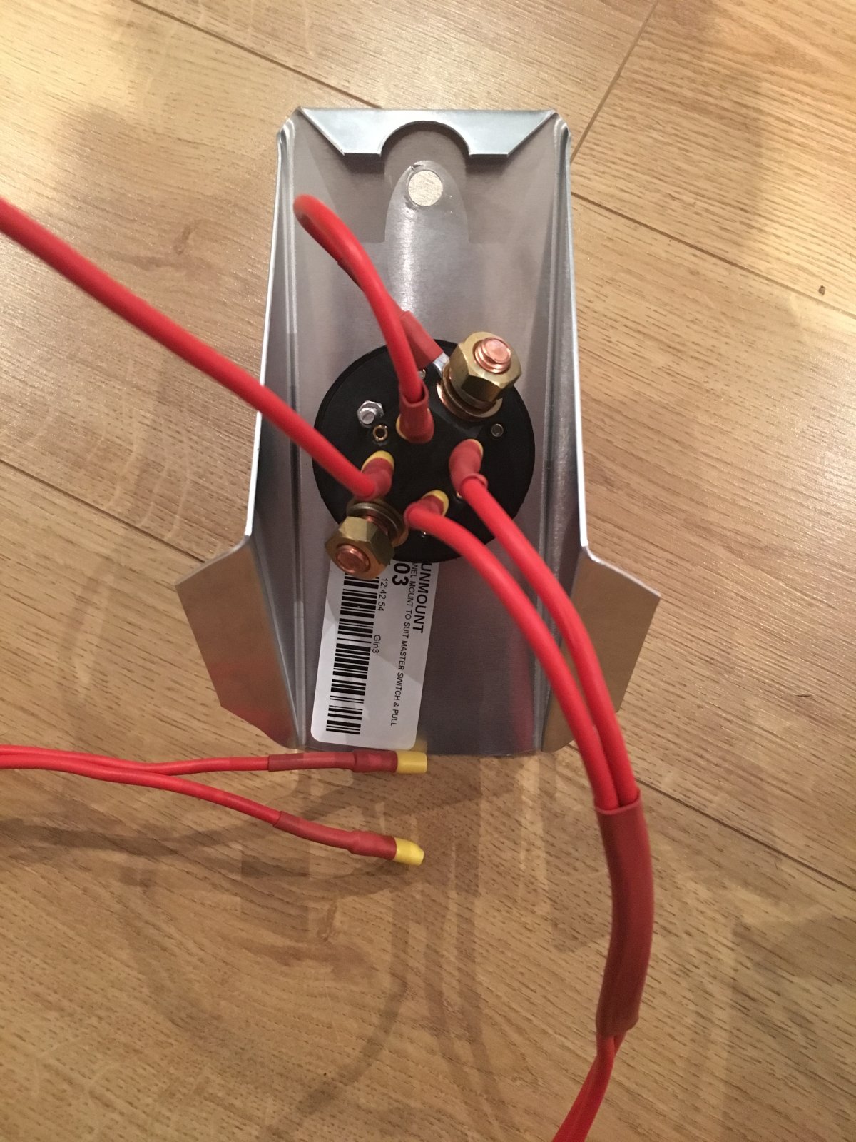

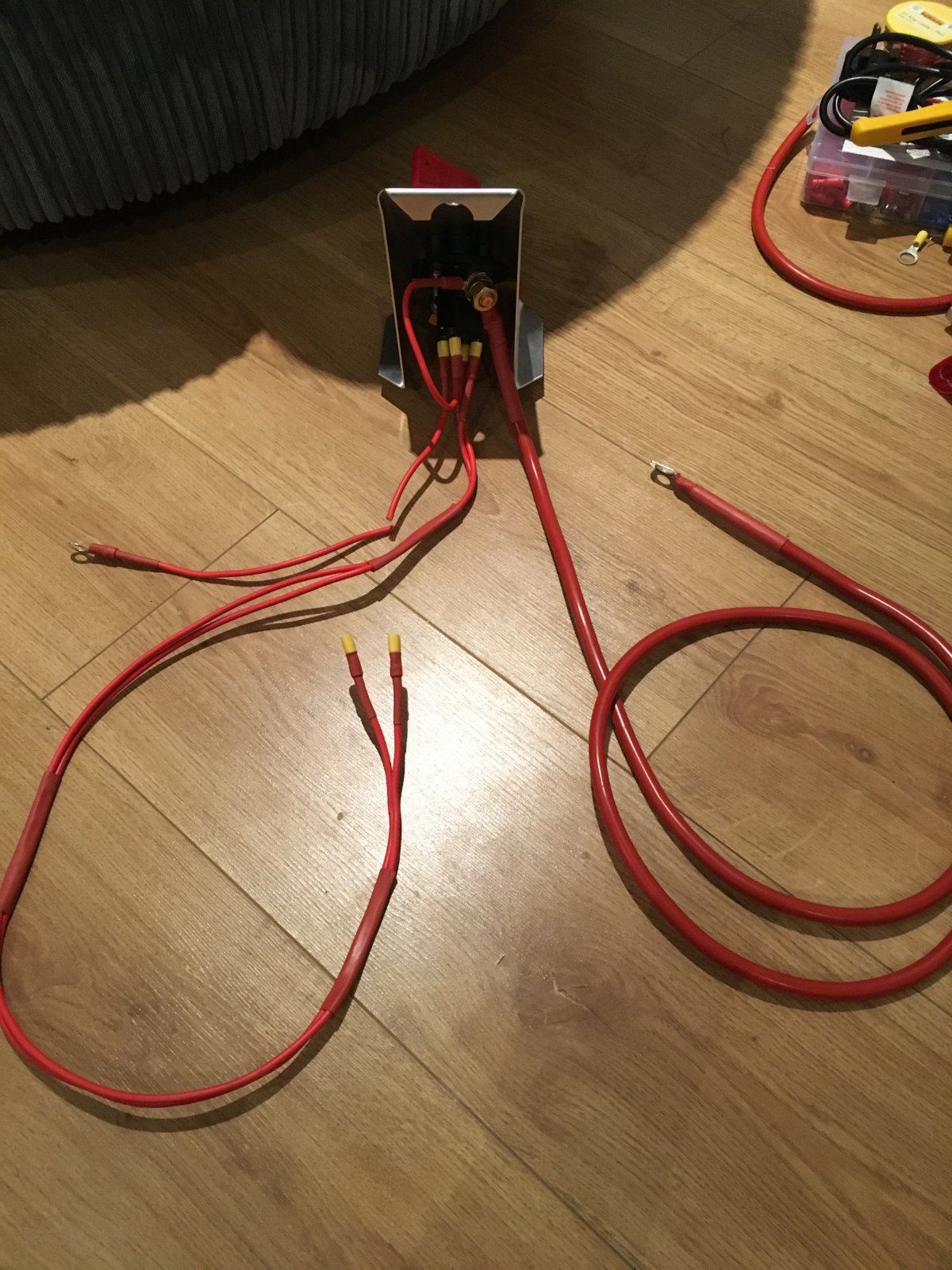

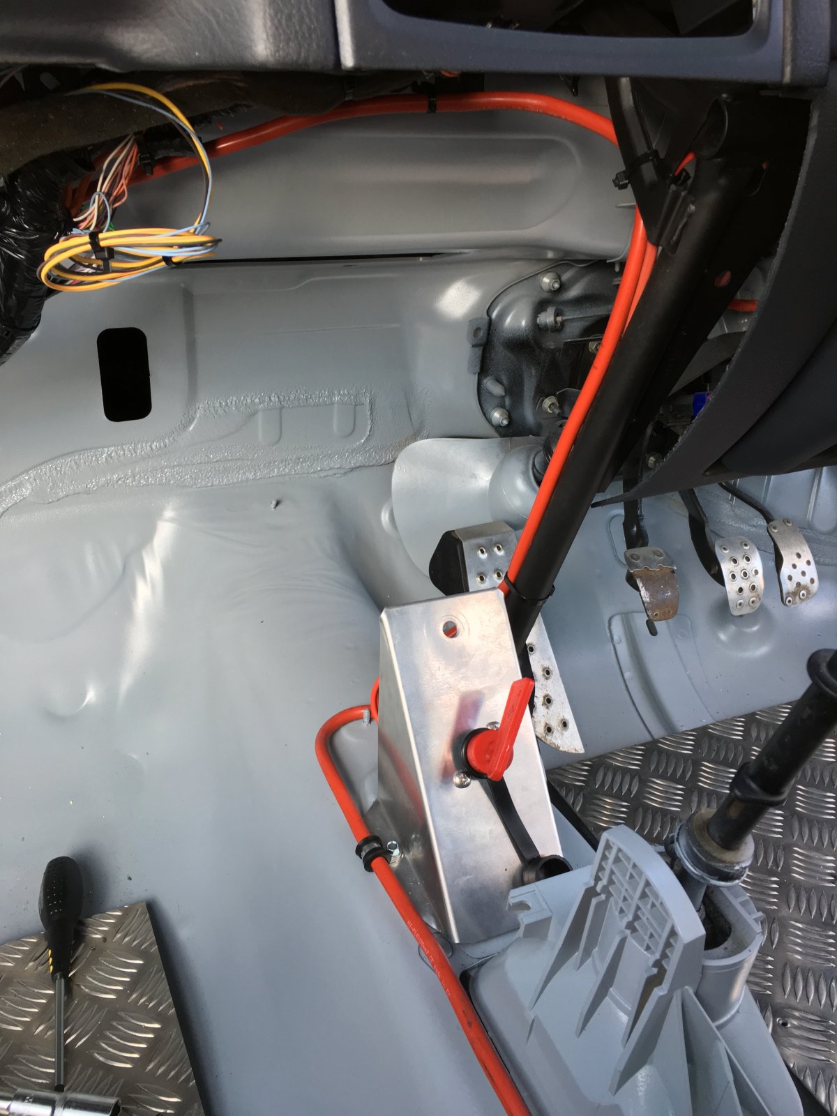

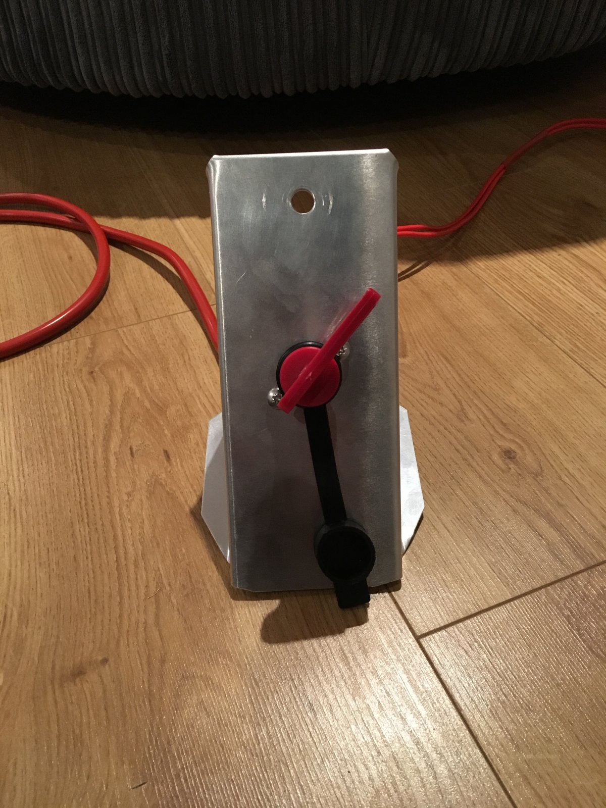

Got some spare time after work so made a start on my FIA cut off switch, one of the legs on the resistor was loose so I've ordered a new one unfortunately I can't finish it off until it comes. Planning on mounting it in front of the shifter where the airbag ecu used to be.
Been cracking on today got my cut off switch fitted just need a couple more p clips to finish it off, race style brake light, removed all the aircon pipes and radiator, fitted door pulls and in the process of painting my scoop.

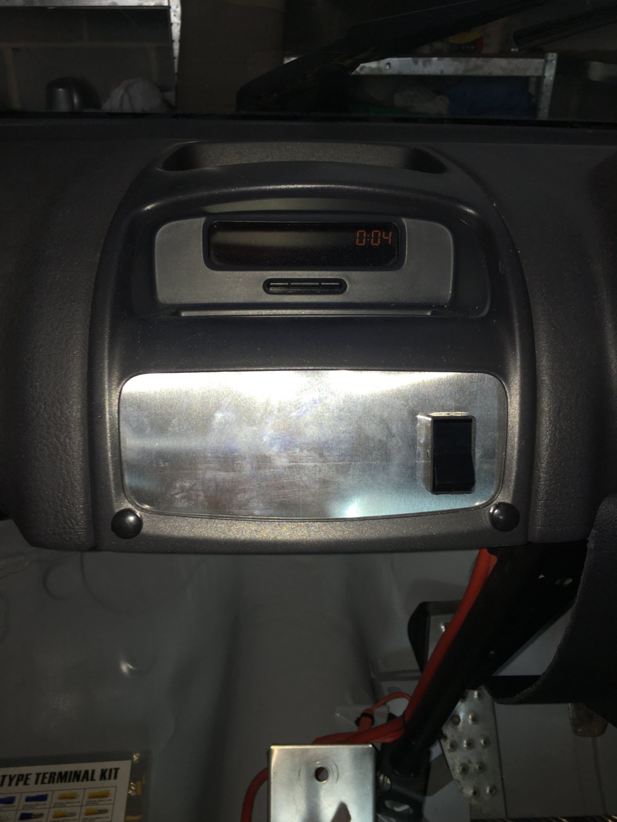

Made a start on a switch panel for my hazard and 12v plug, once I get my fan and heater fitted they'll be on there too.

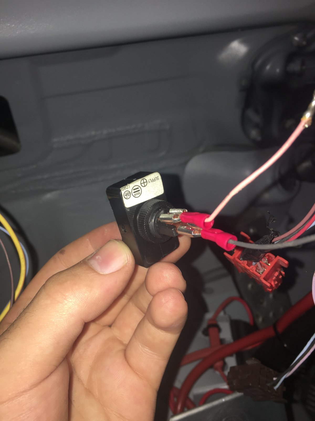

I bought a 17amp rocker switch from Halfords for my hazards but can't get it to work, if someone could give me a link to some decent switches that would be great!
Rs components do nice switches, where did you get the kill switch mount? Looks great.
Finally got my switch working, pink is the supply and black the load. I think orange is for the illumination of the switch which isn't needed in my case.

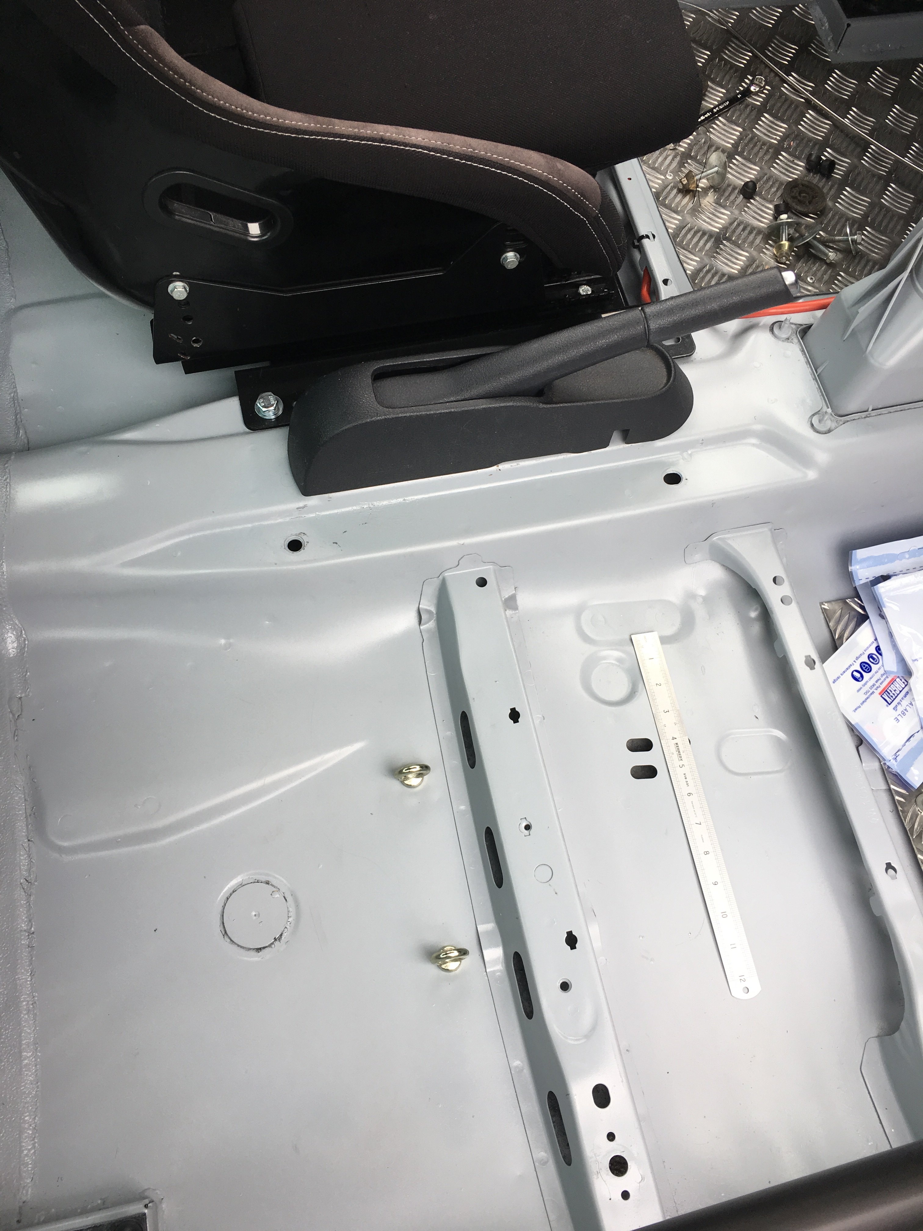

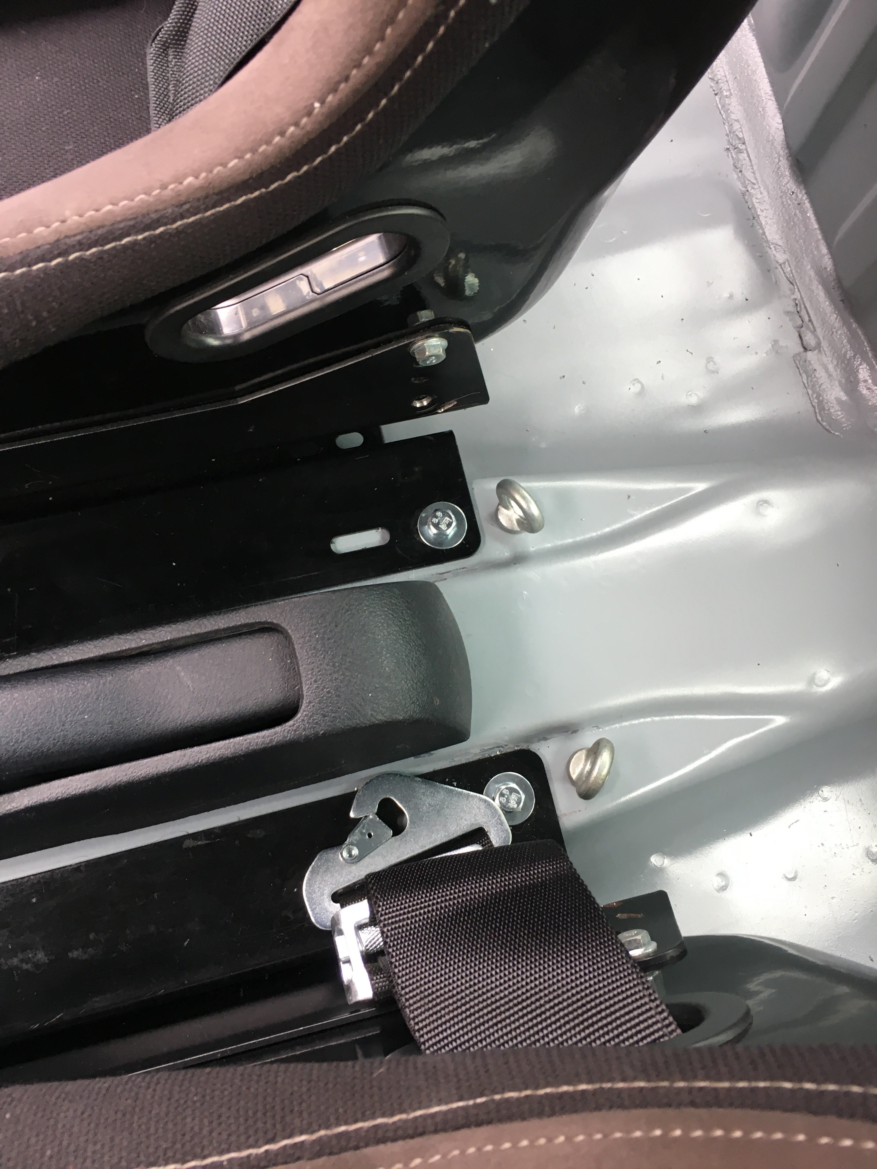

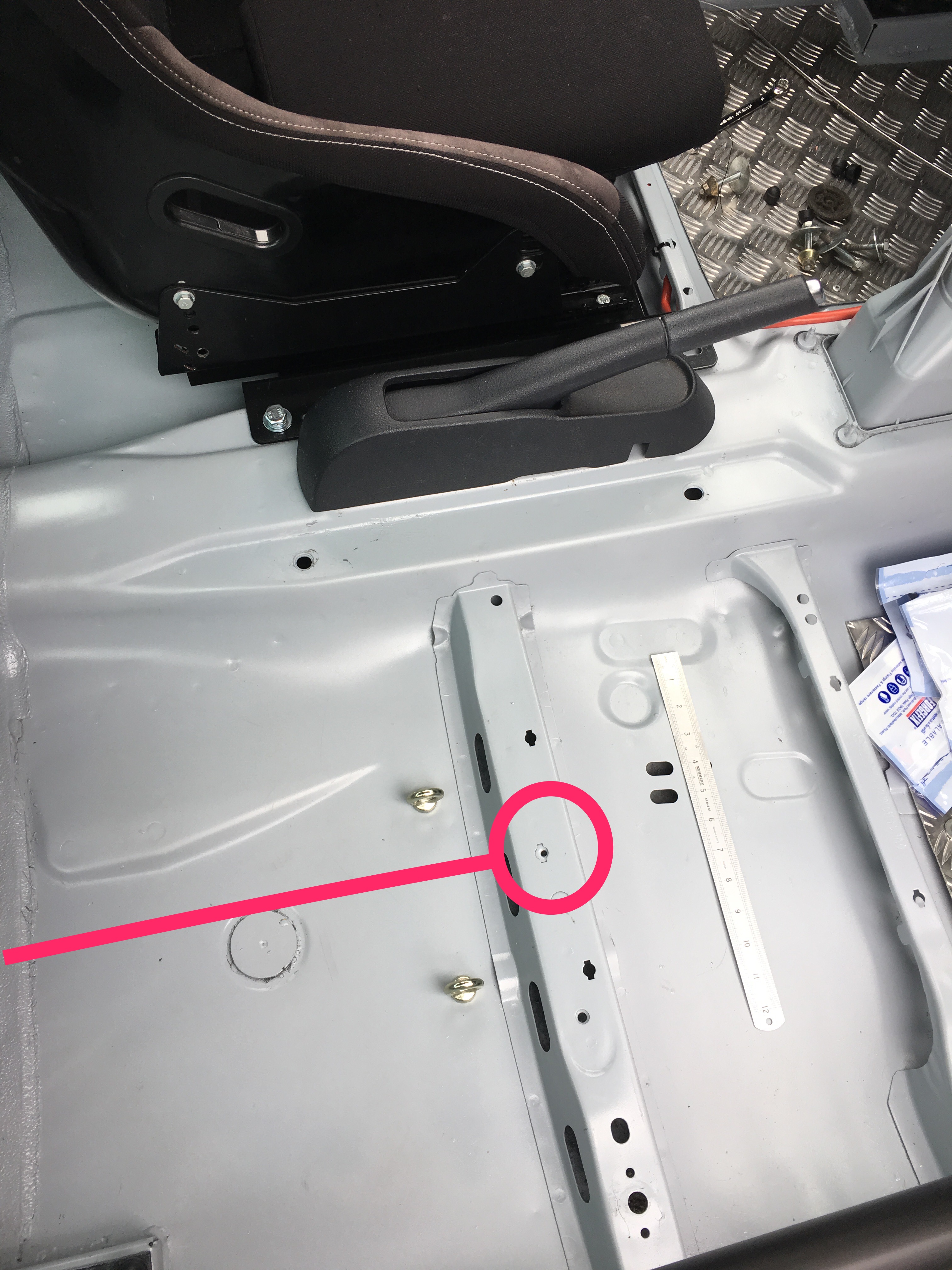

First up was some 3" TRS 6 point harnesses, after reading the Schroth guide I went on to mount my anchor points for the crutch straps, initially they look quite far behind but the second cross member is bang on in the middle of the seat so mounting them a little behind that roughly gives me a 20 degree angle. I then went on to mount eyelets and speader plates for the exhaust tunnel side as my original setup was a 2" 7/16 UNC eyelet which acted as a seat bolt as well as a anchor point, made it annoying when taking the seats out and I wasn't really keen on the setup. I should of mounted them about 1/2-1" further back as the speader plate for the seat nuts are basically touching the eyelet bolt I still had enough thread and just mounted the speader plate on top.

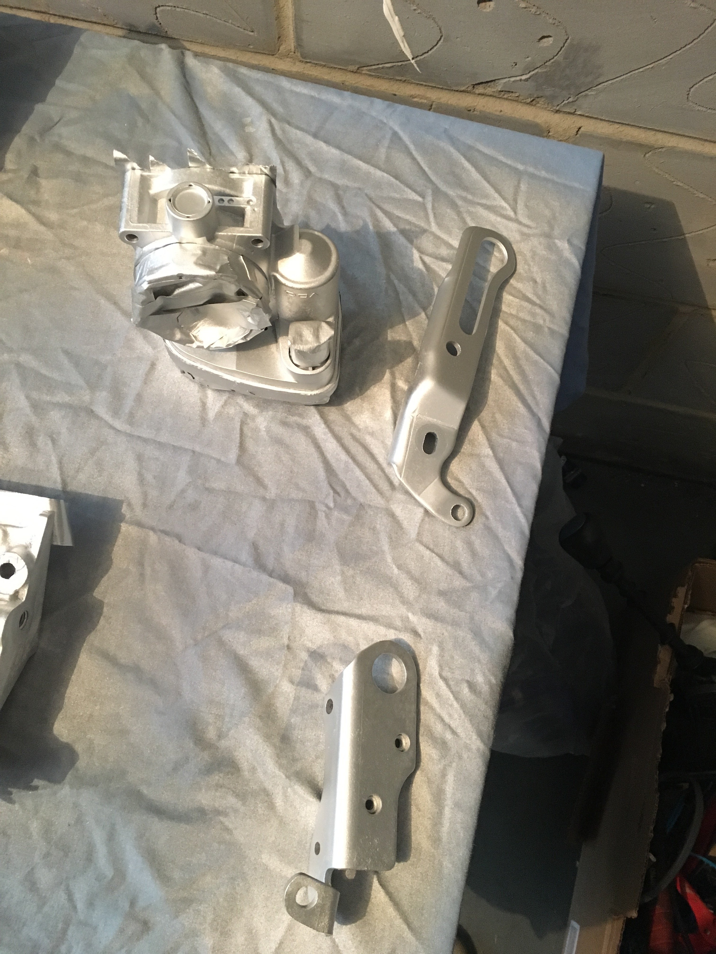

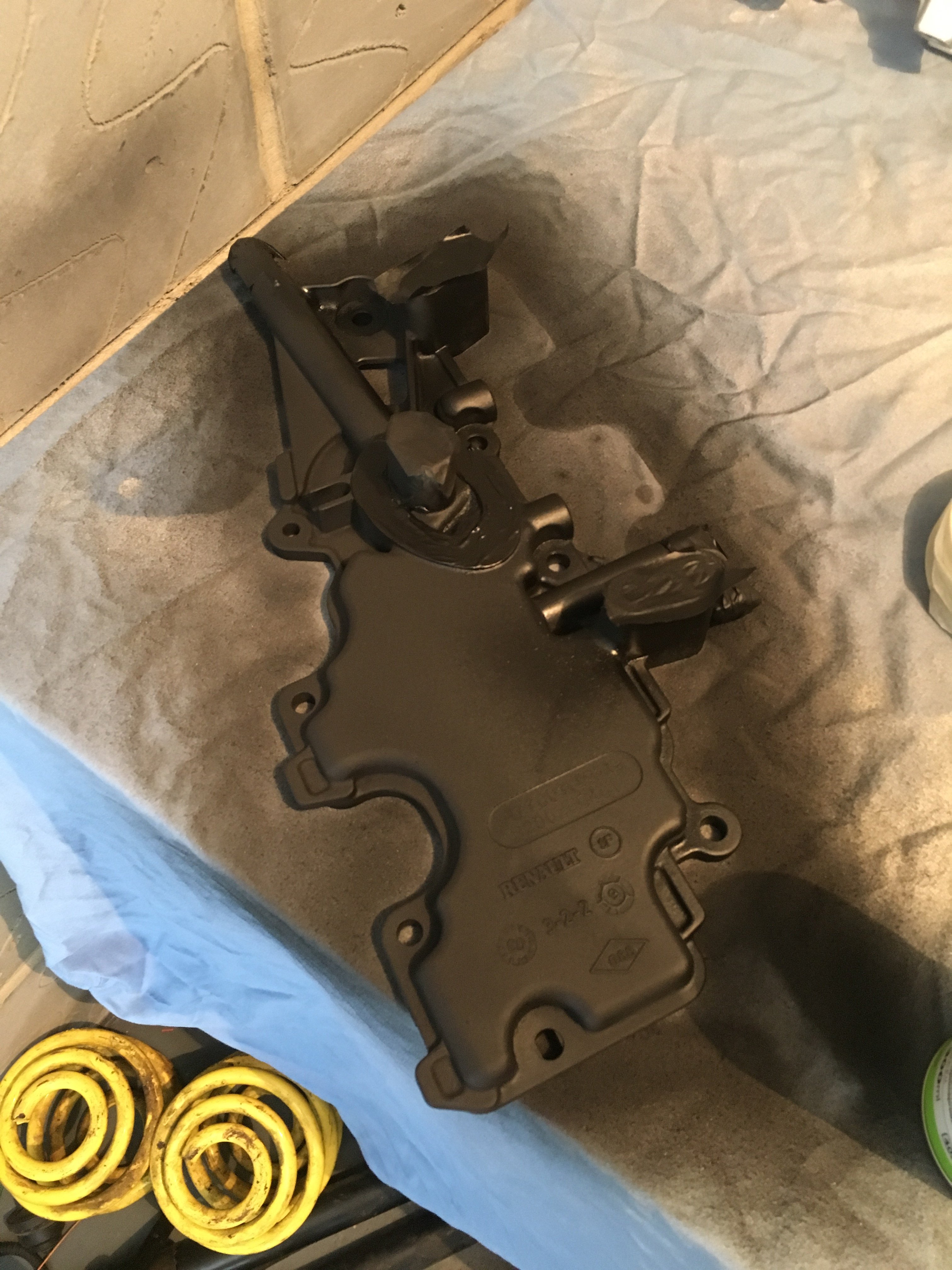

Next up was a PMS shifter which I wasnt looking forward to as I heard lining up the gears up was a pain, turns out it's pretty simple by just putting the gearbox in reverse and using @NorthloopCup's method of cable tying it over to the left. Biggest pain was getting the cir clip in that holds the white nylon bush in place. I used a deep 6mm socket and jack to compress the bush whist I tackled the clip with a set off hook tools, as I couldn't find my cir clip pliers.
Those with good eyes will notice the clip isn't fully seated in the image above, another go with a socket and jack and it jumped into place.

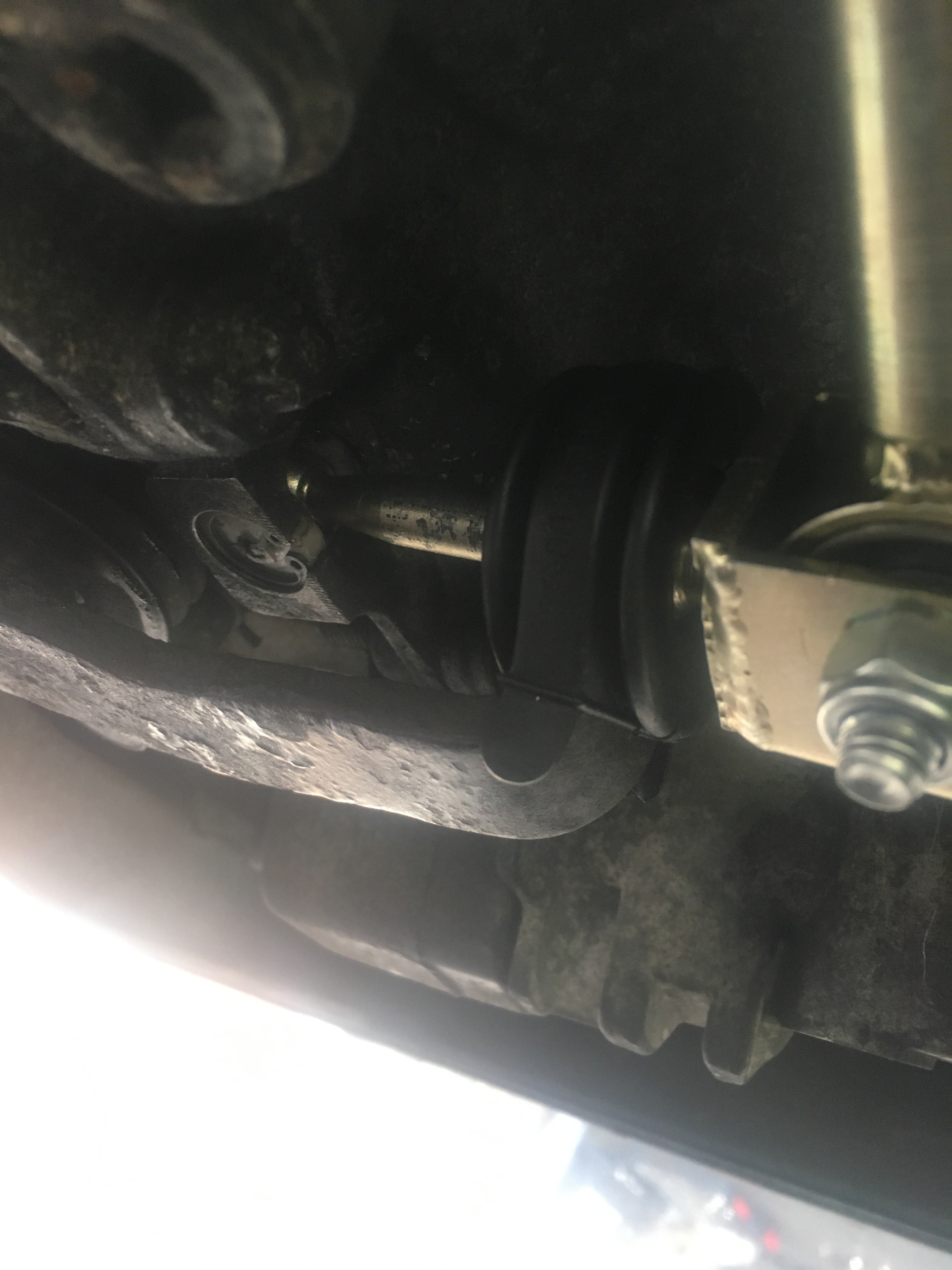

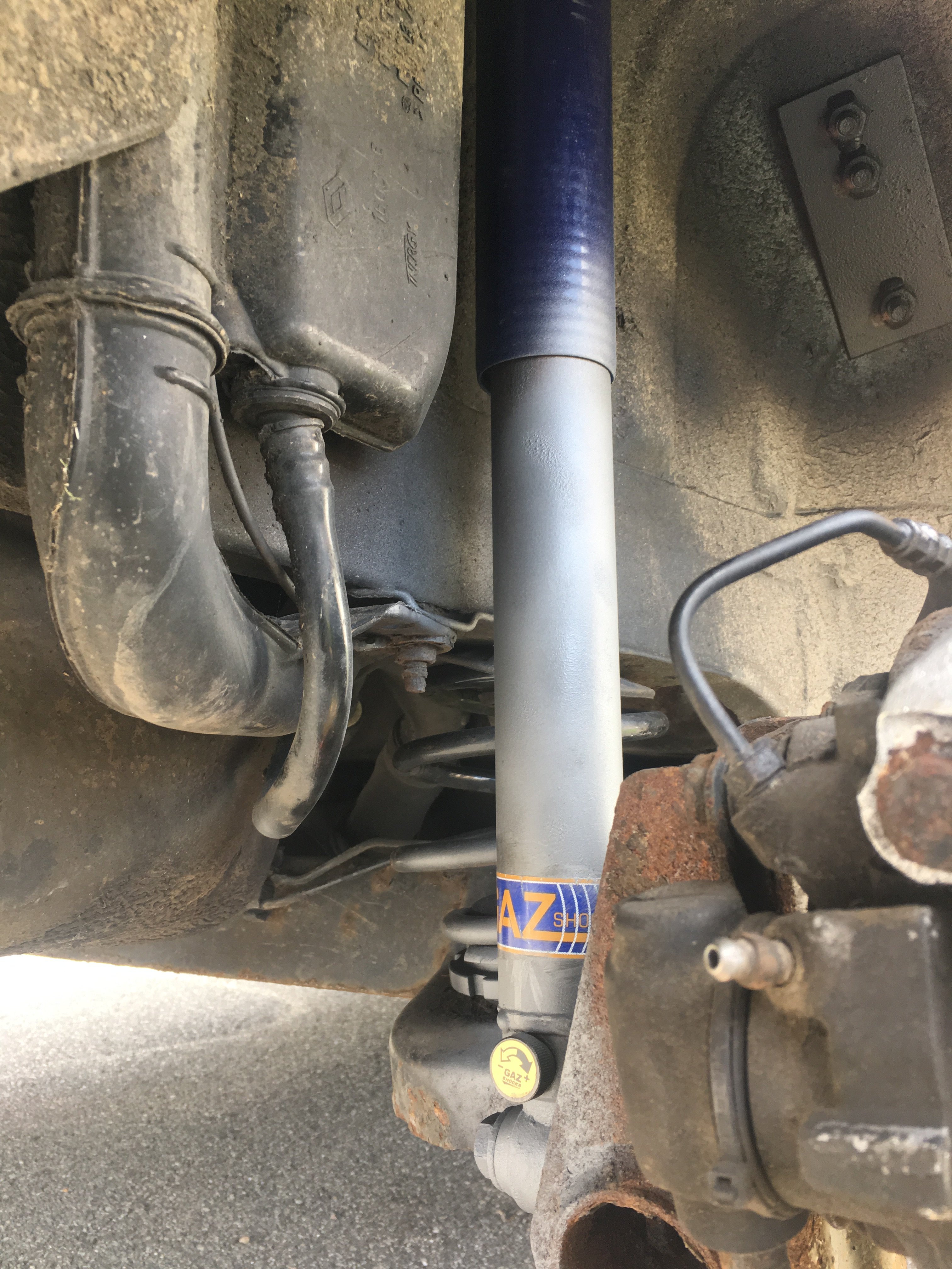

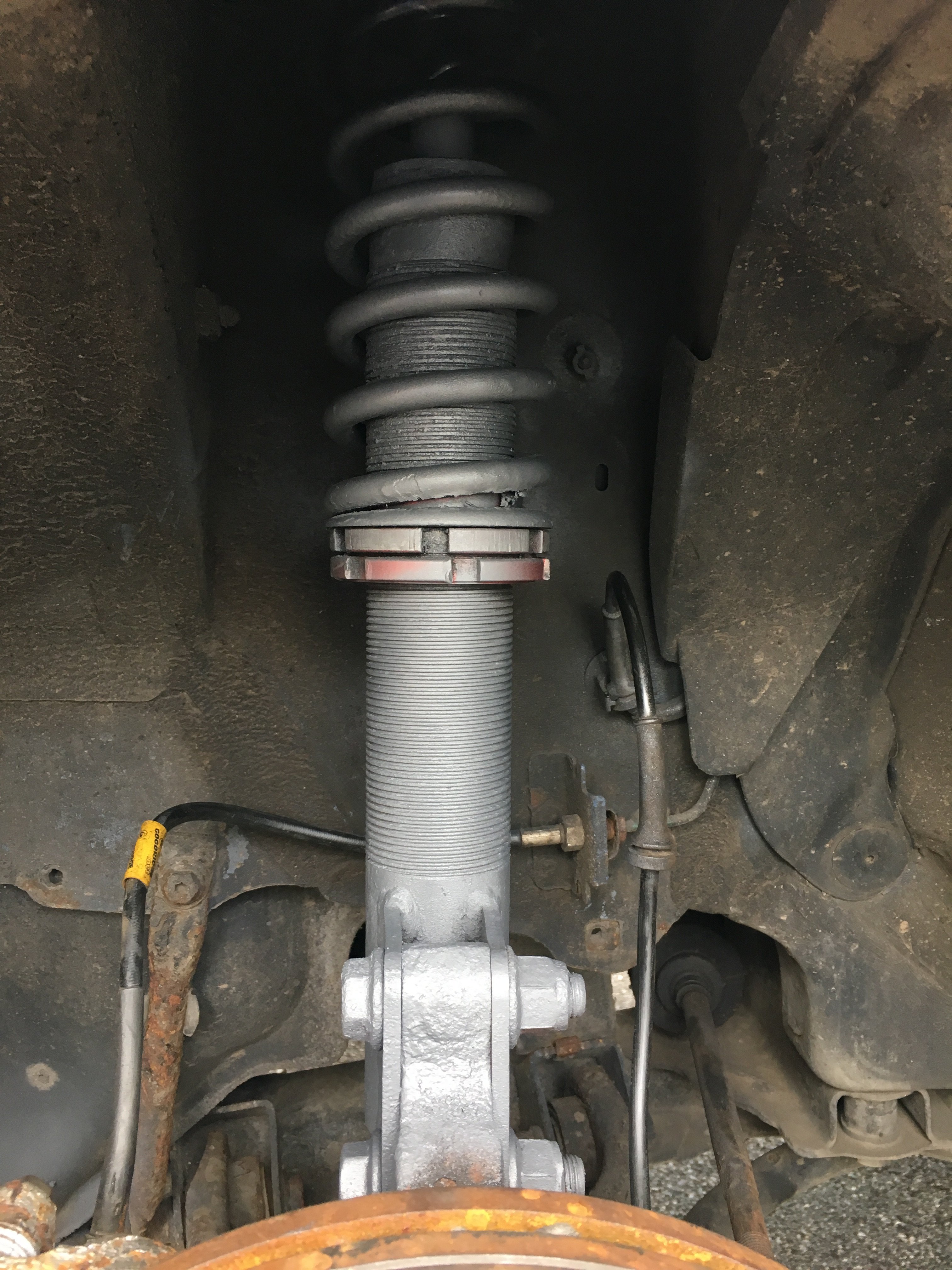

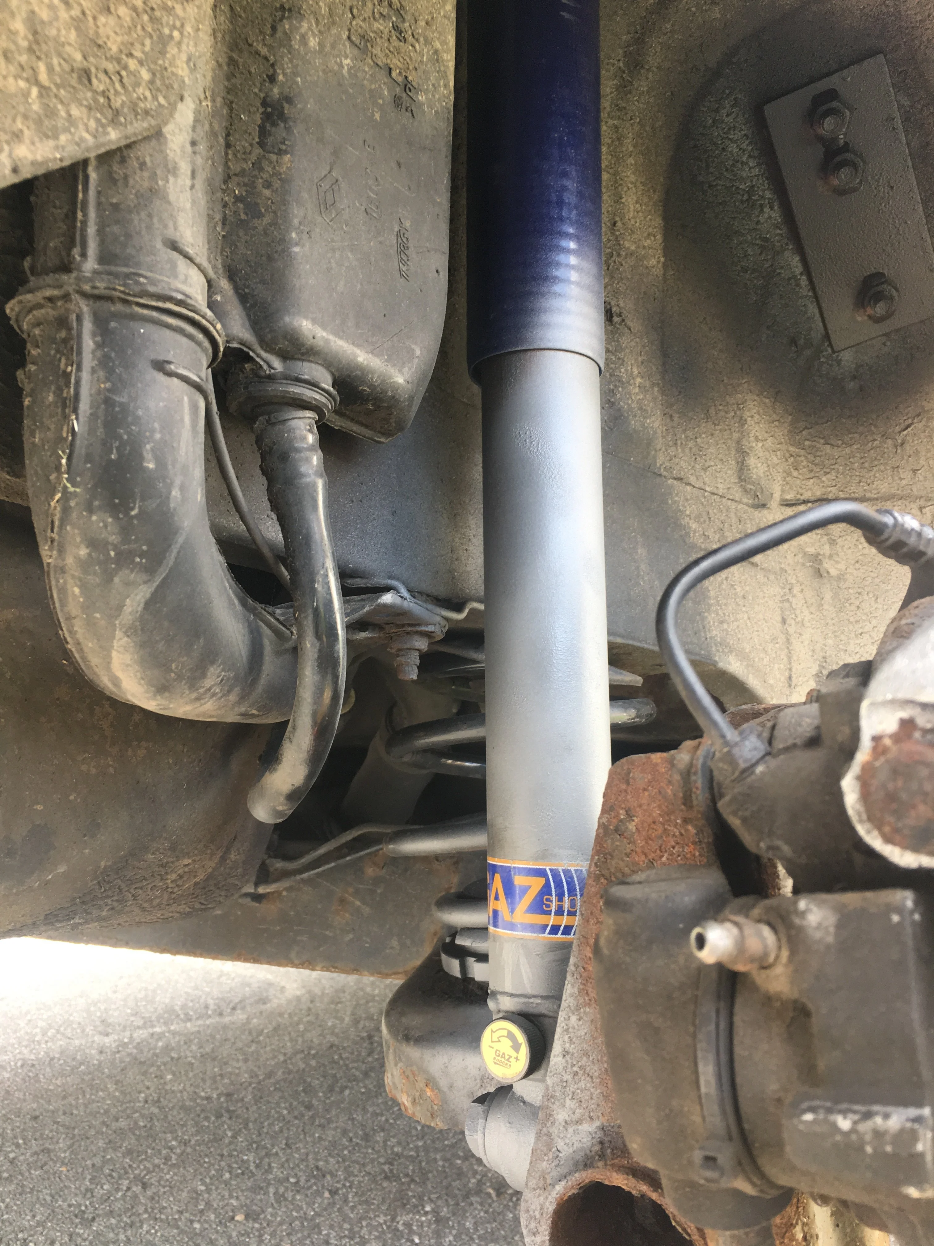

And finally cracked on fitting my GAZ coilovers and powerflex purple rear bushes I bought a few weeks back. Everything went smoothly! Gave them a coat of metaflux which should prevent them from corroding in the future I've set the dampness to half way until I get it out on track and get a feel for what needs adjusted.

When drilling the crotch holes was there any pipes, hoses, etc to avoid or was it clear?
Thanks
Tom
Thanks
Tom
Drivers side was fine, but there's brake pipes next to the inner passenger side. I just moved them out the way and put them back in the clip once finished. I drilled them about 1" back from the cross member and 6" apart using the hole in the photo as a C/L.
Perfect.
Thanks, I'm hoping to fit mine tomorrow so will copy.
Did you use fix the spreader plates to the bottom of the vehicle with silicone, etc or just let bolt hold it up?
Finally, What plates did you you use to attach the lap mounts? Same as the crotch belt?
Perfect.
I put a bead of silicon on the face on the plate to keep it water tight just some water resistant stuff which is suitable for external use. Then gave it a coat of underseal, this stuff http://www.screwfix.com/p/hammerite-vehicle-underbody-aerosol-seal-black-600ml/6221h
Yeah the same plates but I had to cut them to make them fit basically just chop a corner off so they end up like a triangle. Just make sure you mount them further back than what I did to avoid the speader plate that's there for the seats.

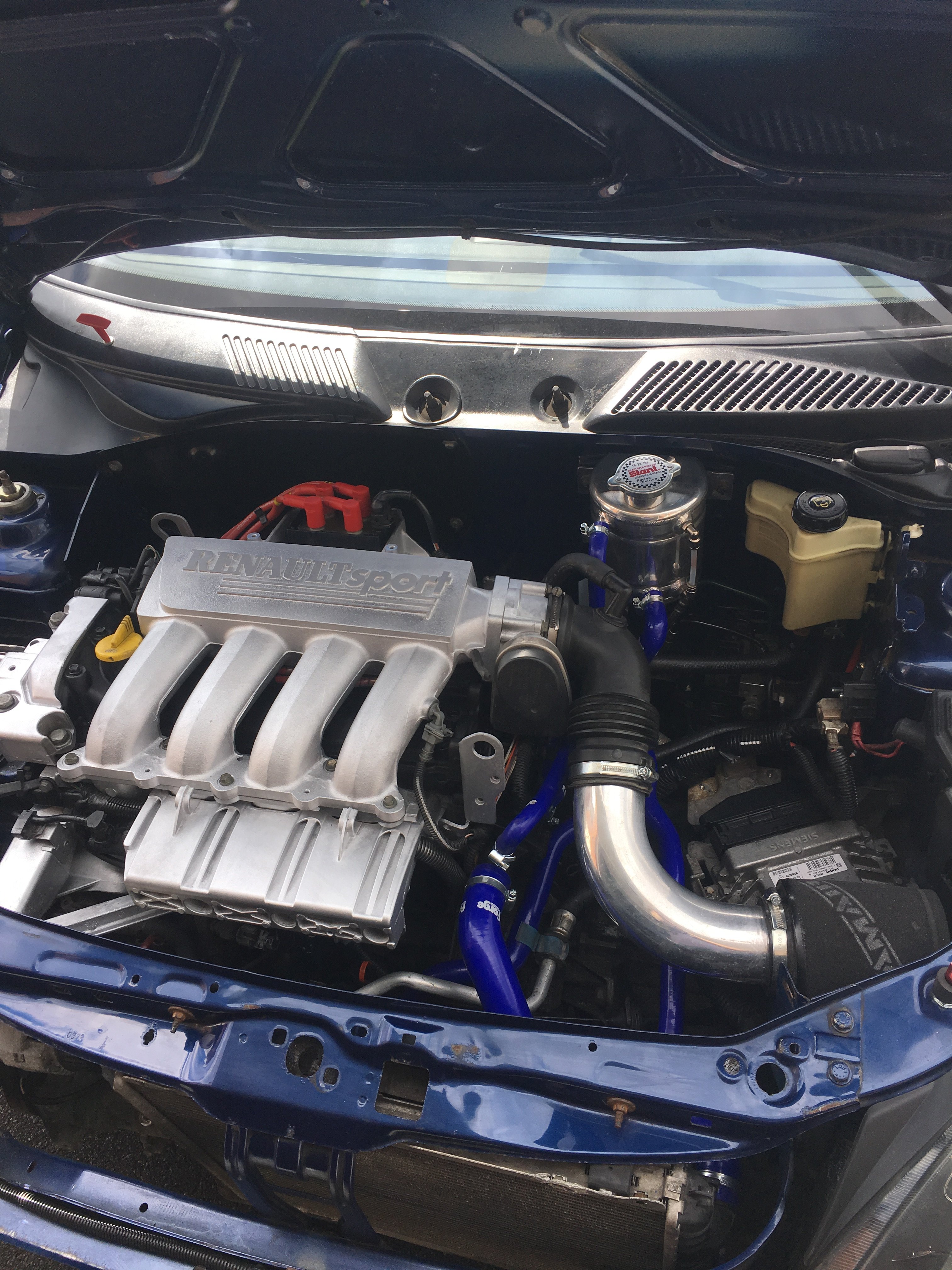

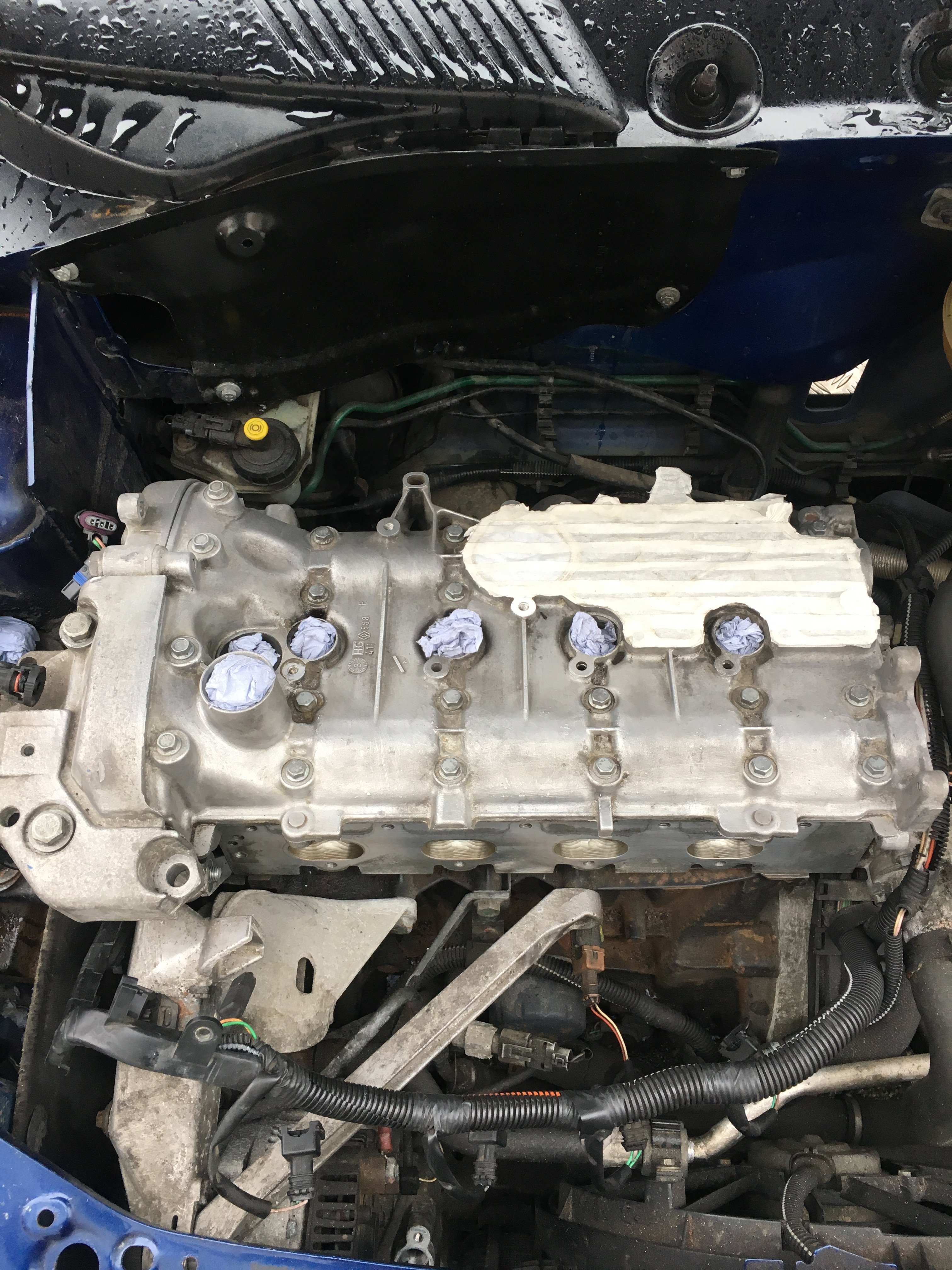

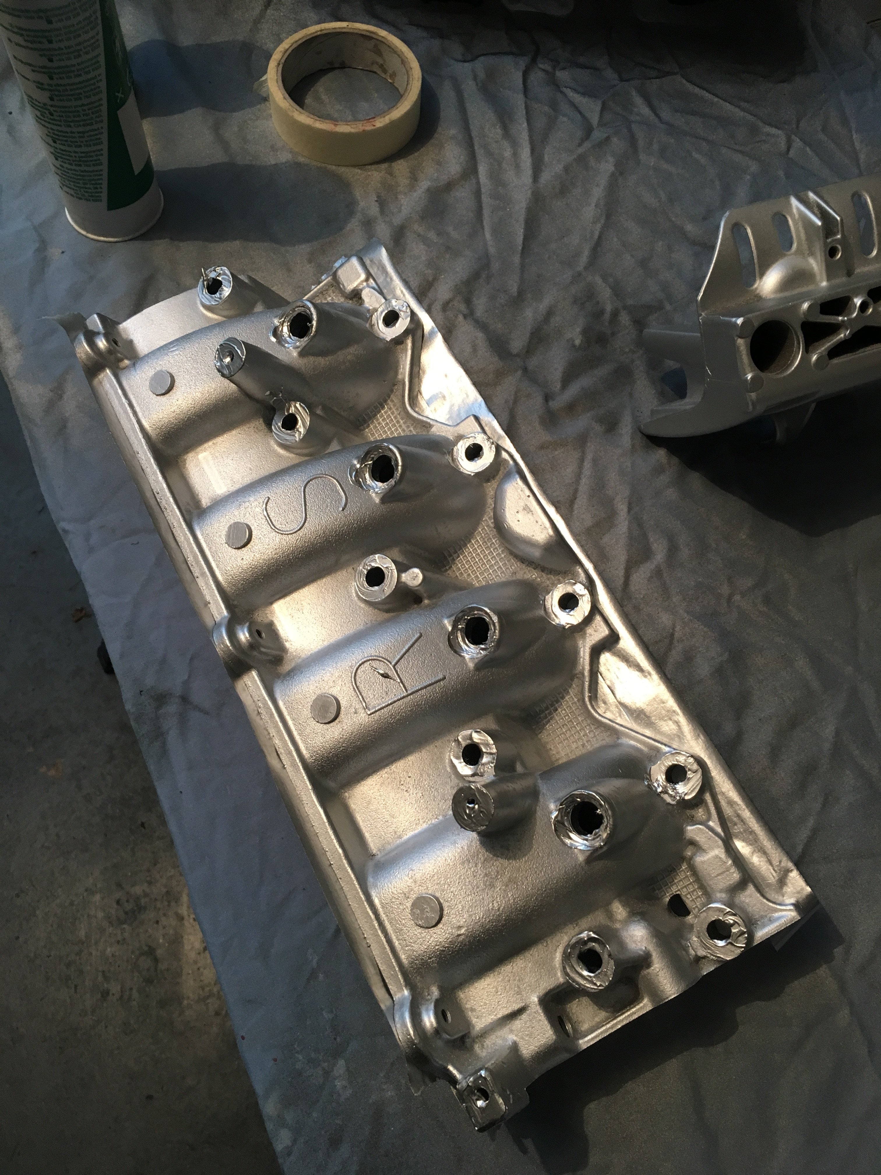

Started removing my carbon canister when I got in from work the other morning and it has turned into a full engine overhaul Removed the intake to get them cleaned up and made a start on cleaning the cam cover ready to paint. When I get a full day I'll get the engine mount off, clean and paint that up and re fit everything along with my Forge hoses and AH Fabrications header tank. Unfortunately I never took before photos so you can't really tell how well it's cleaned up.
Pretty happy with the finish used a wire brush and red scotchbrite to remove most of the dirt then scrubbed them with brake and clutch cleaner to remove any oil and grease. Used VHT paint from ECP which I cant recommend enough, goes on so well and I picked up 2 cans for under £10 so can't humble at that! Going to paint the cam cover black as it's always going to get dirty and isnt the easiest part to get to.

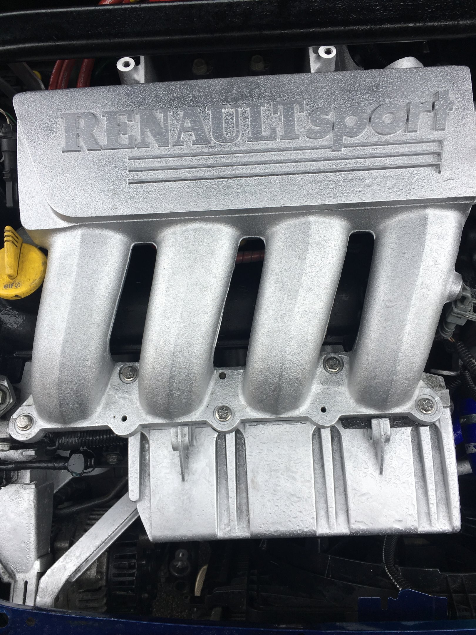

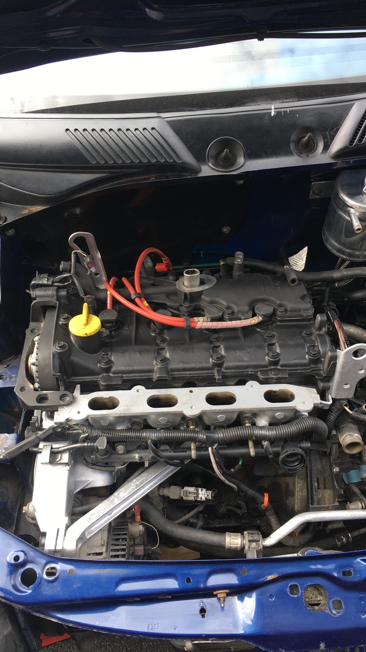

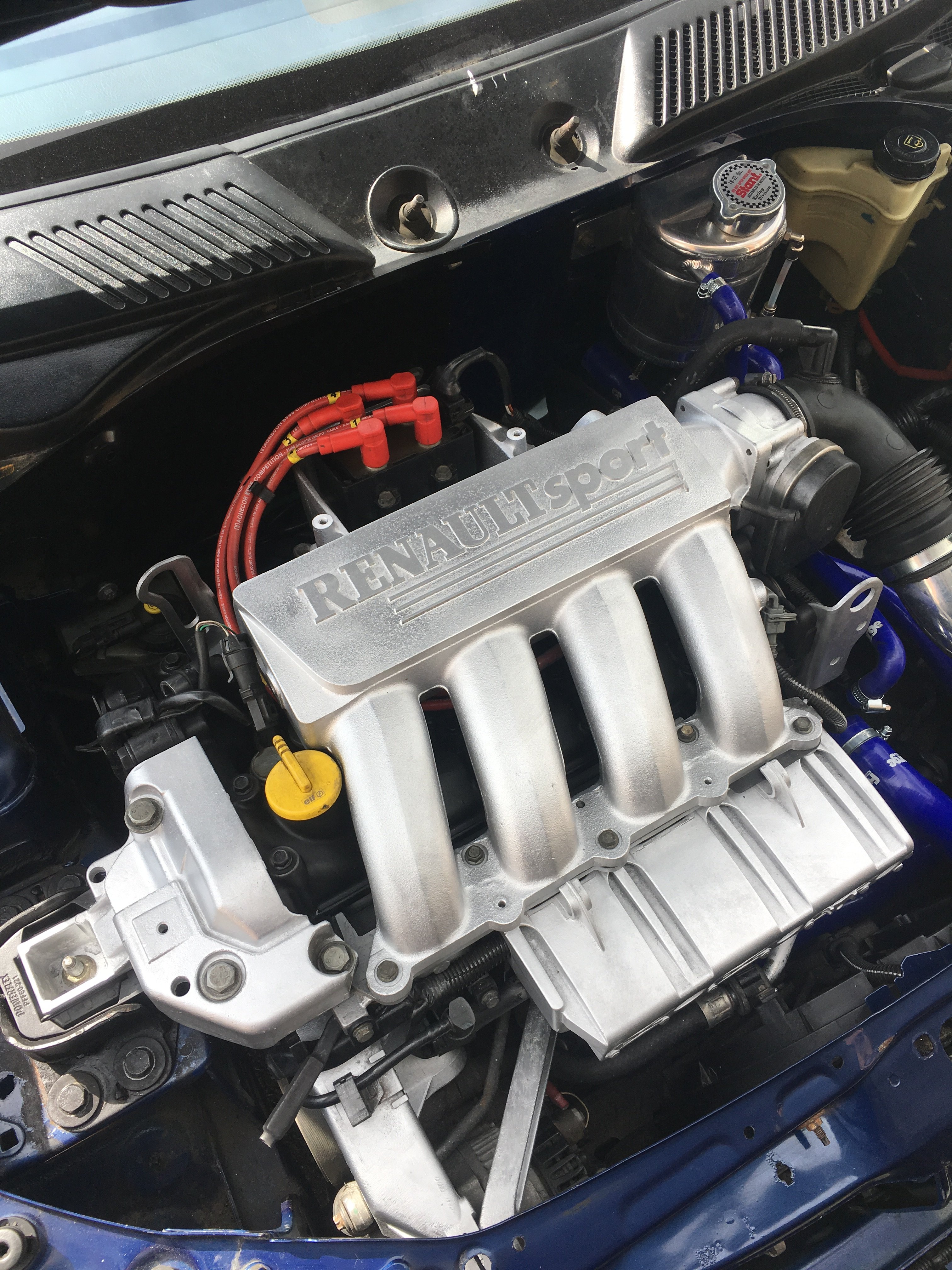

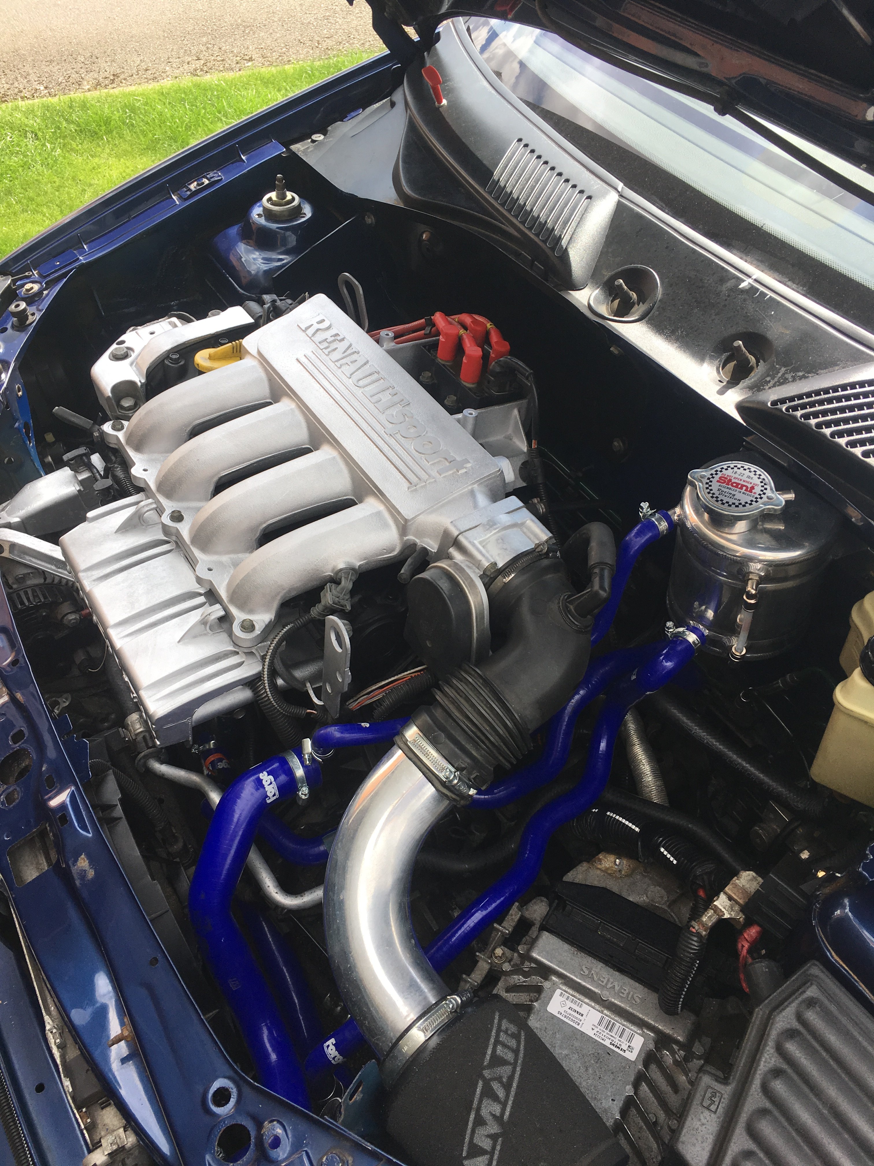

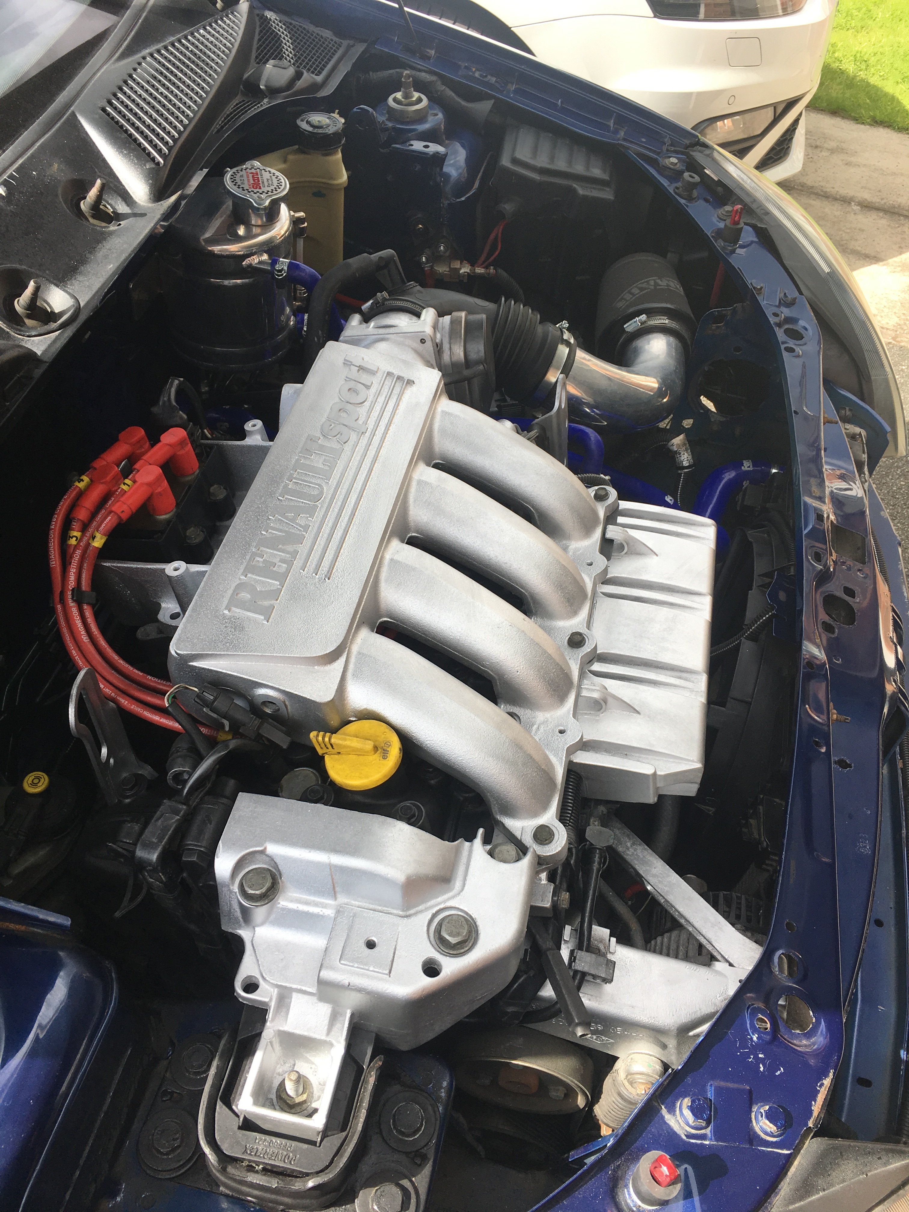

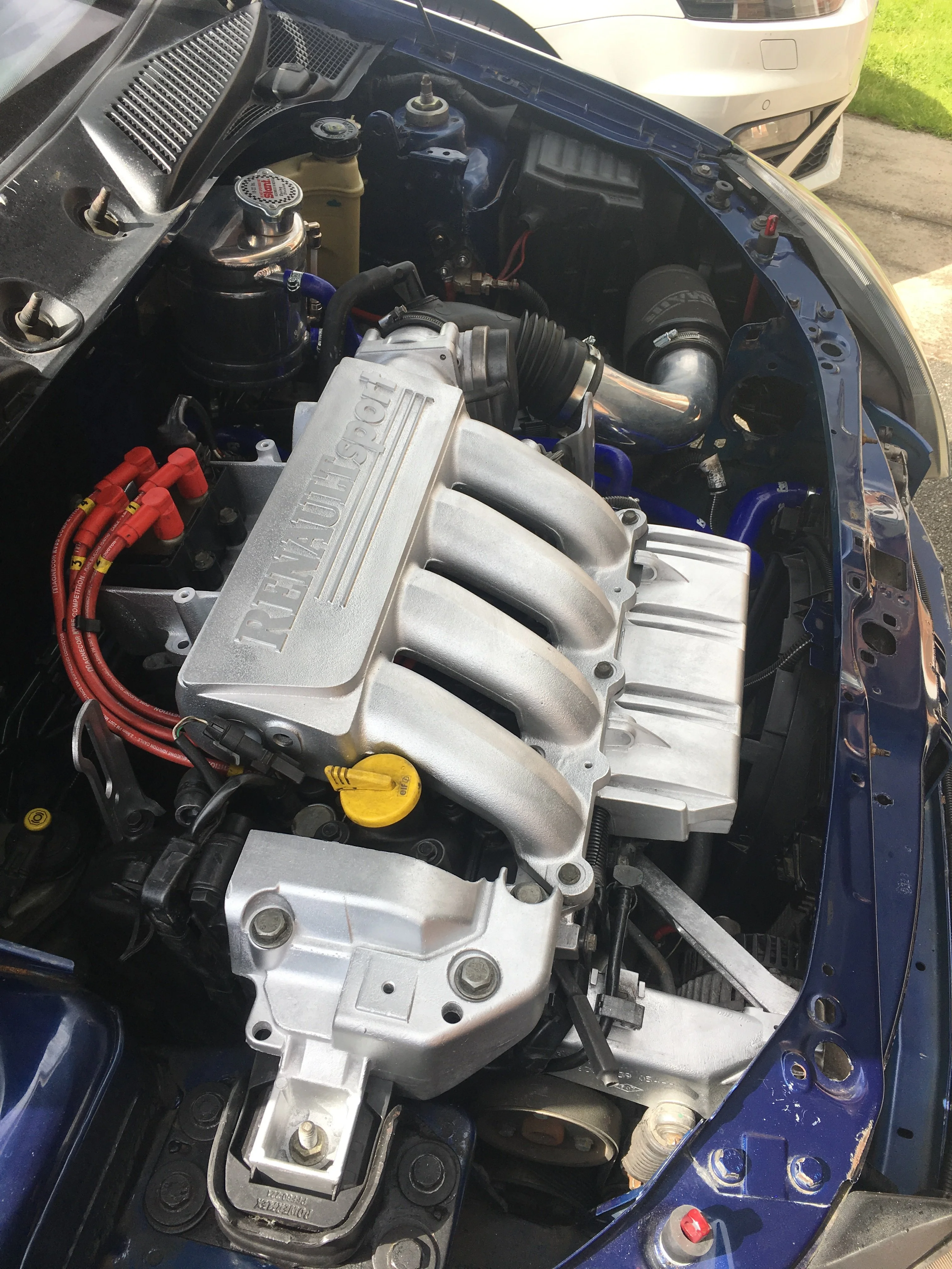

Got the engine bay sorted yesterday, very happy with the outcome, still need a few little bits and pieces to finish it off but it's still a massive improvement! Ordered some new intlet bolts as a couple of mine were missing, some new rad nuts as mine are rusty, want a matching Forge elbow to replace my standard one and fit a oil catch can.

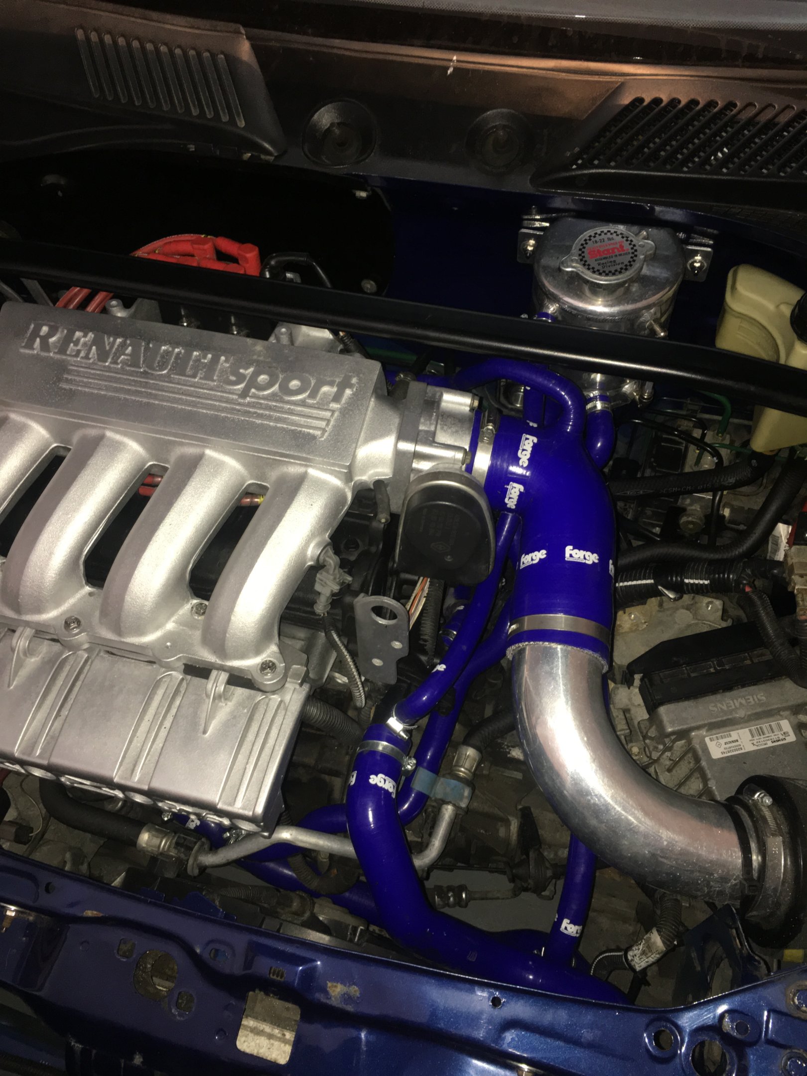

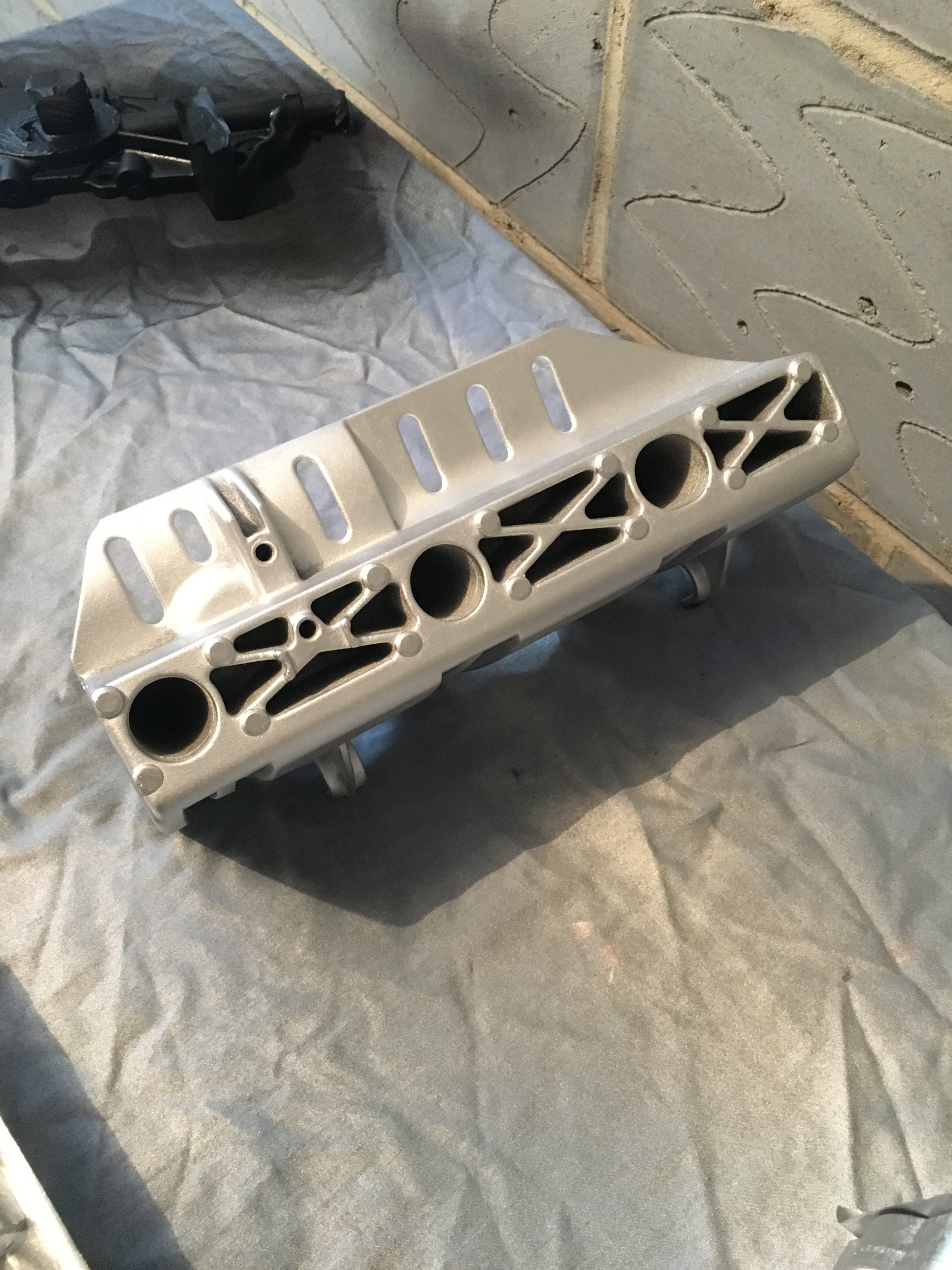

Few little updates, replaced the inlet bolts with some stainless steel bolts and managed to get hold of a Forge intake pipe. Very happy with the engine bay now, on the look out for some ktec engine and gearbox mounts.

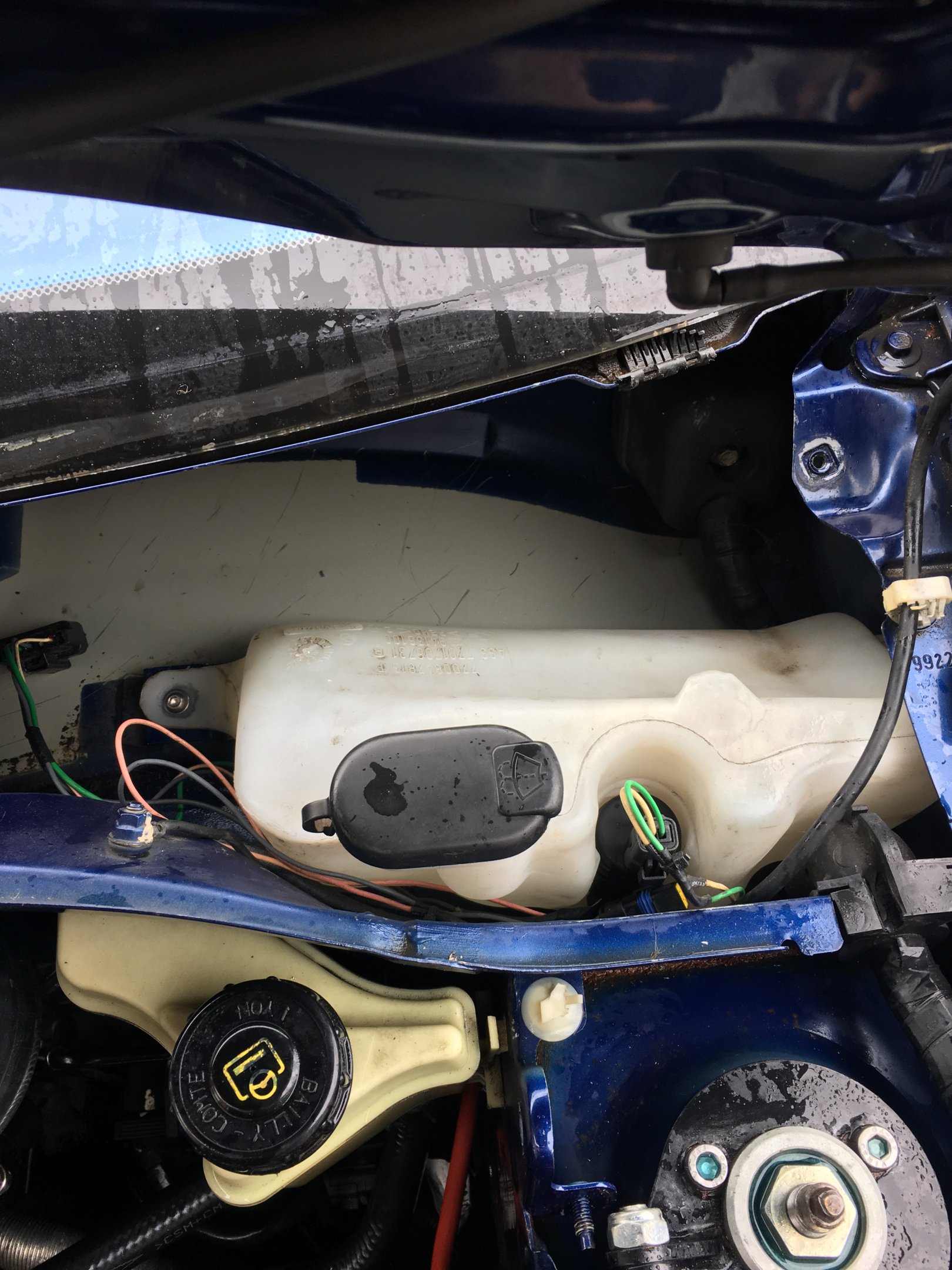

Finally got round to fitting the cup washer bottle I bought but for some reason the rubber seal was missing so need to pick one up.

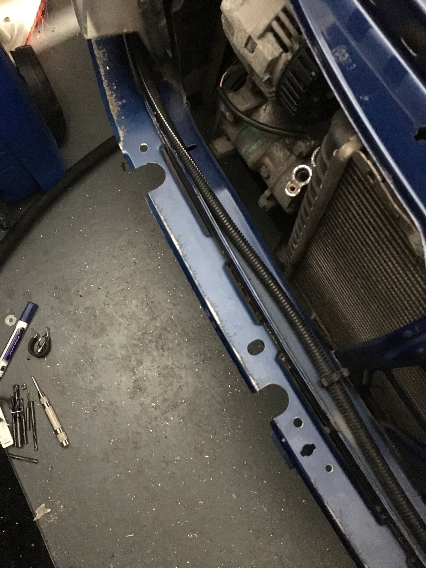

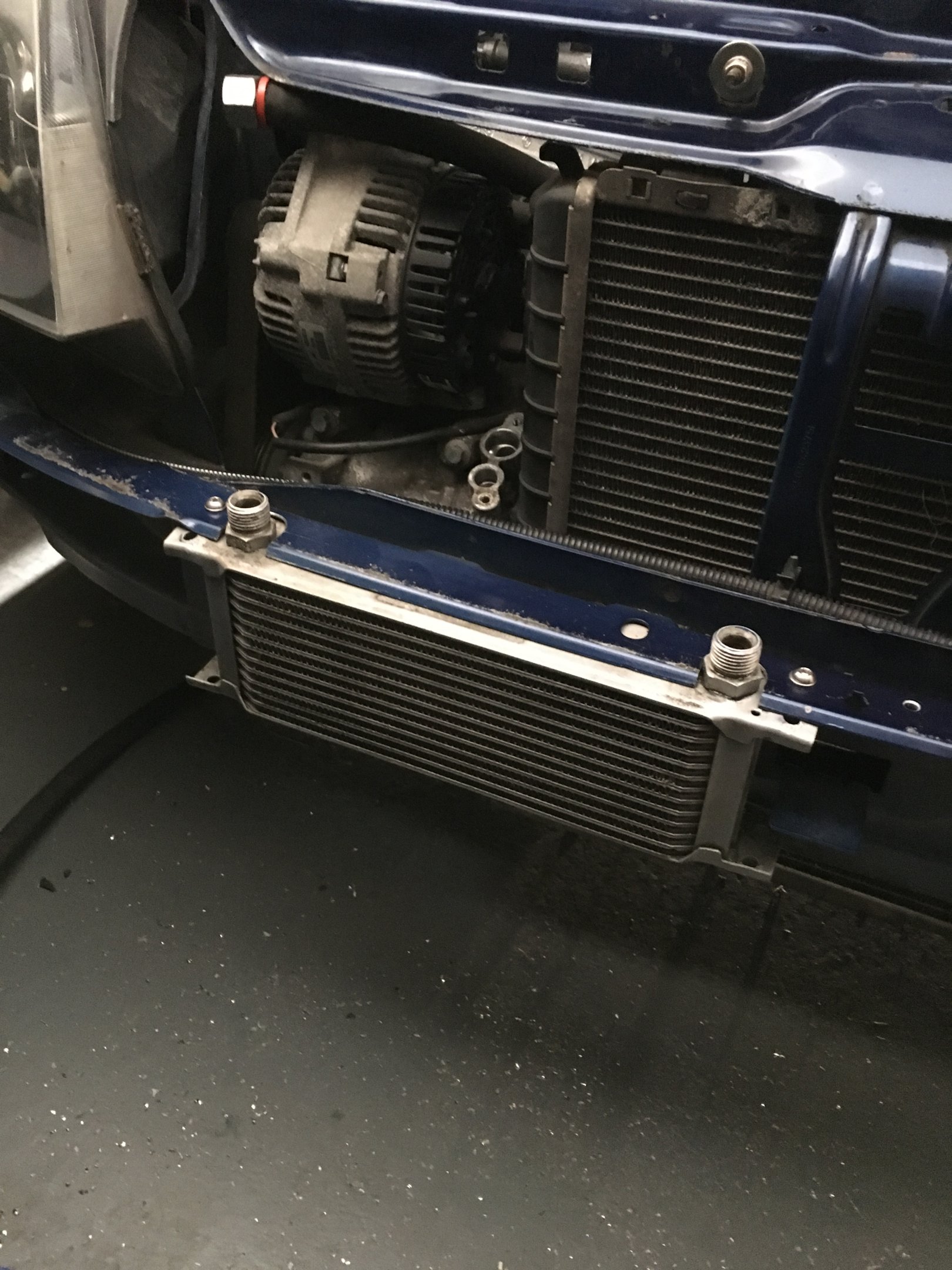

Bought a 13 row oil cooler and set about getting that mounted before work tonight. Deciced to mount it with the inlet/outlets upright rather than downwards this also reduced the length of hose.
