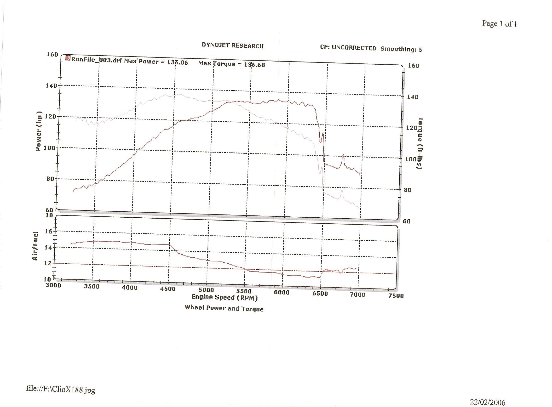

Bad news: My 172 is with Yozzasport at the moment for some tinkering. The initial rolling road was very disappointing showing a peak of 134bhp. Now that the engineers have got in to the engine they've discovered that one of the cam followers has broken off, before the car was ever sold, and I have a perfectly clean cam lobe!!

here's the graph
no the car cut itself off at 6.5K!! kinda just gave up
