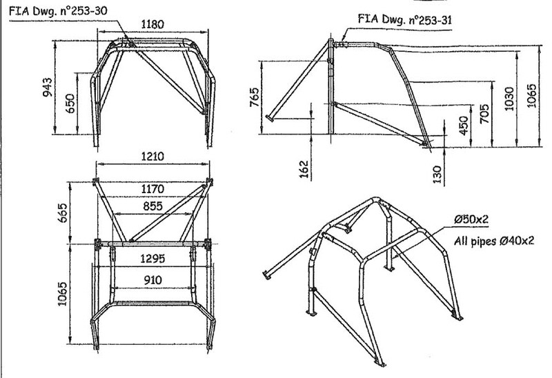

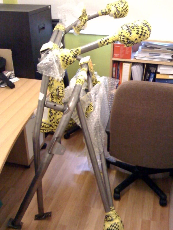

Oh this just turned up!
Drawing of that cage

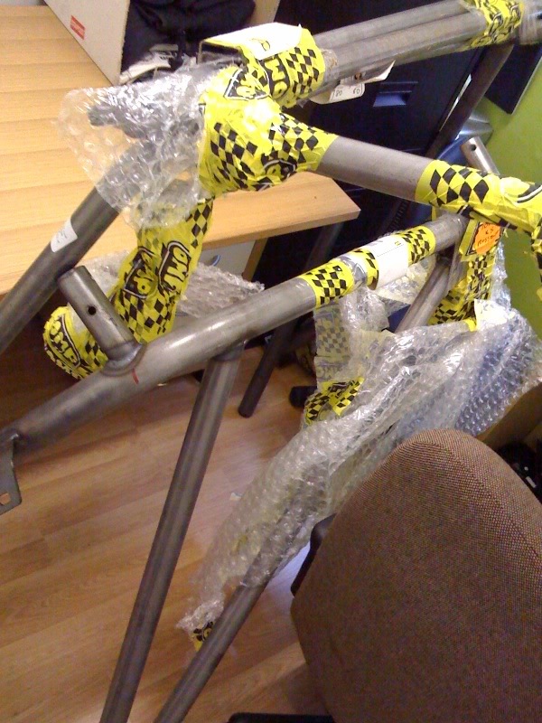

they quoted 4 weeks, then got a email lastnite saying its in stock, will be delivered between 3-5 days!
Then it just turned up!
