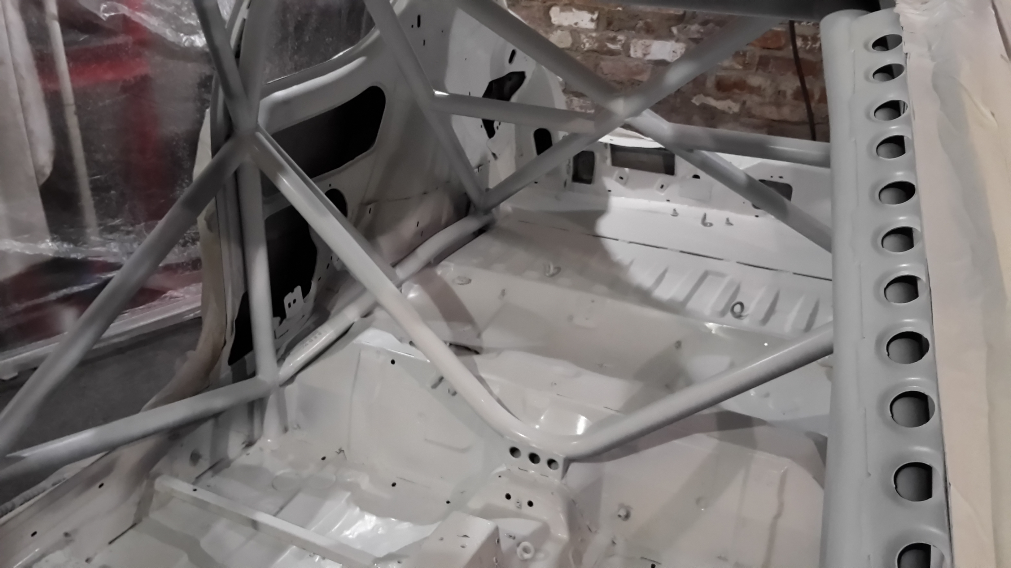

No not had any seam welding. The cage is been put in very tightly, so all the small gaps between the cage and the chassis where they almost touch have been welded together.
It should be very stiff!
all the unused brackets have been taken out - not really anything left to remove!

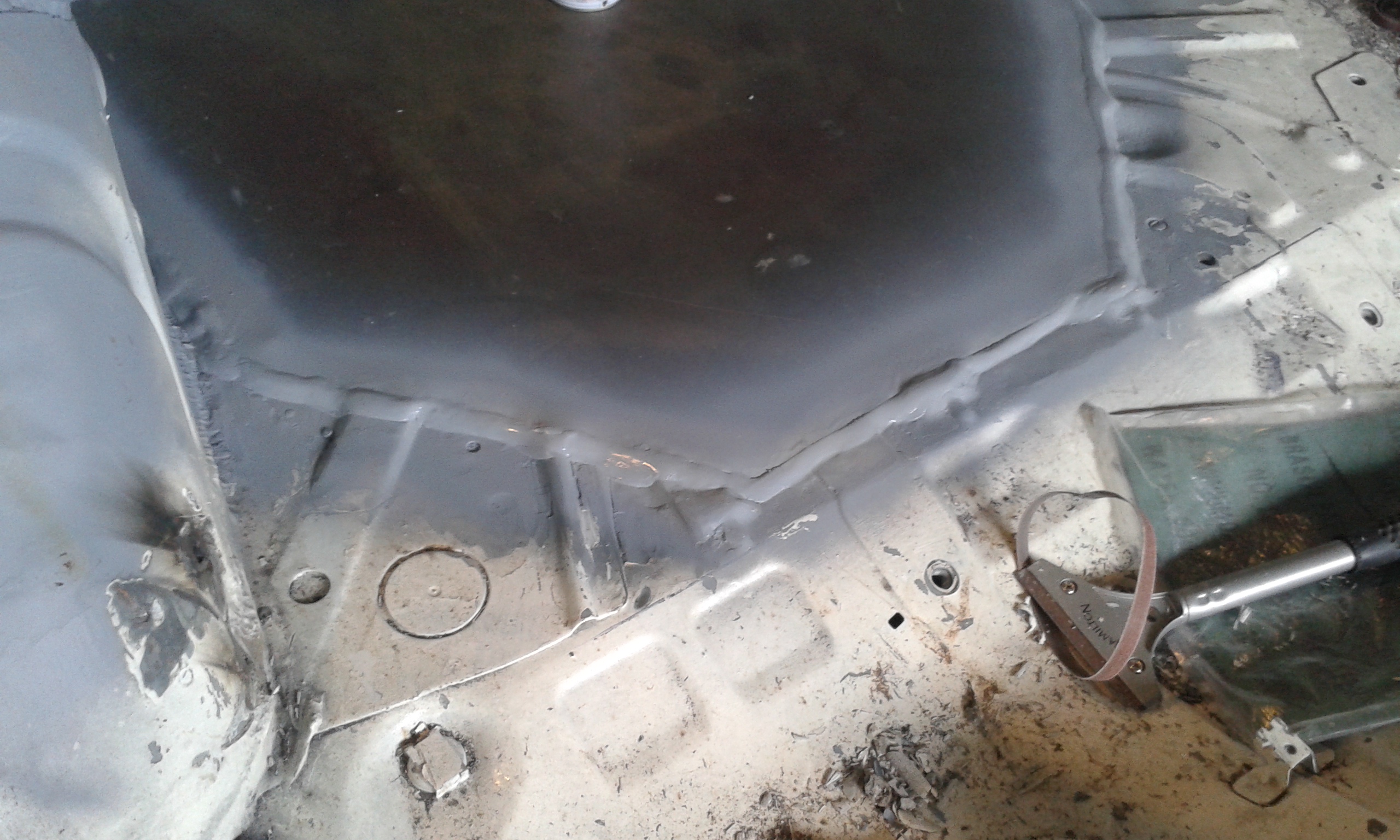

Was the 182 floorpan too corroded to keep in?
  172 Rally Car
Well it was mainly the fact it was riveted as to why I removed it. When removed the panel all one corner was rusty, by the time I'd cut it back it didn't fit anymore!
Ah right fair play, guessing someone had just riveted it to hold it in place ready to weld. New plate looks tidy, good effort.

No welding was going to take place, it was riveted and the P40'd over.

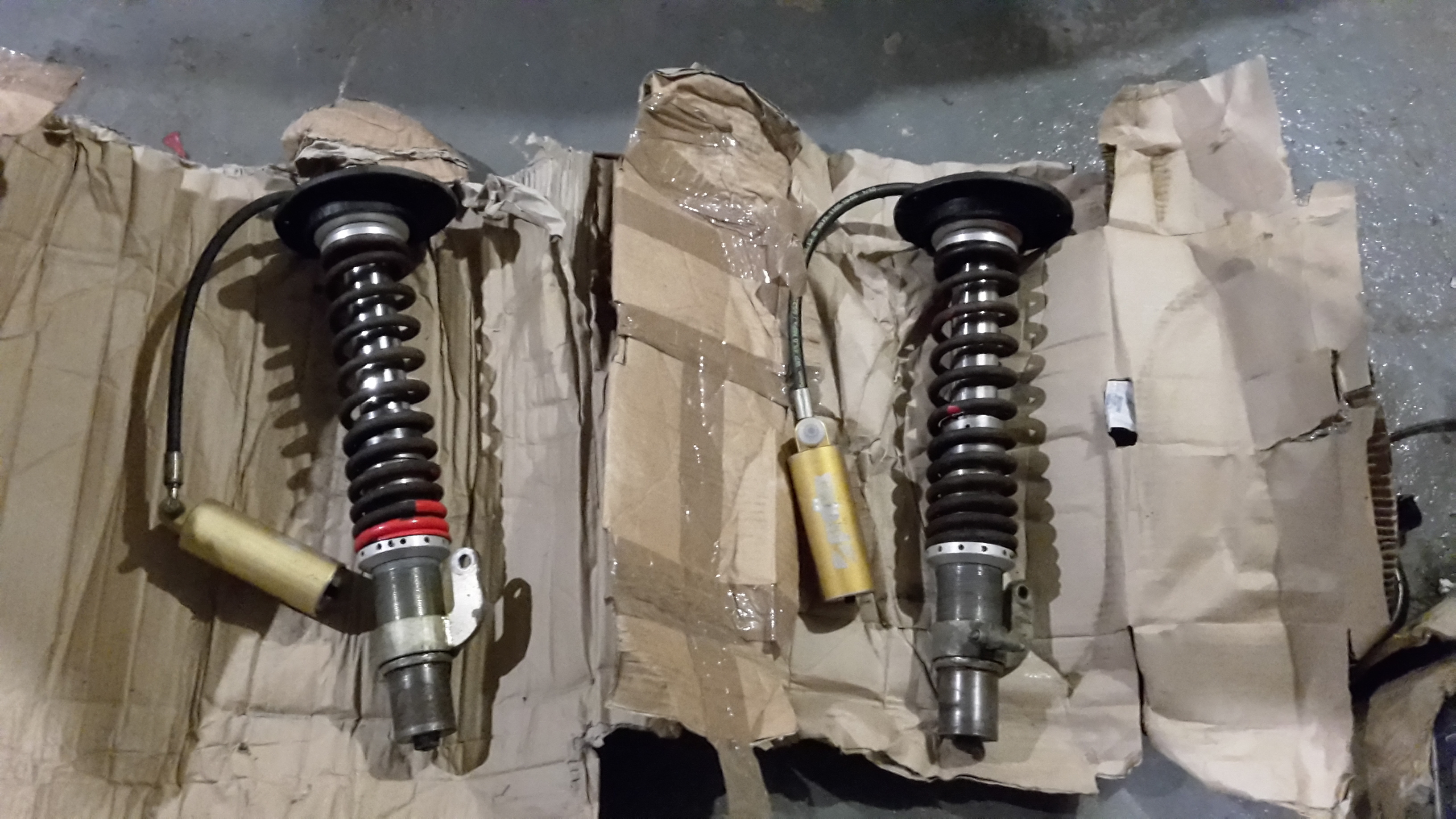

Regards handling then with 500lbs rear springs in amazed you can drive it. Seat time is the most important, the Clio can be a competitive car but you will need to spend a lot to be fighting for trophies.

The car has 500lb springs in the standard position so equivalent of 250lb on a full coilover. What does yours use spring wise?

That sounds better ! Mine runs slightly softer but it only works when you do a few other bits ;-)

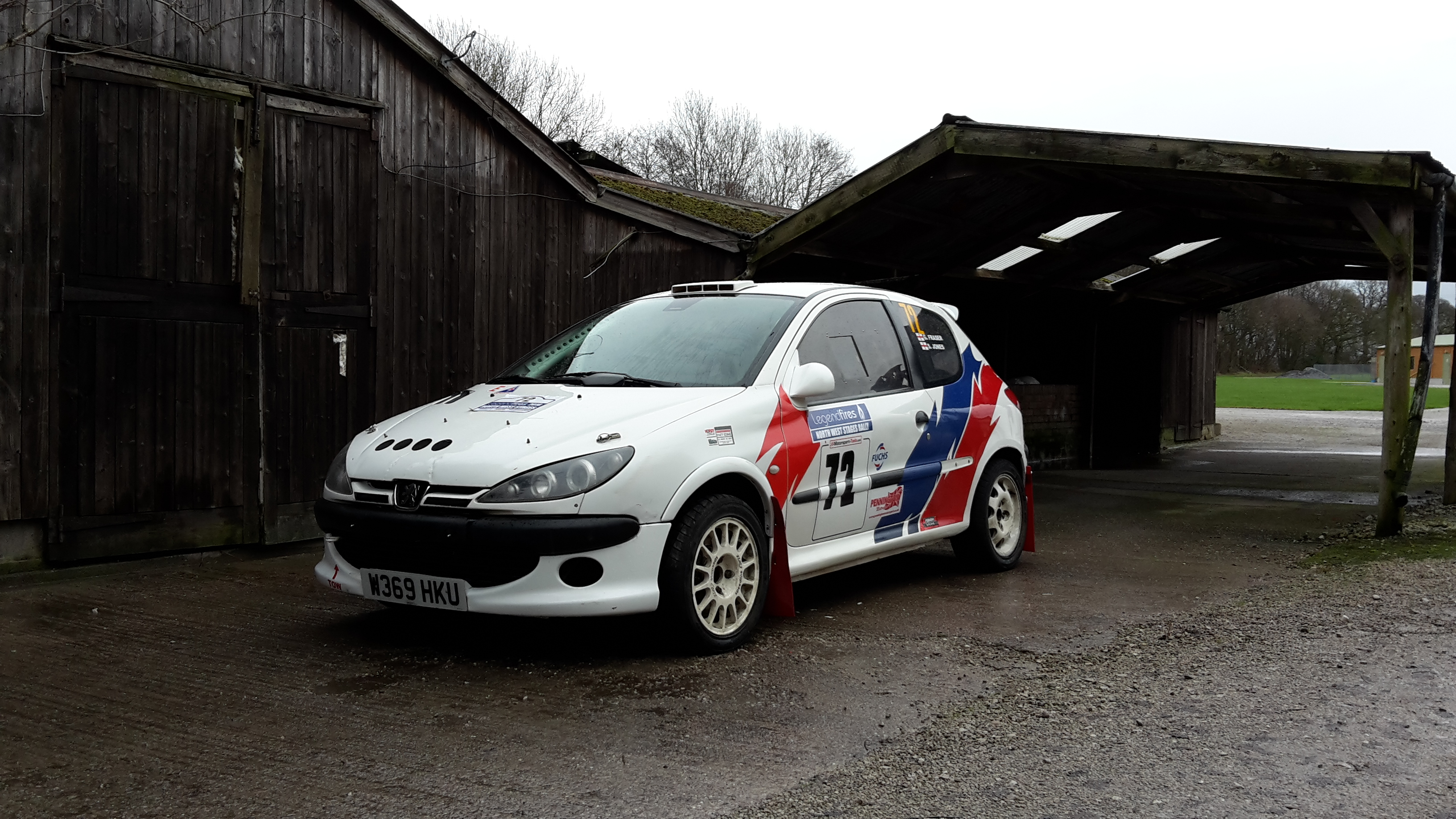

At the end of 2015 i decided to change from the Clio to a 206.
The major reason for the change was the availability of rally specific parts for the 206, and this car came with a spec that i couldn't refuse!
So the basic spec is as follows:
-GTI 180 engine on Jenvey throttle bodies, run by a DTA s60 ecu.
-Close ratio quaife box with a JF plated diff
-Custom cages multipoint roll cage (more about this later)
- Proflex 3 way suspension front and rear
- Wilwood calipers with bells and rotors (fit under 15" wheels)
This image has been resized. Click this bar to view the full image.

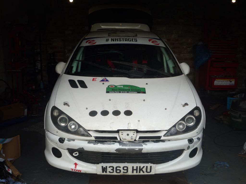

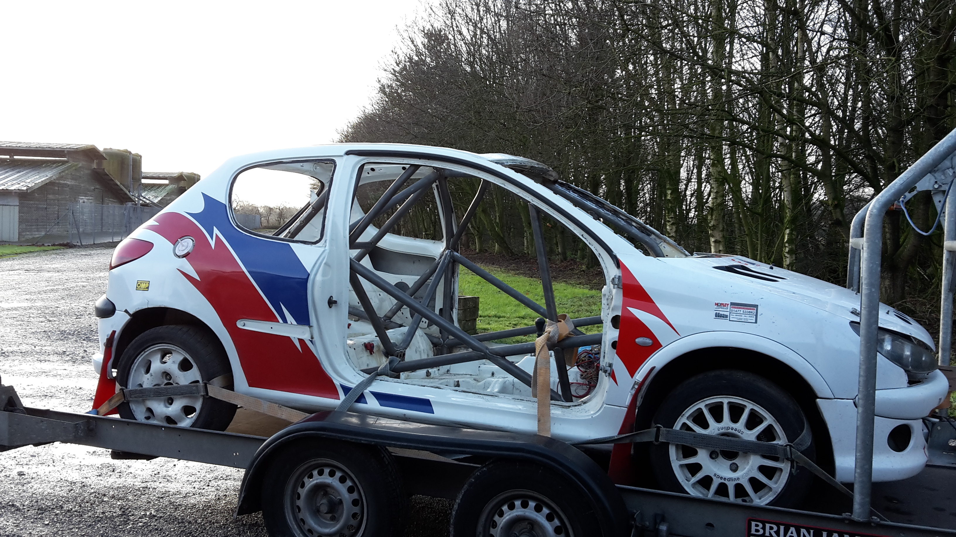

The car was collected from ross on wye in time for a quick check over, ready for the Neil Howard Stages at Oulton park. The car is very different to drive than the Clio, the 206 is much more lively at the rear end which takes some getting used to.
The Neil Howard uses the circuit as well as some of the car park entry roads, these are gravel and quite slick.

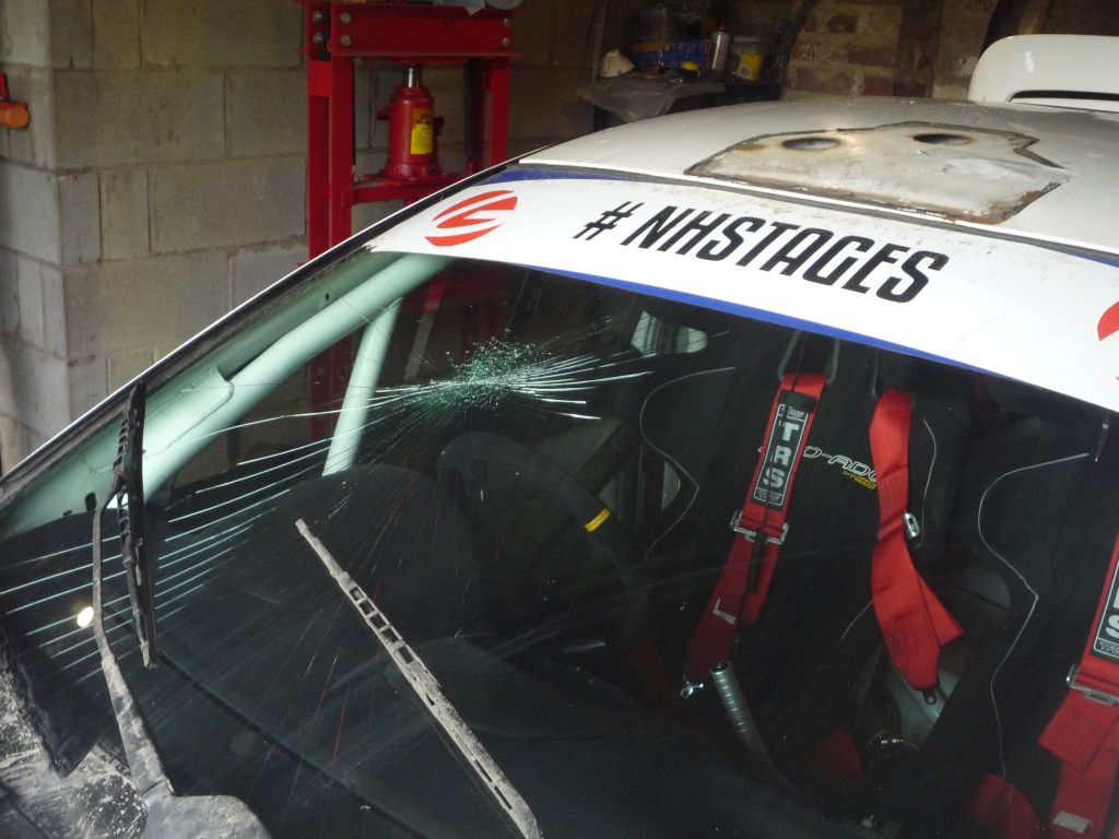

Unfortunately on the second stage we had an impressive "off", hitting one of the spectator fences. This smashed the screen (lucky not to come through), broke the radiator , took the roof vent off and dented the rear wing.
So with the Neil Howard over it was time for a spanner check and check over.

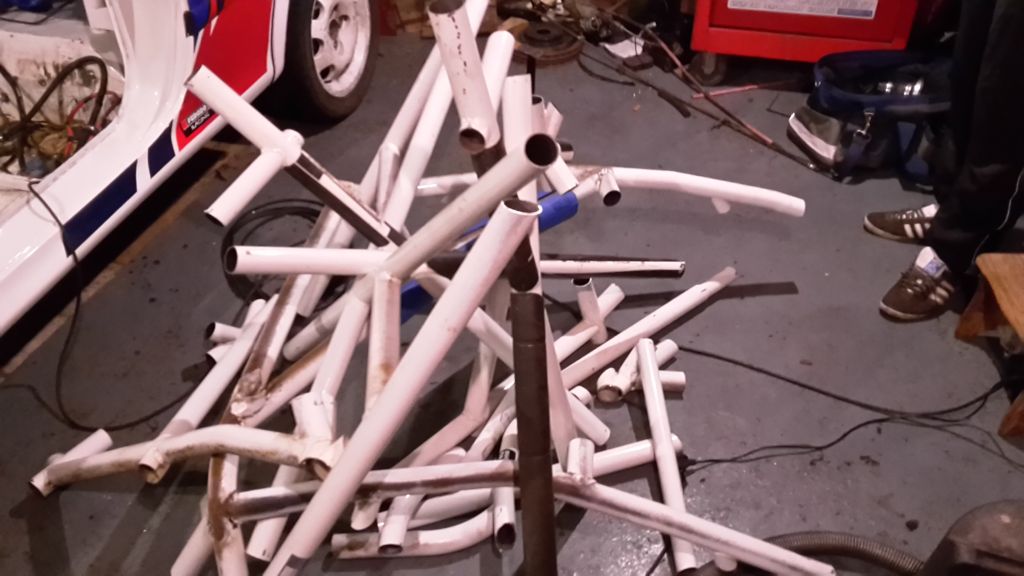

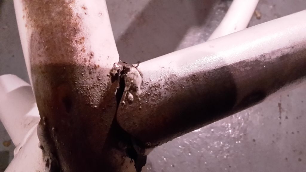

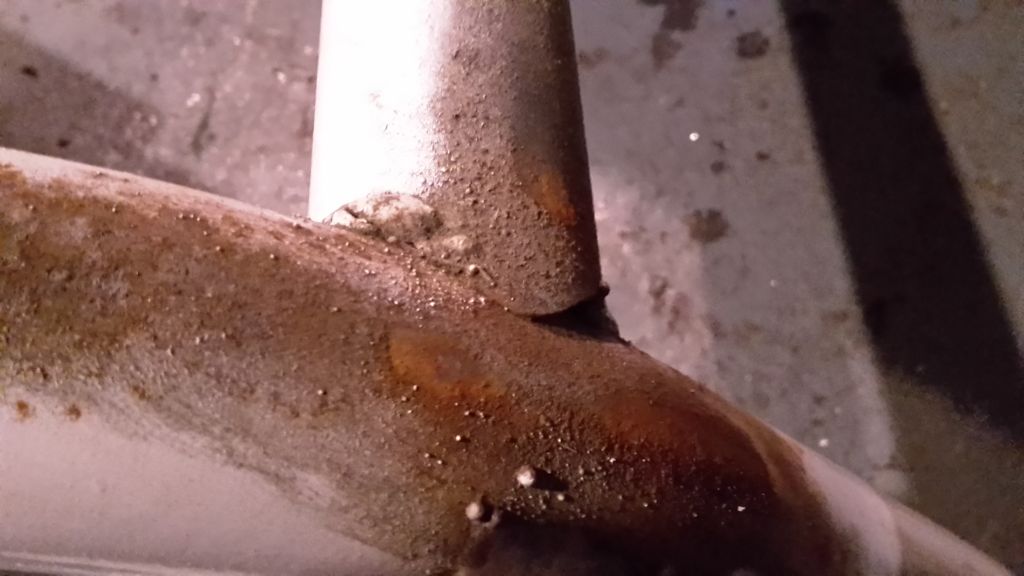

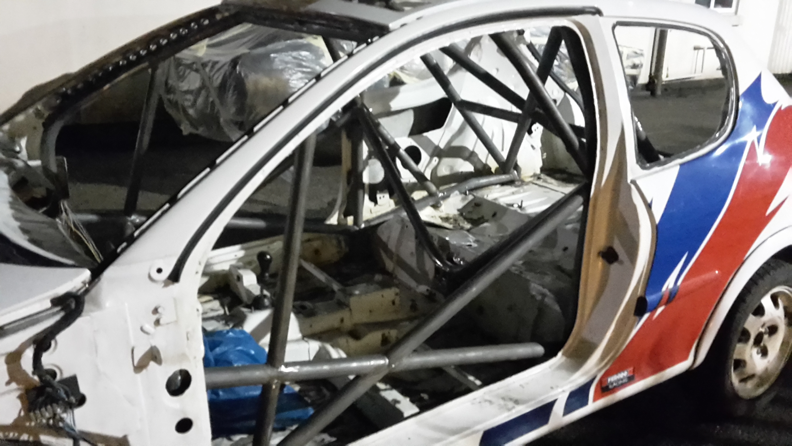

On closer inspection, i noticed some welding on the cage that i wasn't overly happy with..
This played on my mind for a while, safety is something that is important to me no-one wants to end up injured or dead for a days sport.So in the end i decided to remove the cage. REALLY glad i did, most of the joints hadn't been welded on the top and was lethal, worse than having no cage at all. Lesson there though folks, weld in cages are only as good as the welder that fitted them!
http://imageshack.com/a/img903/6470/8qzovm.jpg
The car is now with SW Motorsport in Preston for a new cage, properly fitted this time!
The next event is the Northwest Stages in Blackpool on the 6&7th of February, so plenty to do if i am going to make the deadline
In the meantime i have been collecting parts to but it back together.

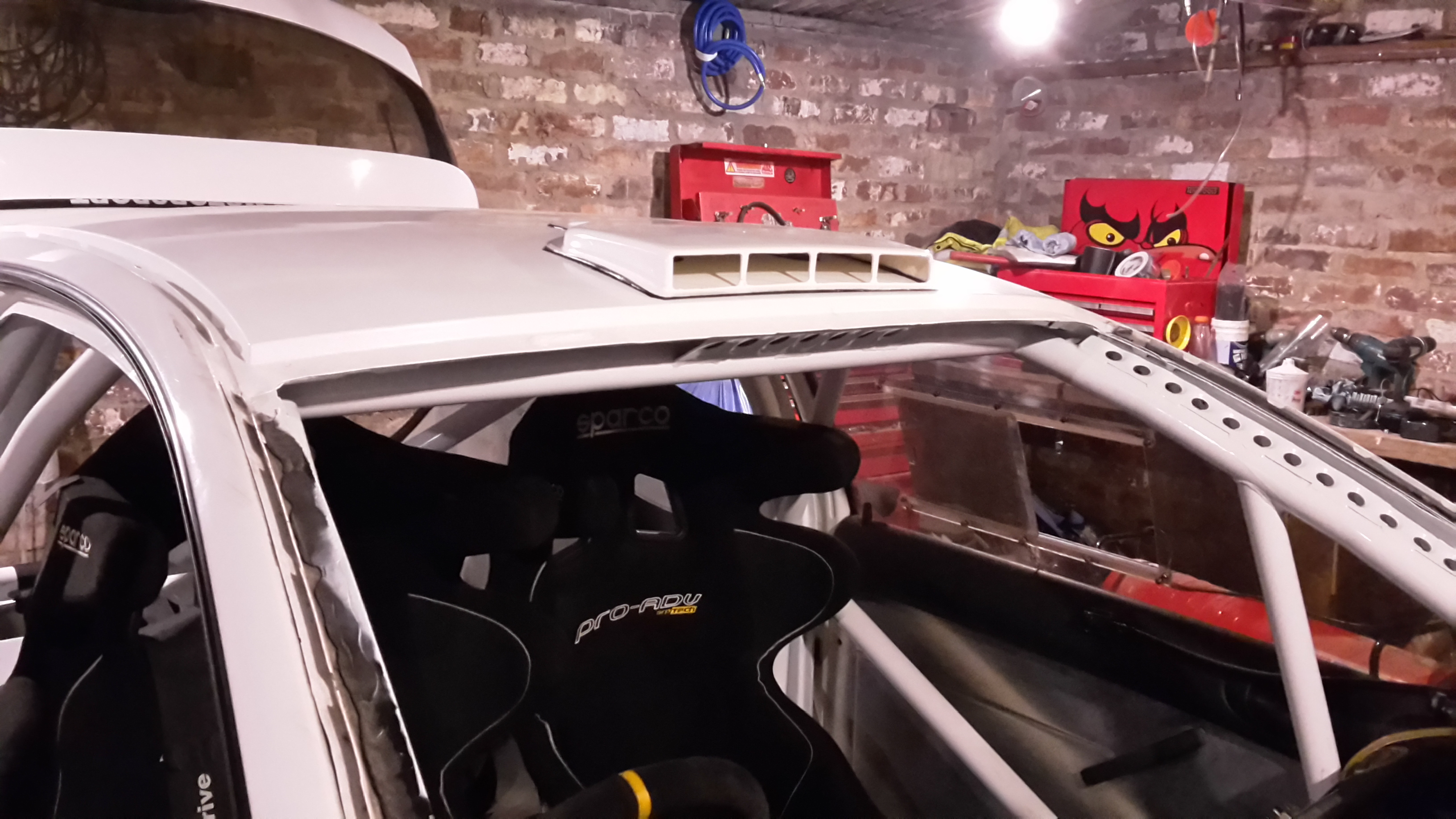

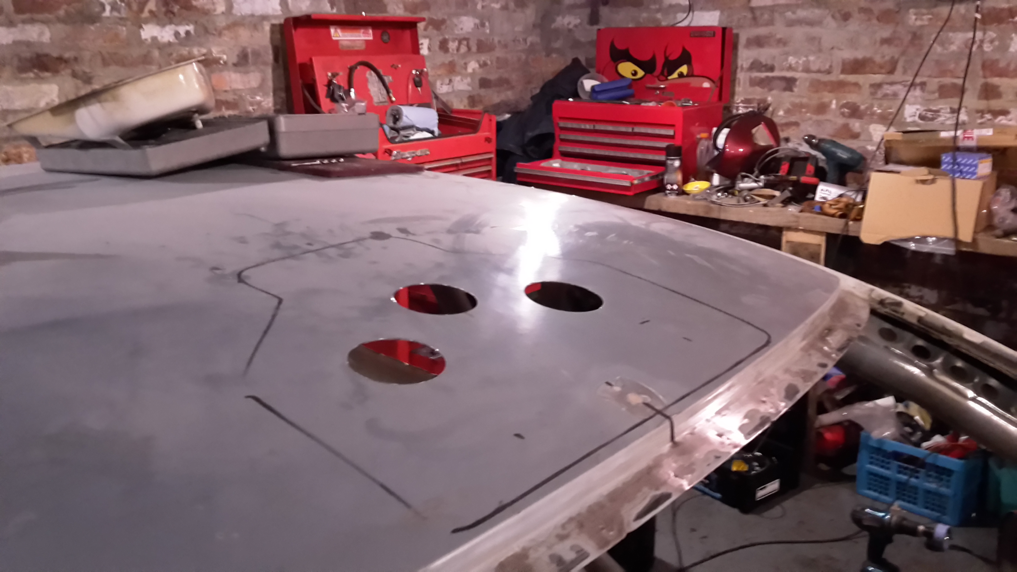

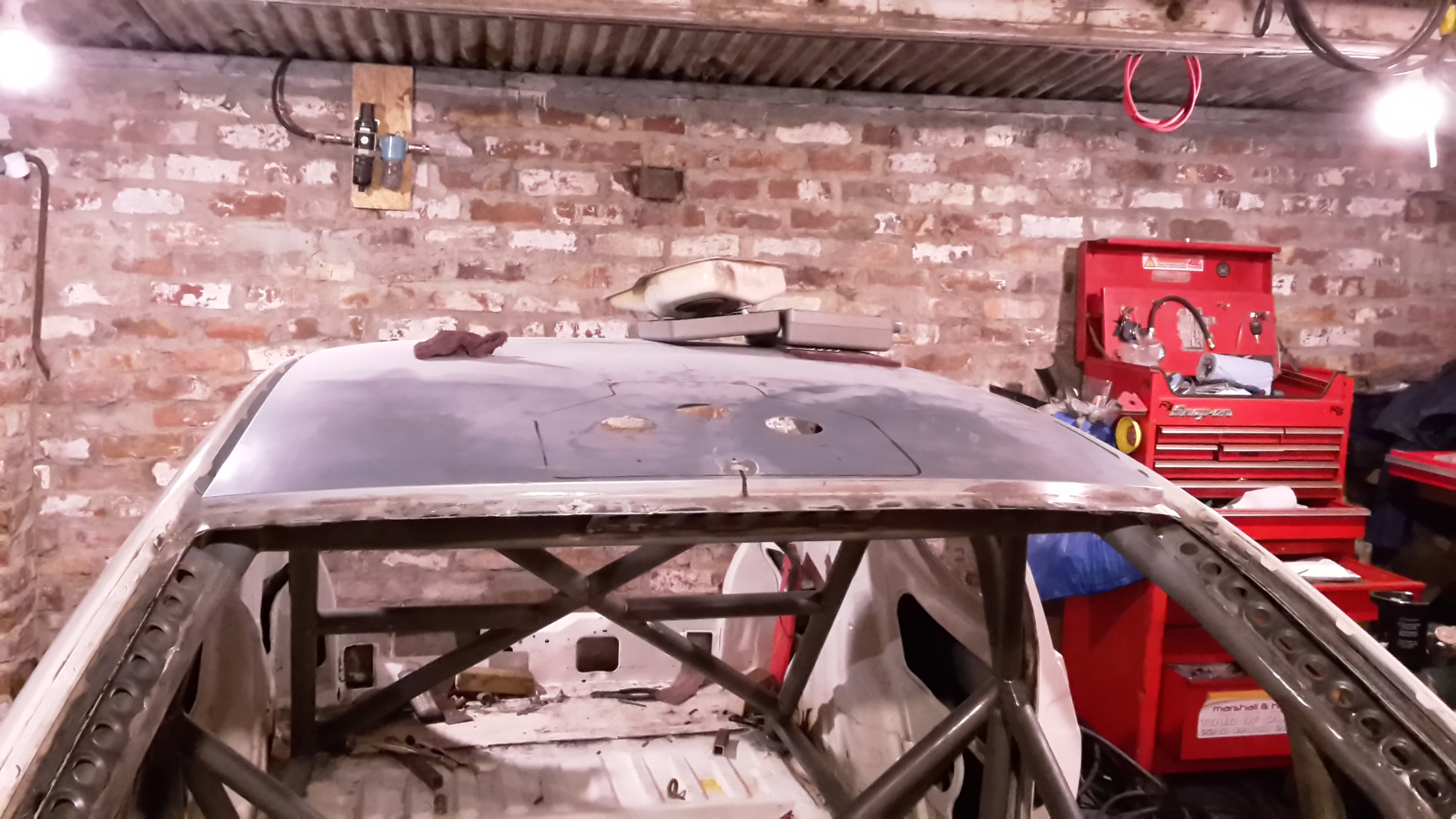

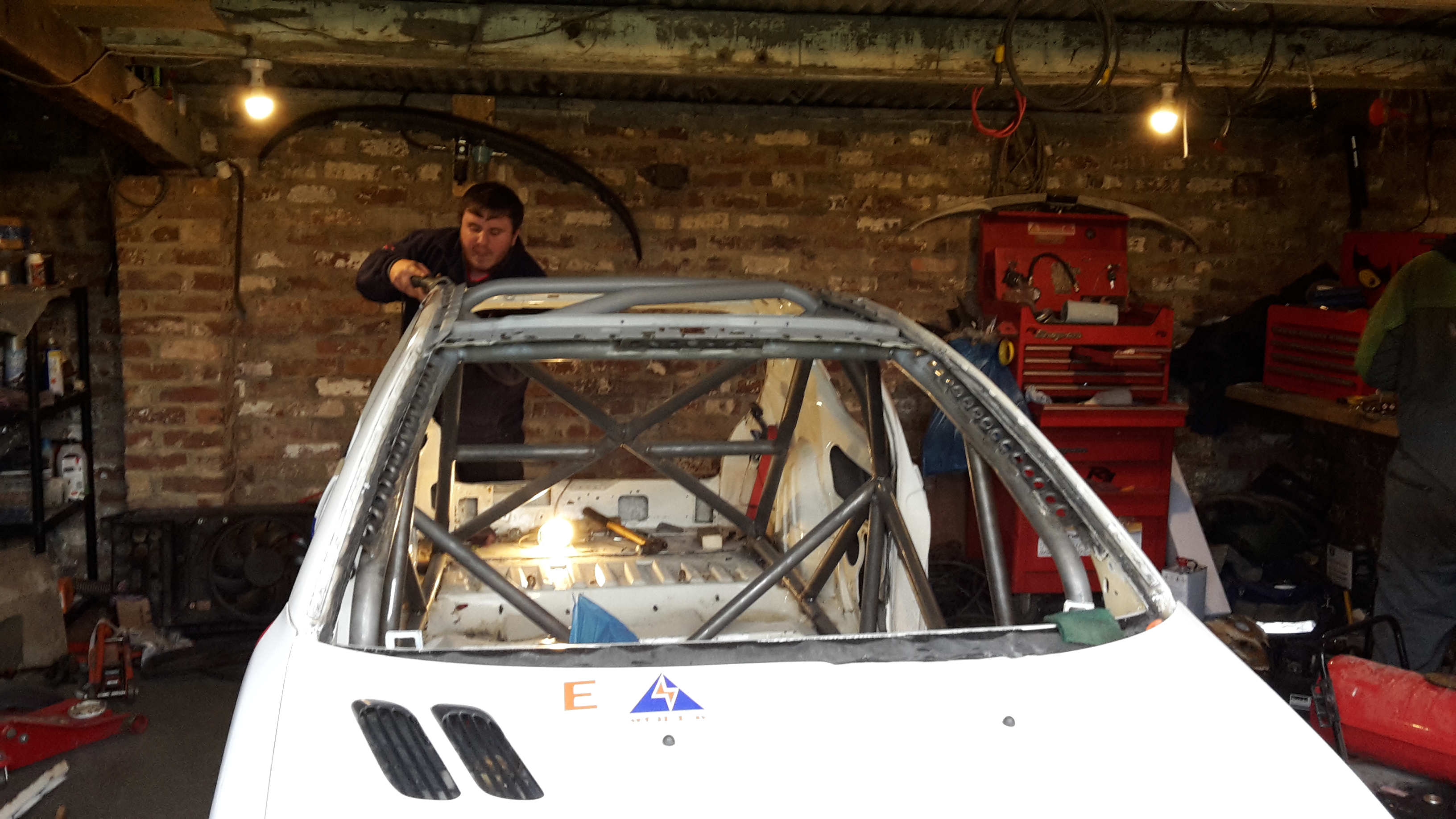

The cowboys that had fitted the cage had cut holes in the roof to try and get to some of the joints then welded the patches to the cage. This meant that when the cage came out it made a right mess of the roof skin and the car now needs a new roof!

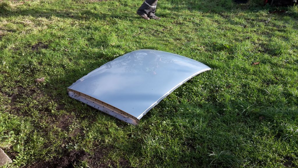

I have collected a roof section and removed the roof skin, ready to fit it when the car comes back on the 23rd of Jan.
Removing a roof skin really is as simple as it looks. Drill the spots out (carefully) then separate the skin from the carcass.

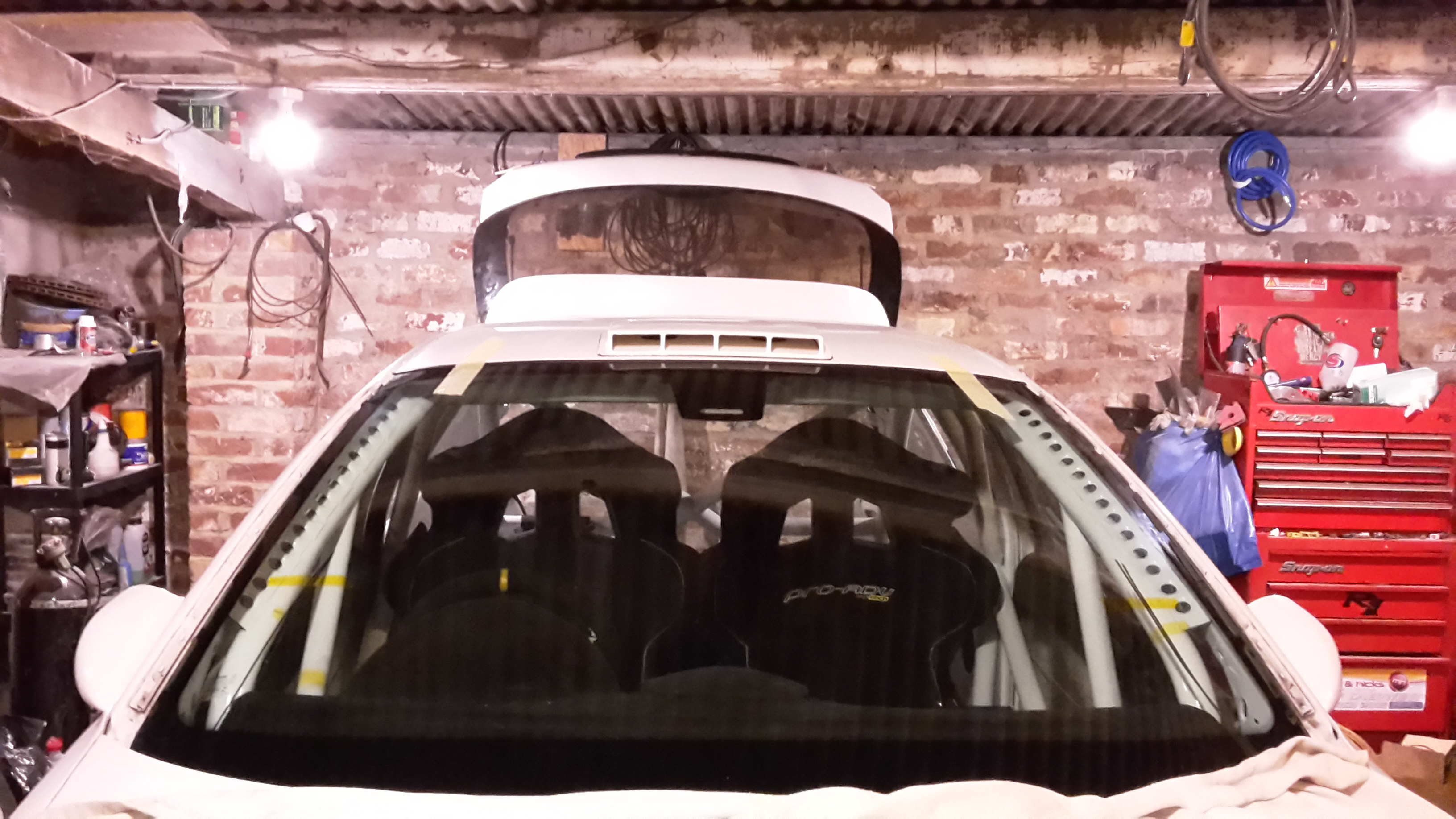

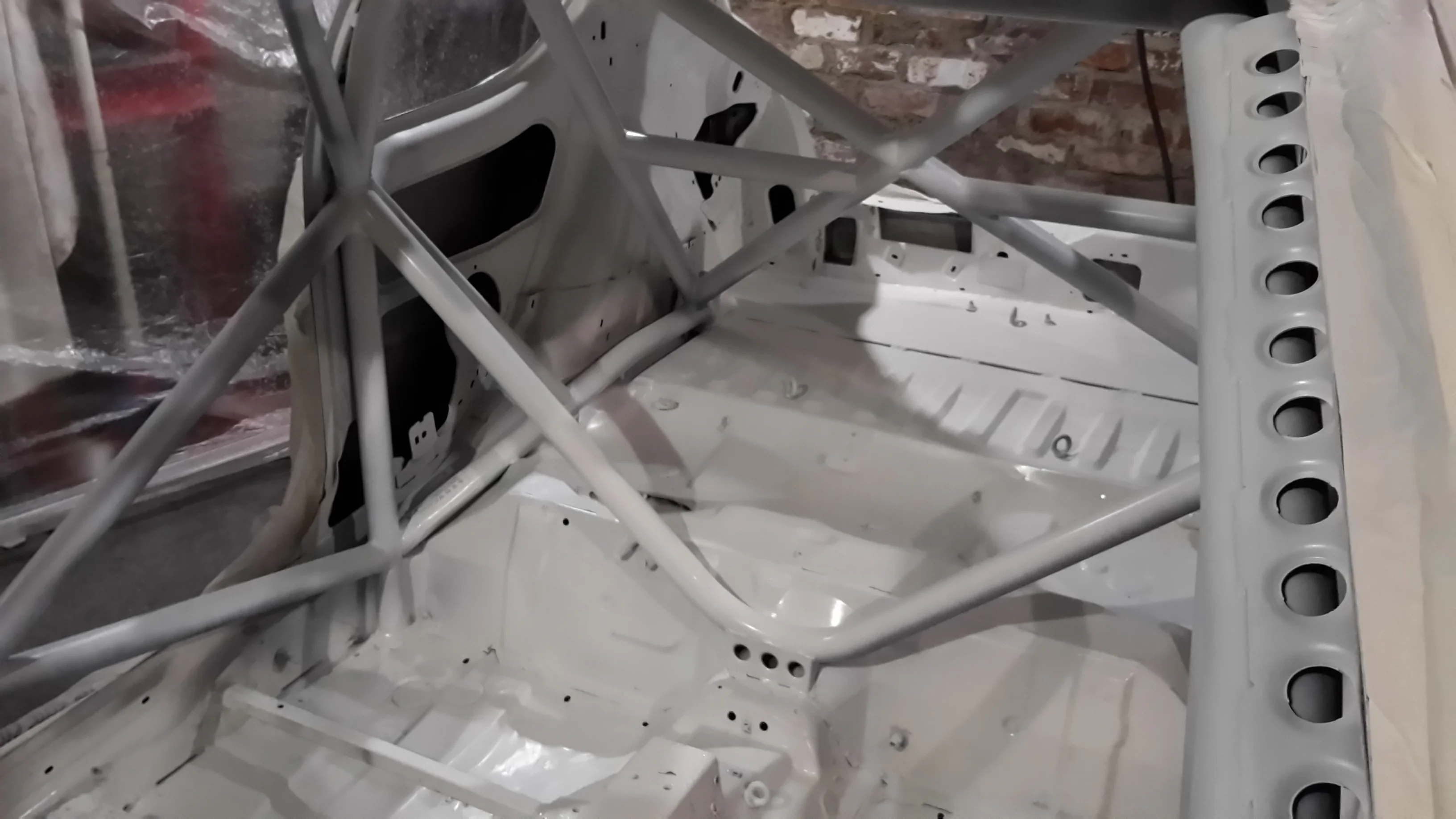

More progress on the pug today,
Got the car back from sw motorsport in Preston last night. Shawn and the guys pulled out all the stops to get the car back to me in time to get it finished for the northwest.
The quality of the welding in immense, equal to the cage I had fitted by RED.
Today was all about getting the new roof skin on so that tomorrow I can paint it ready for reassembling next week.
Fortunately everything went to plan and the roof went on without a hitch! I got the holes drilled for the roof vent as well.
So far so good, as long as tomorrow goes to plan we have a good chance of being ready for the 5th: Only 12 days to go!

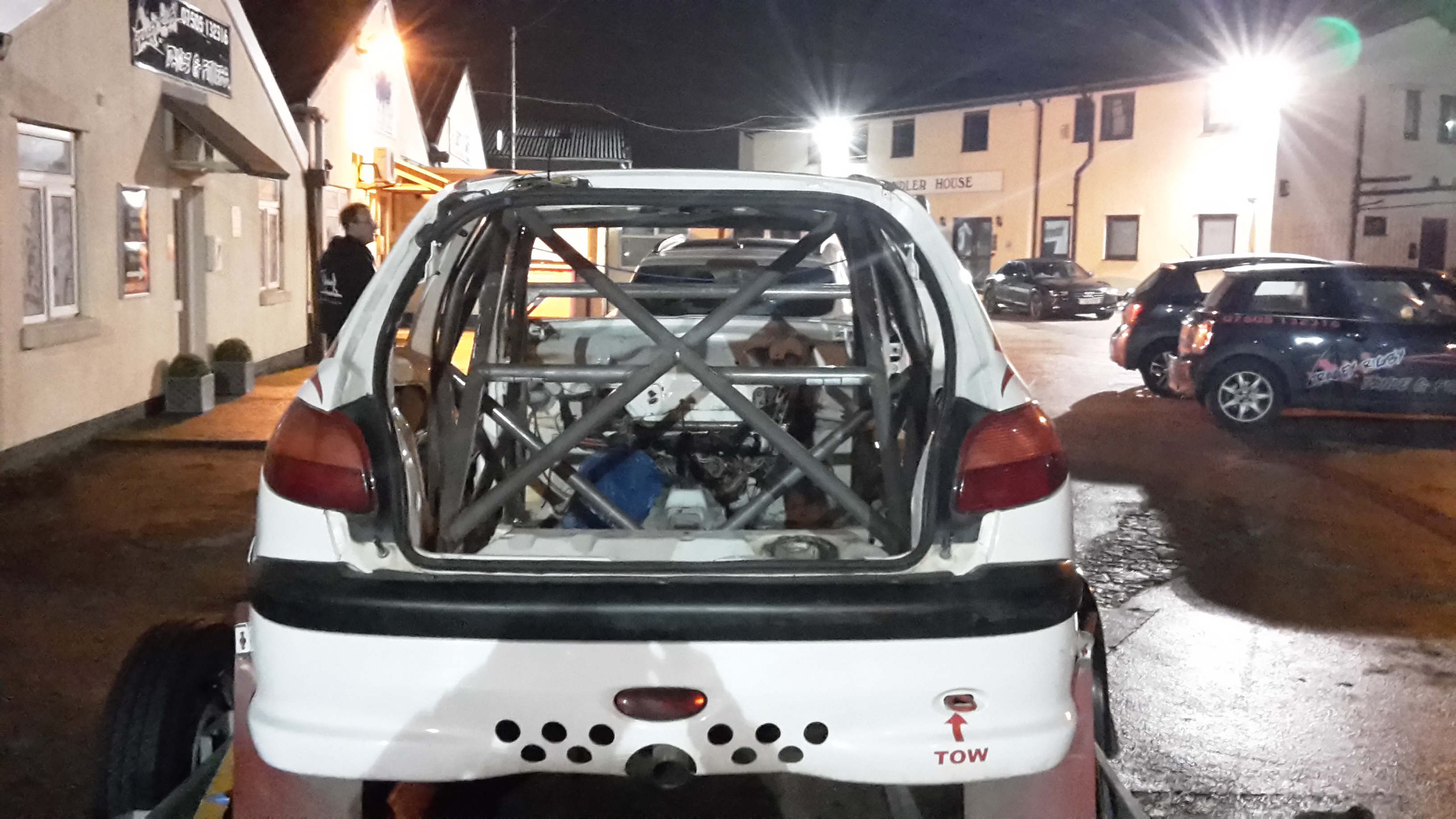

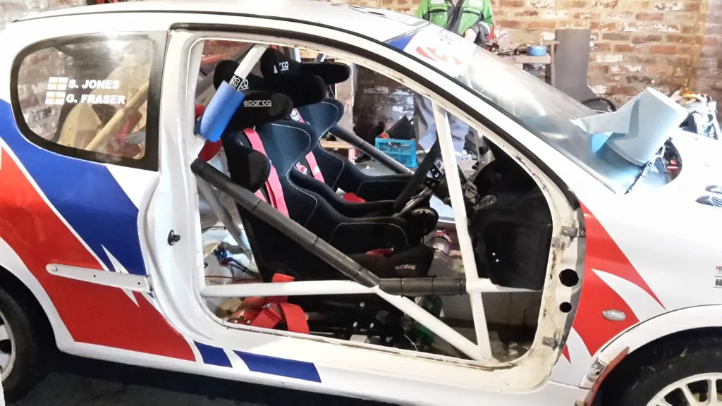

Well we made it!
It took a grand total of 4 days, and 9 late evening to get it finished!
To be honest it tried to fight us every step of the way.
The drivers side shock decided to blow up the Monday before the event, so that was a mad rush and mega turnaround from Proflex. Not only that but the Friday morning of the event it wouldn't start, well it started, ran for five minuets before stopping and not restarting. we chased that down to fouled plugs, probably due to a poor cold start map. We got to Blackpool in plenty of time though and it flew through scrutineering.

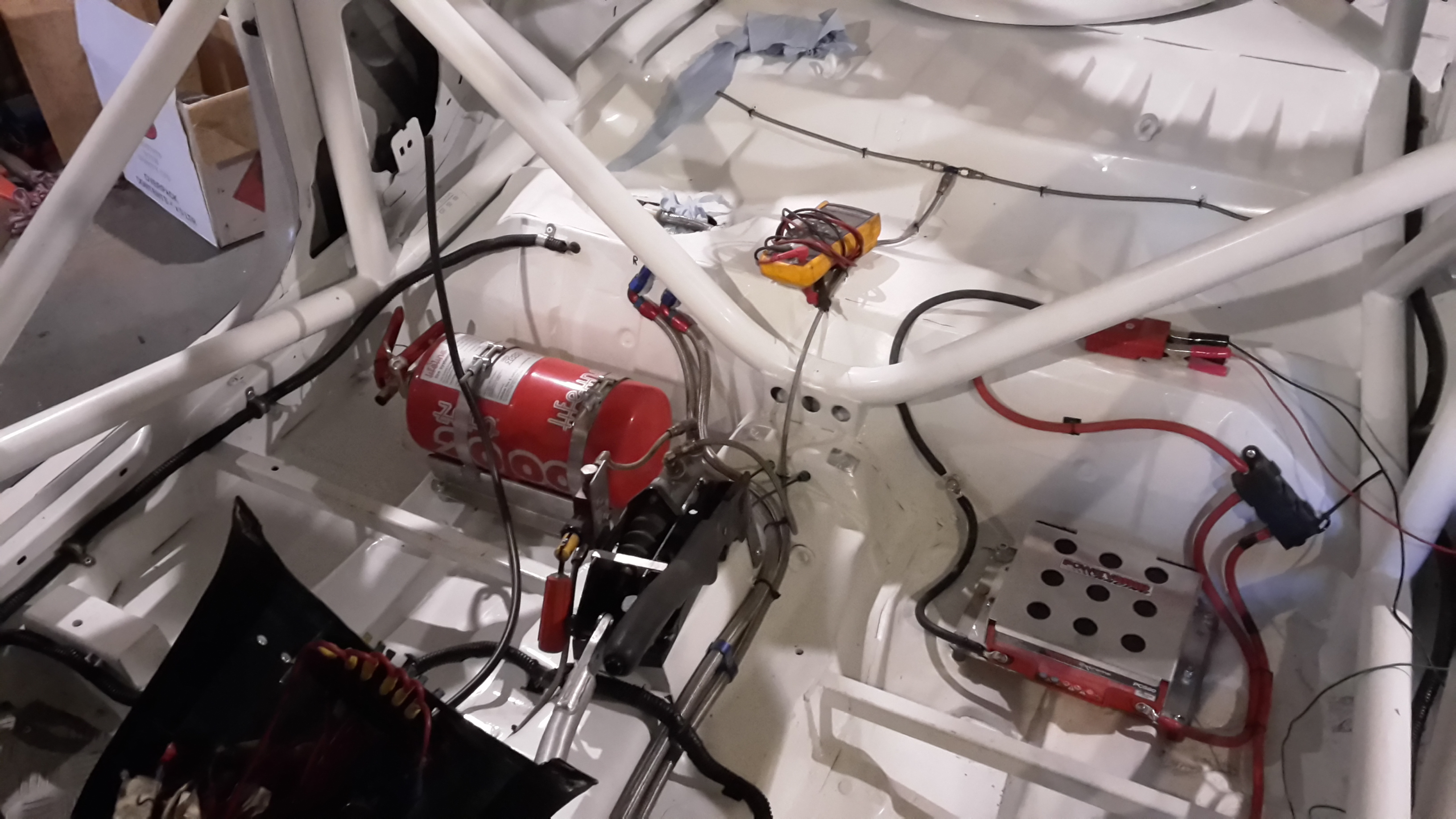

First problem! The new heated screen kept blowing fuses, quick fix was to just run the drivers half of the screen. The result was heavy condensation on the passenger side meaning water was running down the inside of the screen on the passenger side! (result of no testing time!) Oh and the first 4 stages were in the dark!
