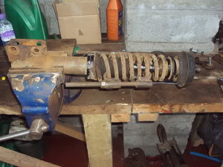

This is the stage that I am at, any idea on how I take the spring off? I've got the spring compressed to take the weight off the head of the coilover, but it doesn't want to come off.

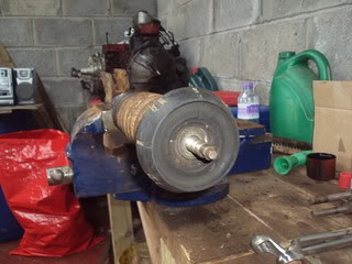

the top mount doesn't want to come out at all, I think i will have to drop them an e-mail cant find springs anywhere for them!
get some wd40 on the adjusters and get them lower on the strut, you will de-compress the spring and there will be no need for the compressor.
And yes, you can get new springs from gaz or gaz suppliers. For the top mount you may heve to use some kind of extractors. I remember it was a pain for me as well to remove them from my old suspension when I fitted the coilies

Just gave the adjusters a good soakin with wd40 but they are well n truly stuck. I managed to slacken 1 of the adjusters a full turn with the hammer and punch but il be at it for days if that was the case of slackening them far enough back. Ive coated the coily with diesel to sit overnight to try n loosen it up. Can you remember if the top mount is actually threaded on or pressed? I measured the distance between the end of the shock and bottom adjuster ring - 212mm
I noticed there is a very small nut at the top of the coilover - what is that for? to adjust how hard or soft you want the damper? and do you need to slacken this or take off to allow for the top mount to be taken off? Thank you

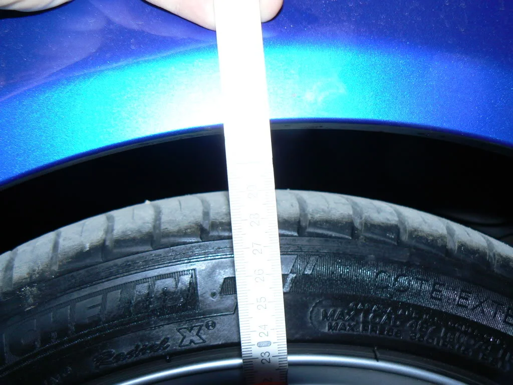

thanks for taking that measurement for me. one more thing, if you have a side pic with your car with this suspension on would you be kind enough and post it? just curious how it stands
yeah that's the damper adjusment nut.
looks pretty low that second pic although hard to tell from that angle.
from your memory, was it lower than this (judging from the gap):
so would i need to slacken this nut to allow for the top mount to come off? N I'd say that that isnt far off the way my 182 was set up!

Looks to me that you are in the same difficulty that I was. I'd get myself some kind of a claw puller to get the top mount off the shaft.
