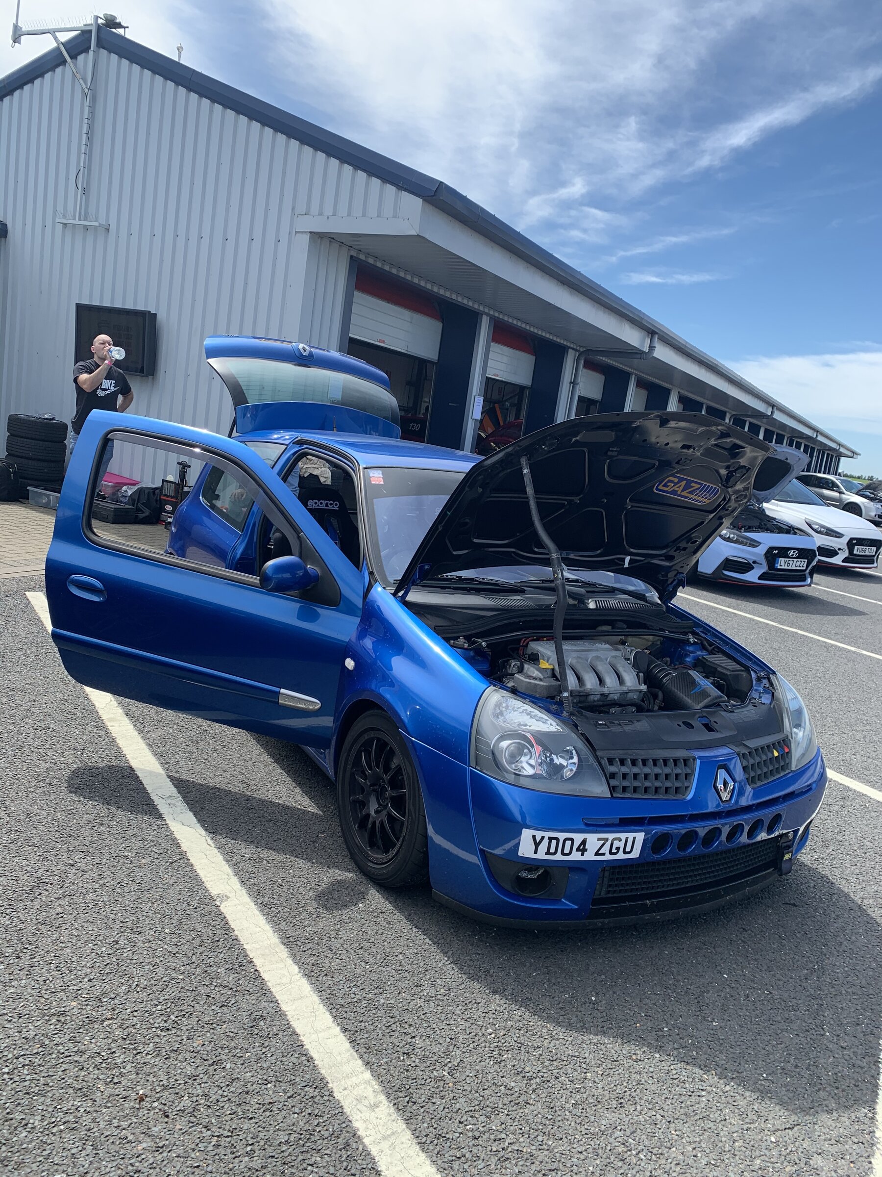

182 Fake Racing/ Track car
Few photos from Cadwell, booked to go back in July 9th

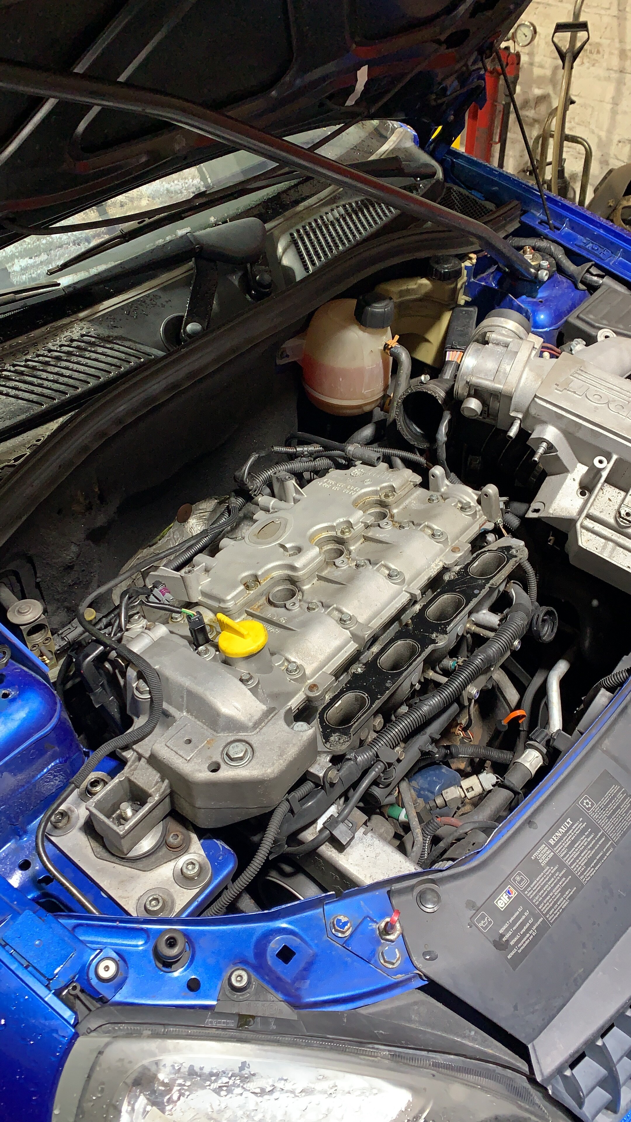

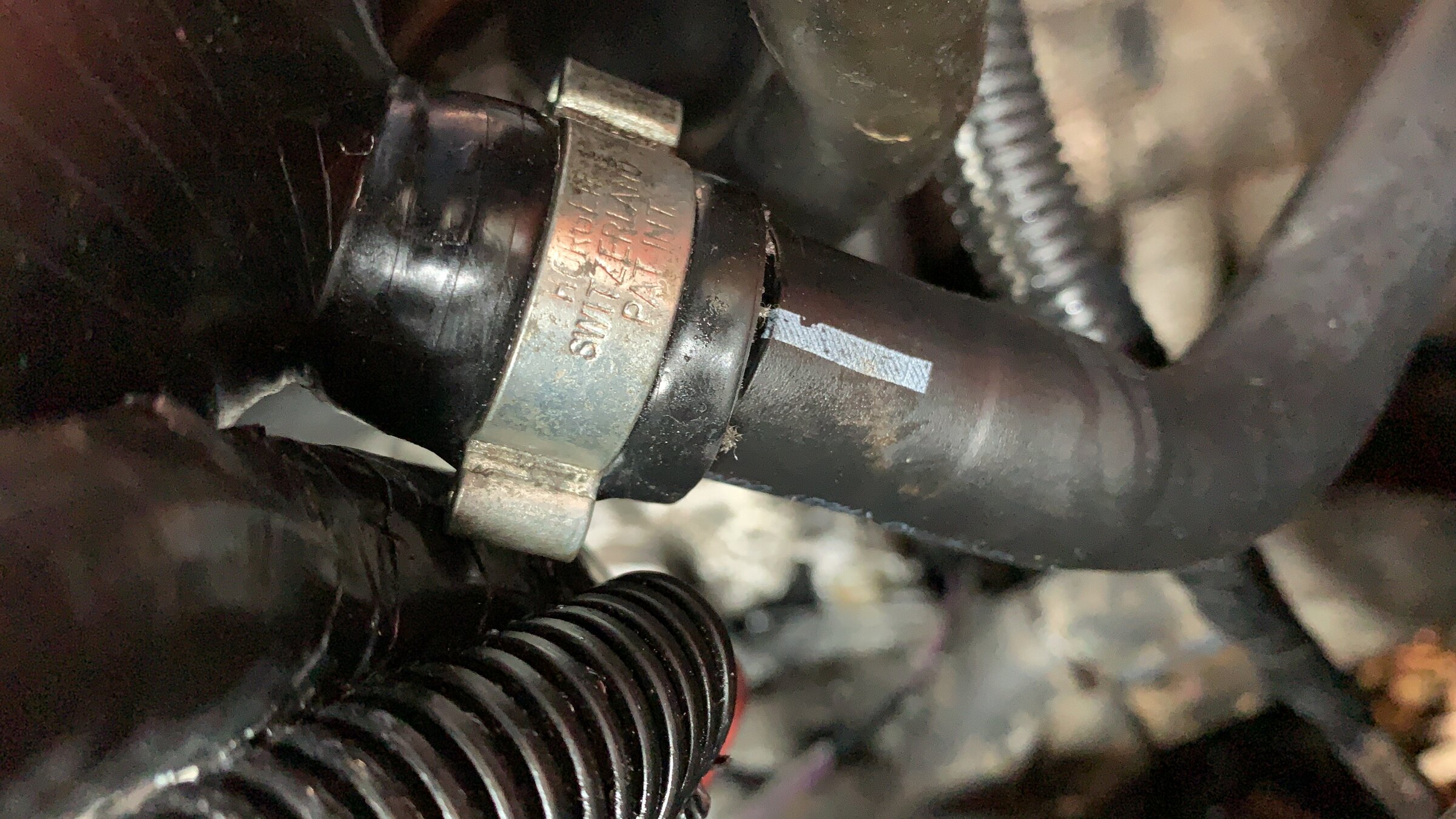

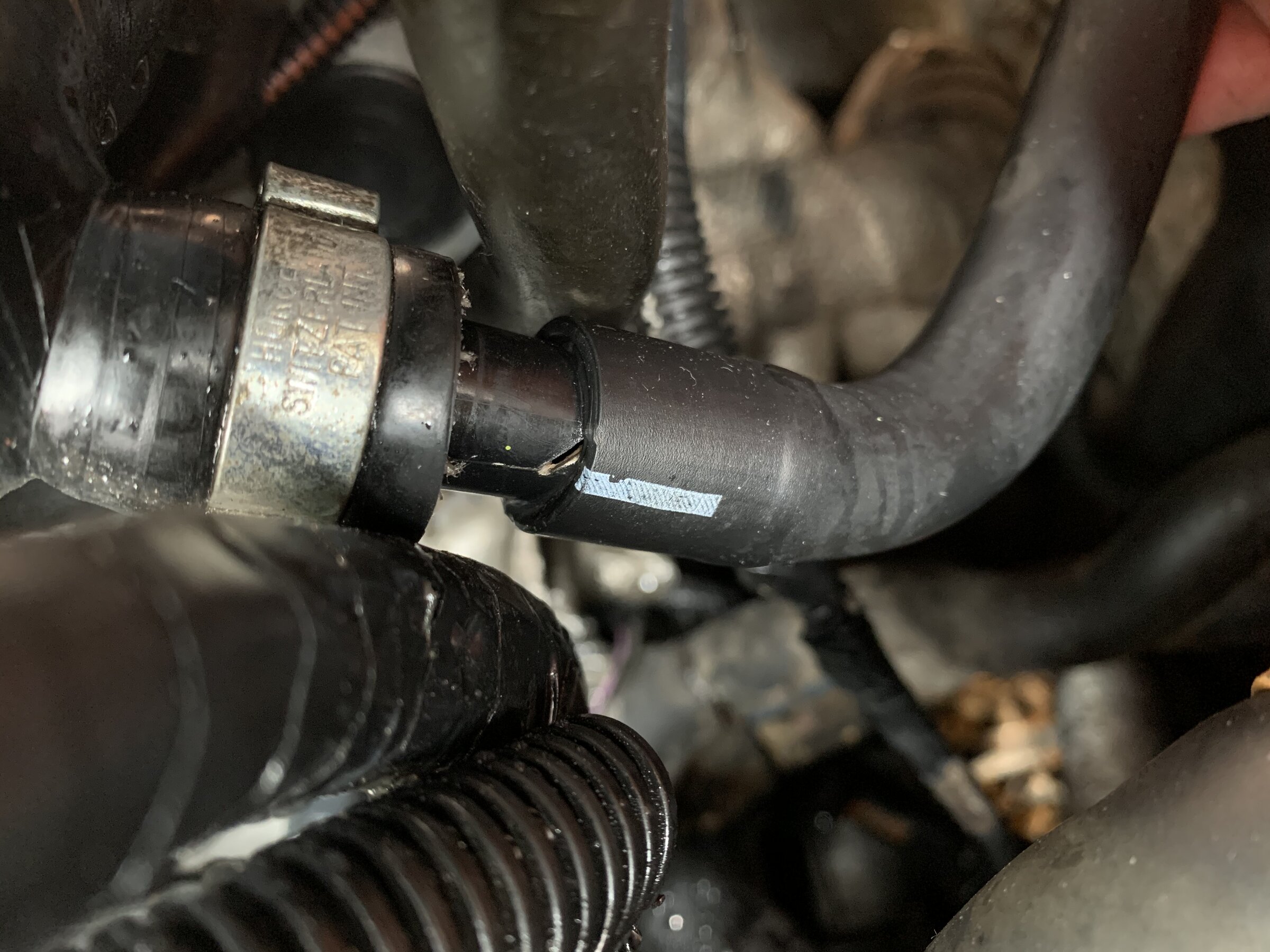

Found the source of the little leak little cut in the connection pipe, Jubilee clips ordered and pipe covered

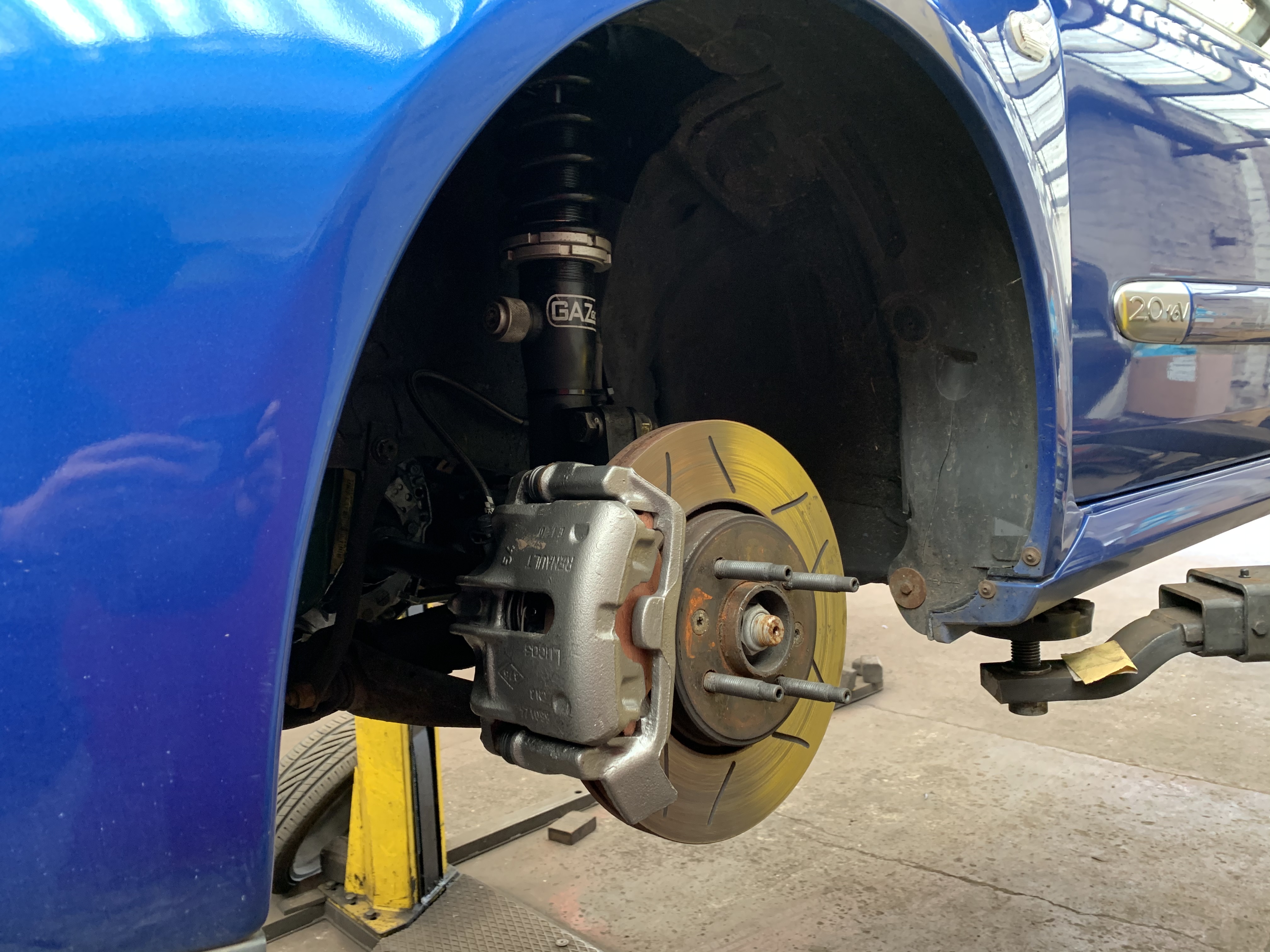

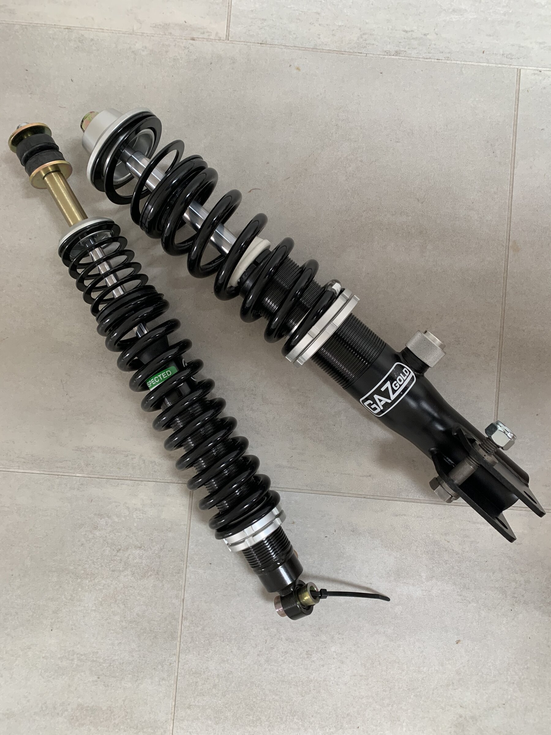

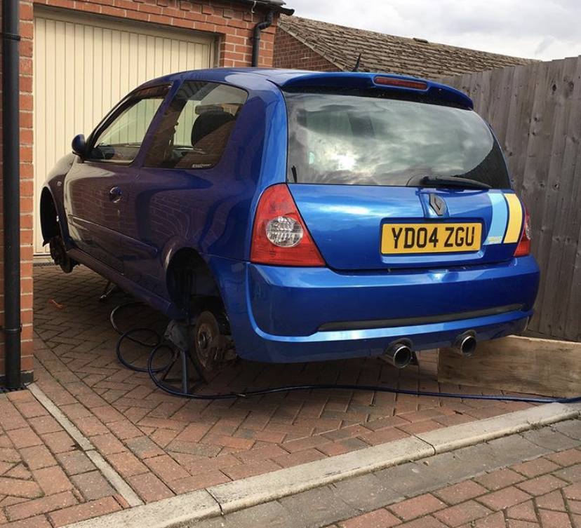

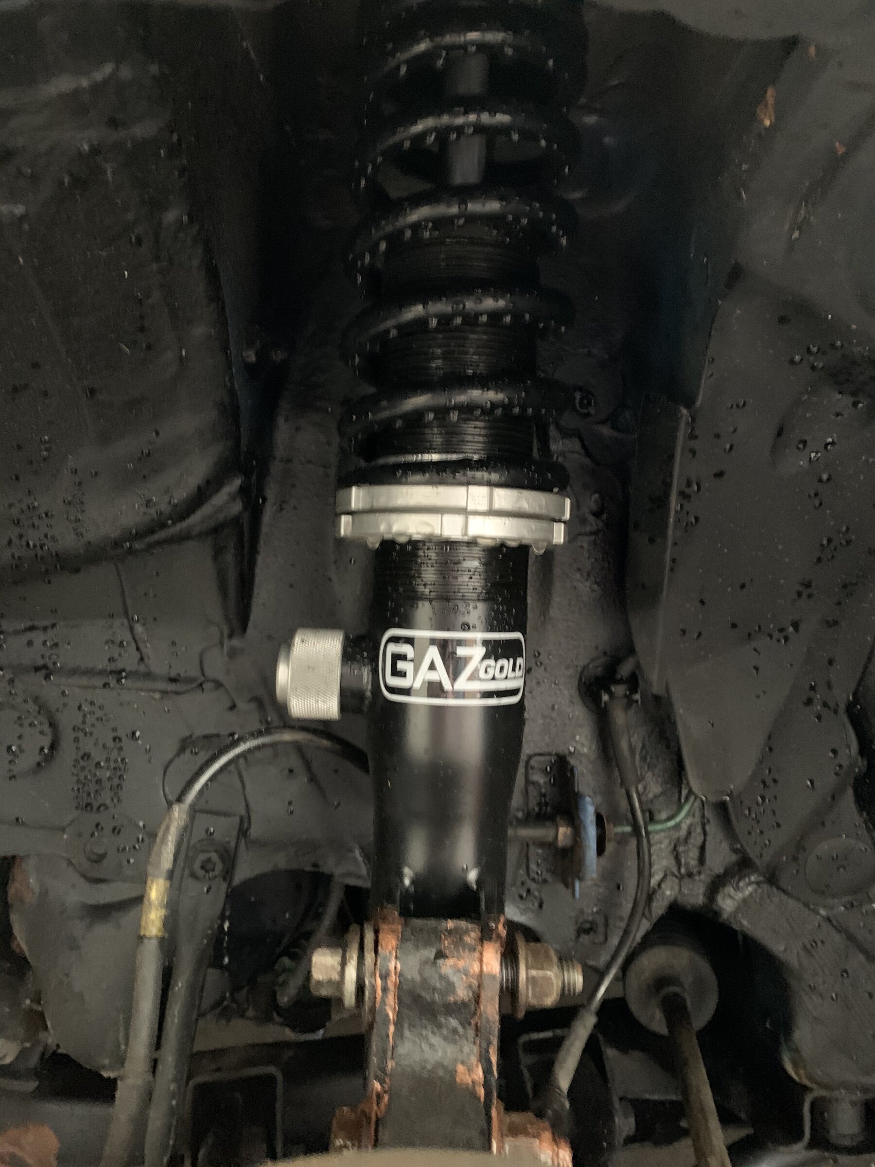

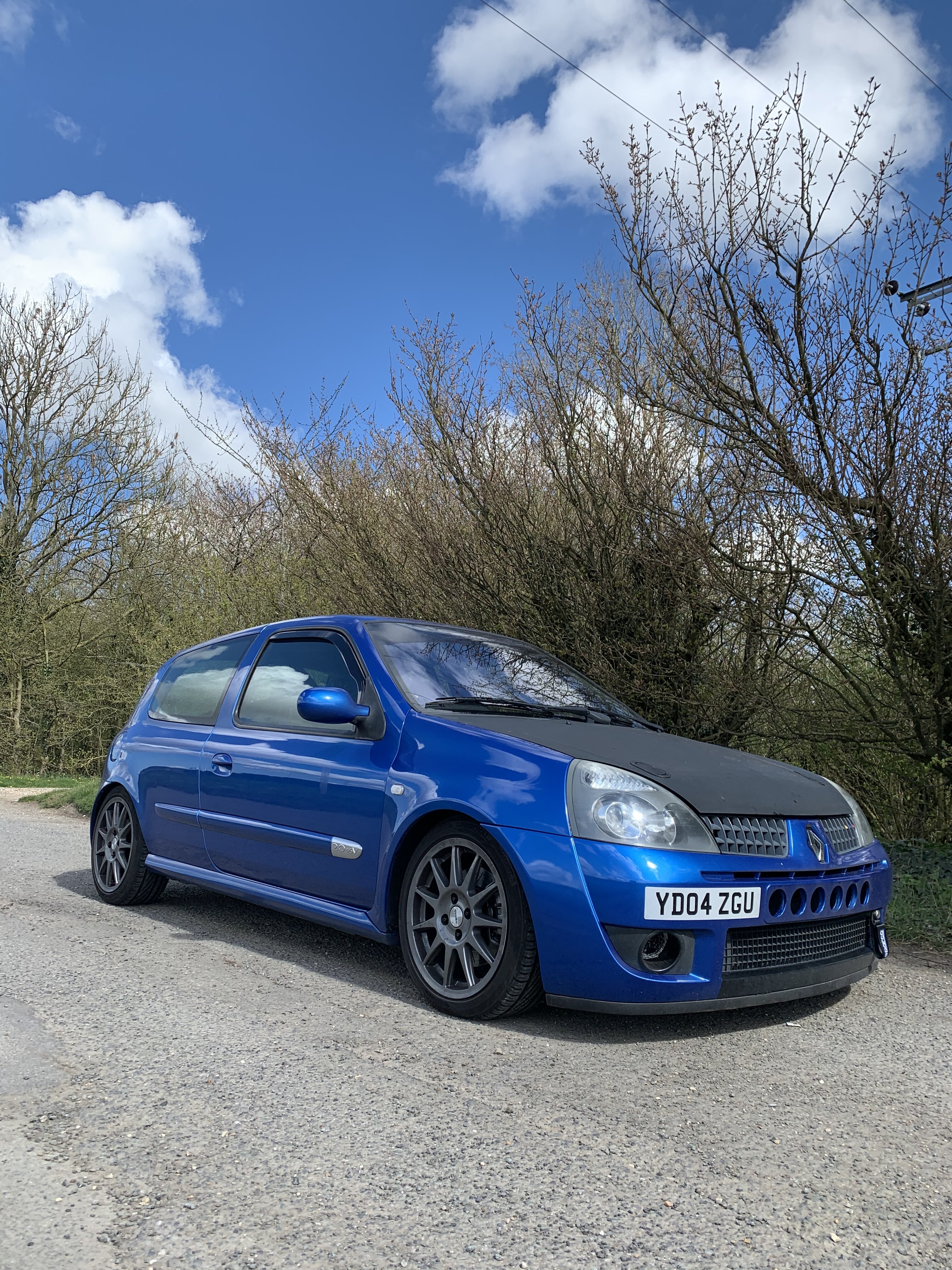

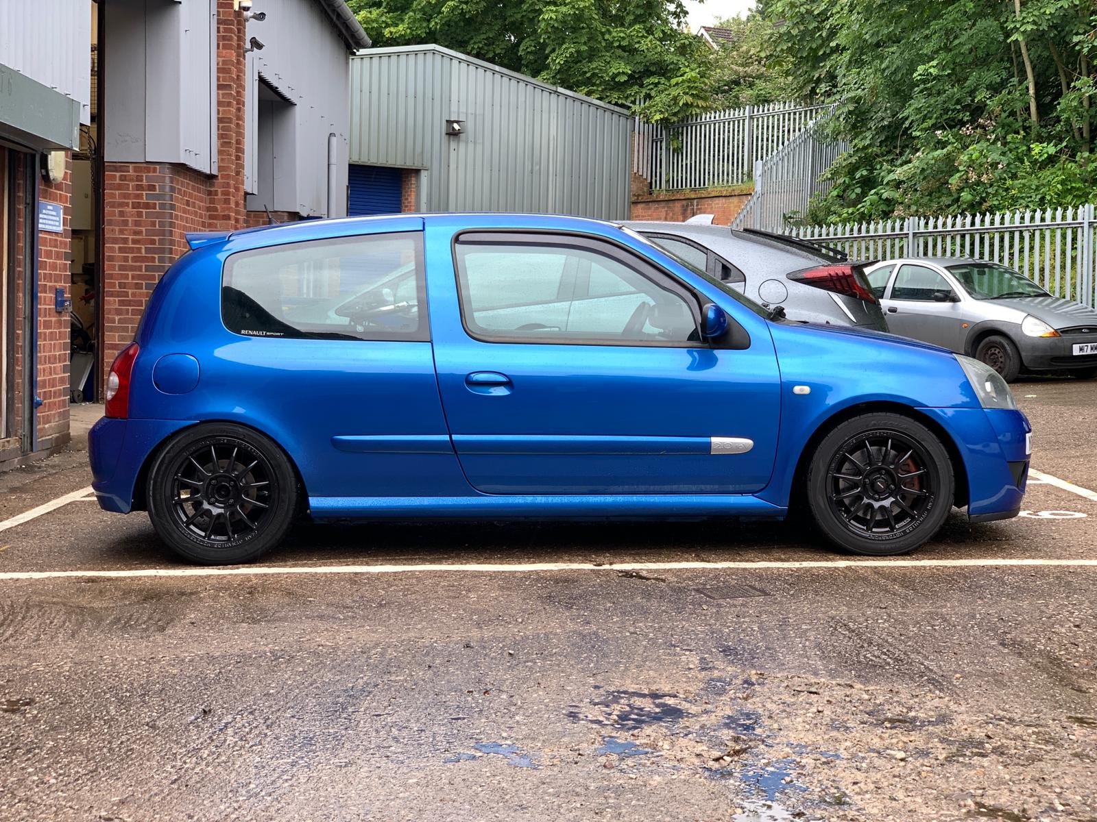

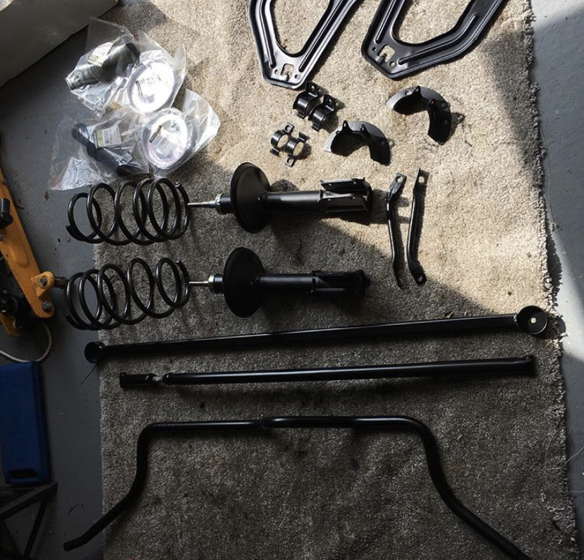

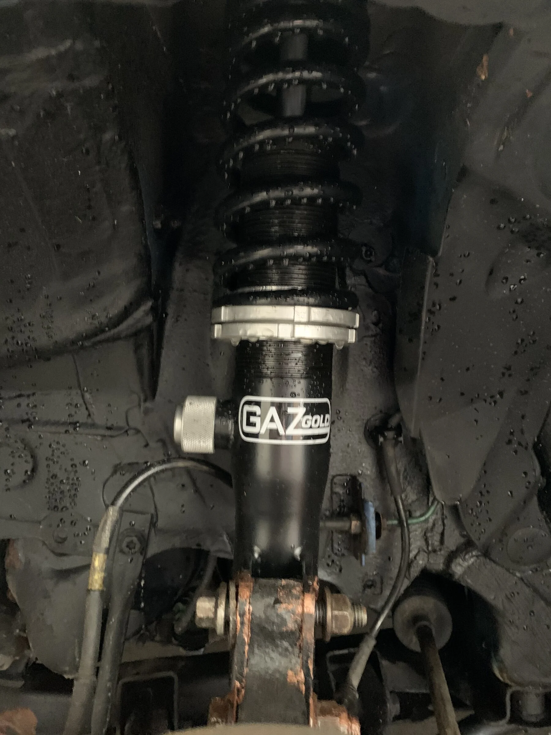

Fitted the Gaz Coilovers, probably a little to play with the ride height as not 100% sure where it should sit and best for handling.
At the moment it’s a little lower at the front than the back measuring off the chassis (although it looks like it sits lower at the back).

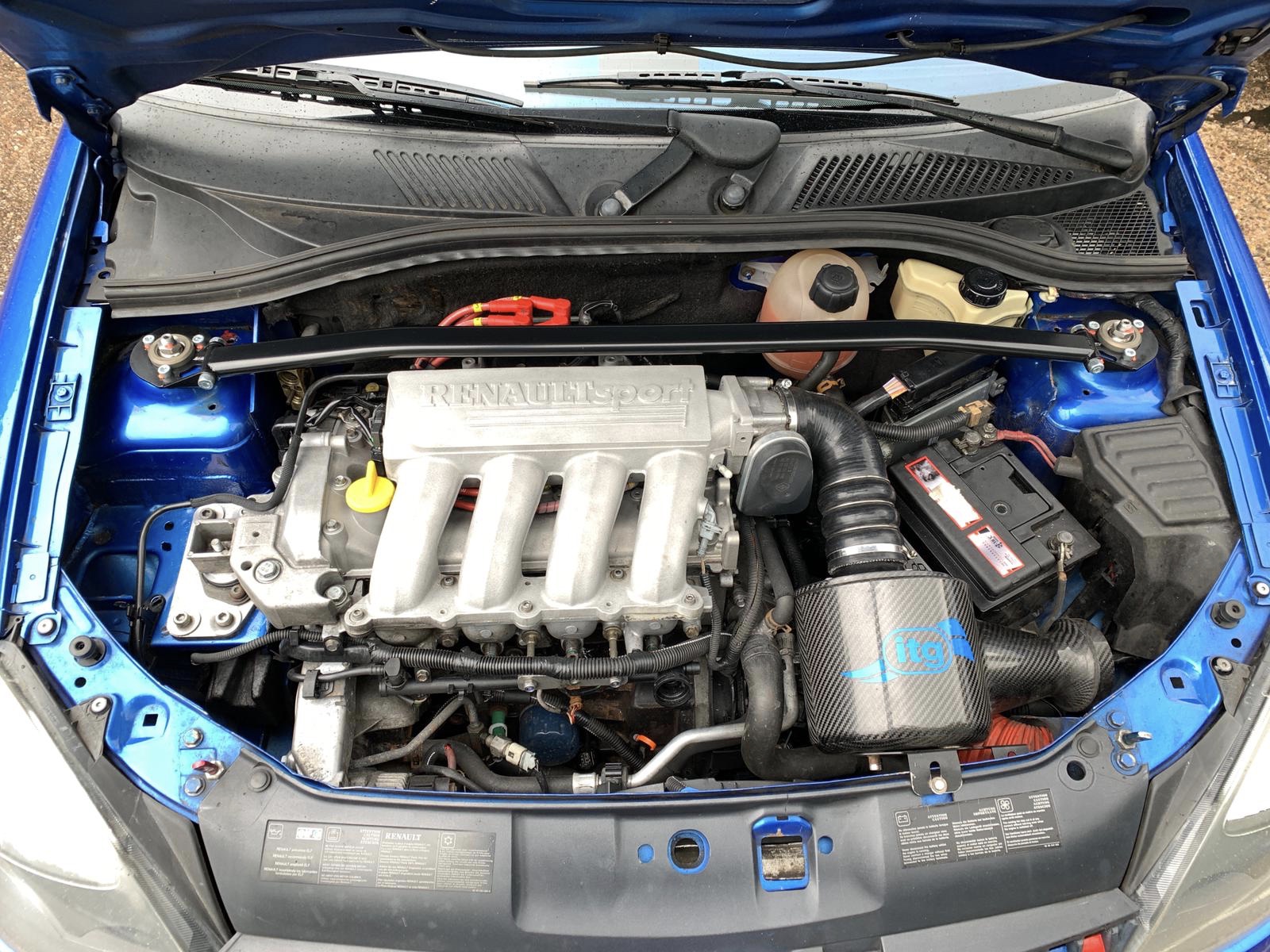

something to play with. PMS solid top mounts and strut brace also fitted.

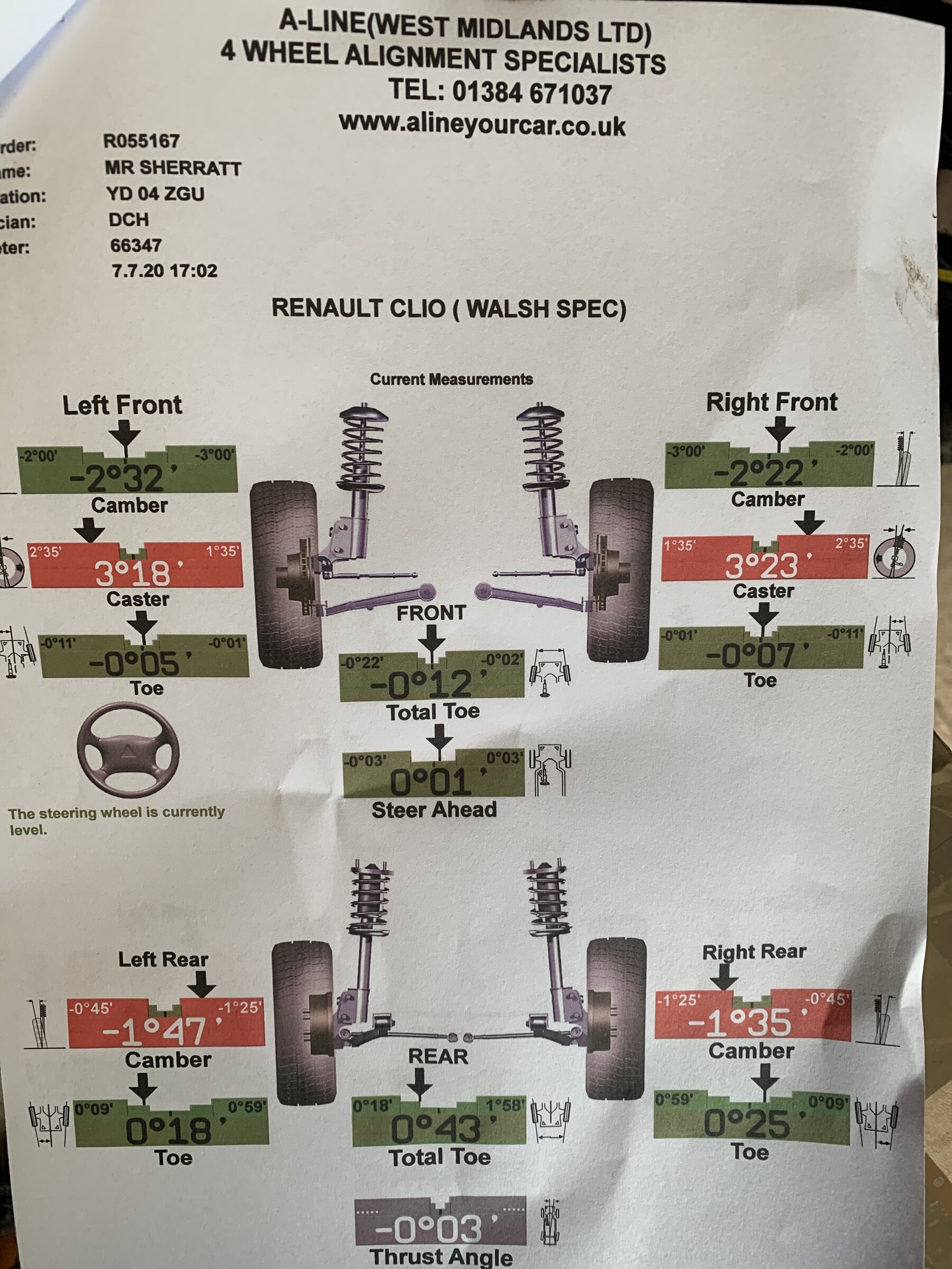

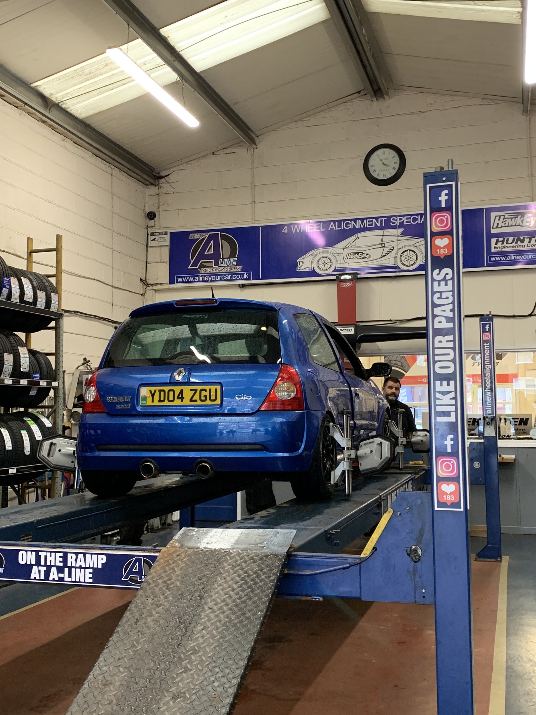

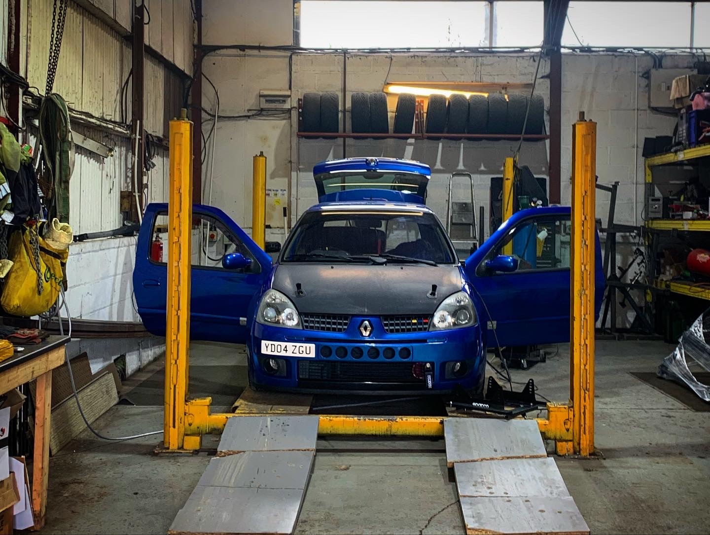

Alignment sorted. This place came recommended and didn’t disappoint. Aline, Dudley 👌(plus the steering wheel is now dead centre which was doing my head in since I fitted it!)
Even on a wet, slow drive home the car feels like a little kart, steering seems so direct (but still drivable to drive to the track).

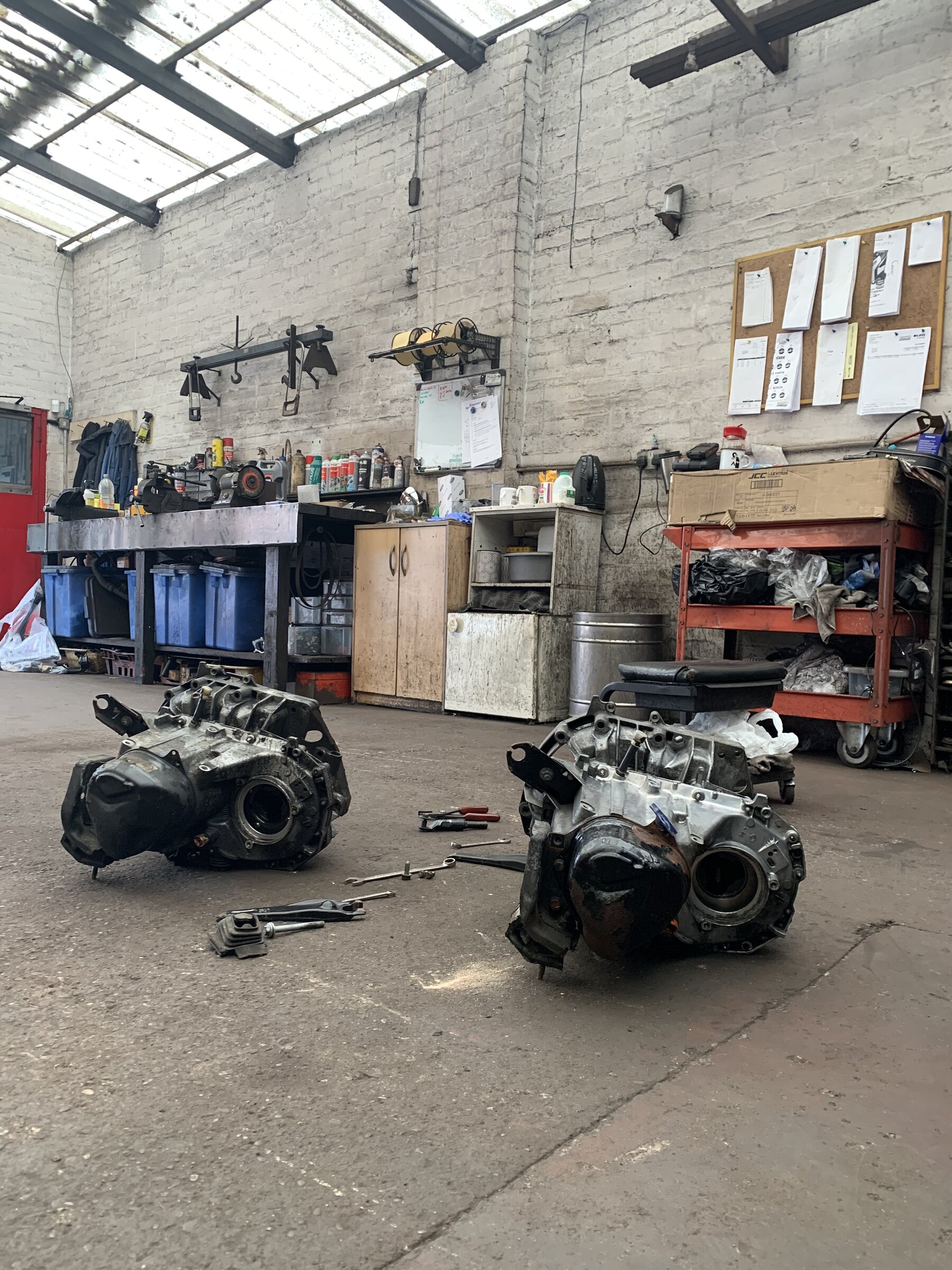

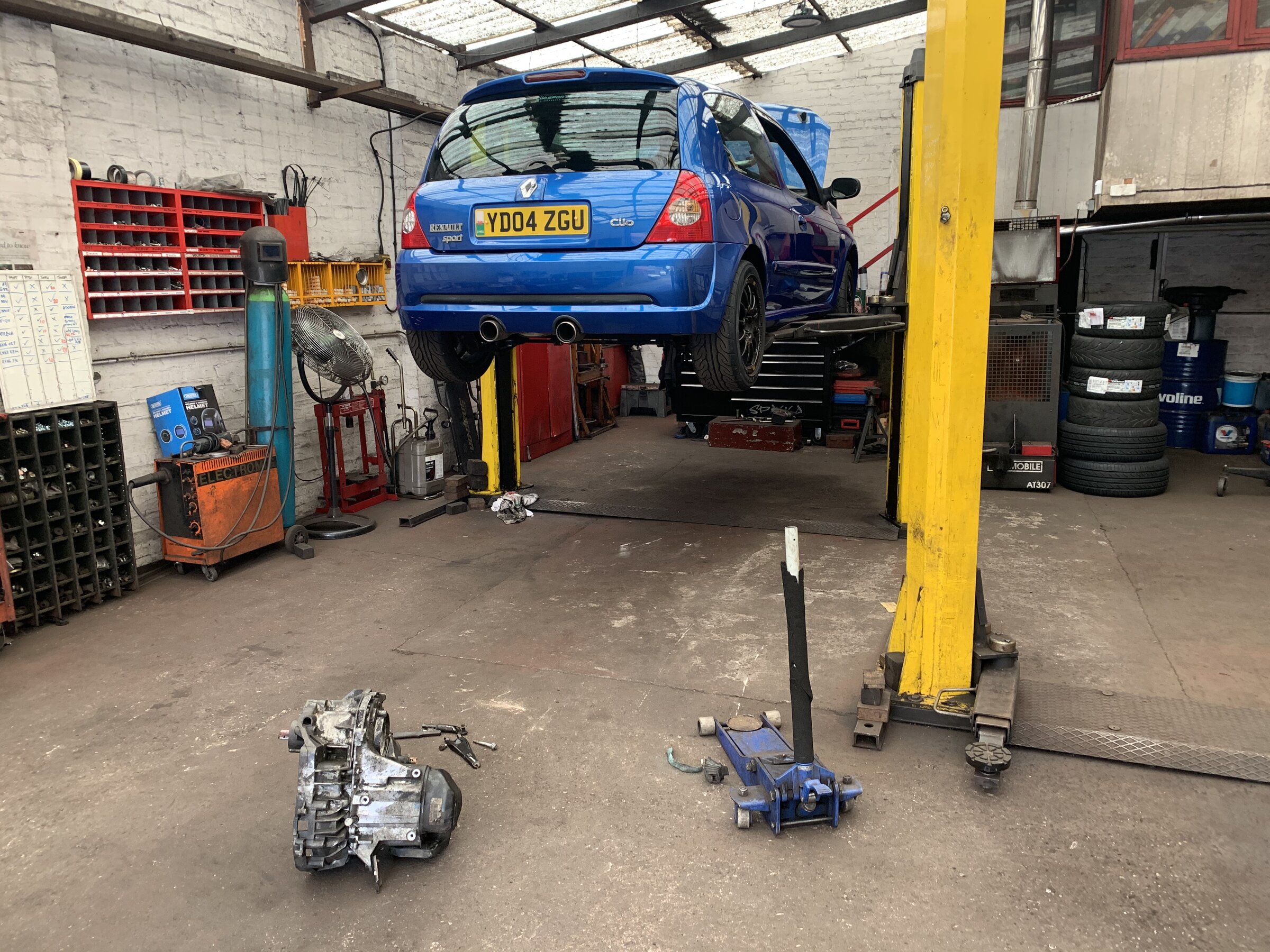

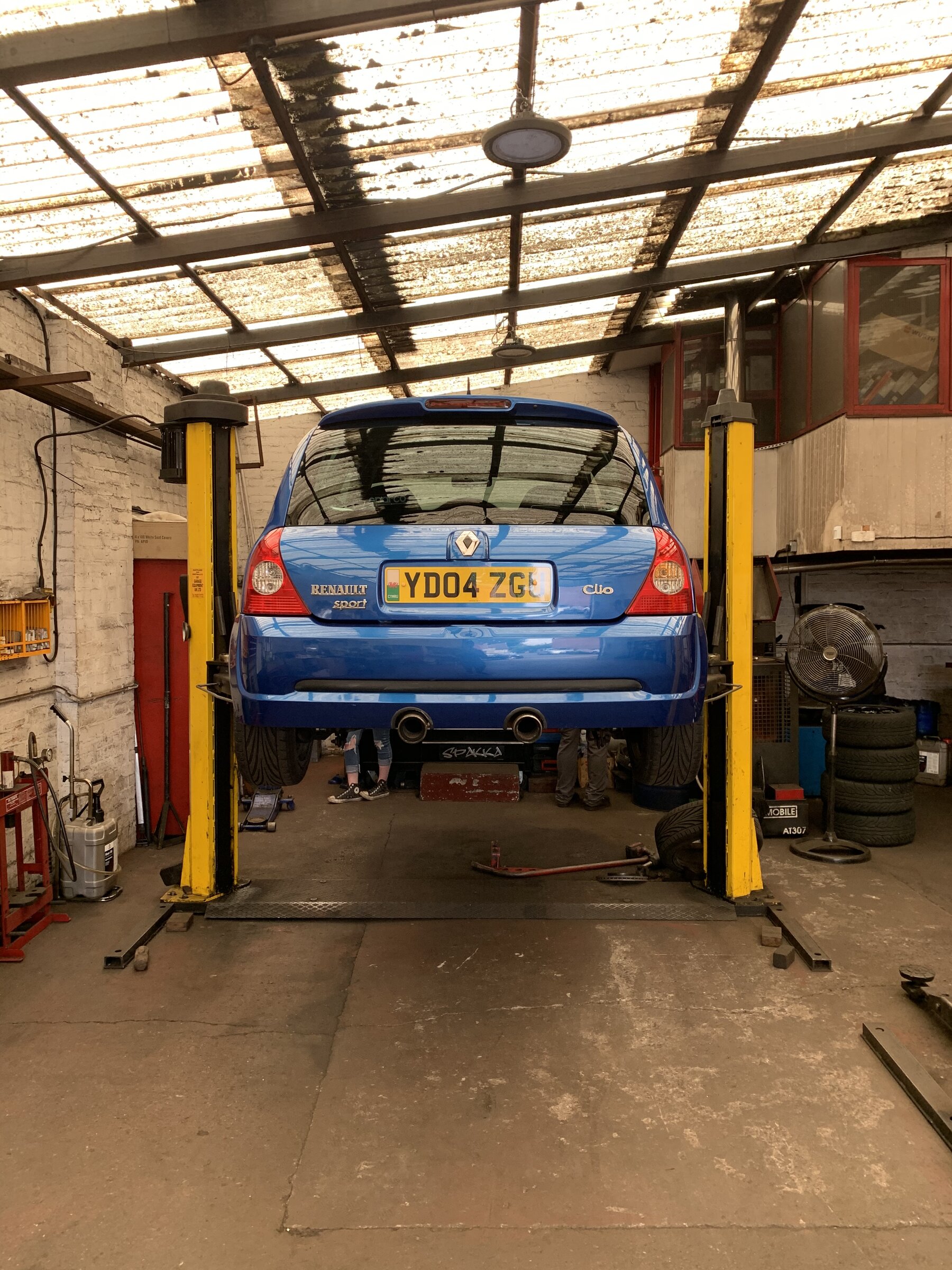

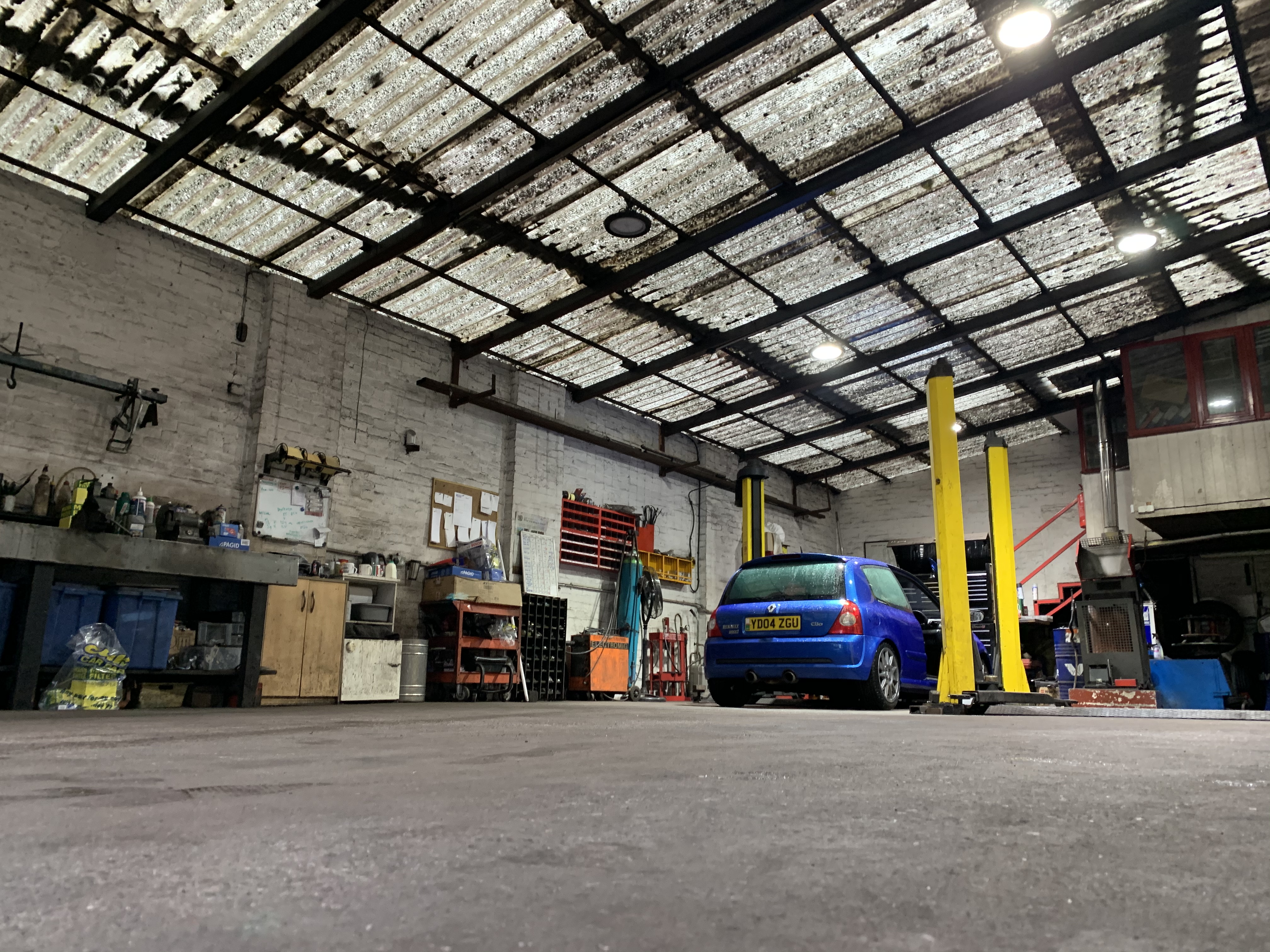

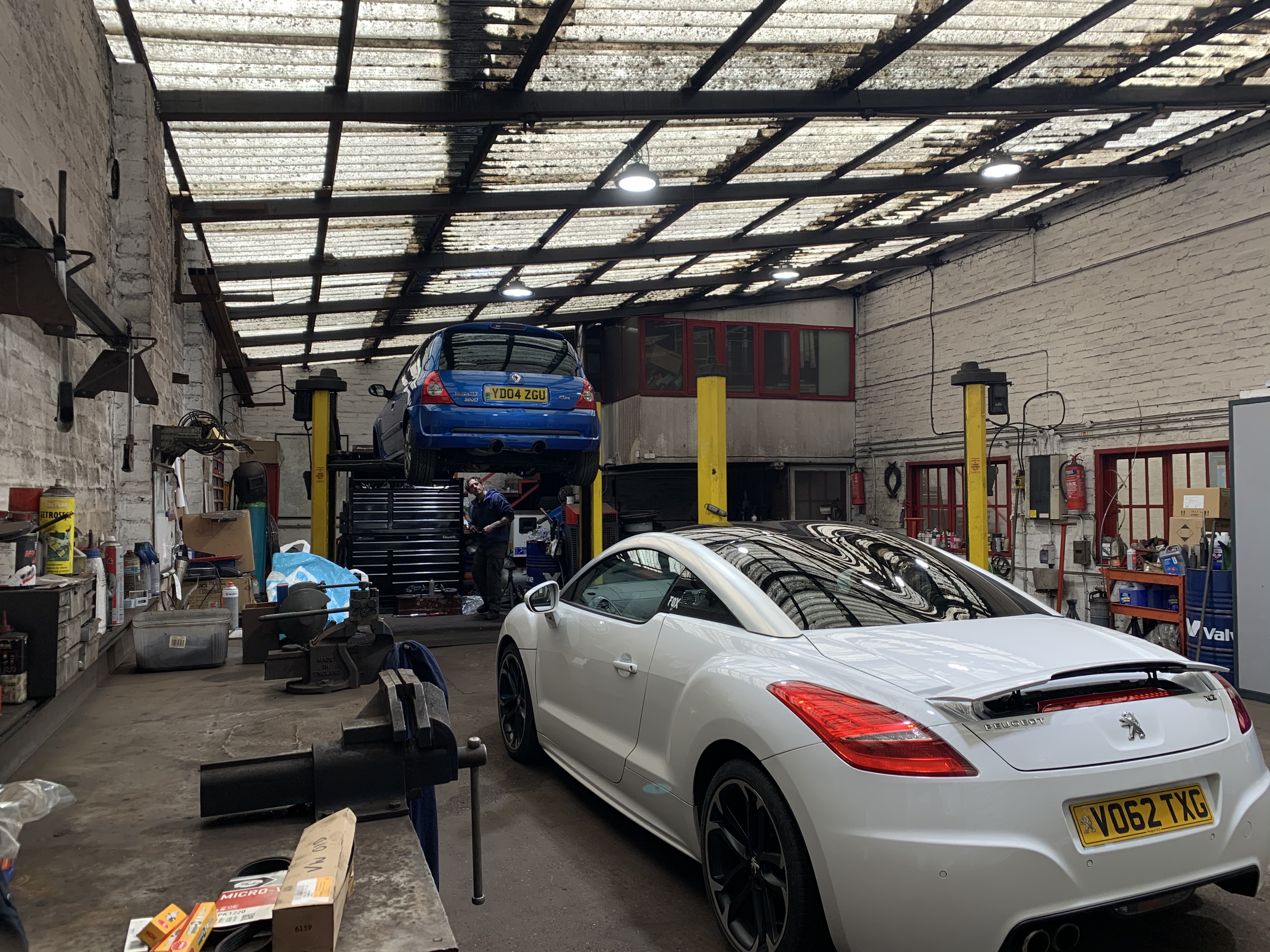

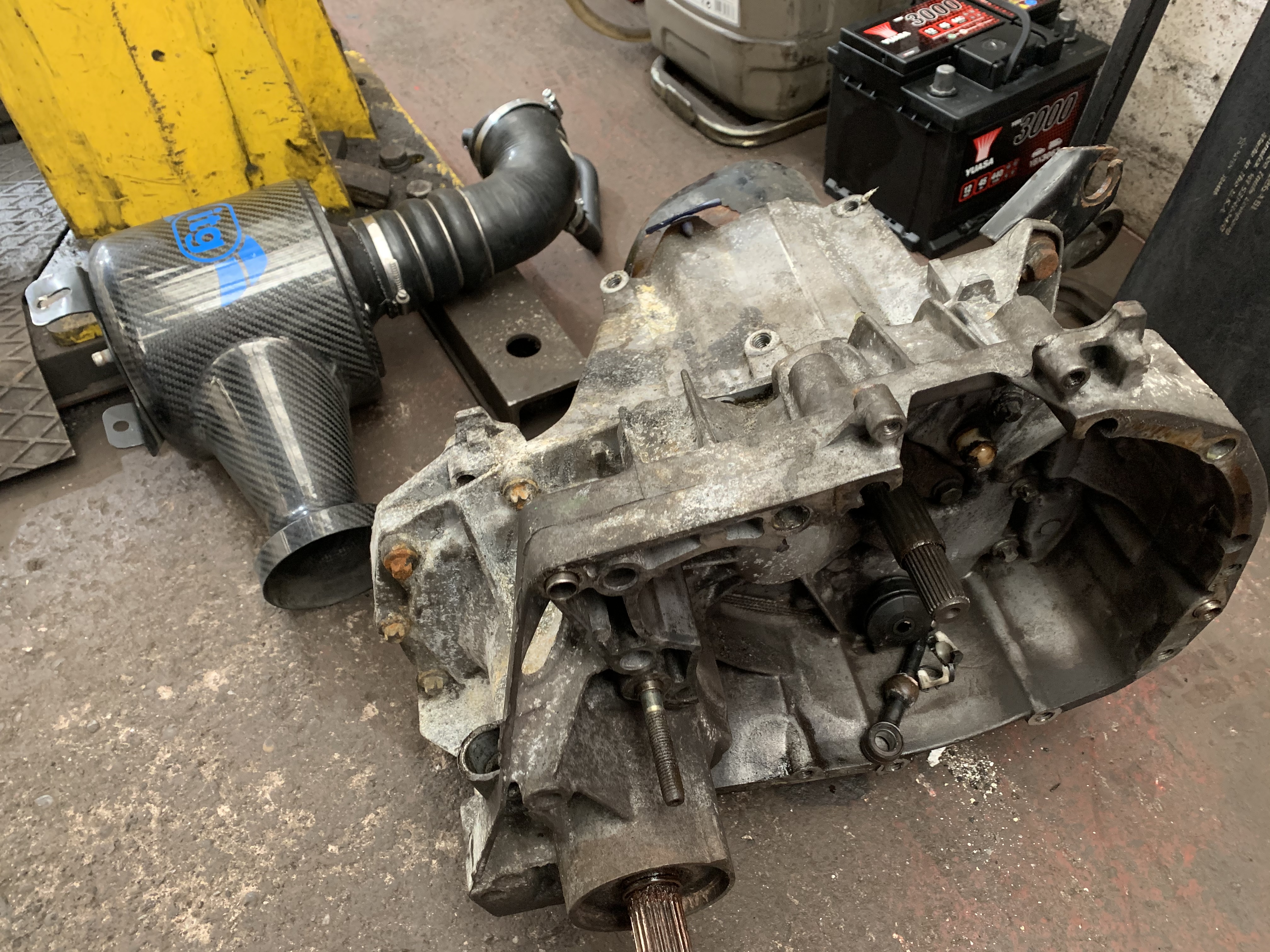

After the 5th gear sync eventually gave up on the way back from Cadwell Park, I headed to my mate at KingSwinford motor services today to fit a temporary gearbox.
The one fitted seems ok, but will get the old box reconditioned to former glory and refit when I can.

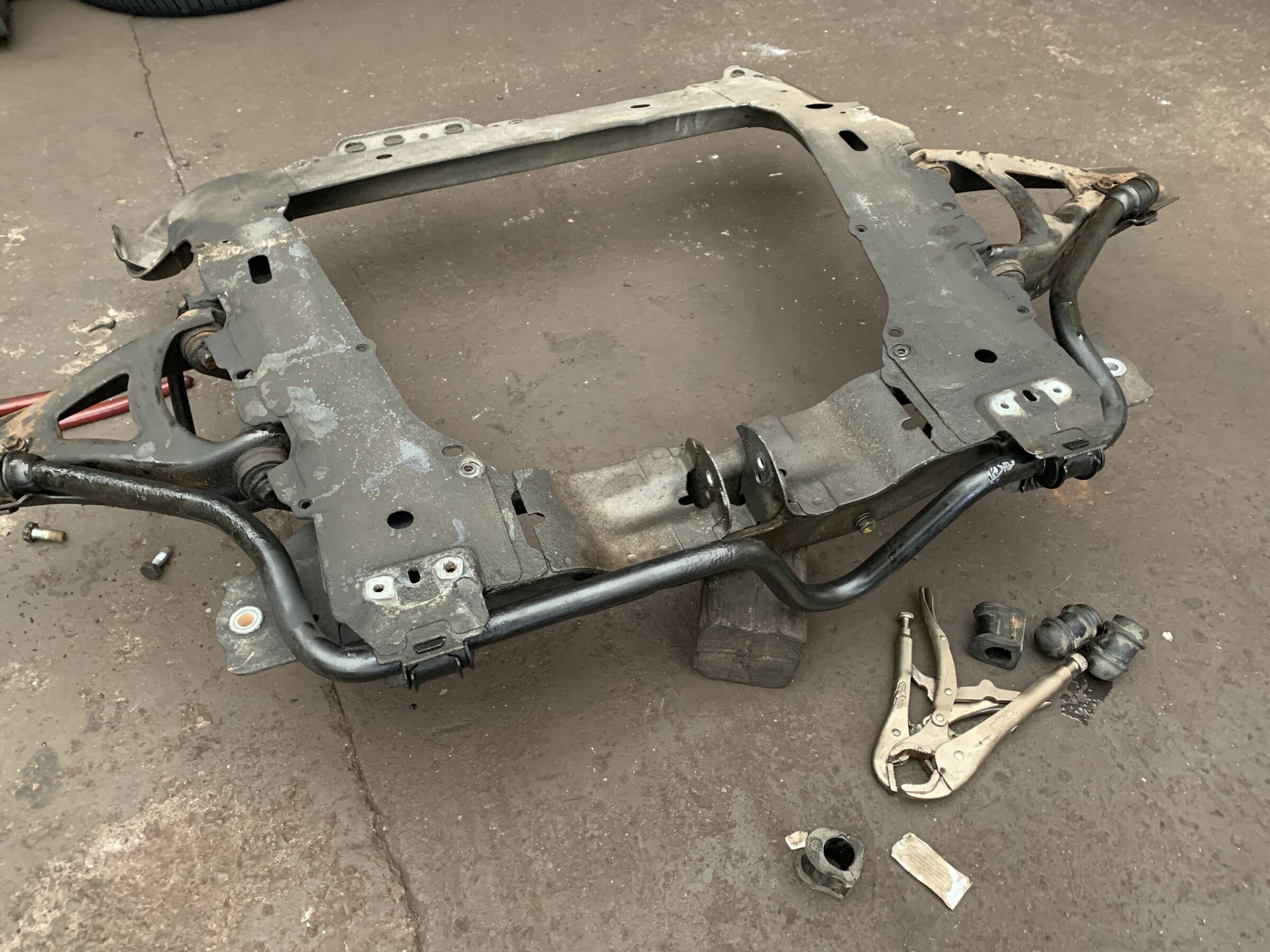

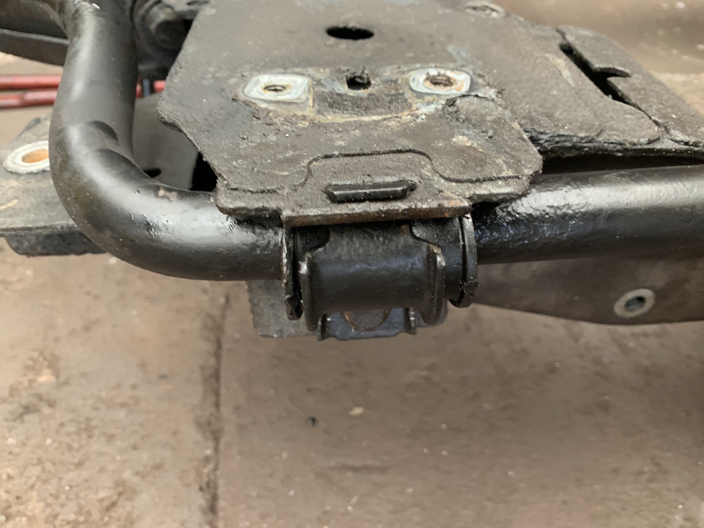

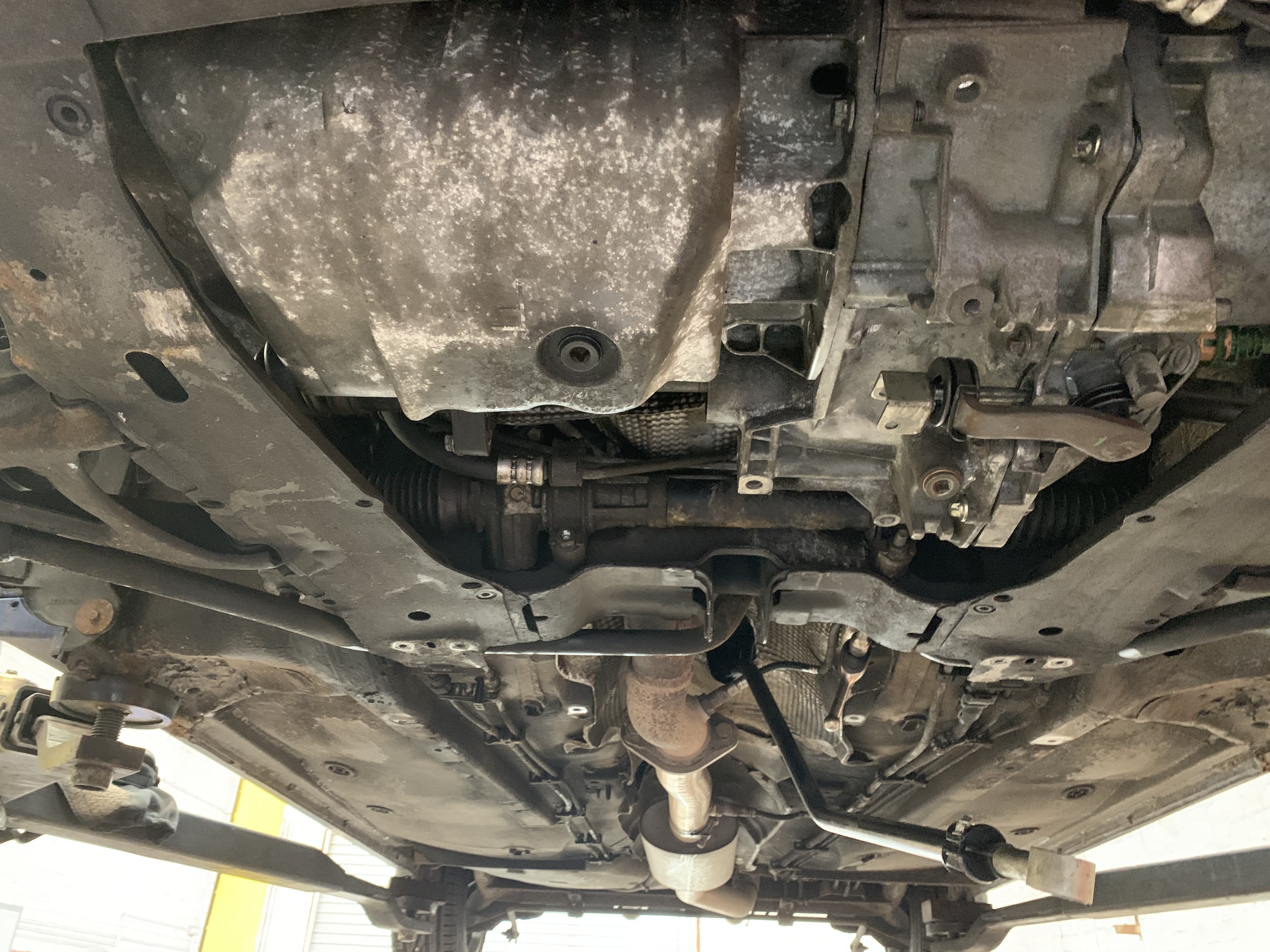

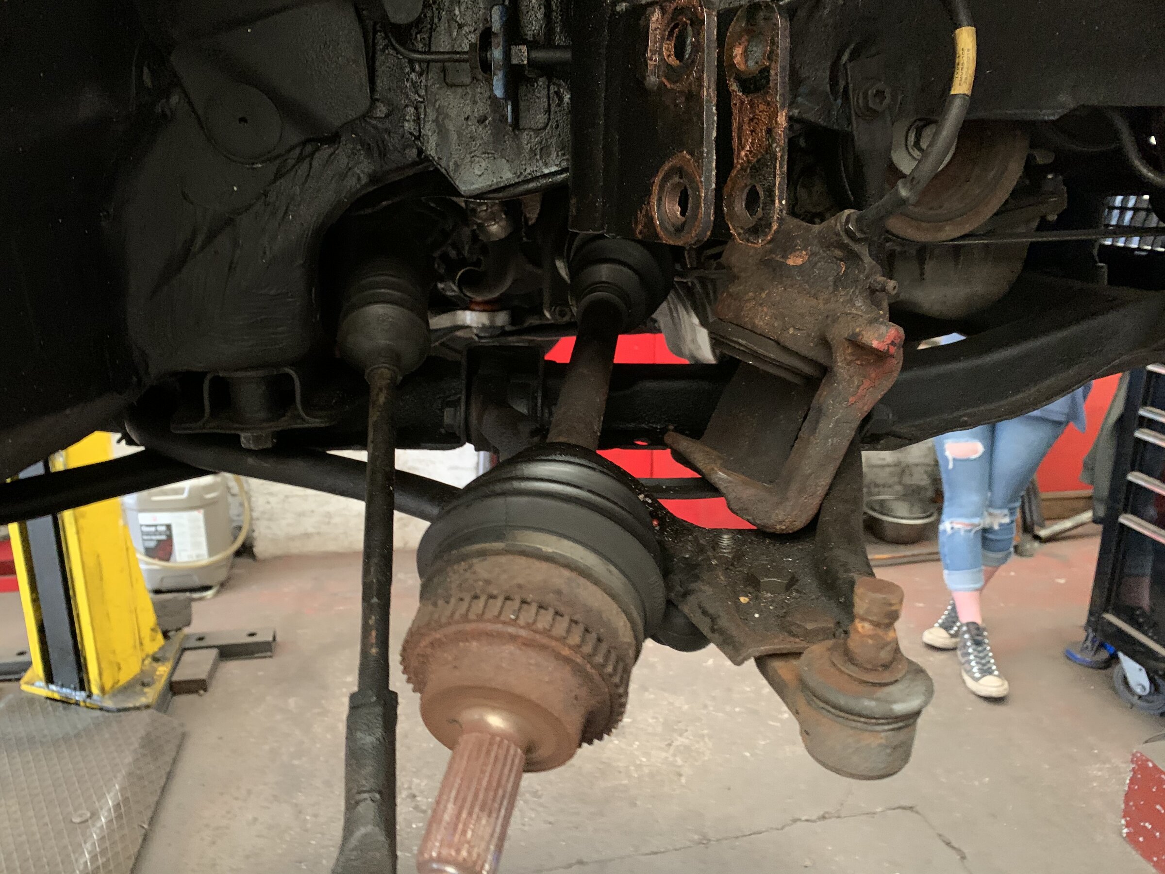

Whilst the subframe was out fitted new front roll bar Powerflex Black bushes.

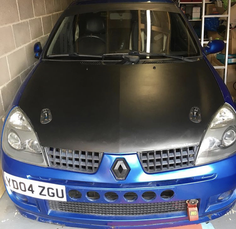

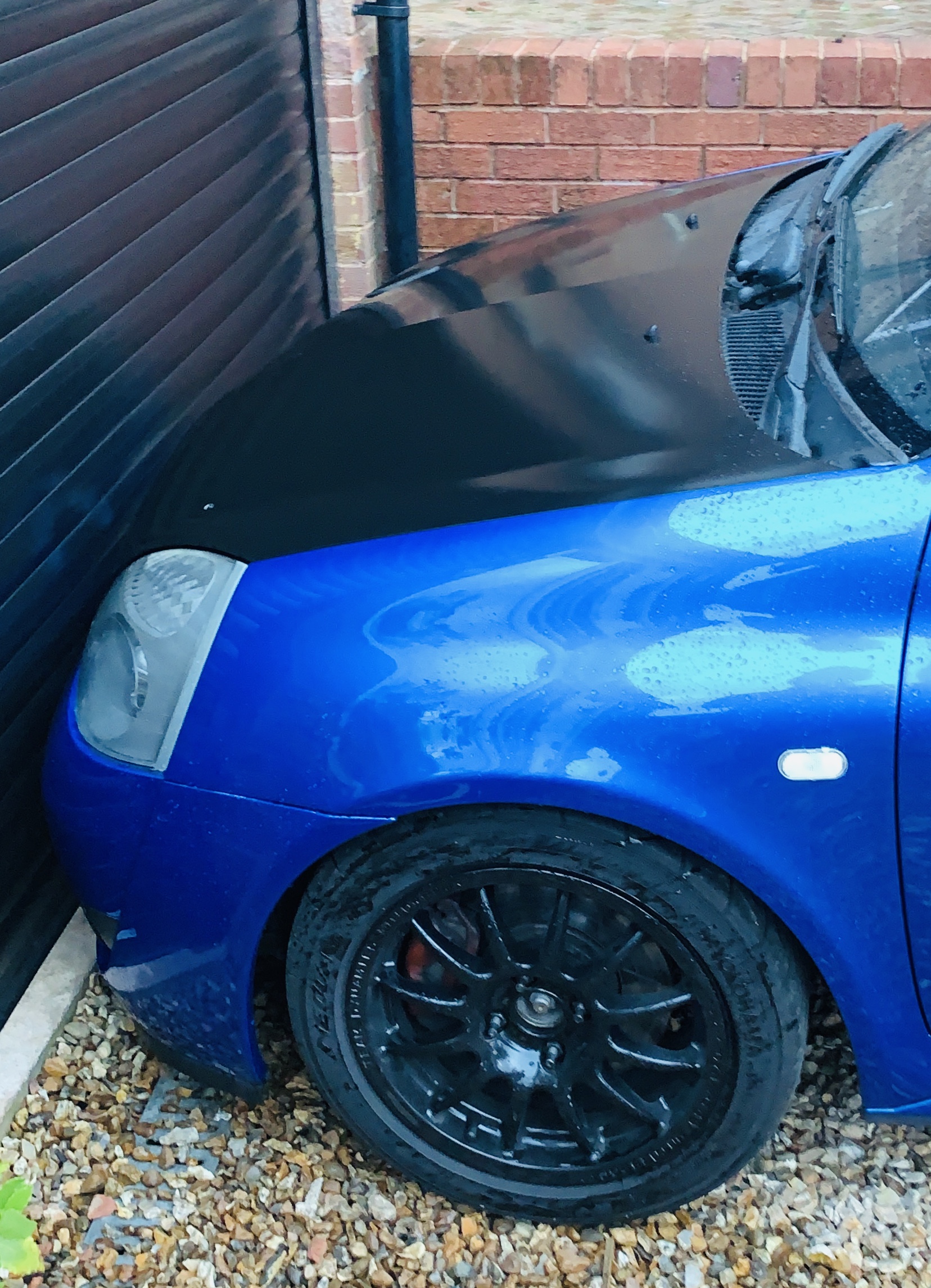

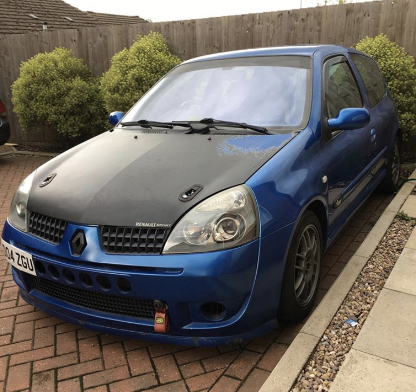

Swapped out the old bonnet for a new one. The only one that had all the structure cut away and was flexing and all bent (was a bit worried it would pop the hinges eventually).
Just need to get it painted now
Rad day at Bedford today. Had a great play with the new Gaz Gold suspension and changing tyres.
Been running Yokohama Ad08 R on the front and RS on the rear. In the morning I ran the RS on the front and R on the rear, swapped round for the afternoon- Nearly 5 seconds a lap quicker (lot less understeer).
Also first dry day running the Gaz Gold shocks. Raised the back end 15mm after a few runs and sorted the balance nicely!

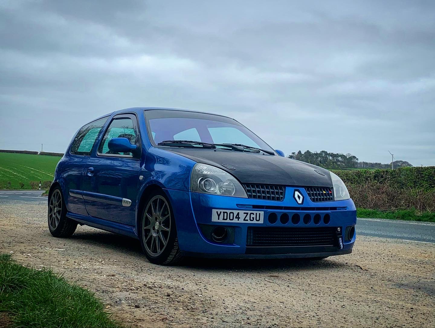

Strangely starting to like the primer black bonnet...

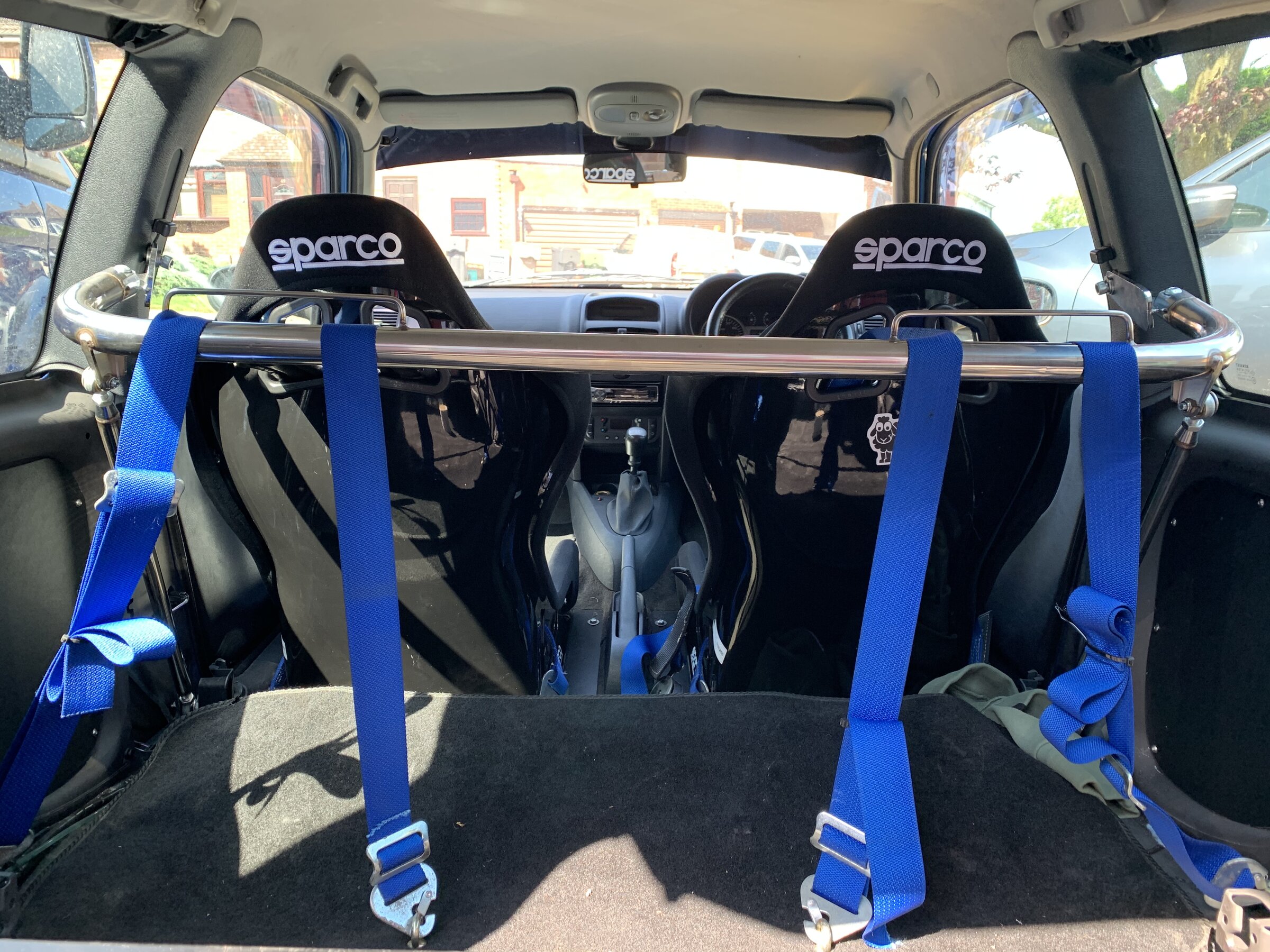

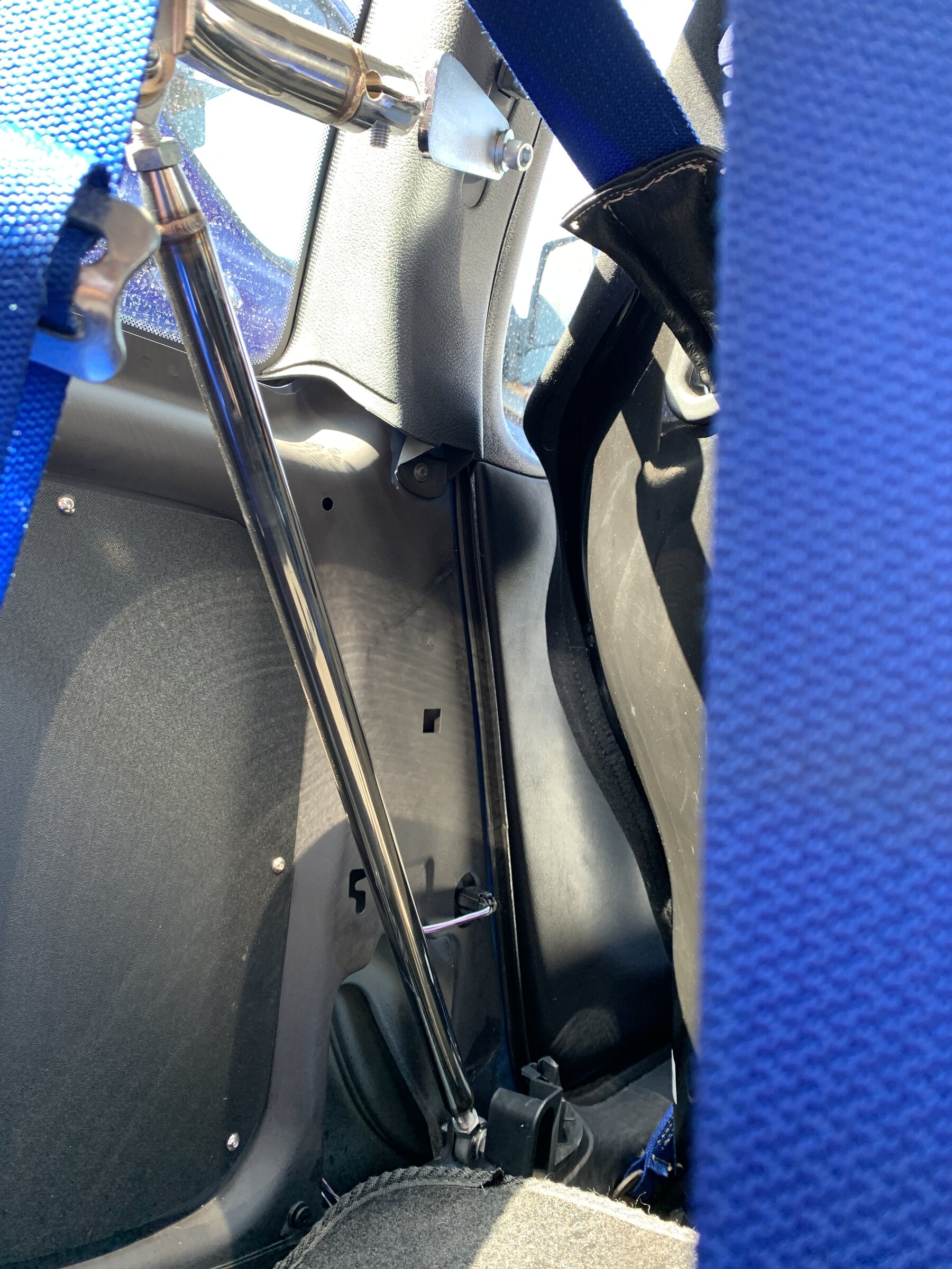

Will end up fitting a half cage around some point Soon. But in the mean time fitted this harness bar to make sure the harness angles are ok.

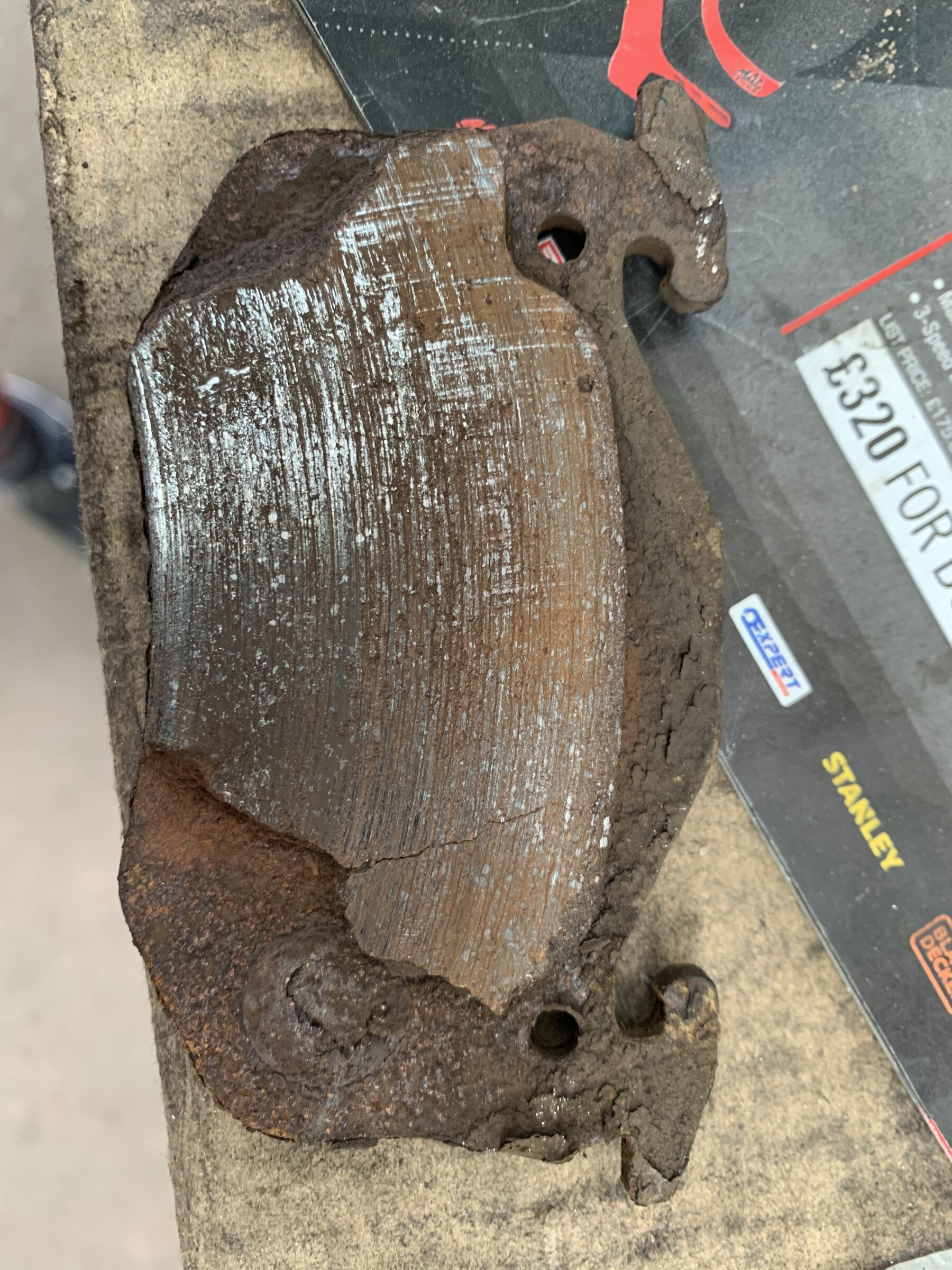

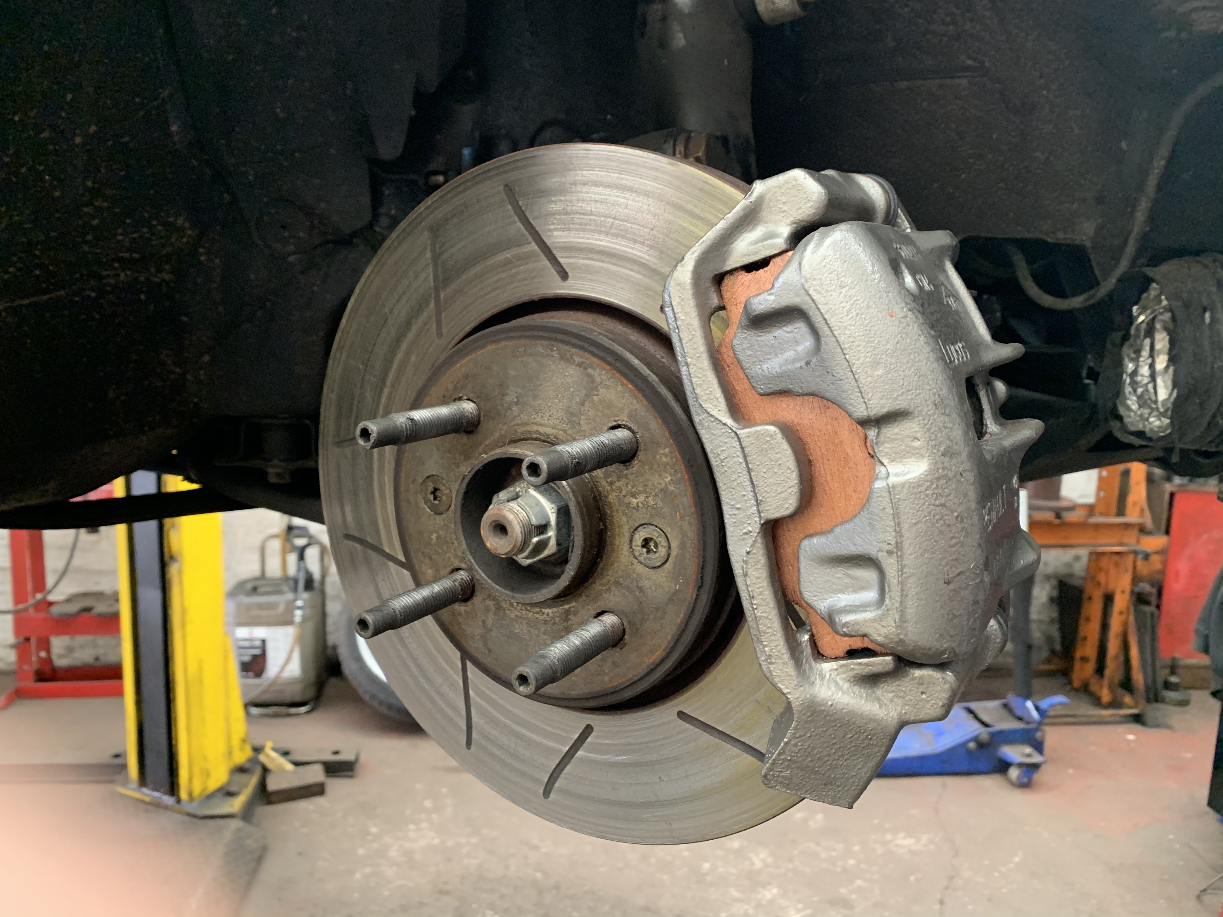

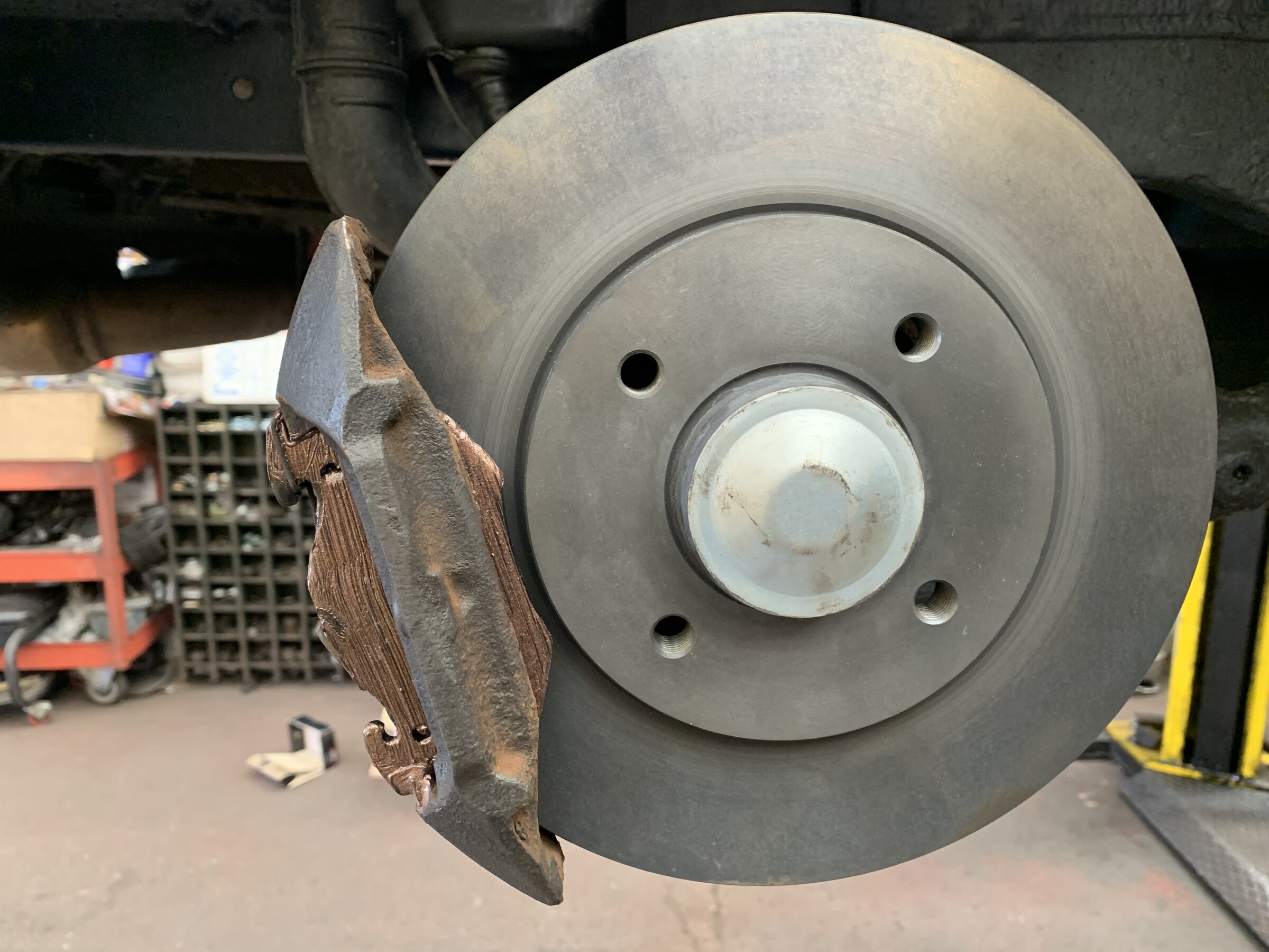

New DS2500 rear pads and genuine Renault discs for the rear. Ready for another day on the track, Blyton Park Monday for the performance french magazine day then Donnington a week or so after.
Pads had seen better days
Also new genuine front wheel bearing
Thanks again to my mate for use of his ramp and skills!

Playing with ride height, raised the back end 15mm from when the coilovers were fitted.
Hopefully try dial out some understeer.

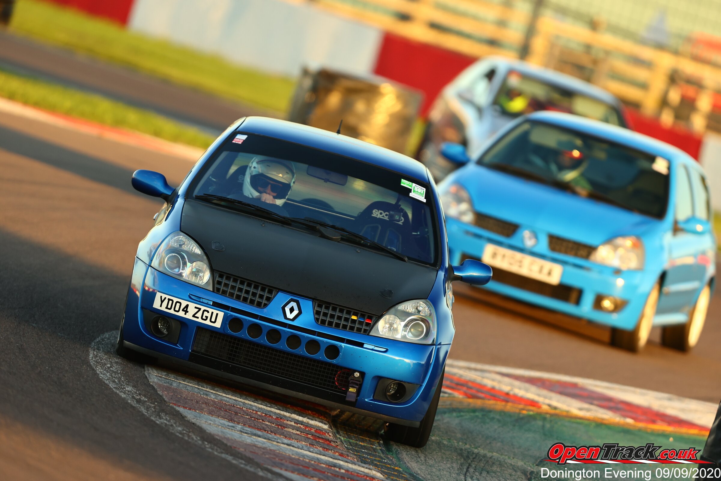

Good fun playing with a few Clios last night at Donington Park.
My mates 182 out on track

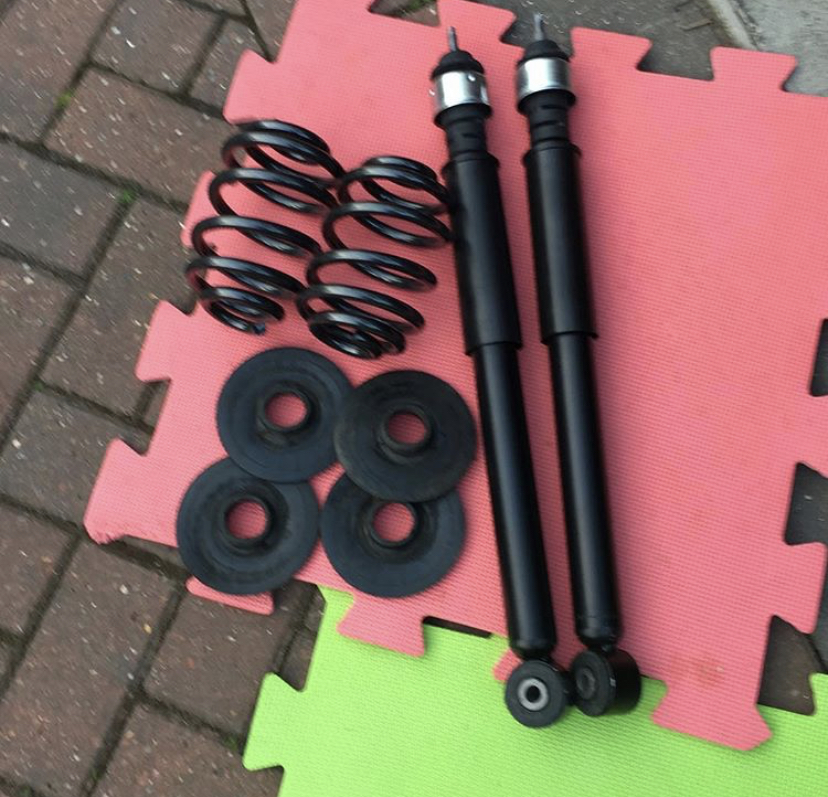

Some photos from the previous owner of the work he did, just a little history.
Hope it’s changed for the better, I think so..

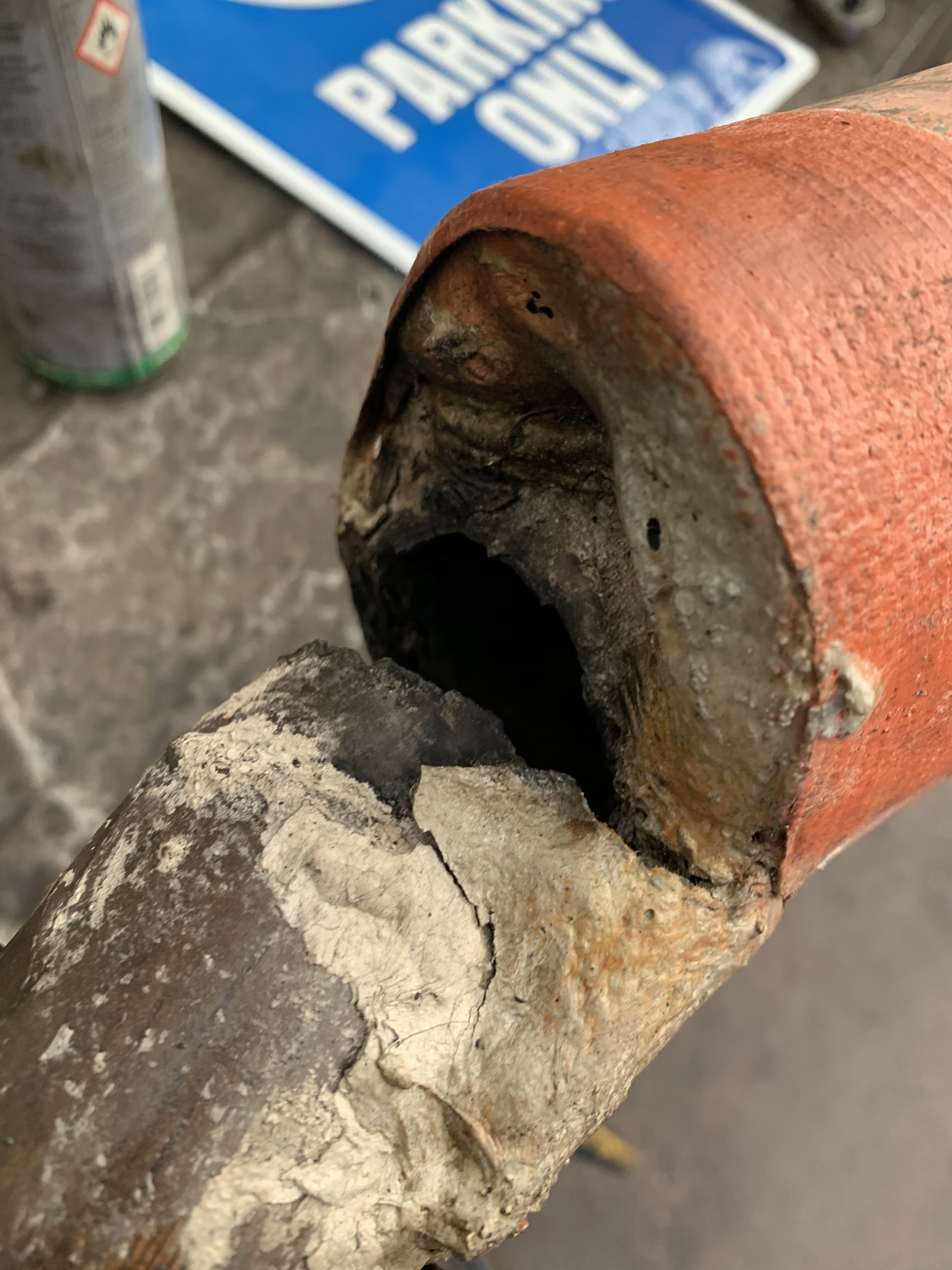

Busy few weeks at work, so just spent a little bit of time on the Clio recently, Just waiting for a new exhaust to arrive as found a few small holes in the current on. Probably could have repair, but got blinded by newness. Also had the gearbox reconditioned by universal transmissions in Kidderminster (great lads) and have a Pure Motorsport shifter to fit too.

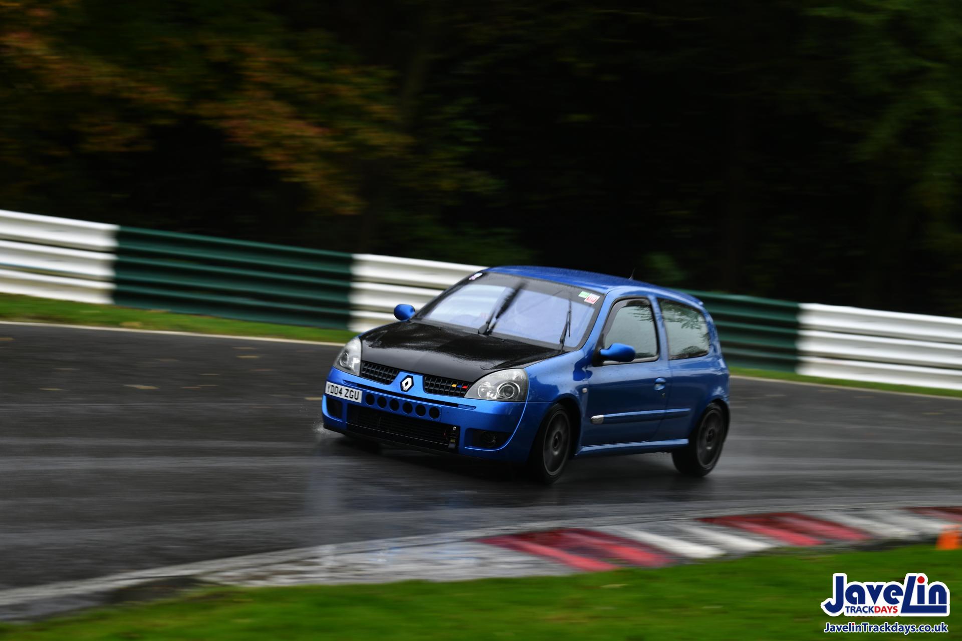

Before all that, had a good day at a very wet Cadwell Park. Can highly recommend Uniroyal rainsports!

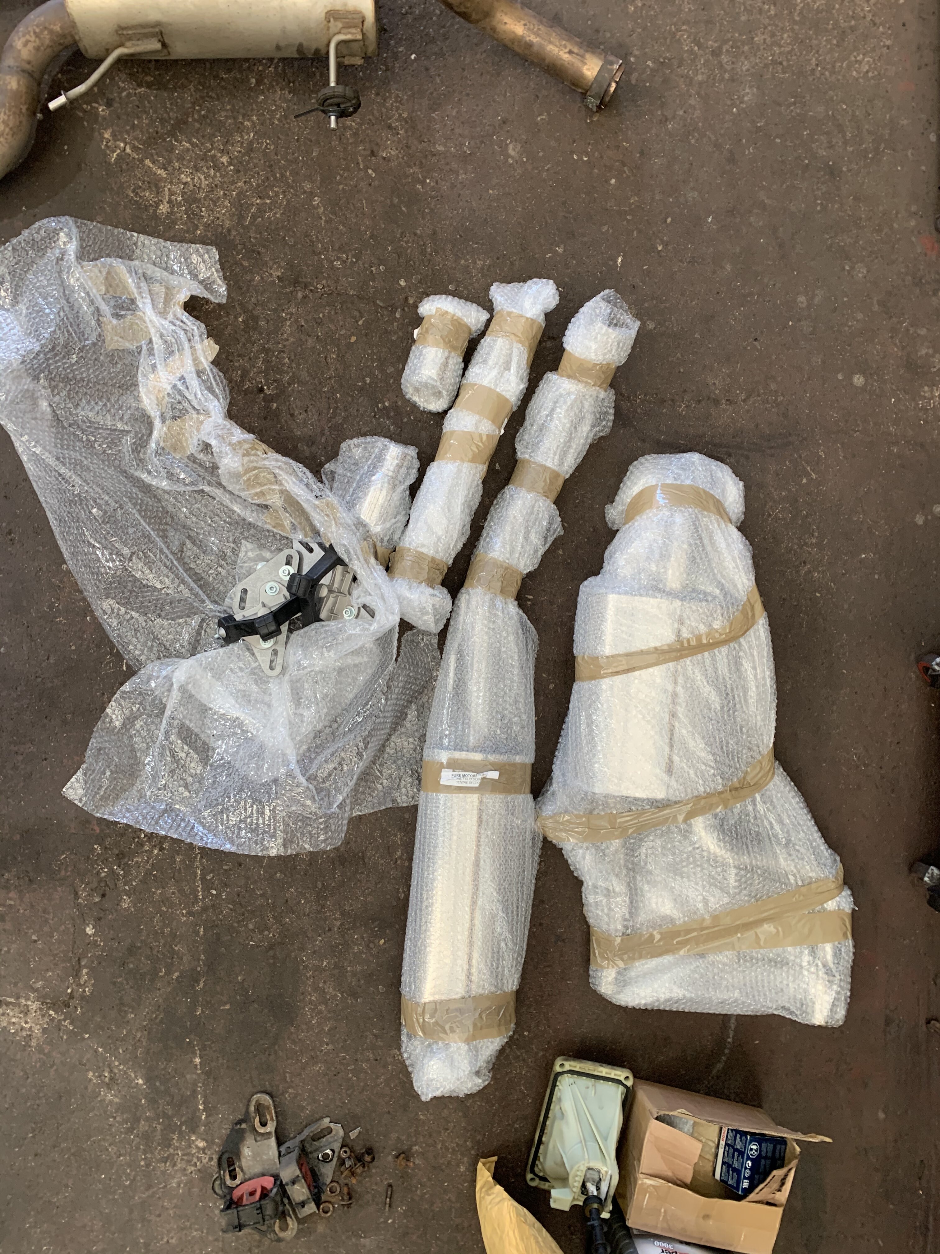

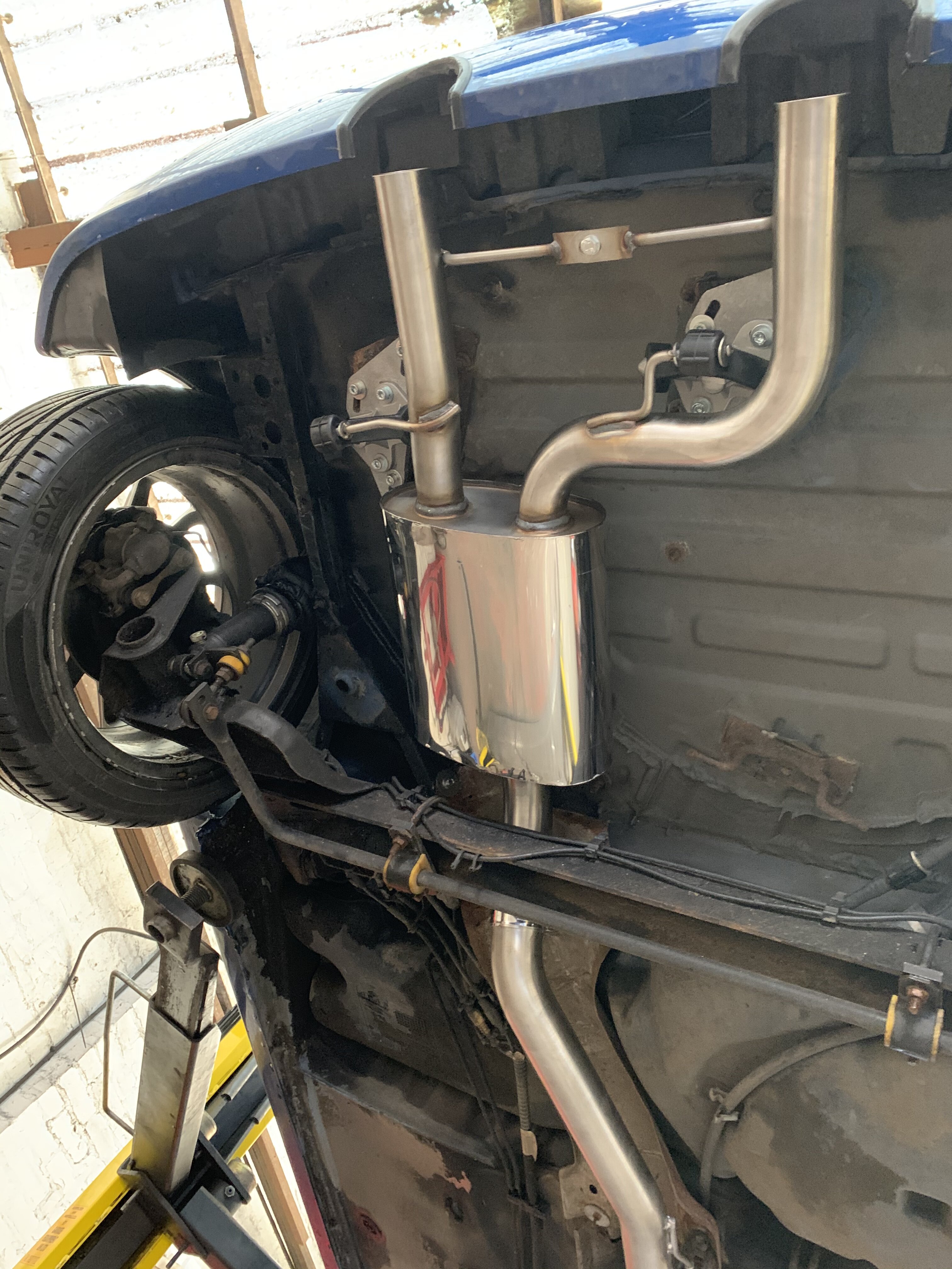

Bit of time in the garage today to fit some parts.
- Pure Motorsport Exhaust
- Pure Motorsport Shifter
- x4 new genuine injectors
- oil and oil filter change
- clean and check spark plugs

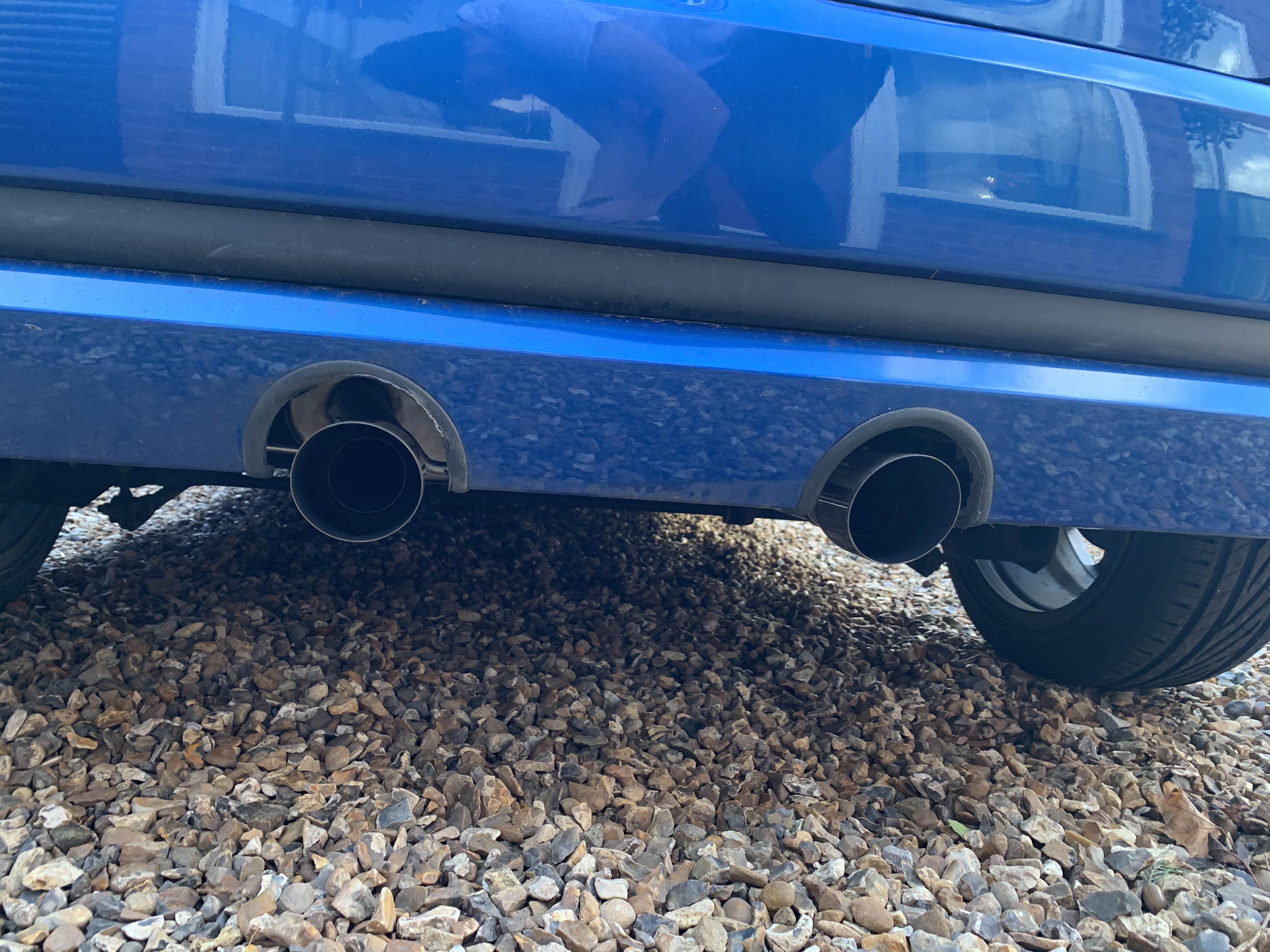

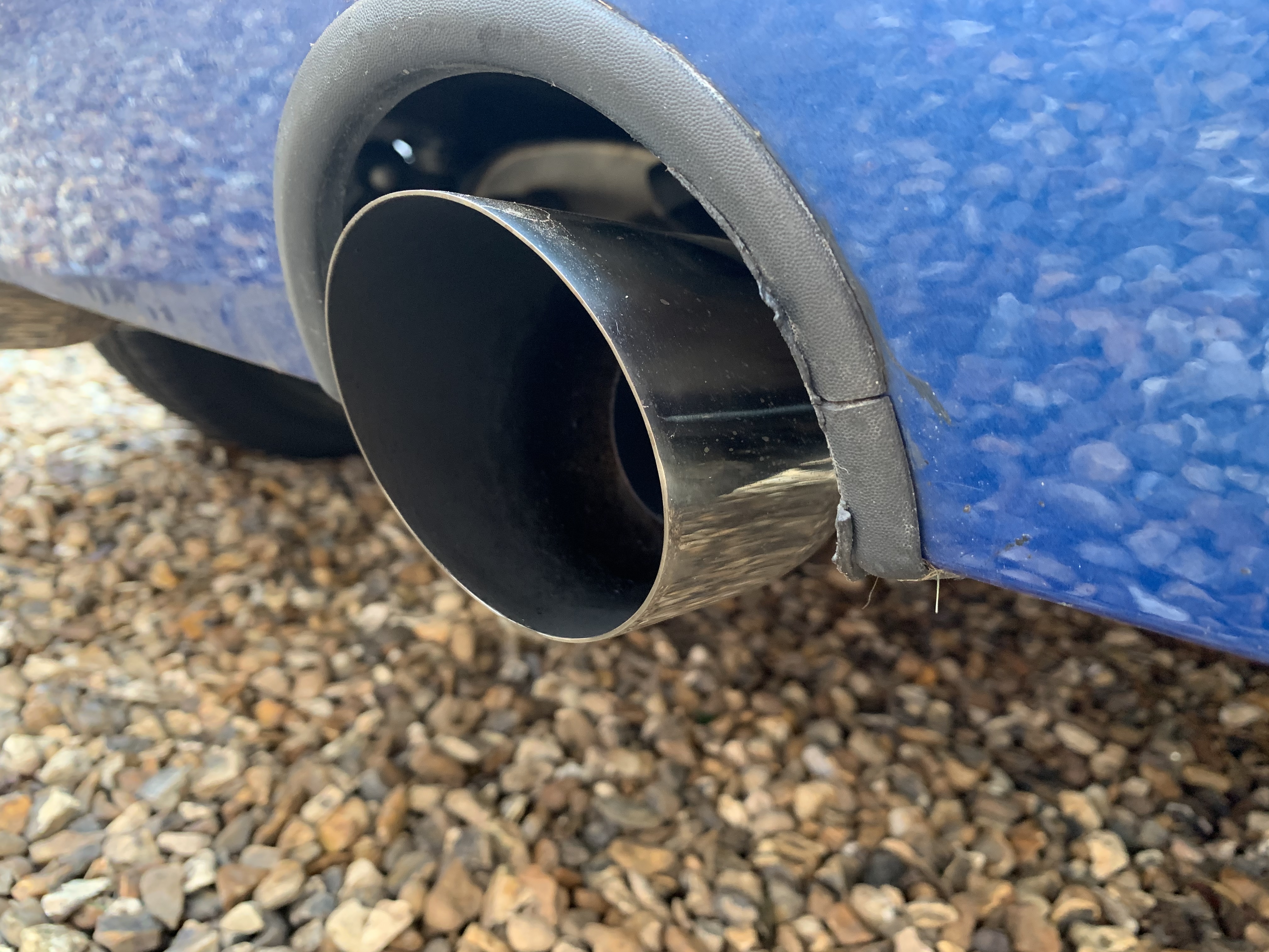

Had a cracked exhaust in the old Scorpion Exhaust, the PMS system is a work of art. (Sounds incredible too, quiet, but a nice rasp)
New PMS shifter is amazing too, feels so much better and the Clio is running 90% better now. Just in time to park it up for a while!

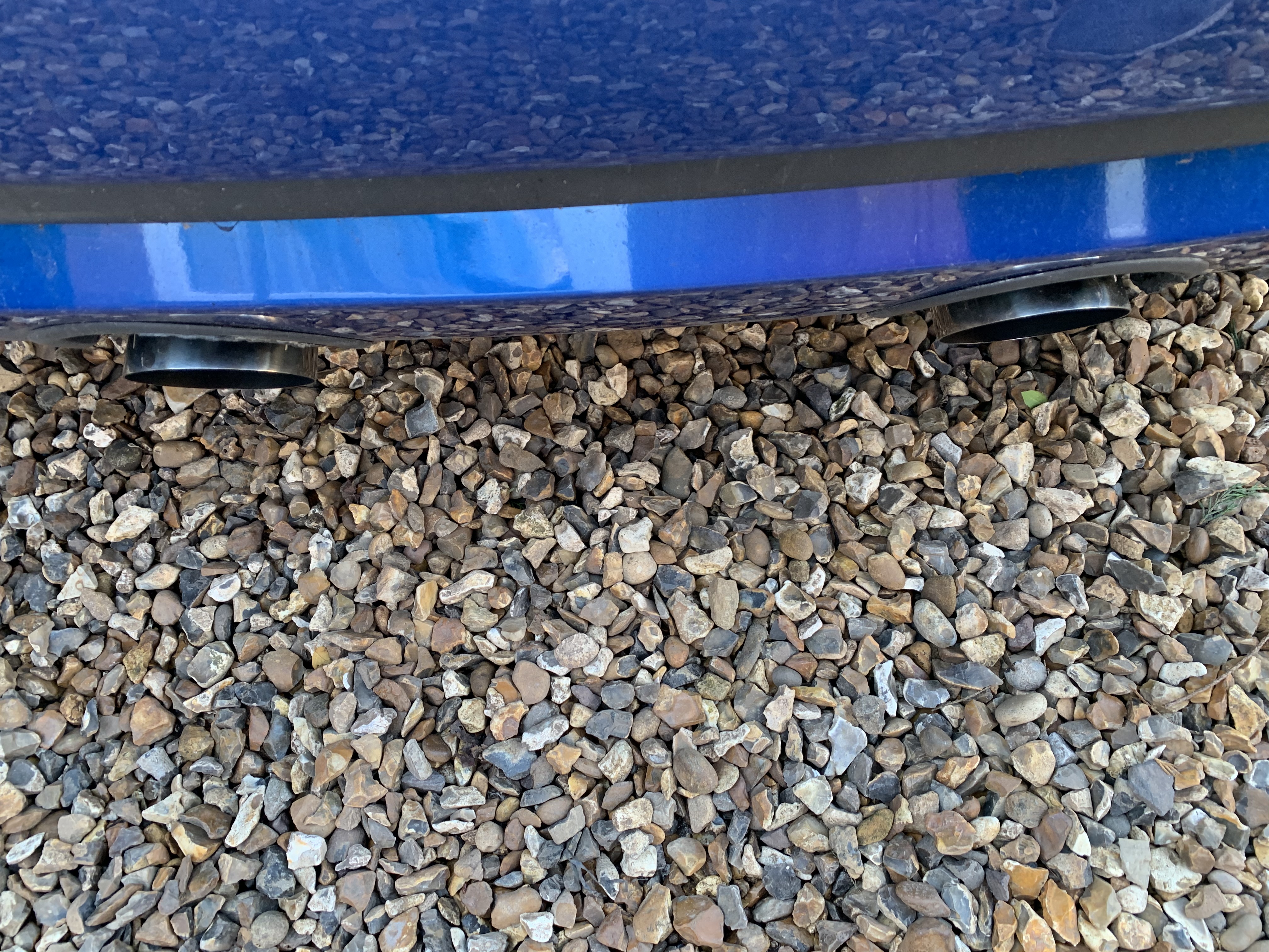

That does look good! Have you got some pics of the exhaust with the exhaust tips on? Which ones did you decide to get?
3’ Slashed tips, wasn’t 100% a fan before they were fitted, but they look great in my opinion (and the exhaust sounds amazing)
  • Love
Reactions: MLB
Exhaust looks great, it’s on my list of upgrades for next year I think now. Be worth investing in some of the ProAm exhaust mount plates in stainless I believe they are slightly shallower so would close the gap between the tailpipe and bumper up nicely.
Ah thanks, the mounts were little buggers to get off As they were a little past their sell by date. so may have a look when I’m on the next purchase wave (and can get some ramp time again, makes it so much easier than on a gravel drive)!!
View attachment 1504077View attachment 1504076
That does look so good! Thanks for the pics.
Just got an email from Nick at PMS that the exhaust system is in stock again and their cats are in their way so might have to have a look in the next couple of weeks. Can't decide on straight/slash cut and shiny or brushed tips though!
I thought I ordered straight, but happy how they turned out and look when they are on the car. Awesome but of kit so far (and goes together easy!)

Plans over Christmas to fit the fully refurbed gearbox (as it crunches in 3rd with this spare box I fitted- will refurb this one too- may save the pennies and fit a dif, if I get really into things). Will also sort the minor electrical gremlins out.

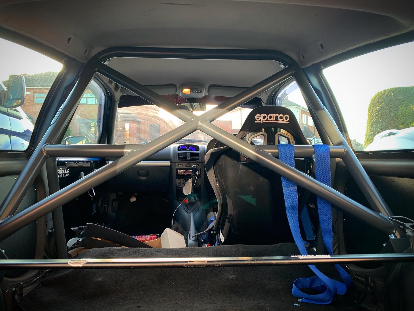

Placed an order for a rear 1/2 cage to be build (and fitredby Fulcrum Cages (option to make it a full cage in the future), just to get rid of the harness bar and a little safety.

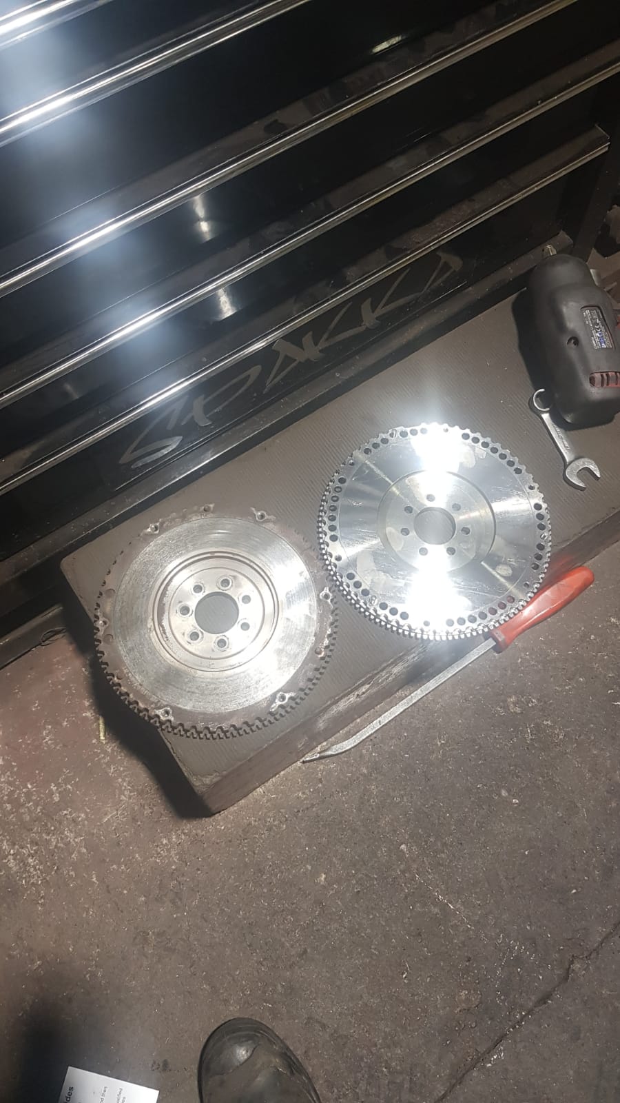

Time to swap the gearbox back from the spare back to the fully refurbed one. Whilst it’s out we may as well change the clutch (genuine Renault clutch) just in case and add a bit of Bling (Shame you will never see it!) pure motorsports flywheel.
Out with the old and in with the new.
gearbox swapped, pure motorsport flywheel fitted, new OEM clutch, new aluminium heat shield made and fitted and the Clio is running like a beauty.

just had it fitted today, can’t recommend Tom at Fulcrum high enough! Will get a load of photos tomorrow. Had the half cage, with fixing if I do want to make it a full cage in the future, finished in anthracite grey.

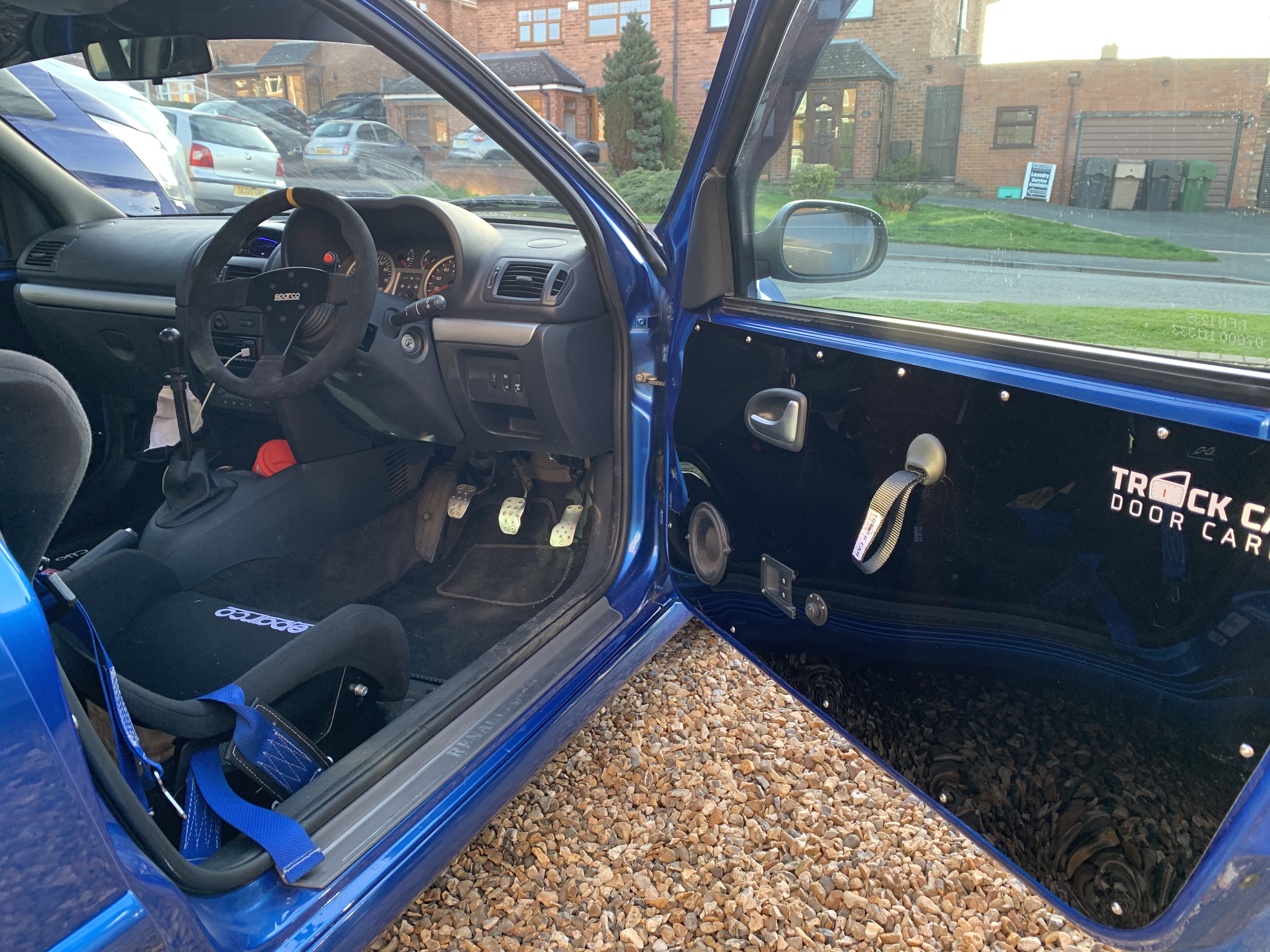

Also fitted the track day door cards the other day too and a new sparco 330mm steering wheel, little OCD to match the Sparco
