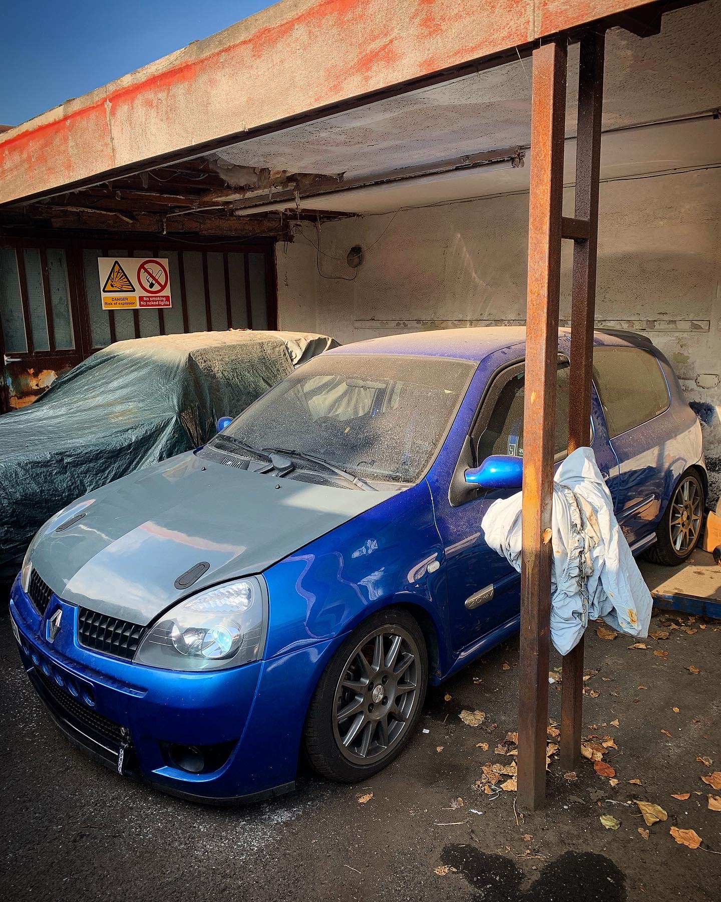

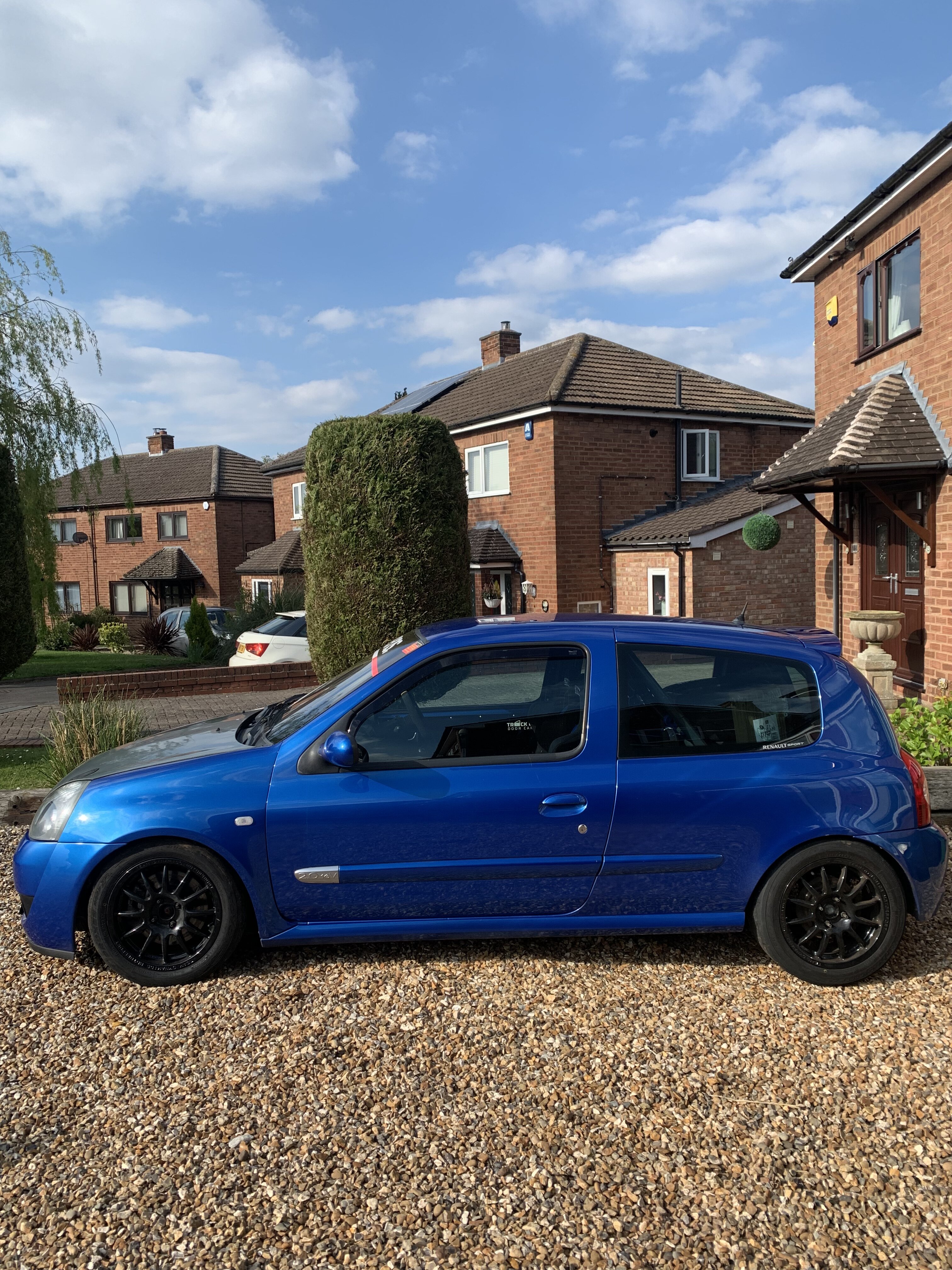

182 Fake Racing/ Track car
Before it went wrong...

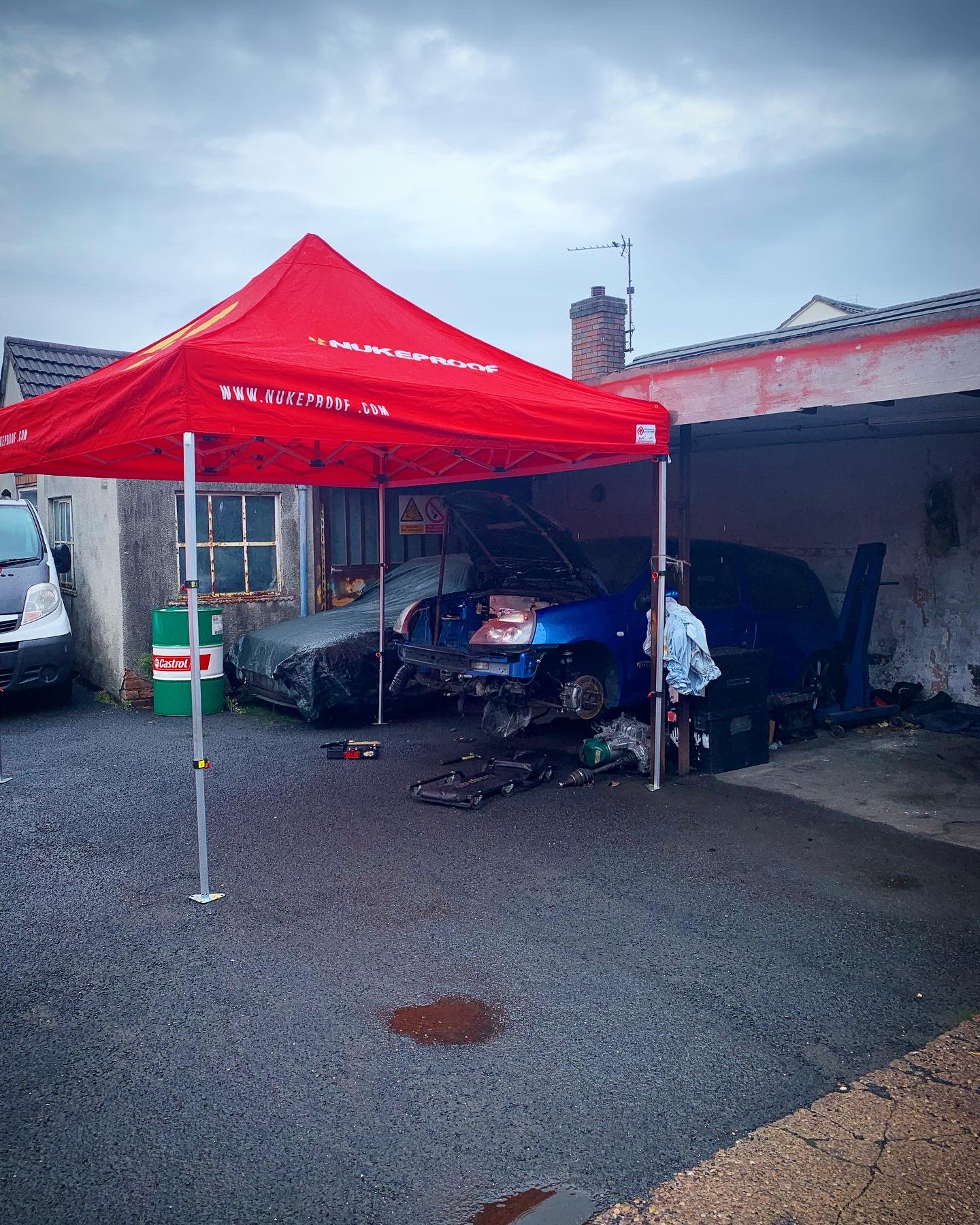

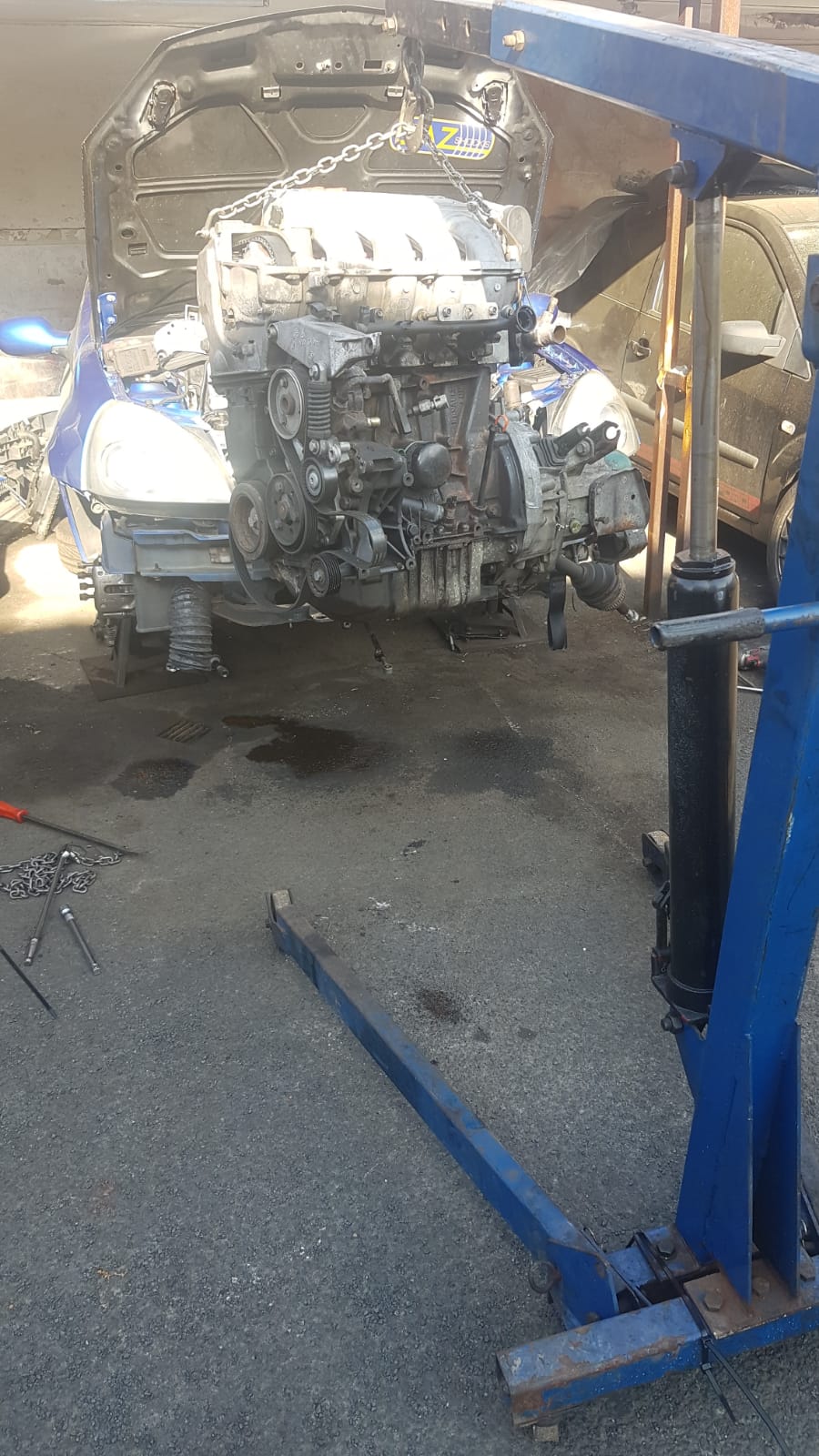

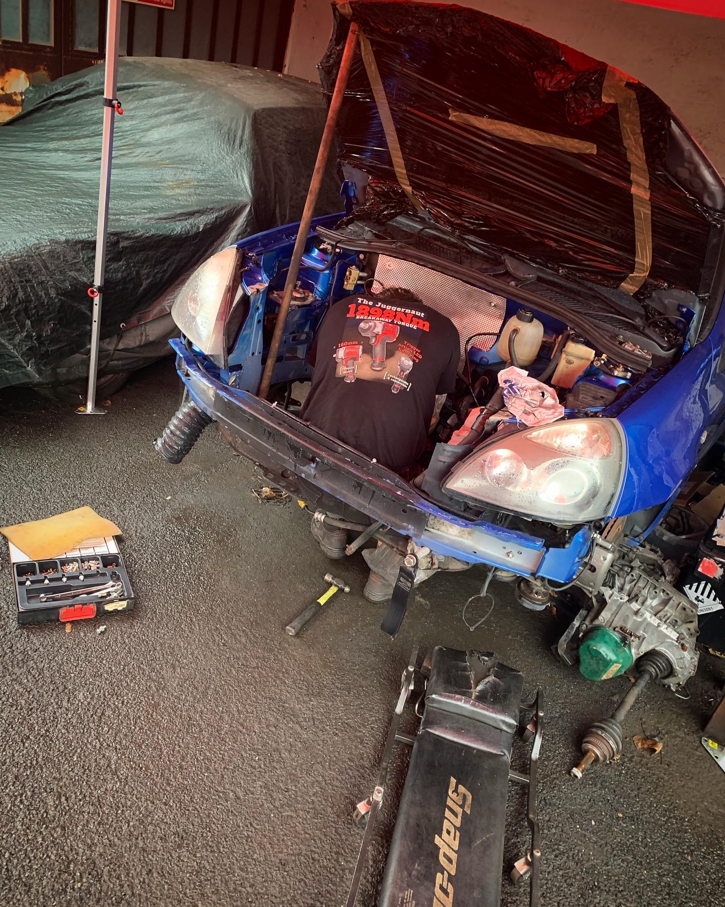

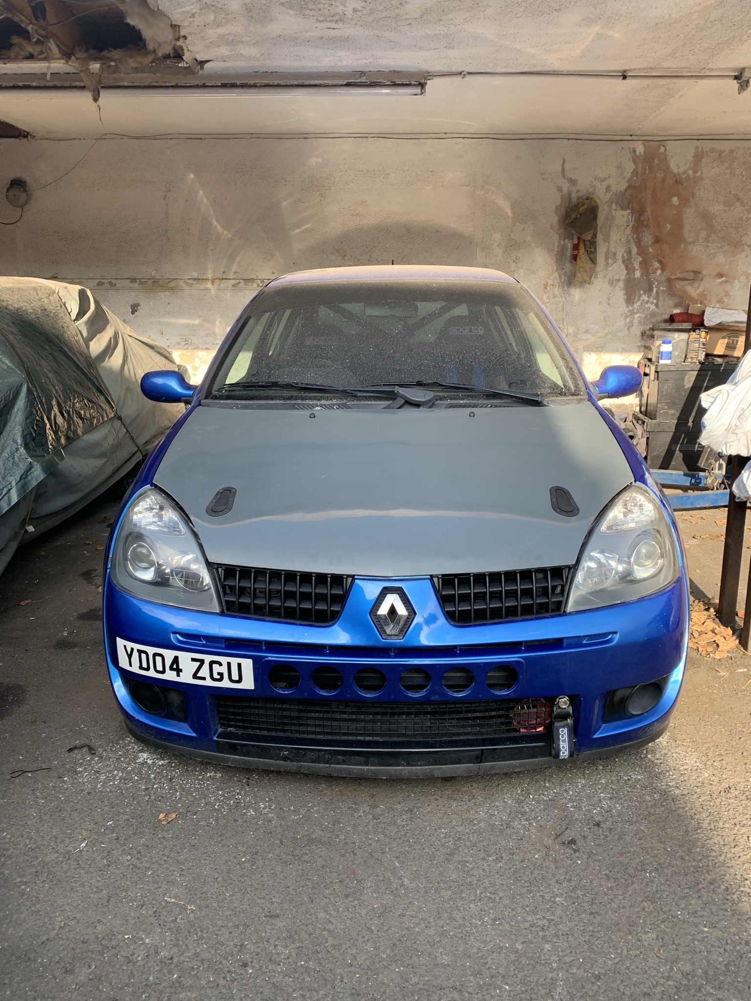

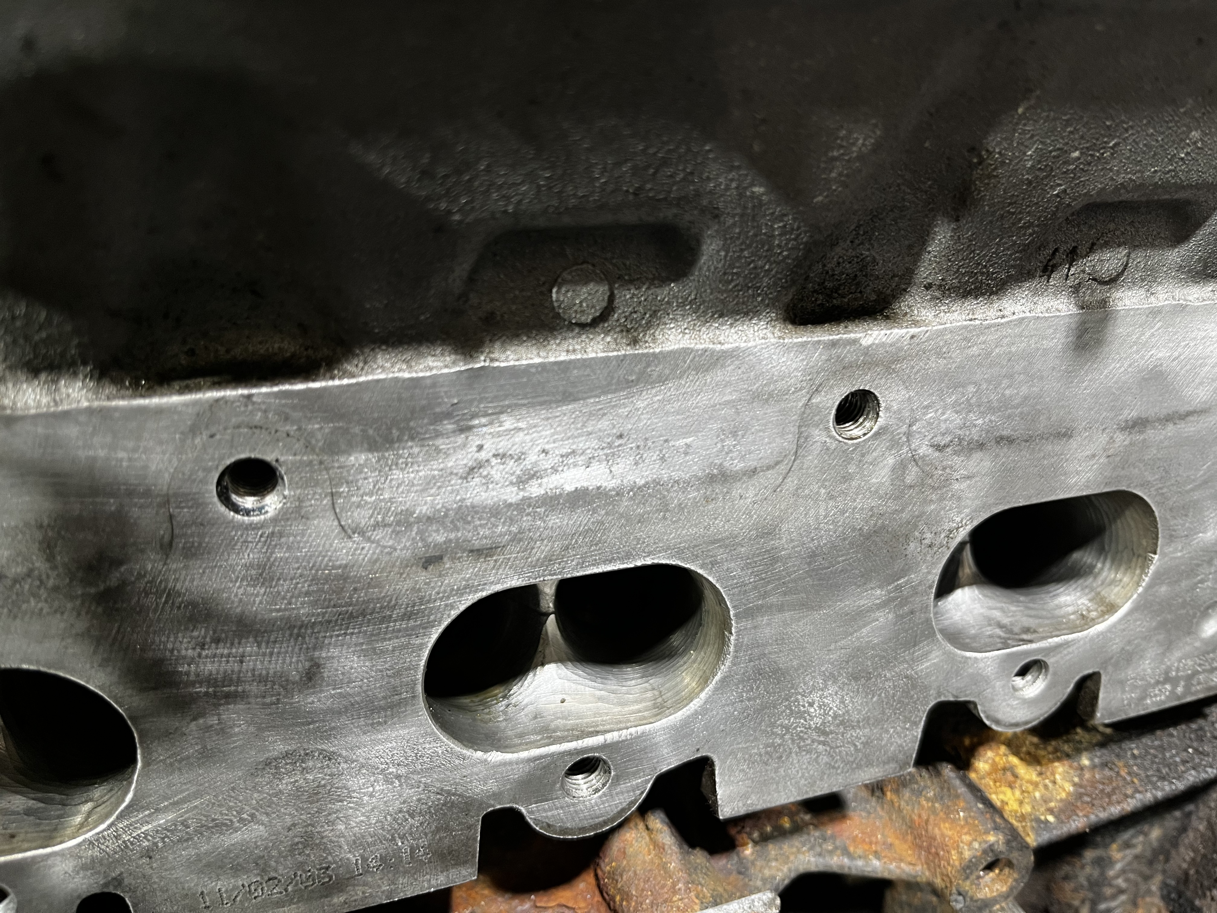

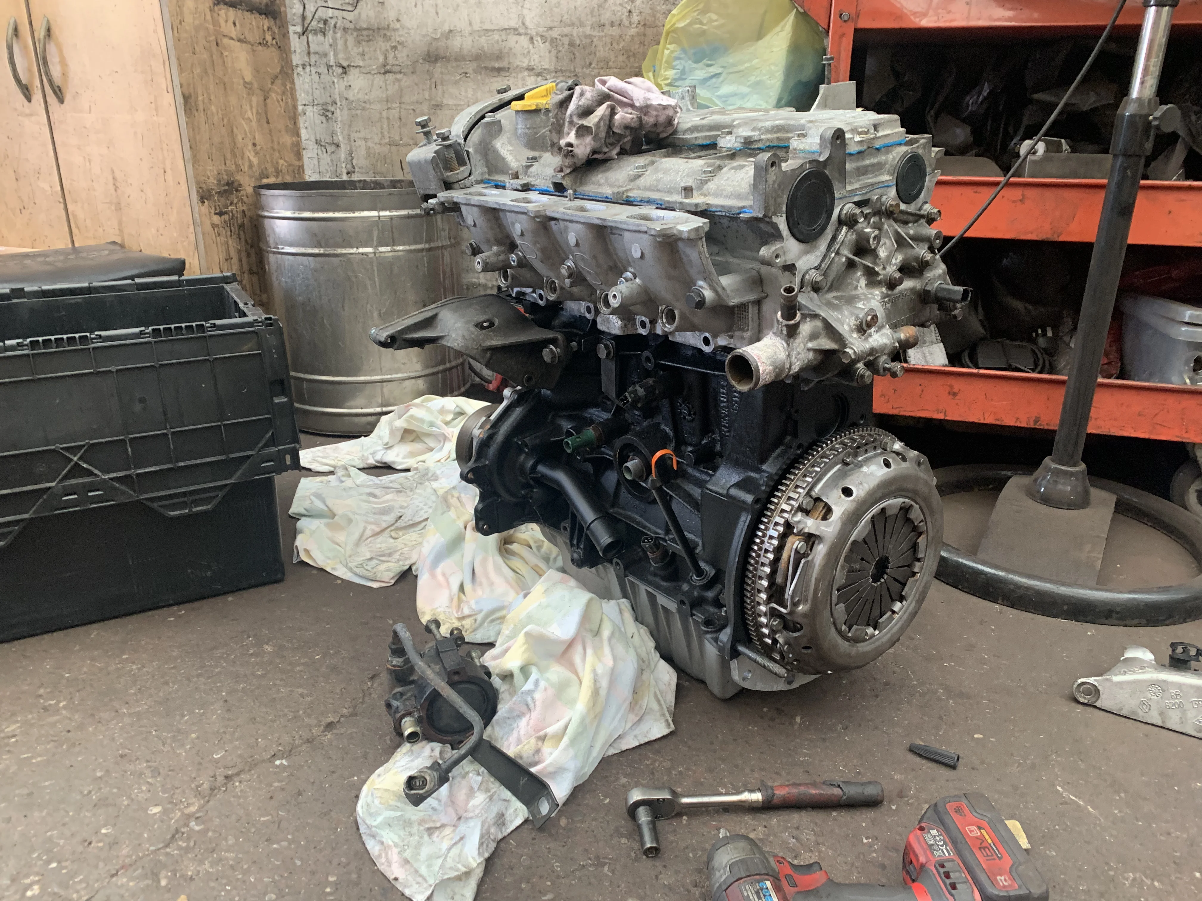

Stripping it down, engine out for a full check over then off to get rebuilt, and maybe a few wee upgrades. Will tidy up the engine bay and auxiliaries with it out.
Slowly getting there with getting back on track.

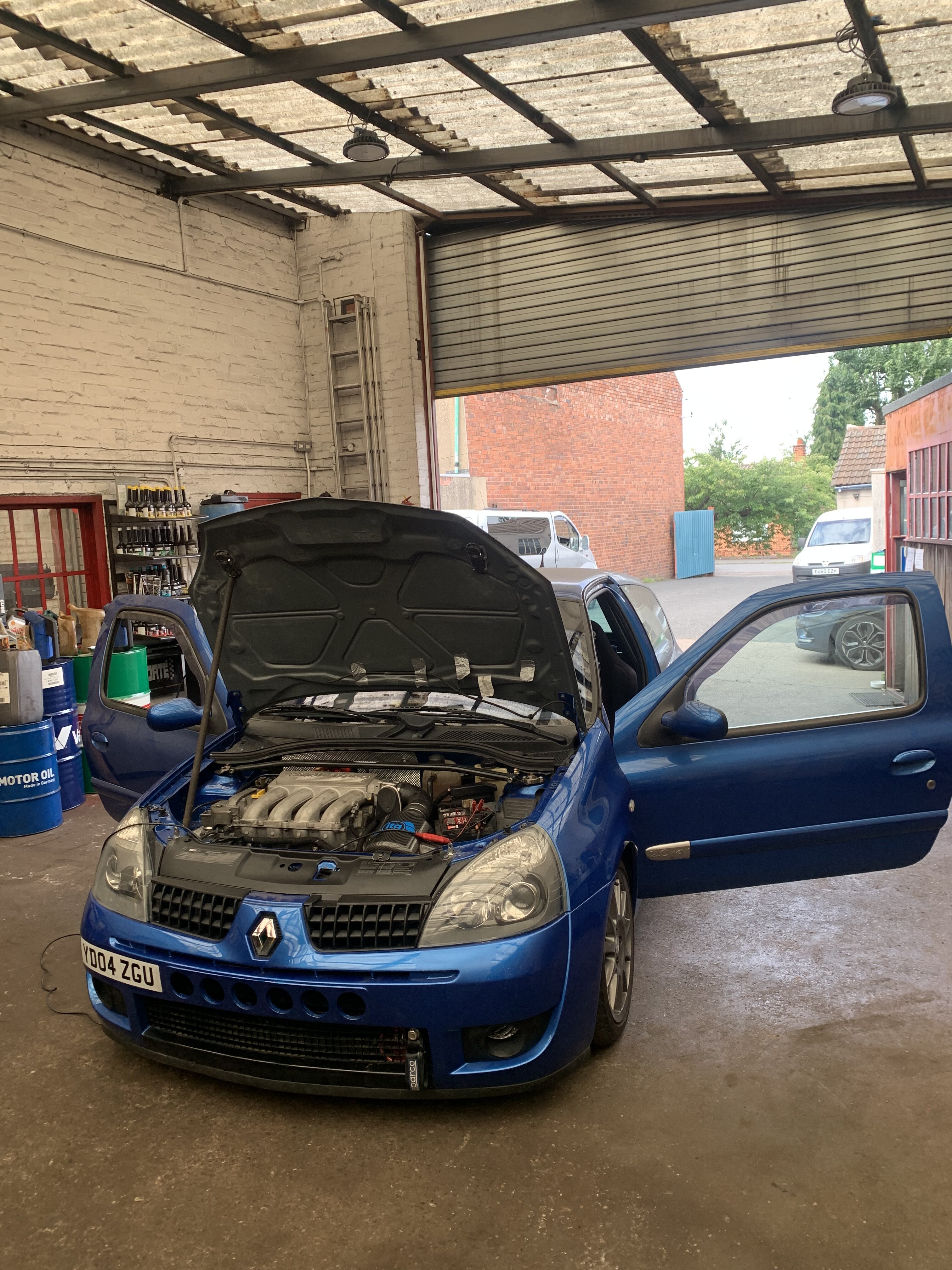

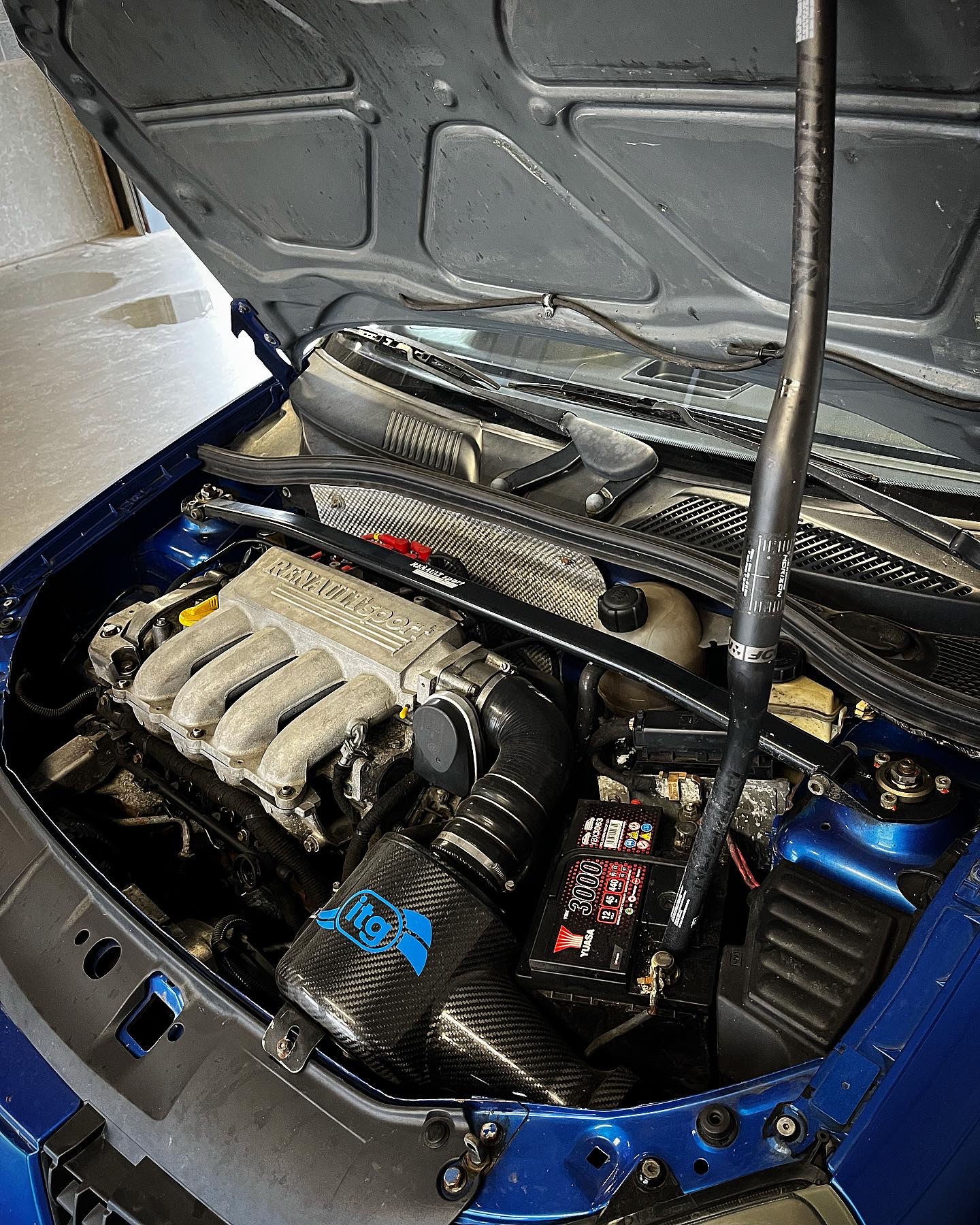

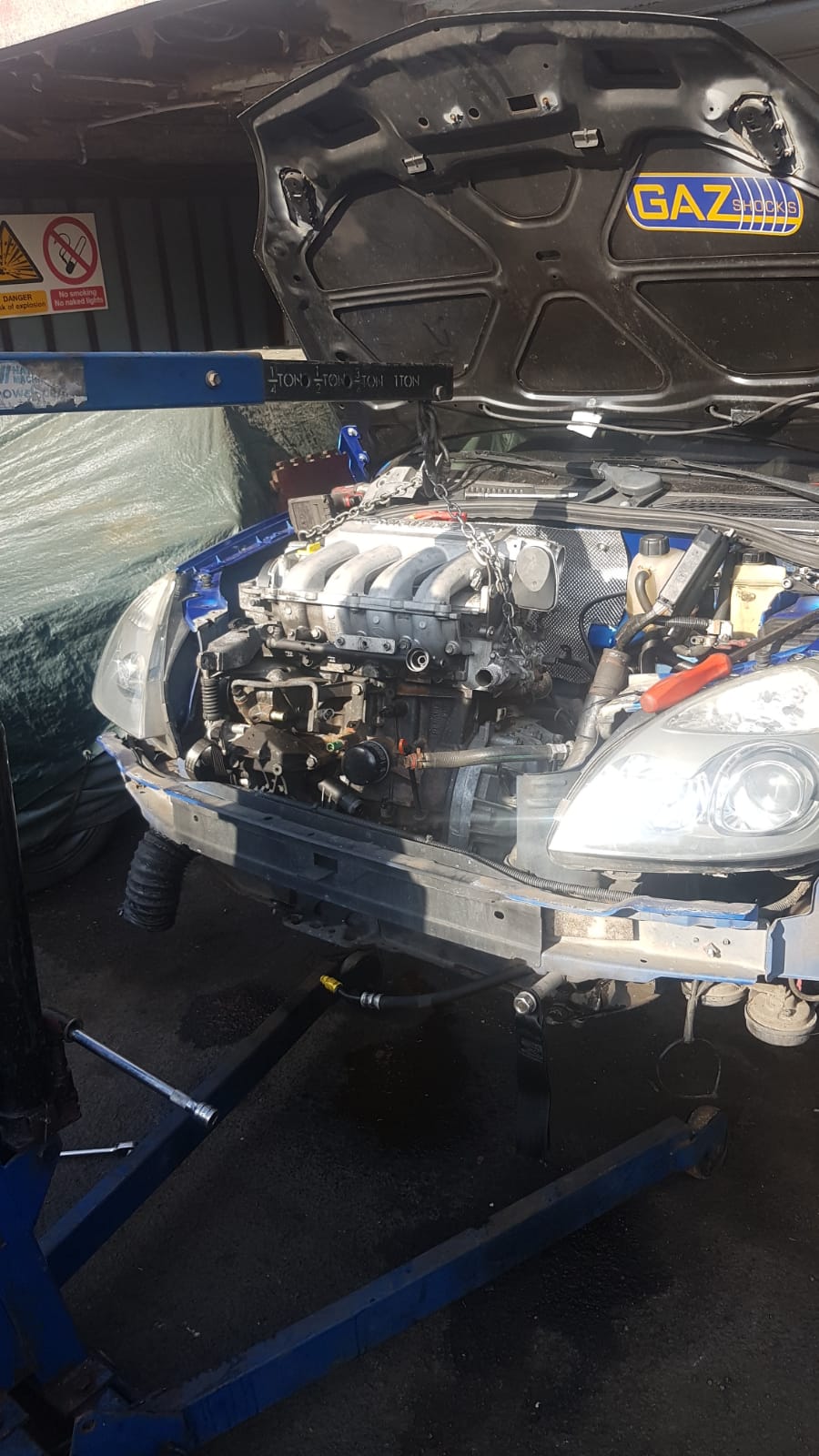

Fully refurbished engine sourced, all new belts, dephaser, water and oil pump. ARP bottom end bolts fitted and machined head.
Just waiting on borrowing an engine hoist, so bit of tidying up ready for the engine, re-wrapped the manifold, tidied all the electrics, fitted all new water hoses, refitted and changed a few heat shields and a lick of paint in a few areas. Fitted a new fibreglass bonnet too, just as the old one was a bit rough.
Hope to have it back ready for some September track days!!
Back on 4 wheels and New engines running well, going to give it a few pre flight checks and an oil change before heading back out on the road/ track. But not long now (can’t wait to give it a good clean too!
Engine fired up at first time of asking after checking the pressures and no leaks! Booked in for a remap too with EFI in a few weeks, just as the old engine had a few issues, so want to make sure the map suits this one.

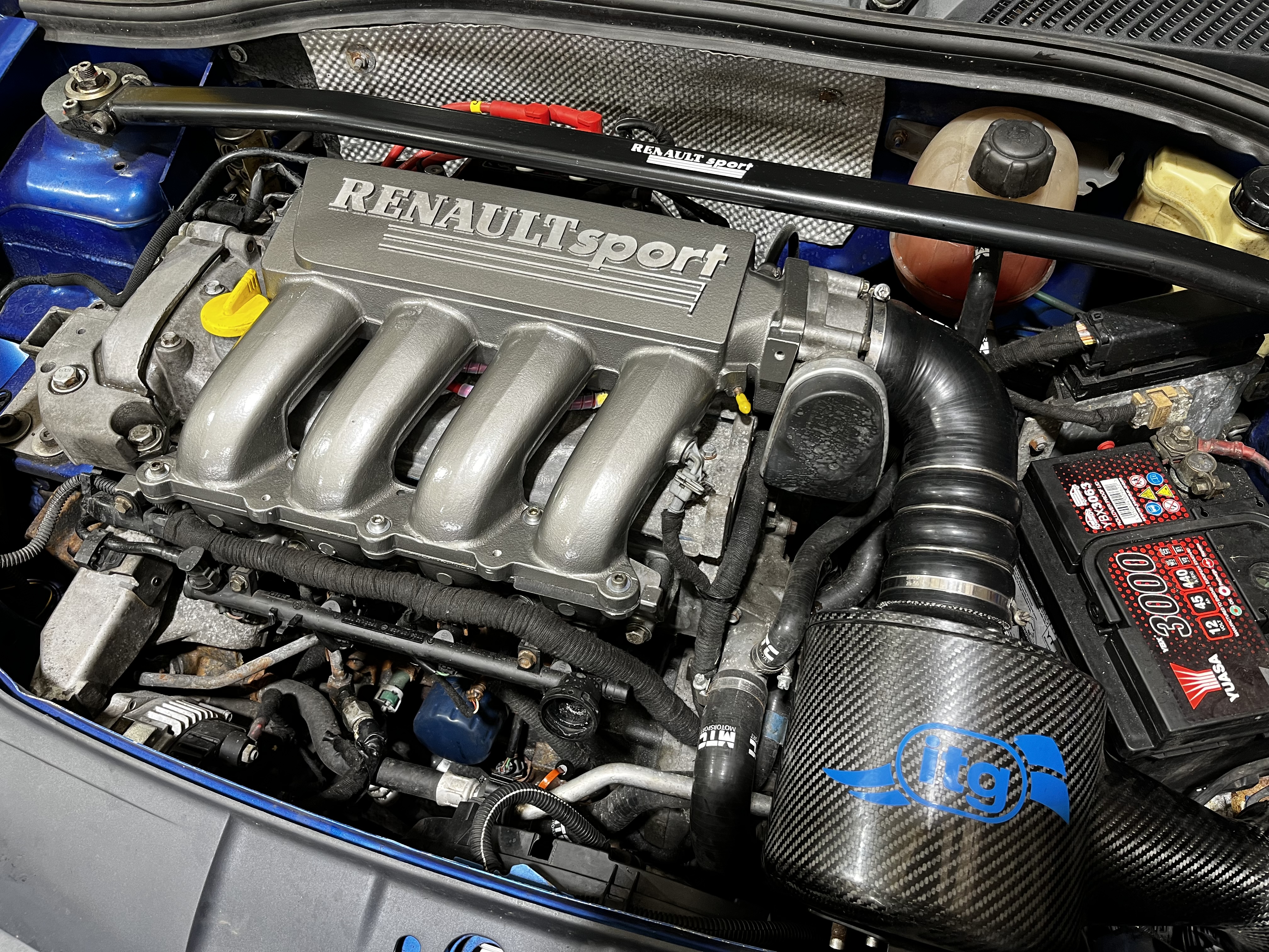

  • ITG Carbon intake

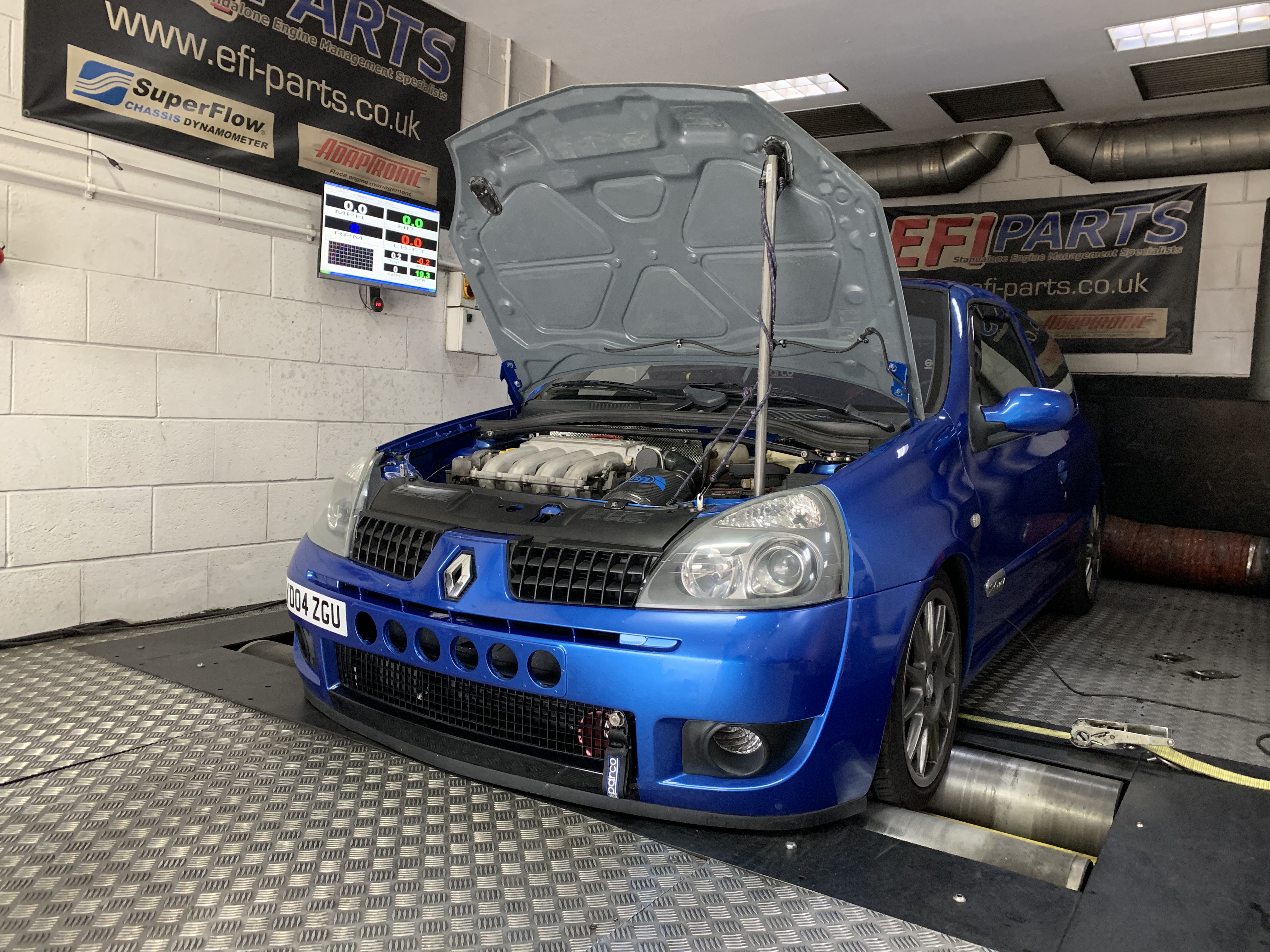

Have you got a figure you're aiming for when you map it at EFI, or are you just wanting it to be sorted for the track?
You've put some serious work into this recently, very impressive mate. Looking forward to seeing more updates.
Thanks very much, it’s been fun and a nice learning curve.
I don’t really have any figures in mind to aim for, just looking for a healthy and reliable engine to enjoy! Can’t wait for it to be back on the road/ track!

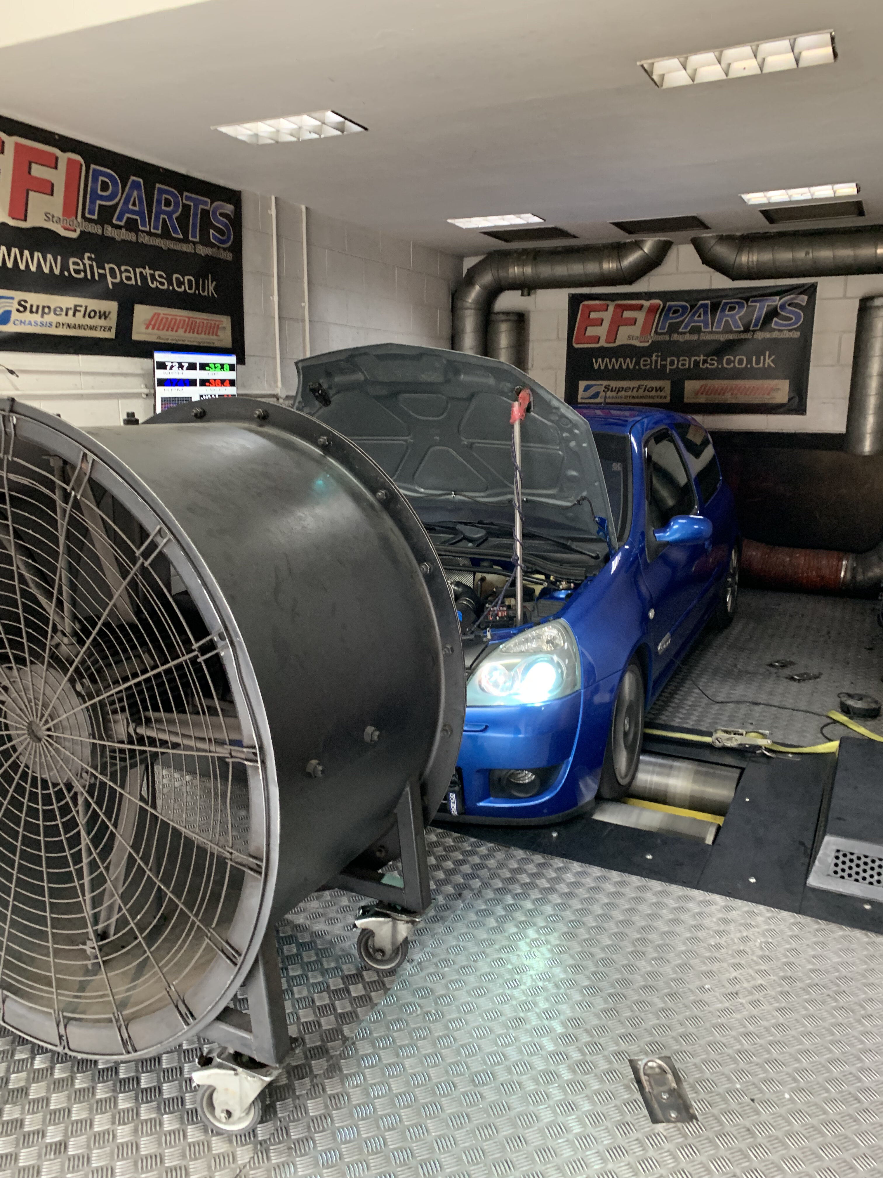

First time in 6 months and the clios back driving. Cycle the oil and filter change just as it’s a fresh engine. Will put a good few miles on it the next few days ahead of a trip to efi for remapping and then first track day at Anglesey on Friday. Got to get the aligning checked before too from the team at Aline Dudley.
Since the first mini run out, just got to sort out a STOP light and the Handbrake light flashing on the dash- will check connections and the fluids as it’s running perfect.
Can’t speak highly enough of the team at EFI, chris was brilliant and the cars now running awesomely and both he and Laura were super welcoming! New engine is healthy producing just shy of 180BHP with strong torque through the mid range. Fuel/ air mix all sorted too.
put a few hundred miles on the engine now so just running in nicely now.

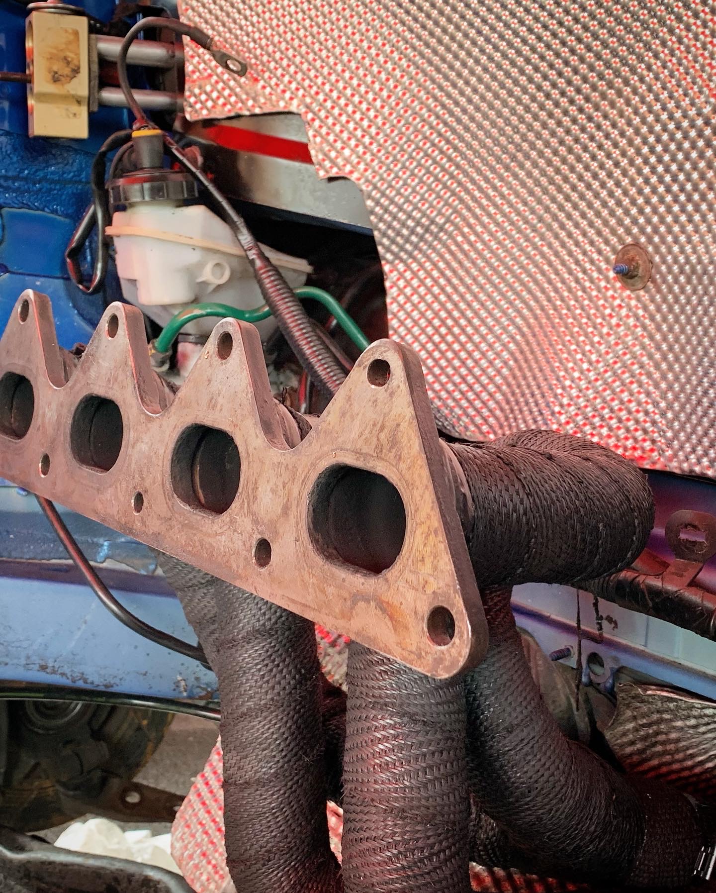

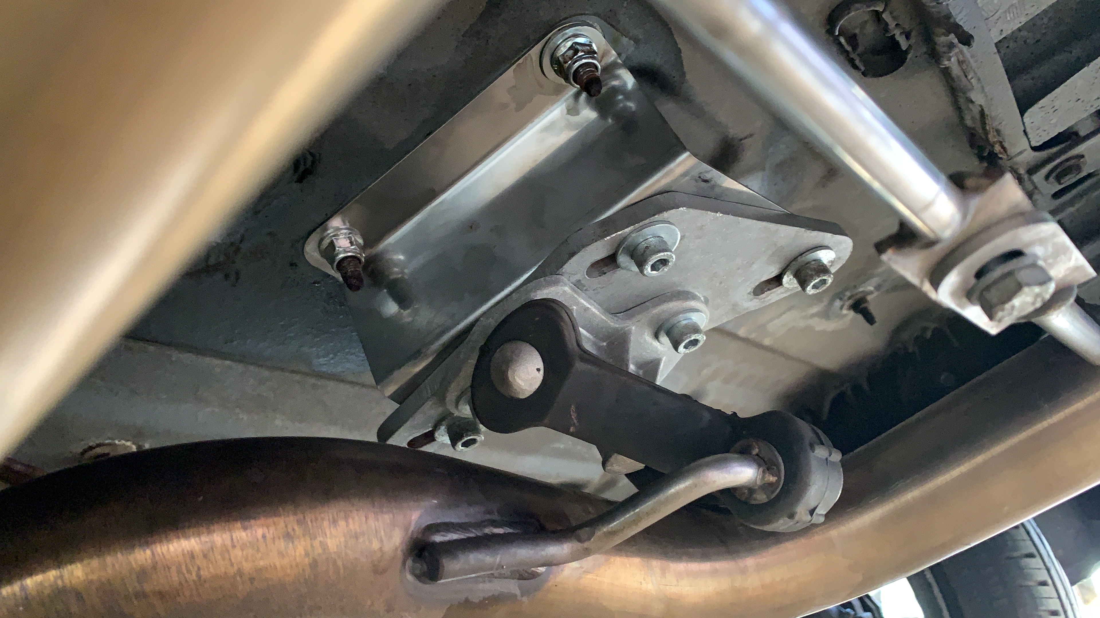

Just a small job today, swapped the old rusty exhaust hangers for the ProAm set. Much tidier and the pure Motorsport exhaust hangs a little nicer.

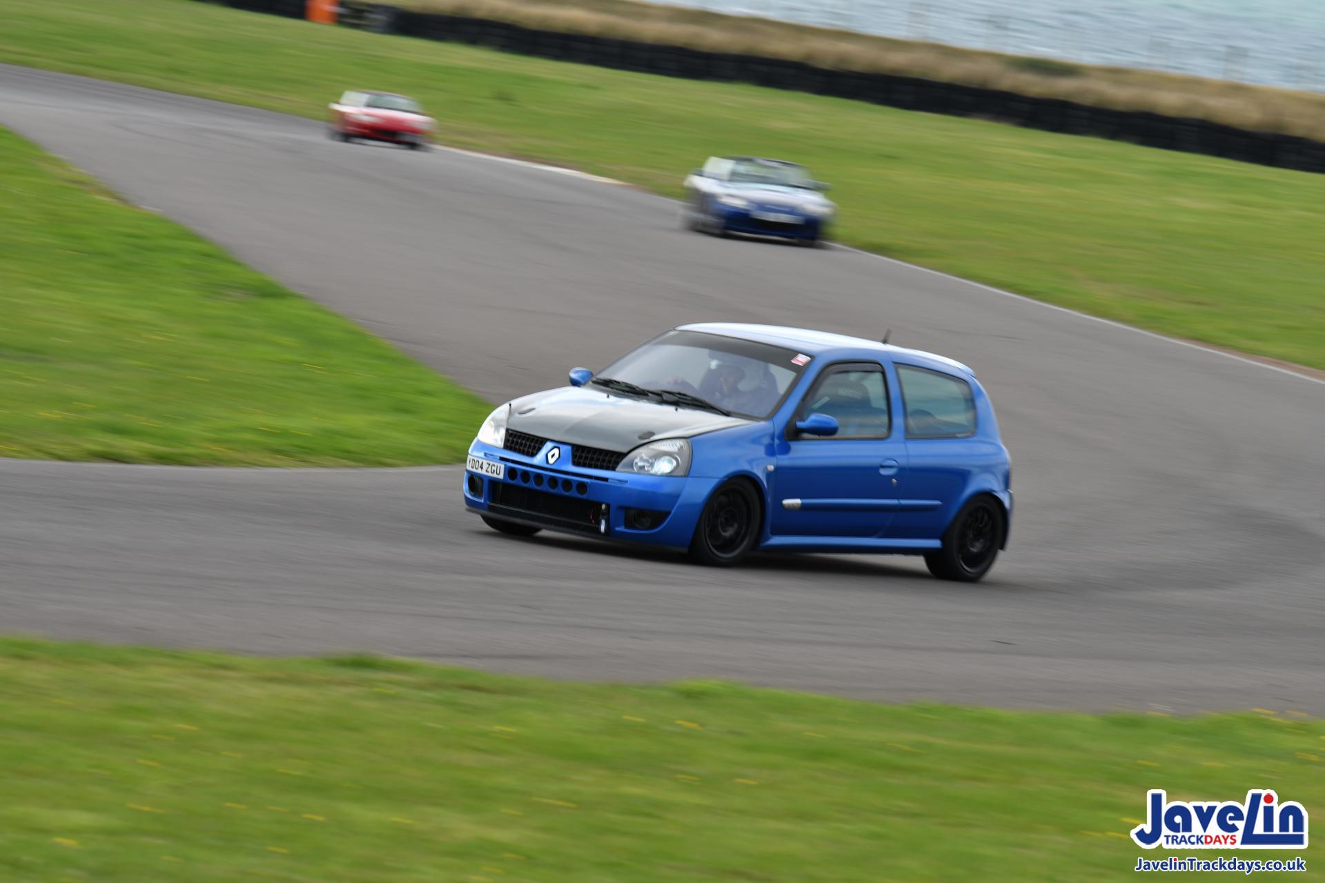

First track day with the new engine- just took it easy to bed everything in, but a good test and felt great.
First time at Anglesey- awesome track, pretty tricky little circuit too with lots of “in between 2-3 gear” corners. The costal circuit was awesome fun - look forward to coming back another day.
hell of a view of the coast too!

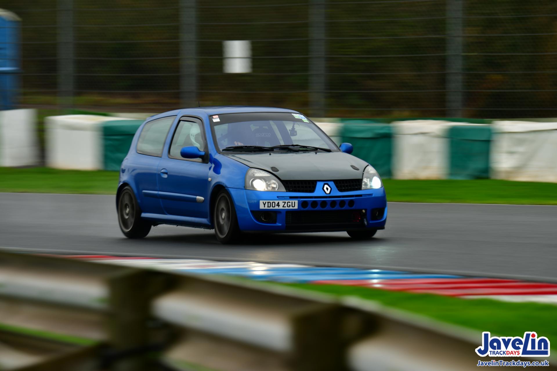

Managed to squeeze in one last track day of the year at a wet Mallory Park. Was a bit interesting in the weather, but great fun.
New engine is working really well now, not burning oil and seems to be freeing up and healthy. Need to do a little work on the suspension set up, maybe get it corner weighted

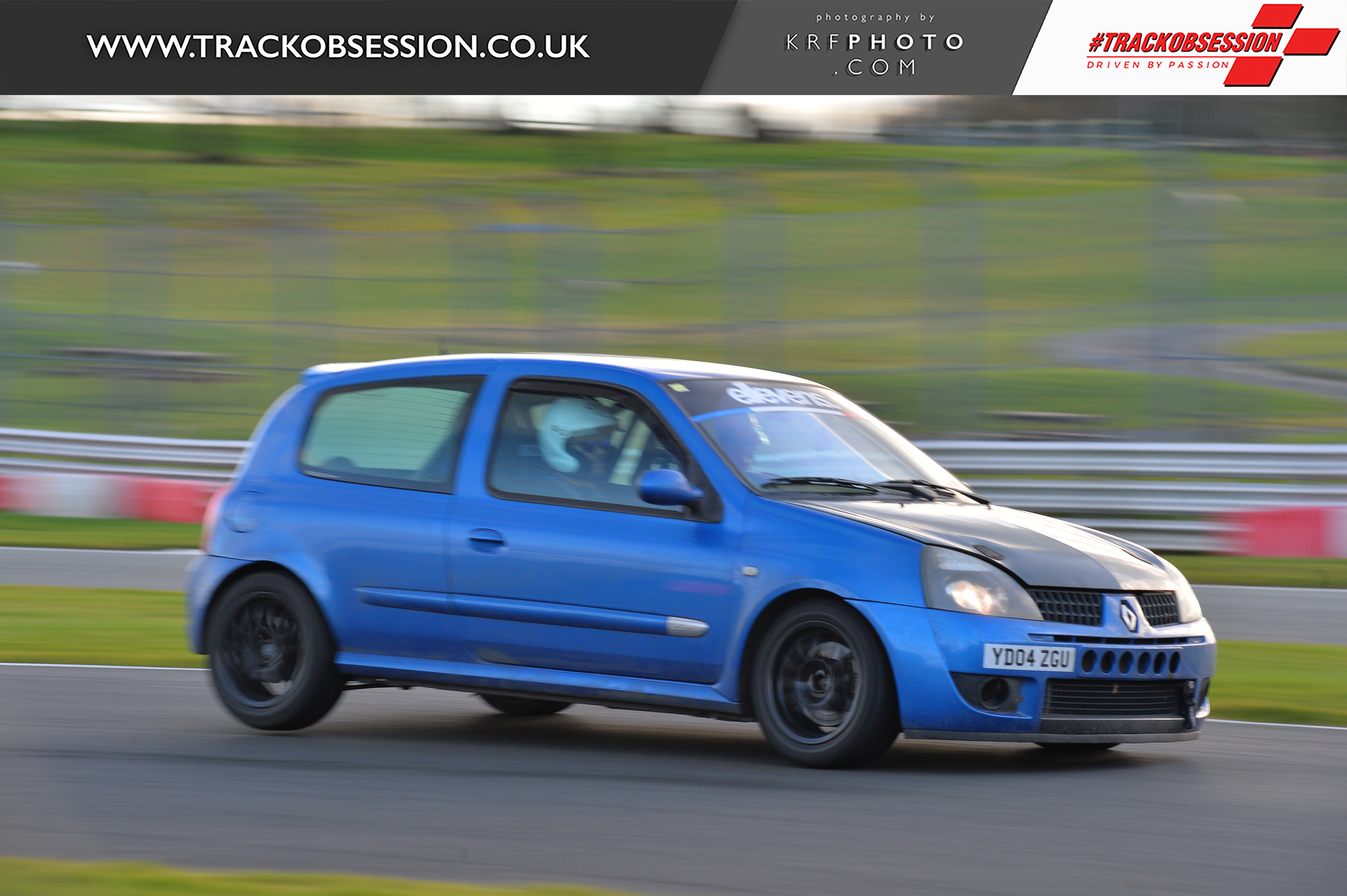

First day since setting up the car with String Theory, he’ll of a difference at Donington Park. Greasy conditions in the morning but when it dried out it was awesome, turns in well, rotates and really controllable and predictable, got rid of that “snap” feeling. Through McLeans it was insane!
loving the car right now!

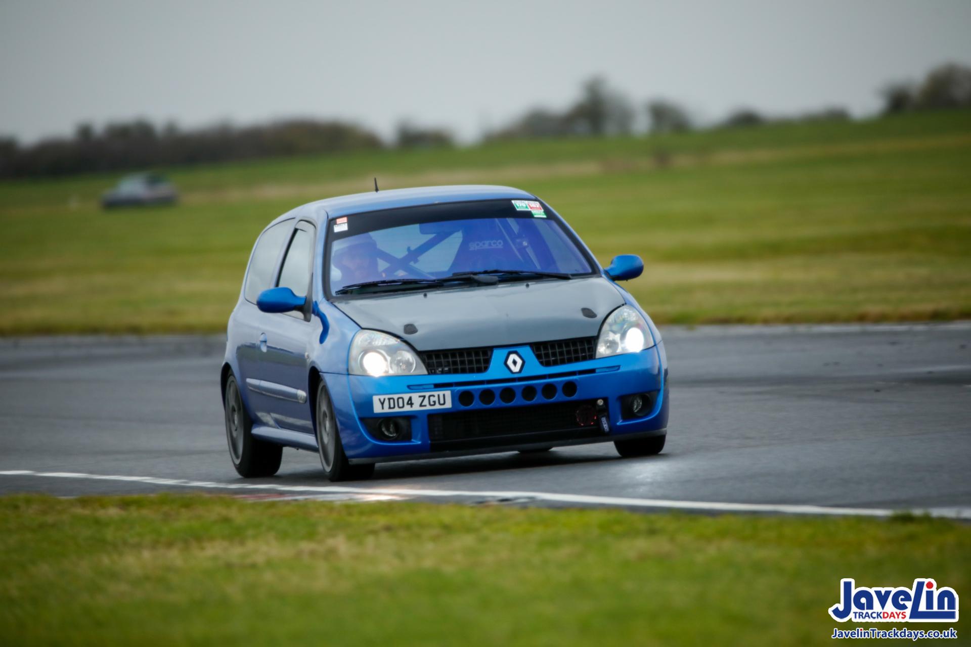

Absolutely sensational on track at Oulton Park. Cold/ damp in the morning but dried out and all the changes made saw a whopping 3 seconds loped off the best time on a cold track with a dirty line of oil dumped by a Audi TT that I took it easy on (approximately a 2:07- not race car fast, but I’m happy enough as it felt fun and pretty easy to consistently lap that pace). Video of a few traffic filled laps
first time I’ve seen a photo of it cocking A wheel

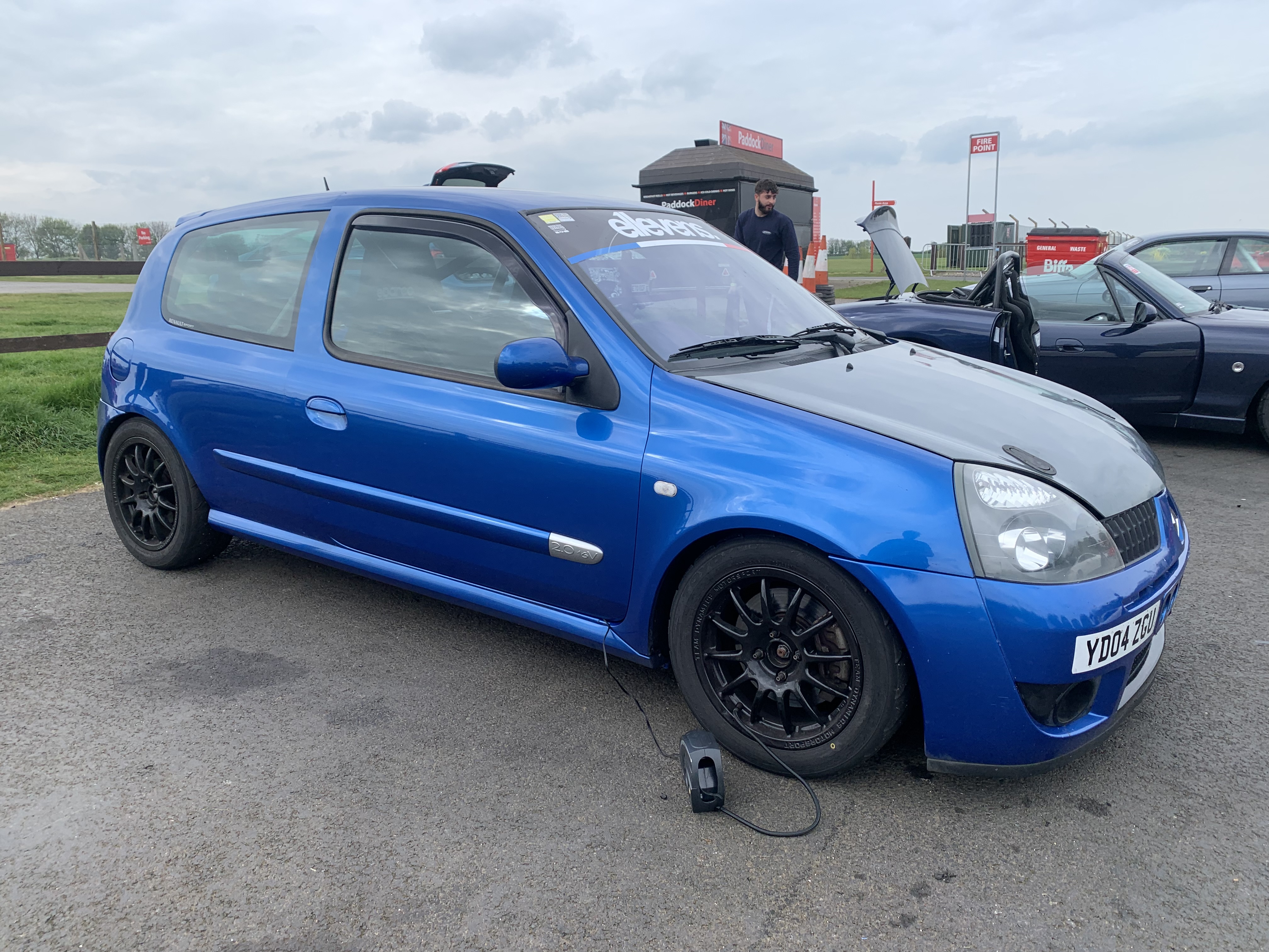

Saturday Club at my mates garage. A quick check over ahead of Oulton Park on Friday. Changed the brake fluid (Motul 600) and full brake bleed.
Checked the discs and pads to make sure there was plenty left and a few tweeks to the exhaust as it was tapping on the rear beam at high revs.

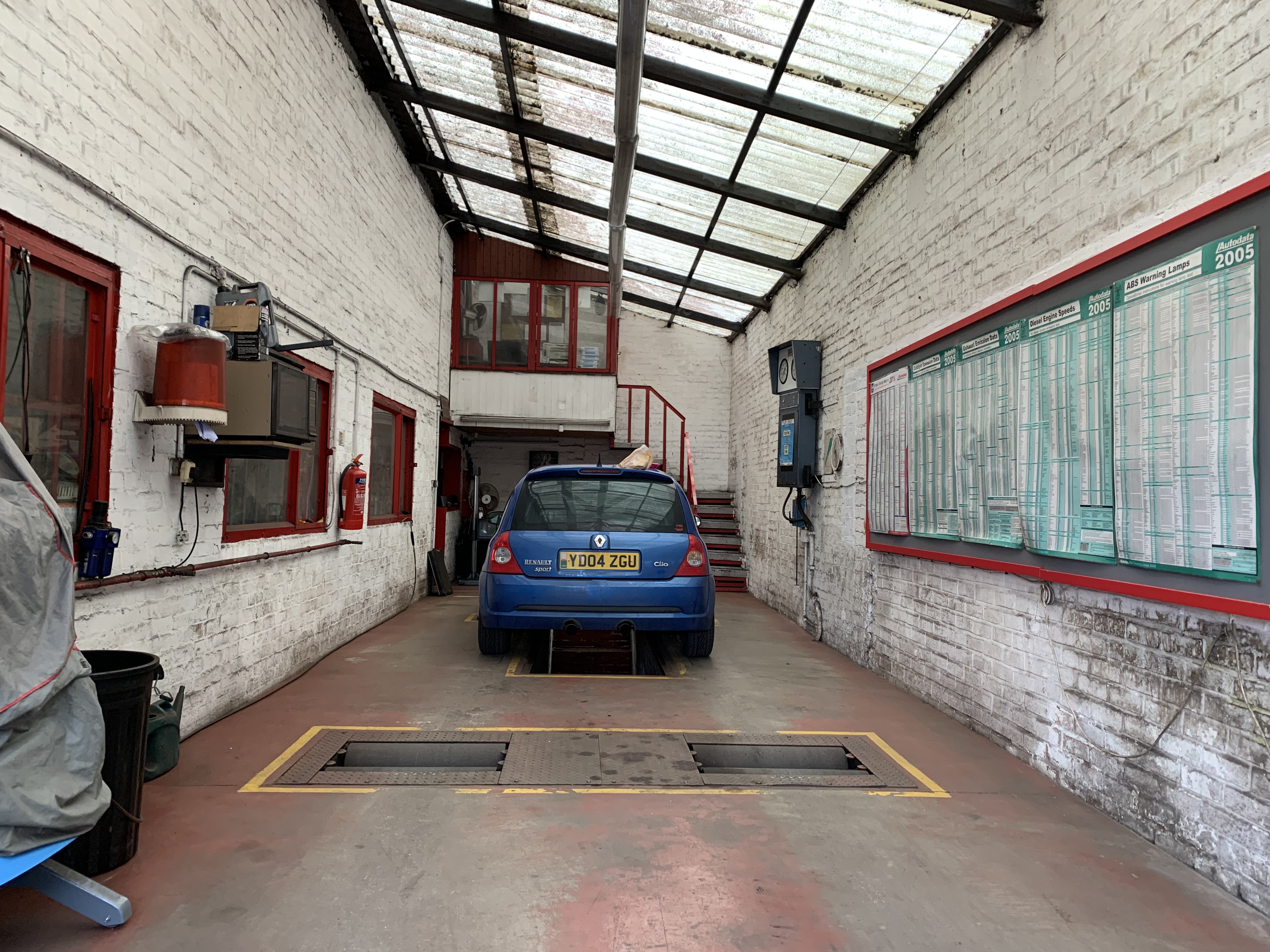

MOT is booked too. When it’s back it needs a good clean too!!

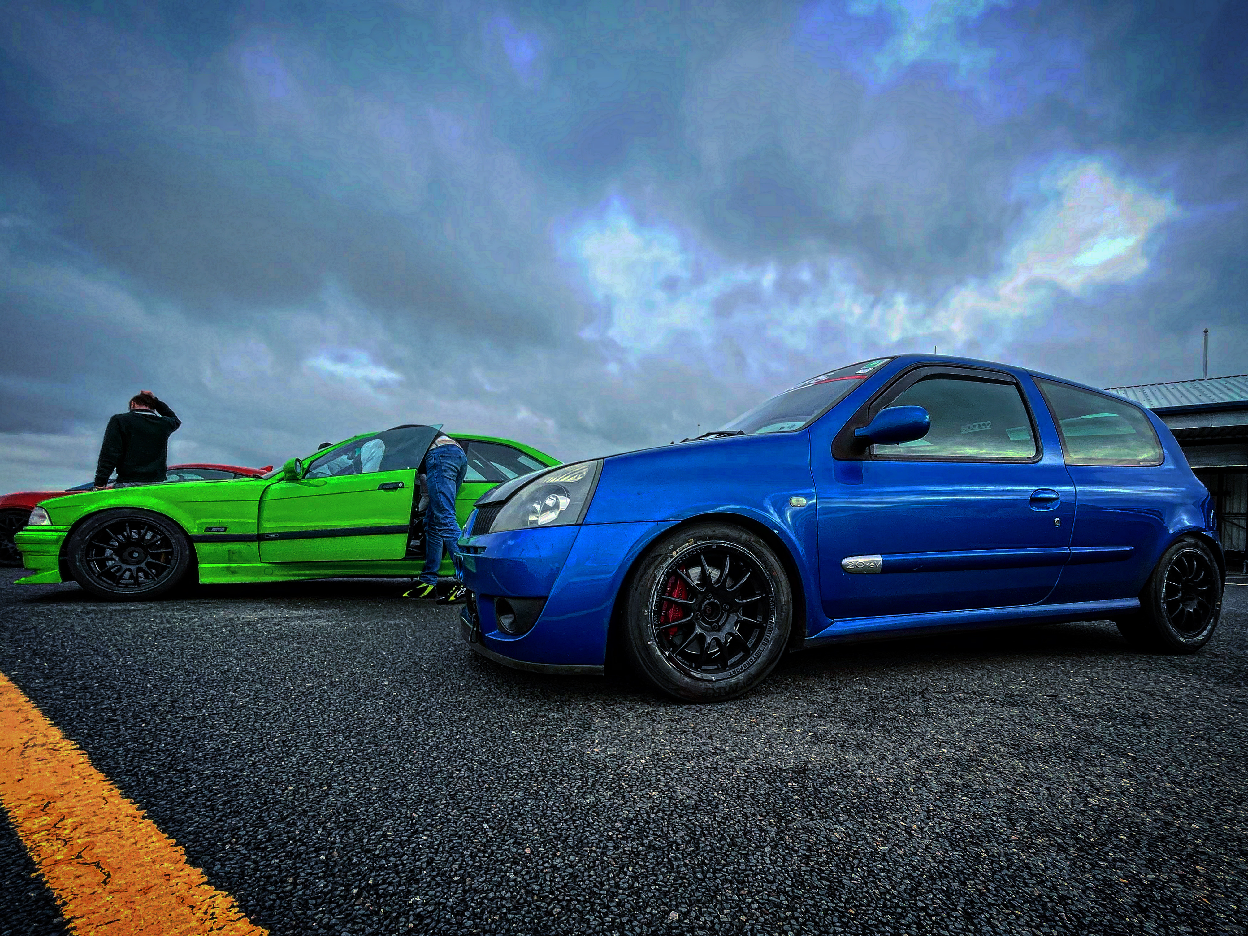

Fun day at Cadwell Park, load of red flags for some reason, but track was mint and Clio was sensational.
got to drive my mates big M3 too, totally different to the Clio with so much torque and power! great fun to experience, but love the Clio!

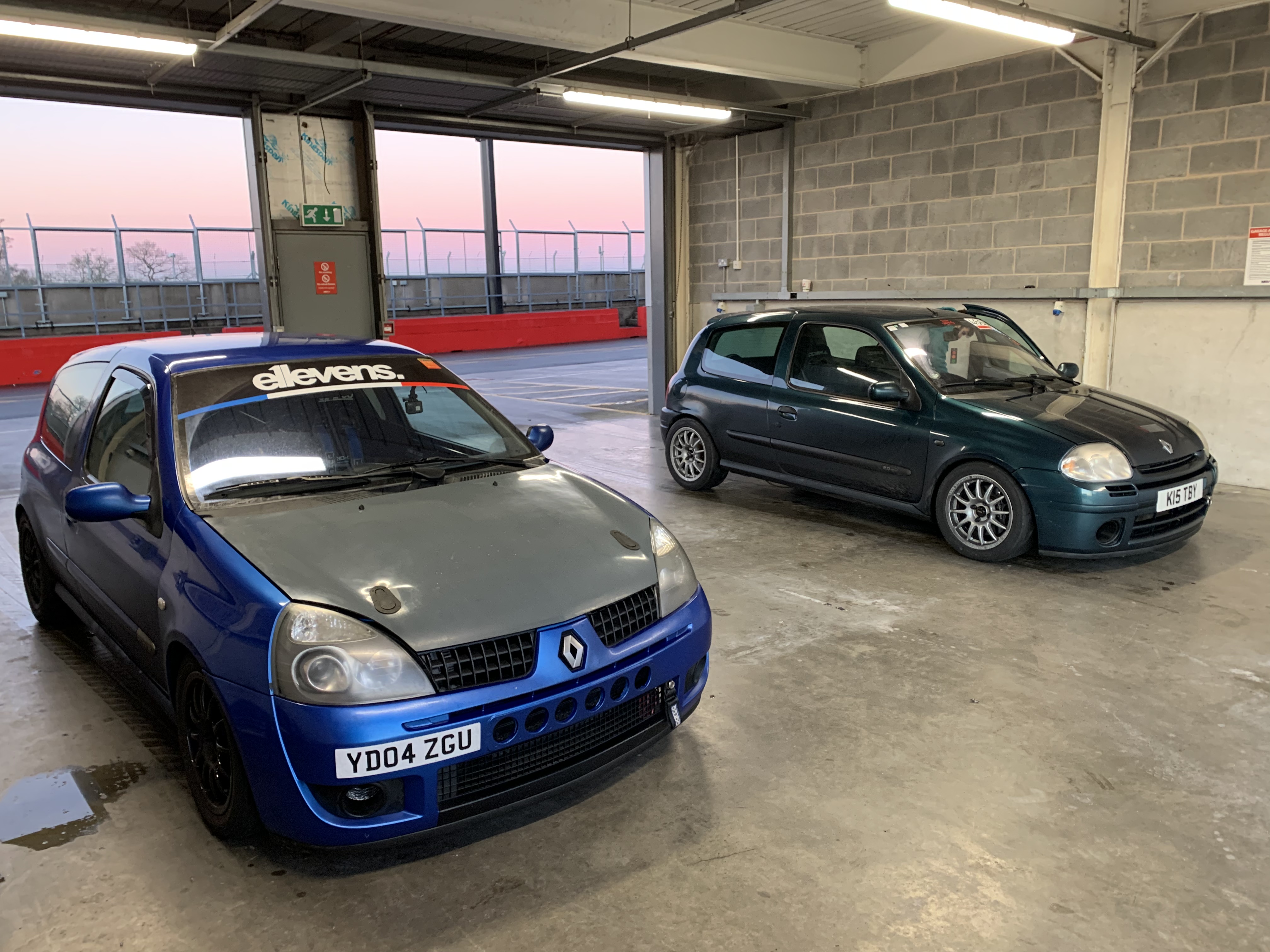

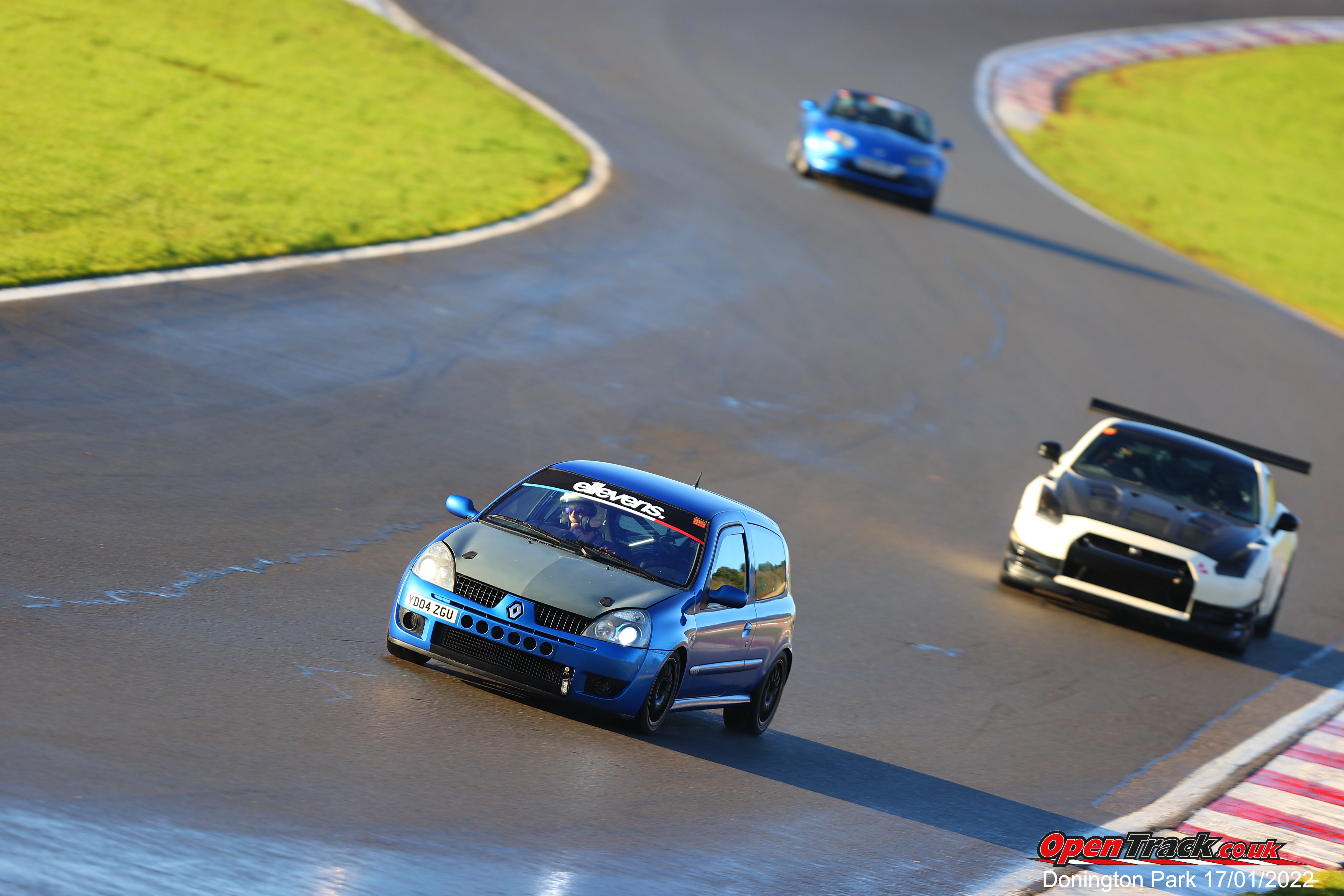

Done a couple of evenings at Donington Park recently, absolutely loved it!
when we first went to Donington a few year back, I just didn’t really enjoy the circuit- too fast and too many high power “race cars”. But with the improvements to the handling, can’t get enough of trying to find the flow of the circuit. On the fake LapTimer on the phone, says I’ve knocked over 5 seconds a lap off to a mid-1.25 (still a fair bit of safety margin in there as I need to drive home!)
Recently I’ve switched the front tyres to 205-55 width and maybe it’s a placebo but seems to help with the mid-late corner understeer (I’ve no LSD). Look forward to going back to Cadwell and Oulton Park to see how it is there. Also fitted new Feroda Ds1.11 front pads (last ones lasted really well and felt good enough for me).
Trying to keep up with a Porsche GT4 and a BMW M2 in the first play session of the night:

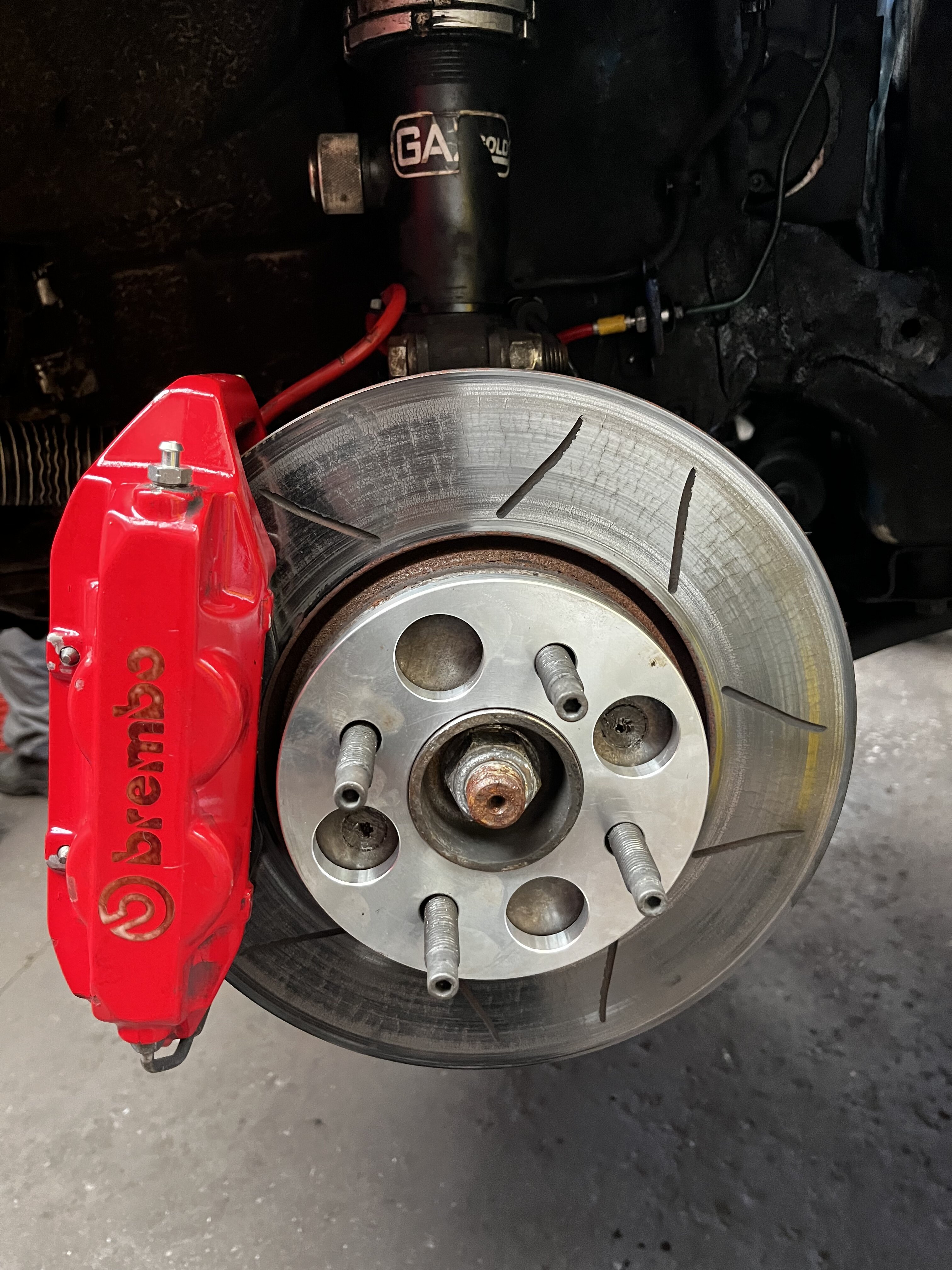

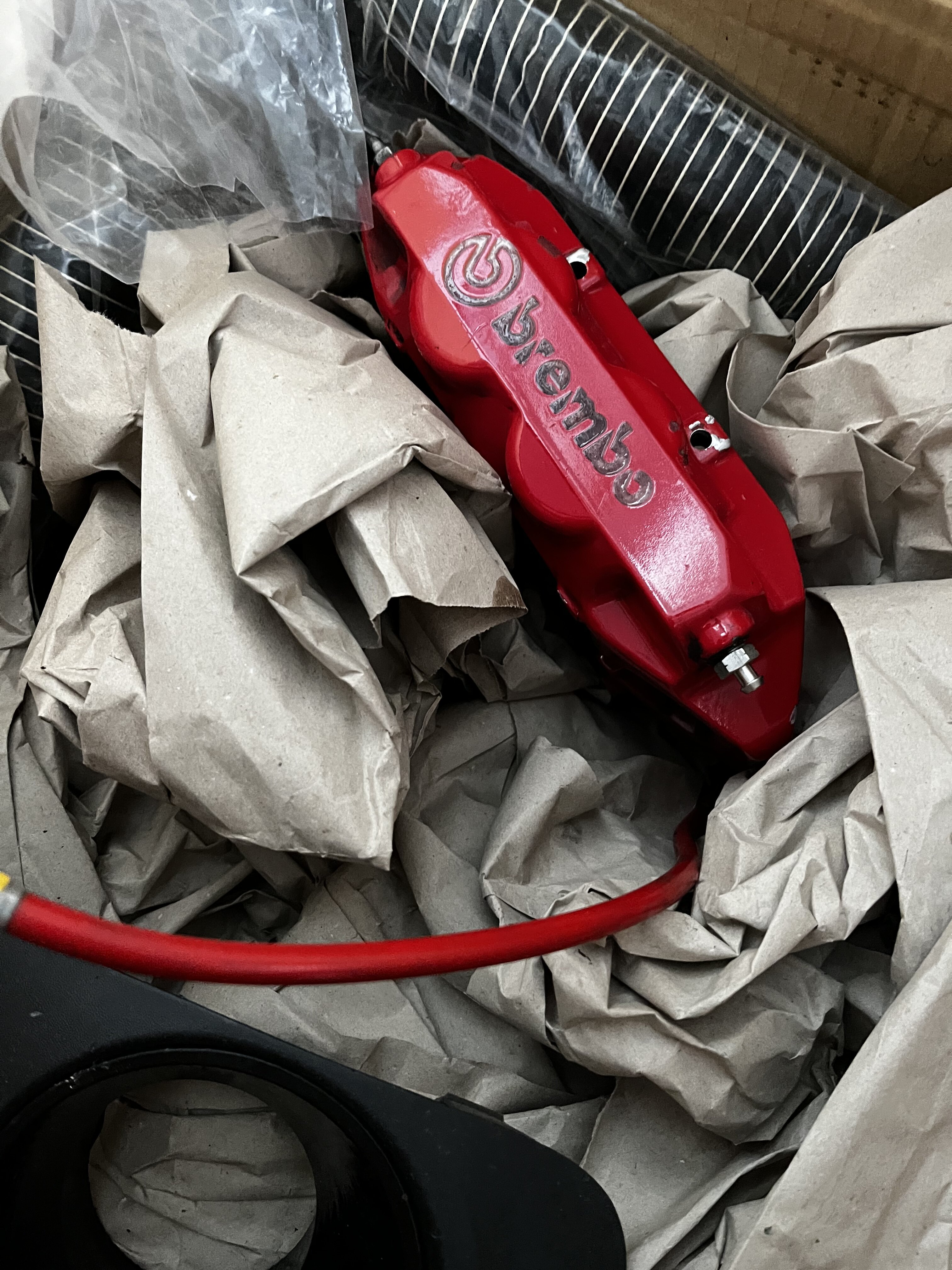

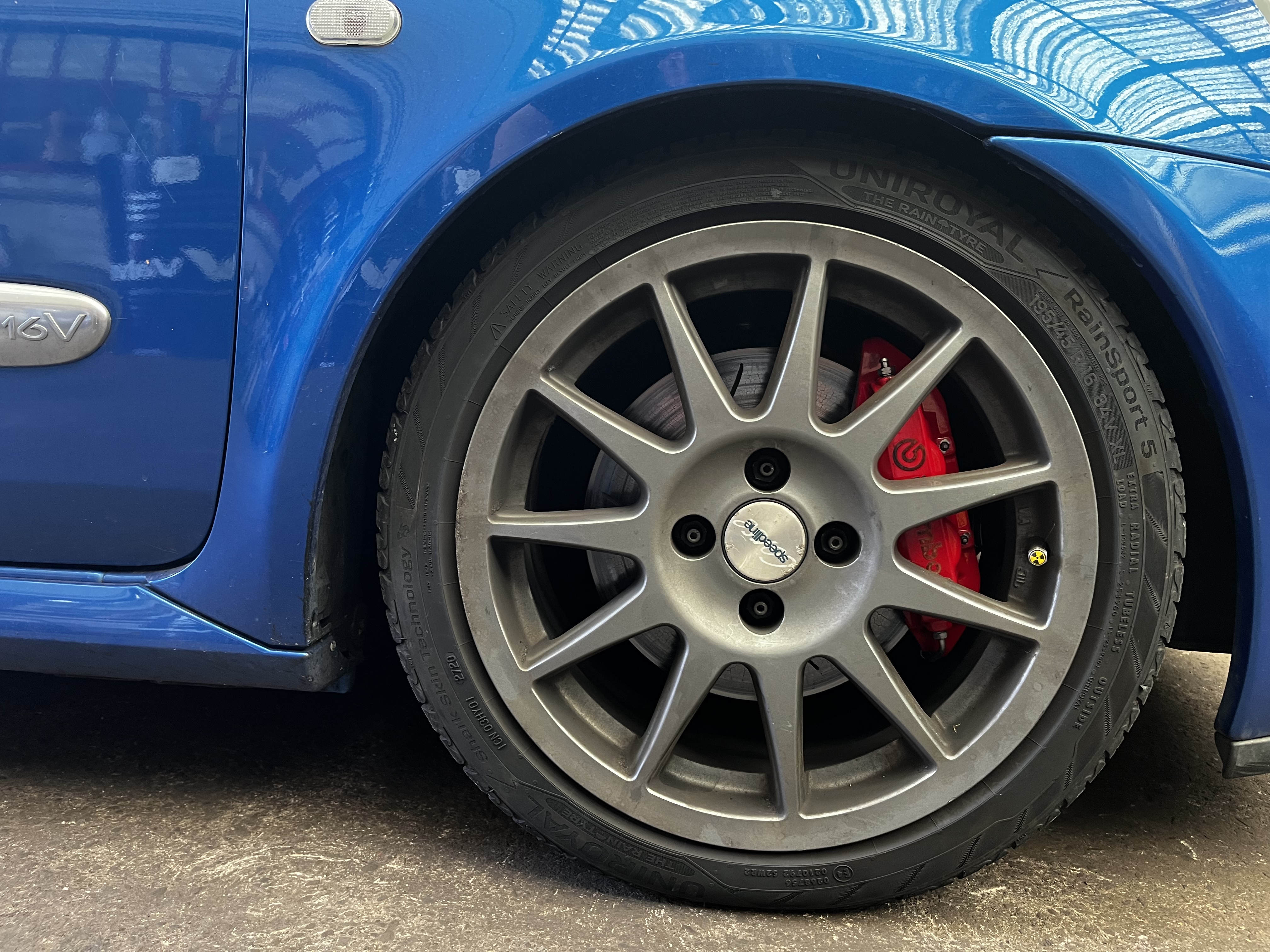

New Brembo’s fitted today. Taken the 182 for a quick spin on the road and they work. Will see if they make much difference come the next track outing.
FITTED with a fresh set of Ferodo DS1.11 pads and Motul fluid RBF 600 fluid
To help clear the wheels on my 15”fitted a 10mm Pure Motorsport Wheel spacer.

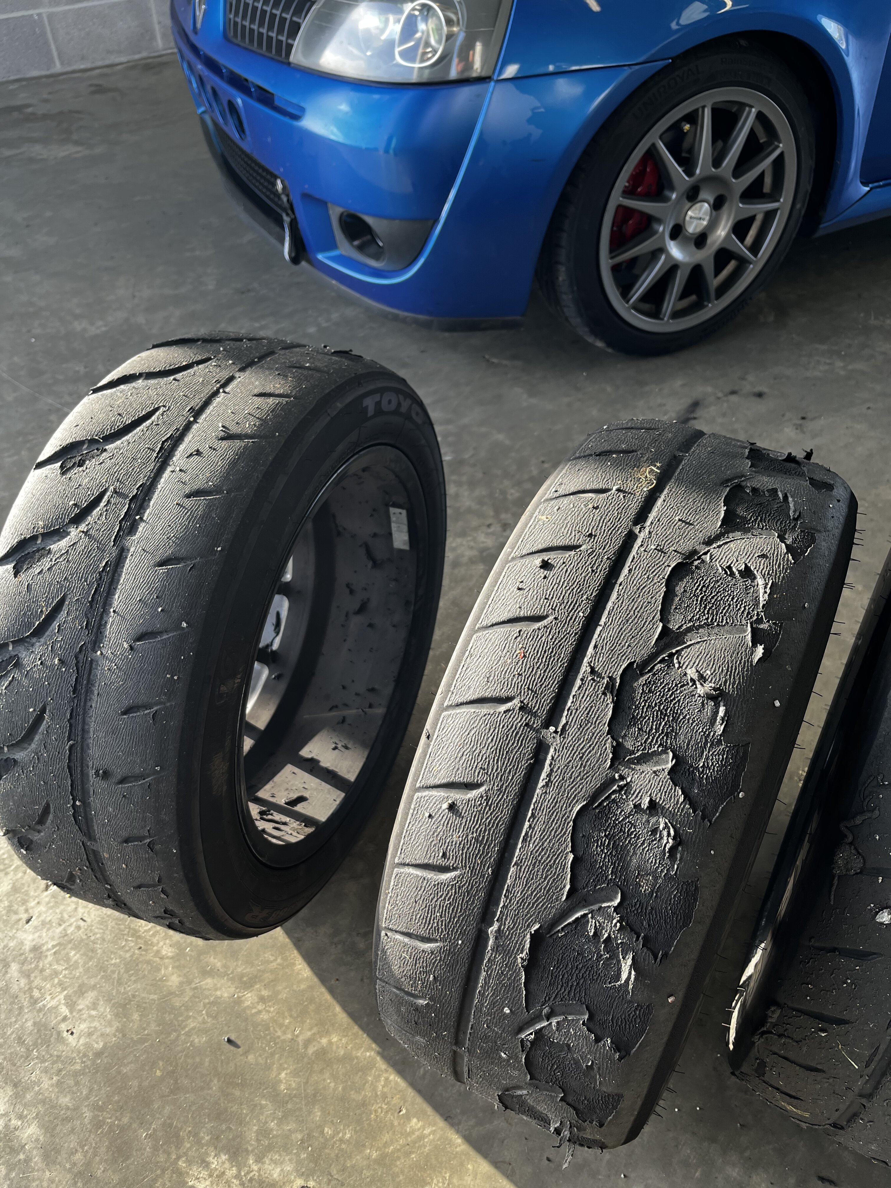

Rad fun until I checked my fronts and found them roached!
Bought some new tyres as I fancied a change from the R888.

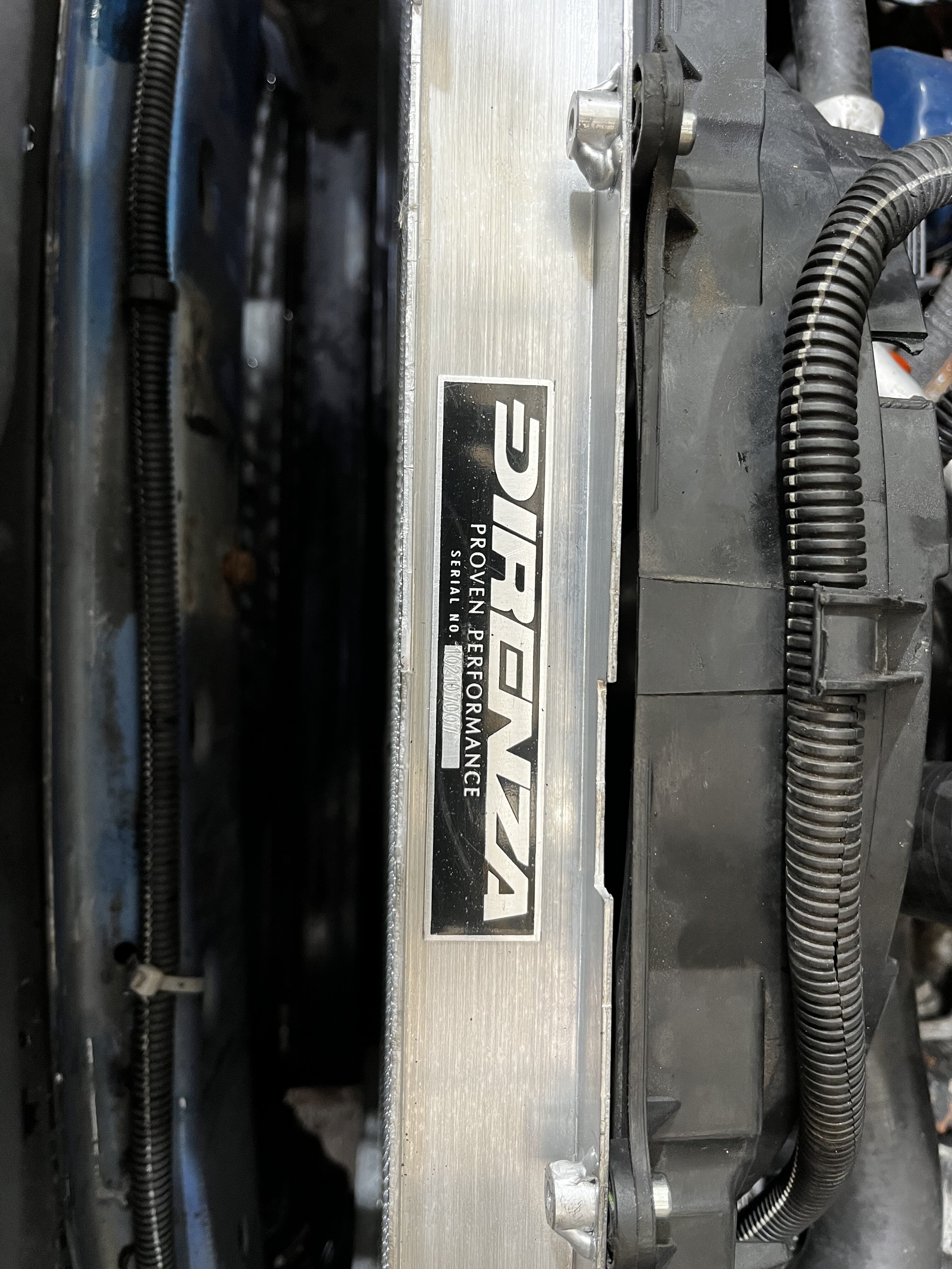

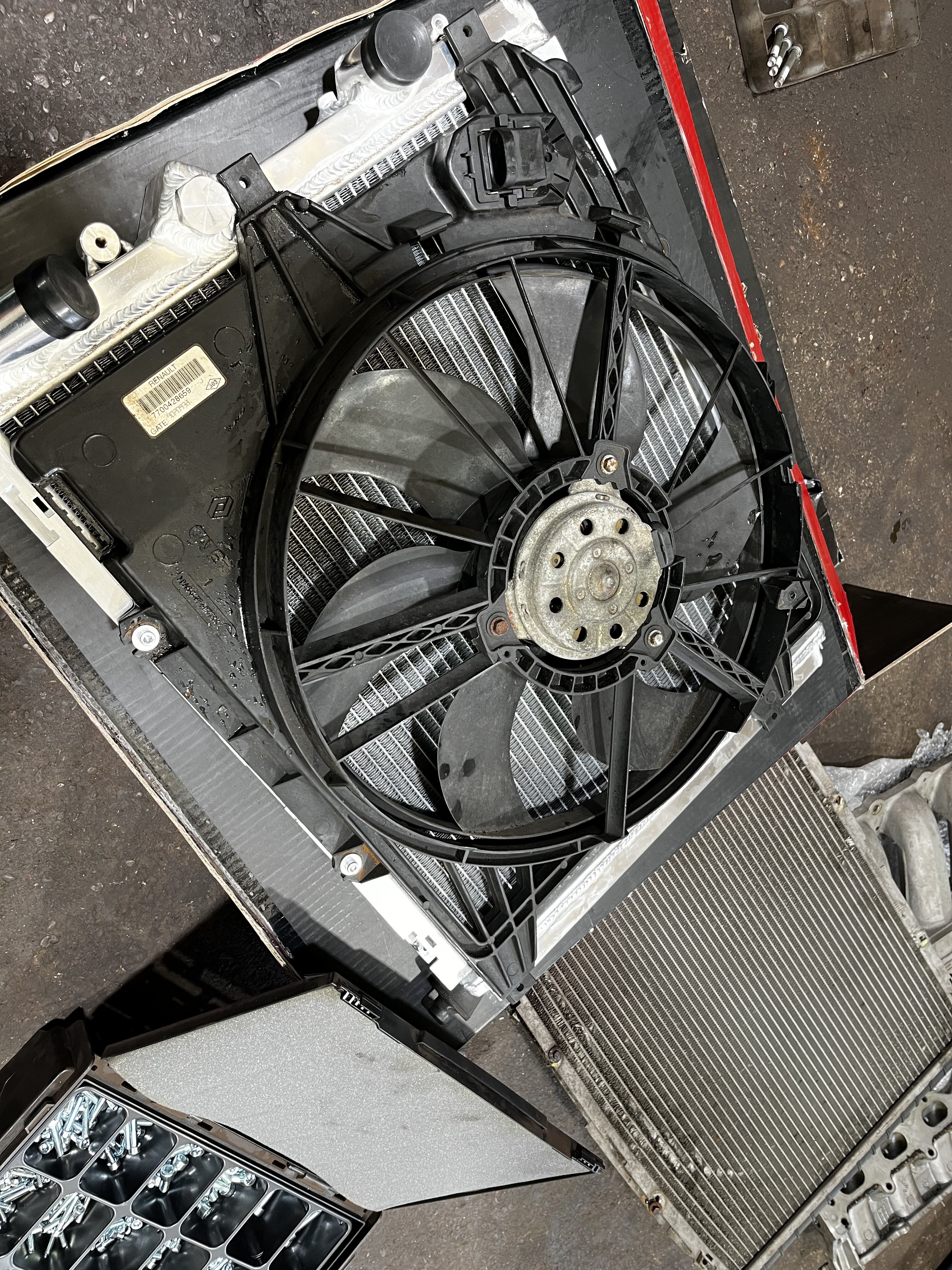

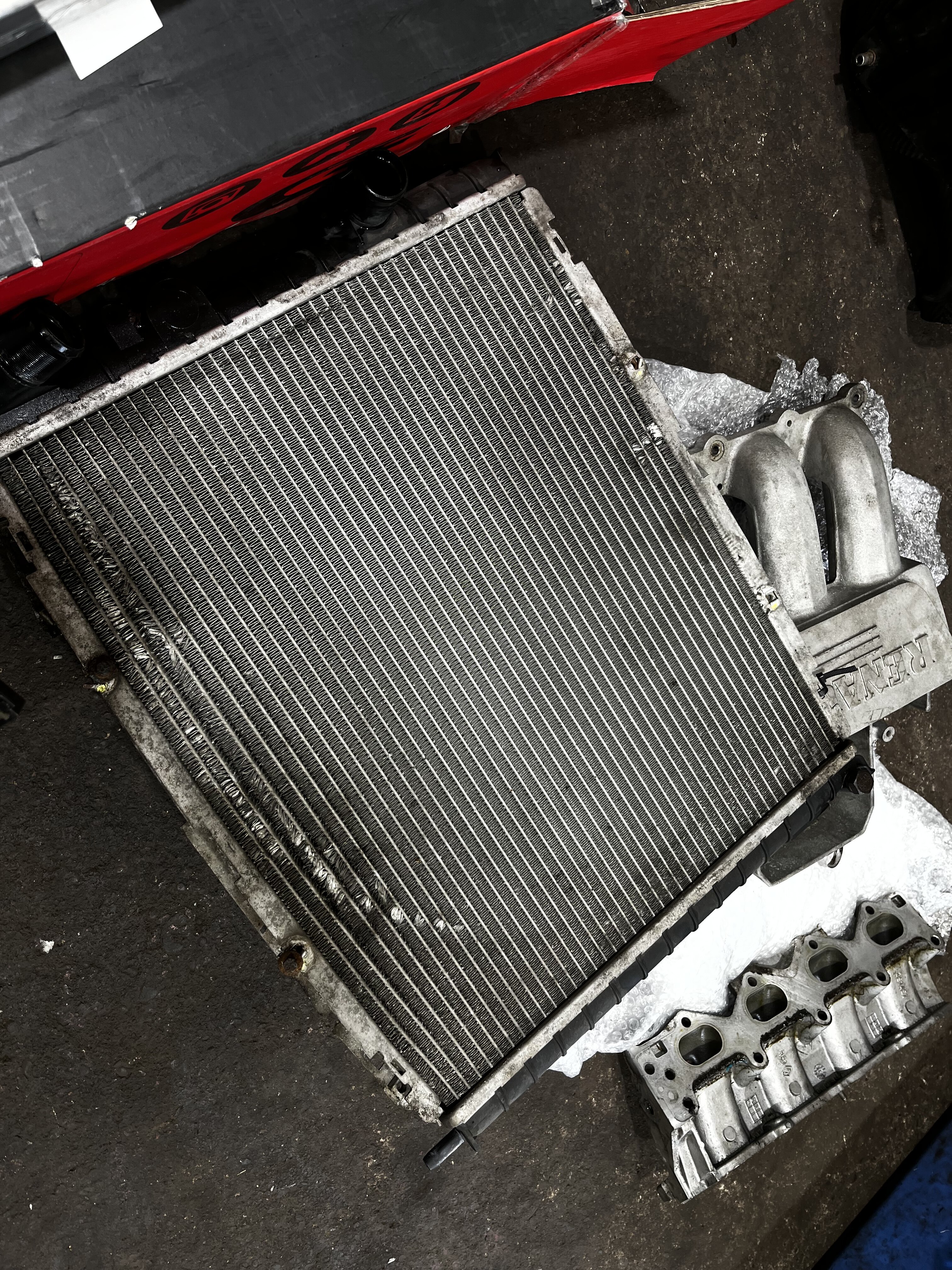

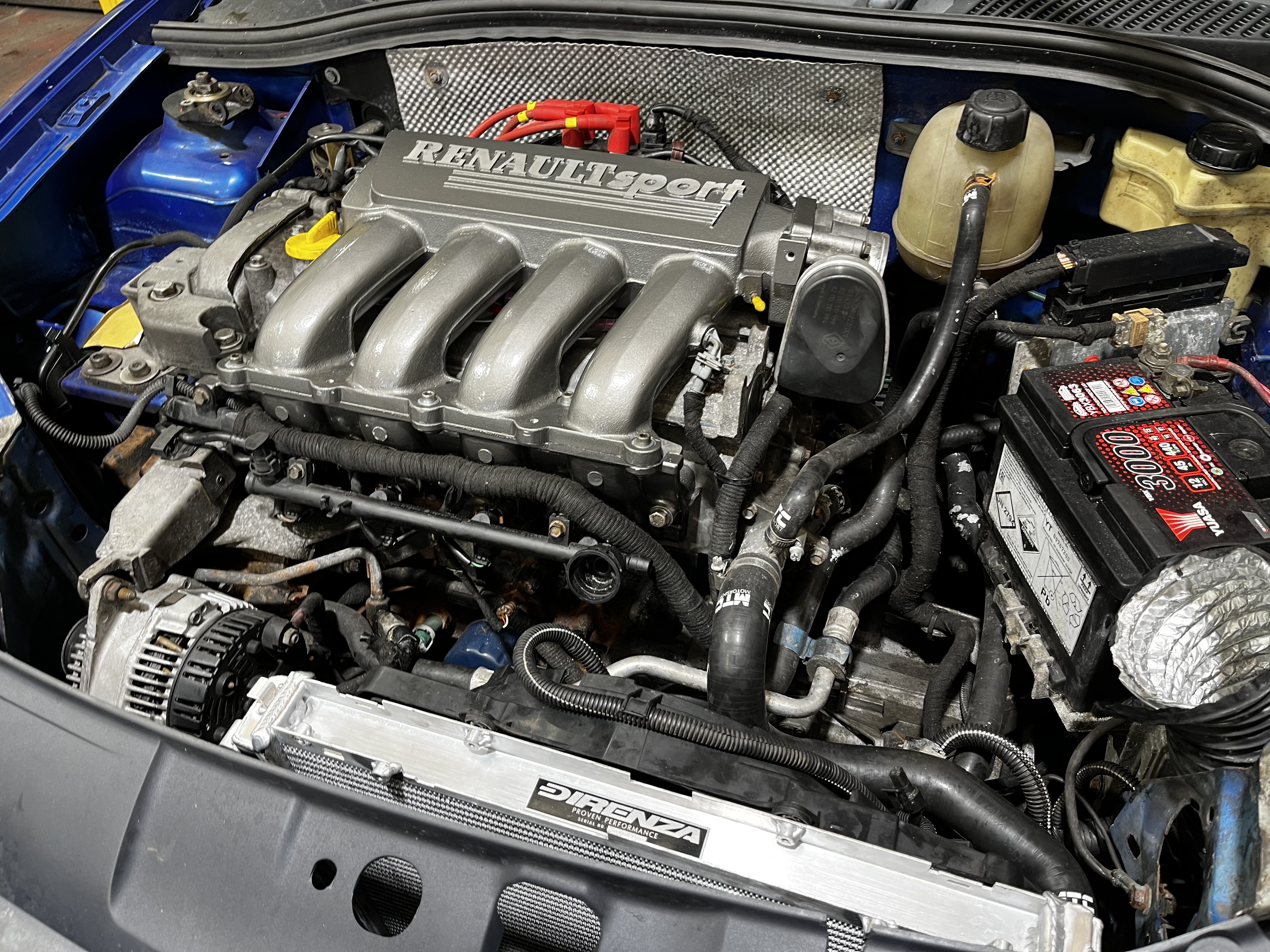

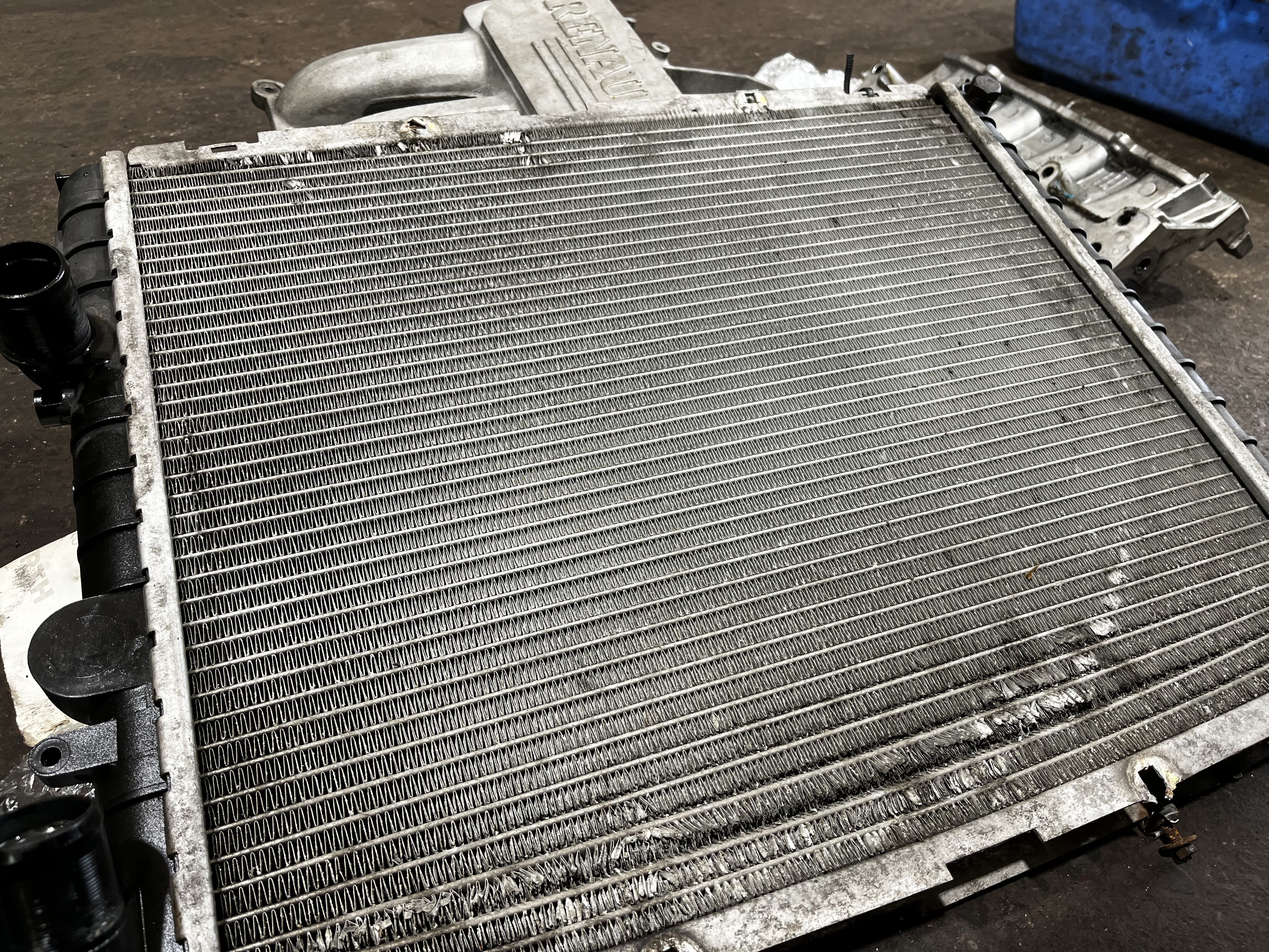

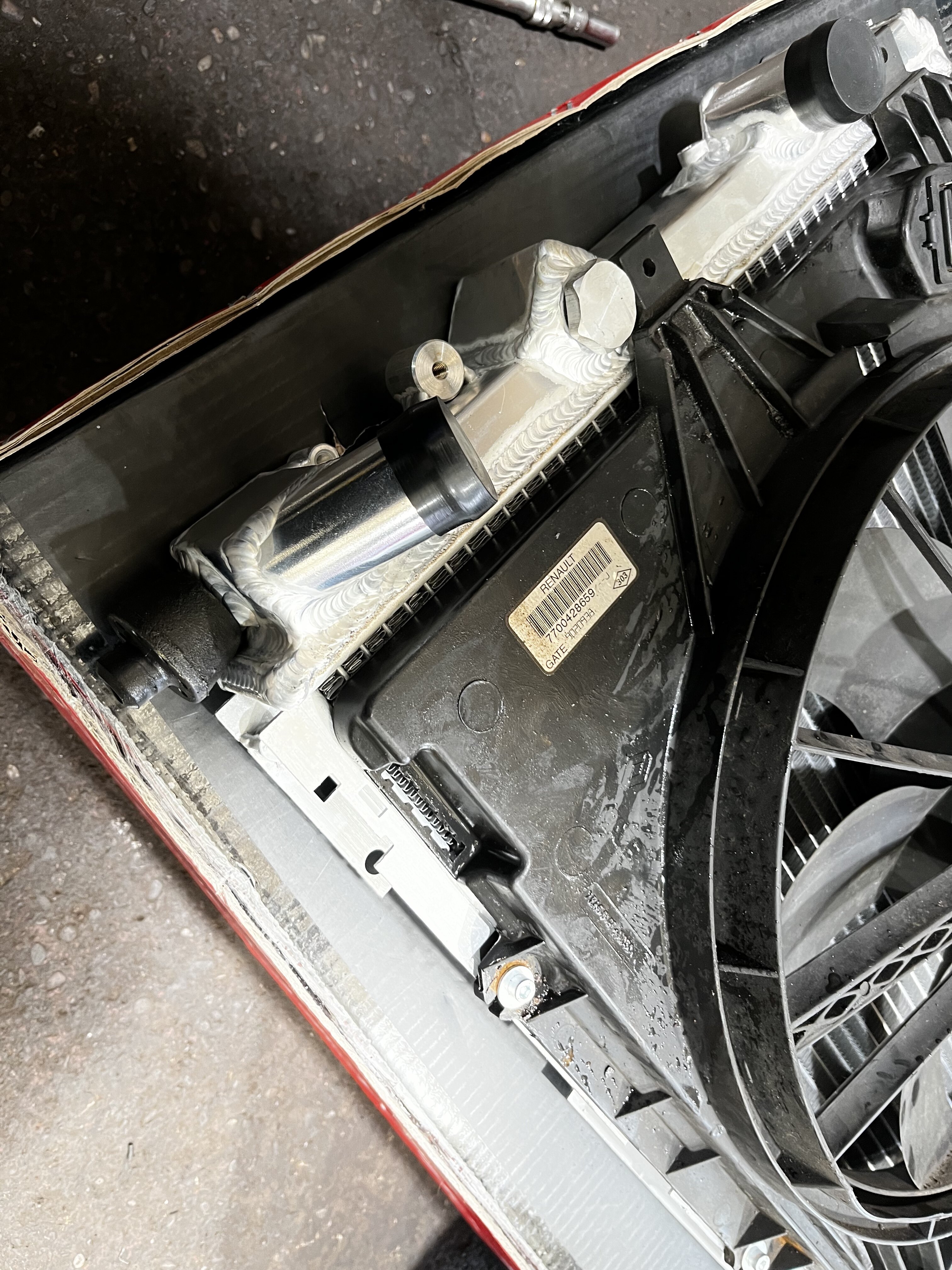

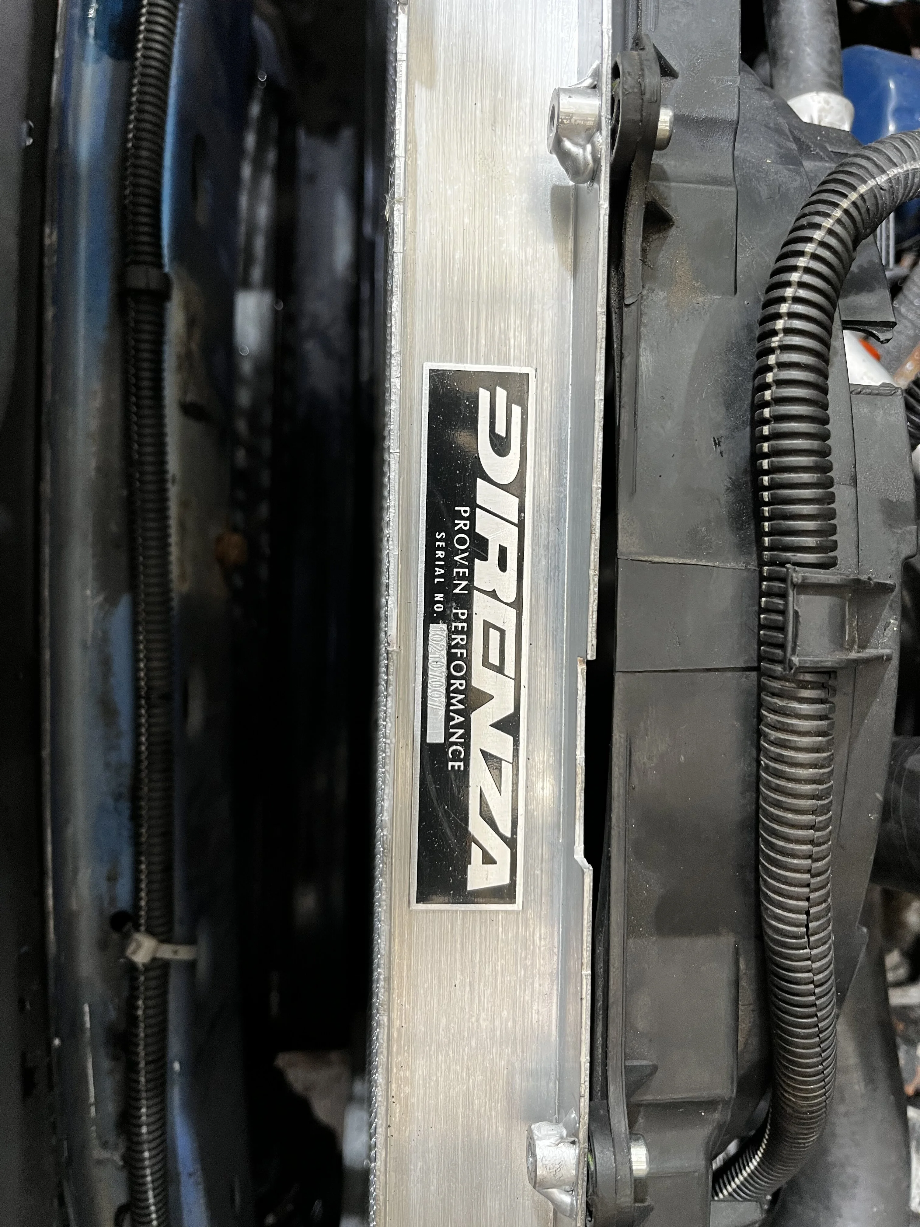

The time had come to replace the old OEM radiator. We noticed it’s started to bow and the fins deteriorate.
Any excuse really to buy and fit this beautiful Direnza radiator. The finish is first class and it mated to the OEM radiator with ease. Really tidy, just gutted that it gets hidden.
Also took the chance to fit this port and polished inlet manifold, bought from @avstar1
Really nice quality piece from MS engineering, now matches the ported inlets on the head (if that makes a difference?!).
The finish tidy’s up the engine bay a little too. Slam pannel in and fitted back together

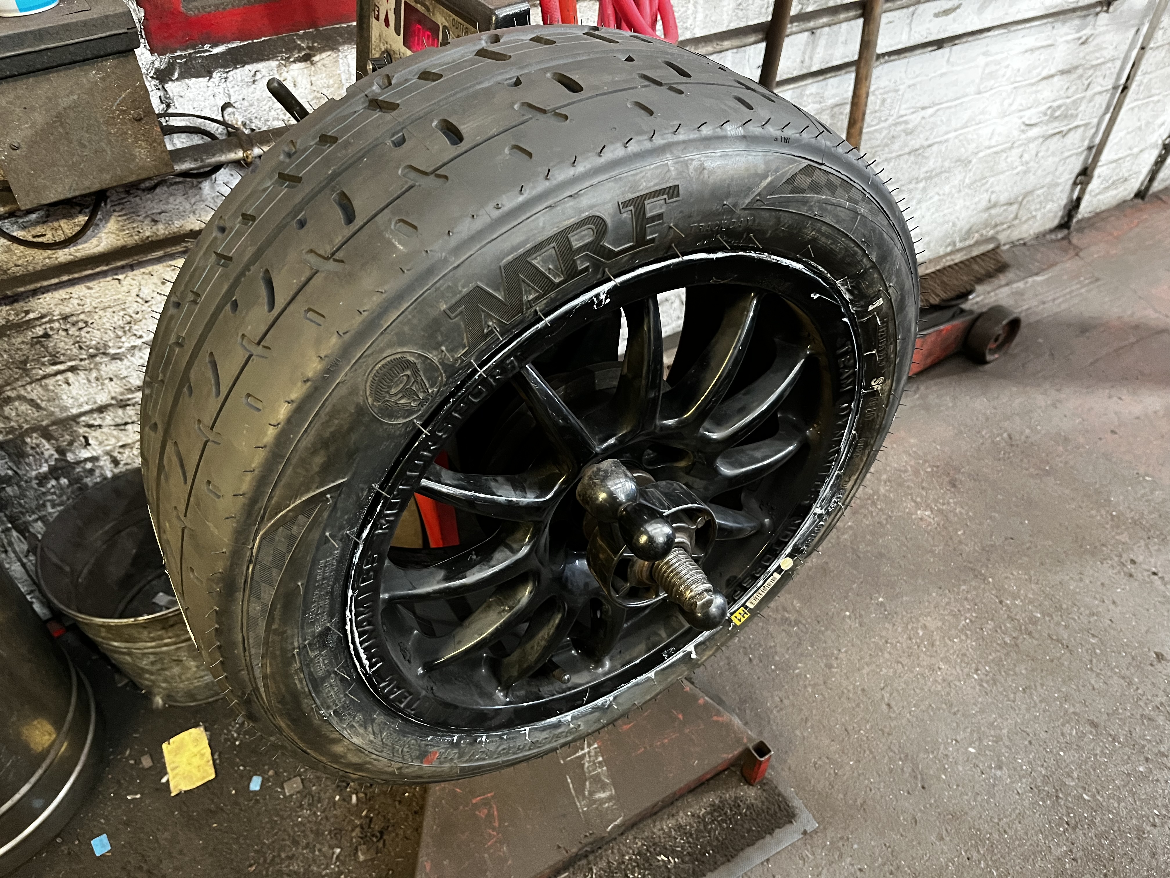

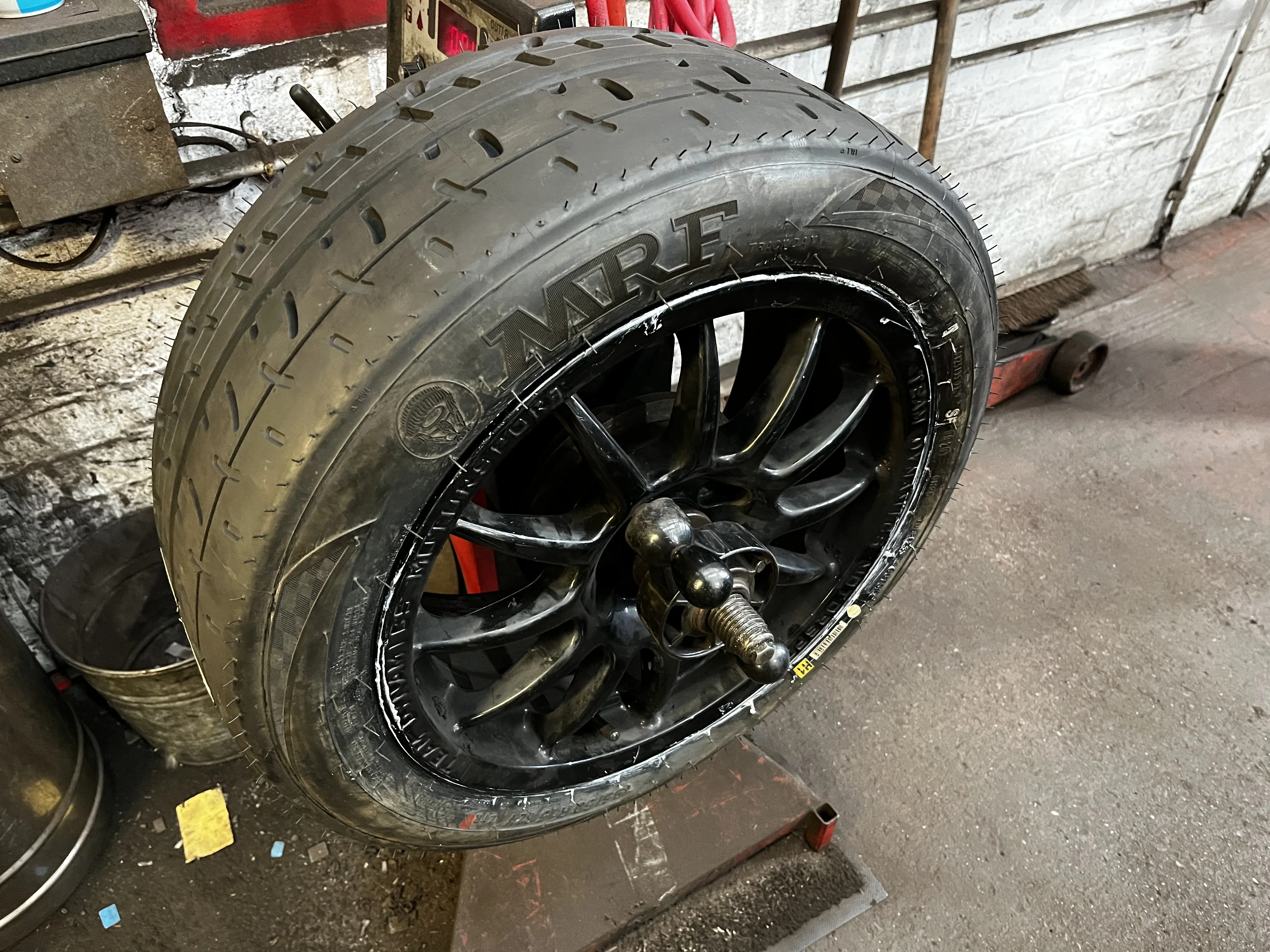

Last job of today, After writing off the Toyo R888, time to fit some fresh rubber too. This time thought I would try a set of MRF ZTR in Hard compound.
Not been for a long drive, but pick up seems a little quicker- may just be a placebo effect of enjoying some tinkering? Waiting on a few more parts in the post and then chatting with Matt if we get the Clio on a diet over the winter. Strip out the un used wiring and some of the sound deadening (want to keep some as I’m old and still want to drive to the Nurburgring next year).

Monday saw the latest track adventure to Bedford. Lucked out with the weather, damp in the morning, but dried out nicely through the day.
Great test for the MRF tyres, can say I’m really impressed. Grip was comparable to the old r888, but the consistency is really good, they didn’t fall off on longer runs.

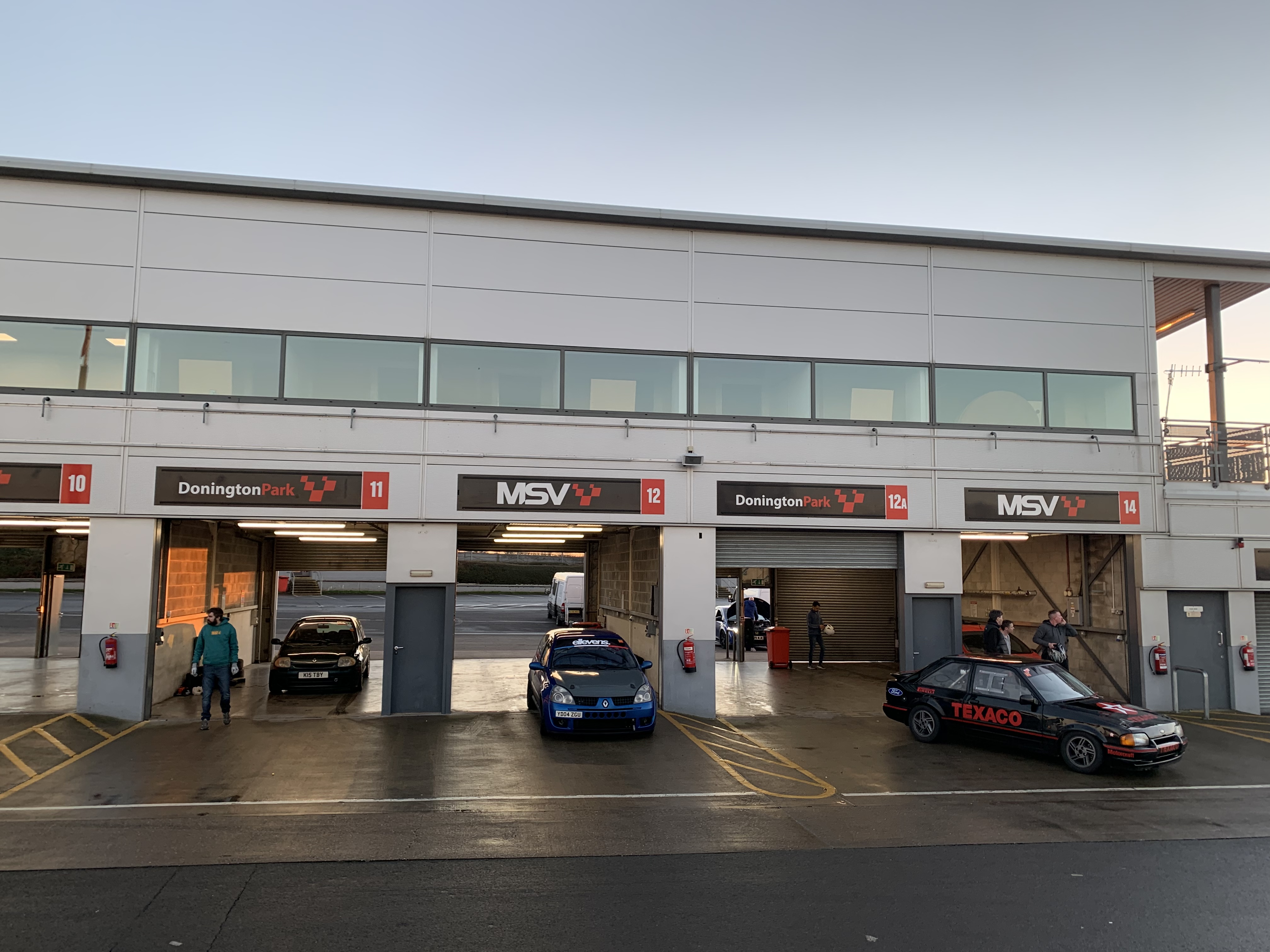

Next up is Oulton Park next Friday, hopefully something else to try- not sur wit will do anything (was just interested to try it)
May start to save the pennies for a LSD next I think, just can’t face fitting it for now.
