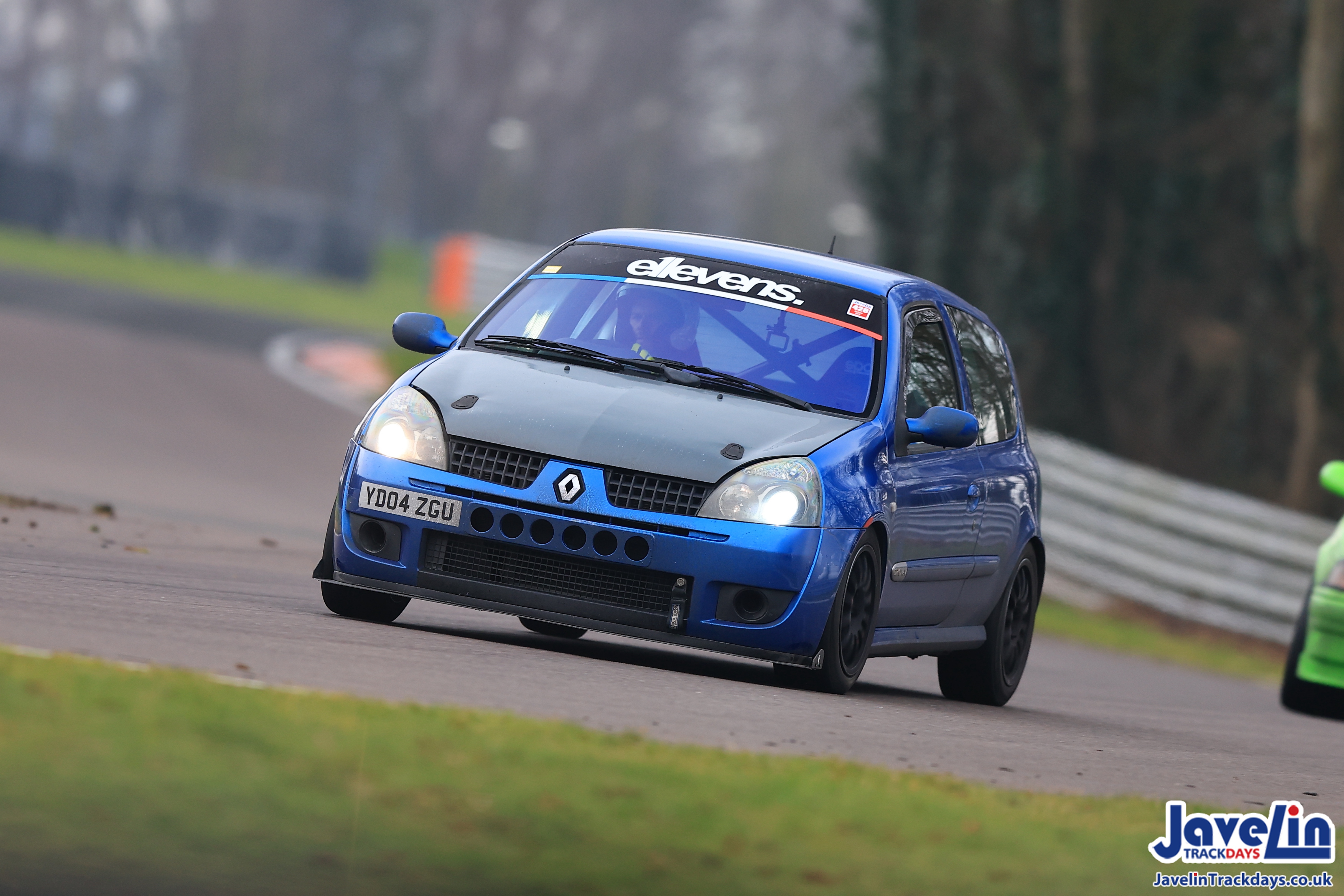

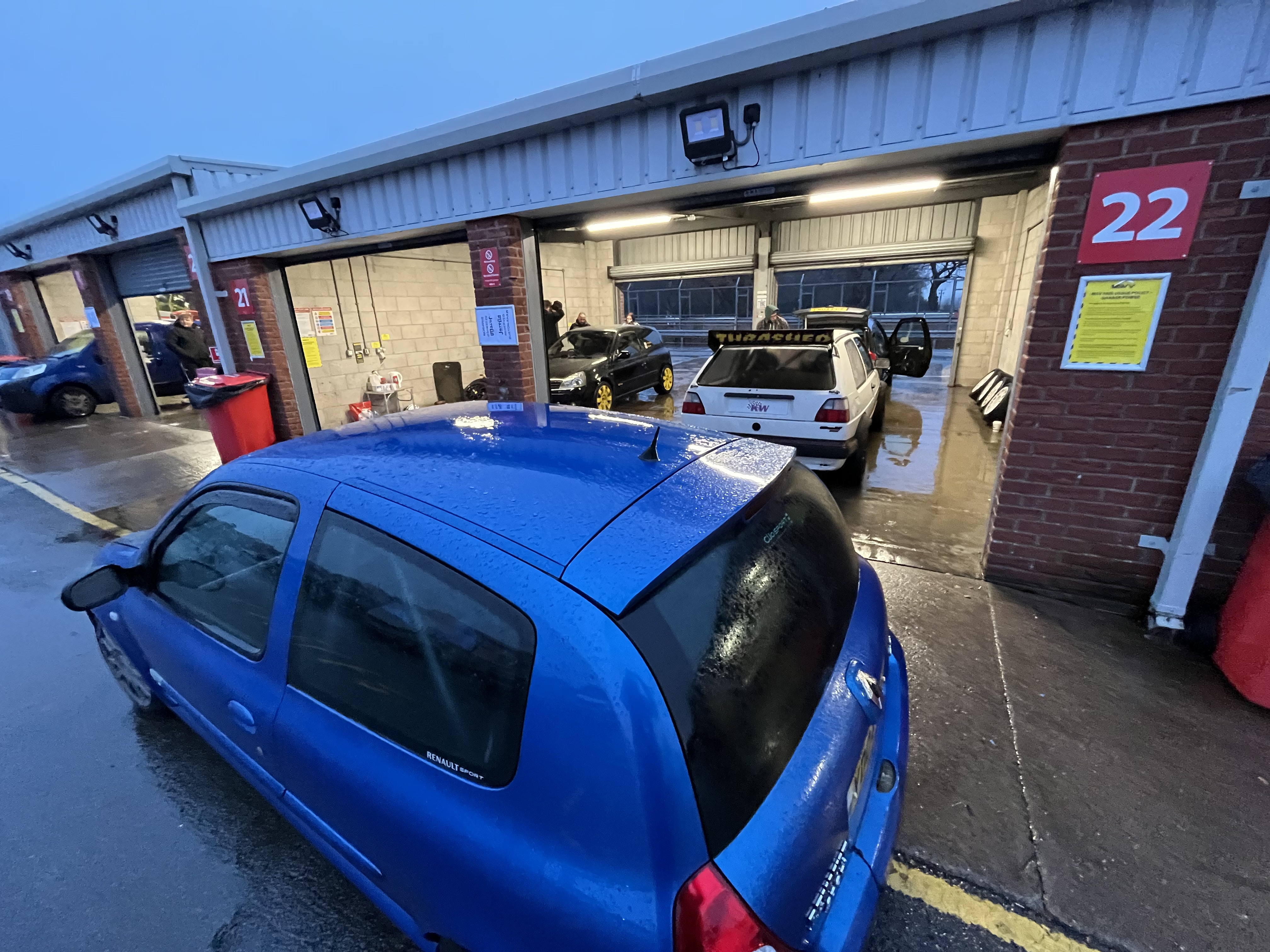

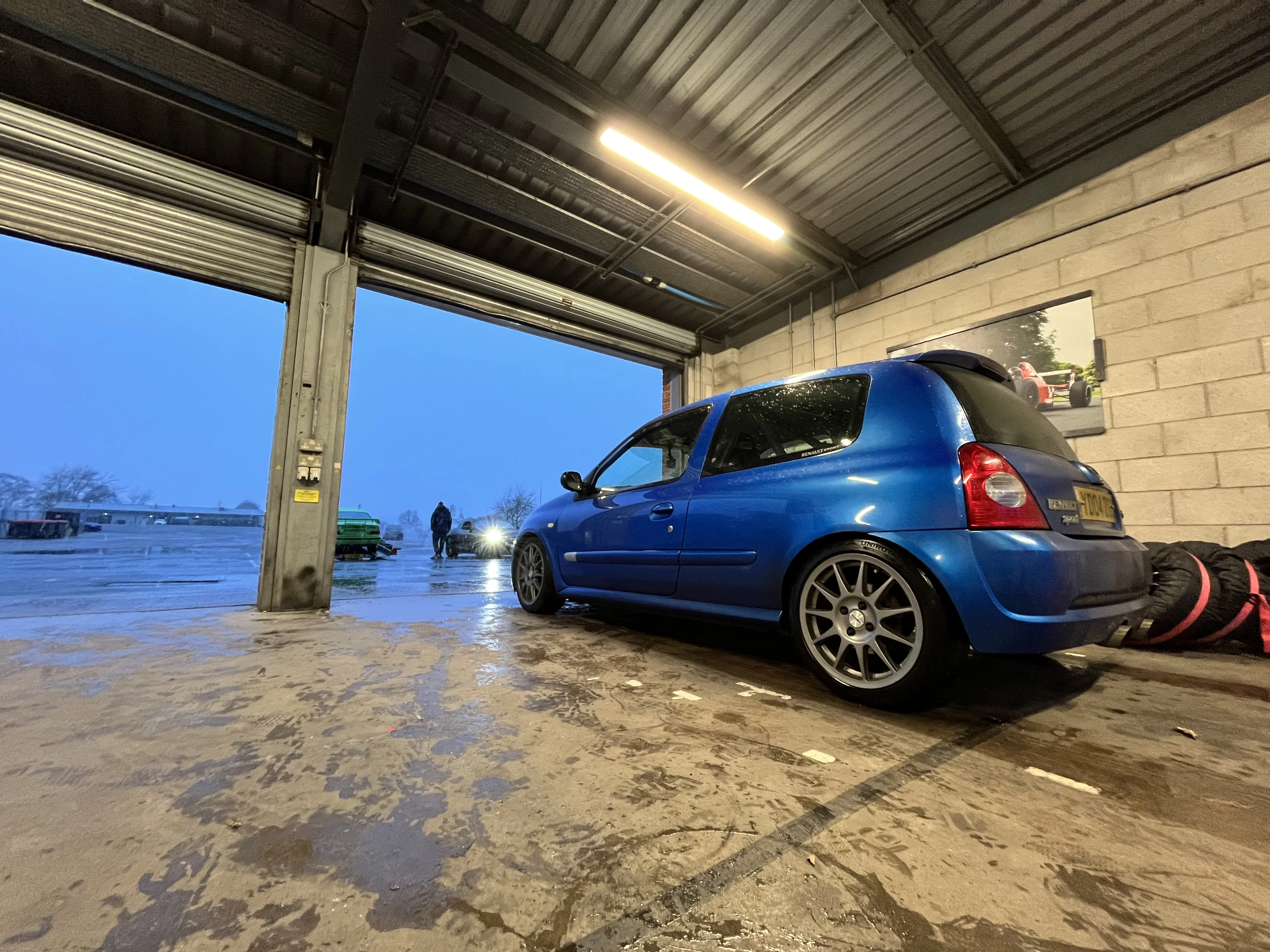

Oulton Park last week, icy start, snowy finish with a dry track in the middle. Mint fun
nothing but awesome fun to report and another day there in a weeks time (fingers crossed for good weather).
Clio was mint, spent the day in a train with my mates track spec Porsche 911 4s and BMW M3

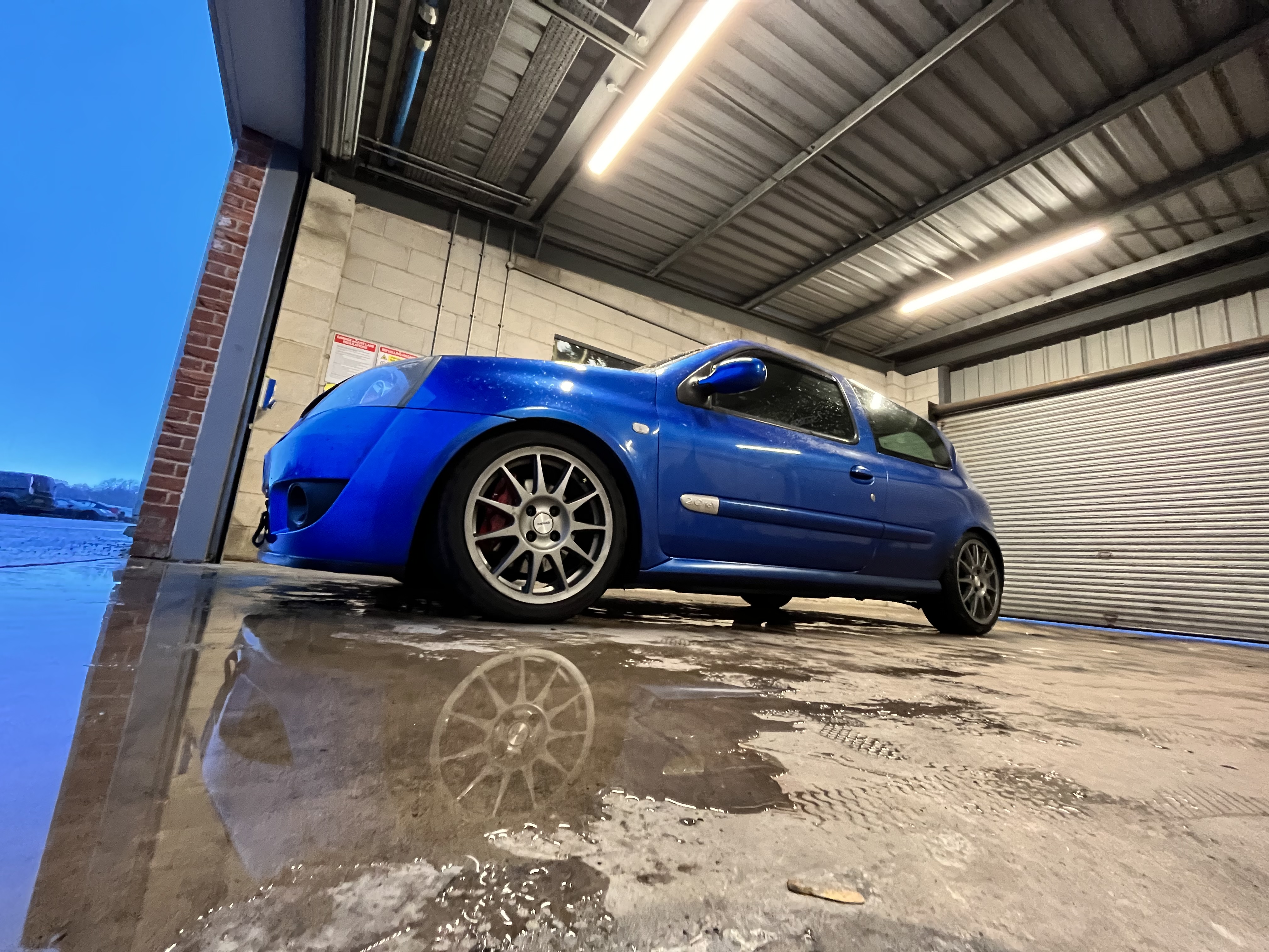

Another filthy wet day at Oulton, but ace fun. Did most of the day on the semi slicks which was ace fun, but swapped for the Uniroyals before things got a little too out of control.
Quite thankful for the rain as my brake pads were a bit worn out, time to do a pad and disc swap when I’m next in the garage.hell of a way to end the year, been out a fair few times this year and loving it.
Next “upgrade investment” debate now is if do I save to buy a LSD? Is it worth it? then which one to buy and how to fit it!

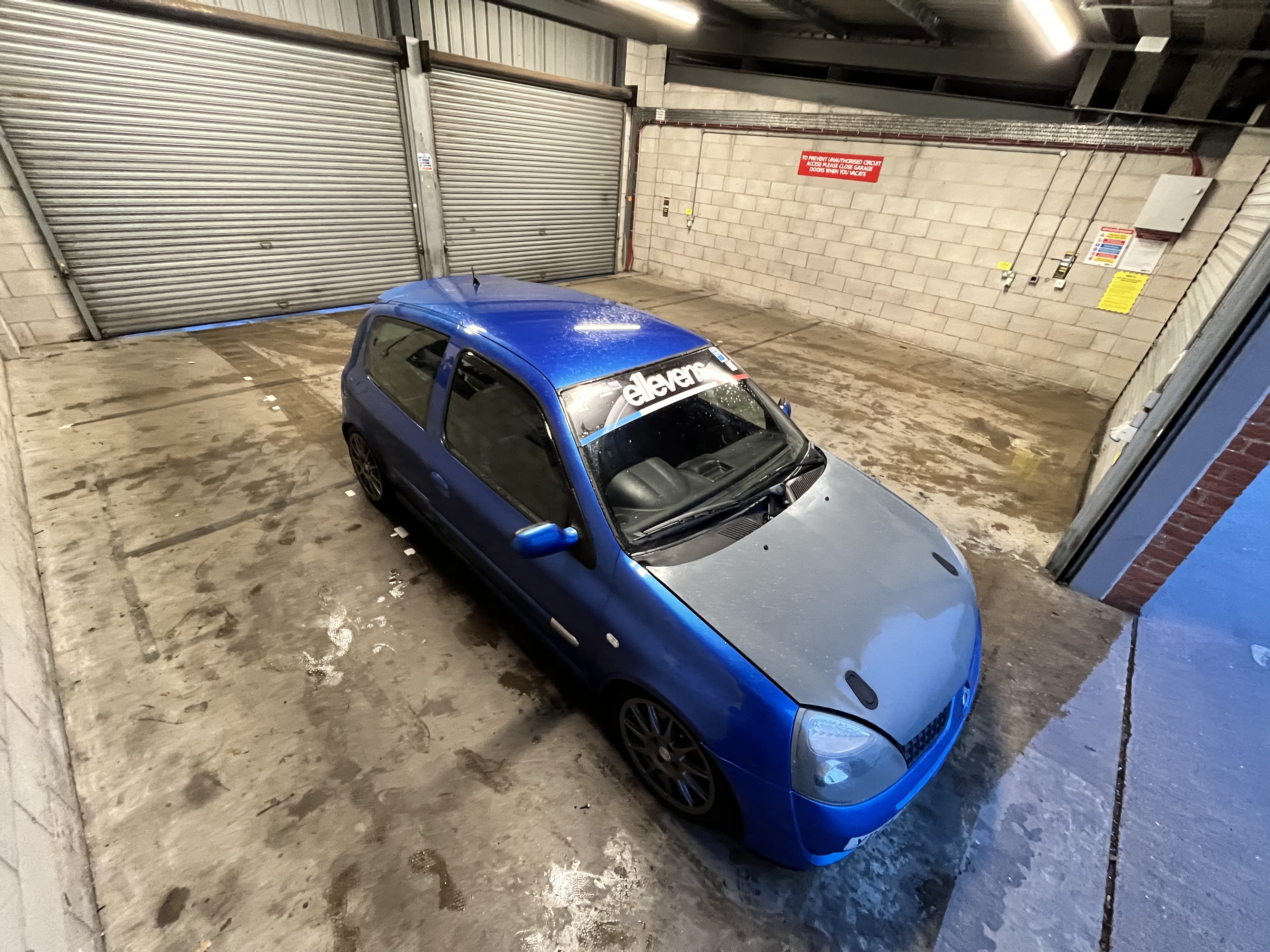

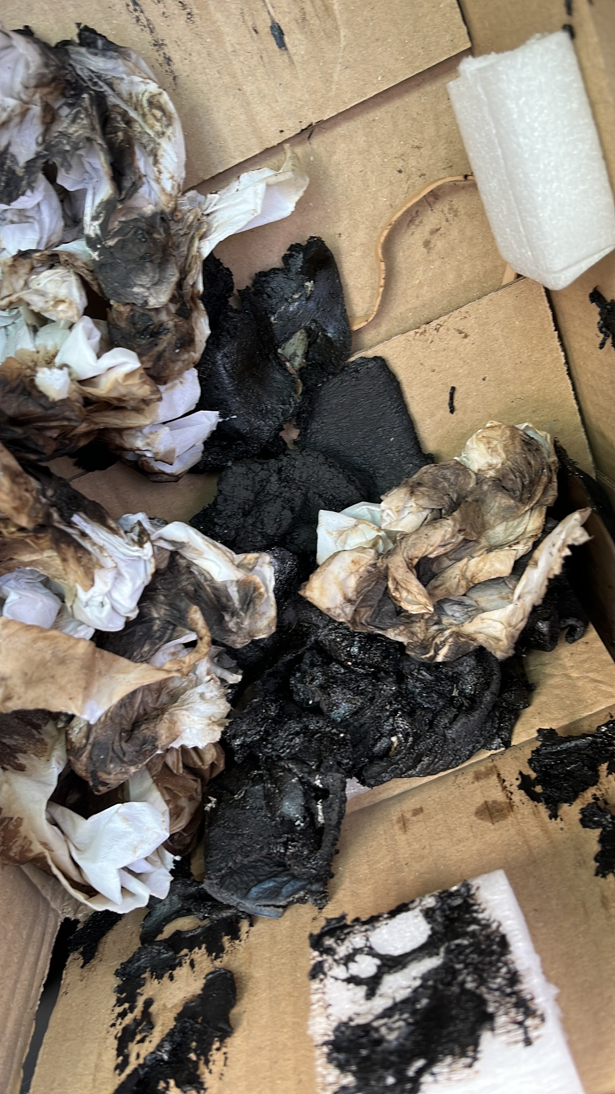

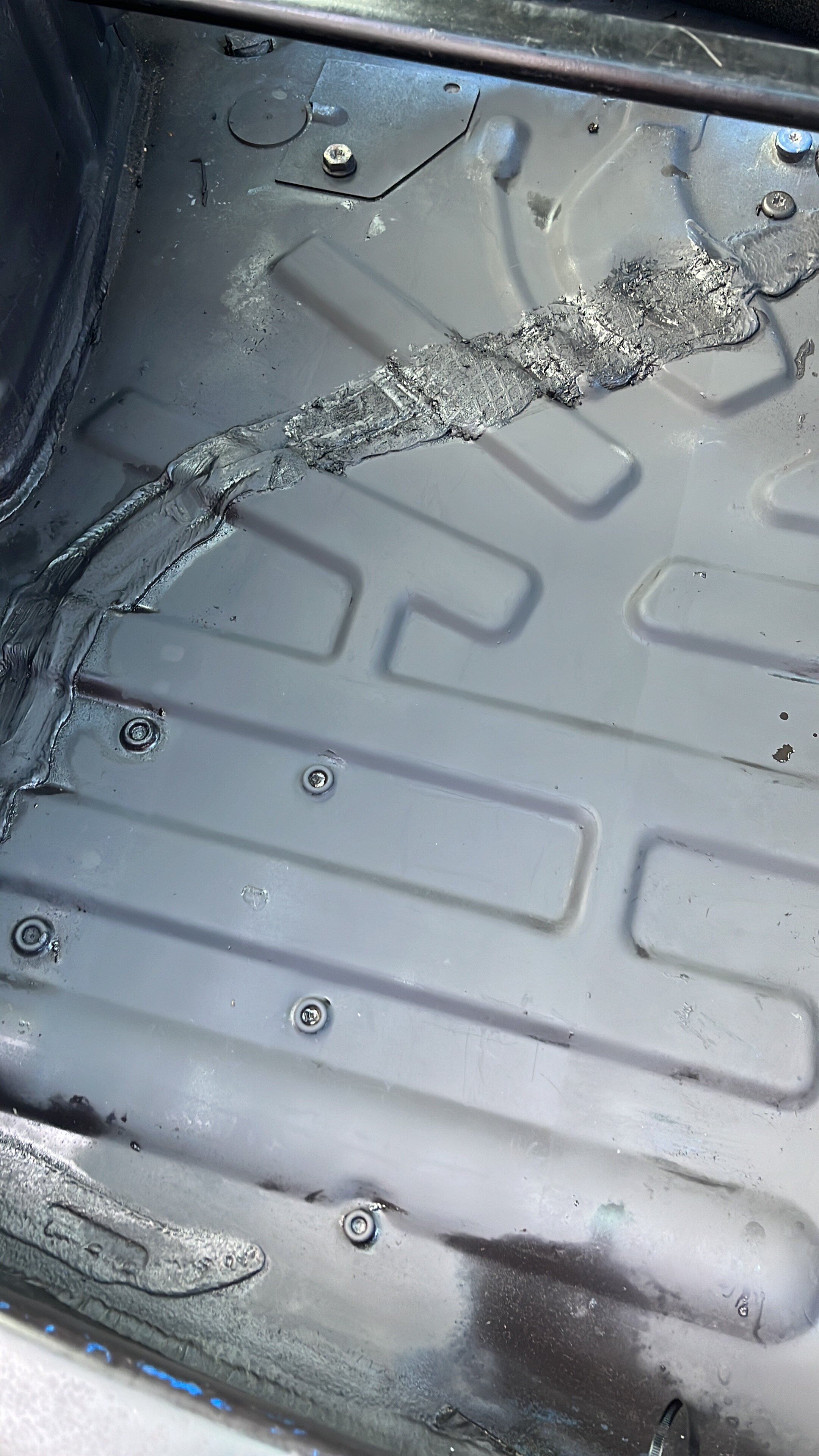

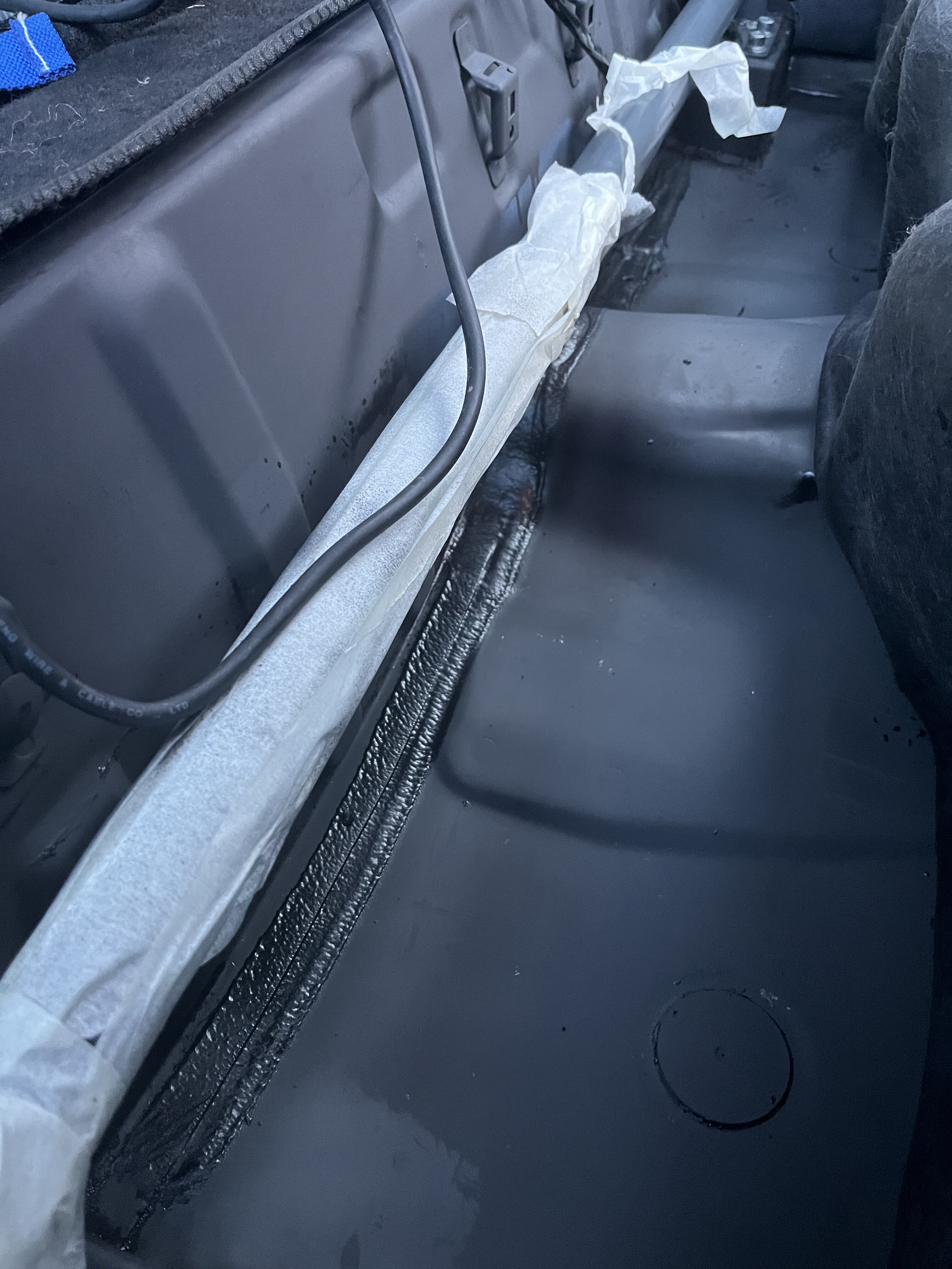

Decided to diet for January. First job was to start removing some sound deadening tar.
pretty easy with a heat gun and blade. Painted over to keep it all tidy. May start to strip the rest of the interior now.

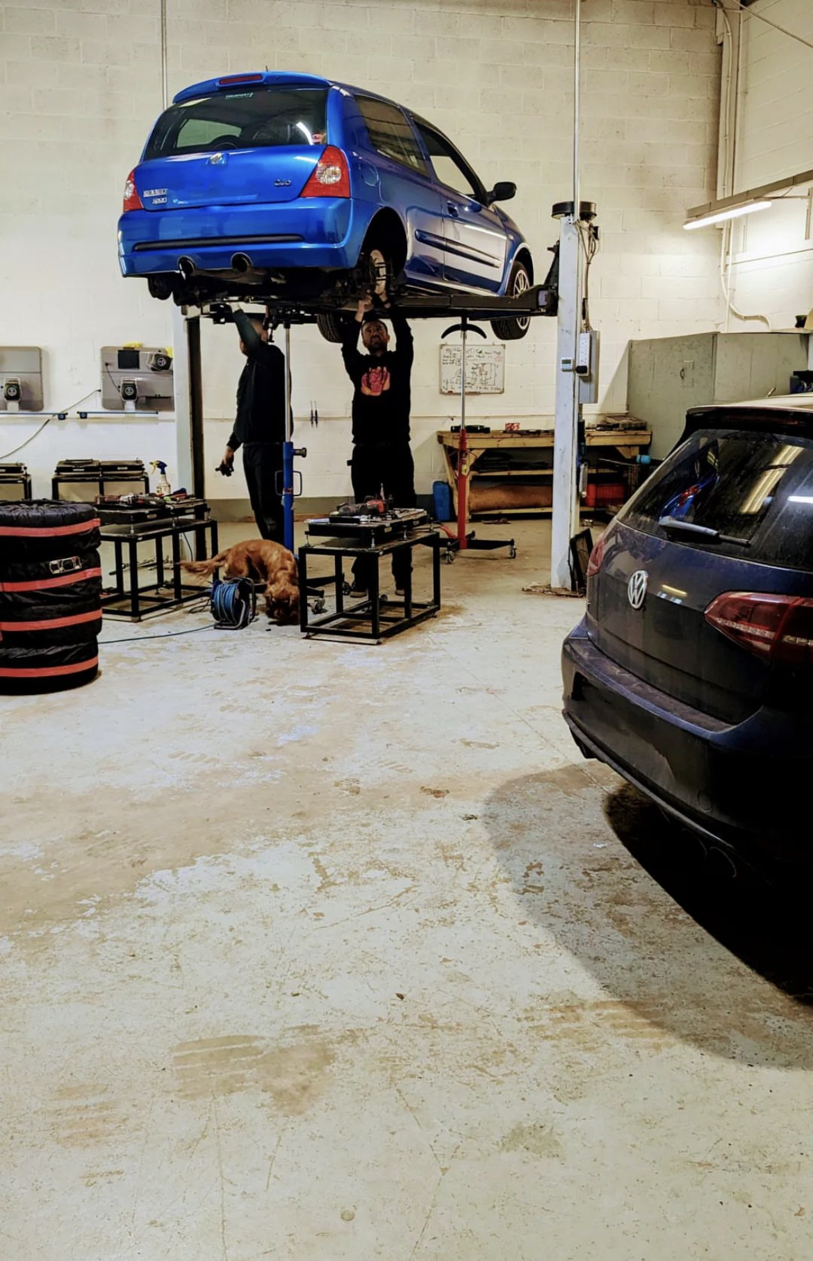

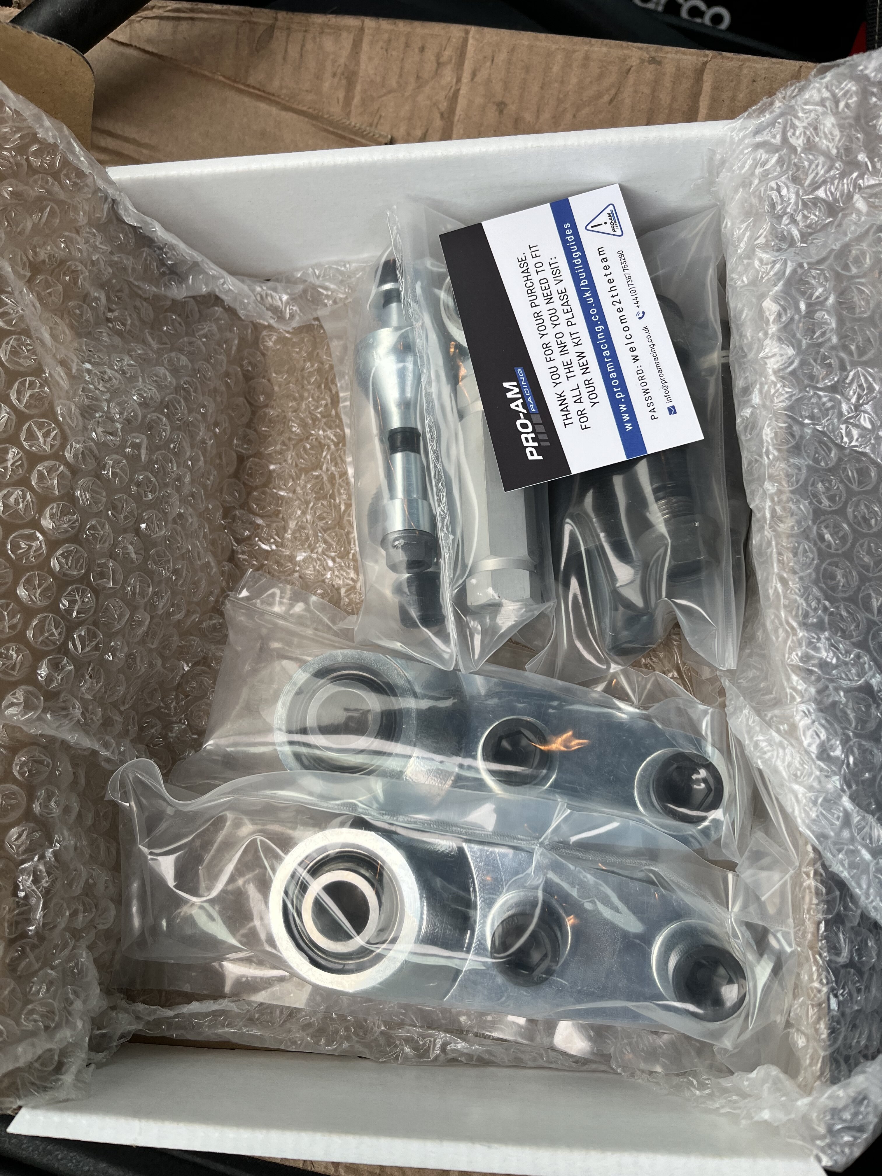

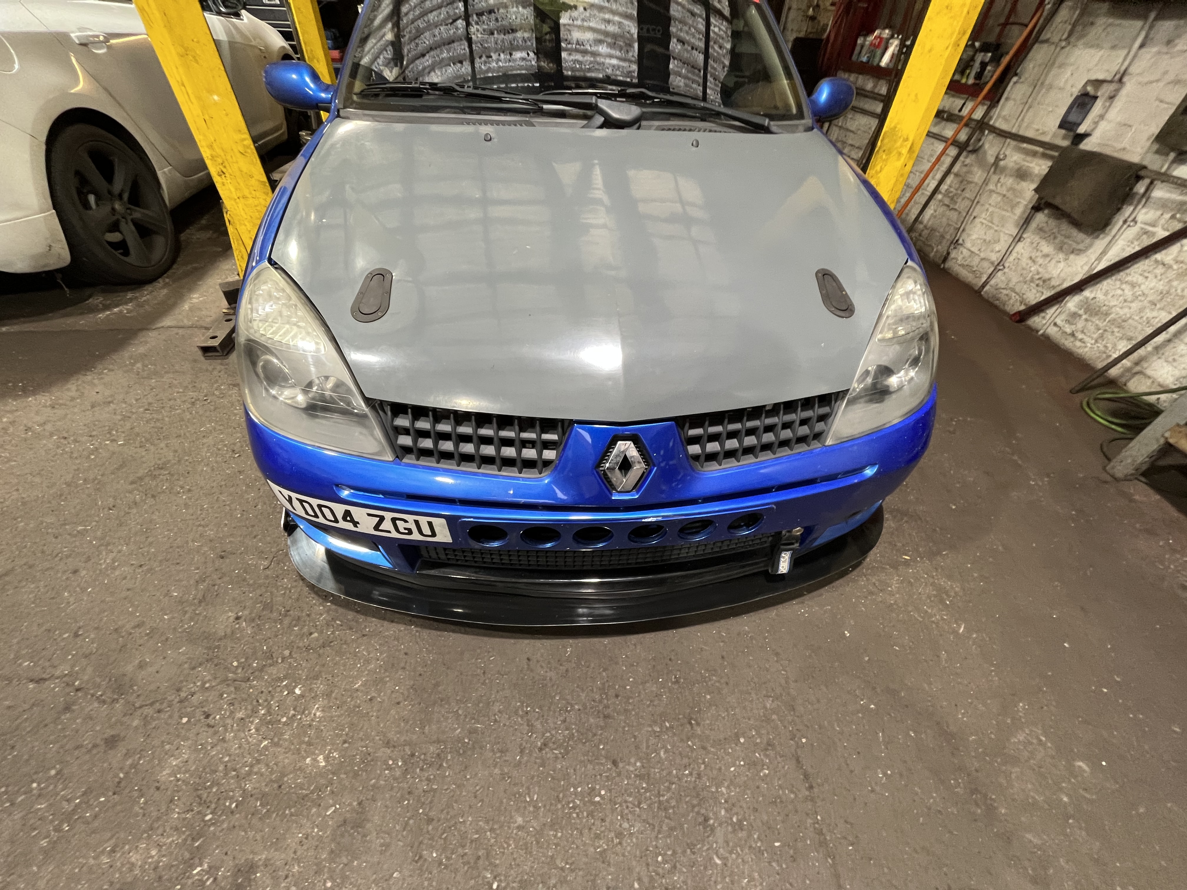

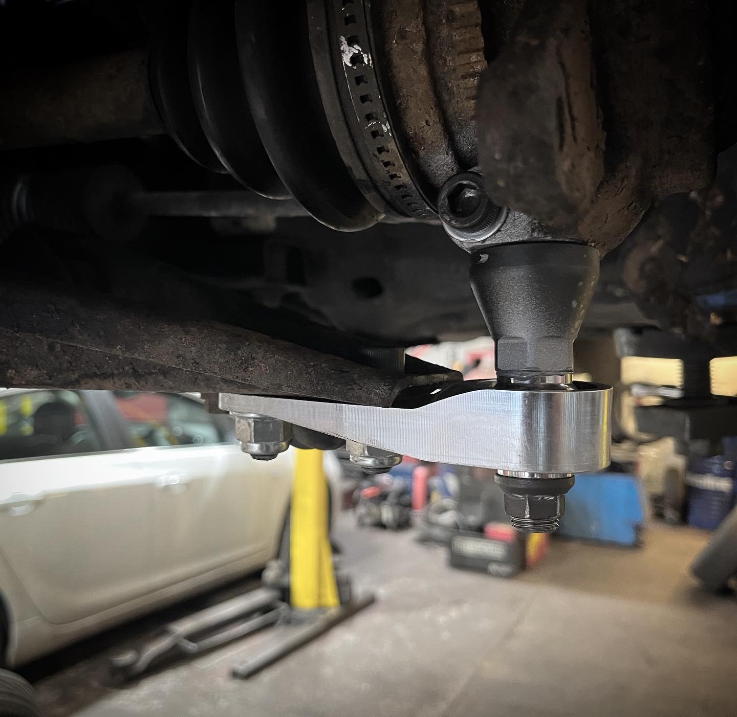

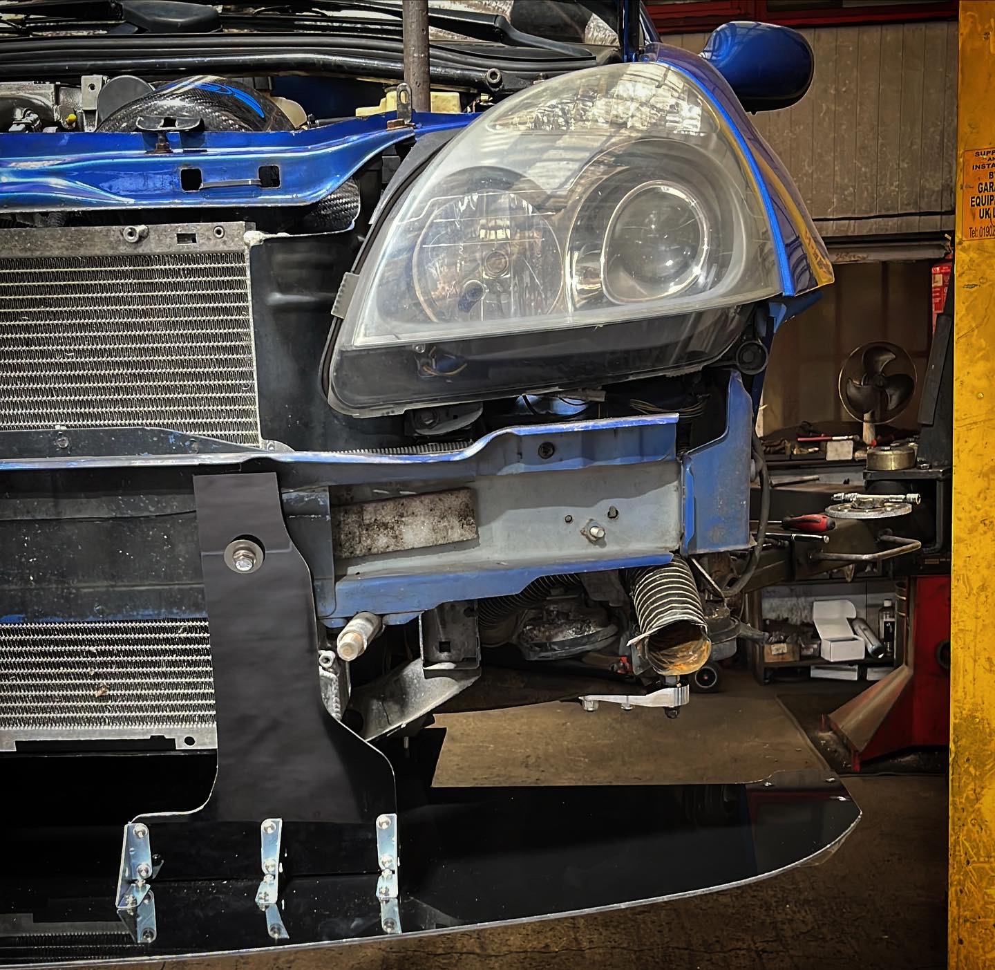

Saturday Club at my mates garage to get the Clio ready for another track day. Been accumulating some wee modifications too.
Pro-AM Racing geo correction kit. Awesome looking bit of kit and a doddle to fit. Will take the car to get a quick realignment this week to make sure it’s all where it should be. Only driven it home so can’t really say much.

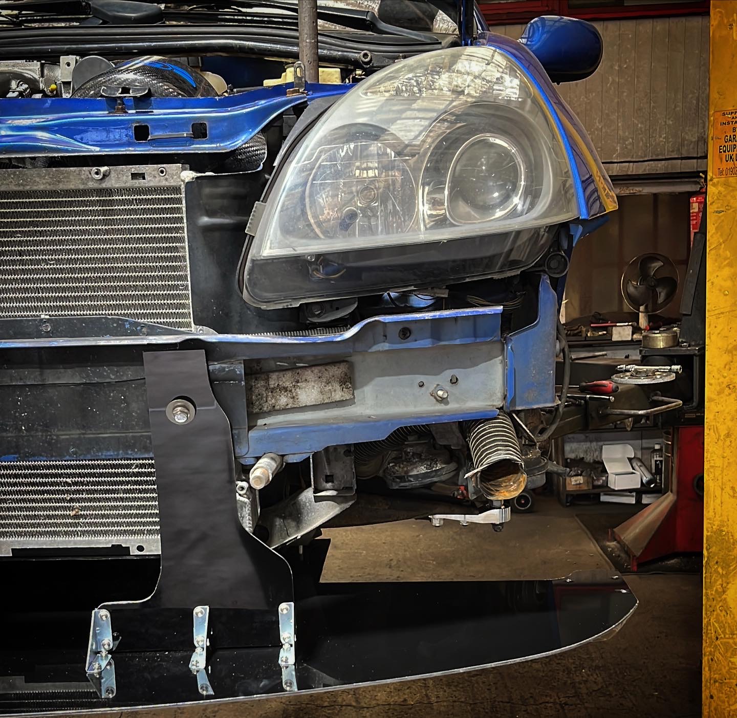

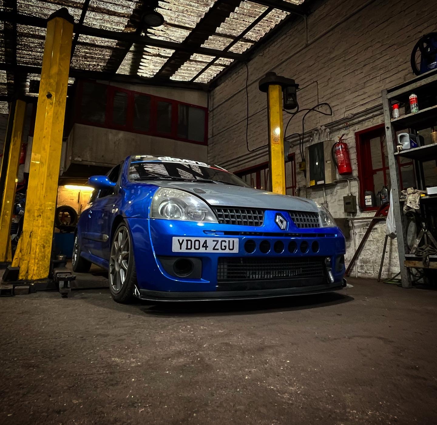

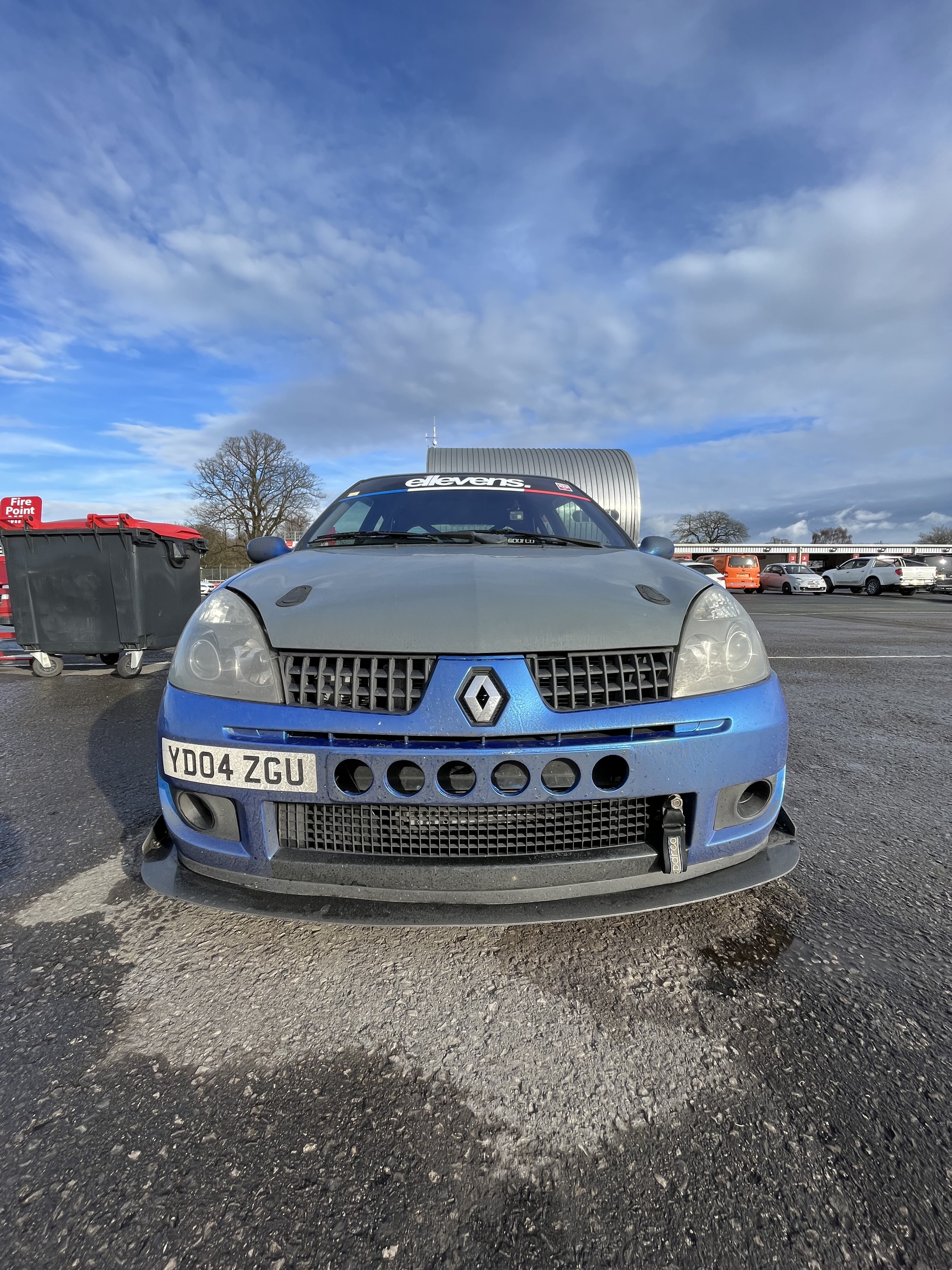

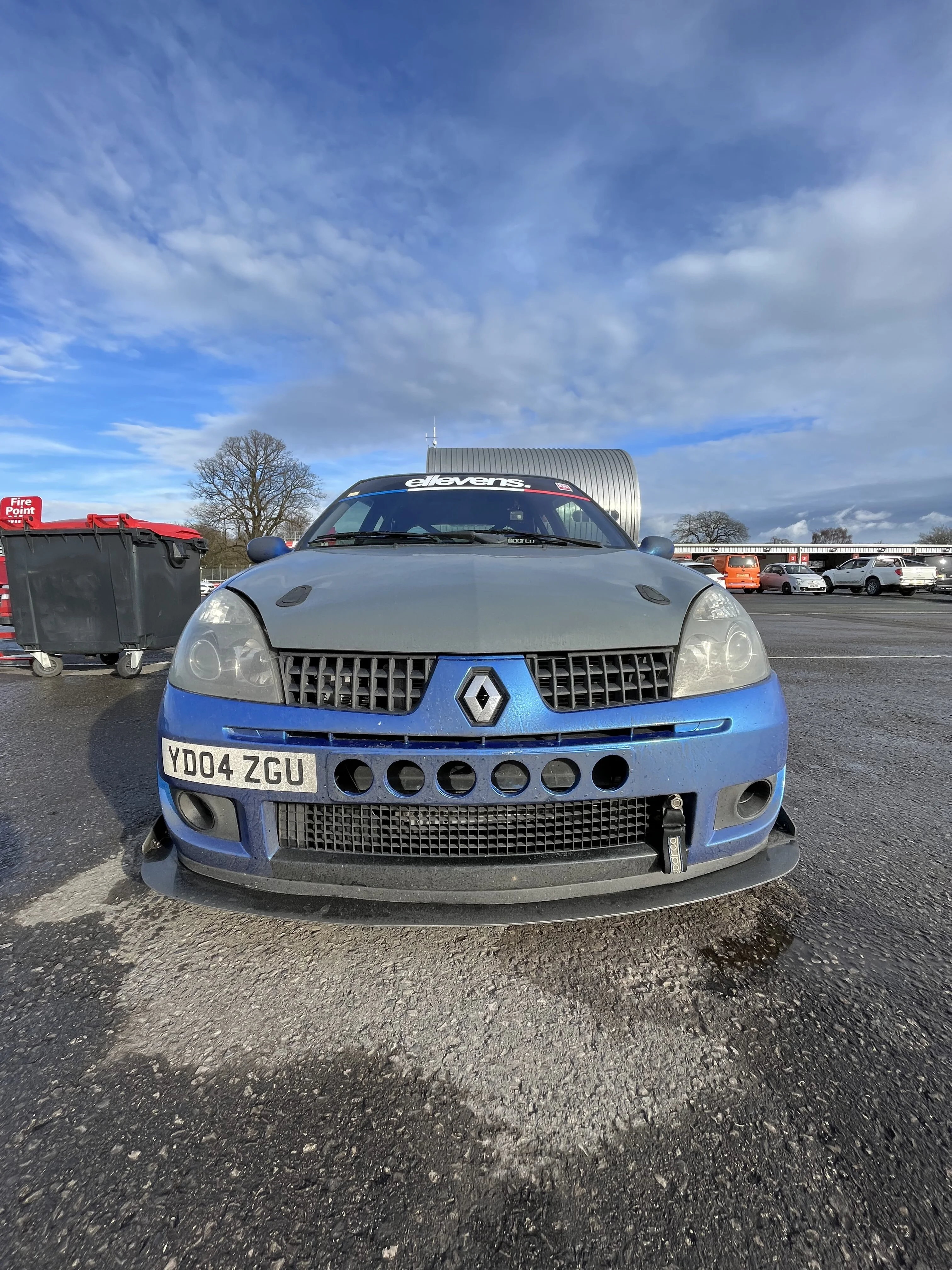

Still saving up and finding the time to get a LSD fitted, but in the mean time I’ve added a front splitter. If it helps a little to reduce high speed understeer that’s cool- quite like the look of it too. Not difficult to fit, just fiddly. Pretty sturdy though on the car.
Also, fitted new discs and pads, Brembo high carbon front discs. Going to try the PBS Race pads up front and track in the rear. Also mini service, new plugs and oil.
spotted the bushings are starting to wear so will invest in some polybush kit for the rear beam and front arms.

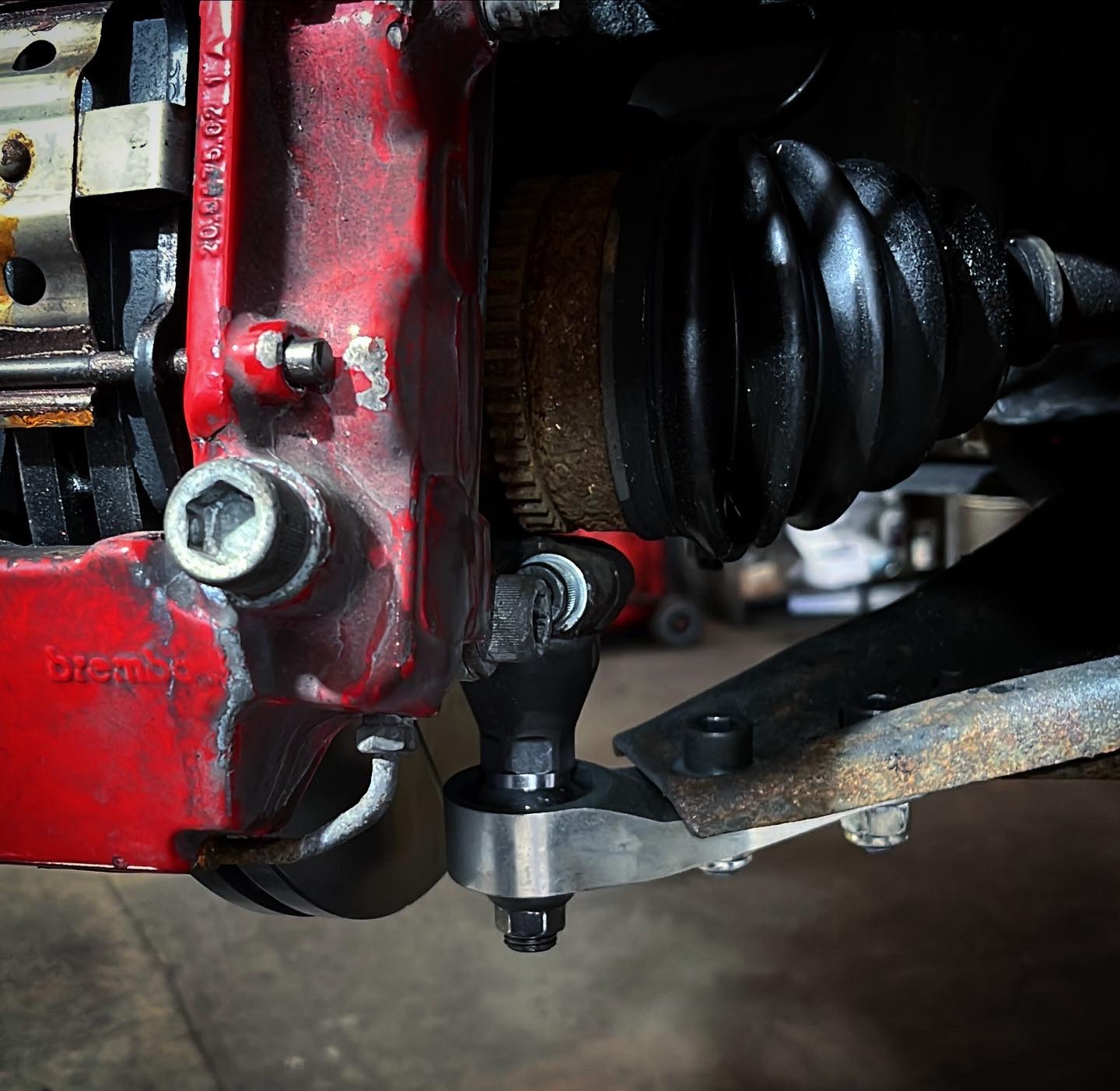

The turn in will be so much better with that geo-kit on. You’ll wonder how you managed to drive around a circuit without it.

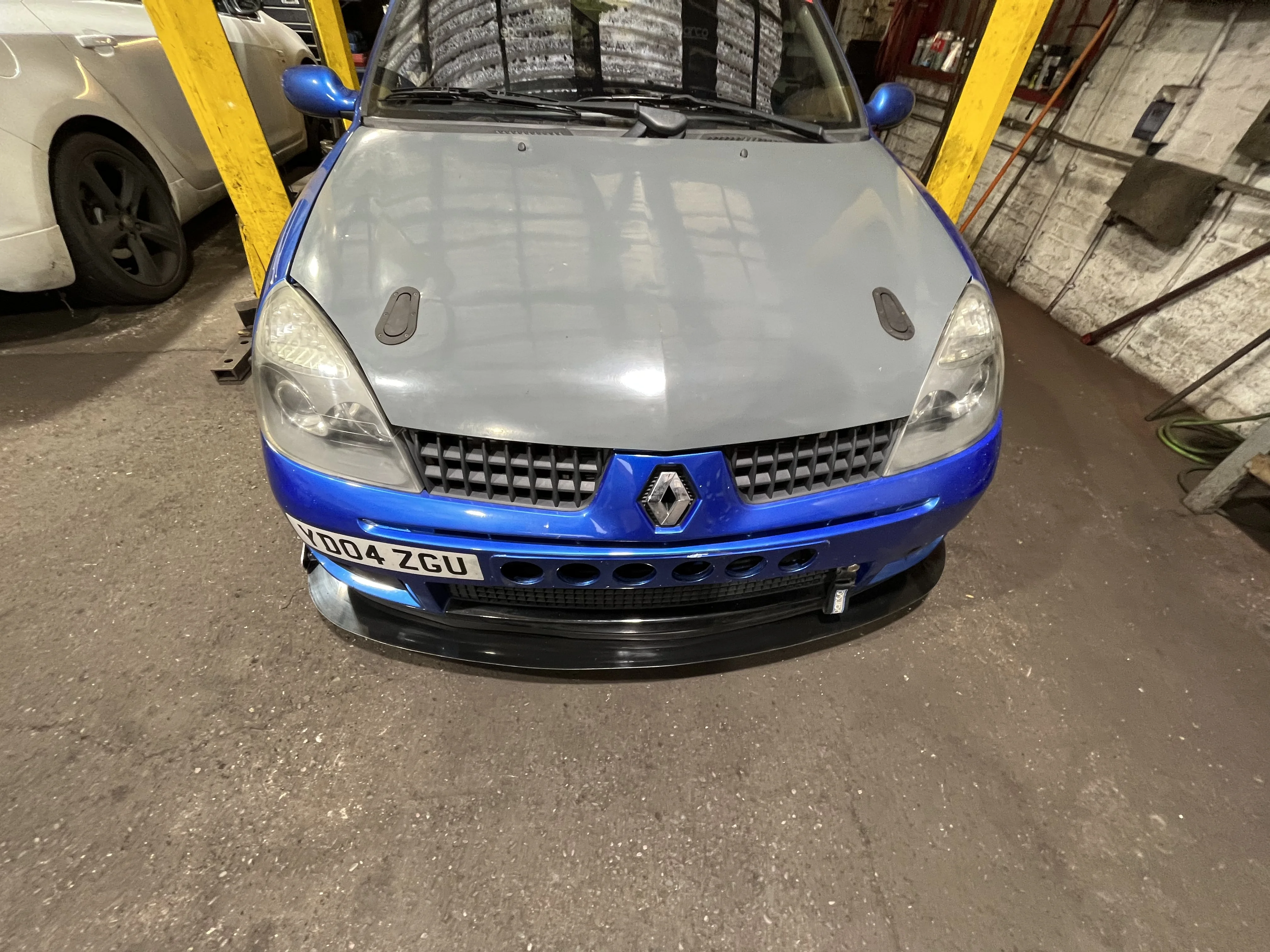

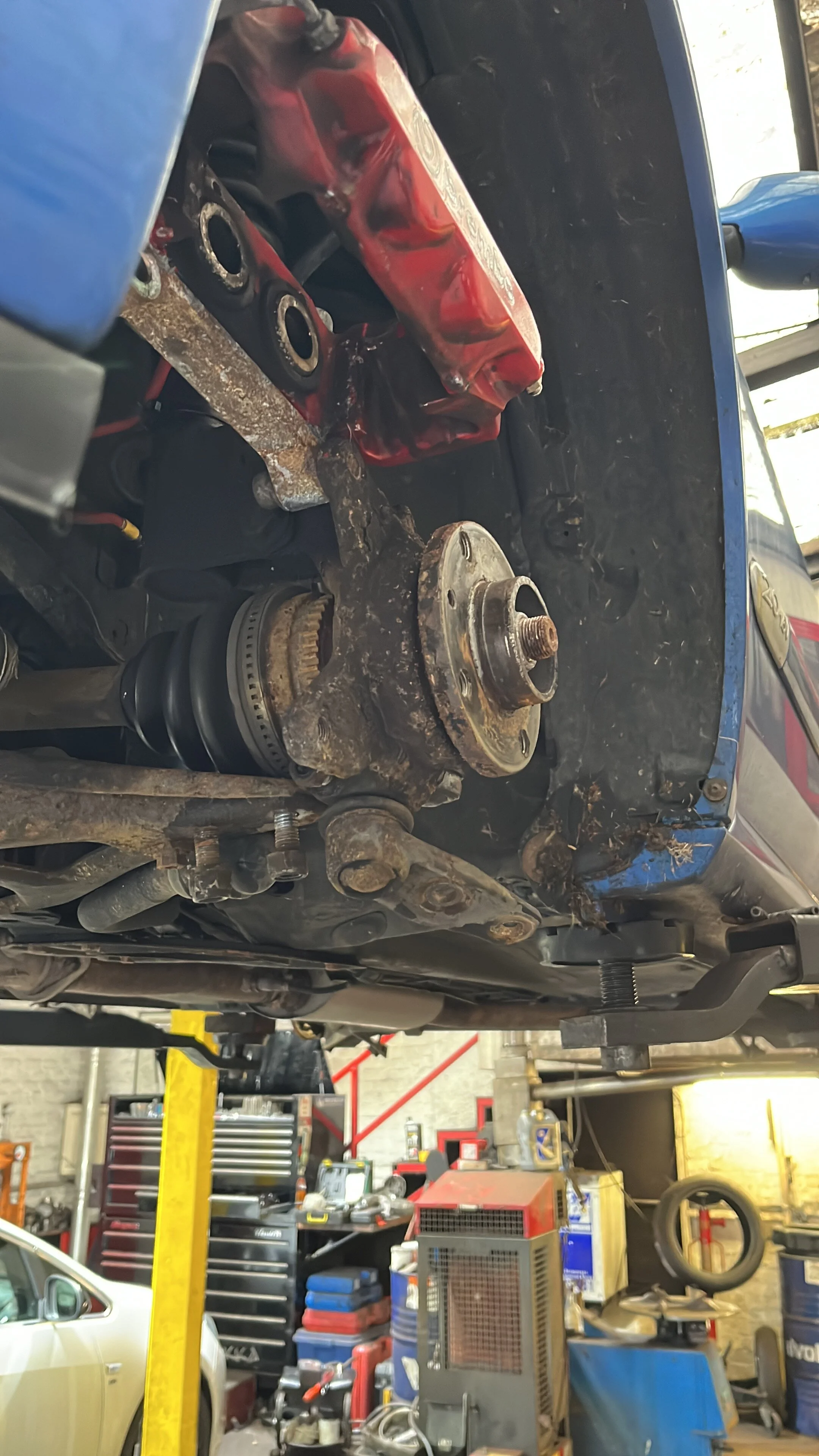

Visit to see Ben at StringTheory to get the alignment dialled after fitting the Roll Centre kit. Whilst it was there had a new rear beam bushings.
Can highly recommend these guys
Amazing day- short shower, but plenty of dry track time. The new Roll Centre and bump steer kit, plus the alignment really makes the car insane to drive. Turn in is on point. Not sure if the splitter did anything, but maybe?!
first time using PMS brake pads too, Track on the rear and race in the front. They work well, but seem to wear really quickly, used about 50% of the front pads today.
Any suggestions for some better wearing pads?

How do you find the roll center kit from pro am that’s next on my list, Iv heard good things about it.
Spa was brilliant mate highly recommend it! There was so many supercars on track so down the straights I was getting killed was a bit disheartening but then the corners was nice to keep with them or gain on a few. The track though is insane so wide and flowing. We had a great 4 days worth doing for sure!
Oulton Park was the first day I’ve done with it. Felt good. On the road it feels a bit less “crashy” (I only drive to and from track days really).
On track, Turn feels a little more precise and I’m not feeling the mid-late corner understeer as much. The benefit is I don’t think the tyres seem to not get rinsed as much so more time on track, which is what I wanted.
Think it’s that and a good wheel alignment (highly recomend String theory- not cheap, but really good folk).

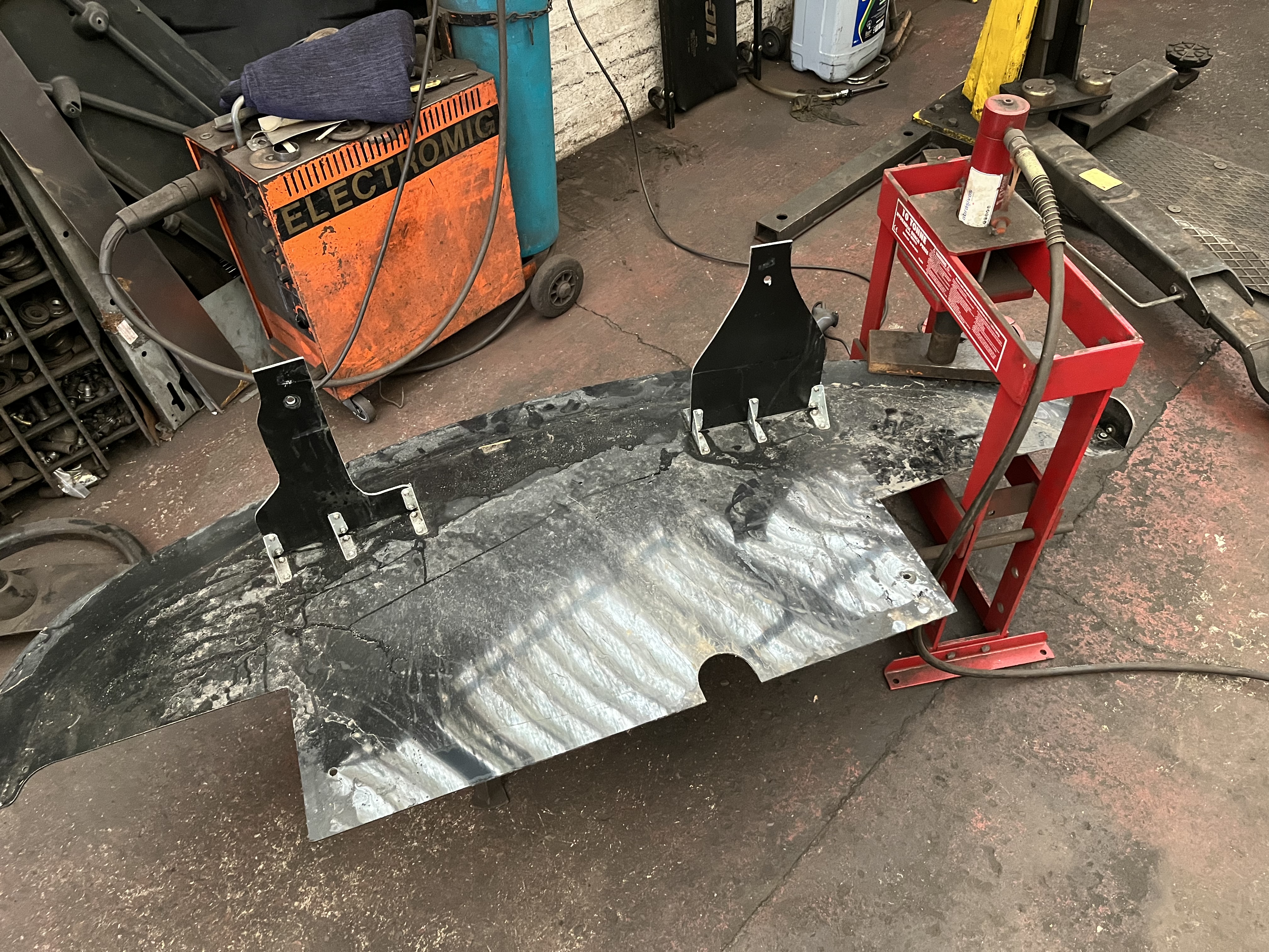

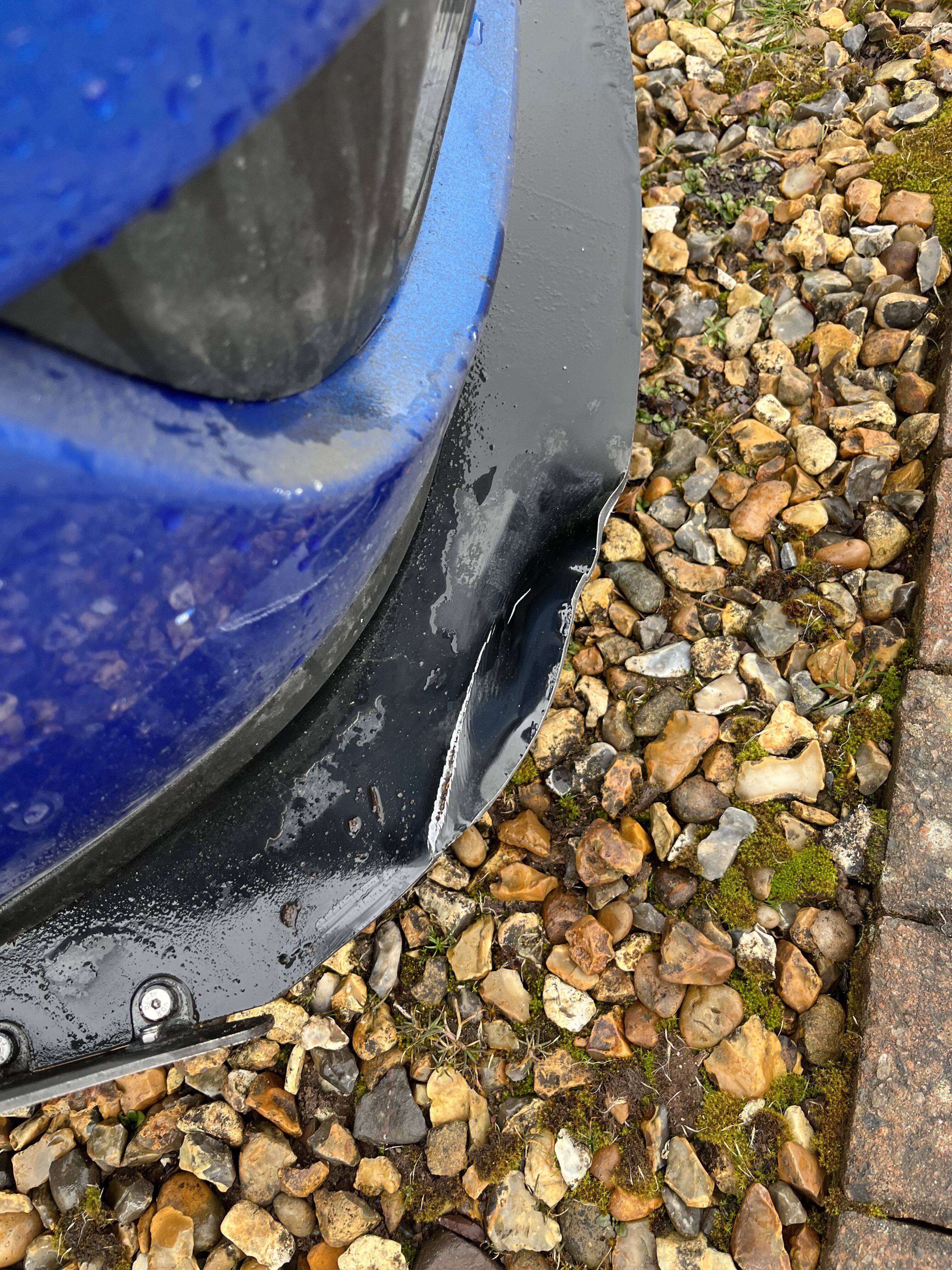

Did a really silly thing and caught the splitter on a plant pot! Mangled it a little, so was a little gutted.
Managed to straighten it enough to pass the 10 yard test. Will do for a bit until I can make one.

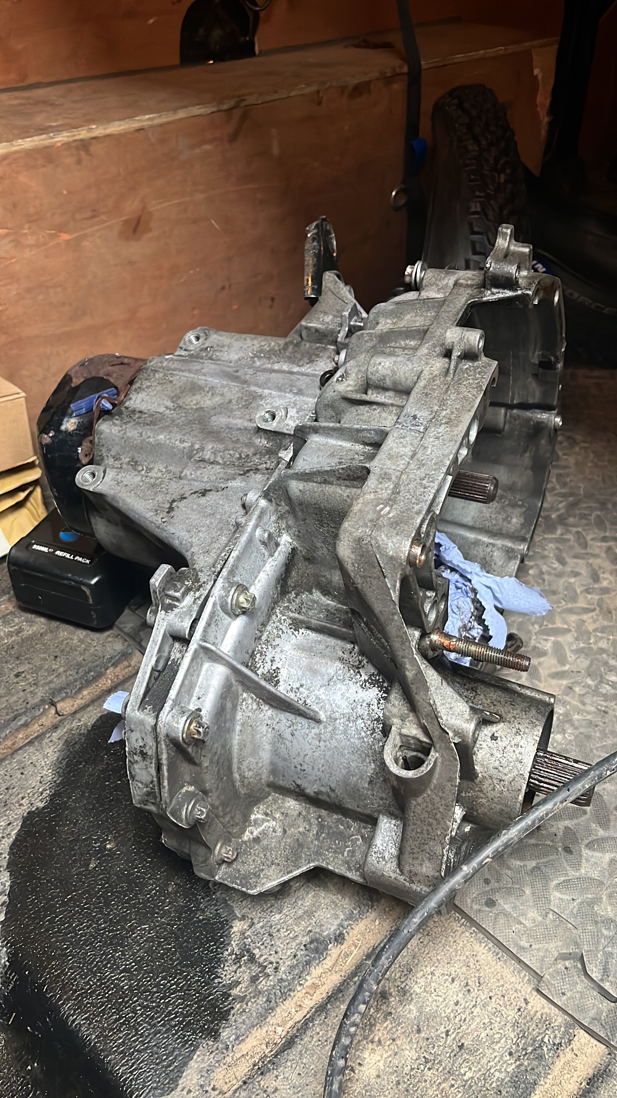

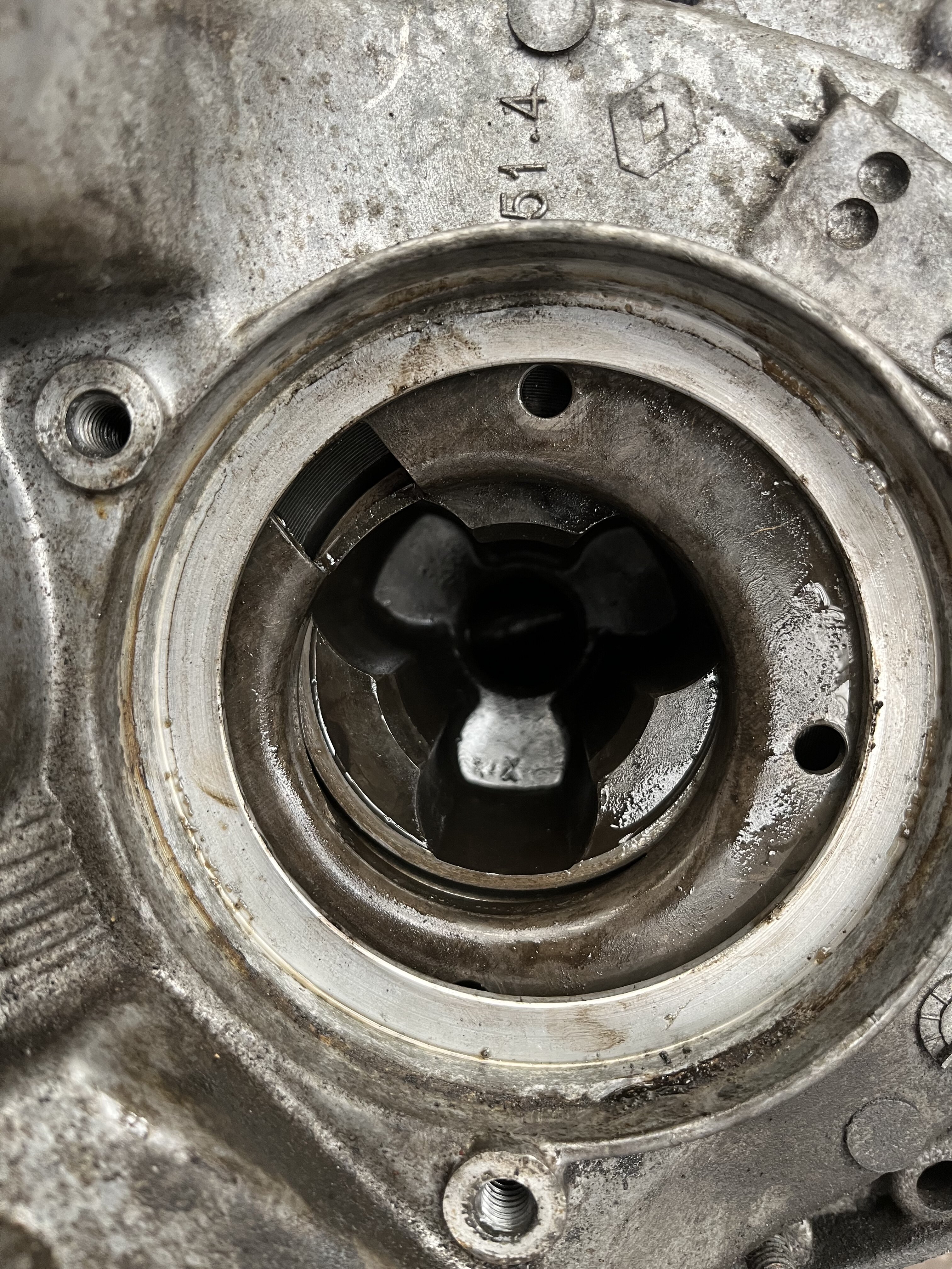

I think I made a silly mistake this week at a track evening at Donington Park. I can confirm if you Clio the yellow inner kerbs of the last chicane it will break your French car.
Not sure what the damage is yet, but it revs, goes in gear and no oil was lost. Will have a look with my mate.
Other than that it was mint! Took it pretty chilled as it had been raining all day and heard stories of Donington Parks new tarmac being slippy. But was luck we only had a couple of light showers that evening!
Hopefully back together soon…

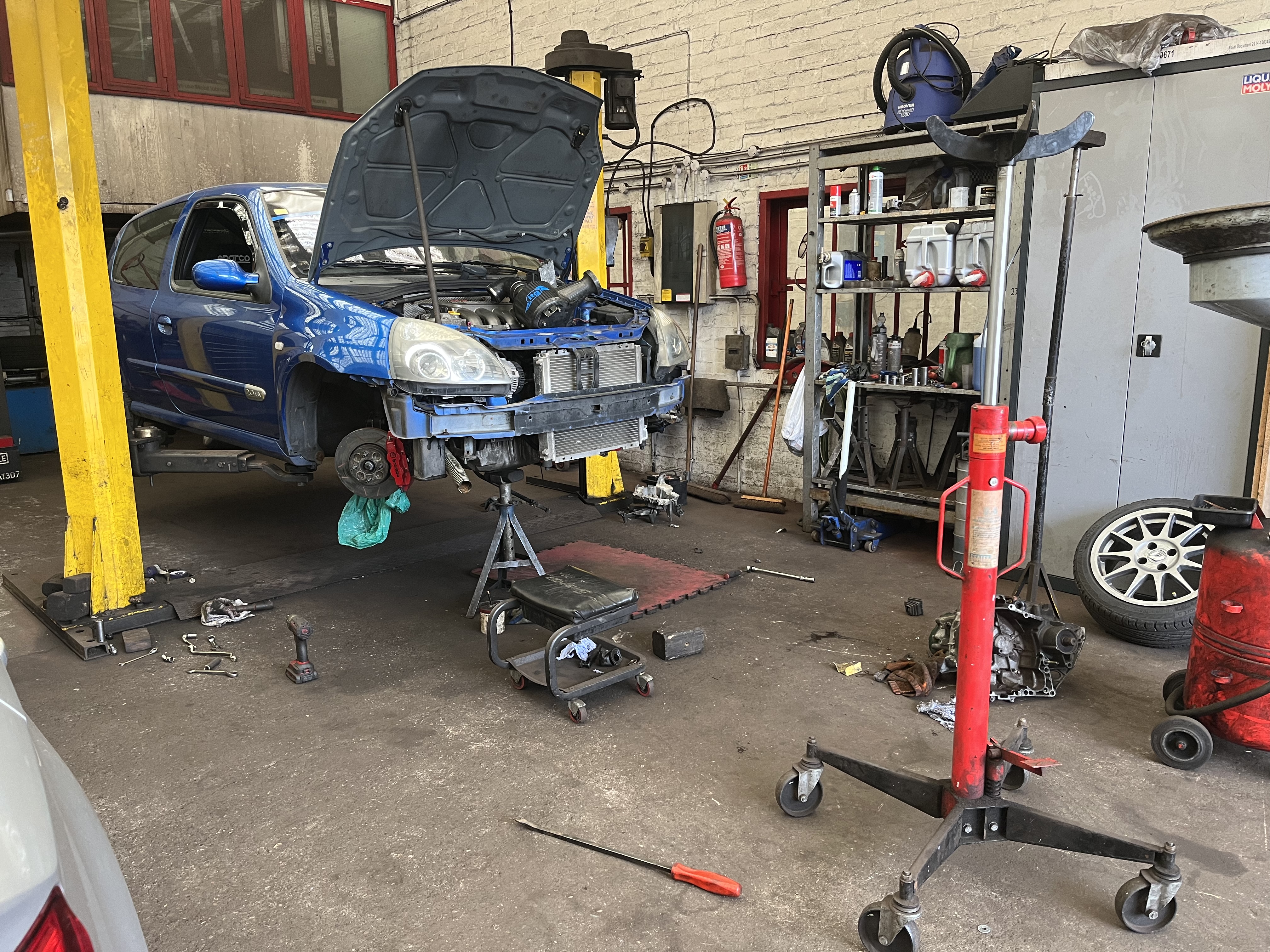

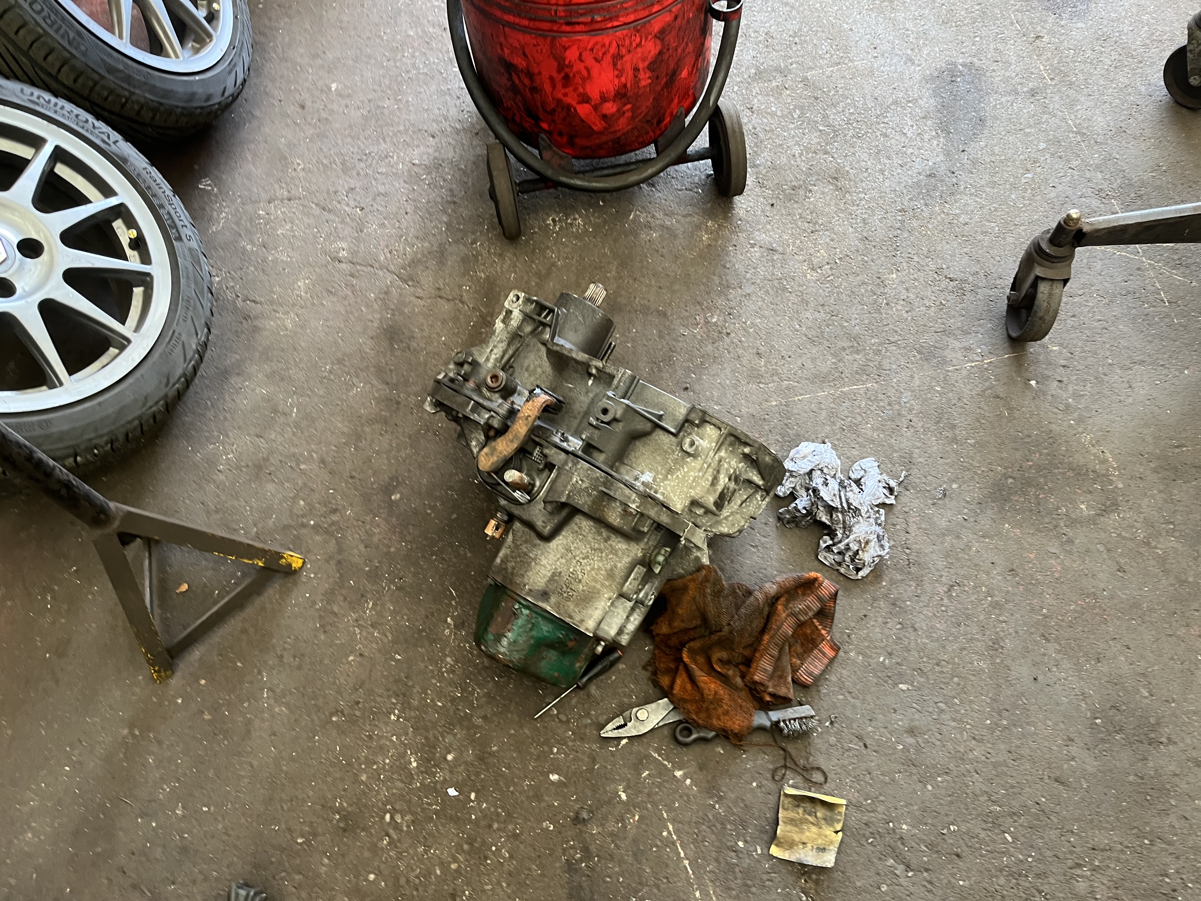

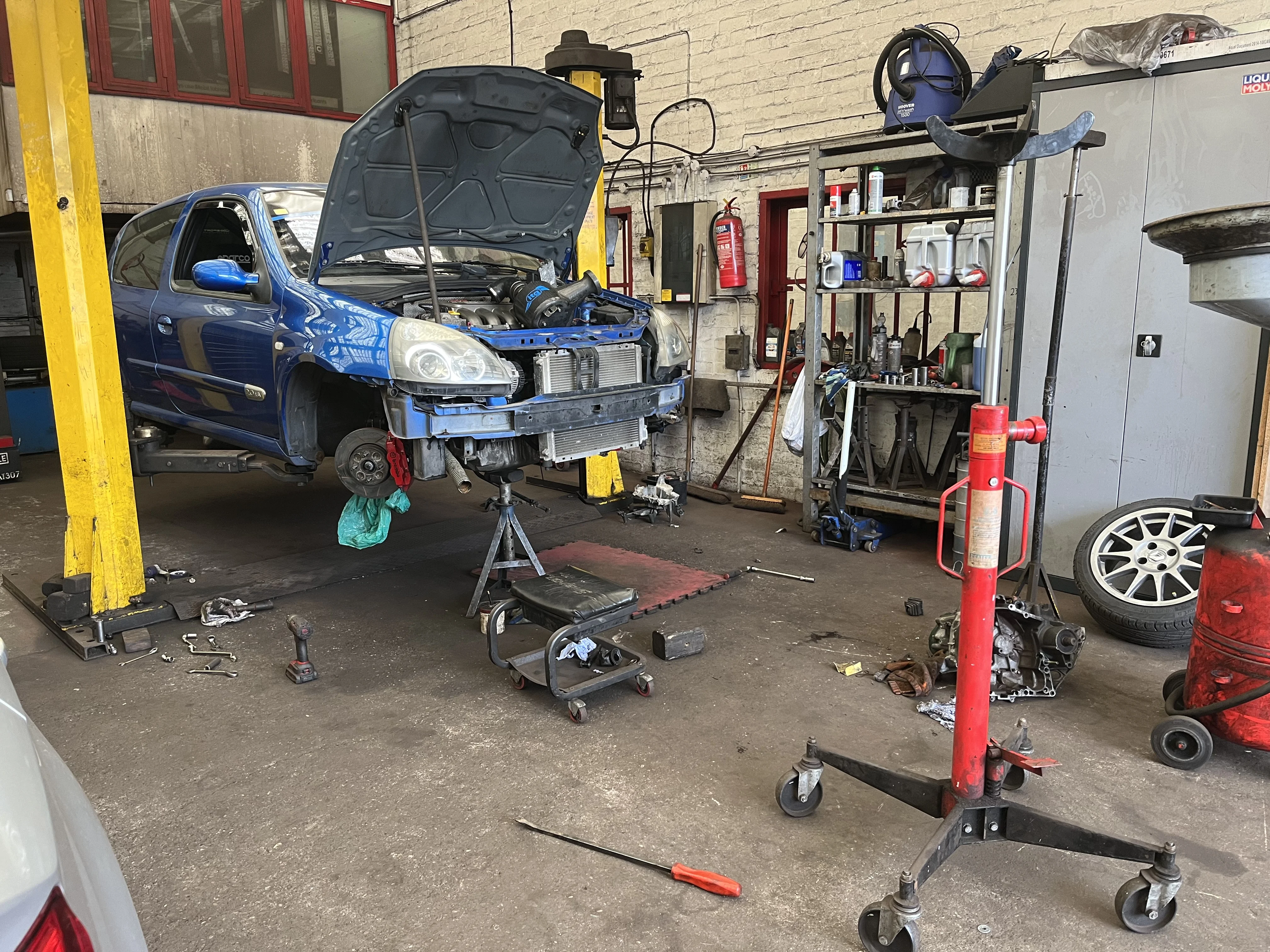

I sold my race car to a lad who managed to break it after a week bouncing off the kerbs there.

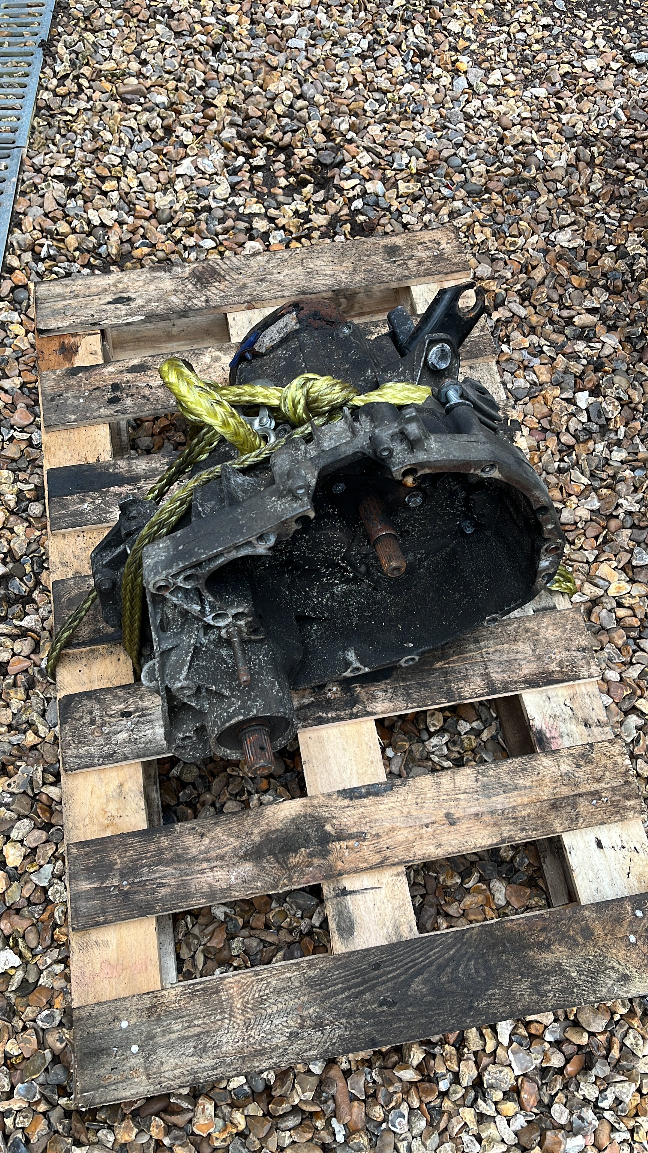

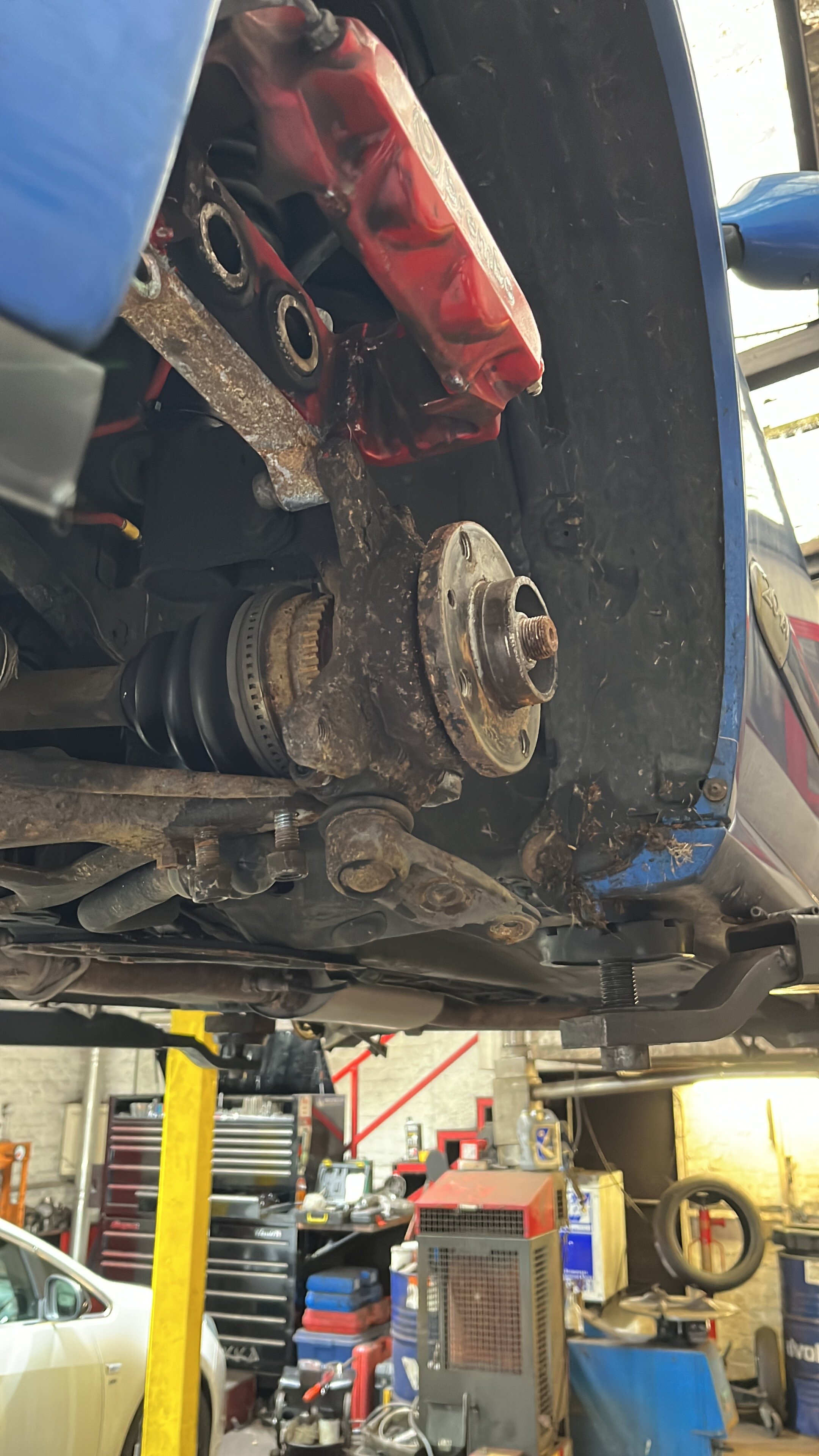

Time to refit a replacement gearbox.
Before
After:
Let’s hope it works… Donington coming soon

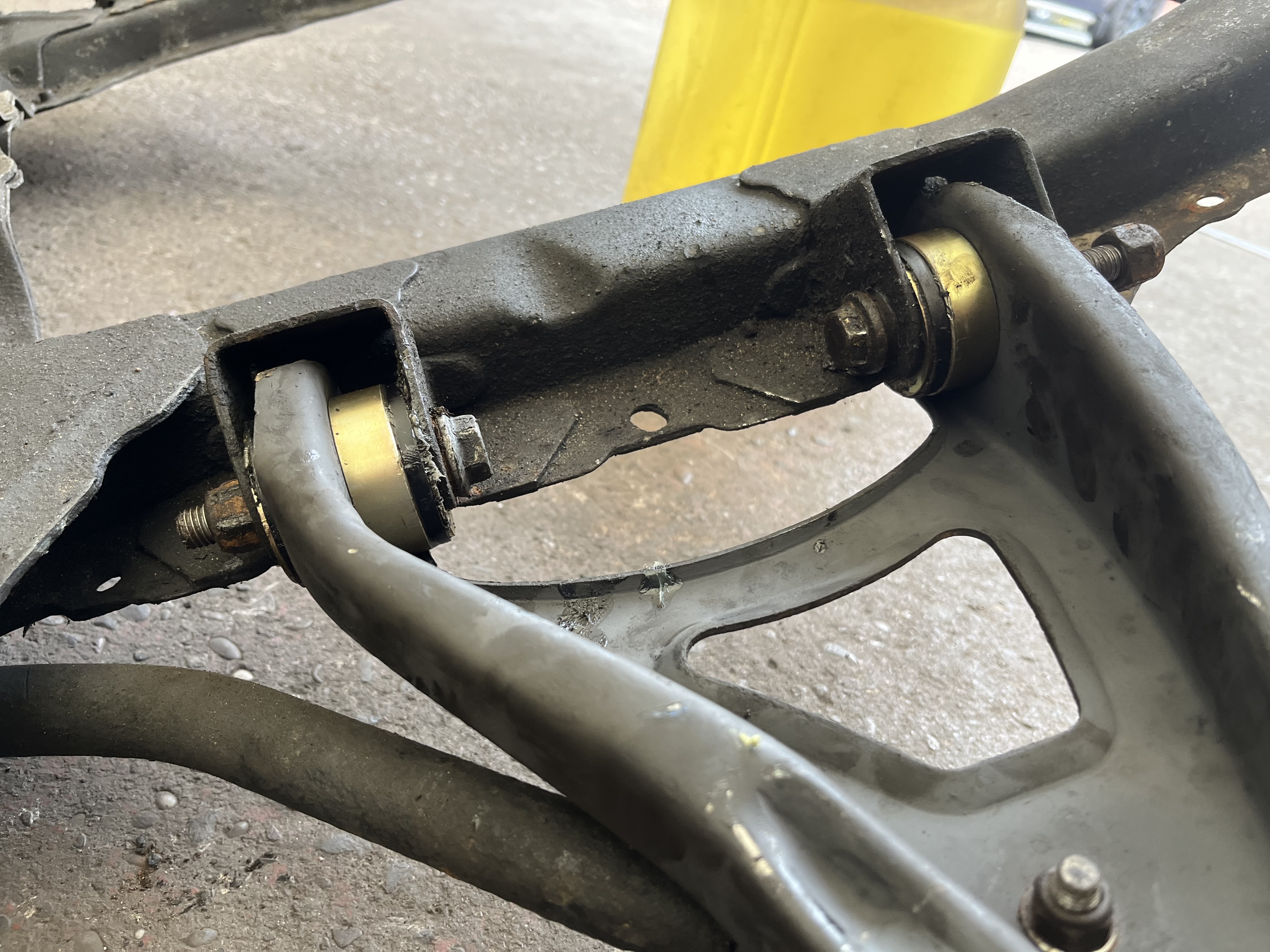

New gearbox in, cars running mint, ready for Donington Park next week. The old box is a little munched, but hopefully salvageable, be good to get it refurbed and maybe add a dif.
Also refreshed the wishbone bushes too for some Powerflex Blackseries
