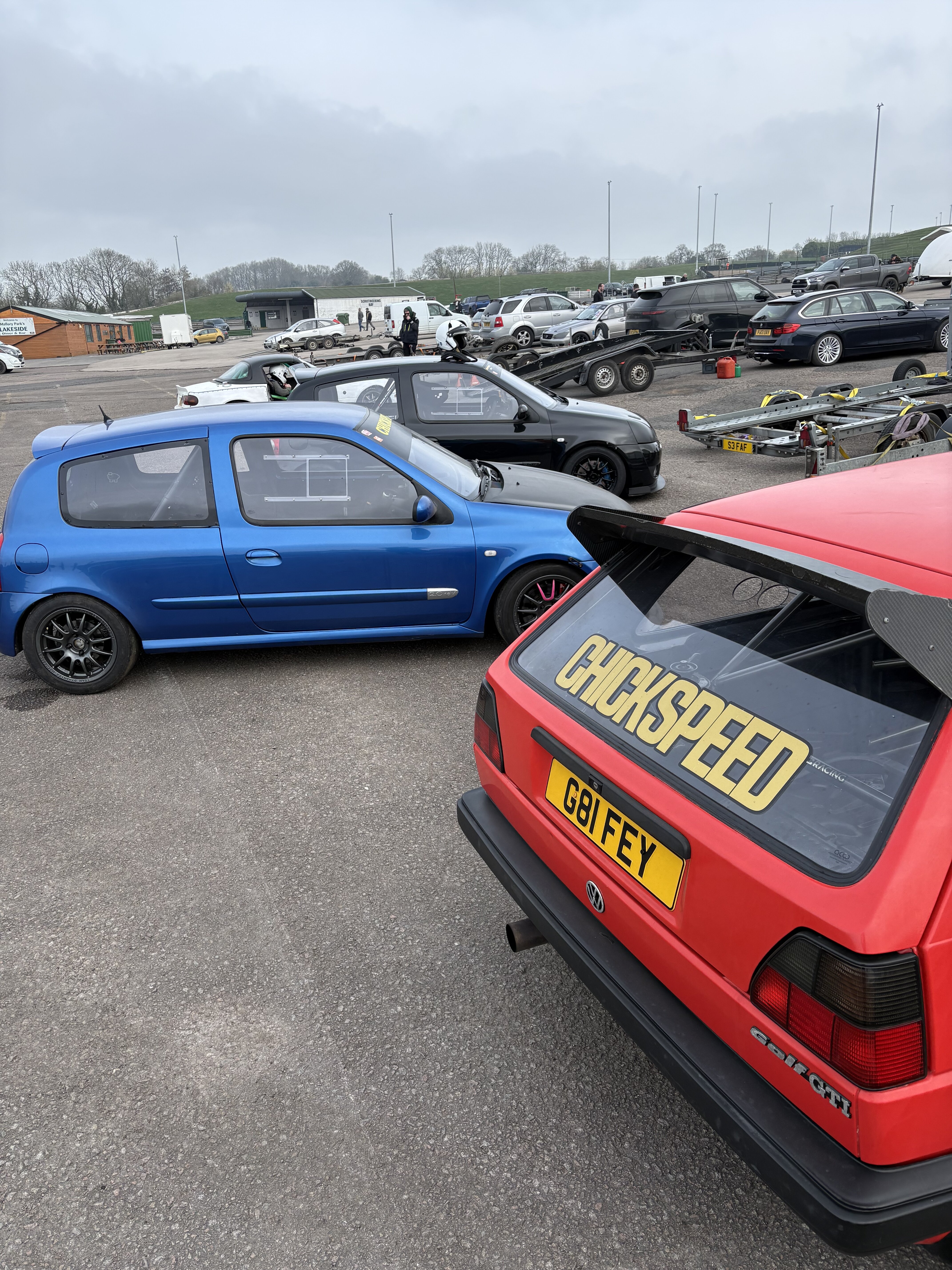

Hell of a day at Mallory Park.
only been here once before, but actually pretty fun and Gerard's is sensational!
Car was awesome, managed to get a few clear laps and get to a best of 53.3 lap.
Tyre delaminated to stop play a little early, but amazing fun!!

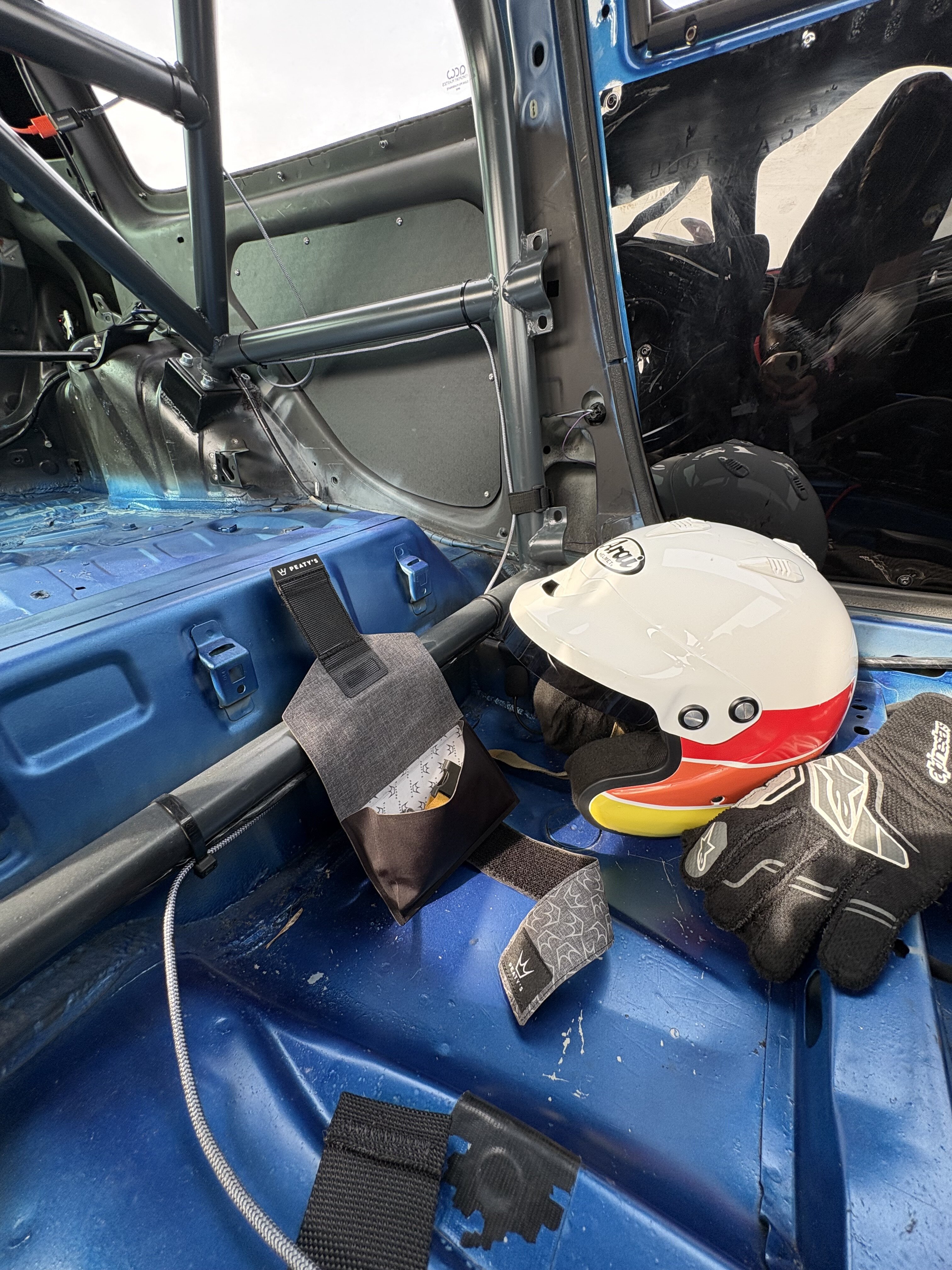

Also.. if anyone has gone full loon and stripped all the storage out their cars and has a cage, recommend Peaty’s holdfast wrap… perfect storage for phones and van keys!
Crew- the golf is rapid…
Mallory’s a great track. More technical than it looks.
I was hoping to there as live 20 mins away.

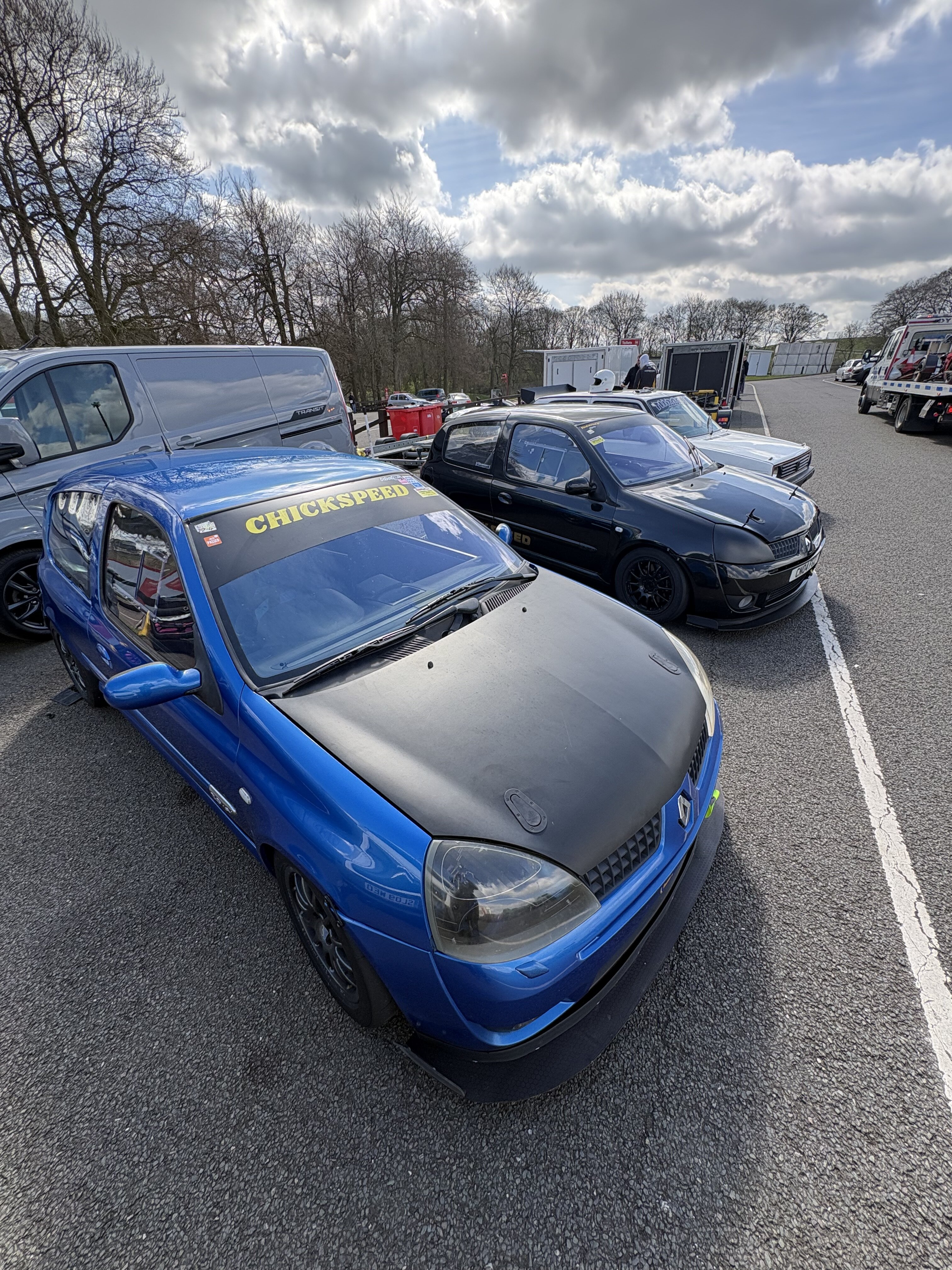

Last of the spring trio of track days…. Cadwell Park.
Was an awesome day, after utilising all the rubber at Mallory, bought some used AR1s (205-50-15 seem to be out of stock at the moment).
Had the trio of us there, Chicken in his 172 and Grizzle in his Golf.
Clio was mint, but think I may have broken an ABS ring as that died in the morning. Managed to get down to a 1:43 lap.
Also bought some awesome polish to clean the Perspex windows, that doesn’t scratch them, VuPlex
Time to mend the ABS and give her a proper little service after Oulton, Mallory and Cadwell.

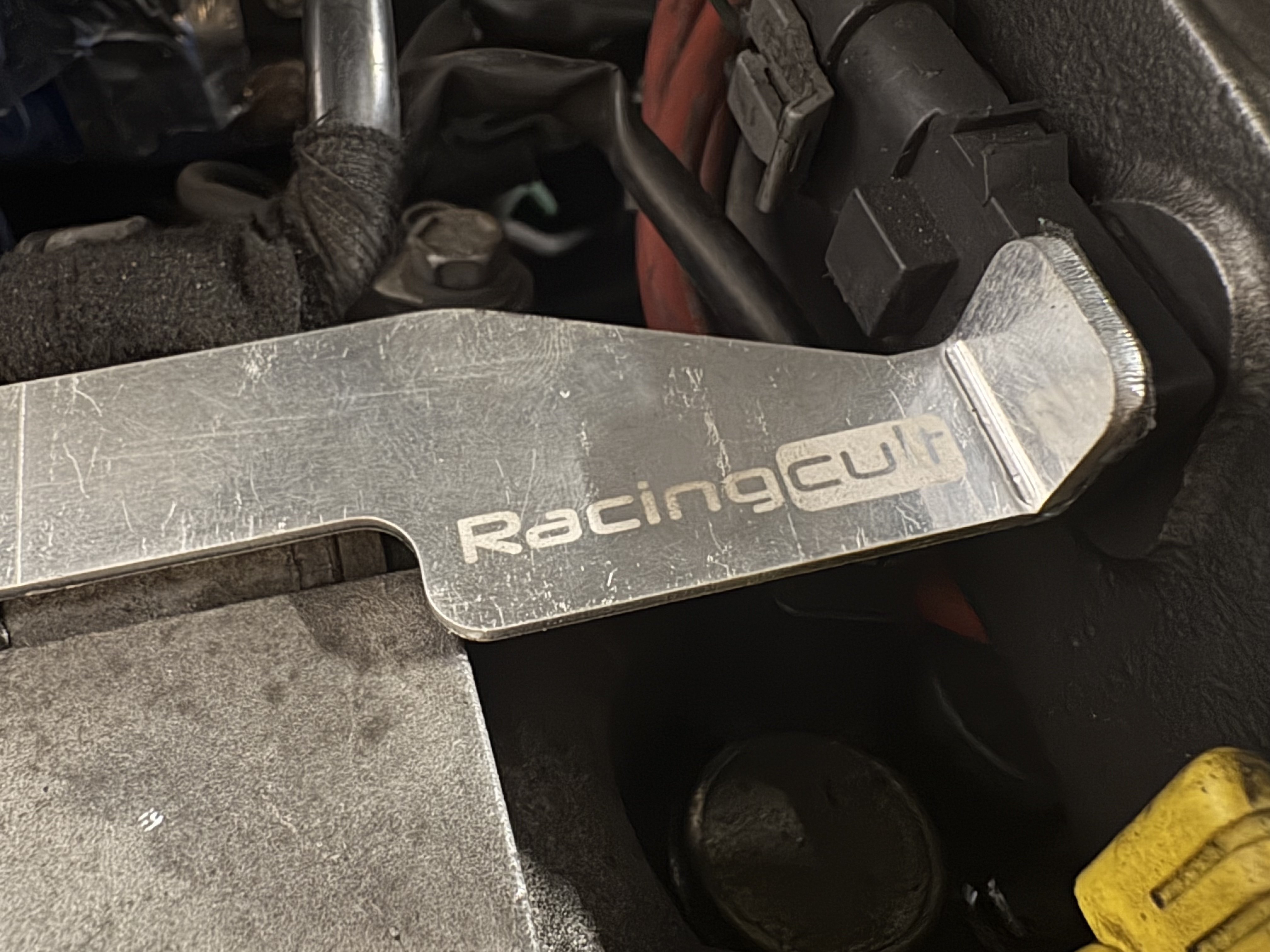

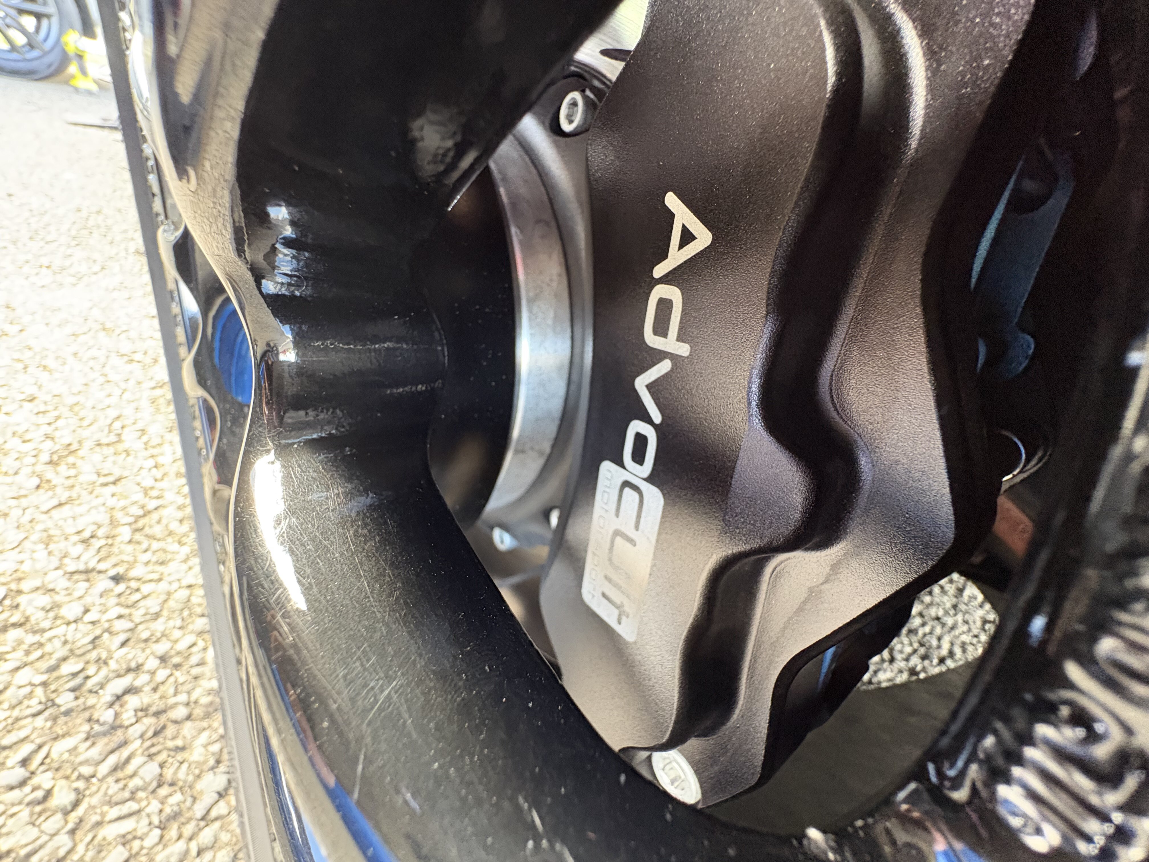

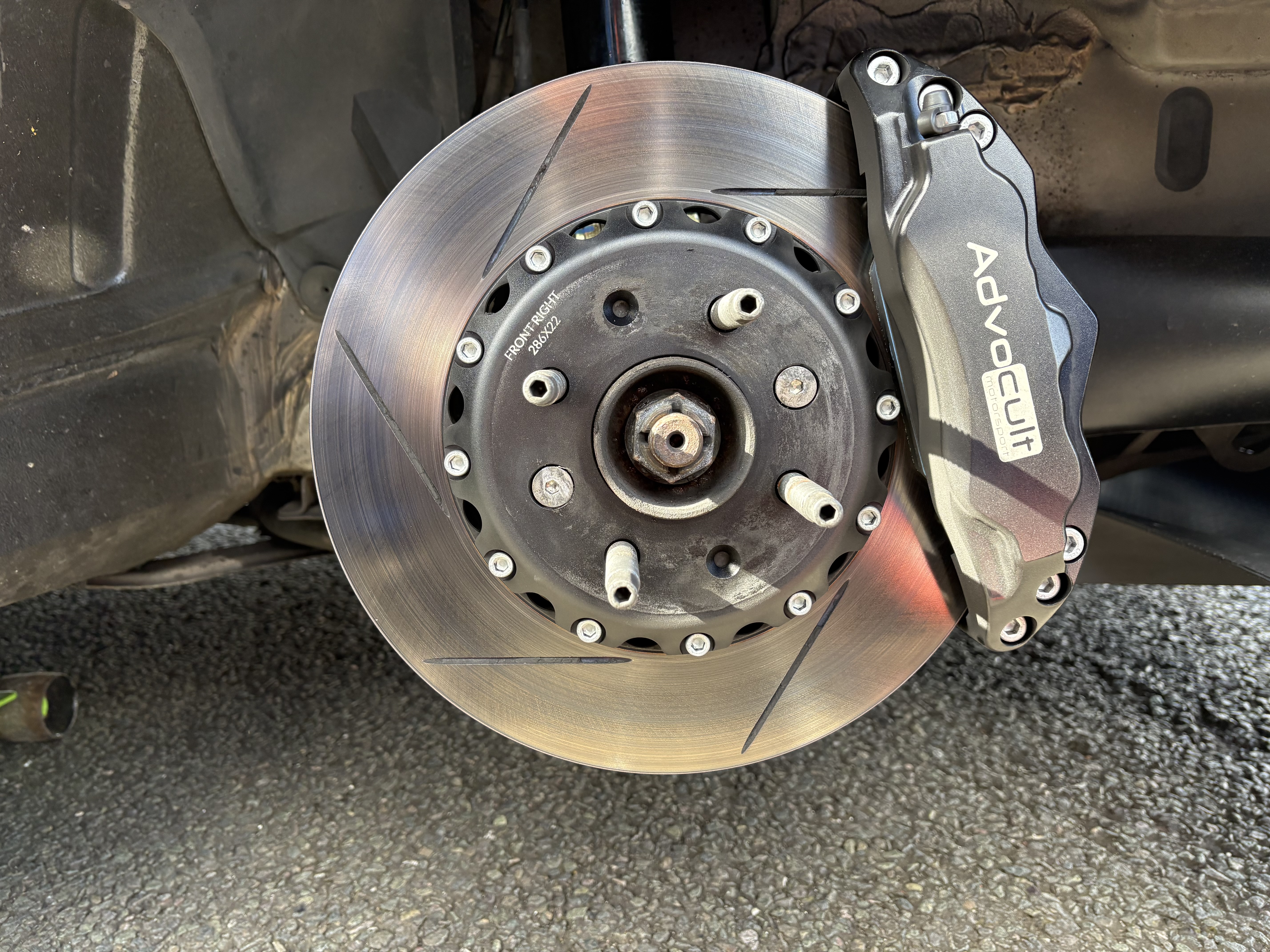

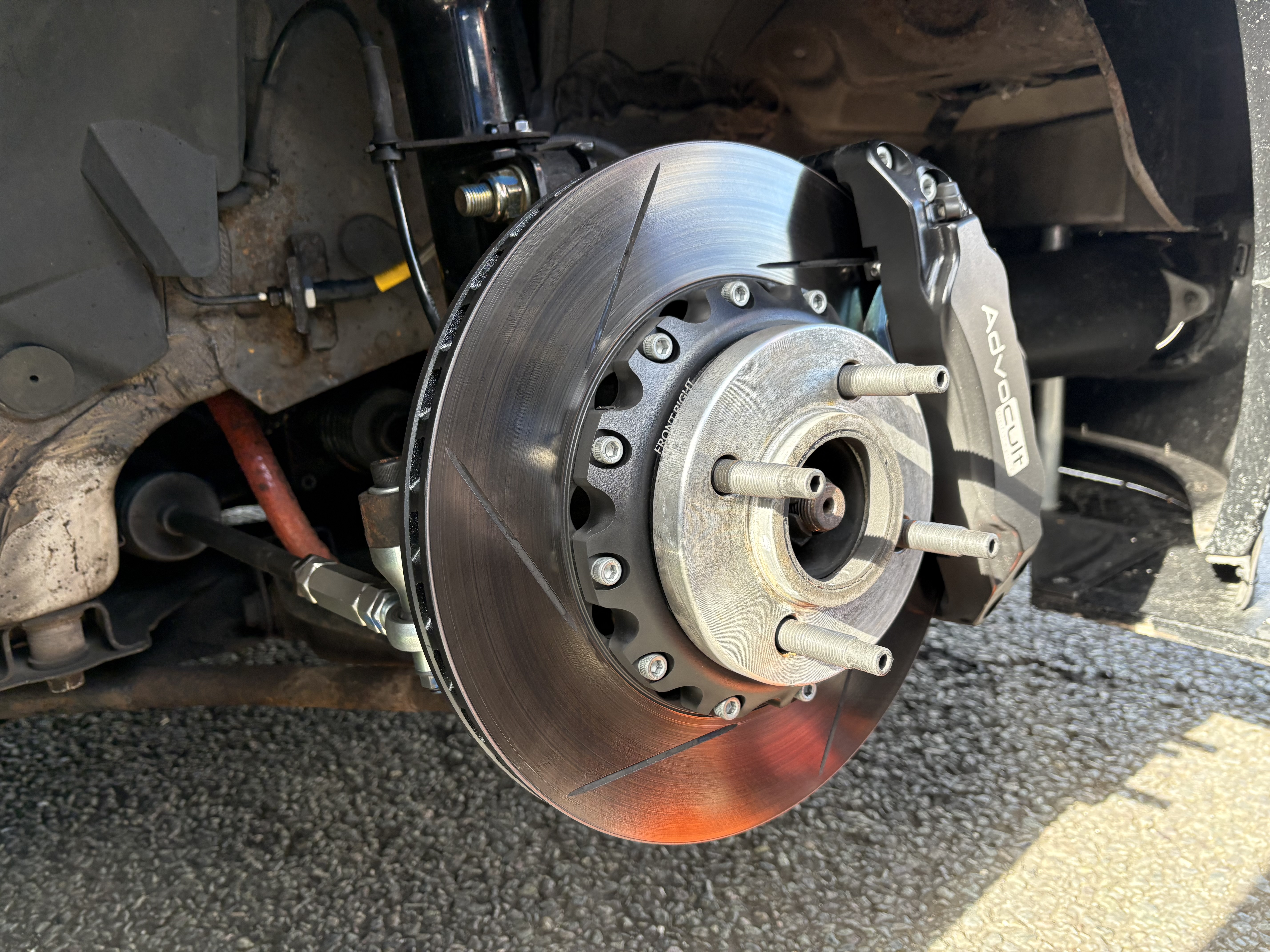

On a side note… Chicken was testing a new brake kit that fits under 15” alloys with no need to machine brackets. Designed with its own discs (with Aluminium carrier)
It’s from Advocult Motorsport. Not on sale yet, as Toms just developing it, but could be mint…

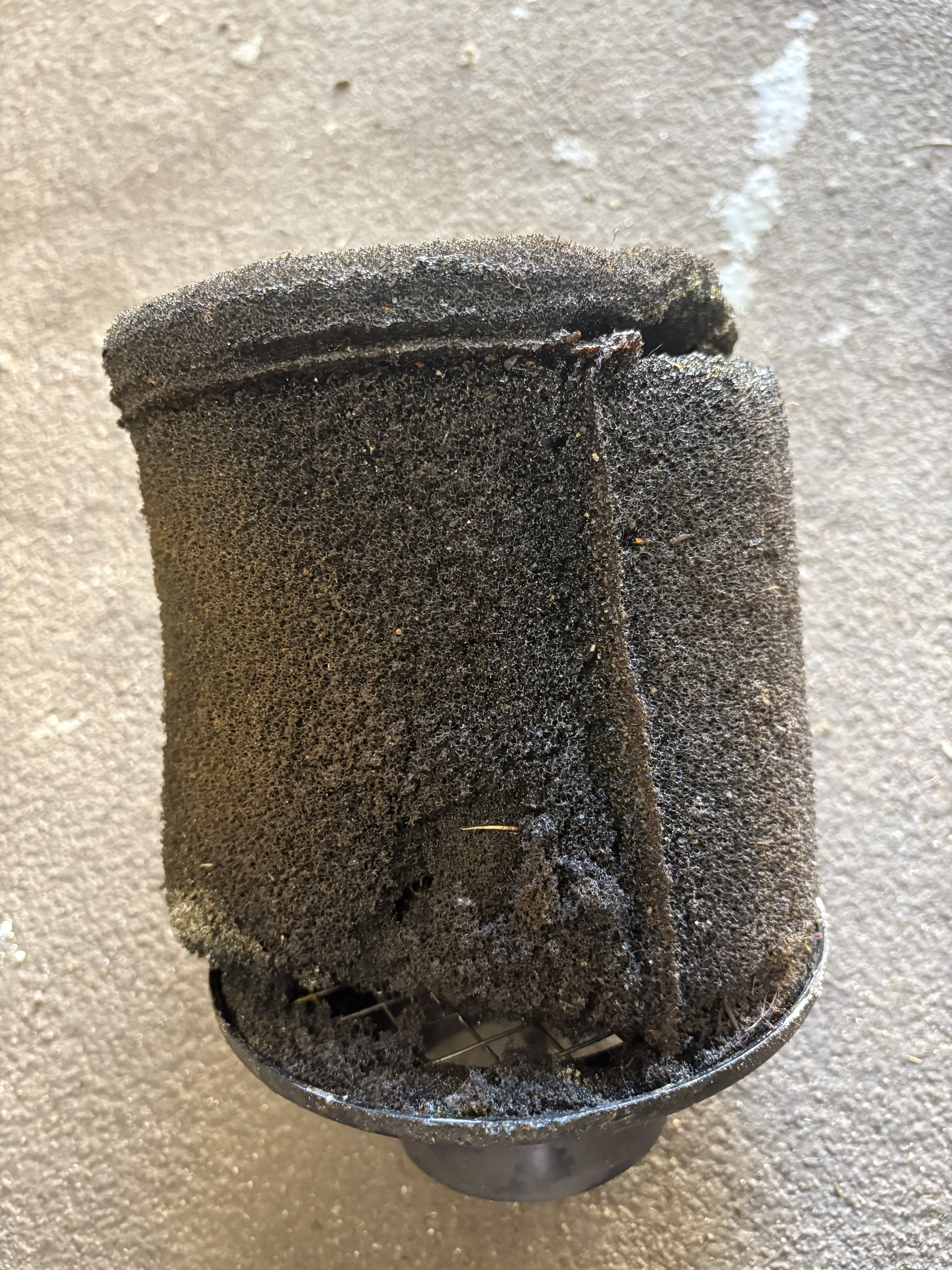

Time for a fresh air filter too… this was worse than I thought. Trip to Advocult Motorsport to pick up a fresh ProRam filter.

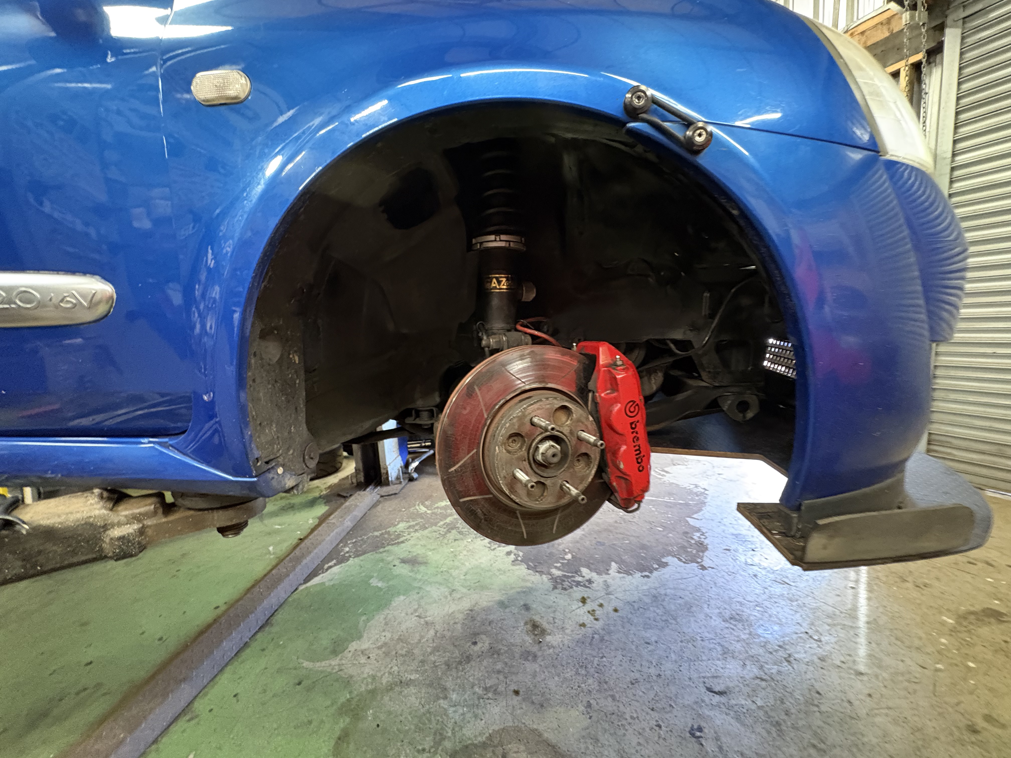

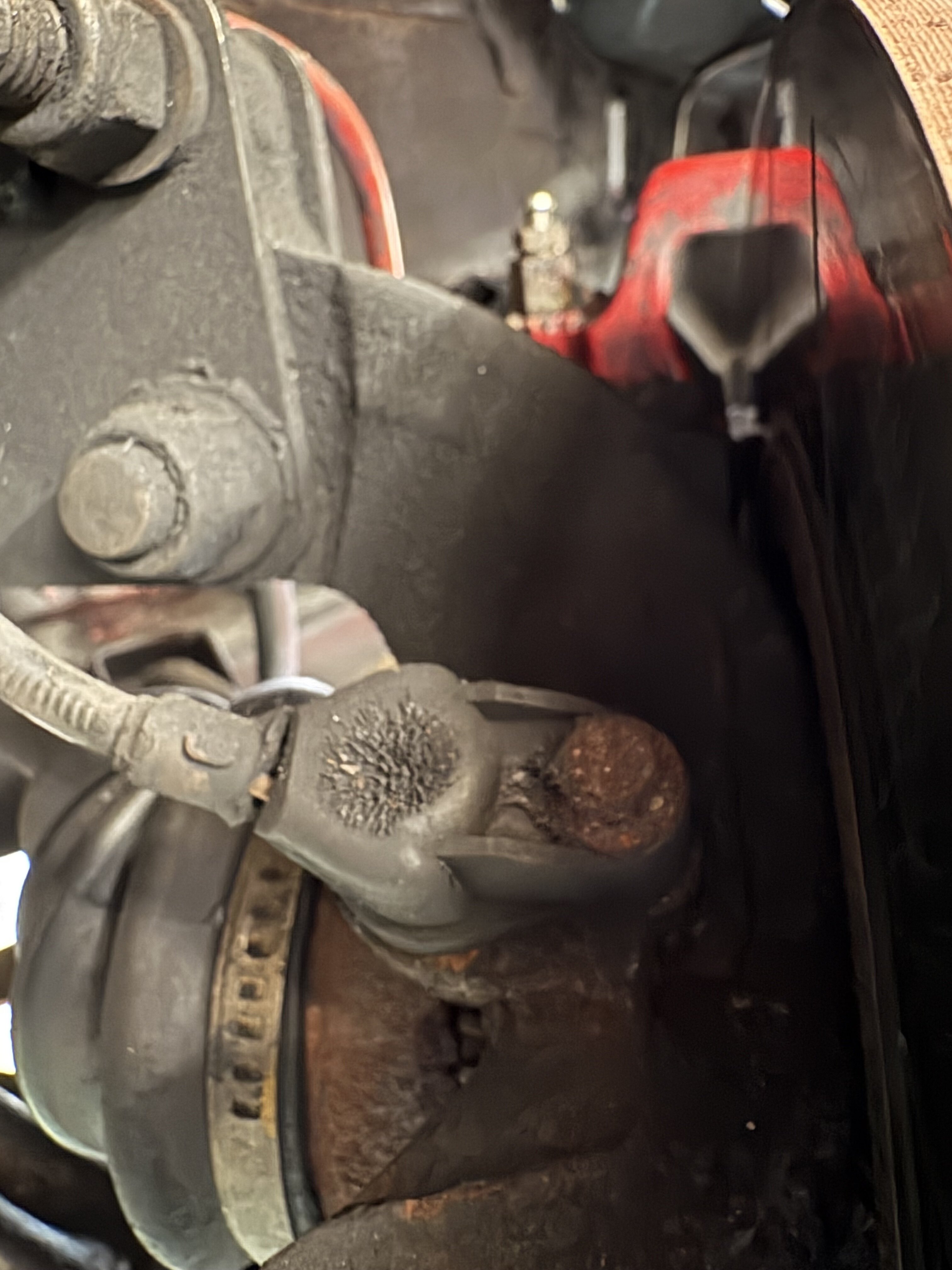

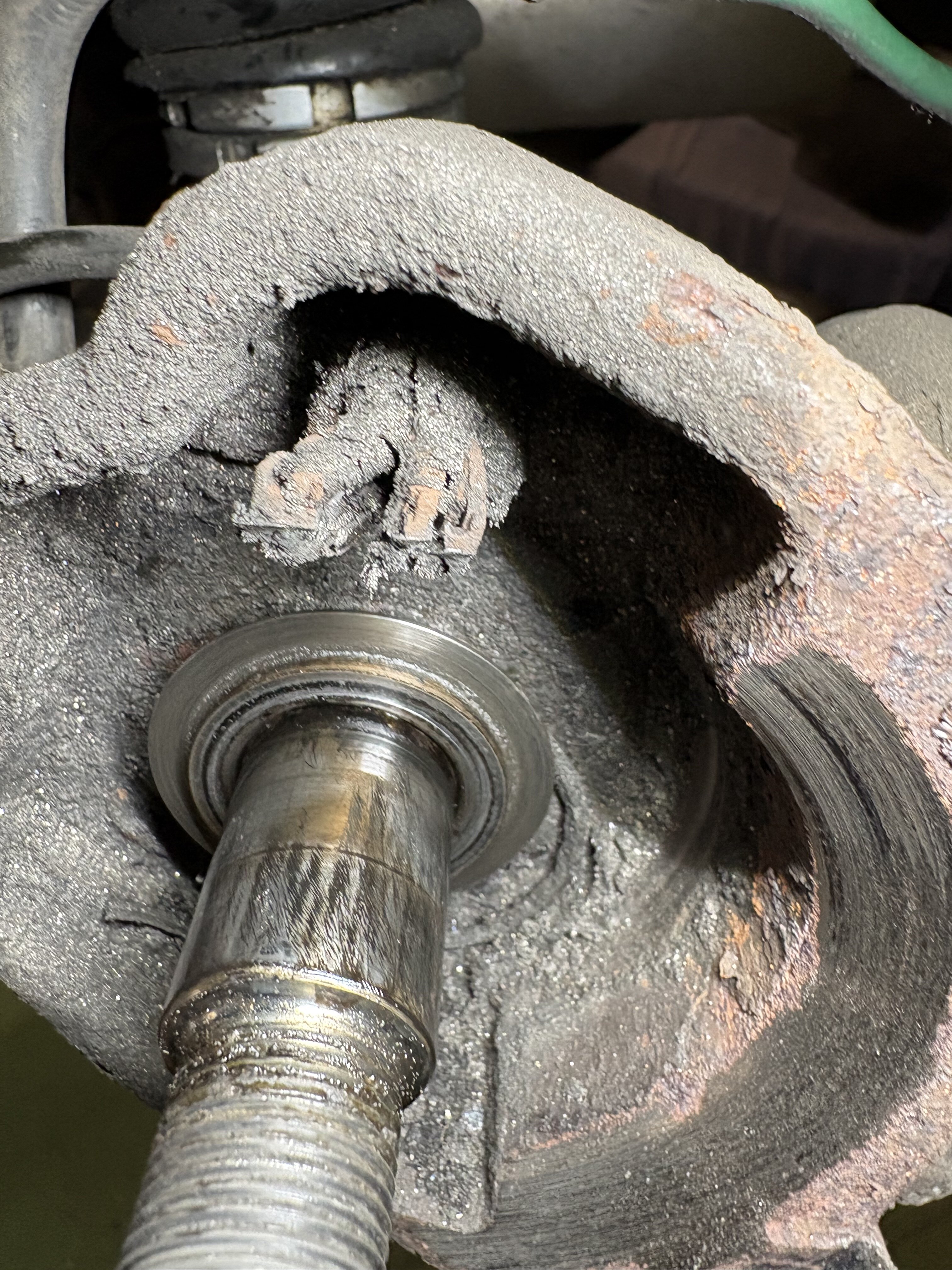

Spent the week diagnosing the ABS fault I had. Found that the front right sensor was damaged, turned out that wasn’t the issue. Stripped the rears to check and found The rear PS hub had been eating itself (maybe a casualty from a little sideways action at Oulton).
So replaced the Stub axel, hub, disc, and everything in that corner.

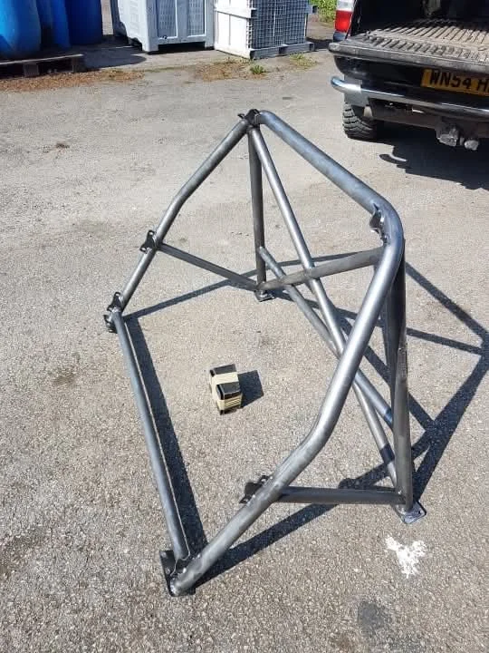

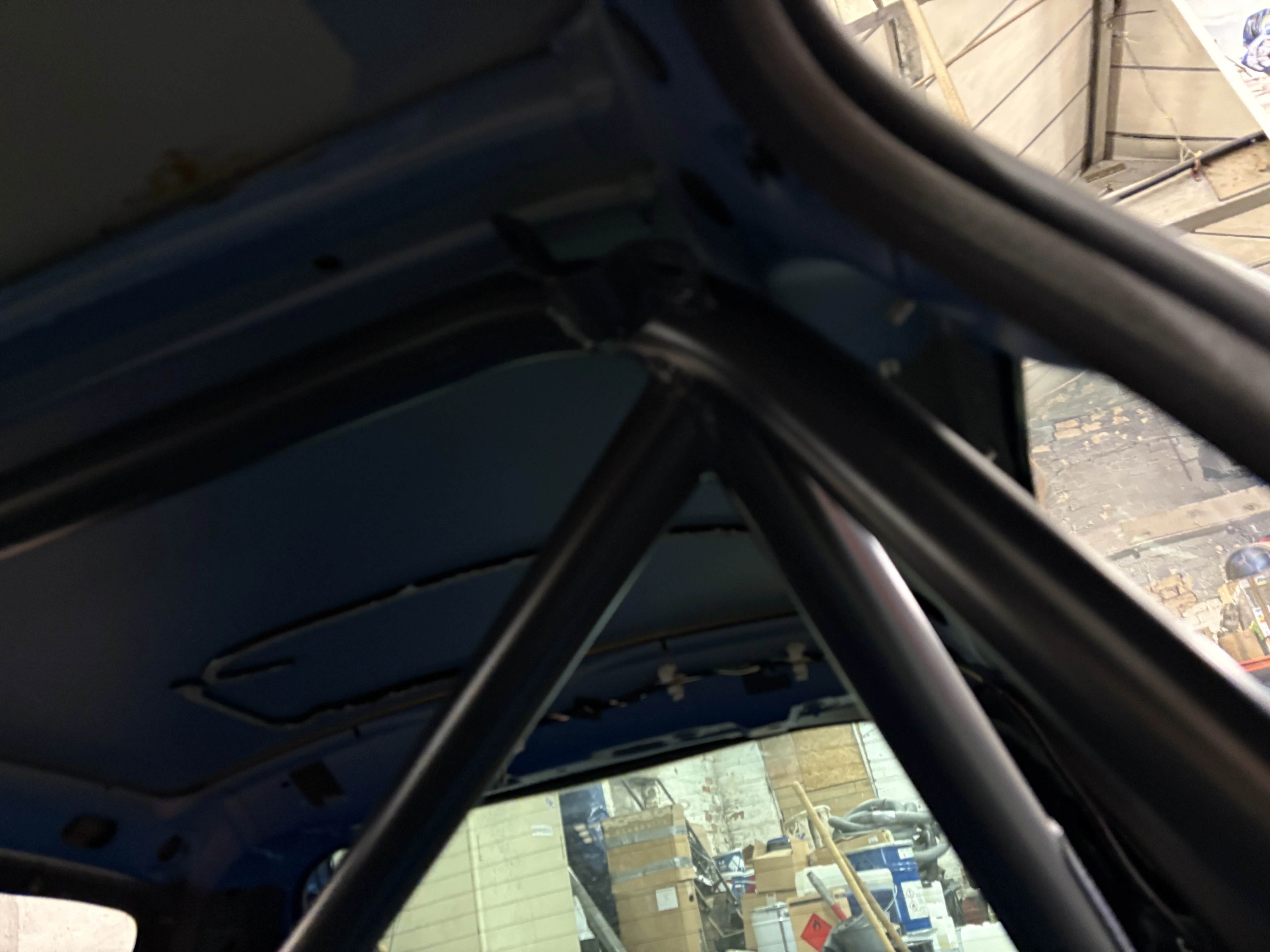

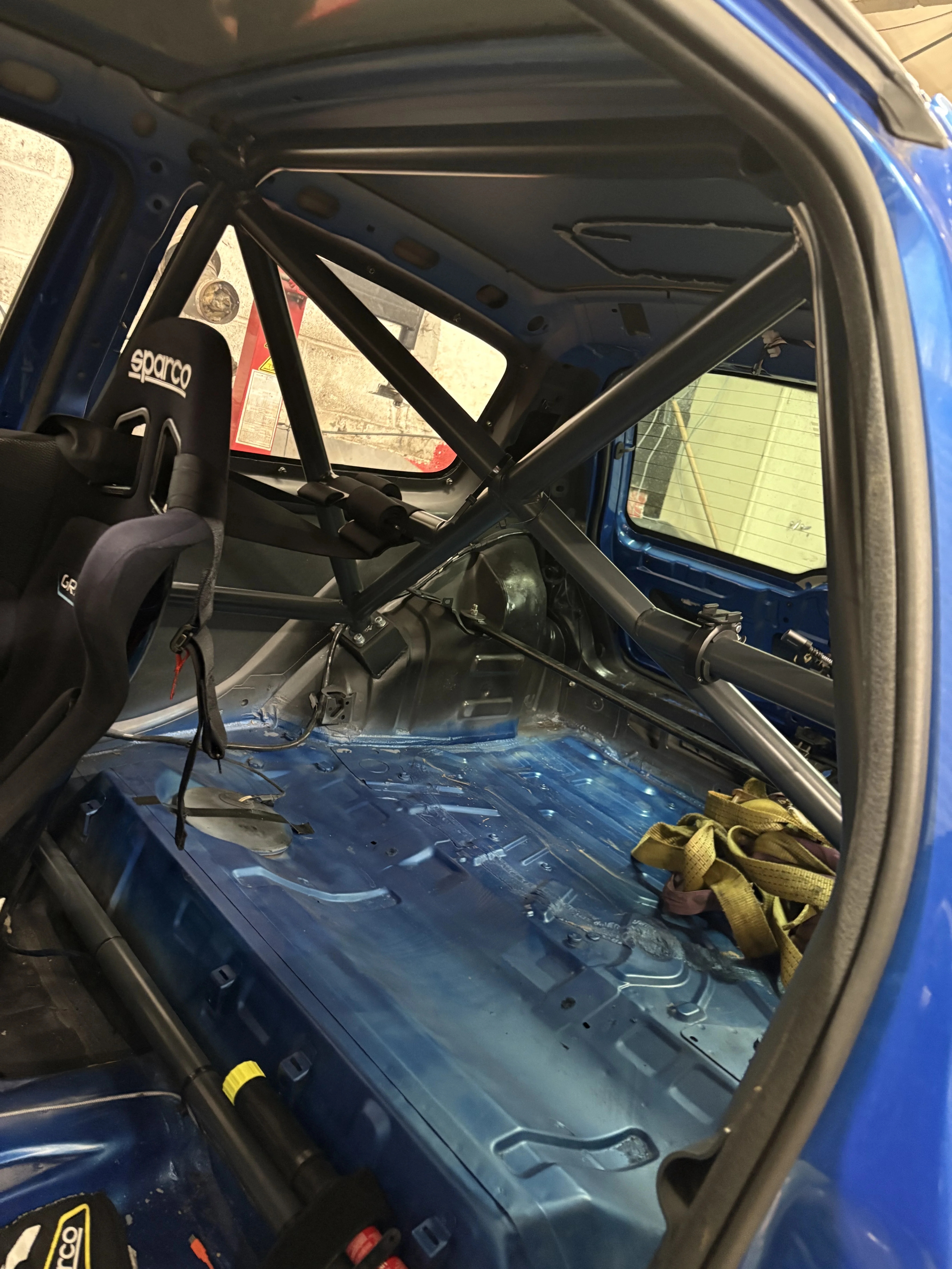

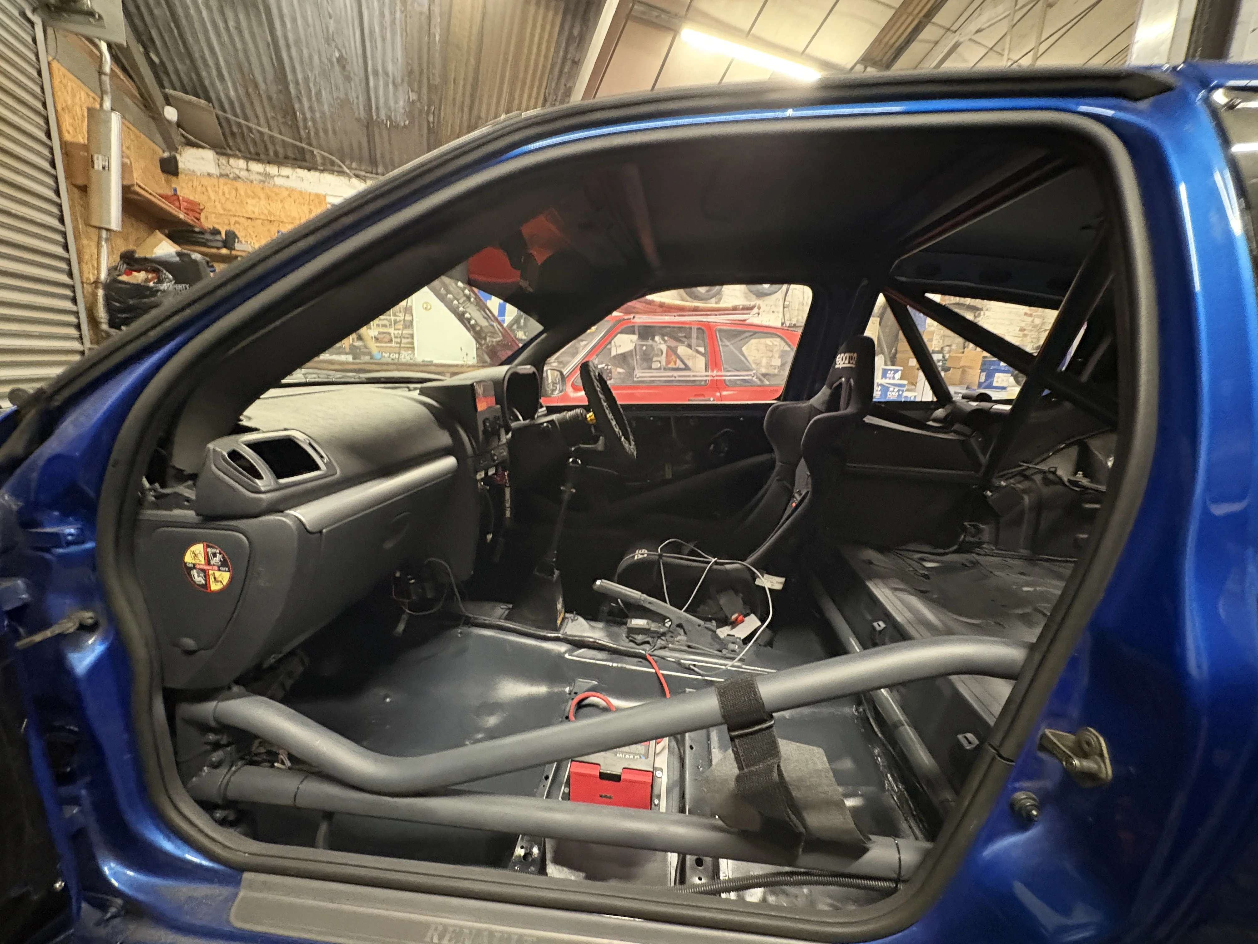

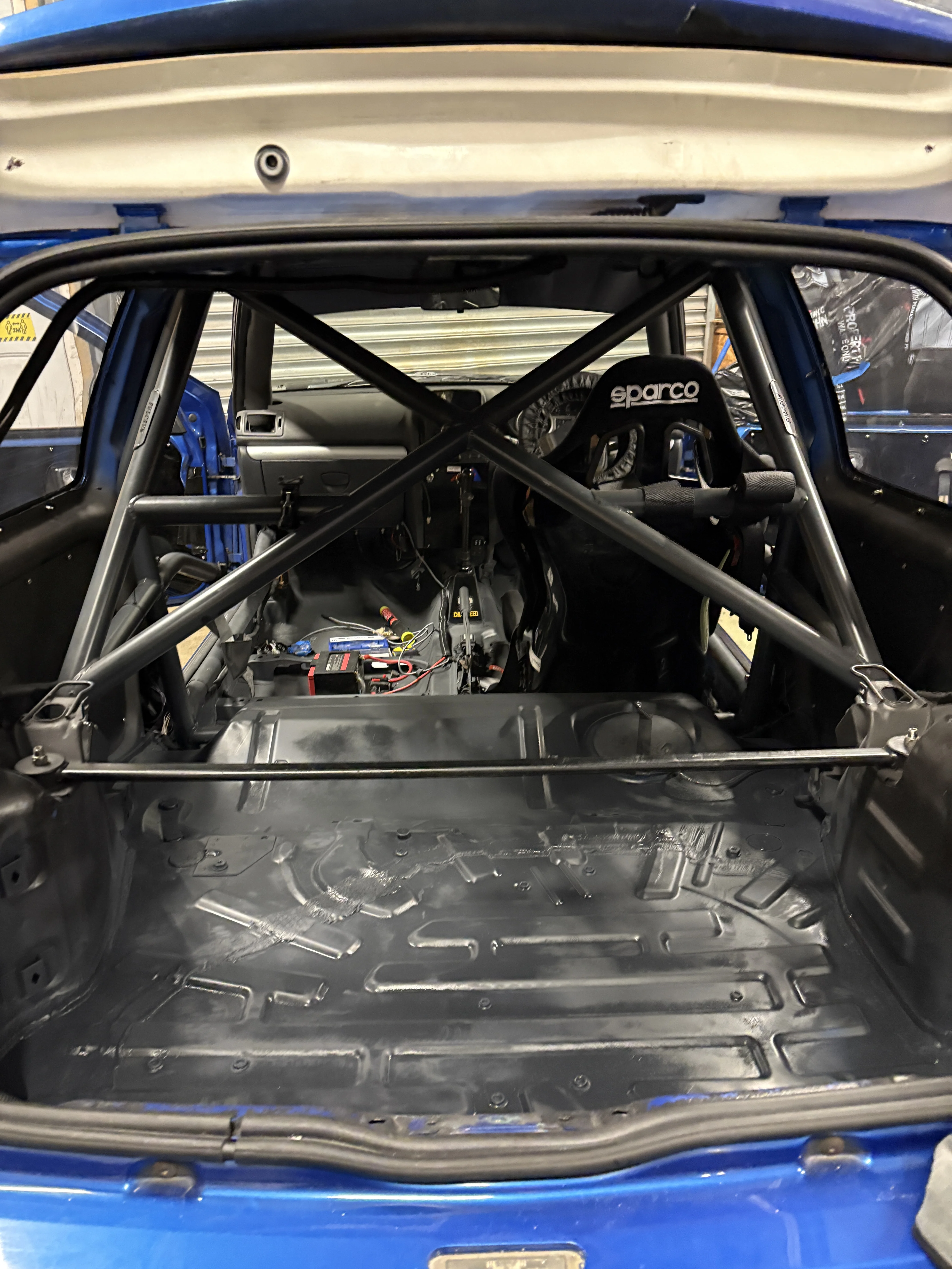

looking at adding the front if the roll cage. Unfortunately Fulcrum Motorsport no longer make cages and so it’s a little challenging to sure more the front part of the cage.
Keep these here or the rear cage for future reference.

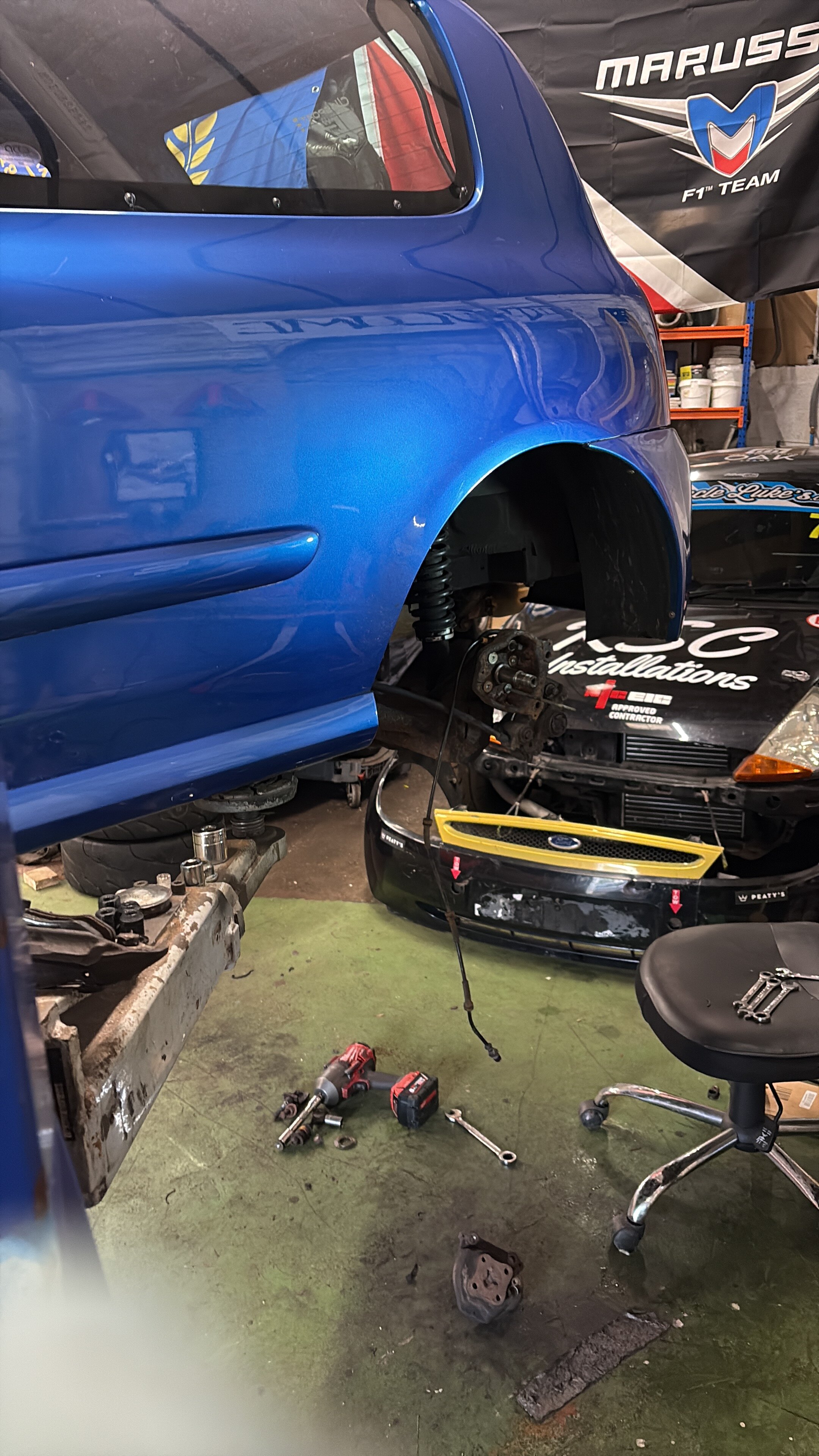

Bit of TLC for the car before fitting the front cage.

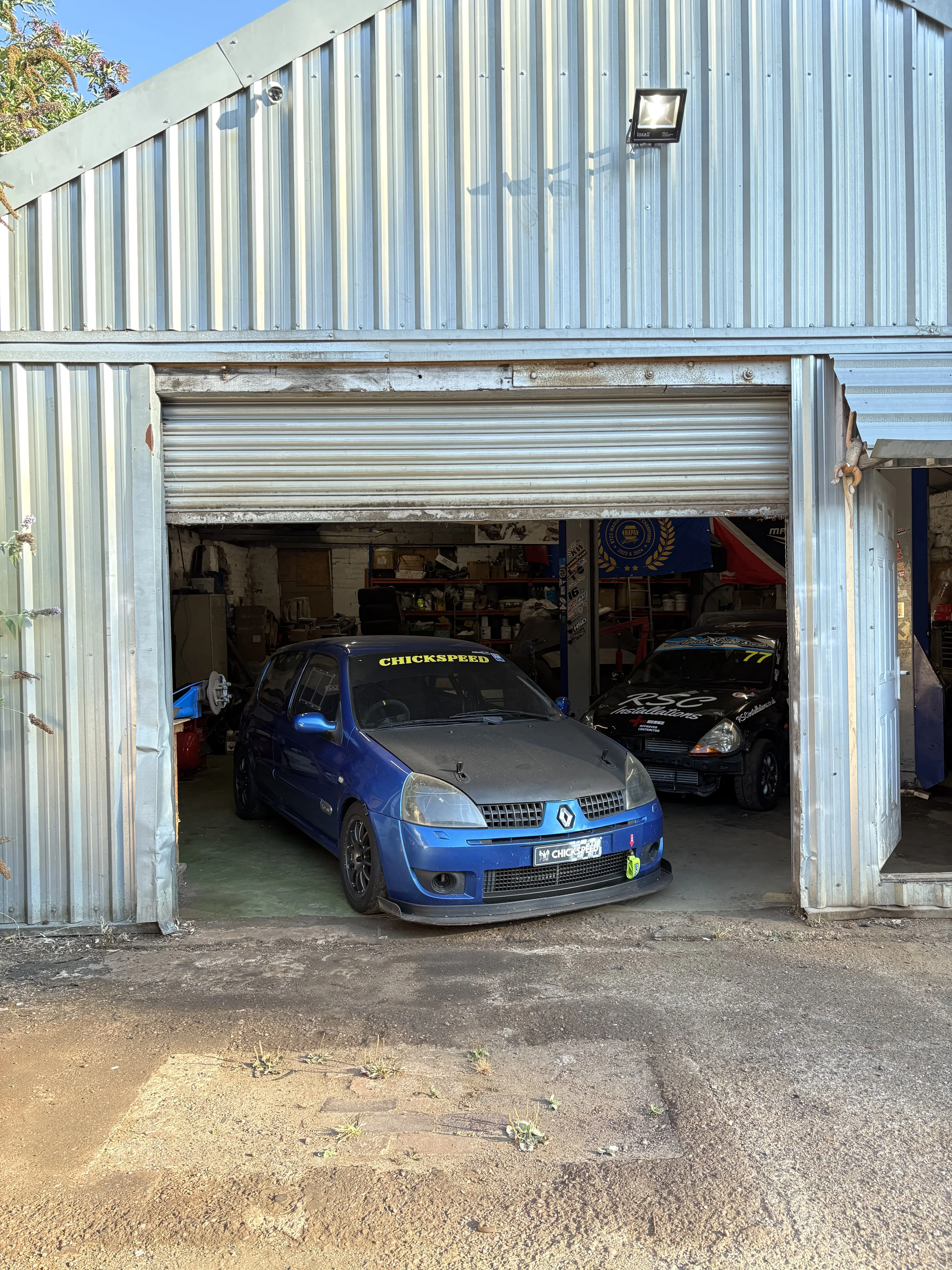

Dropped the Clio to Mark at Lloyd Motorsport in Kidderminster who’s going to do the job. What a fella! Passionate about his Renaults and his work seems great!

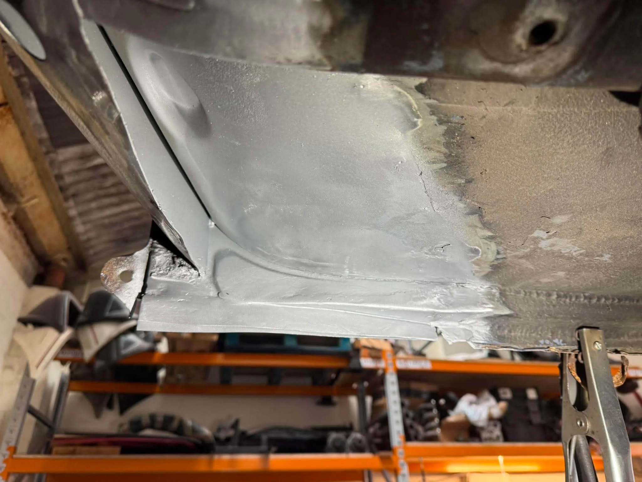

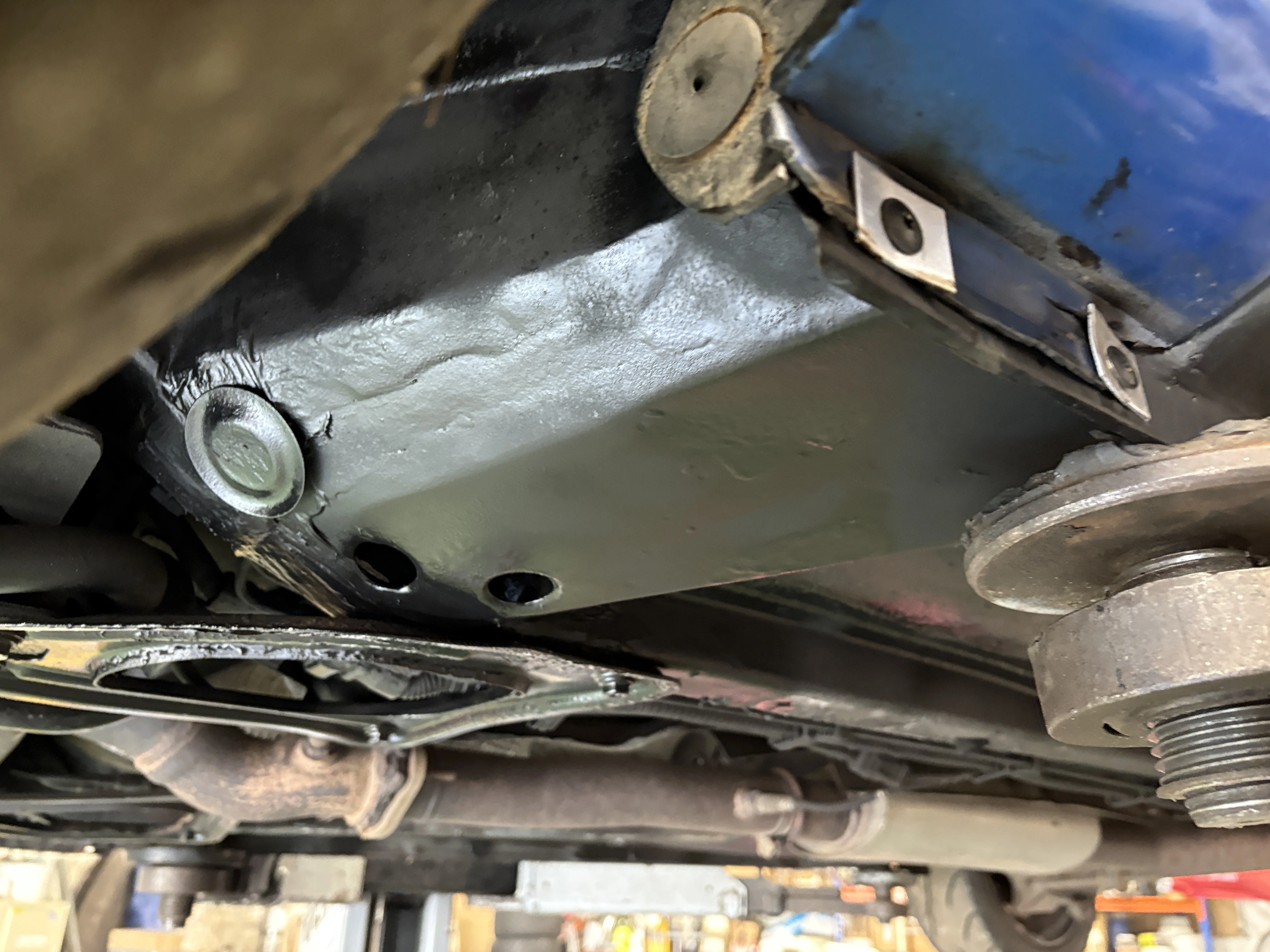

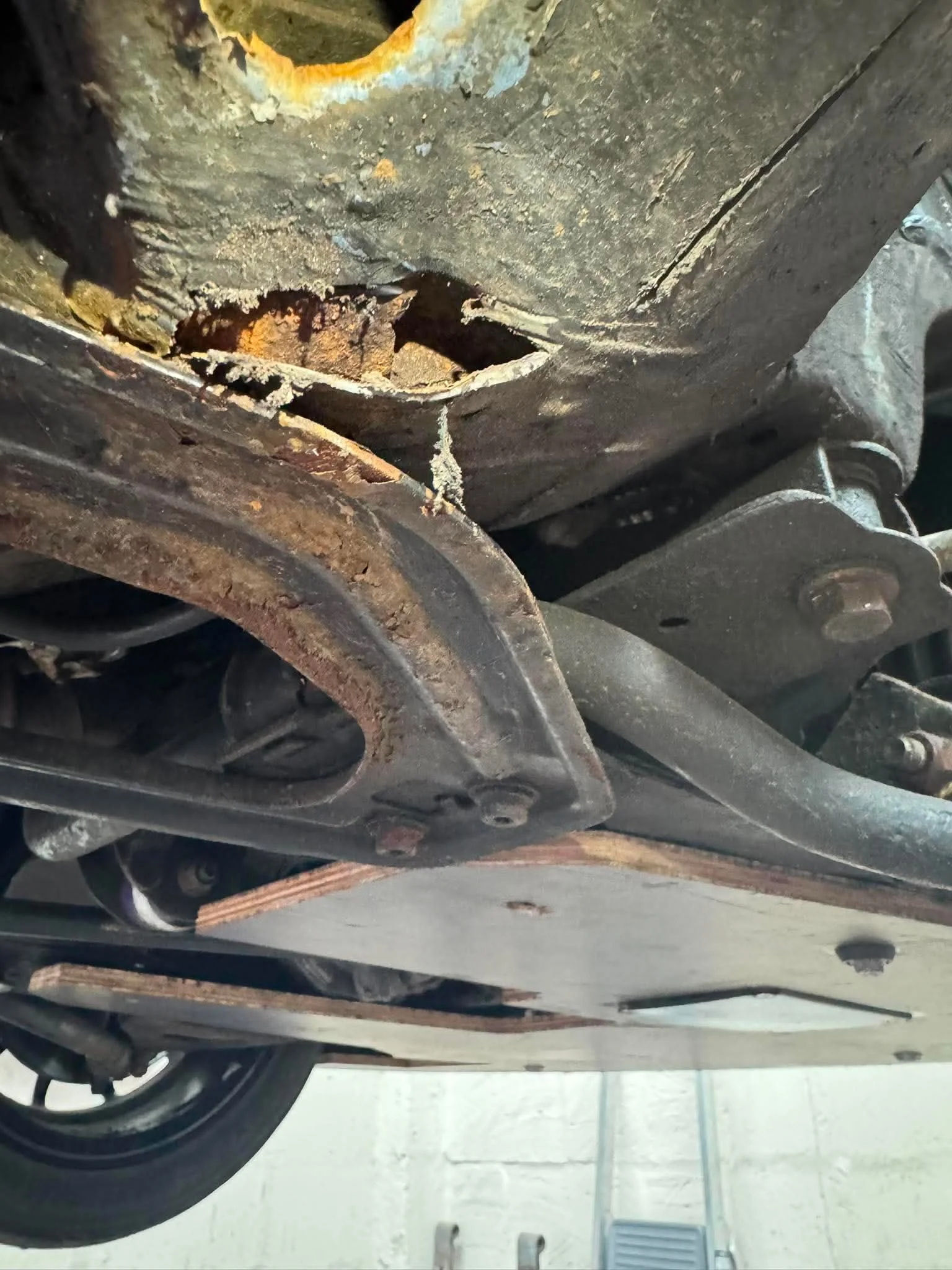

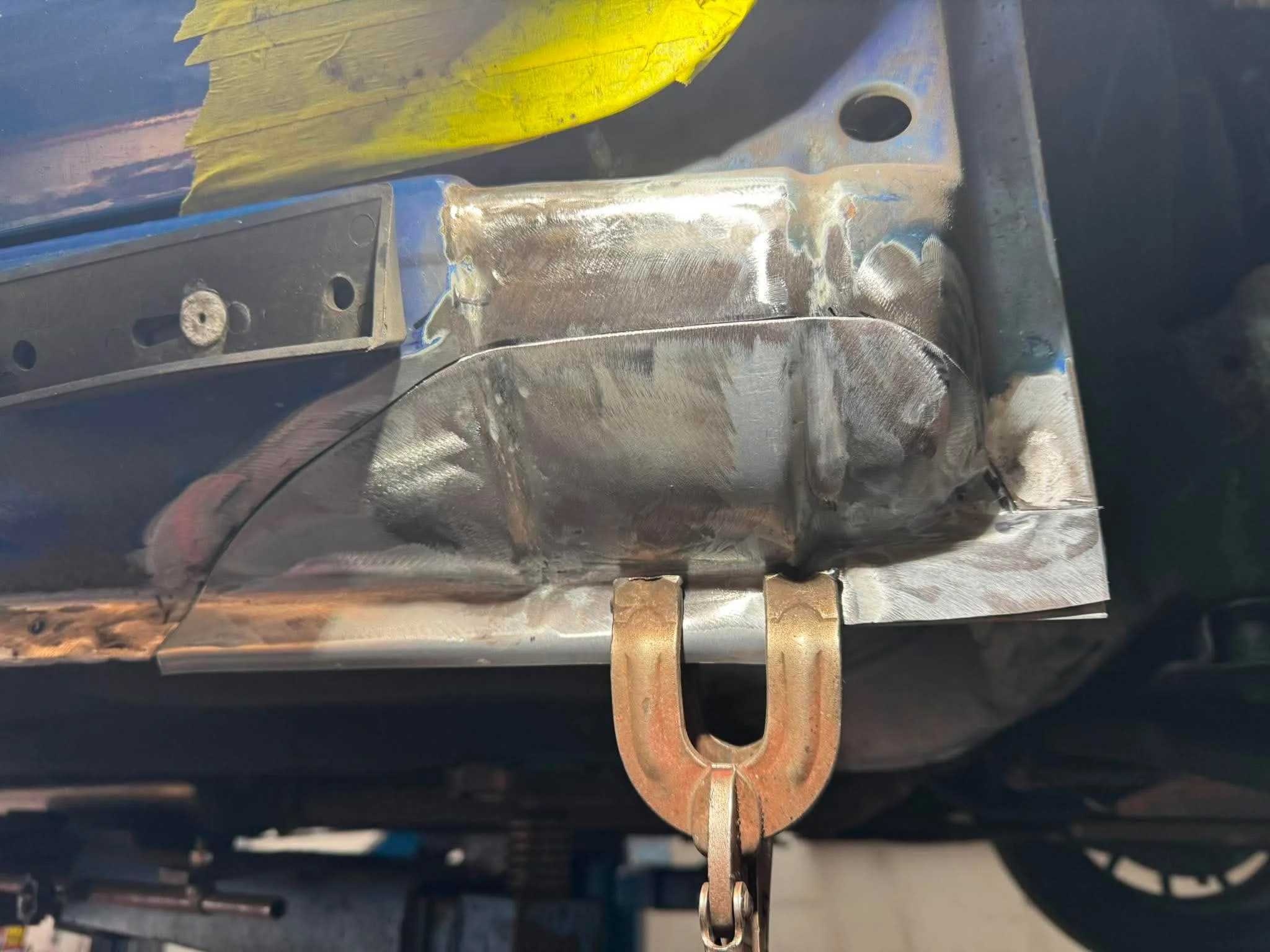

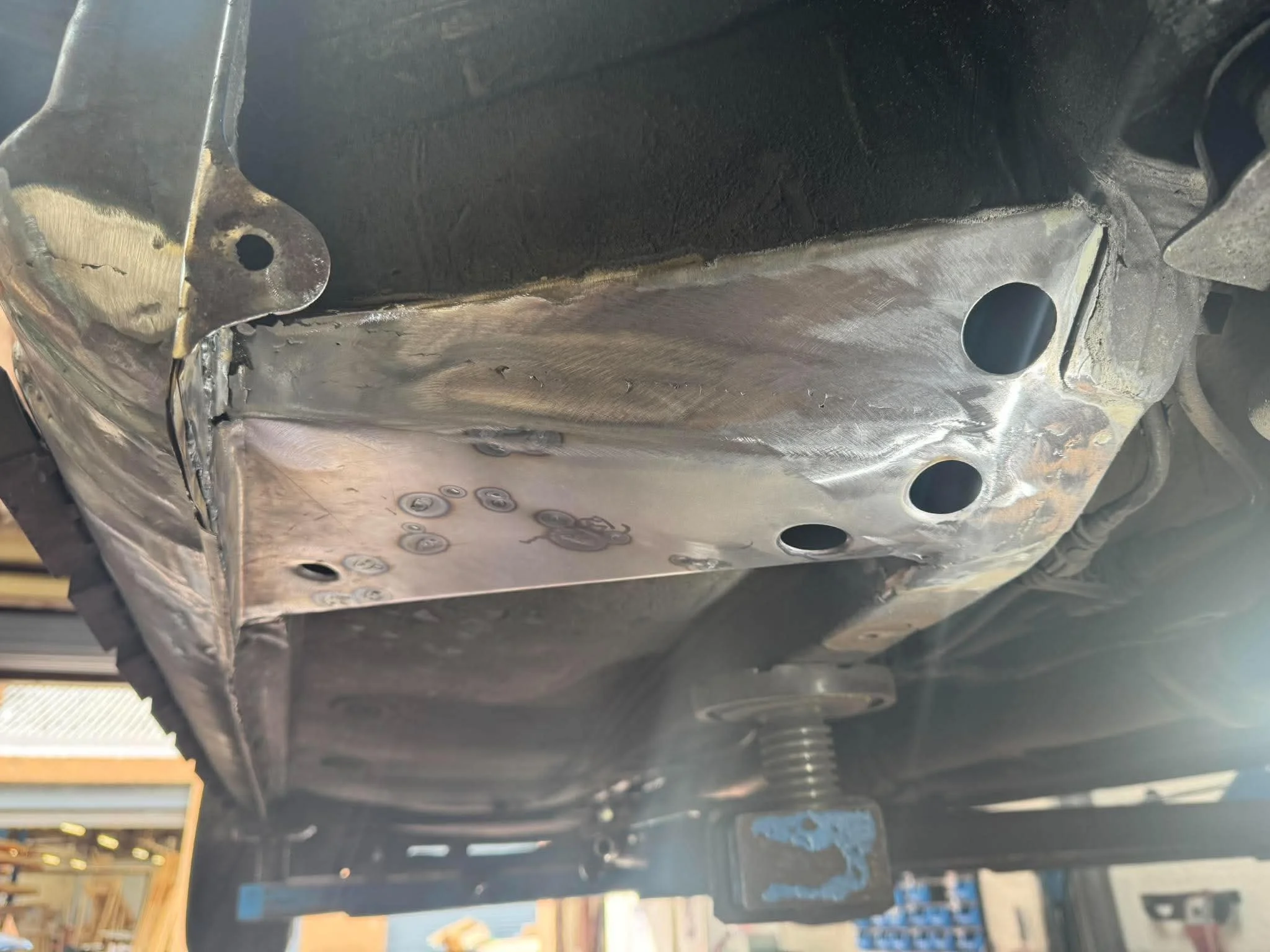

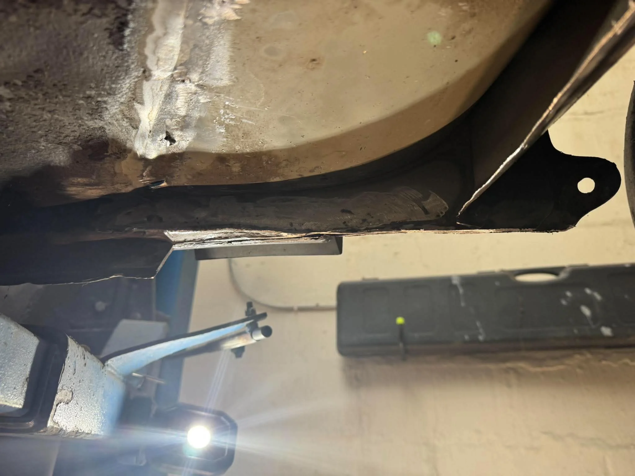

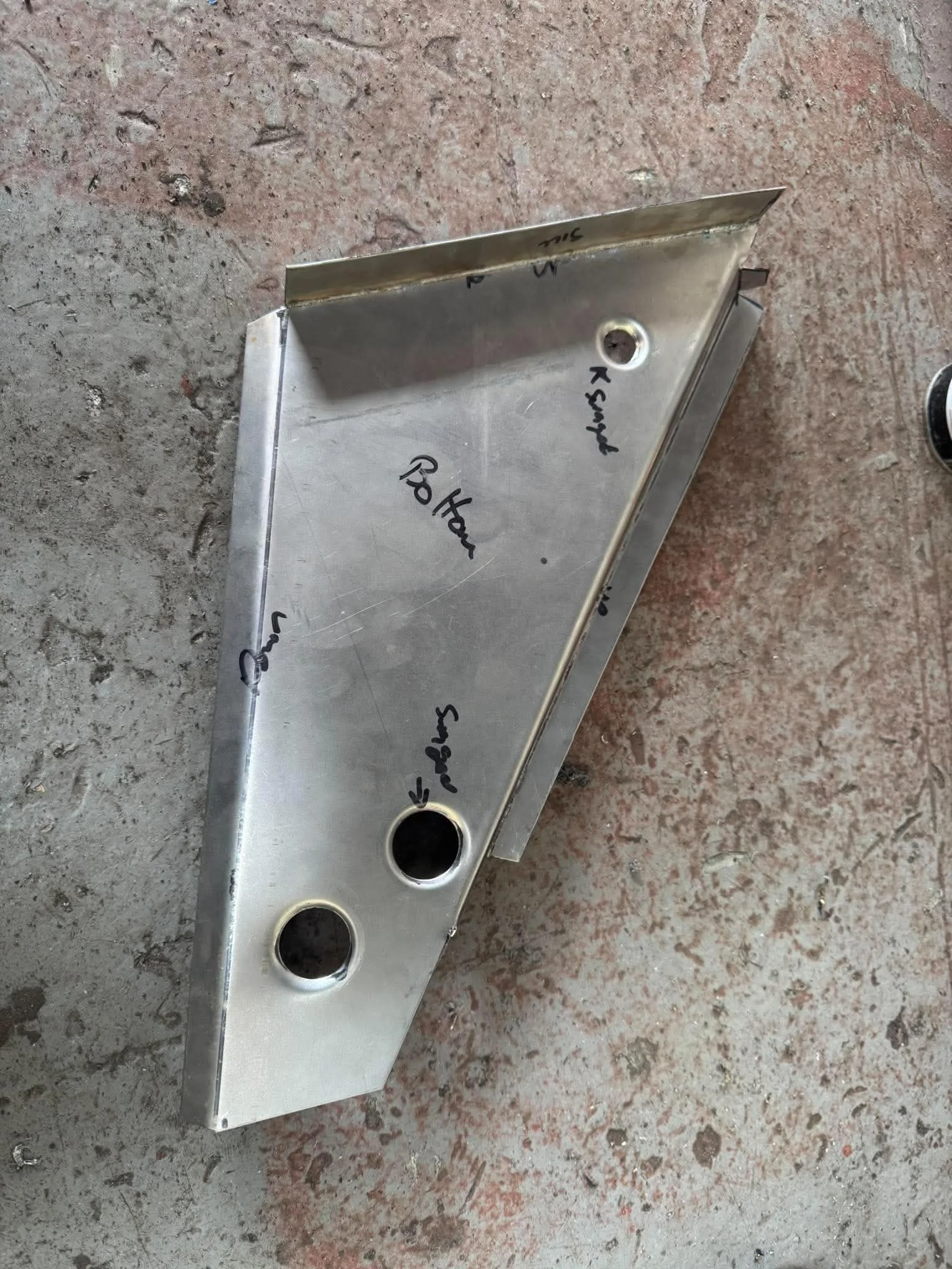

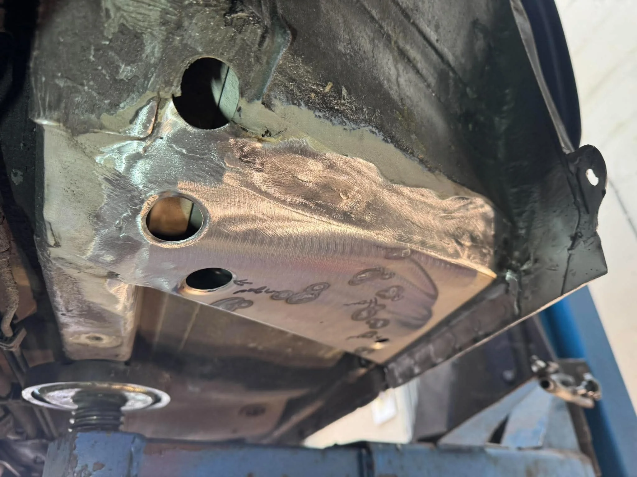

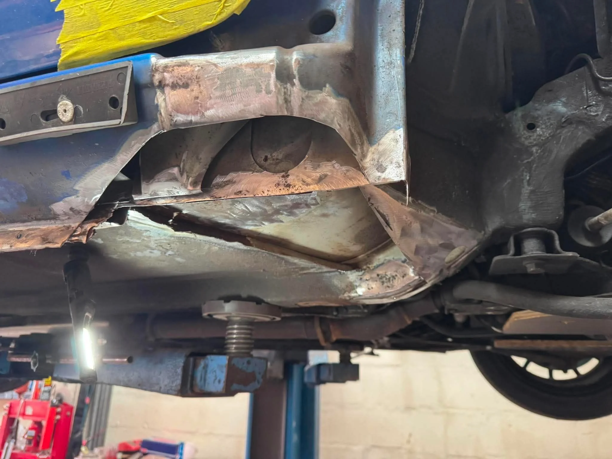

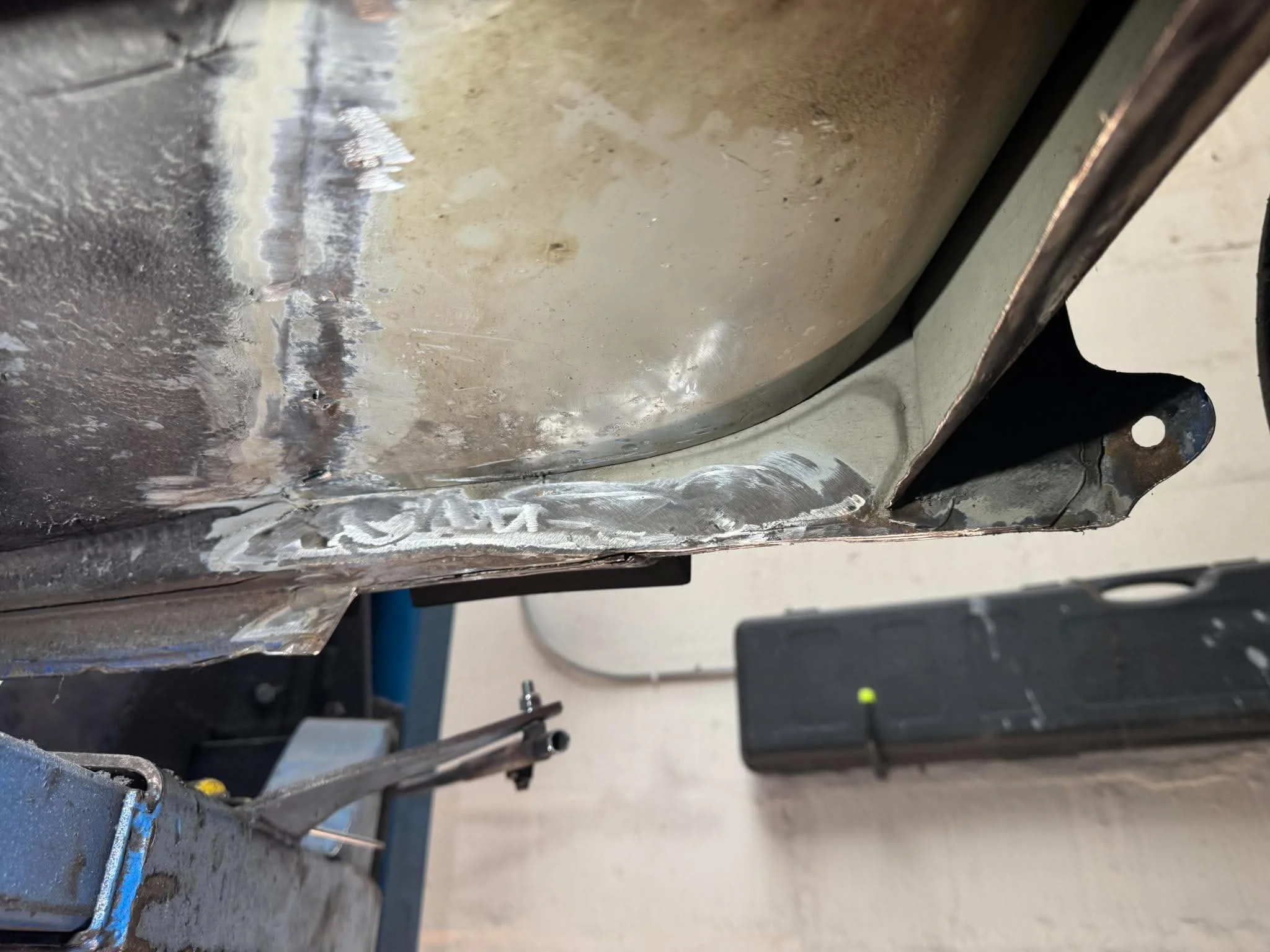

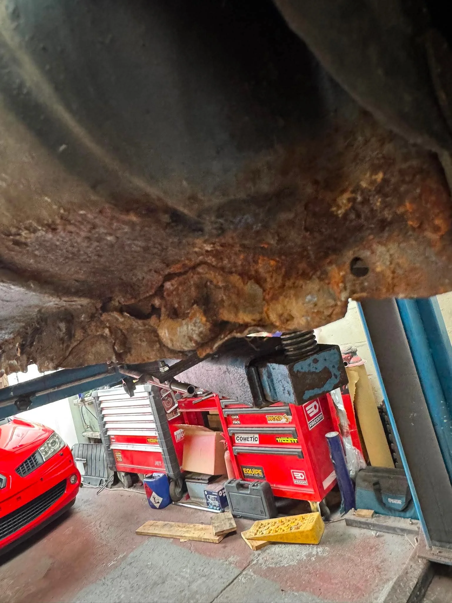

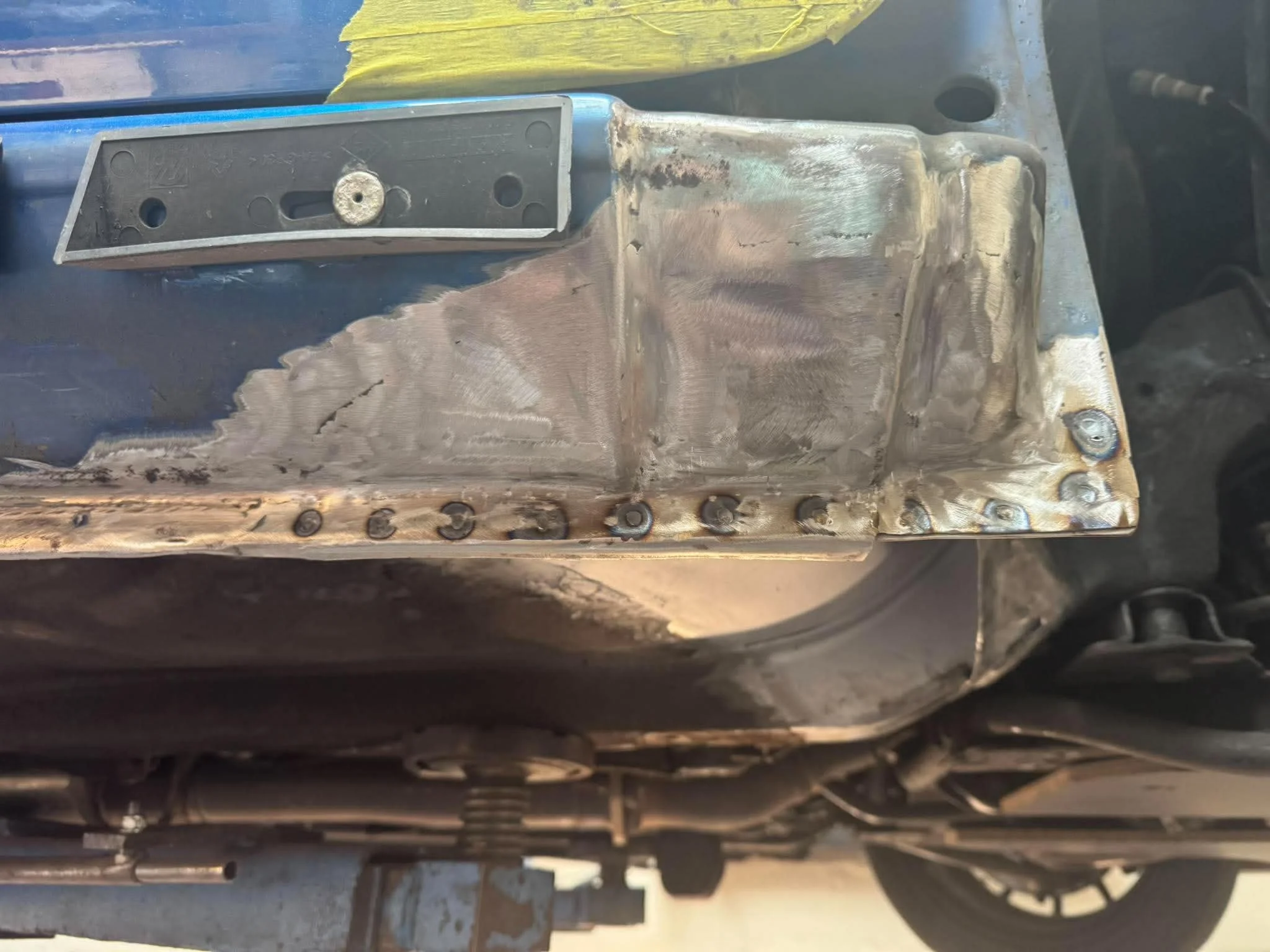

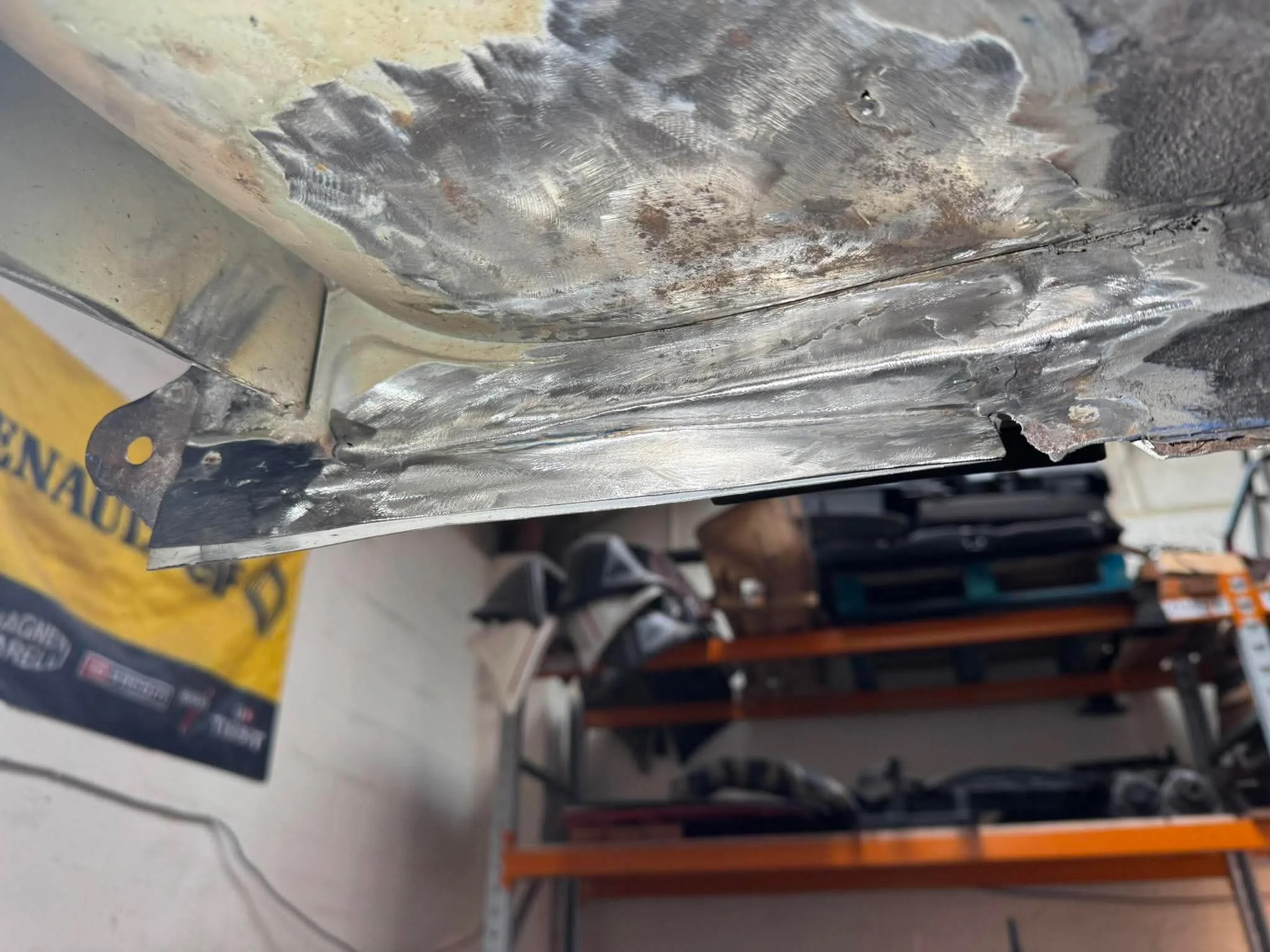

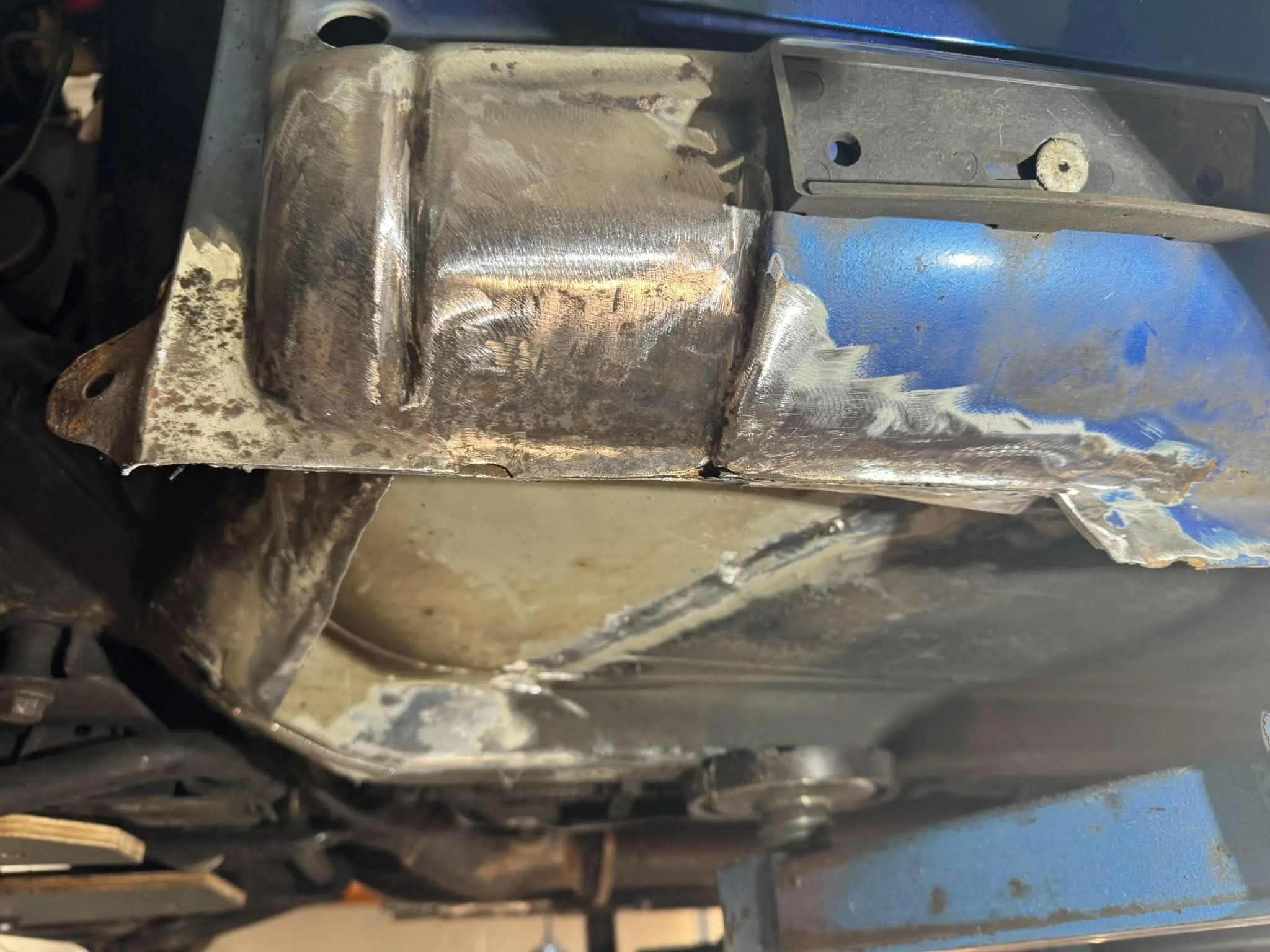

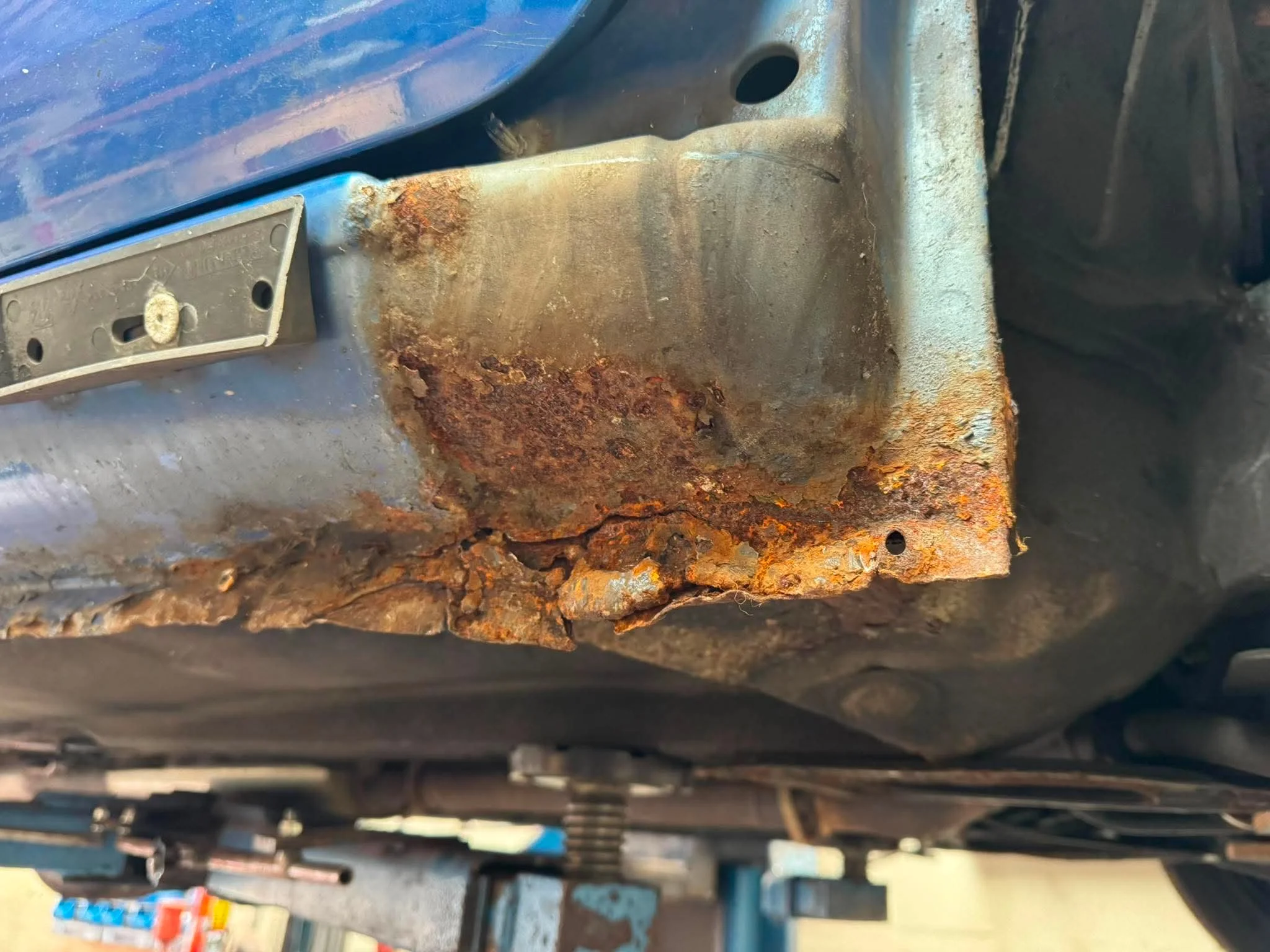

Before fitting the front cage, mending the jacking points and rust. Was a bit messy under there.
All cut out and new metal put in:
Thanks Lloyd Motorsport!!!

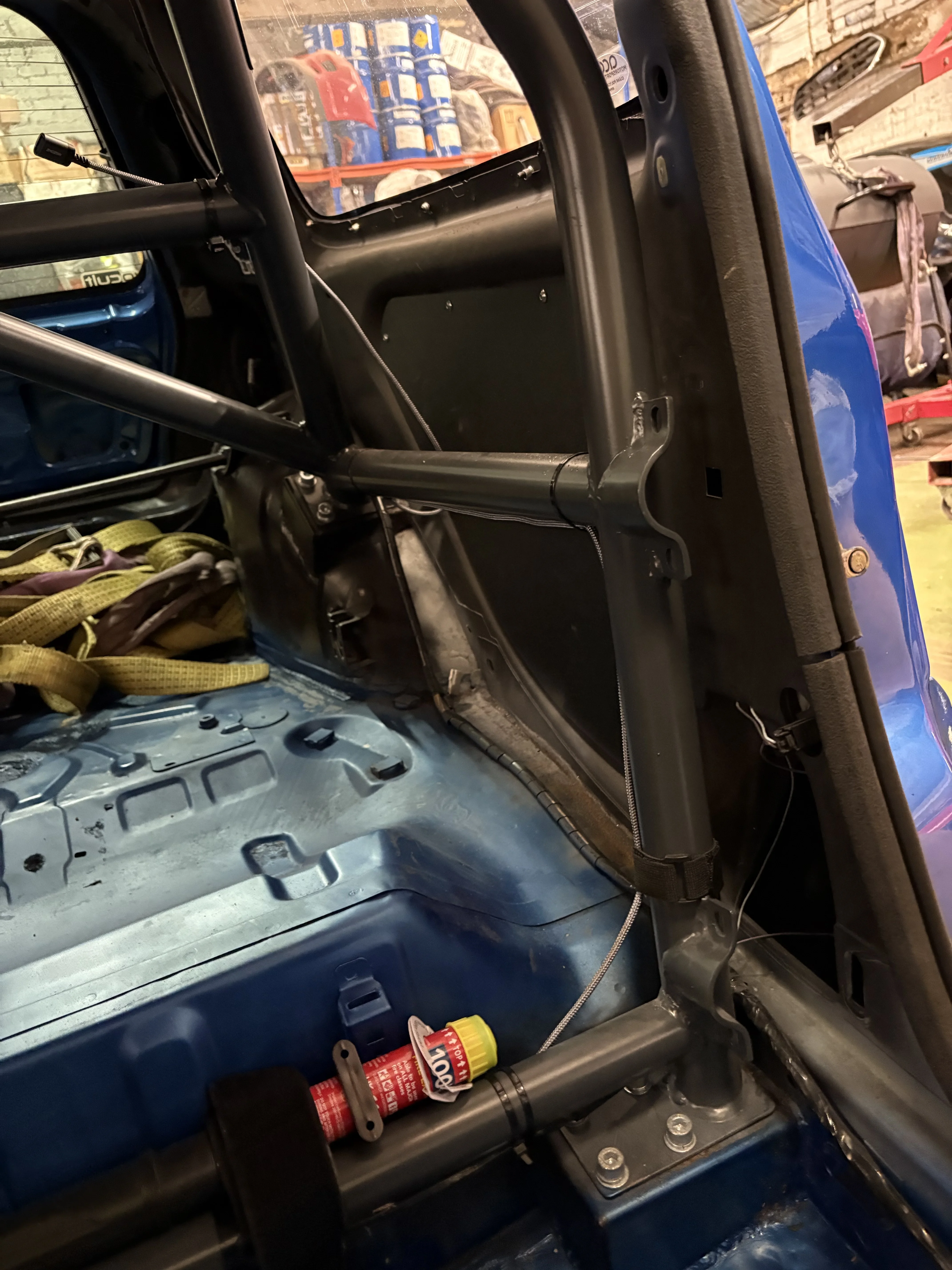

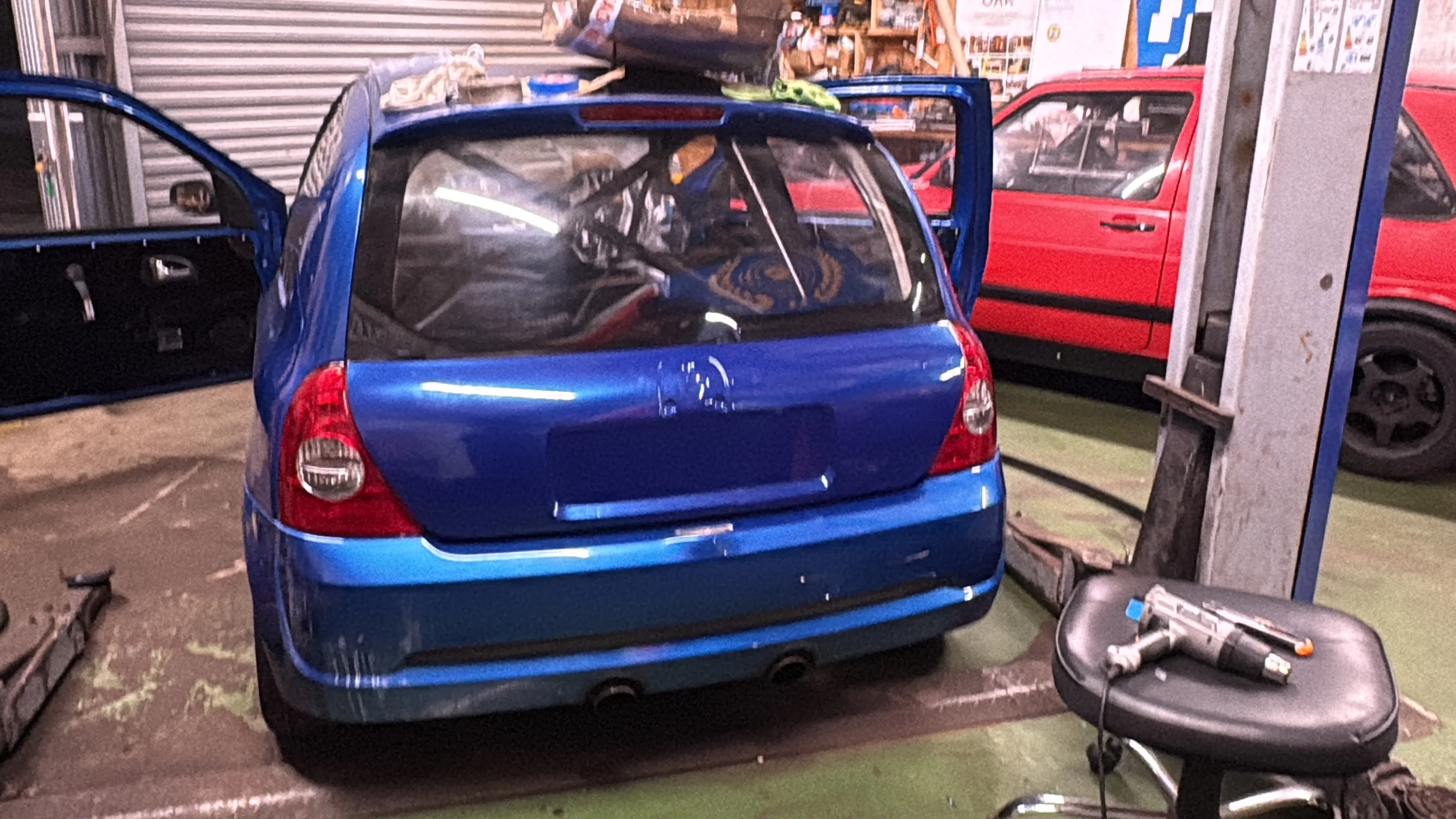

Day taking things out and putting them back in.
Dash trimmed to fit the cage and floor and cage part painted

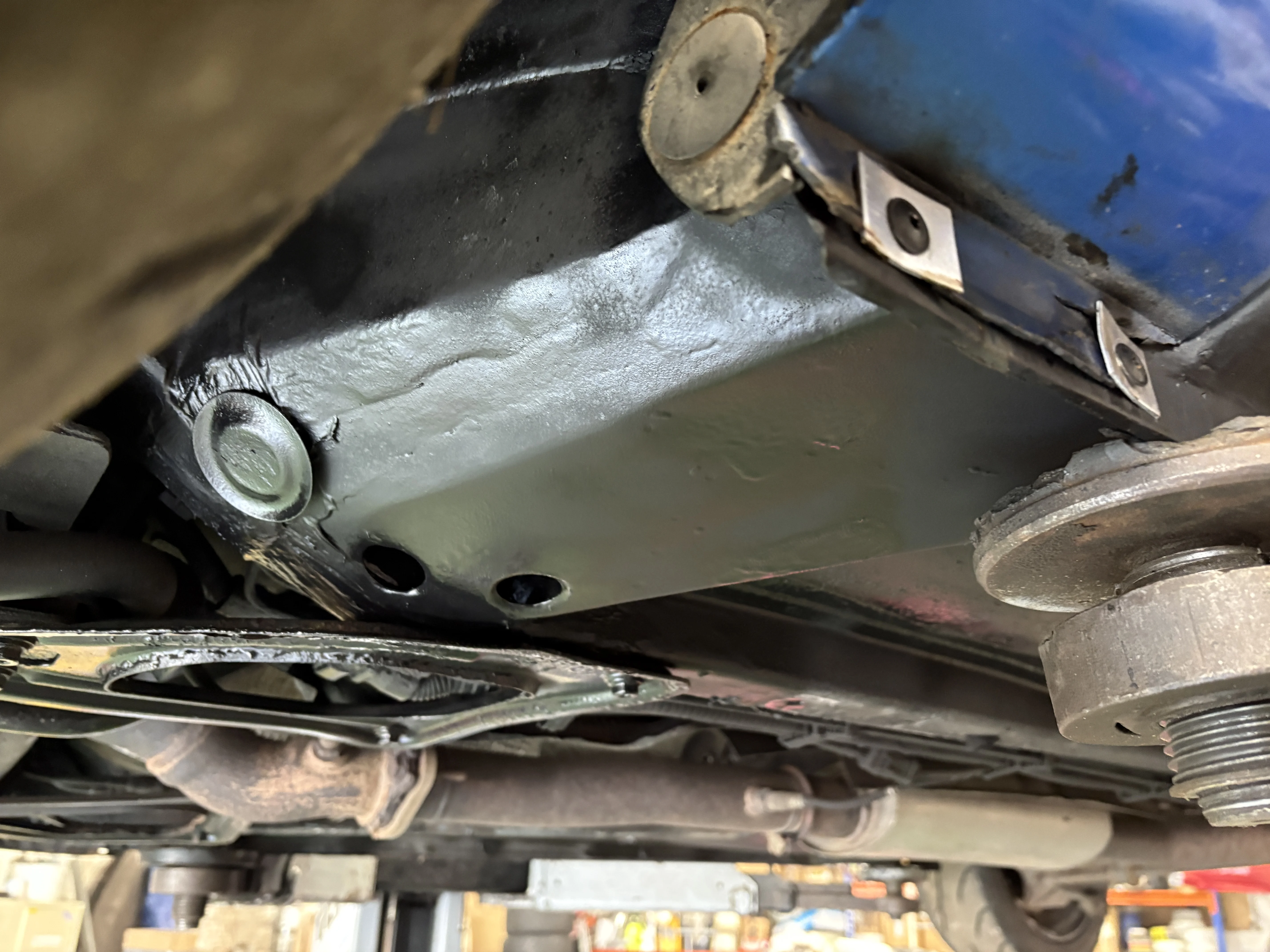

Under floor wax oiled and painted, and sills refitted

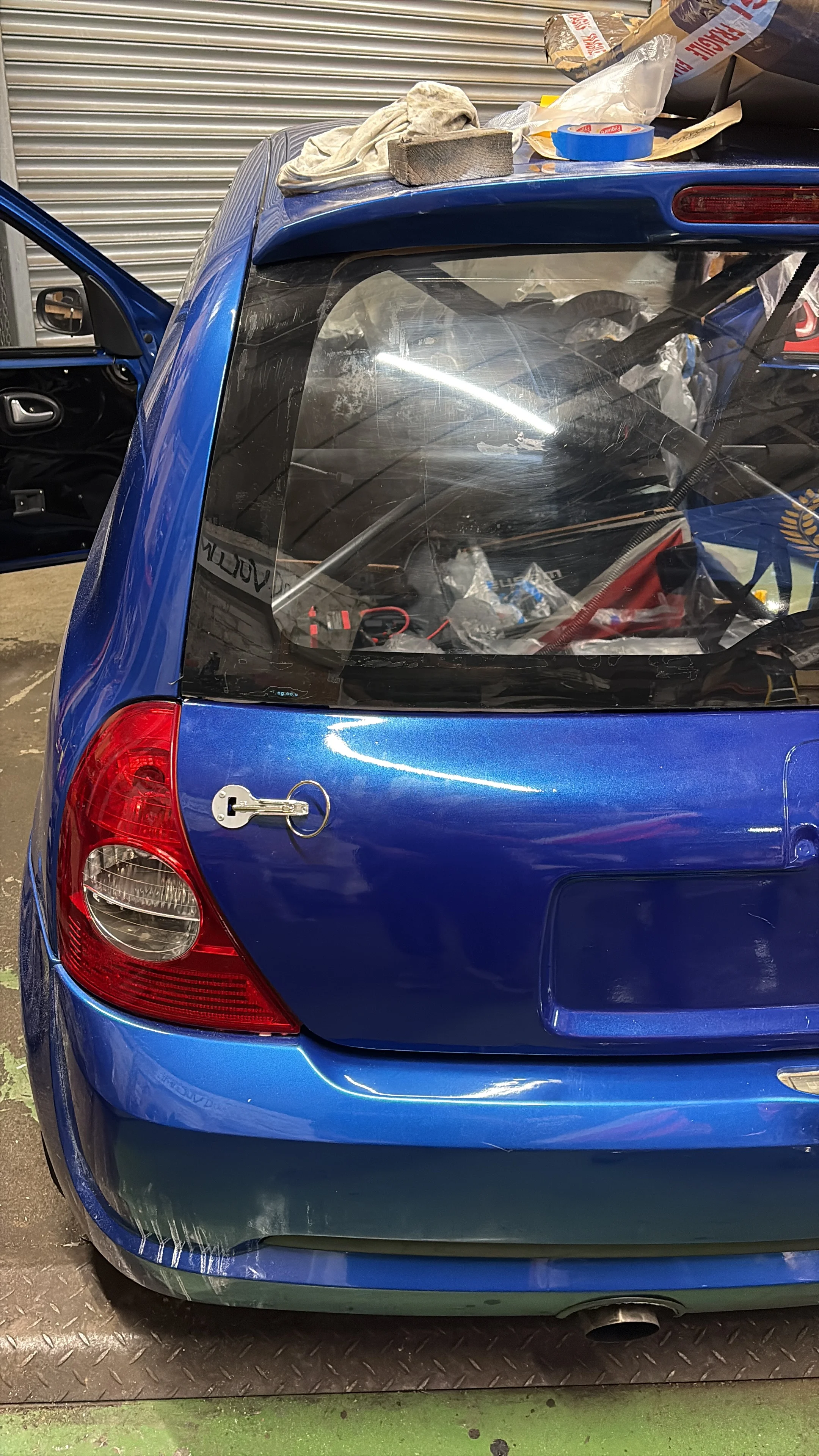

Second hand- new to me ccf boot fitted and wires to rear of the car trimmed to the pins
Sills cleaned and back on and new toe and eye fitted
Sills now fit and look amazing!

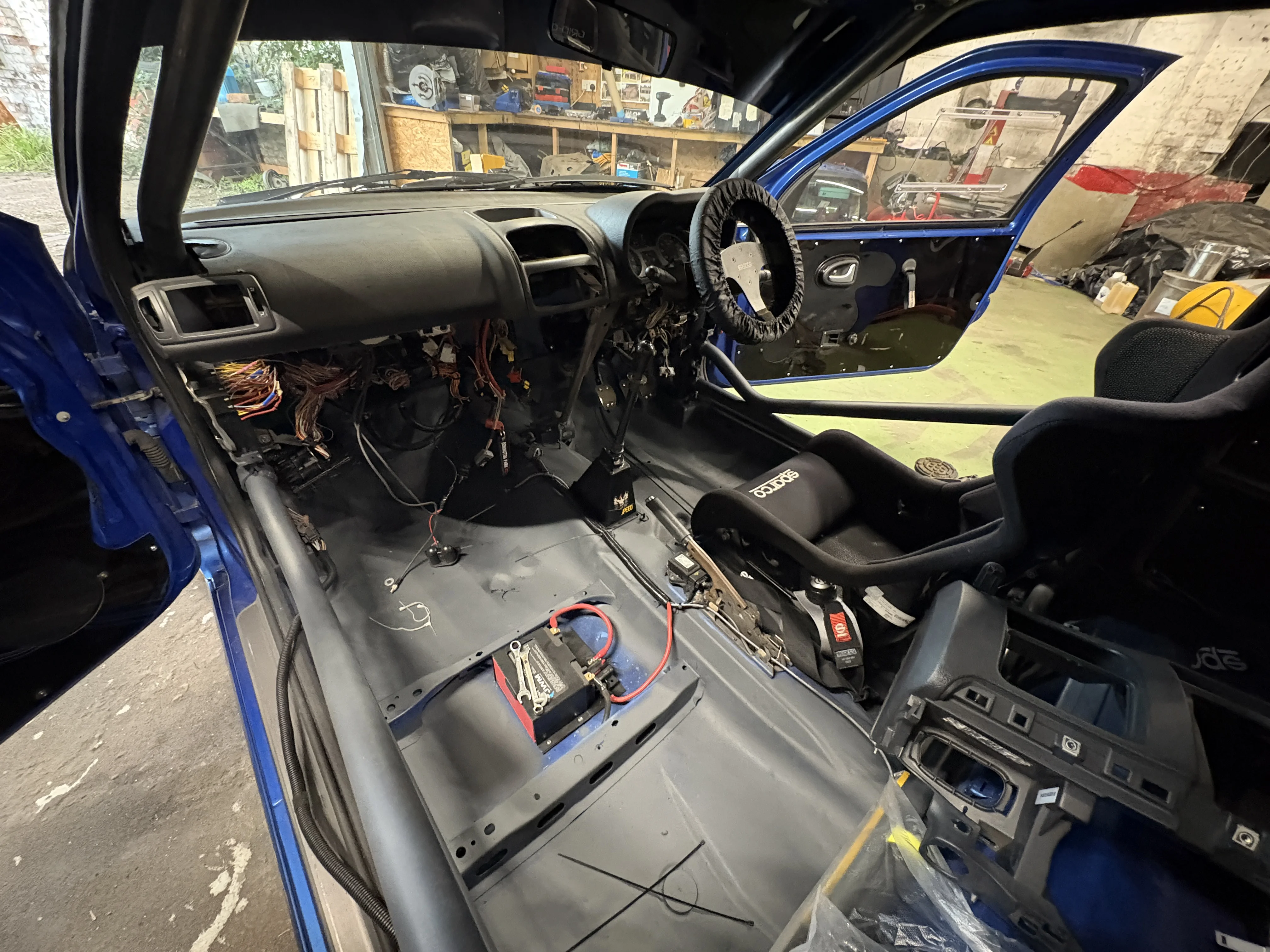

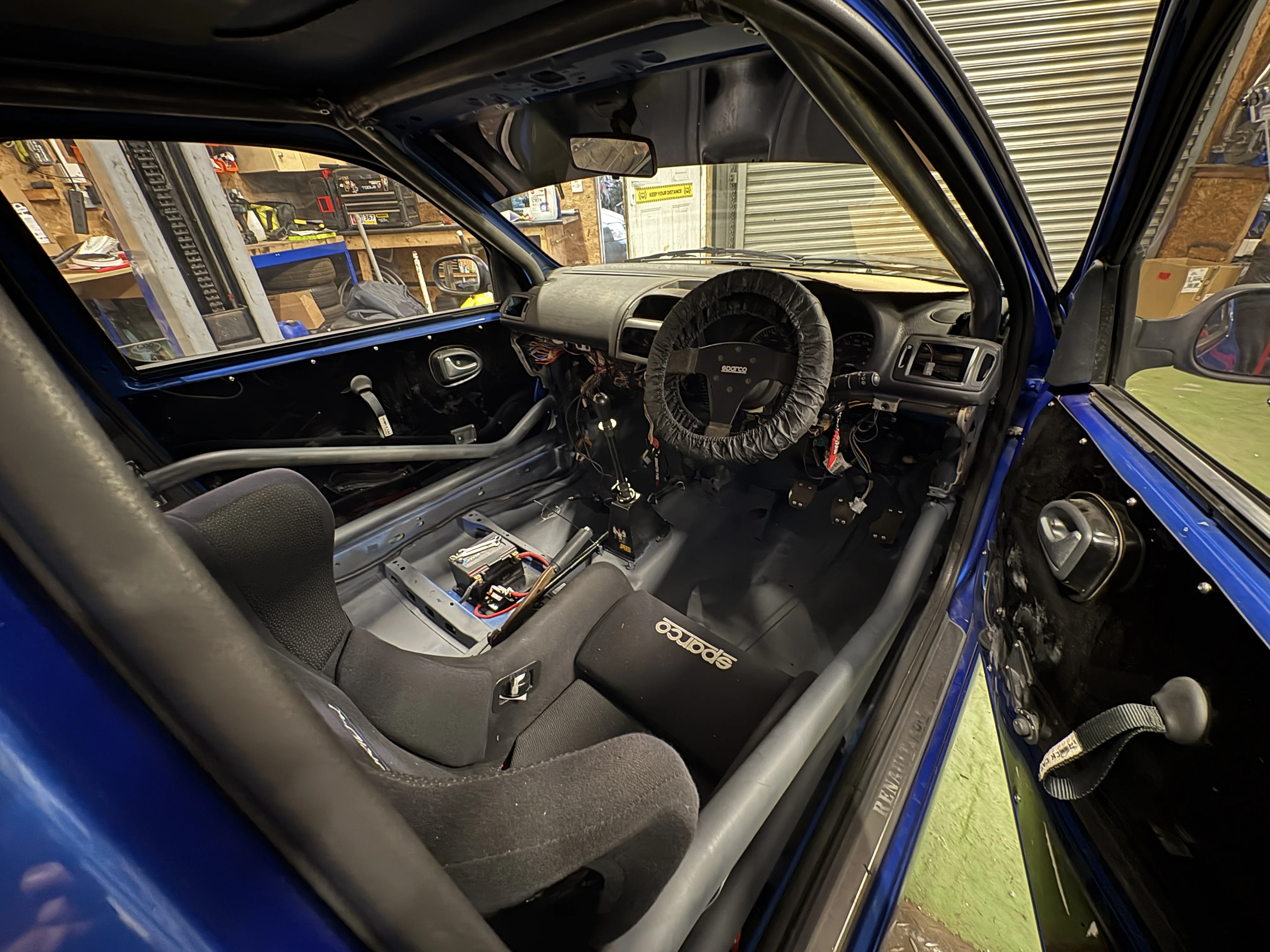

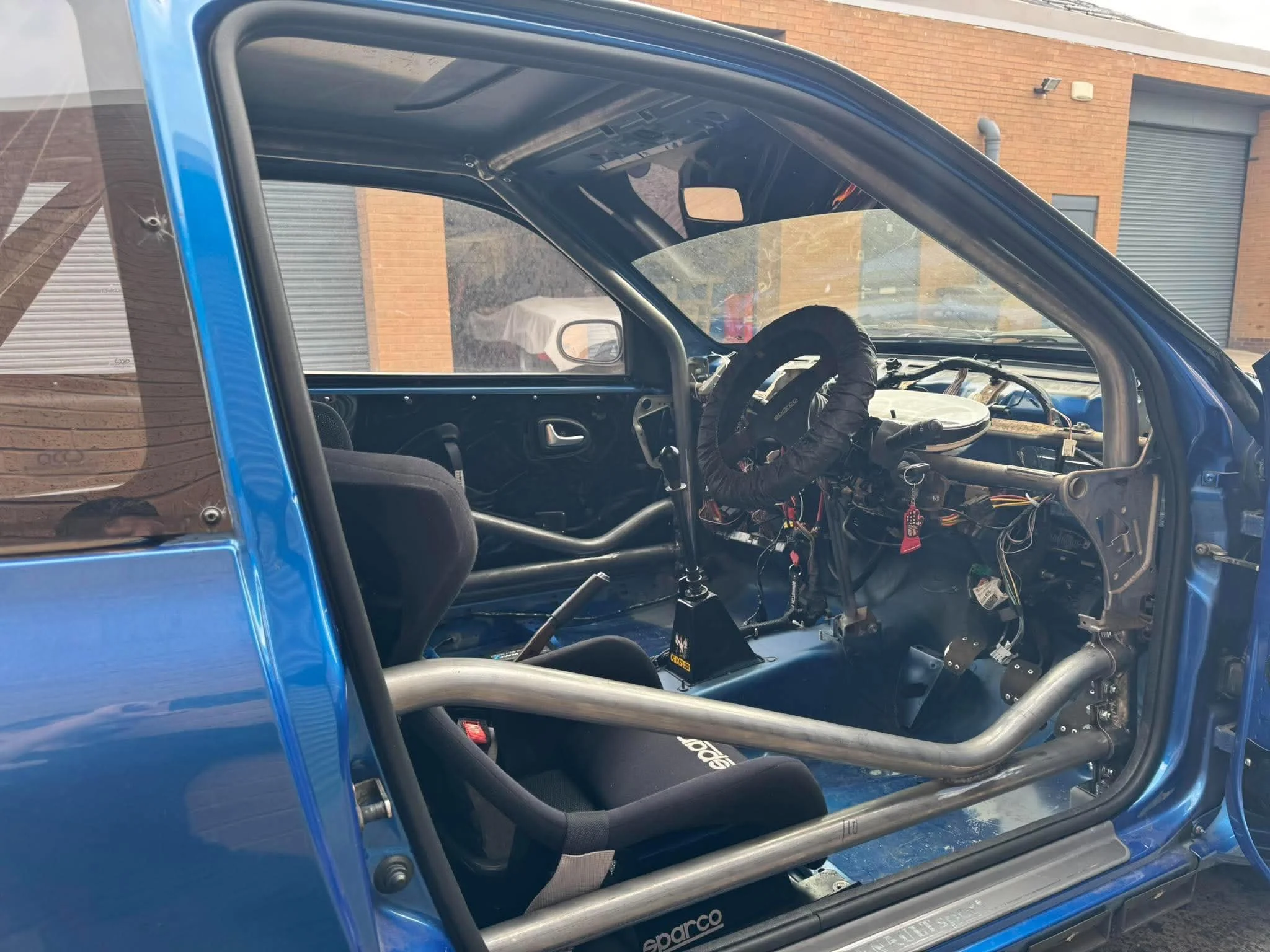

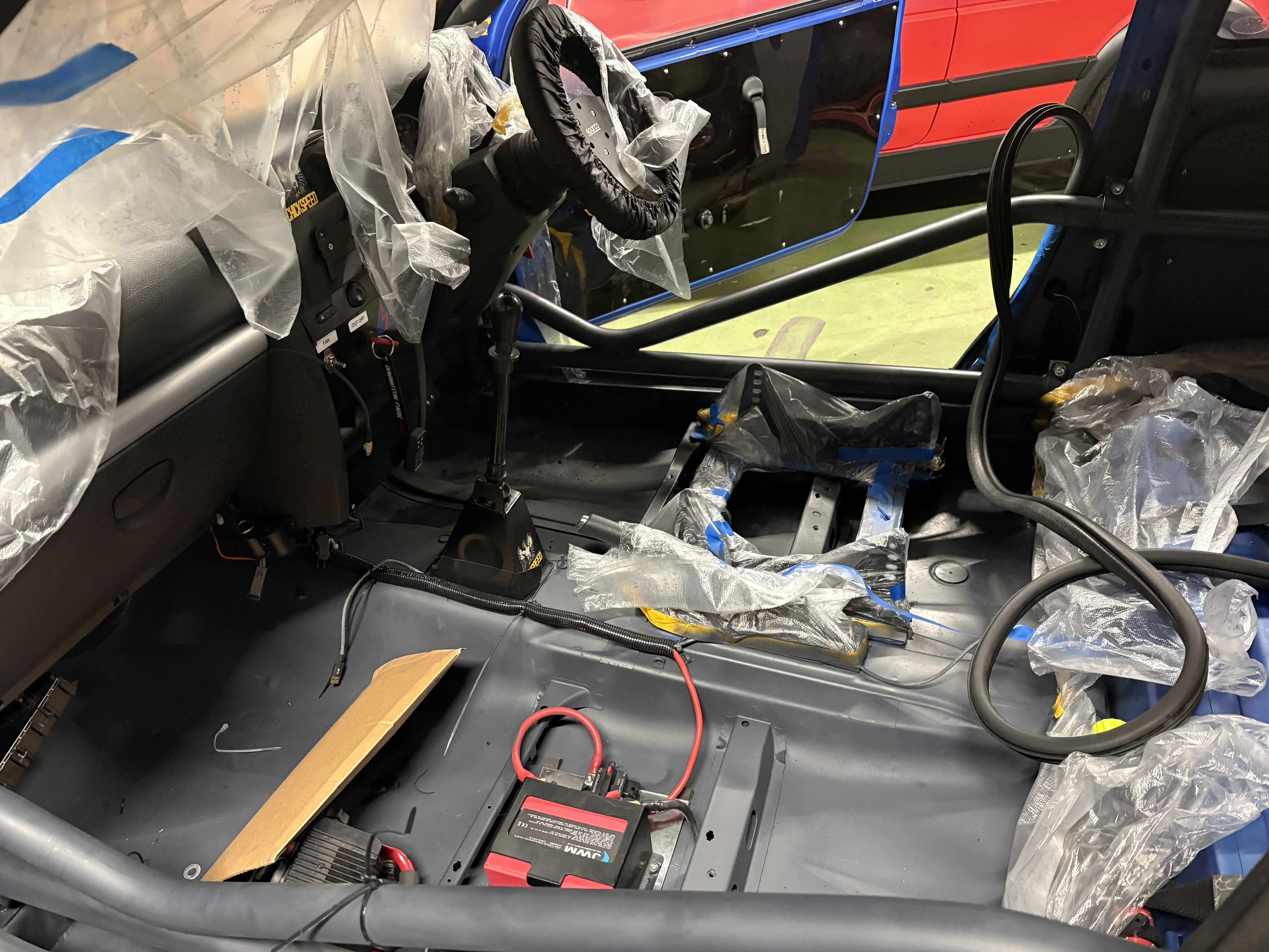

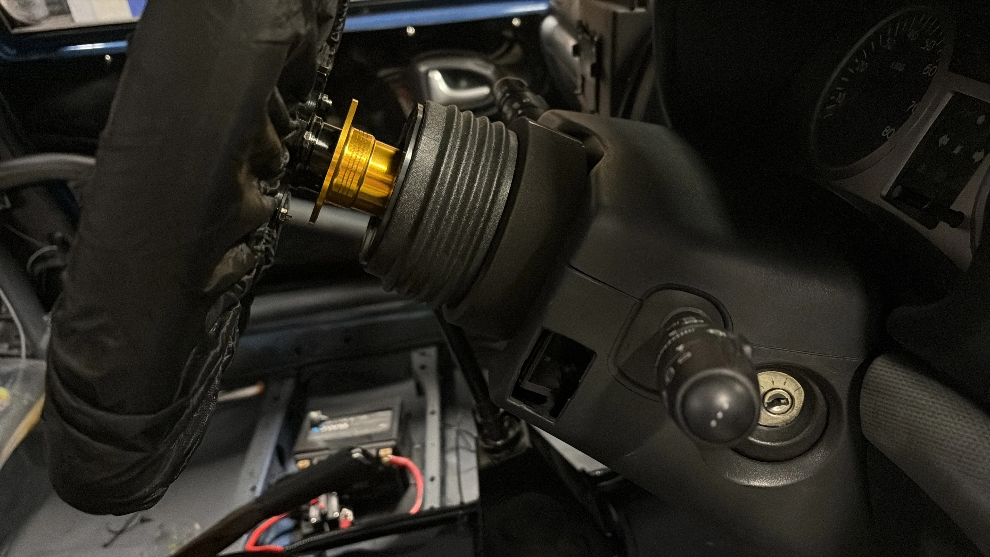

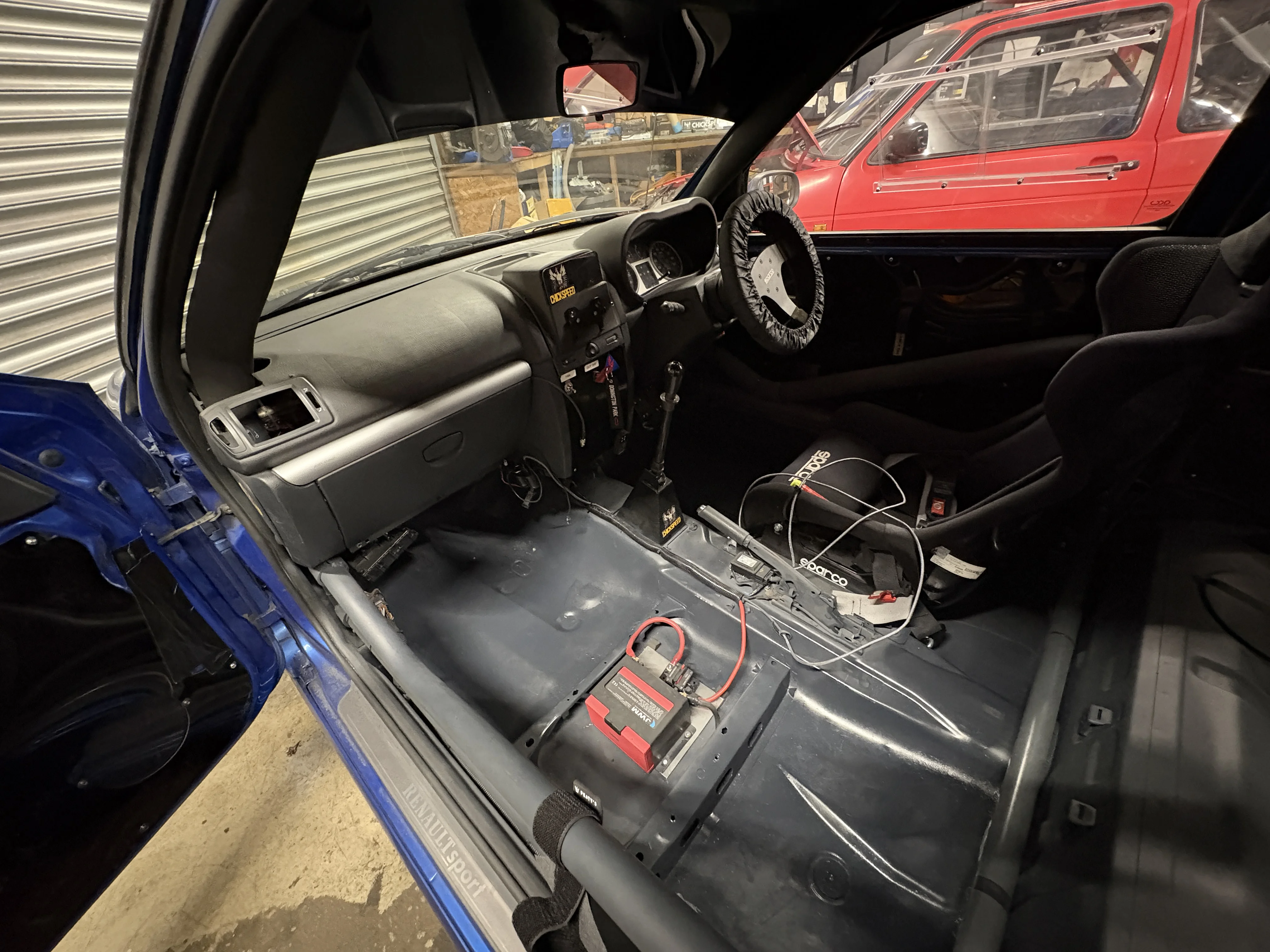

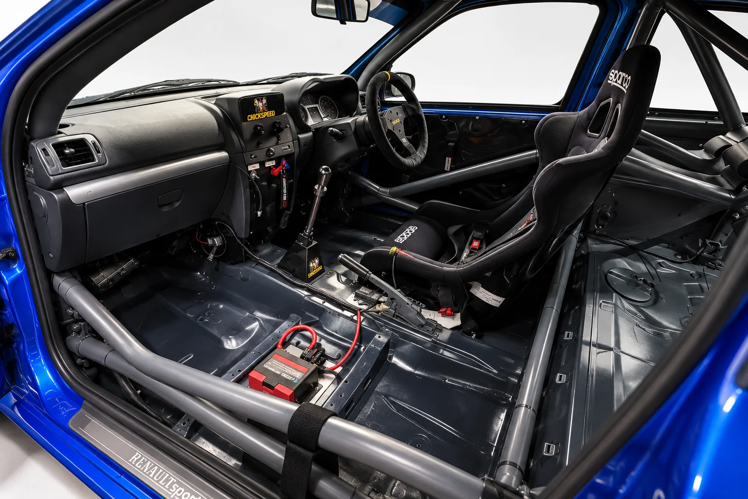

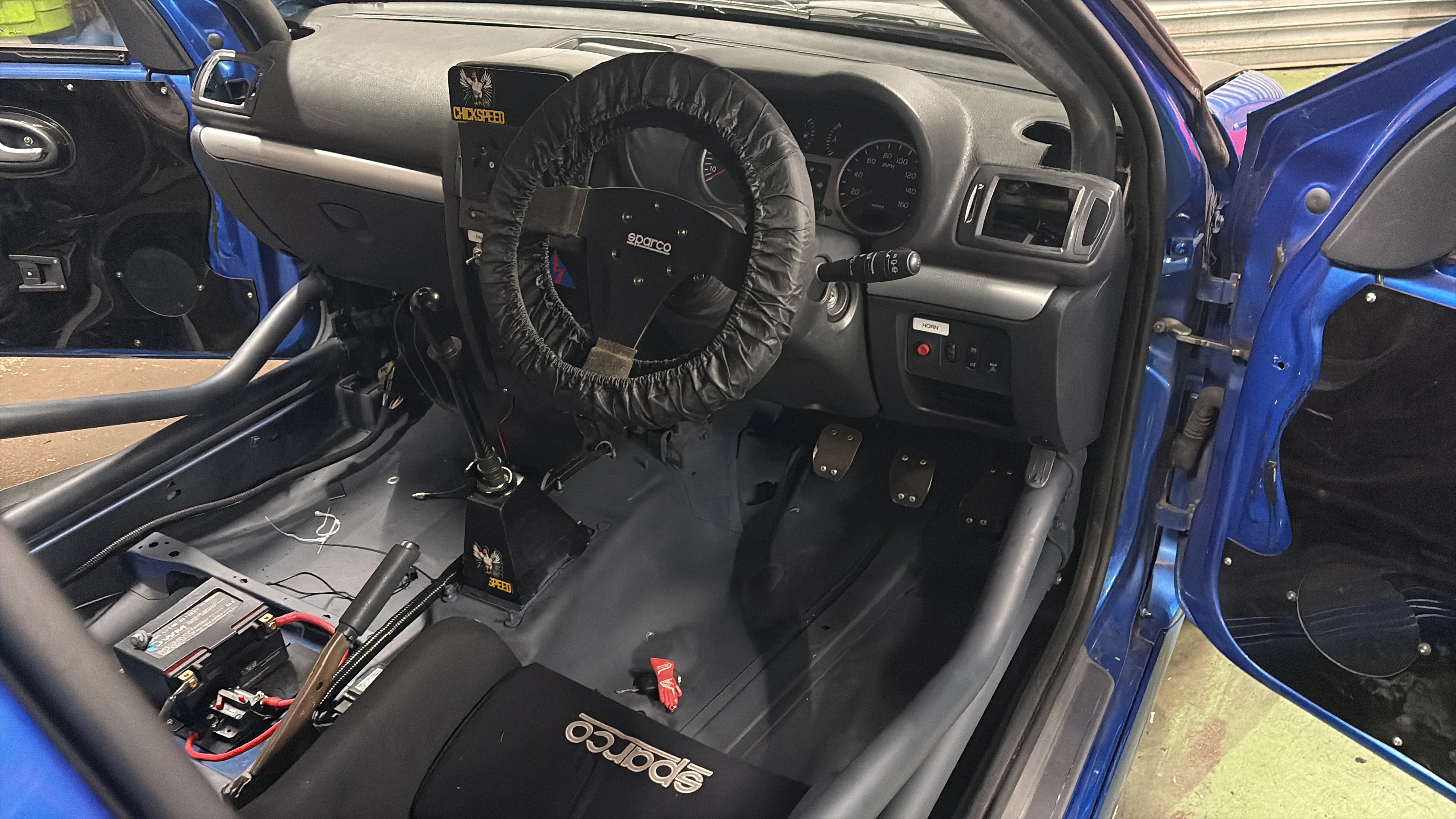

Another night fettling, the dash is back in and trimmed around the roll cage. Steering wheel is tacked on as I’ve fitted a quick release steering wheel boss.
Also cleaned up the rear boot and got rid of all the old glue. Starting to look tidy
Next to refit the harnesses, reposition the battery and then finish painting the interior.

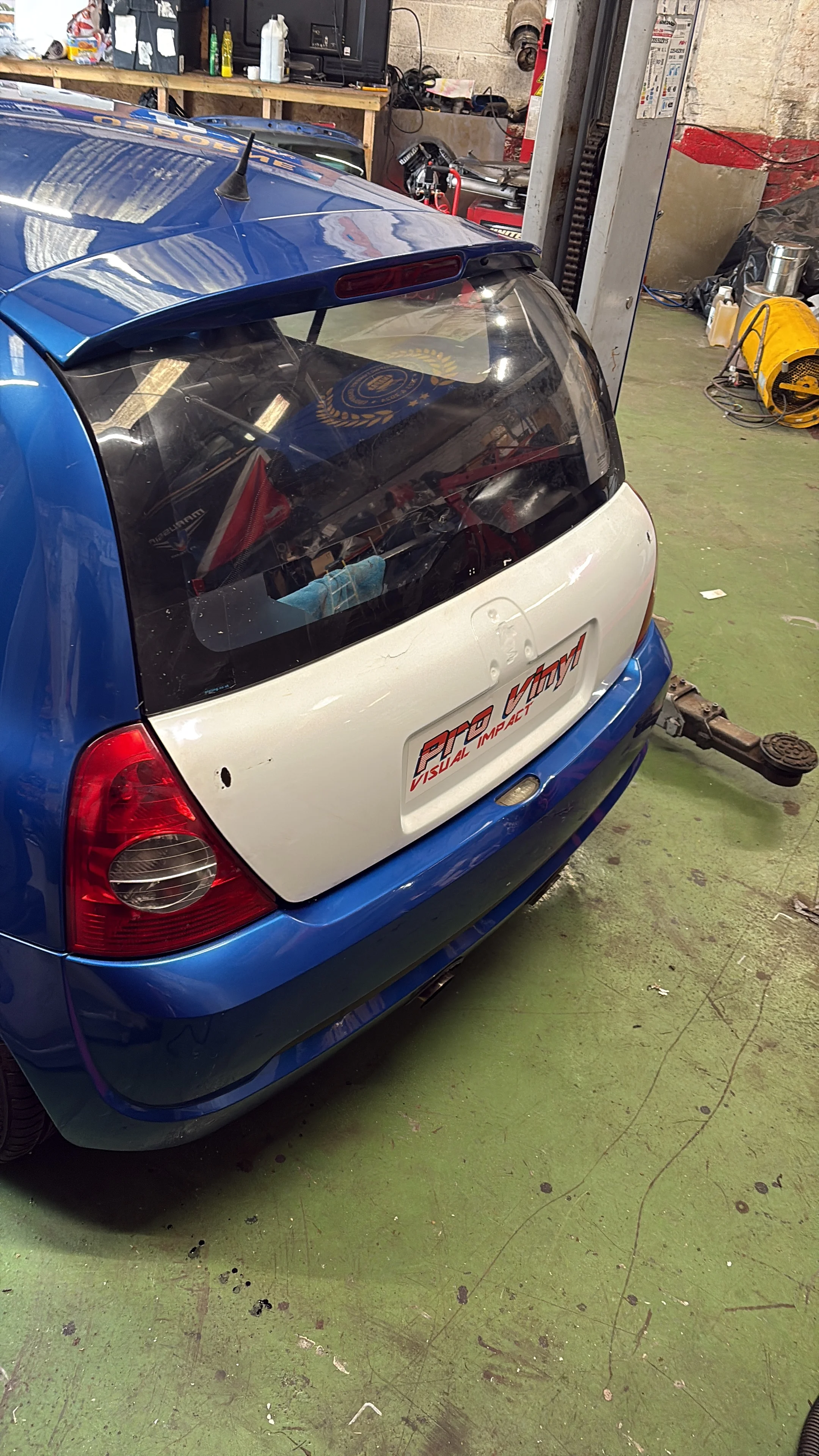

Fibreglass boots on and wrapped. The match is better than I thought! May re-wrap the bonnet now in the same colour
Front part all painted, new alloy plate for the battery fitted and coming together. I’ve got to refit the front seats, but just got the harnesses to sort first. Have a rain light to fit too.
Not far off then, loads to tidy up

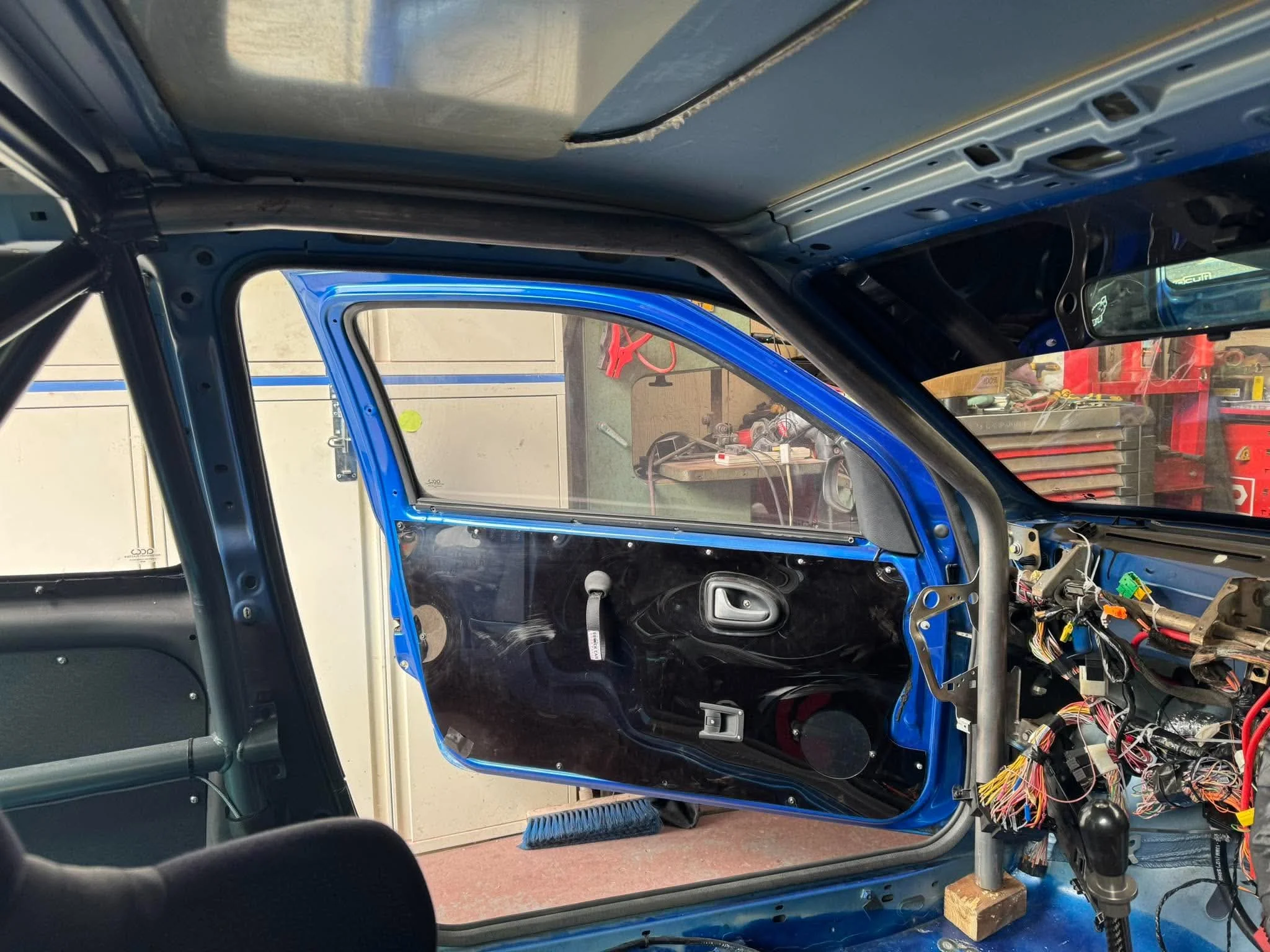

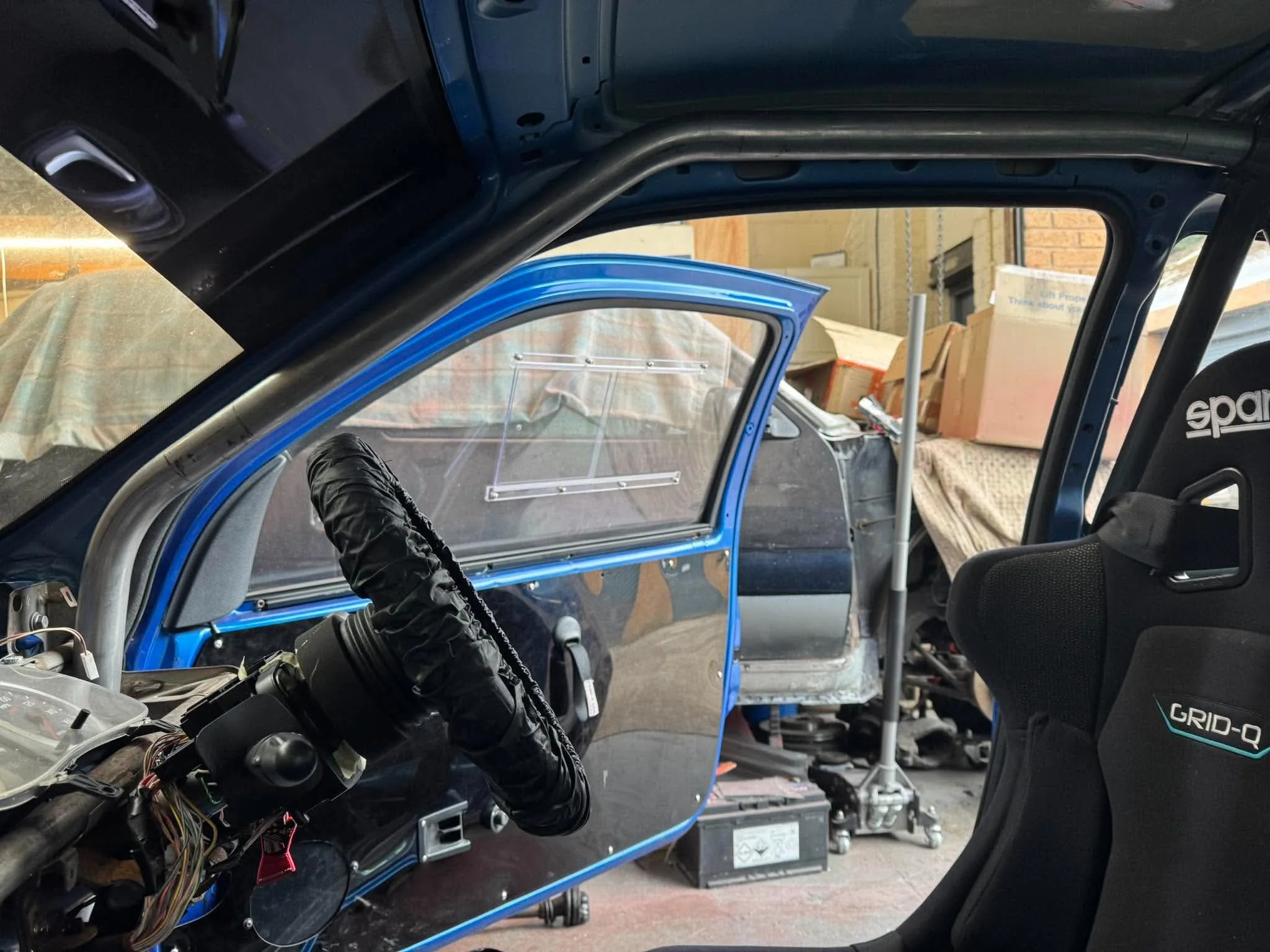

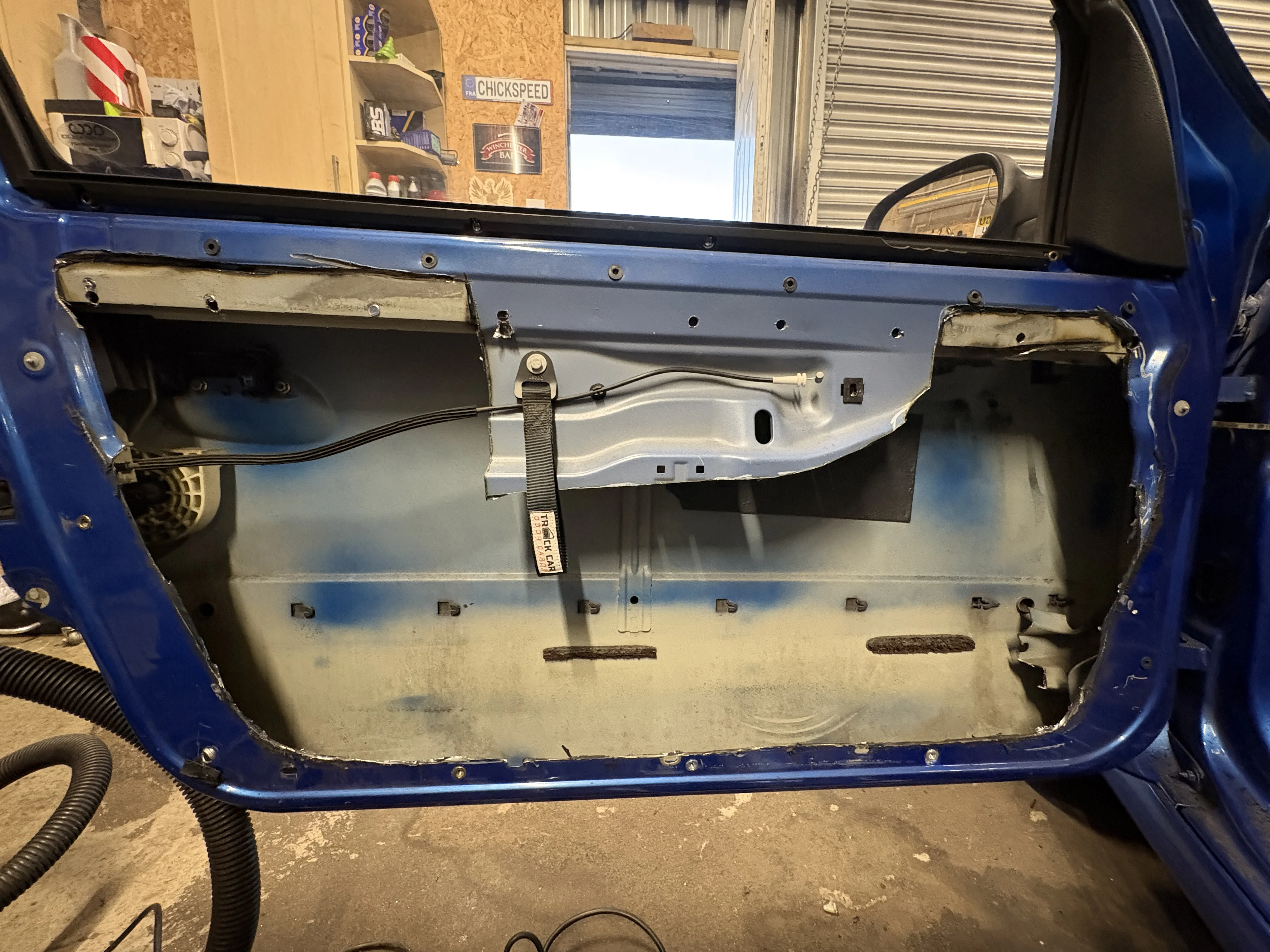

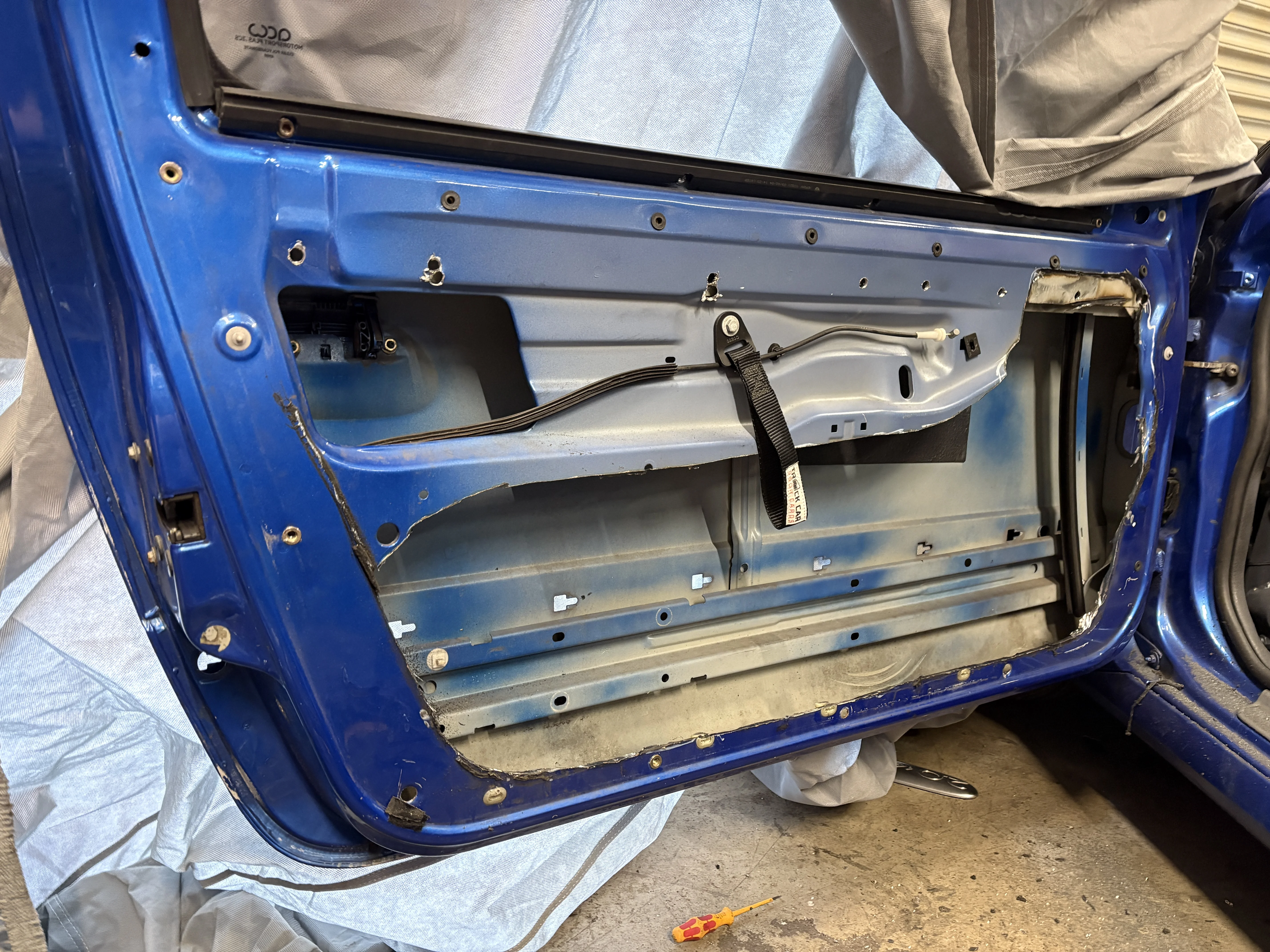

Anyone with a good idea how to remove the door bars?
Chopped a little away to take a look, just don’t want to drill holes everywhere!!! with a full roll cage can loose some metalwork from here.
I stripped my steel doors completely some years ago. I think it's described on my thread way back. That bar is only held on by spot welds at the ends but I think I had the cut the bar at the hinge end because there's no access.
Thank you very much!

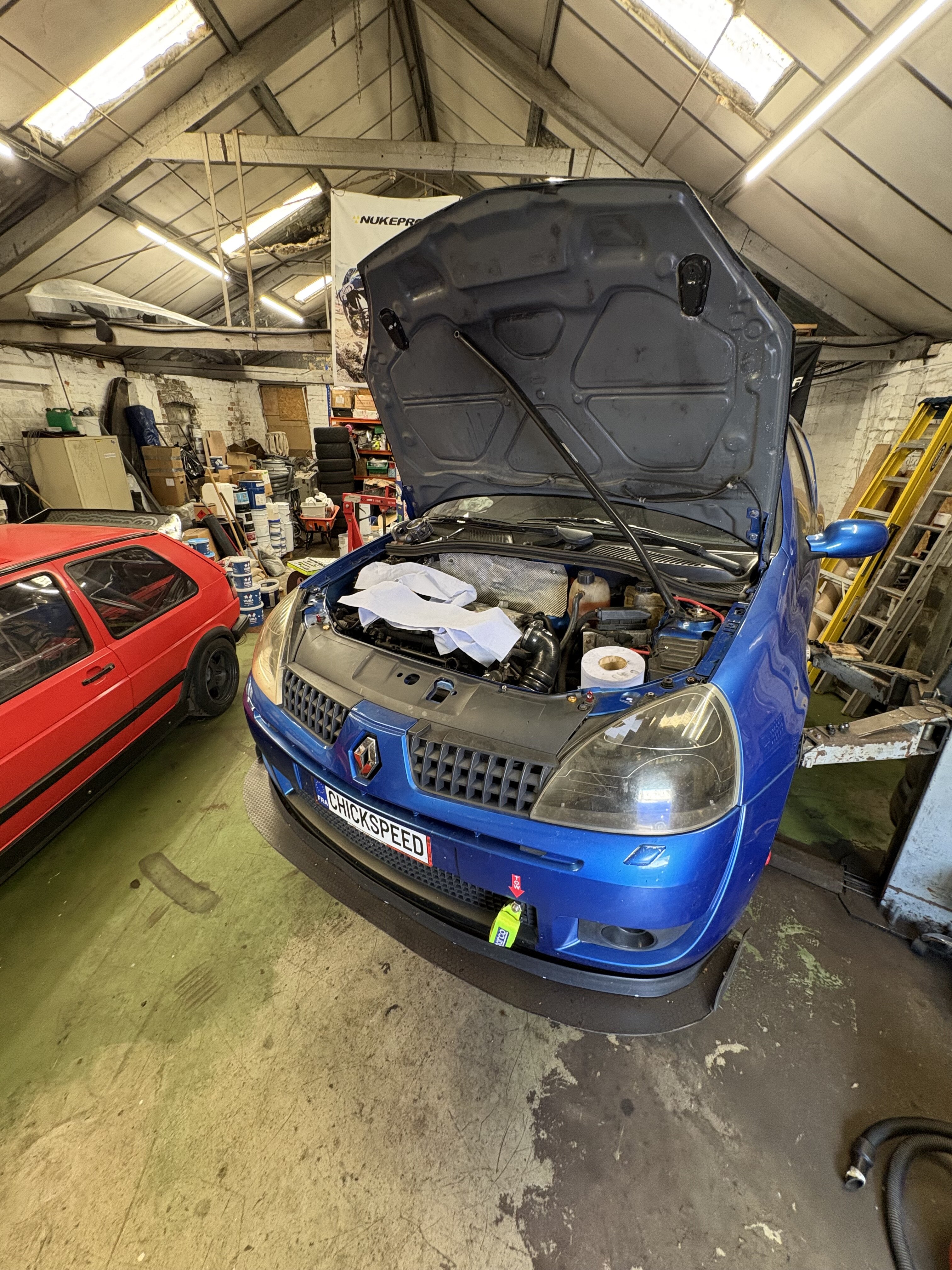

Bit of looking at what happened at Donny. I think, the Power steering pump was leaking from one of the seals (found a few drips) and straight into the alternator, so I think caused it to fault.
New OEM alternator ordered, plus a new power steering pump and Gates Aux belt.
Hopefully that sorts out the issue.
The Fluids on the splitter is lots and lots of cleaner to clear off the PS fluid.
Also, cleaned the earth strap just incase
