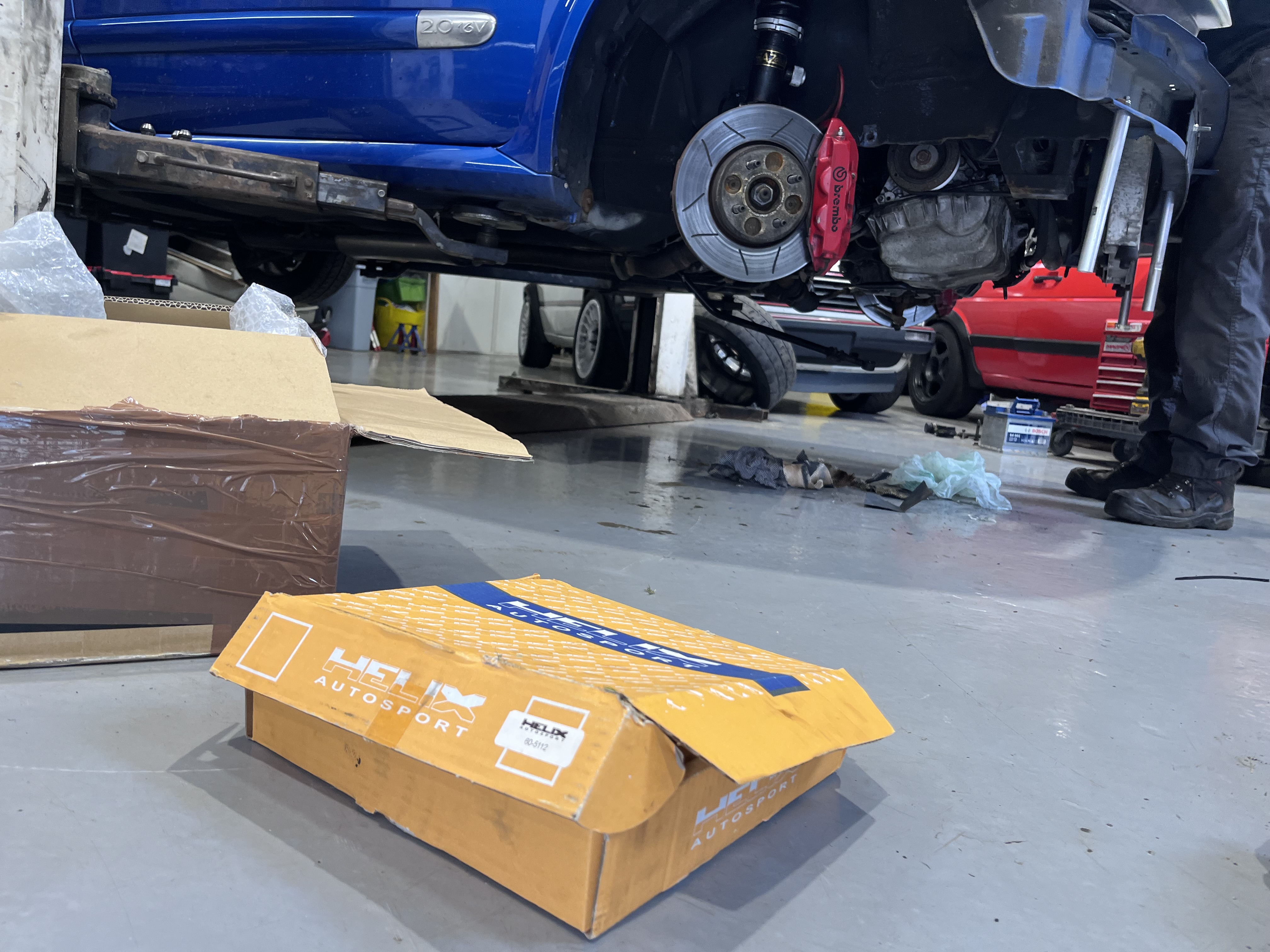

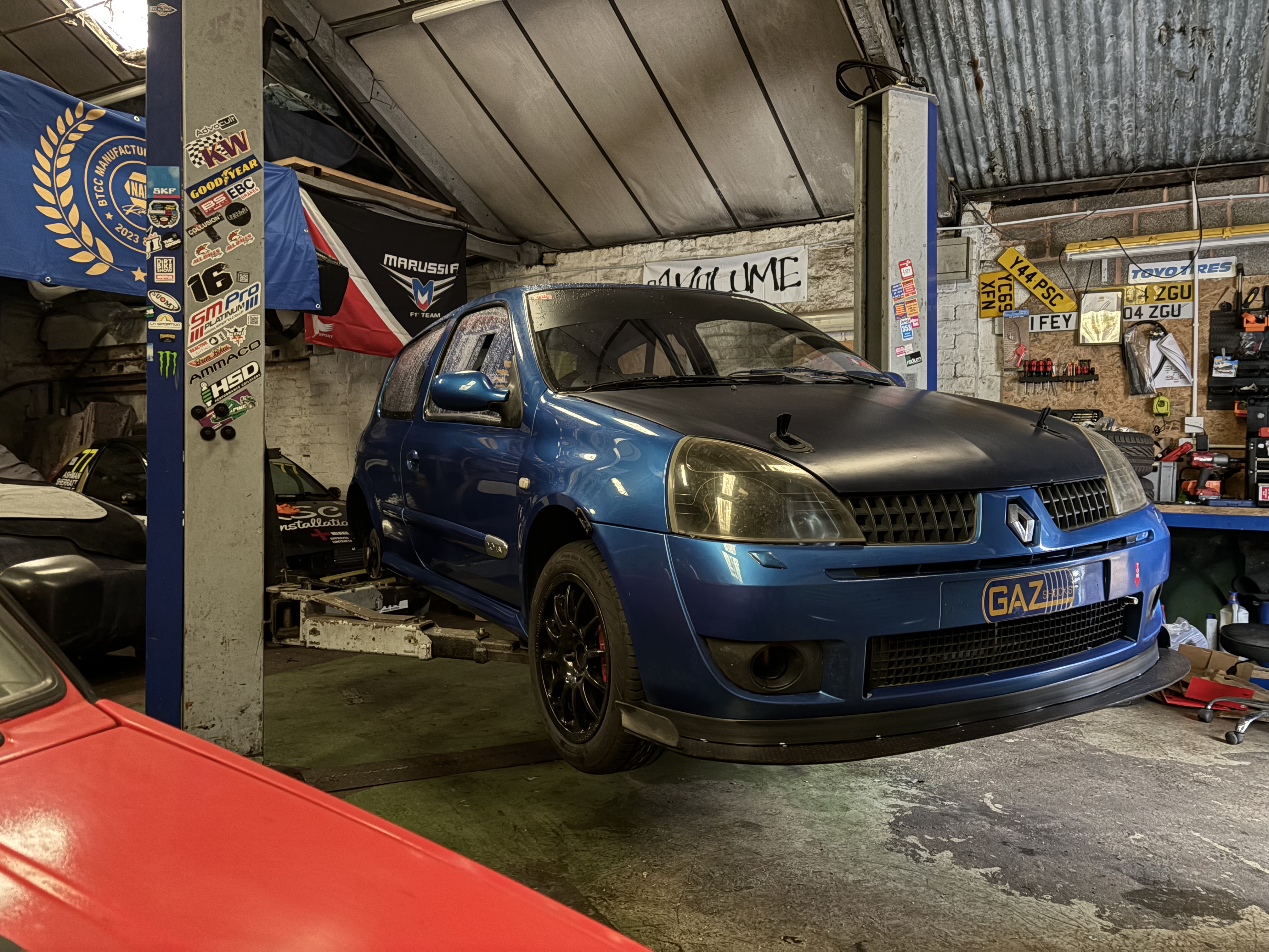

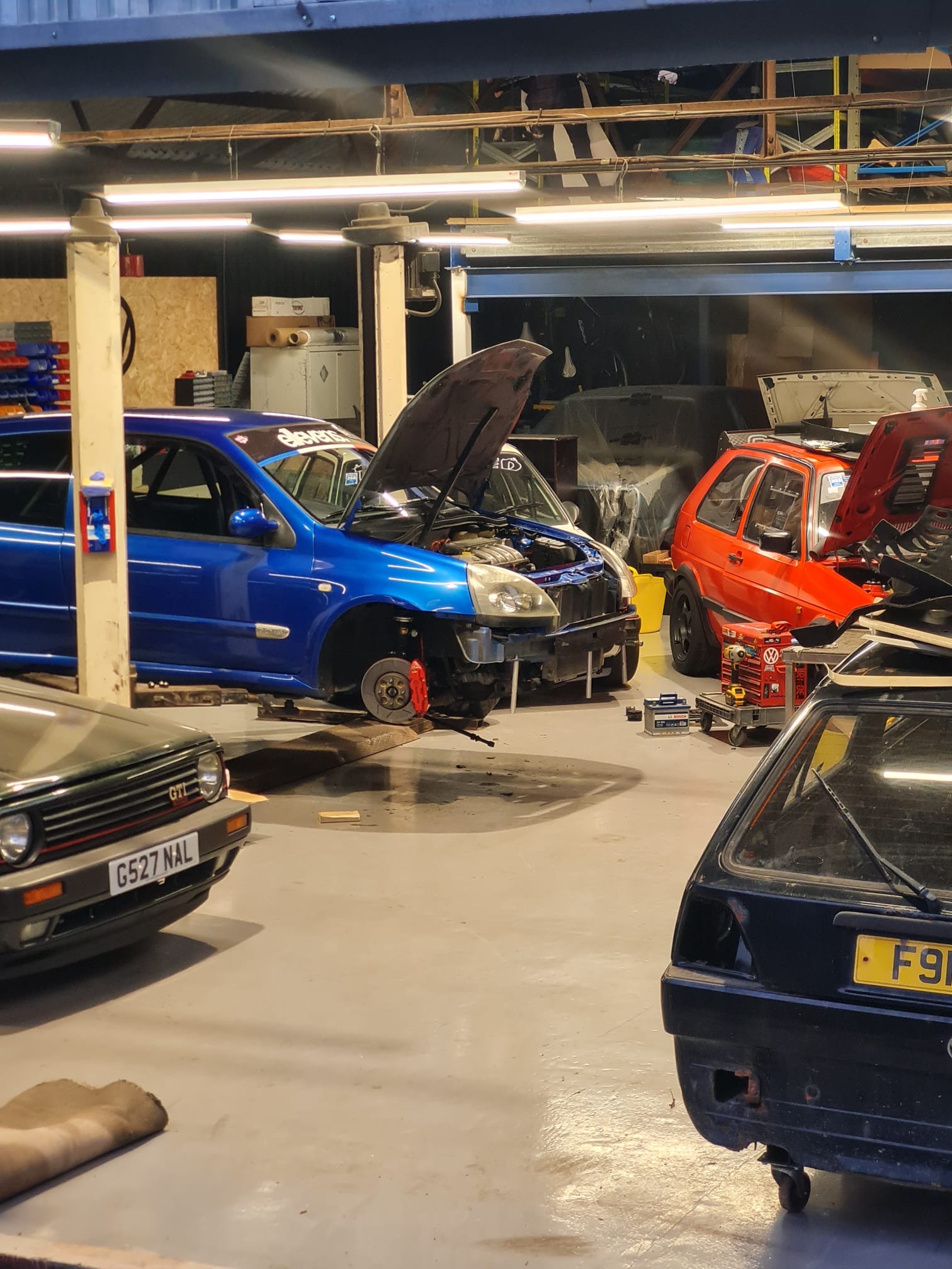

Out with the old clutch and in with new one…

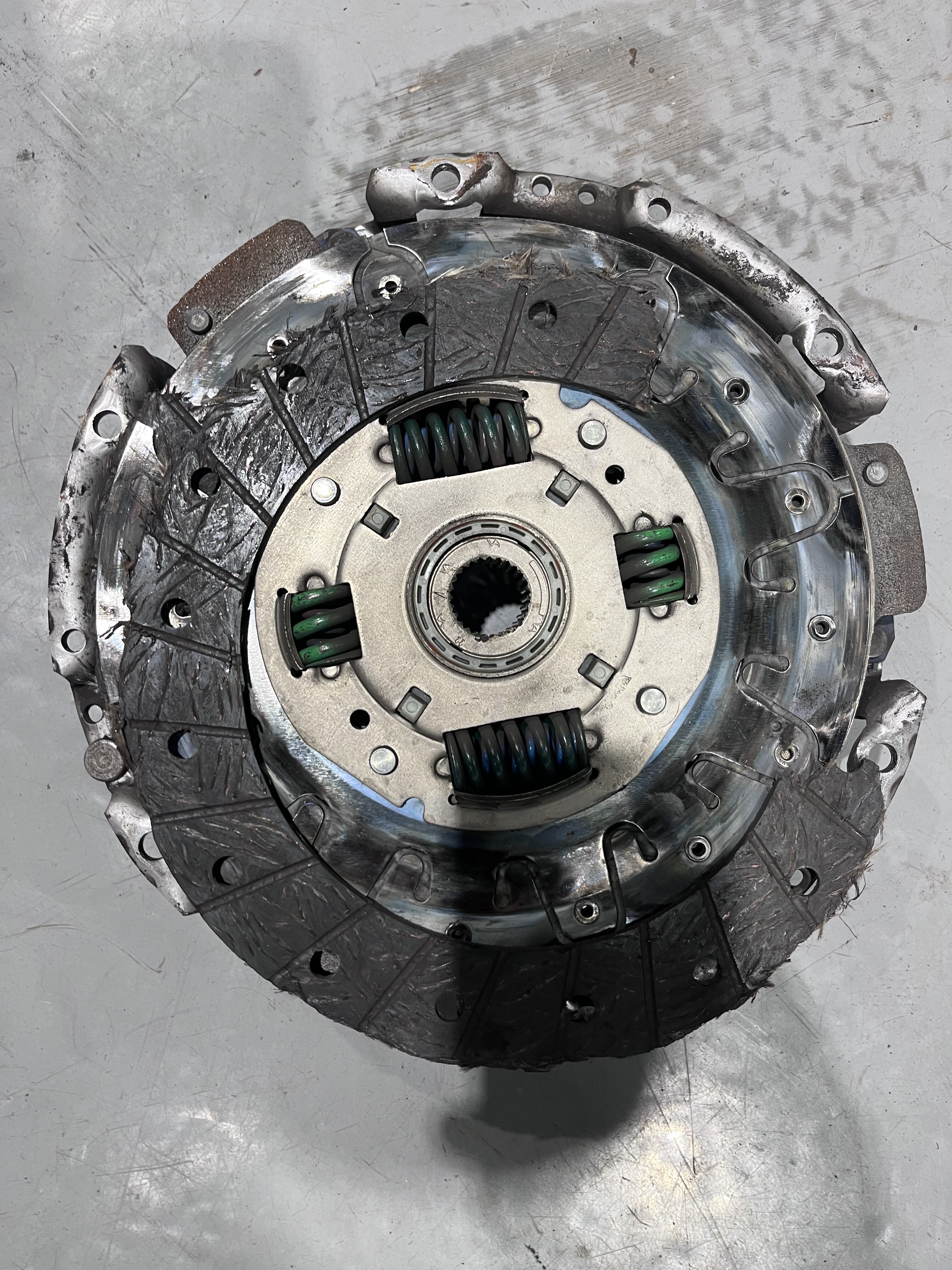

Found a slight issue with the old oem clutch

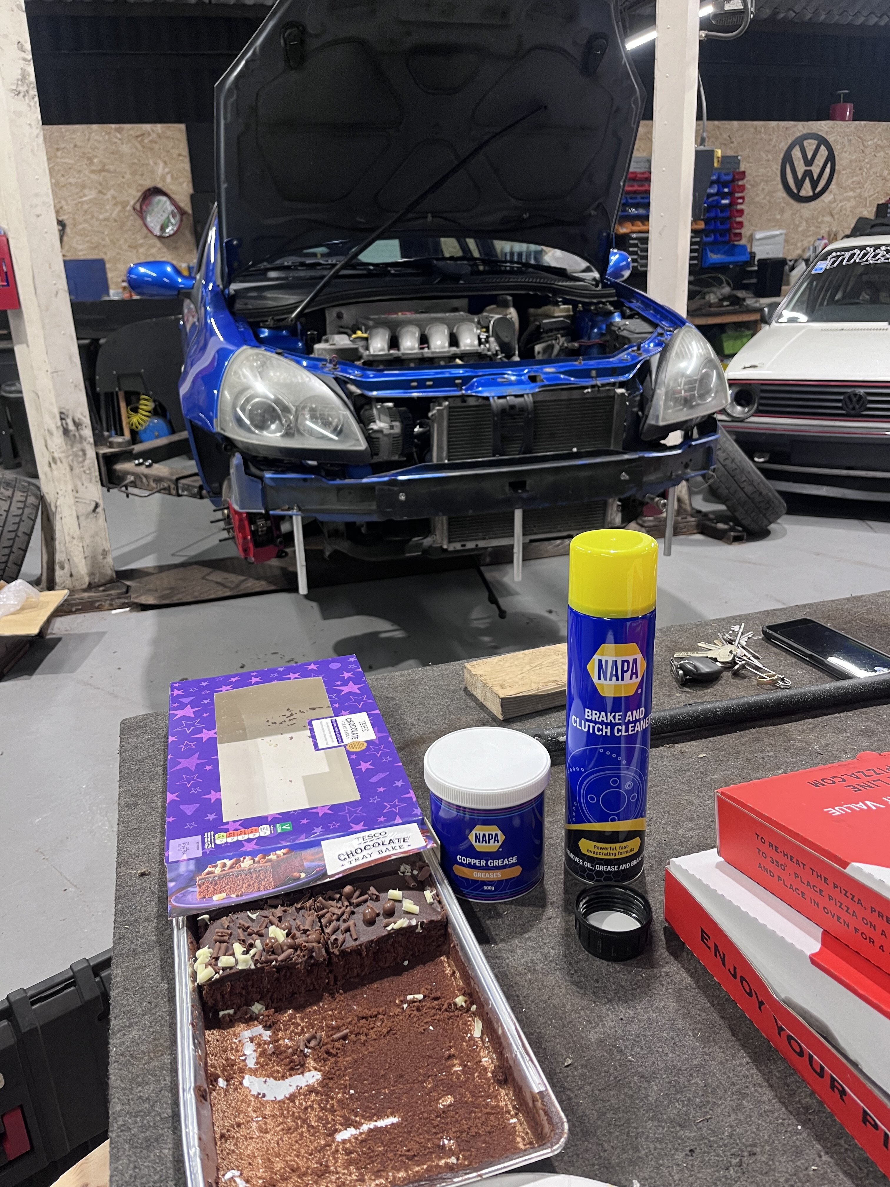

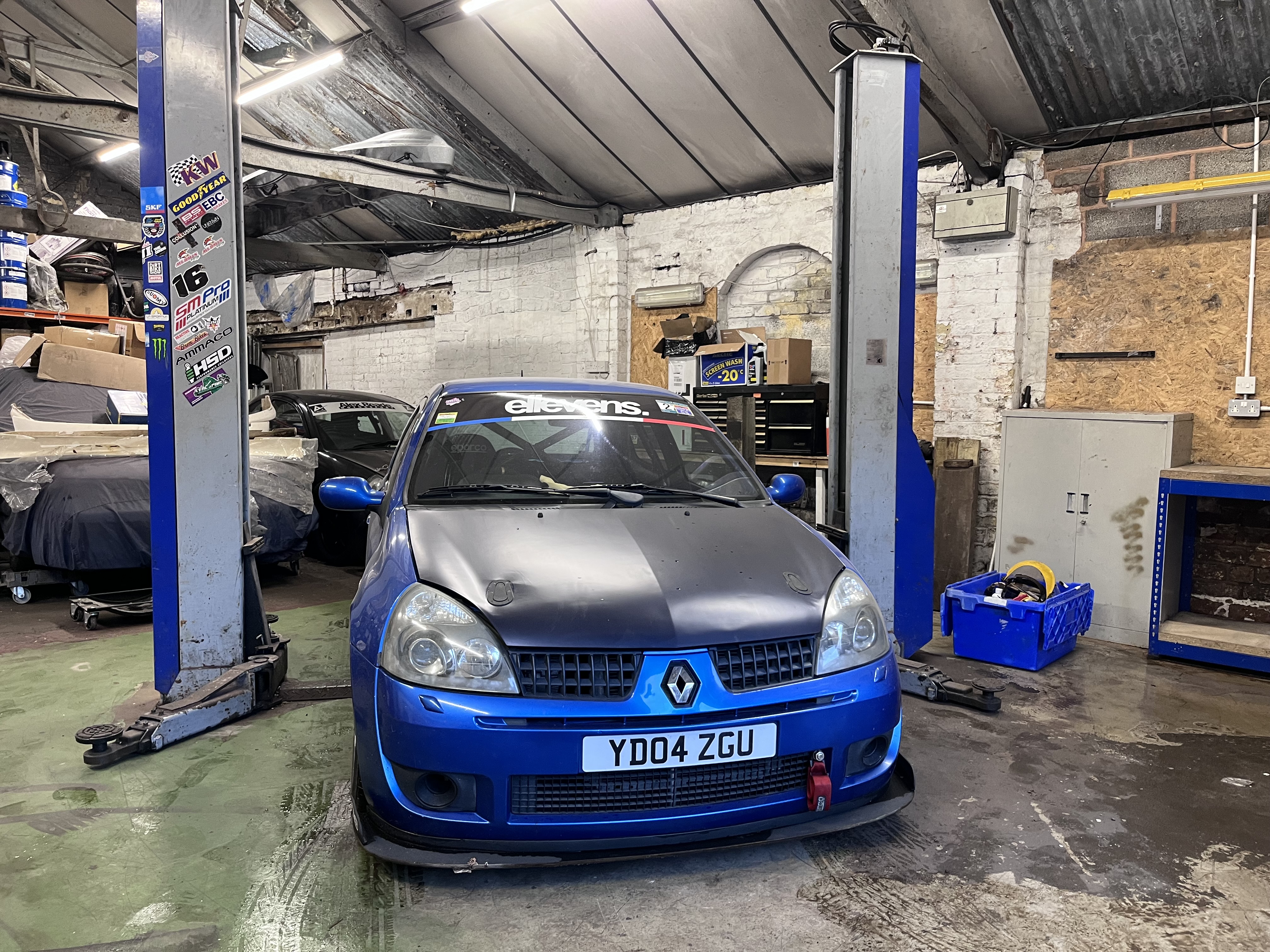

New helix motorsport organic clutch going in…
Cake and clutches… what a night. New clutch isn’t too heavy either so let’s see how this goes.

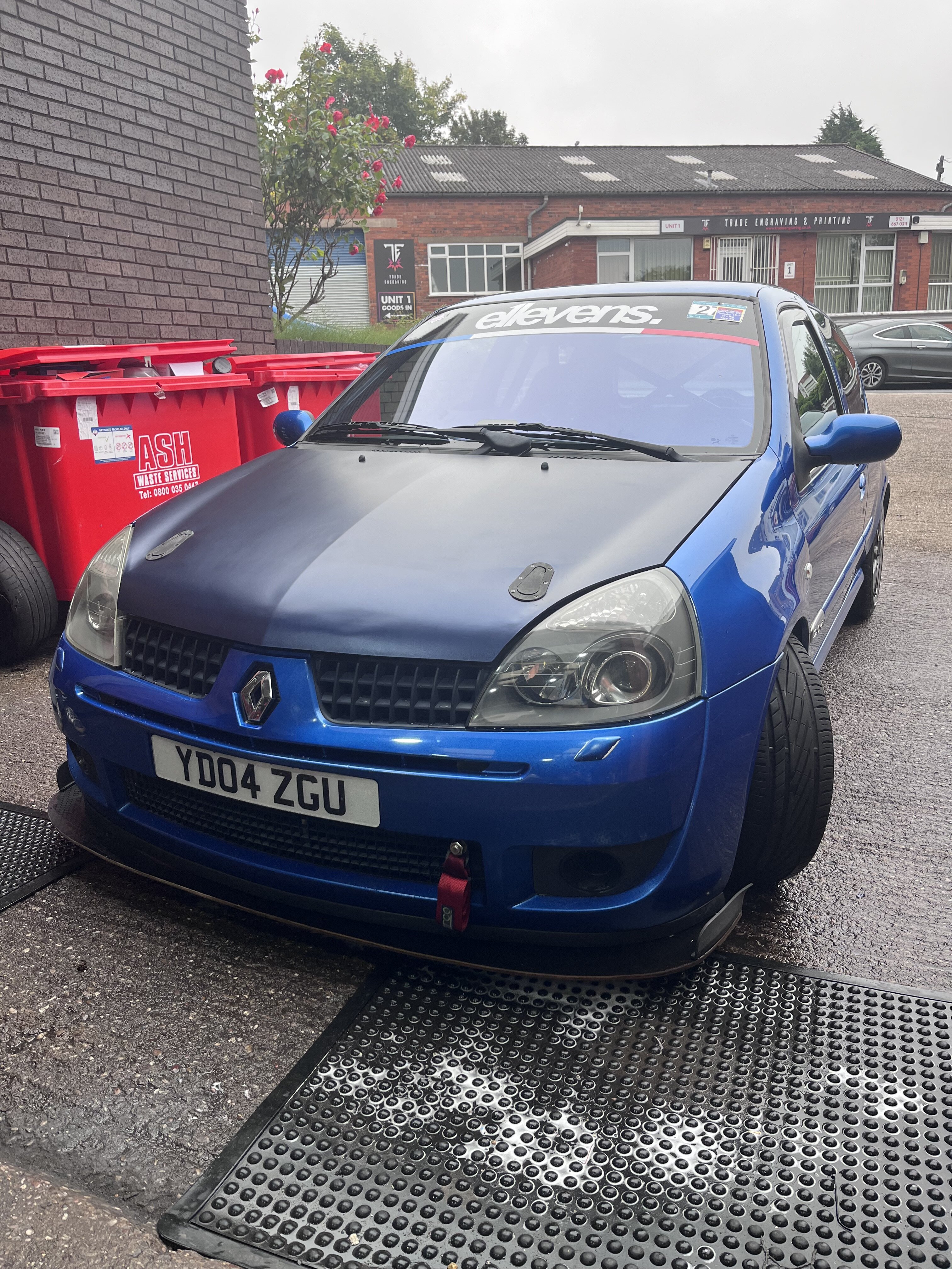

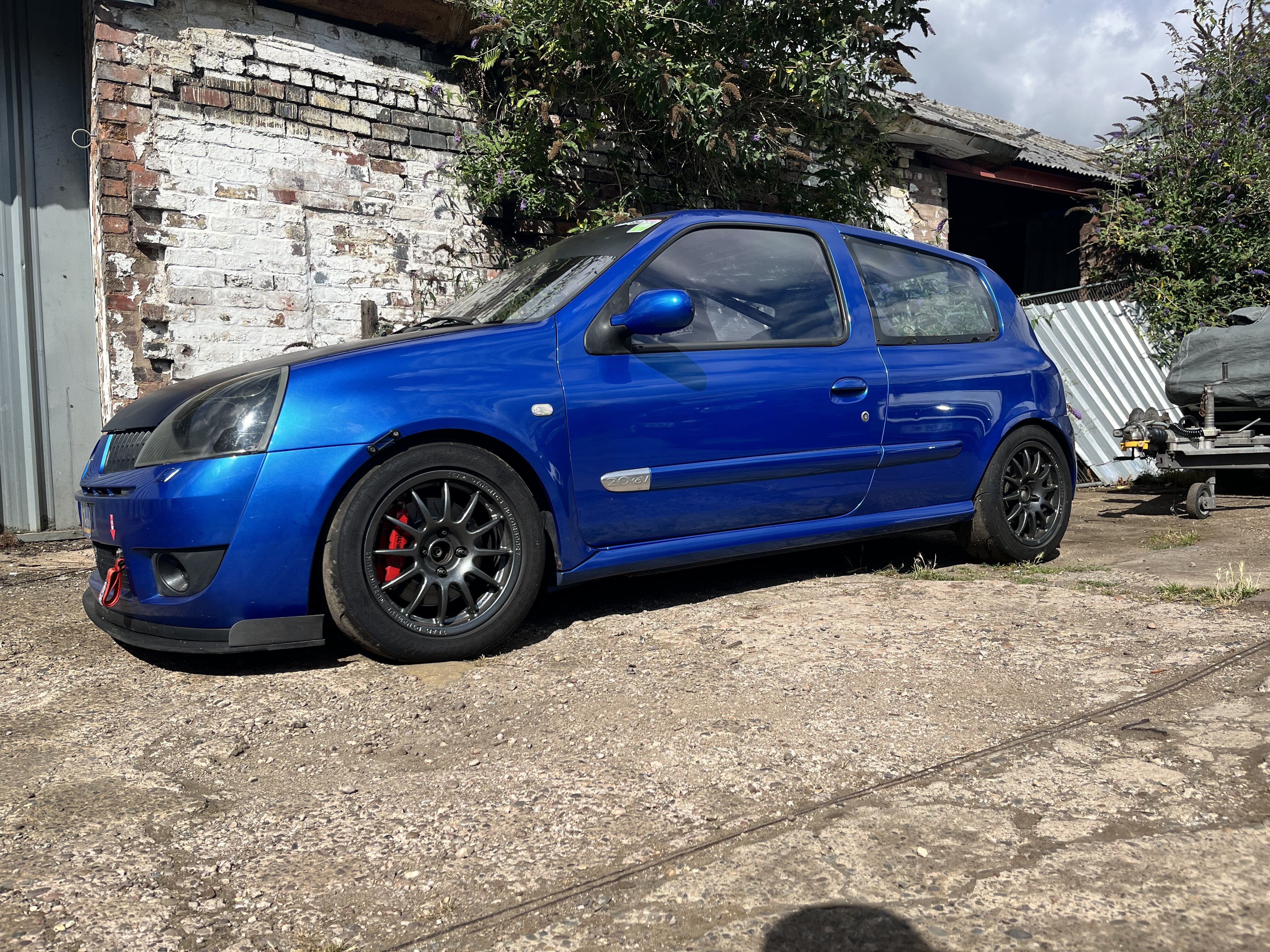

All fixed today, back on the road. The Advocult Motorsport splitter was re-fitted.

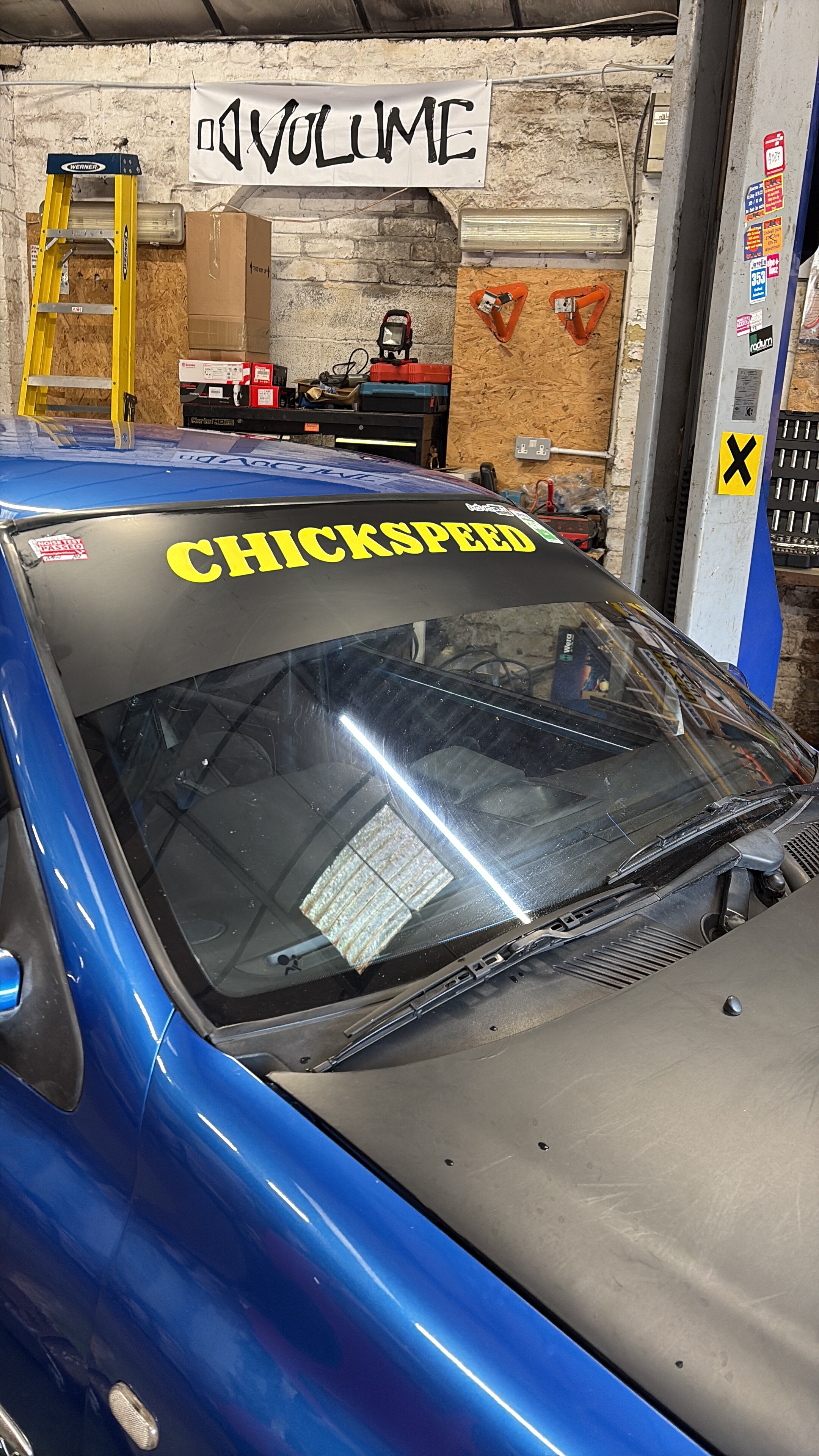

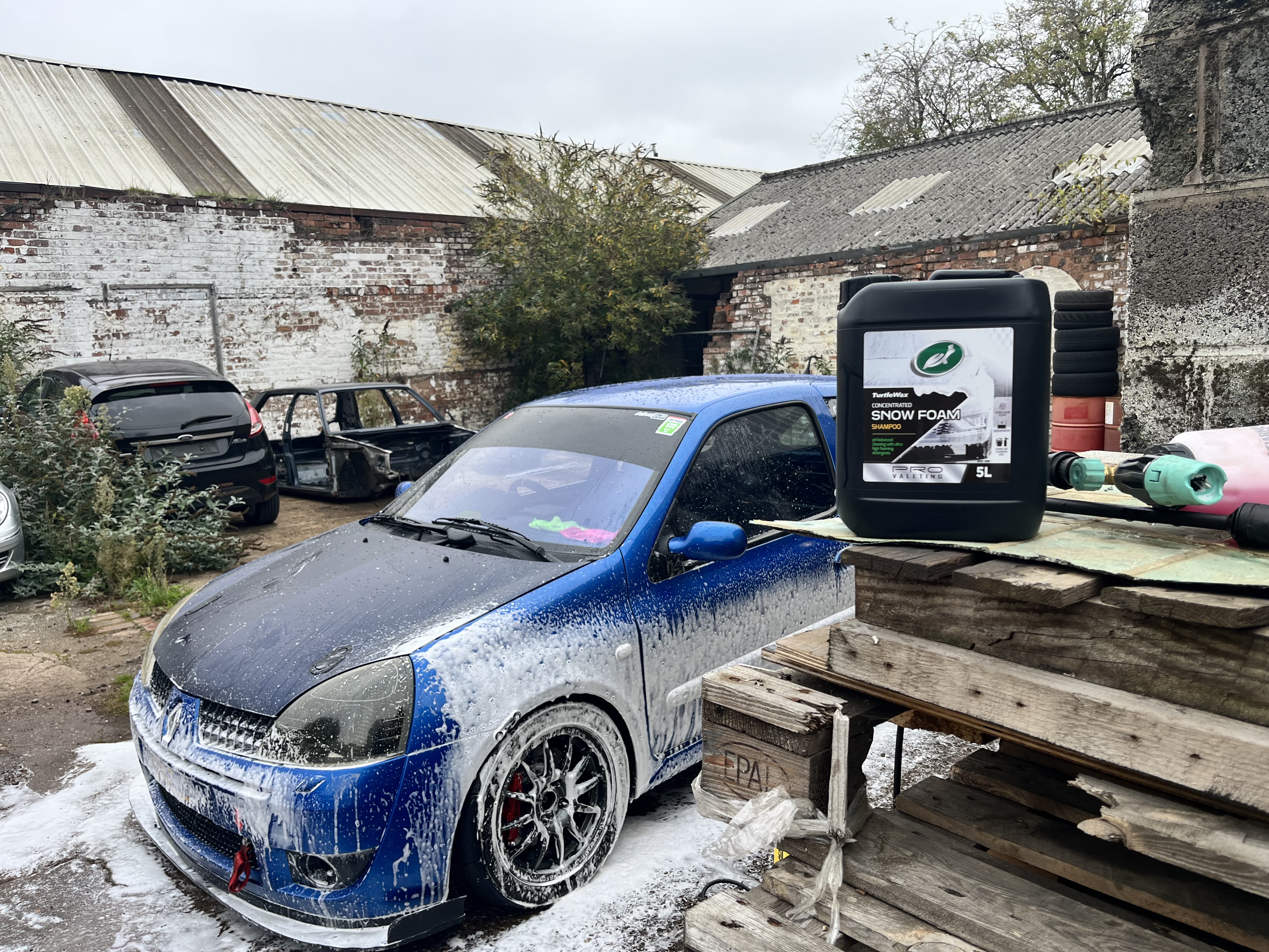

Got a bit carried away, cleaned/ polished the headlights, cleaned and ceramic coated the car, then wrapped the bonnet as I was fed up of the primer grey.
Whilst the colour was just what we had, it looks much tidier now and ready for the next track day.
Just needs to wheels aligning now.

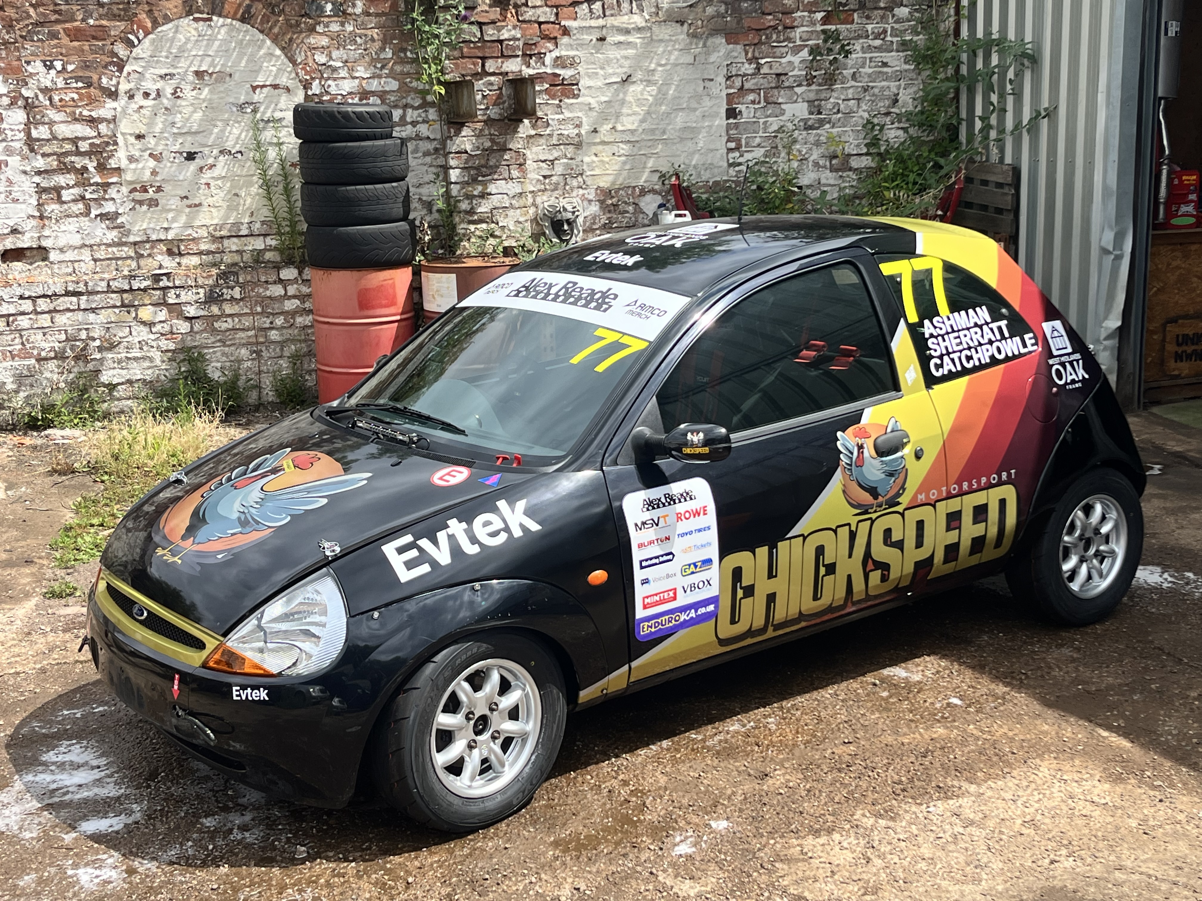

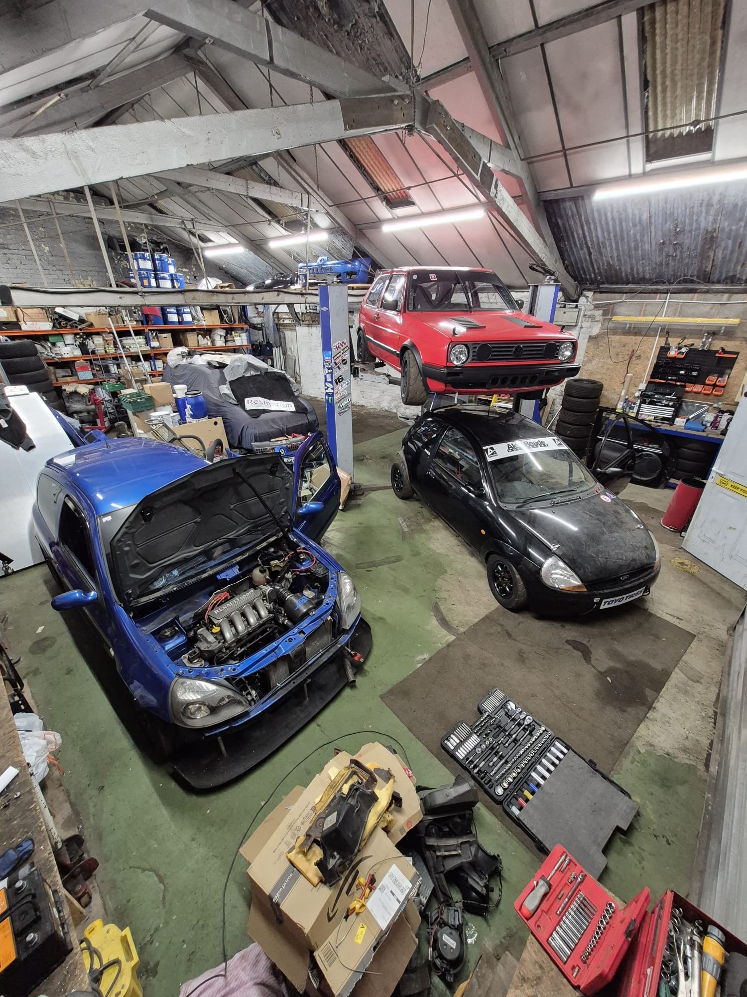

See how all that goes, along with some mates we’ve also decided to race an alongside a Ford KA in the KA-Enduro, scratch the itch of a bit of the boyhood motorsport dream. If your intrested that’s over on instagram @chickspeed_motorsport
Been great having space to work on the car indoors. Loads of jobs done ready for its next trip to the track.

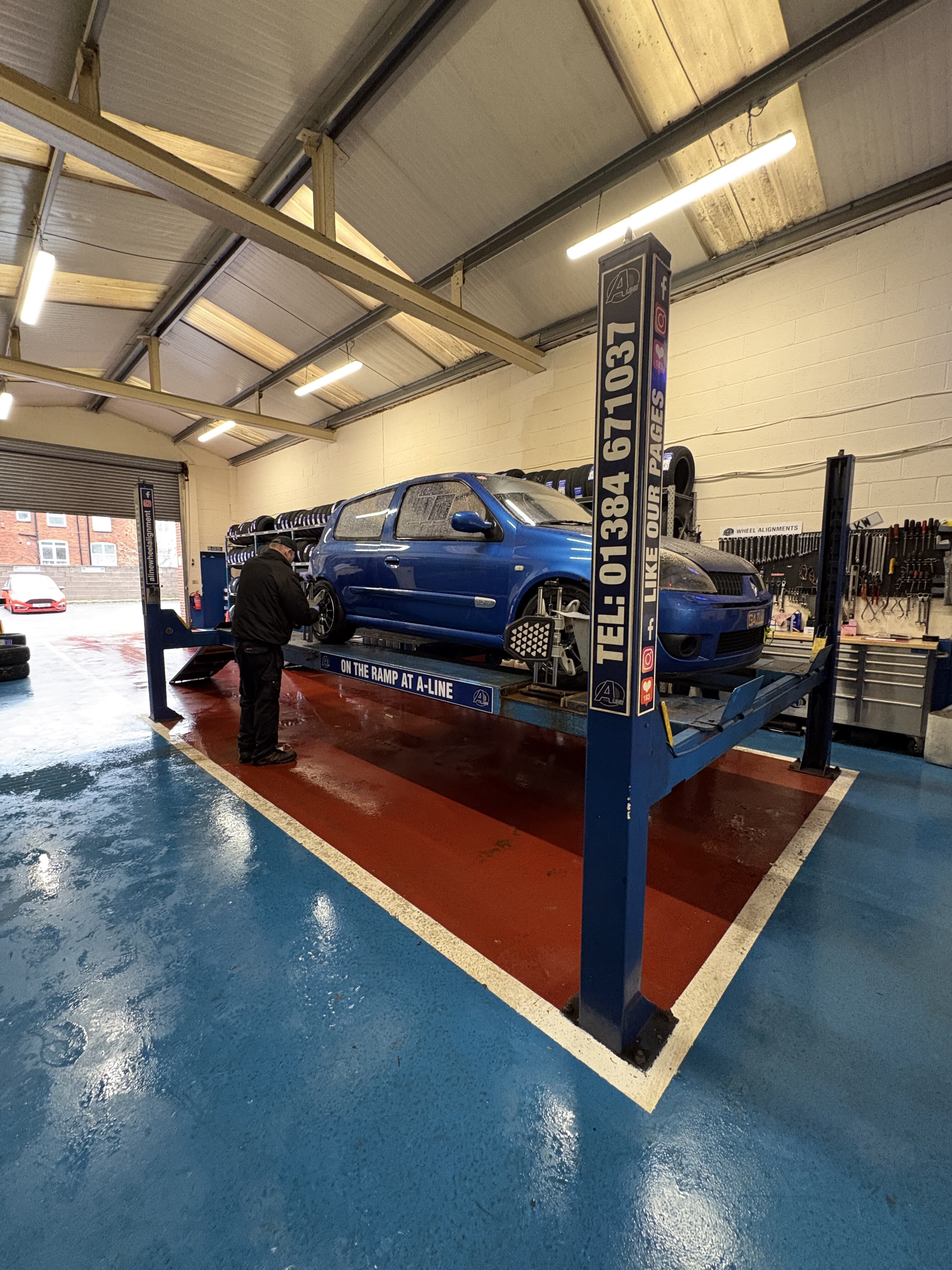

Splitters fitter again, cars cleaned, and a visit to A-Line to sort the alignment, maxing the camber as much as possible.

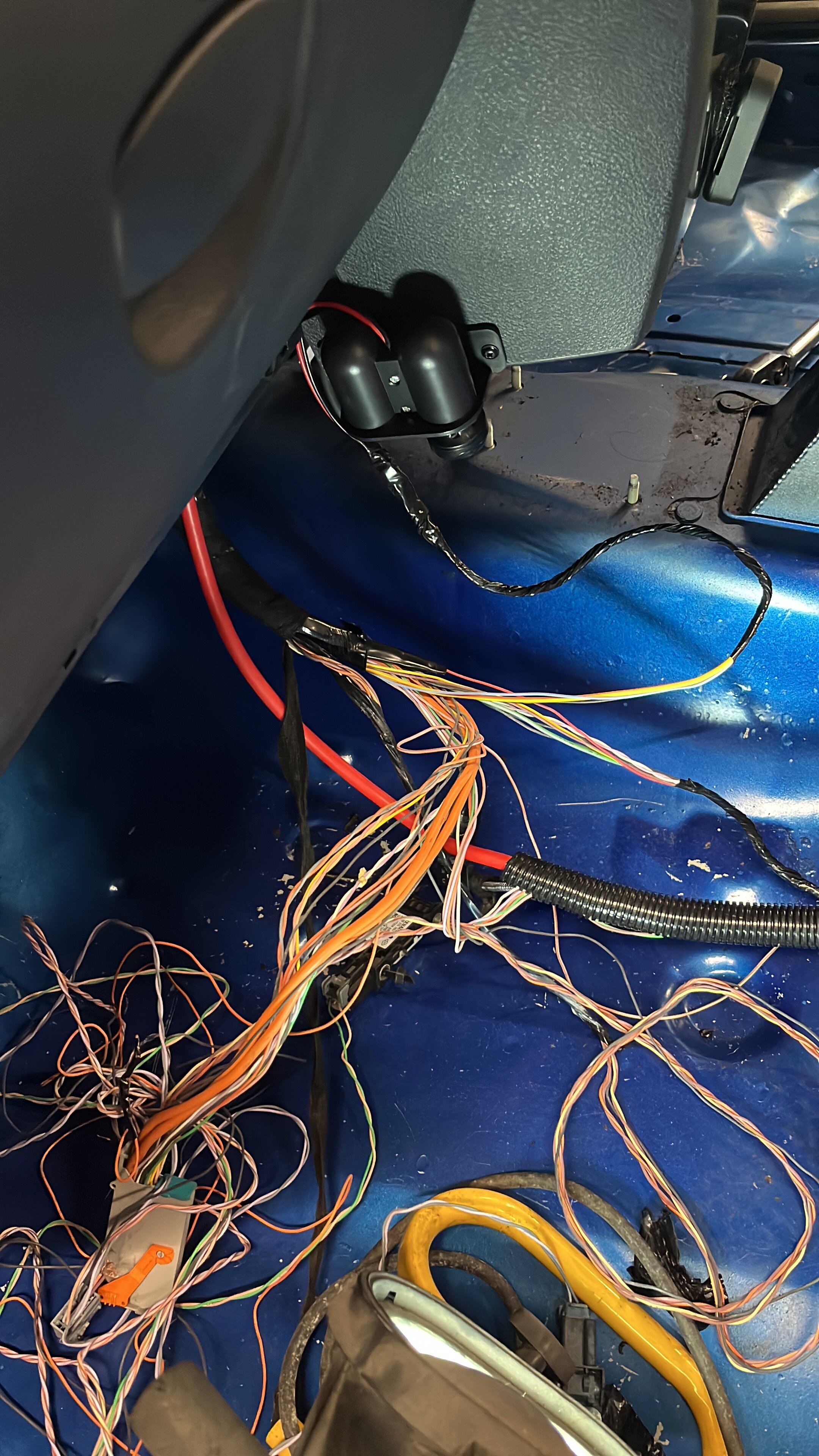

I decided it was time to put the car on a diet, as it’s not going back to a proper road car, took out a few pieces- radio/ passenger air bag/ some of the unused loop and sound deadening.
Time to fit the Jack Webb lightweight battery and lightweight heater now before its next outing.
Then toying with replacing the glass with polycarbonate windows. Can remove the electric windows then.
Well that escalated… thought I’d remove the passenger airbag, then start fitting the new battery…. Then removed a lot of things that I don’t need. Interesting game of finding all the screws that hold the dash in. The sound deadening behind the dash weighs a tonne (and is a pain in the bottom to remove).
Still need to finish fitting the battery, trying to find a nice route through the firewall without drilling more holes in the fire wall. Plus fit the cut off switch in the car. Waiting on a “dash pod” from Racing Cult too.
Then after that time to remove the heater and replace it with the T7 unit I have if I get chance.
A lot has come out.
Now time to try out back in what needs to go back. Plus fit the T7 heater.
Polycarbonate windows purchased too, just need to figure the best way to remove the rear side windows. Any ideas?

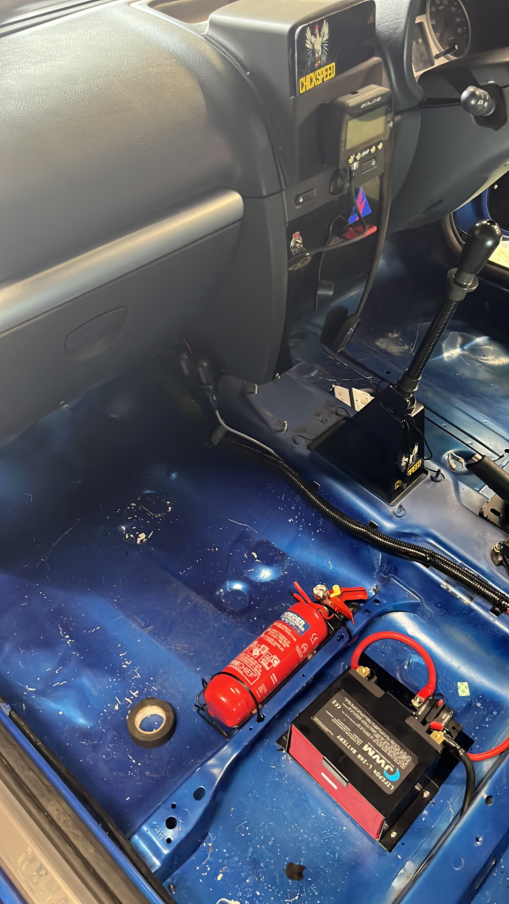

Rebuild started. Clios look quite good without window wipers…
New battery installed nearly and wiring routed, ready for when the dash goes back in.
Sound deadening removed, just need to remove the residue. All holes taped up with aluminium tape for now to stop some of the draft!
Most of the interior that’s going back in is in, T7 heater and ducting is installed.

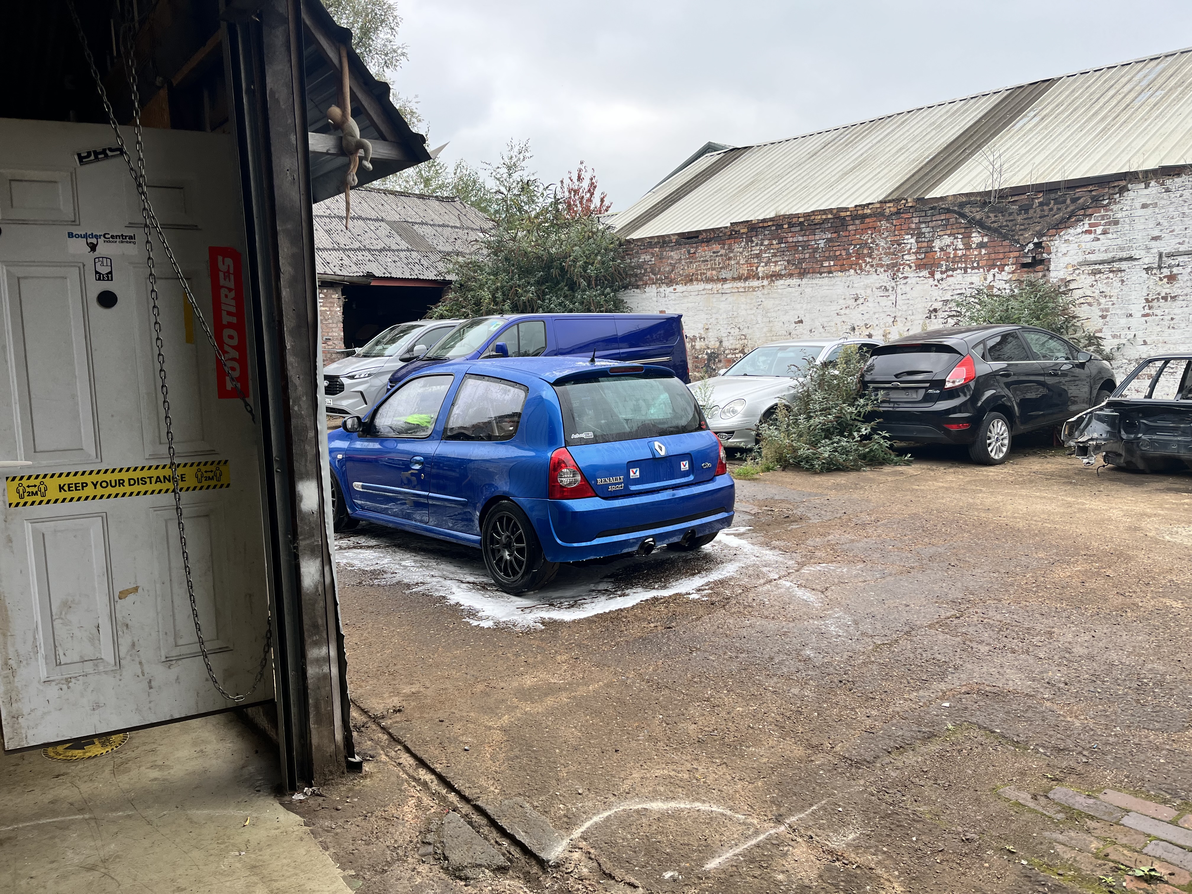

New alternator fitted, and all working perfectly now
Also, car ruined further by removing the headlights, will add venting to the NS one. Still have all the wires and lights if required.

Car clean and ready for another track day. But first a little bit of fun in the new race Ka. Bought it with a couple of friends to try some budget motorsport.
First race at Donington Park this weekend:
Should be a laugh!!! Follow @Chickspeed_Motorsport on Instagram for the antics

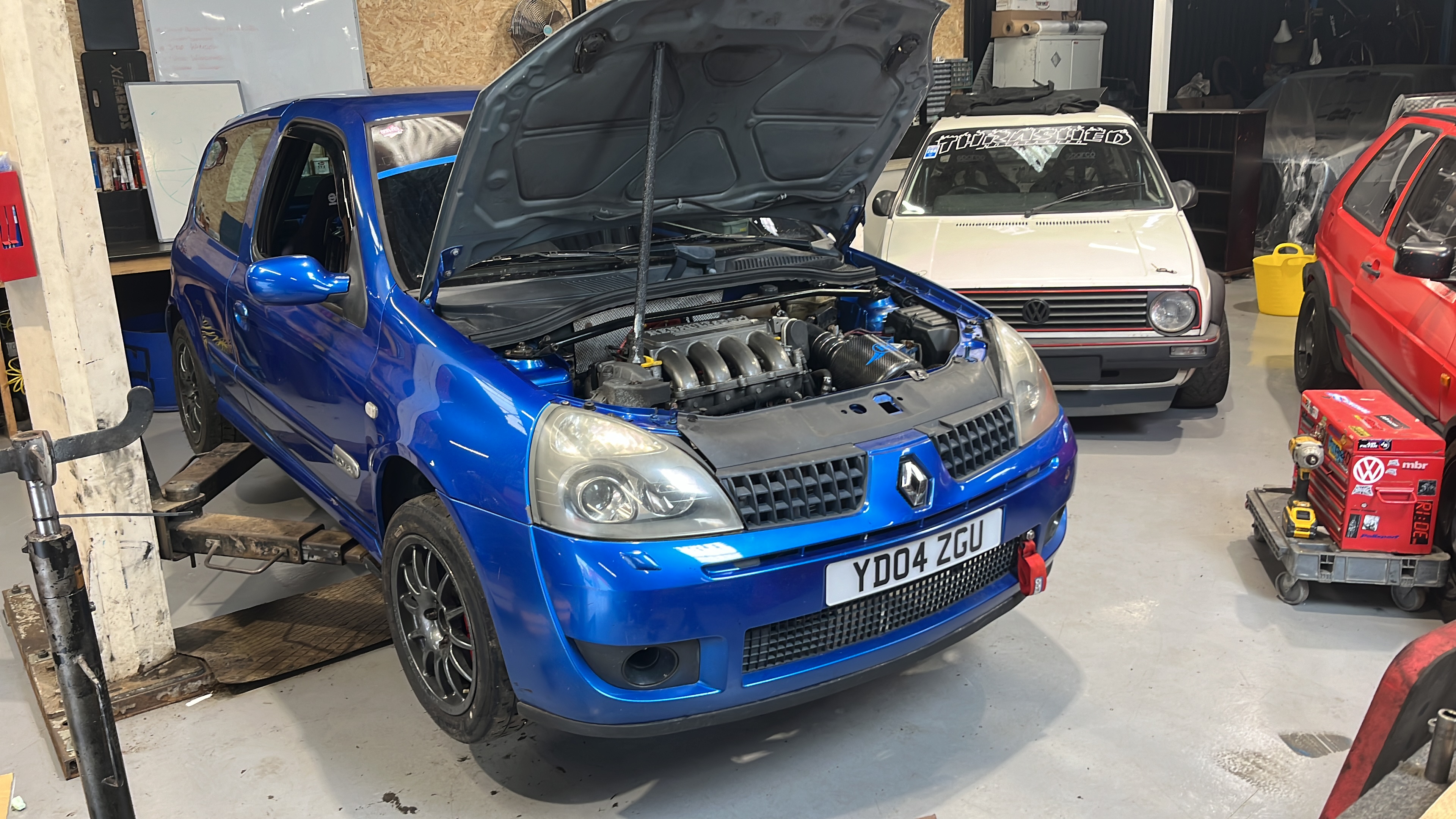

It’s been a while since the Clio rolled out. Little clean ahead of a track day on Monday at Croft. First time to Croft.
New PBS pads fitted, cars prepped, checked and cleaned.

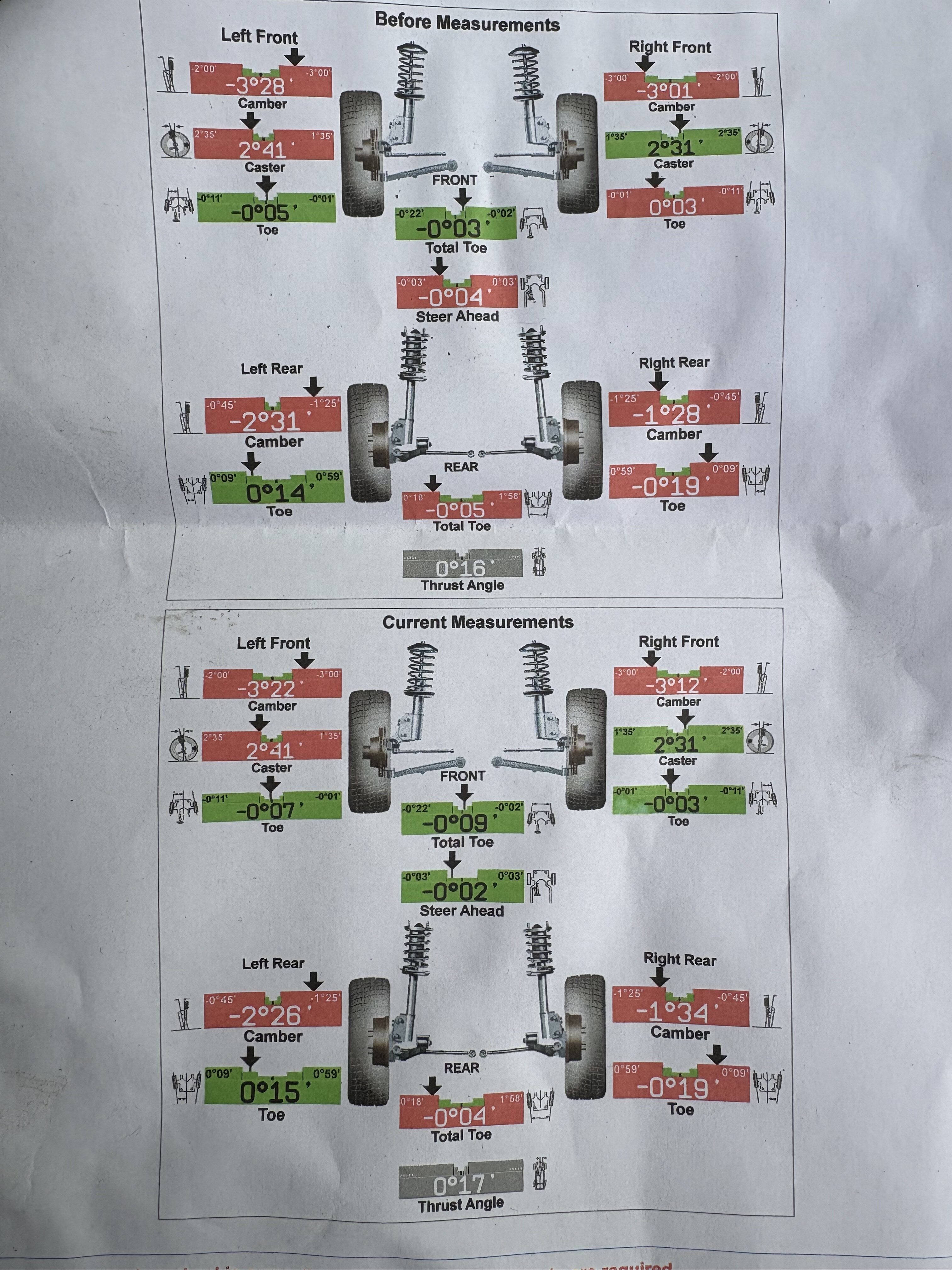

Had a slight “off” at Croft in the sunny In/Out chicane and ended on the grass, so alignment checked- after a visual check over.
The car is all straight, but the rear was out slightly on the camber. Turned out it was a failing rear wheel bearing with a little play.

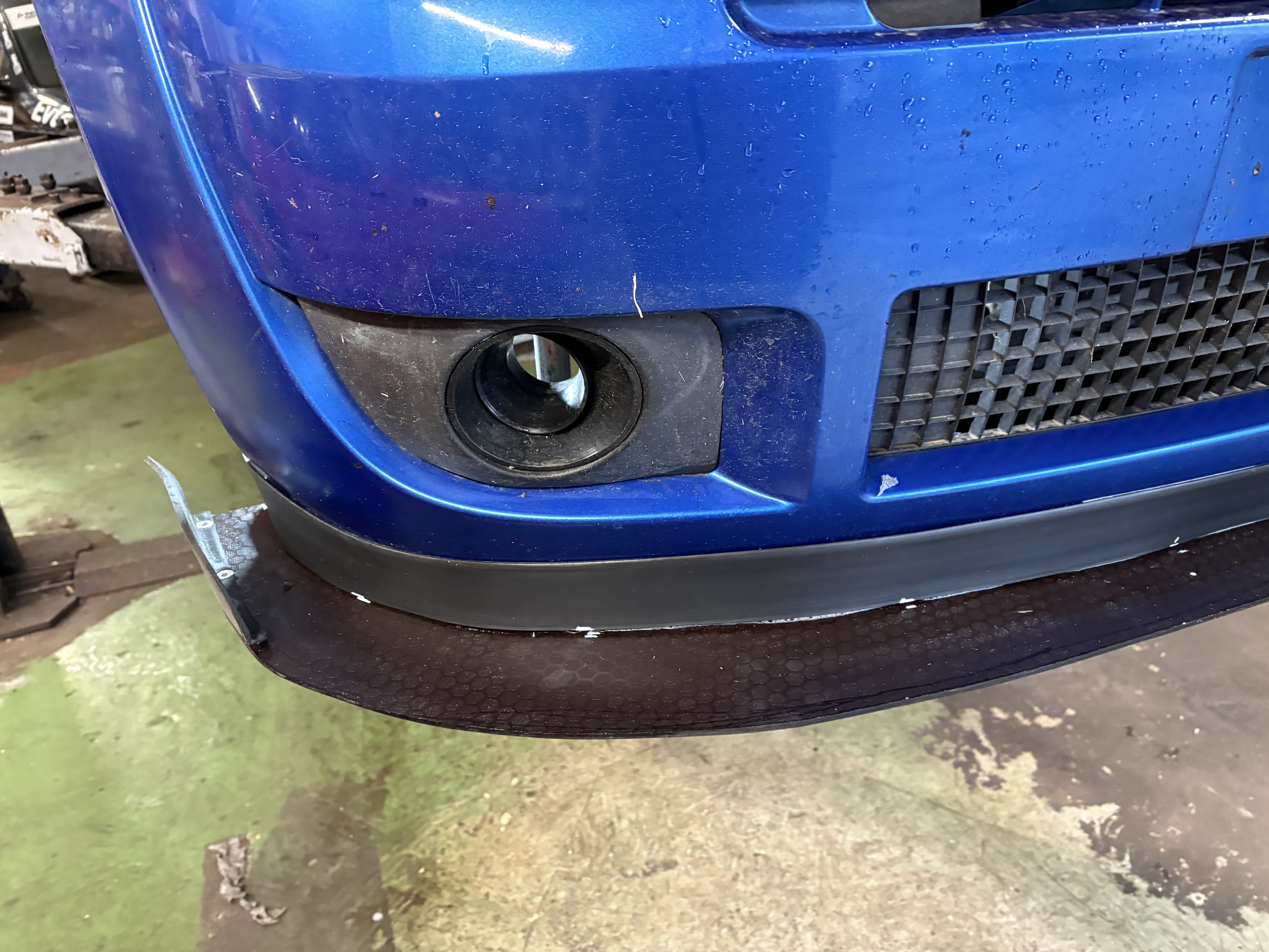

The splitter was a little destroyed- so new one from Advocult Motorsport fitted
We’re out in a couple of weeks at Oulton- ideally the hunt for the sub 2 min lap is on… but chances are it will be a little moist, which will also be amazing!
Just waiting on new wheel studs to fit - and also may try find time to re-wrap the bonnet as that’s a little tatty now. Plus a good clean!!
Alignment settings from 07-02-26
Riverside Rear camber out due to play in rear bearing
New wheel studs fitted to the rear (will fit the fronts when I change the discs next). Full fluids check and topped up.

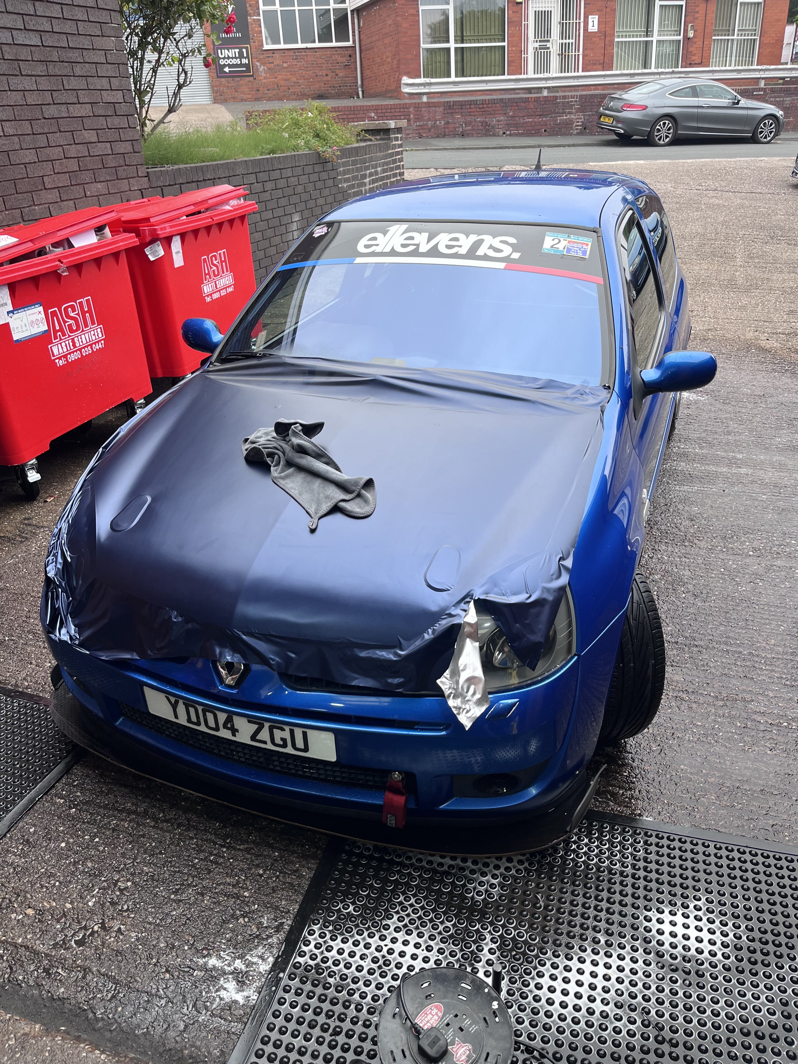

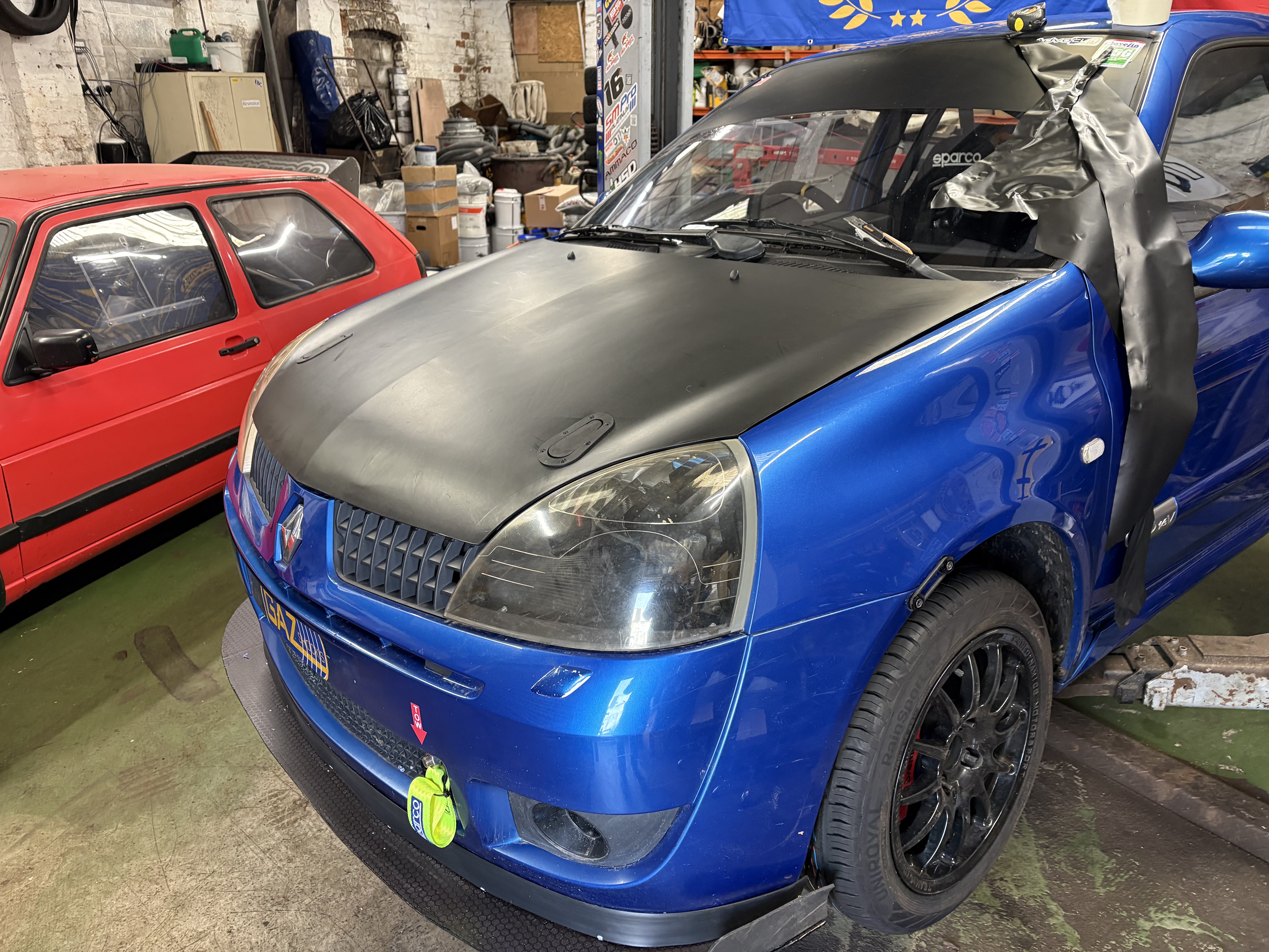

Re-wrapped the fibreglass bonnet matt black and a wee clean up ready for Oulton Park on Tuesday.

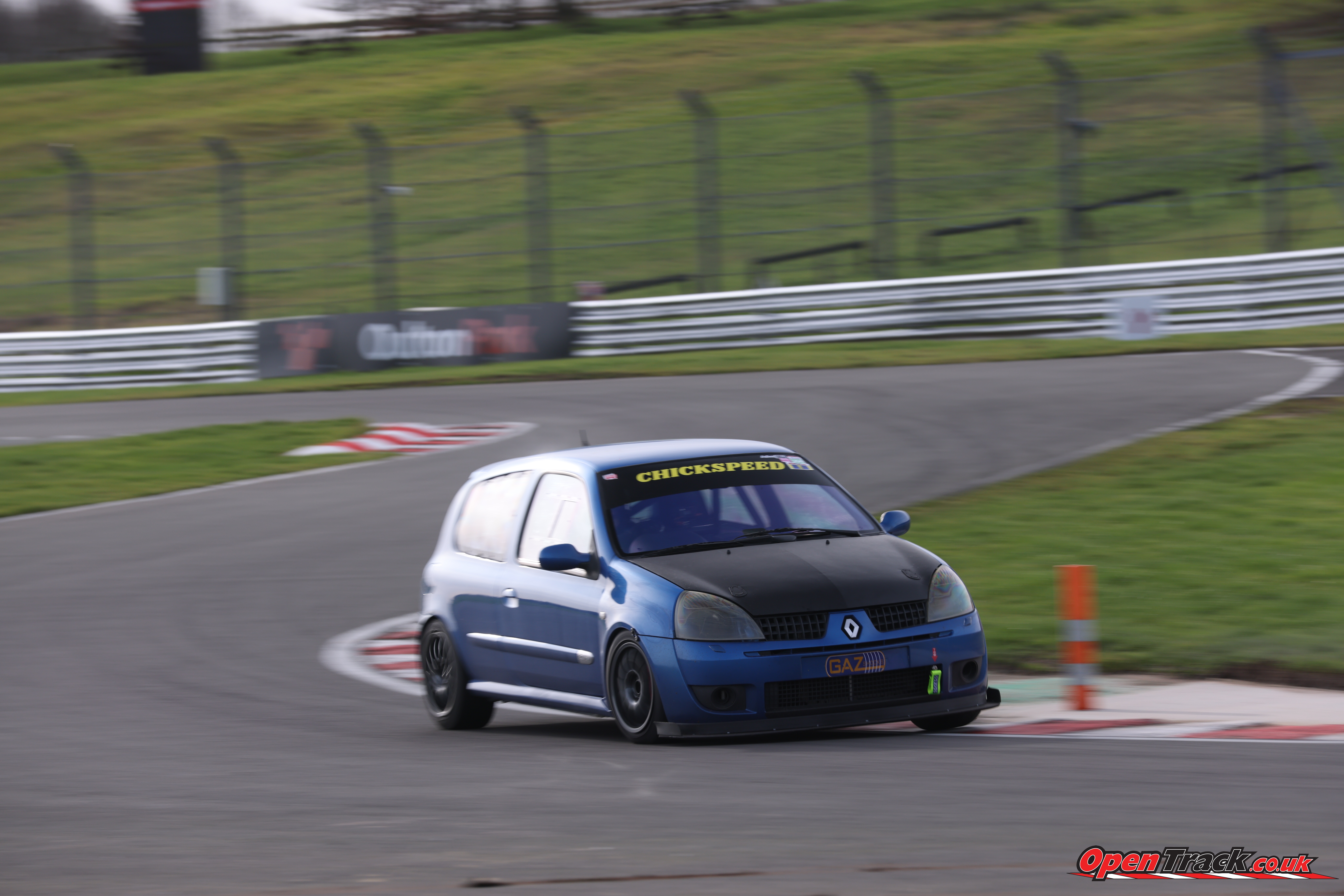

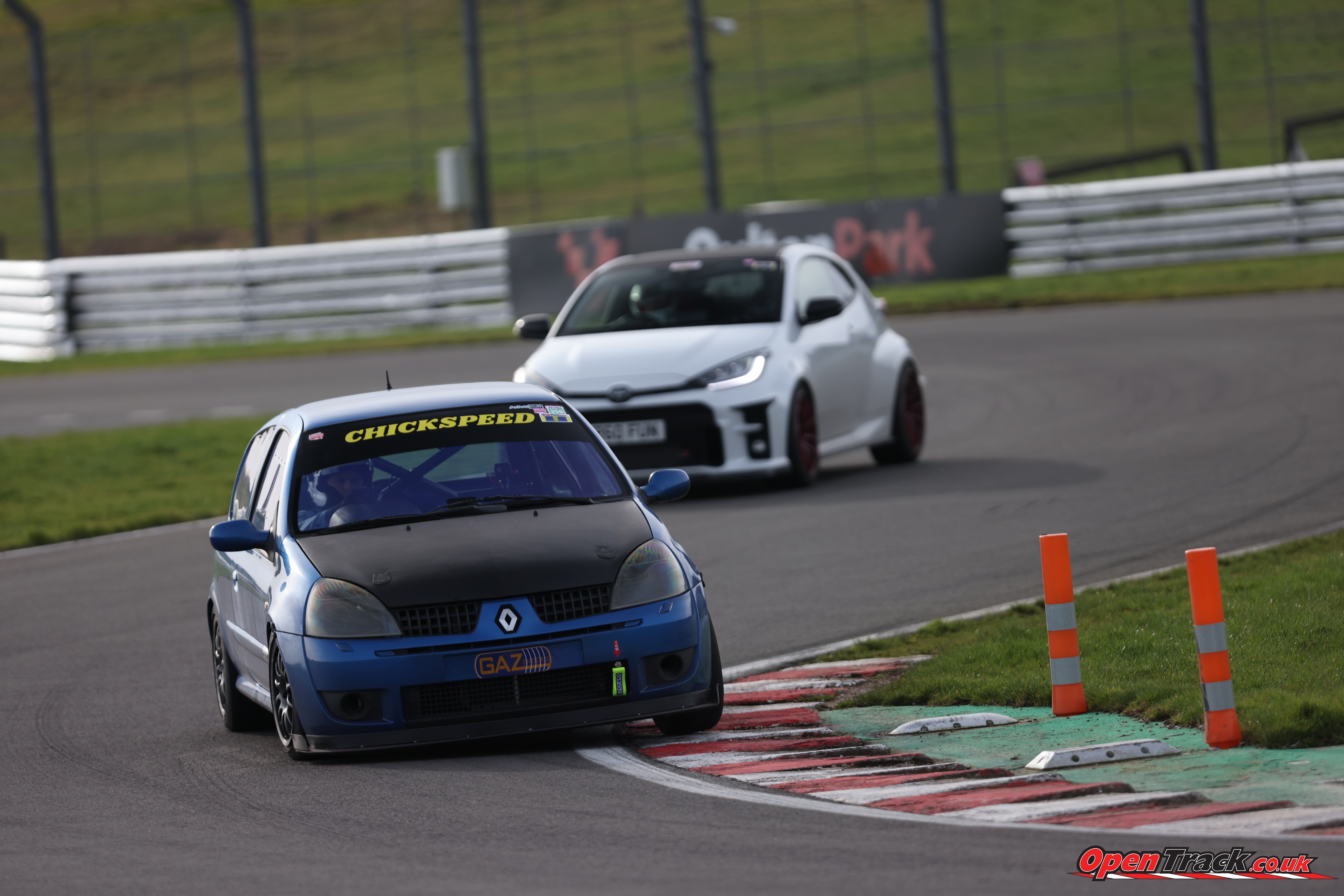

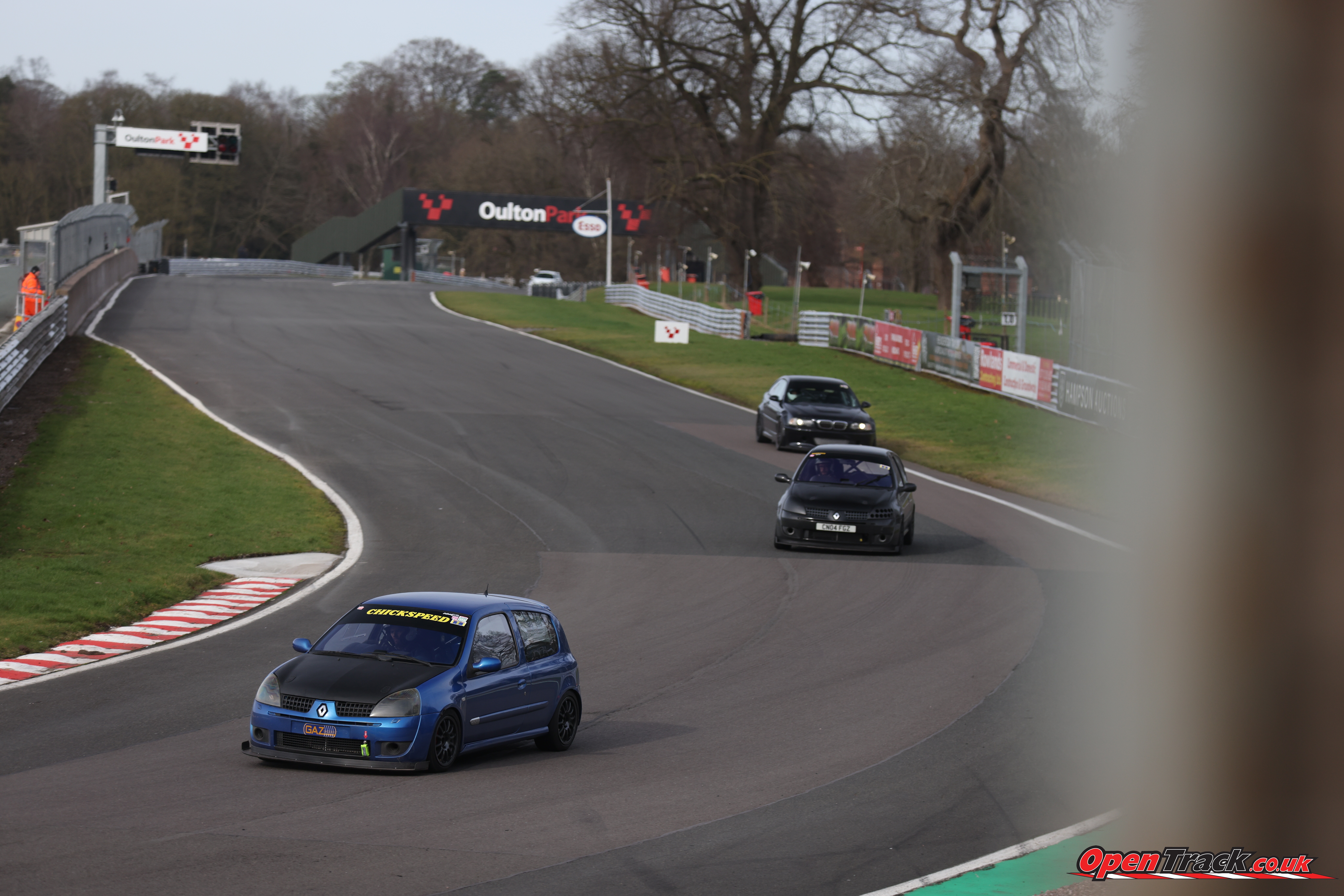

Professional shots from yesterday- lots of Chickens black Clio 172 in train! Chicken managed to go a little quicker than me overall- fair play some commitment! (I still think it’s cus I gave him a draft down the lake straight! Haha
