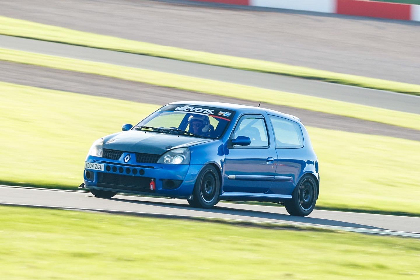

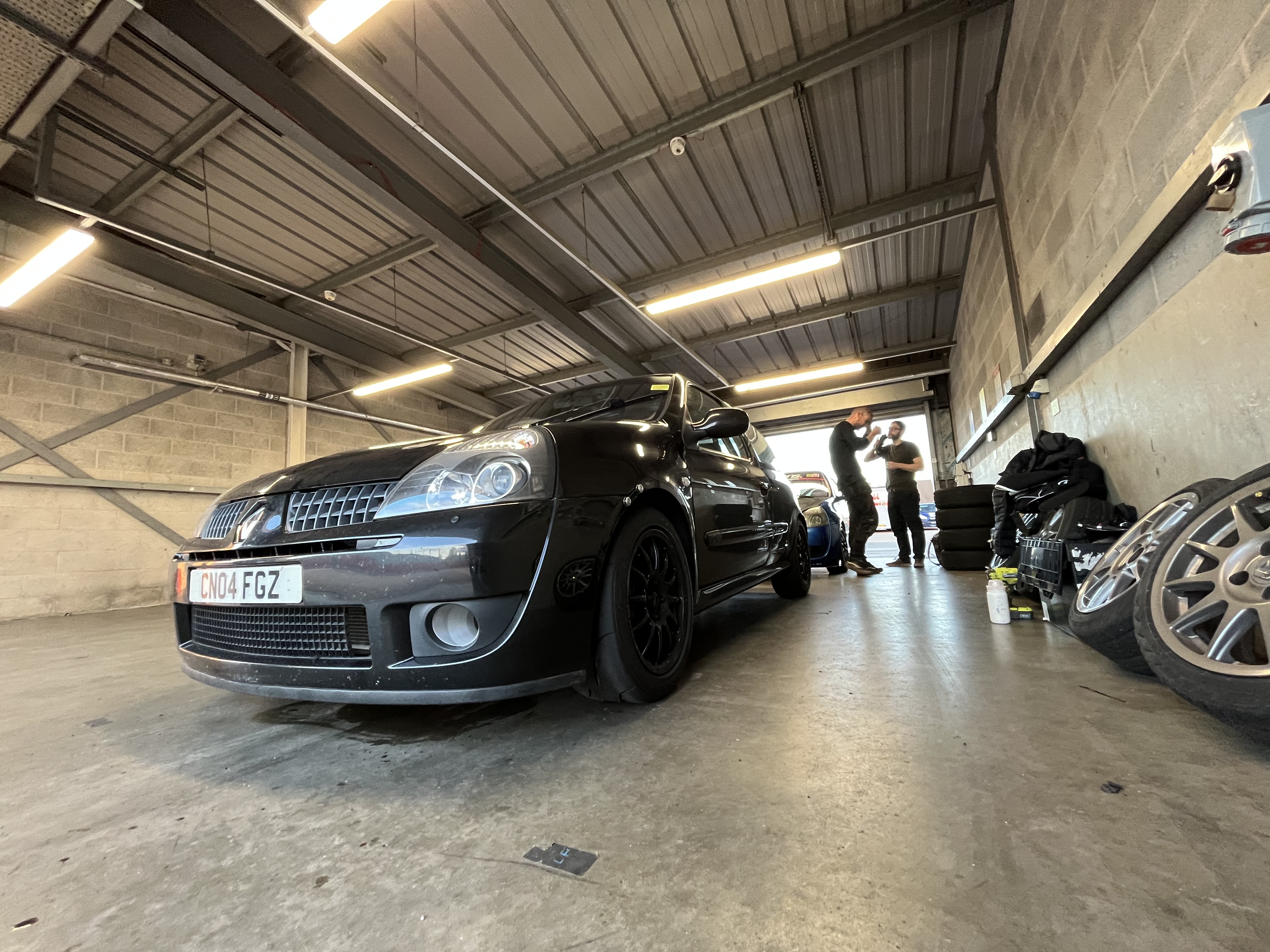

Evening on Thursday at Donington, loads of clios out to play with. Car ran mint- but of a scare when I had a mini leak, but that was due to me over filling the gearbox.
Killed off what was left of the PBS pads- so taking it easy in the heavy braking areas.
The car feels so dialled now on the turn in and through the corners. Really impressed with the MRF tyres, few laps to warm up, but they stay so consistent for laps and the wear is much better than the R888’s.

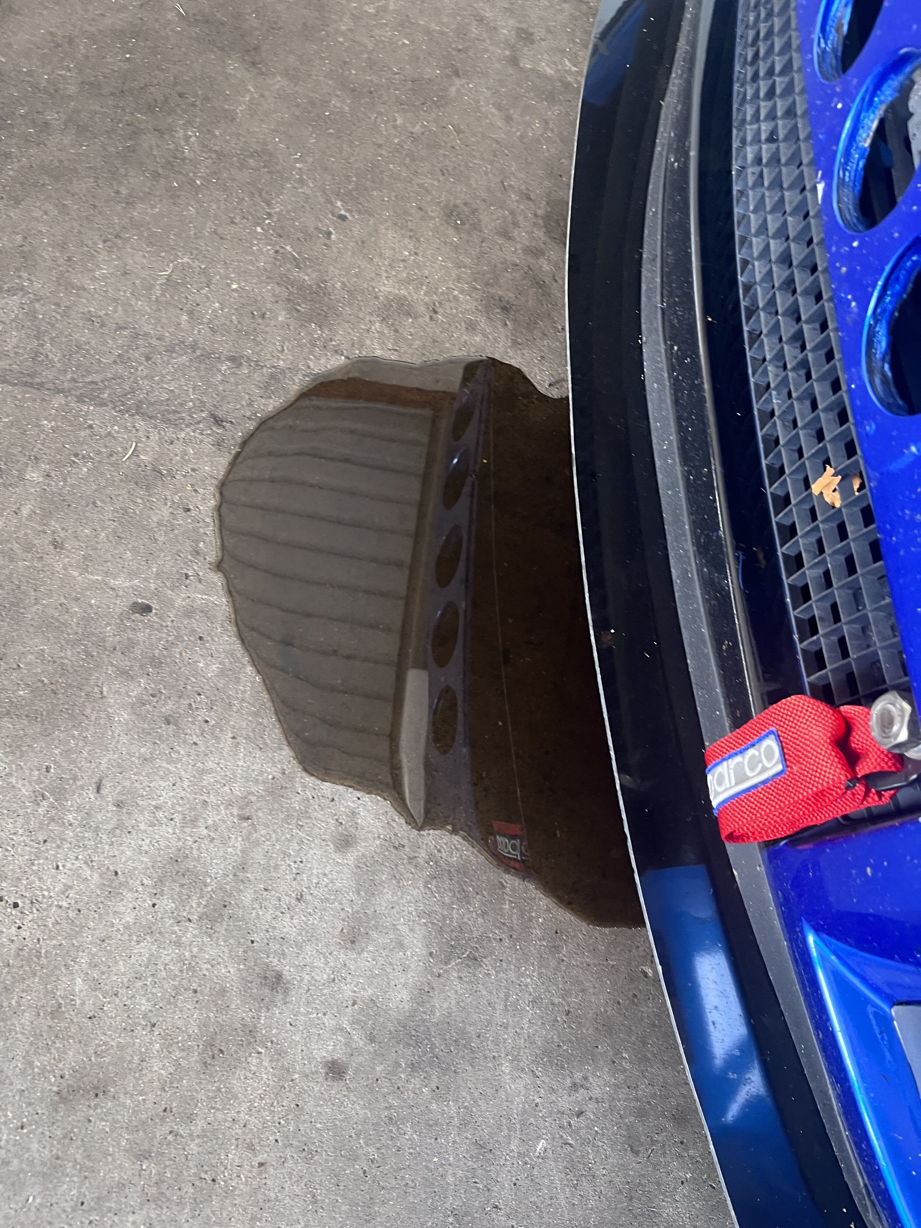

Developed a little power steering leak but found the source and just need a new pressure valve.

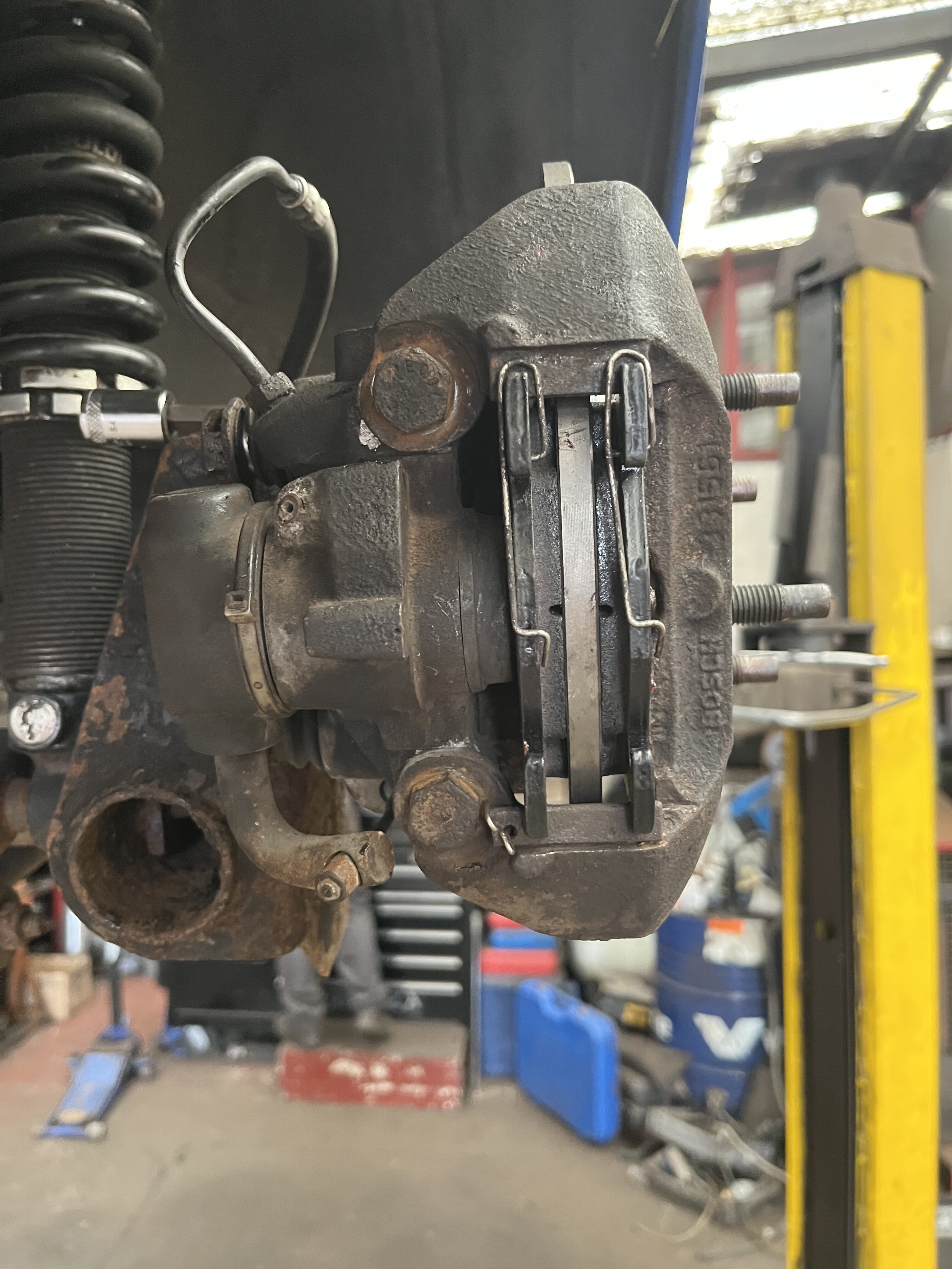

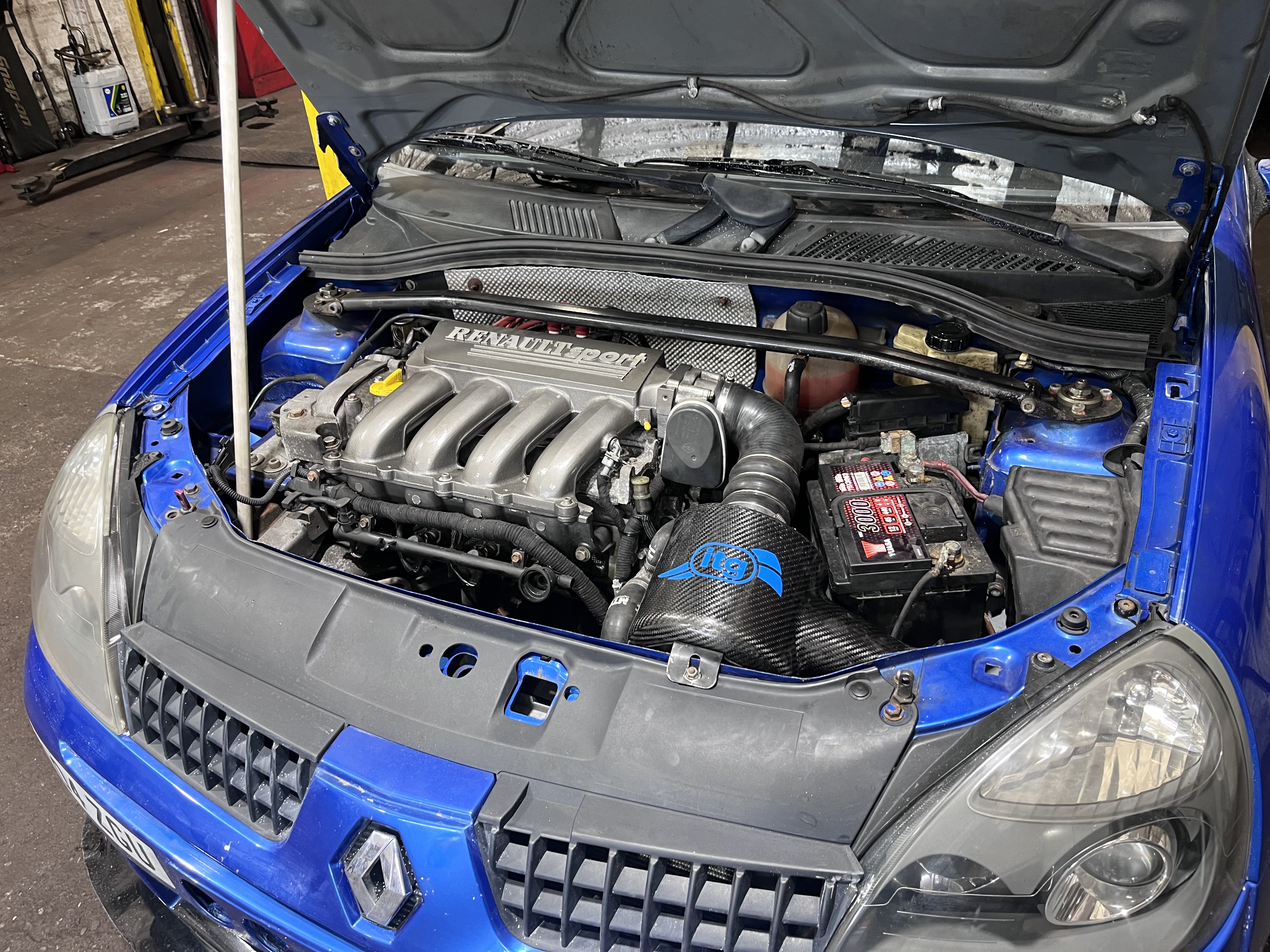

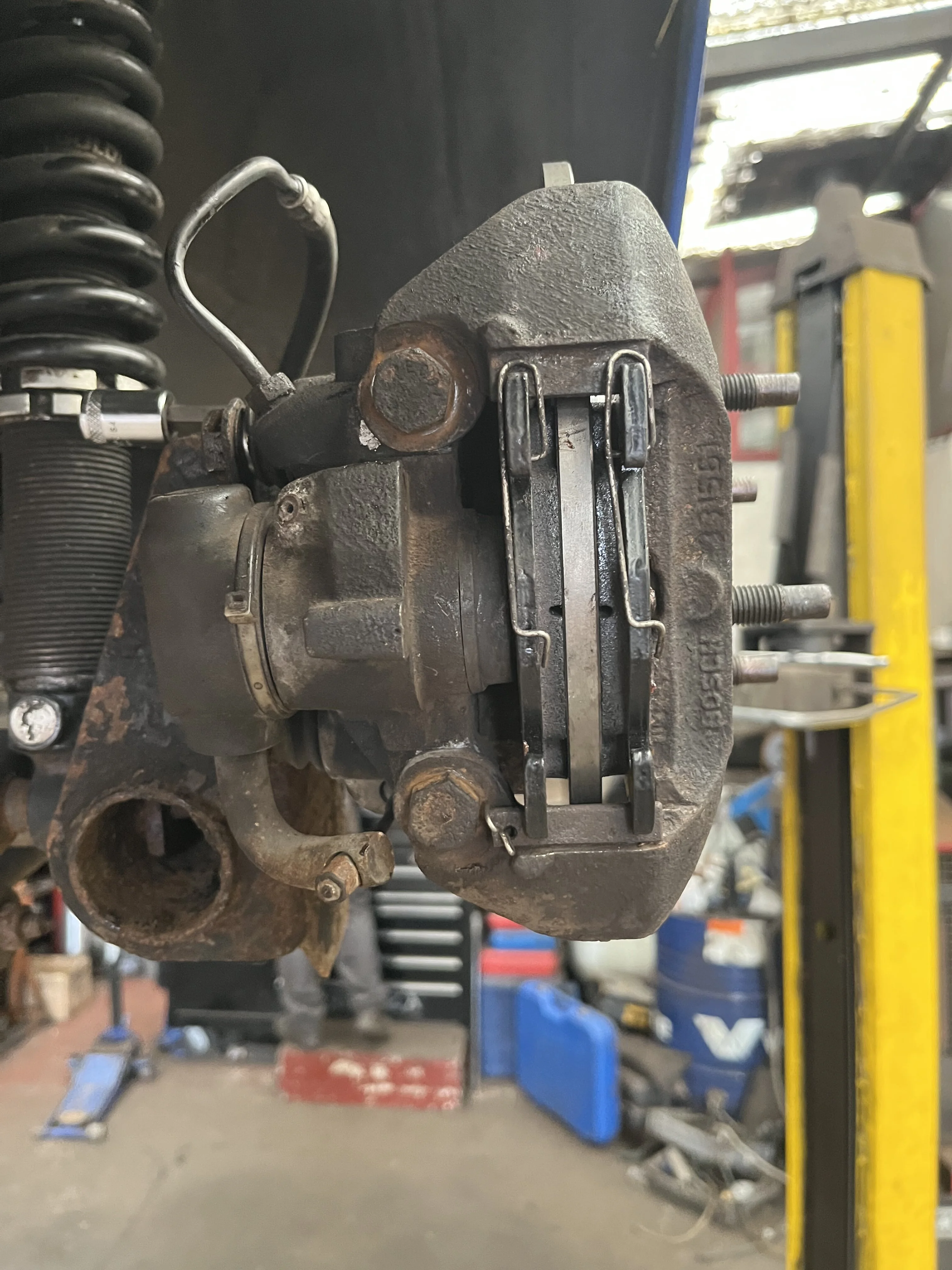

Spent most the evening trying to find the issue, turns out the rear wheel bearing on the left rear was the issue. Also an intermittent ABS fault (sorry me times it worked, sometimes it didn’t- which was “interesting”).
Limped home and today fitted new rear discs and pads (inc. new bearings). Checked every bolt on the rear to make sure nothing else was loose. Problem solved. New Brembo discs- great service from @FrogJam Motorsport and new DS2500 pads.
Just ordered a new OEM ABS sensor for the rear right as it was throwing up a fault. Sort that next week as well as fresh brake fluid and oil/ filter change.

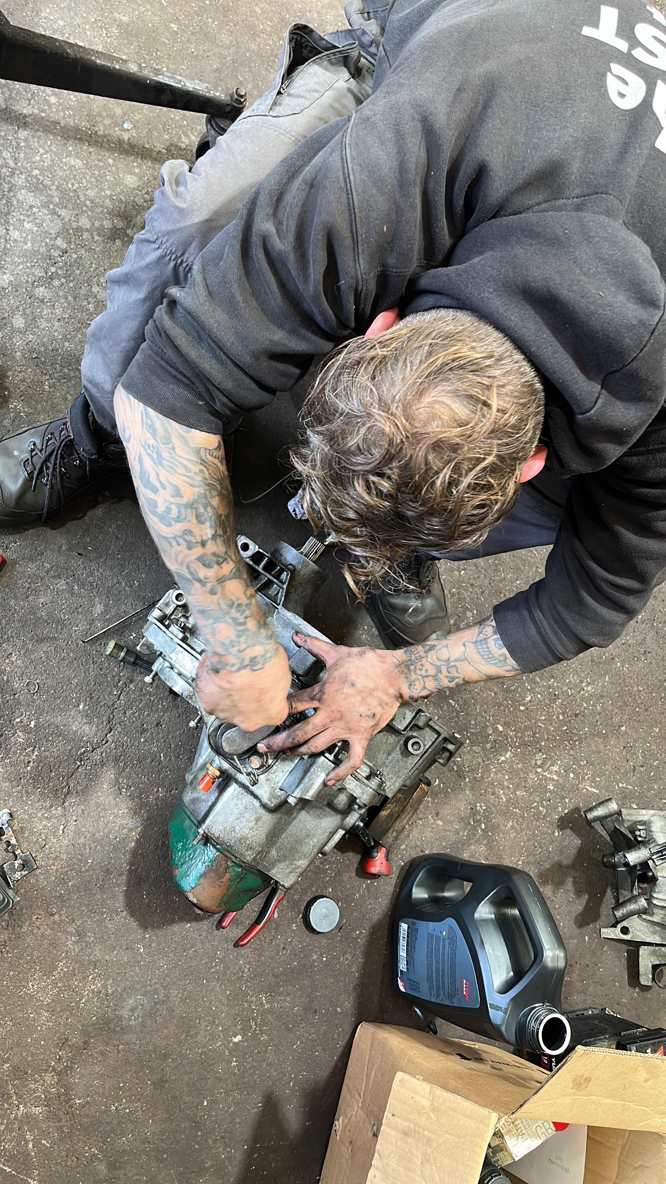

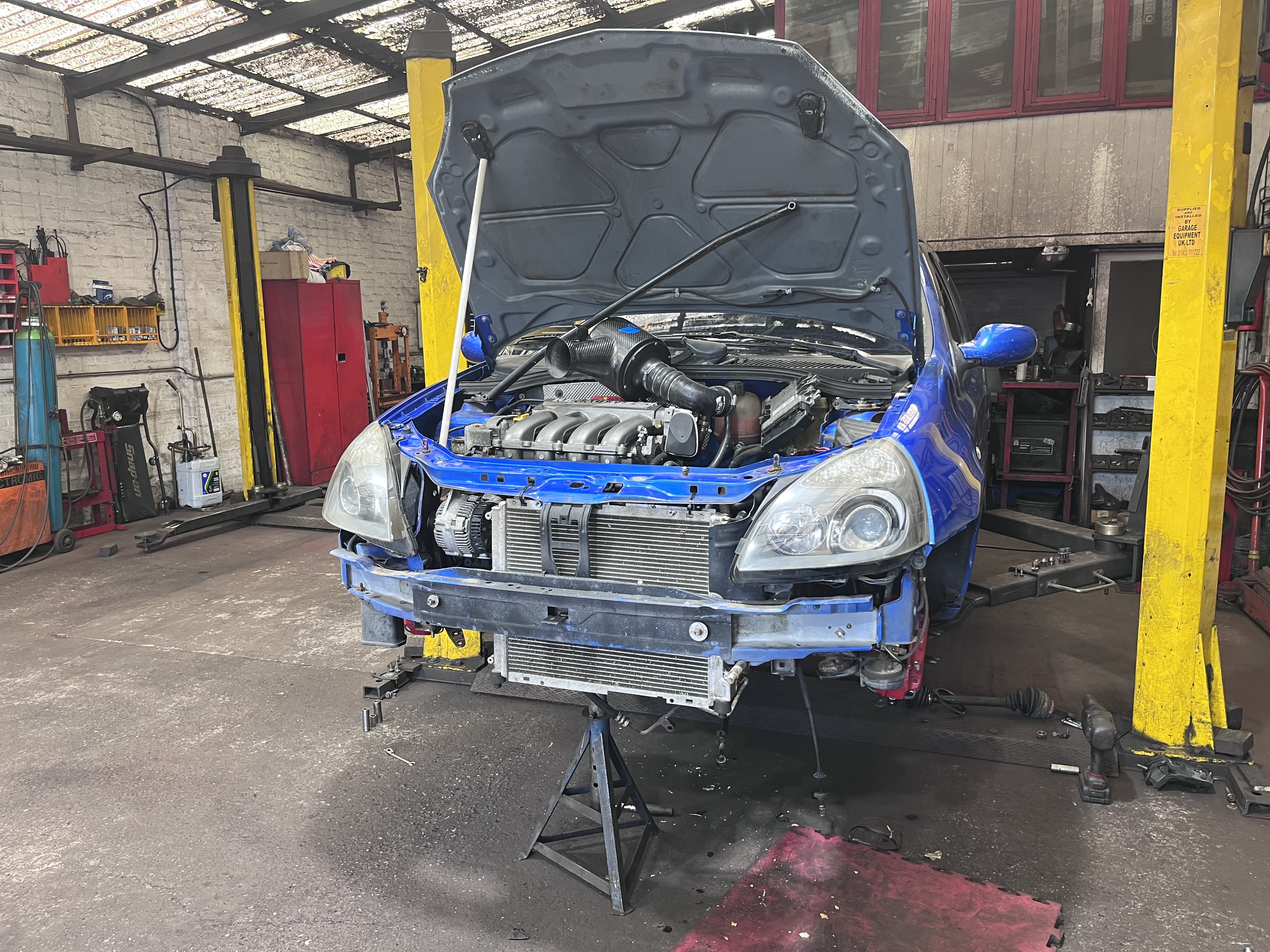

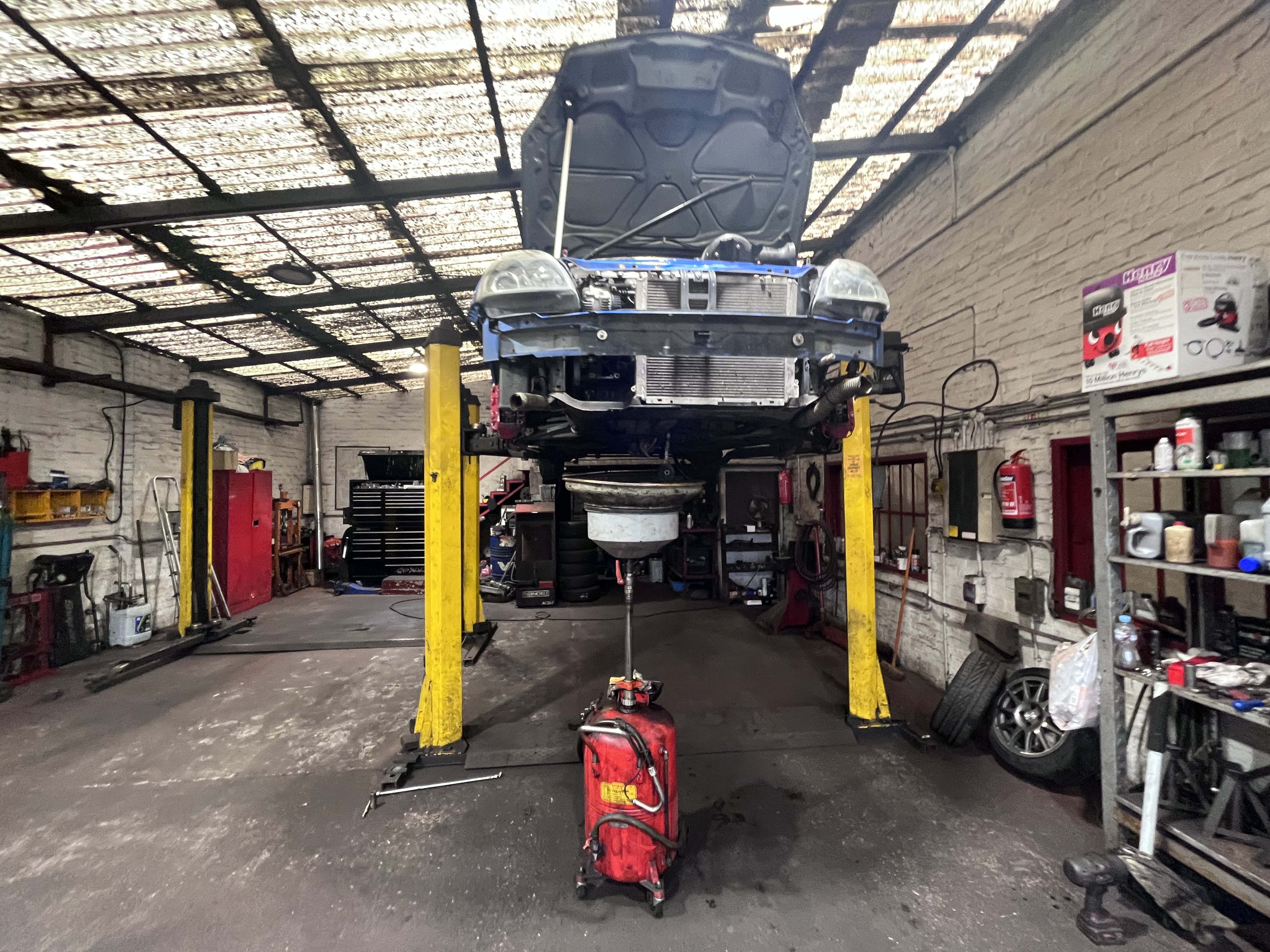

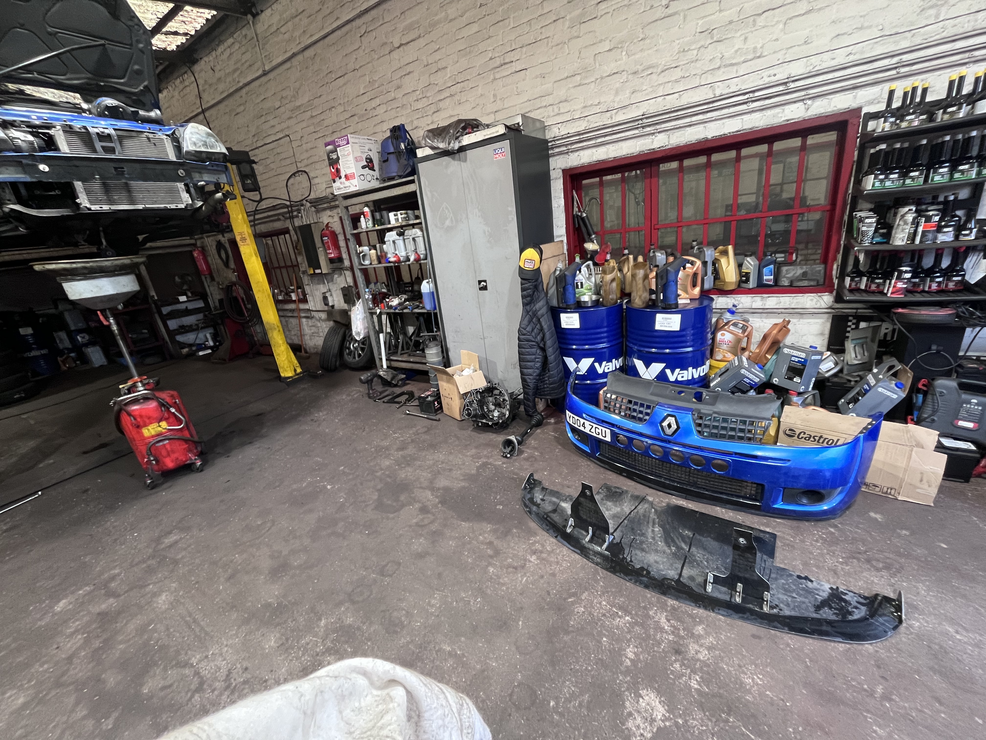

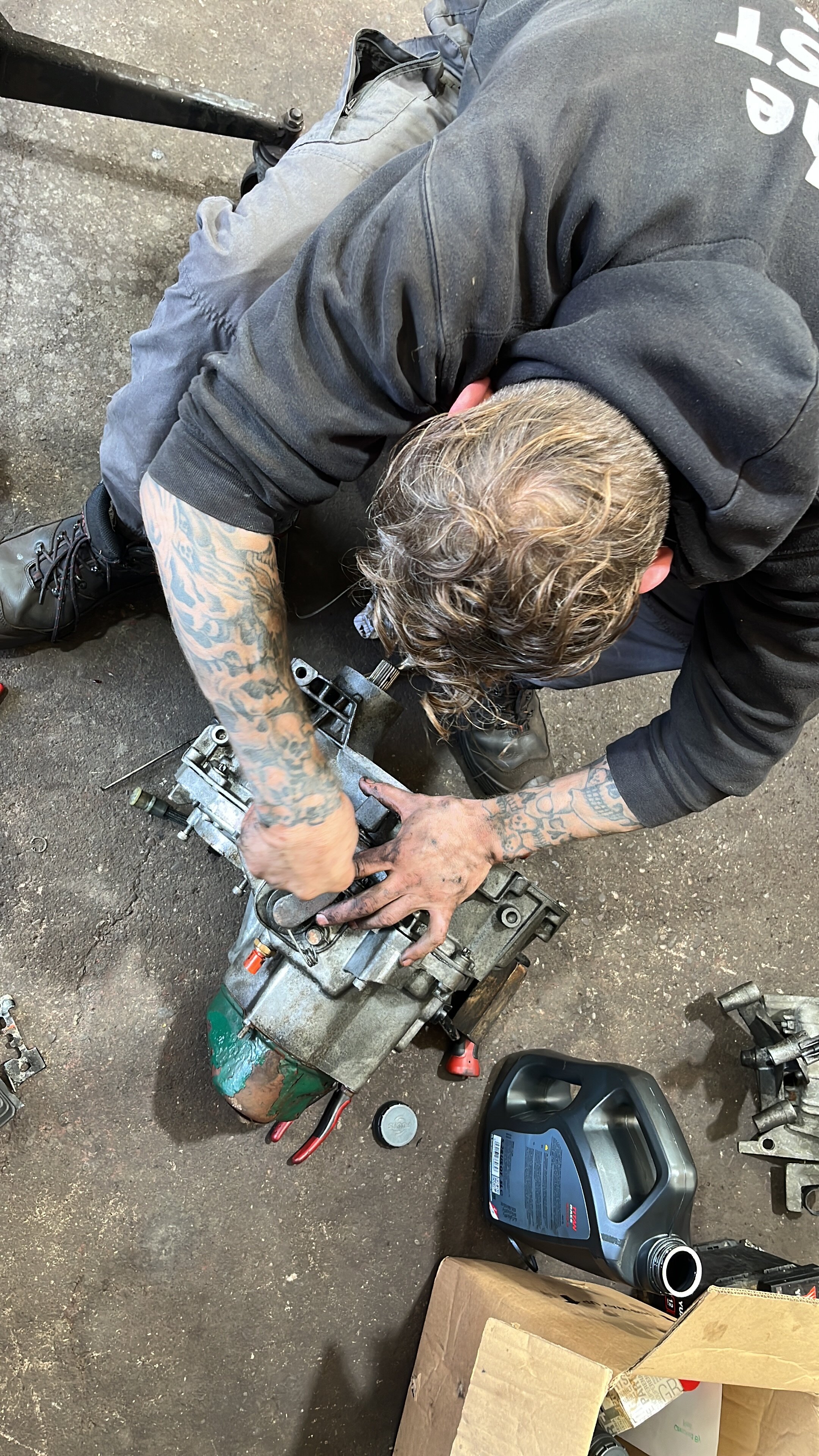

Bit of good news, the gearbox was fine, the gator on the driveshaft was not and caused the exit of oil.
however, I had bought a spare gearbox in the mean time, fitted with a GRIPPER differential. Huge thanks to @NorthloopCup for his work refreshing that and servicing it- can’t recommend him high enough.
As recommended by Mark, gearbox is filled with Redline MTL 75-80.
Also fitted a new original Renault N/S driveshaft with new gators etc.
Whilst there, changed the oil and filter for some fresh Fuchs Titan Race.
Changed the brake fluid too, swapped the swamp water (old Motul 660) for some fresh Motul 660.

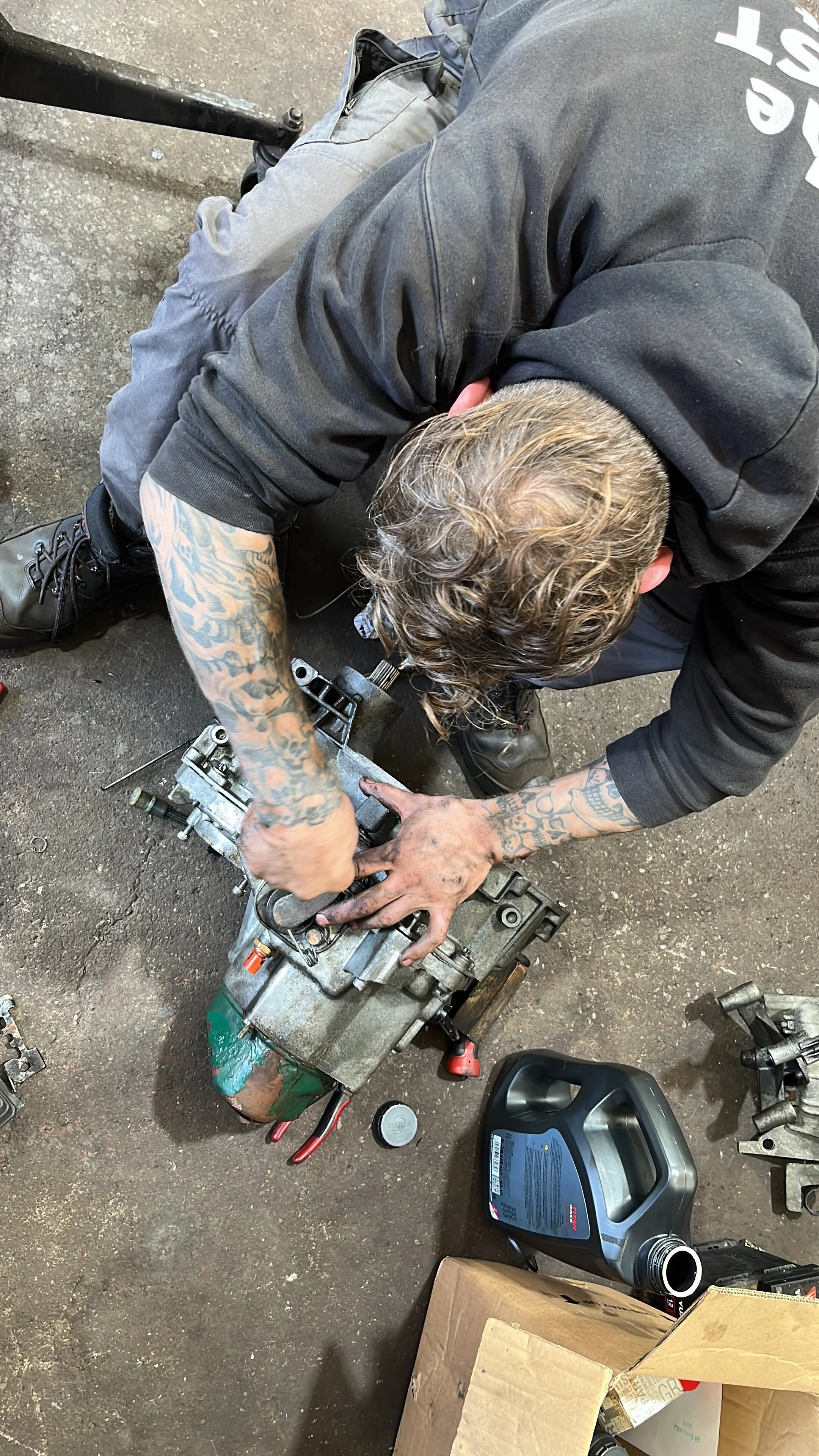

The car is now ready for a big day out on Friday (3rd November) at Donington

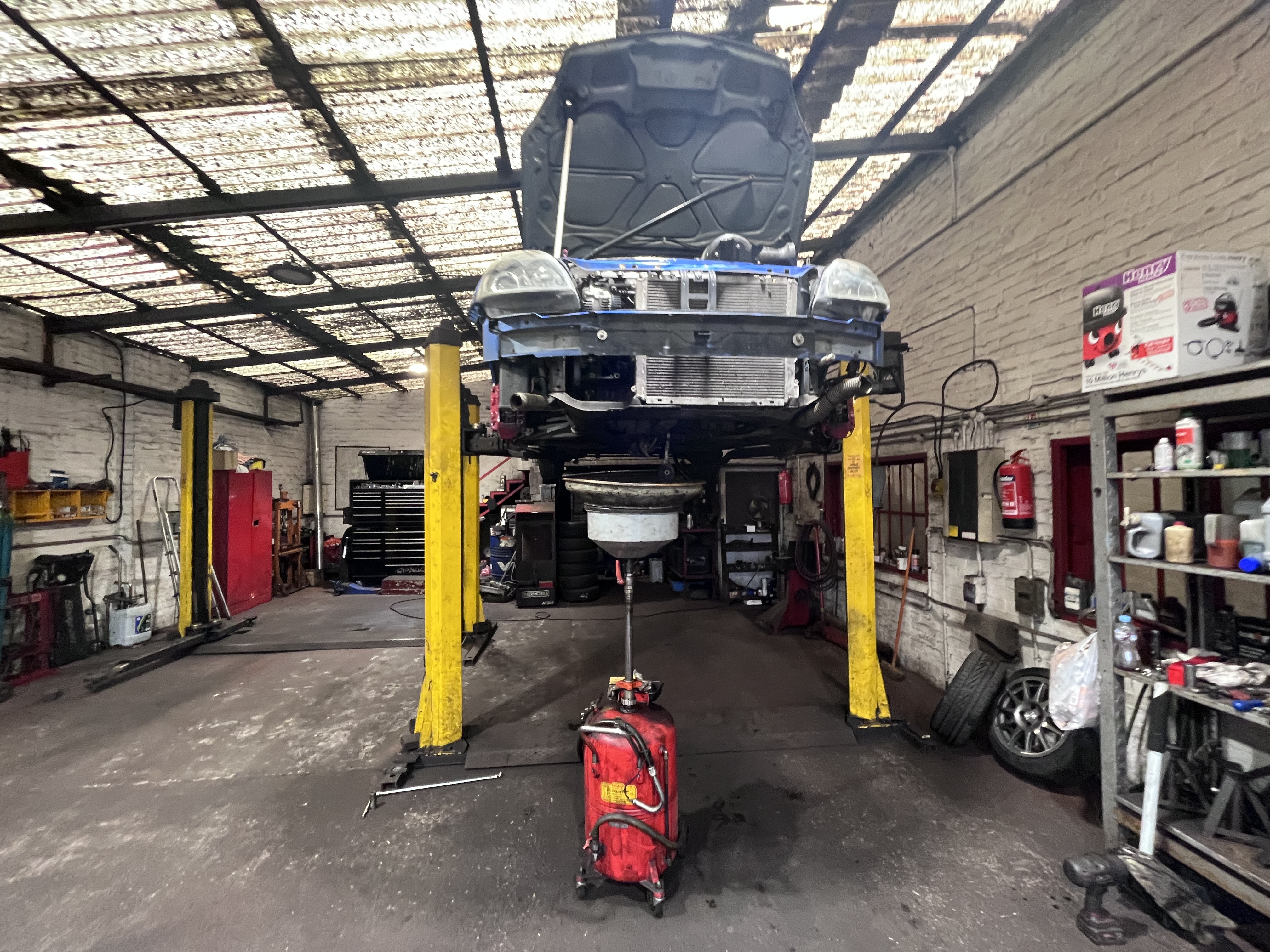

Went out to Donington earlier this month. First time with the new gearbox/ dif. What a difference. On a damp and greasy track, the car was amazing. Was just trying to get use to the change in the feel of the dif. Had 35 of us out on track so pretty fun time on track chasing the 1.8t powered Golf’s.
After fitting the box I made an error I’m not getting the alignment checked, felt out a little. Still mint though. Day was cut short slightly as the clutch started to slip- note to self, should have put a new clutch in with the box

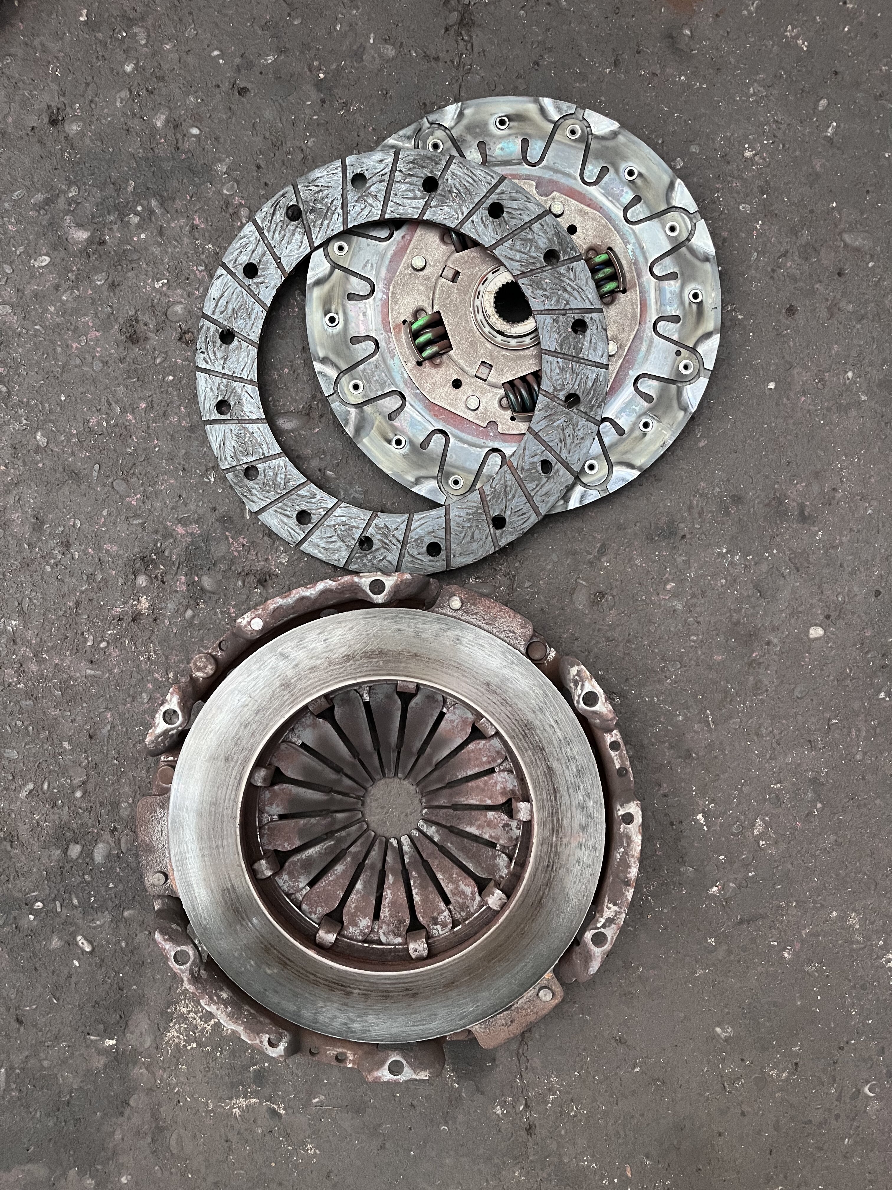

checked out the issue I had at Donington, the rivets on the clutch plate had failed. Brand new OEM clutch fitted.
Also little exhaust clamp repair done.
Also… spent some money to save 10kg
Now drives mint, roll on December track days at Donington & Oulton Park

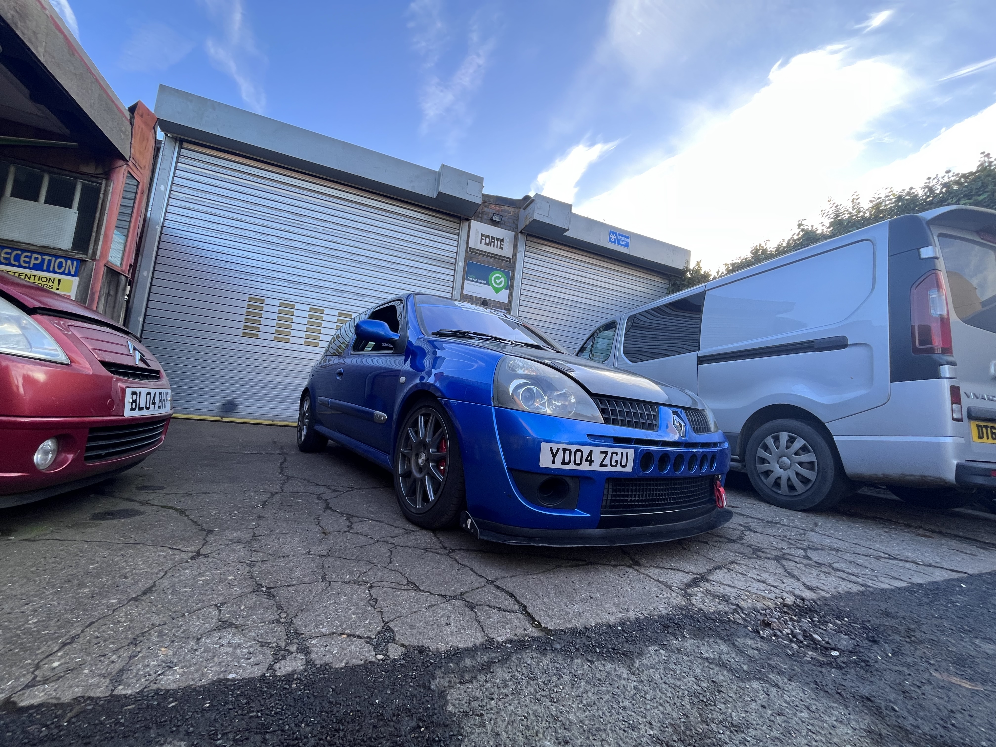

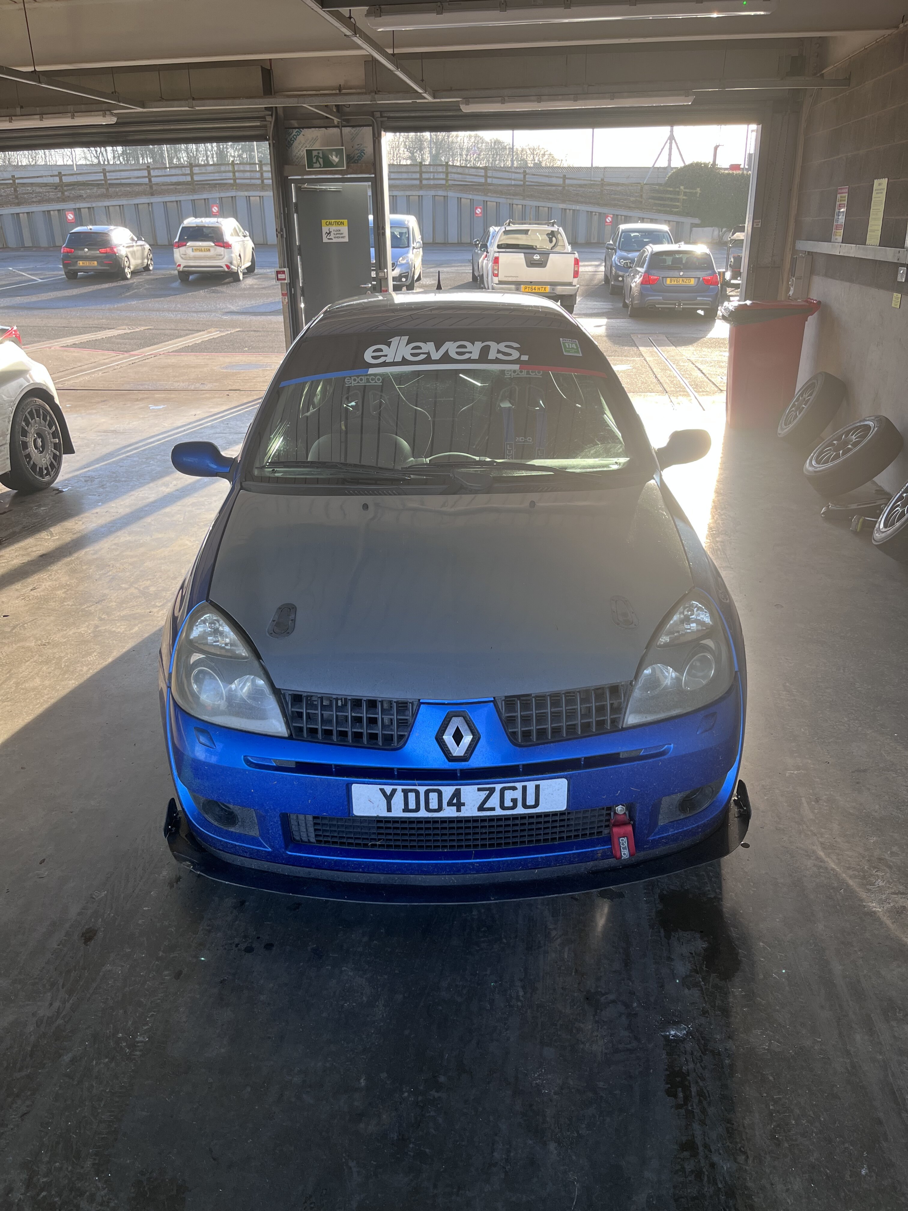

Little tidy up ahead of a few December trackdays. Replaced the old hooligan spec holes to the crash bar bumper with a stock looking one.
New number plate too, like the new look- bumpers great form 10 yards. But of rattle can spray job to tidy it up.

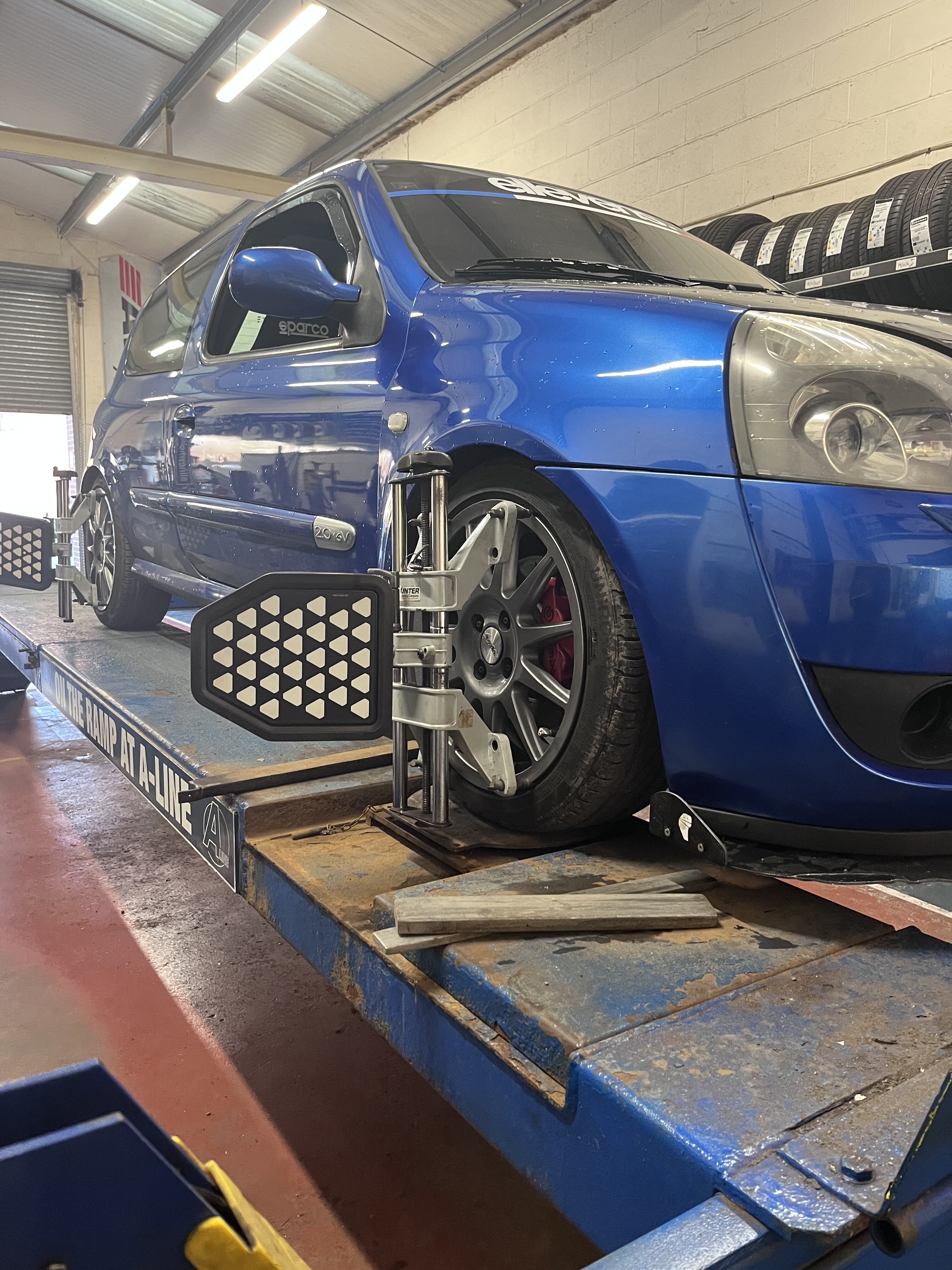

Also the alignment was sorted after replacing the gearbox and clutch. Balanced both sides now at A Line Dudley.

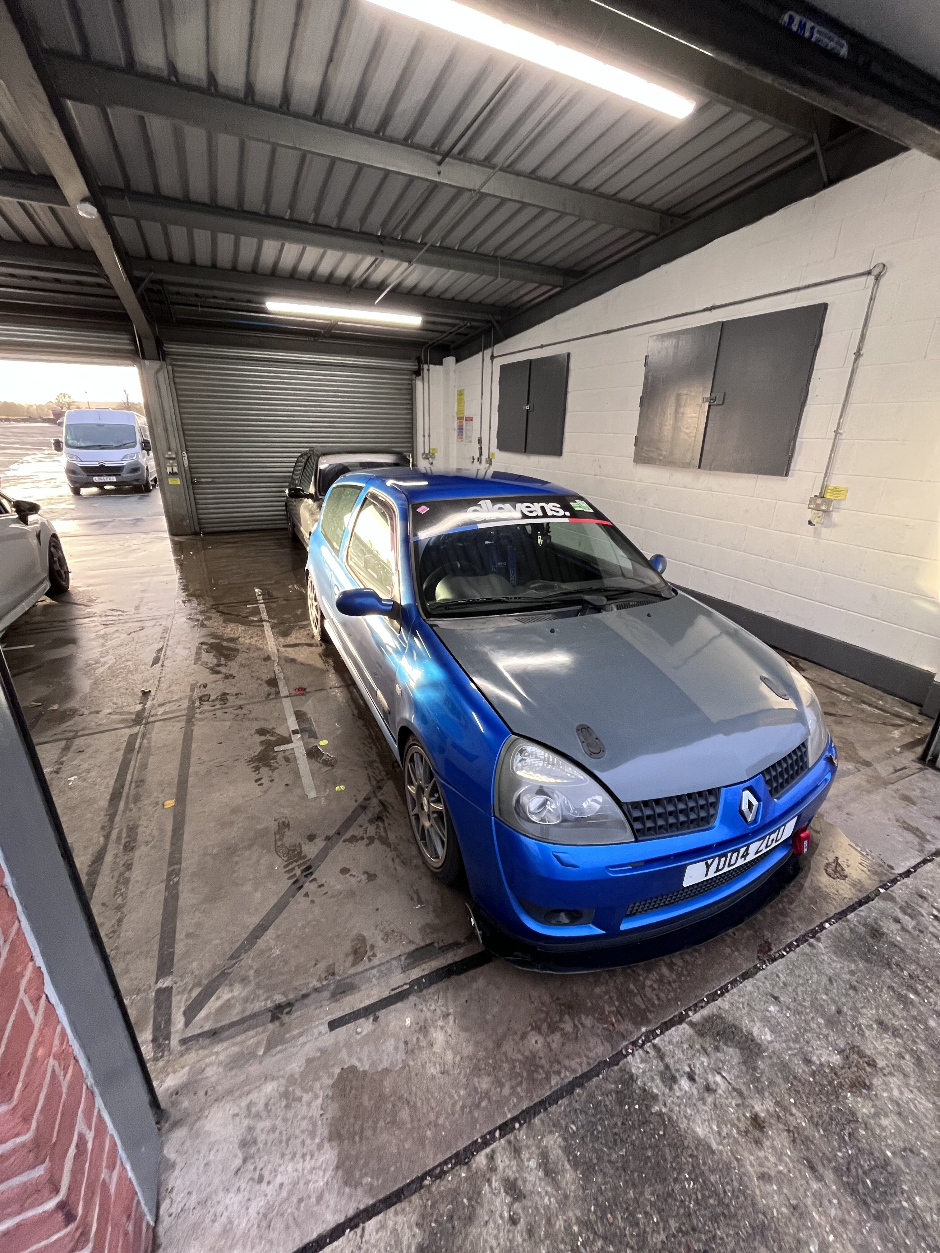

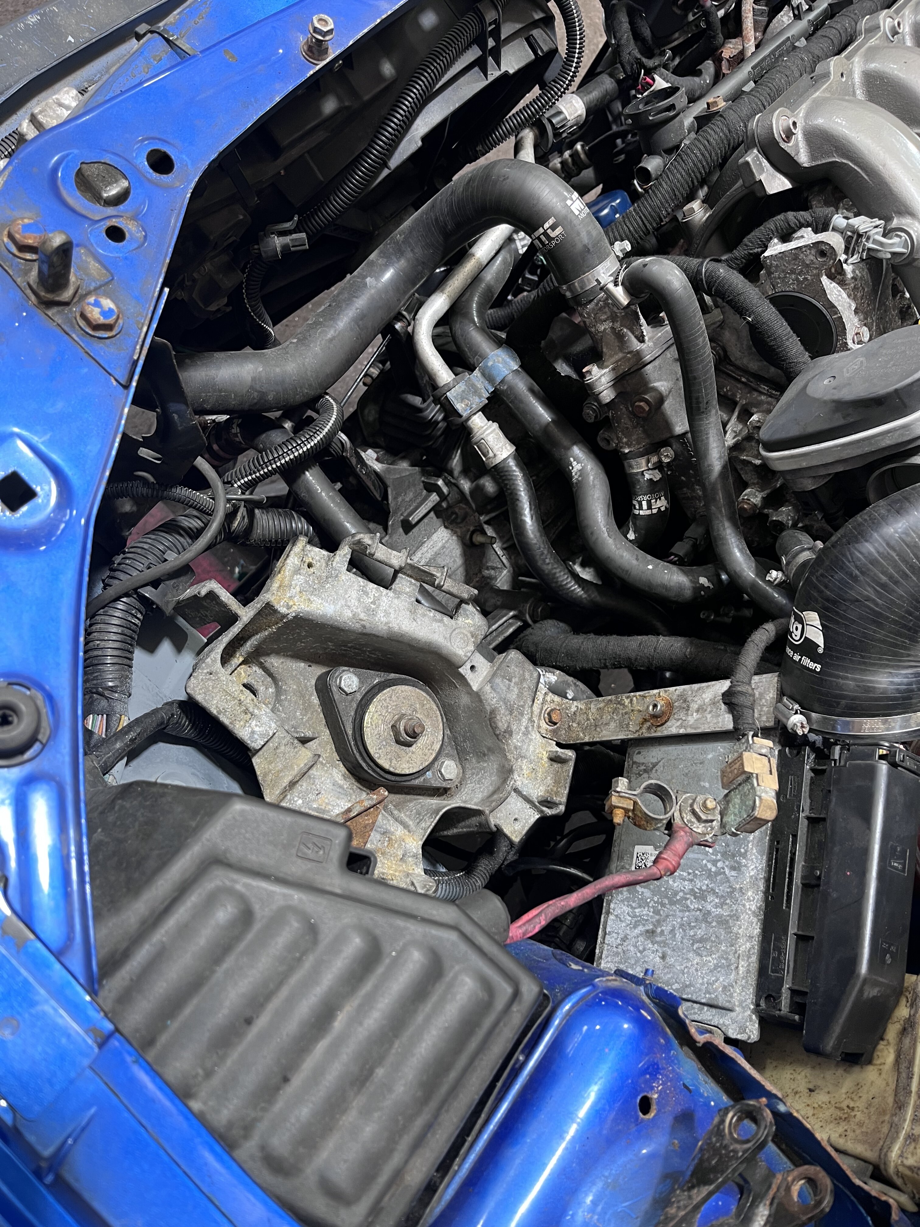

a week of highs and lows.. Wednesday was a track day at Donington Park. Frozen track made for some fun conditions. Morning was amazing fun slipping and sliding around. The car was amazing.

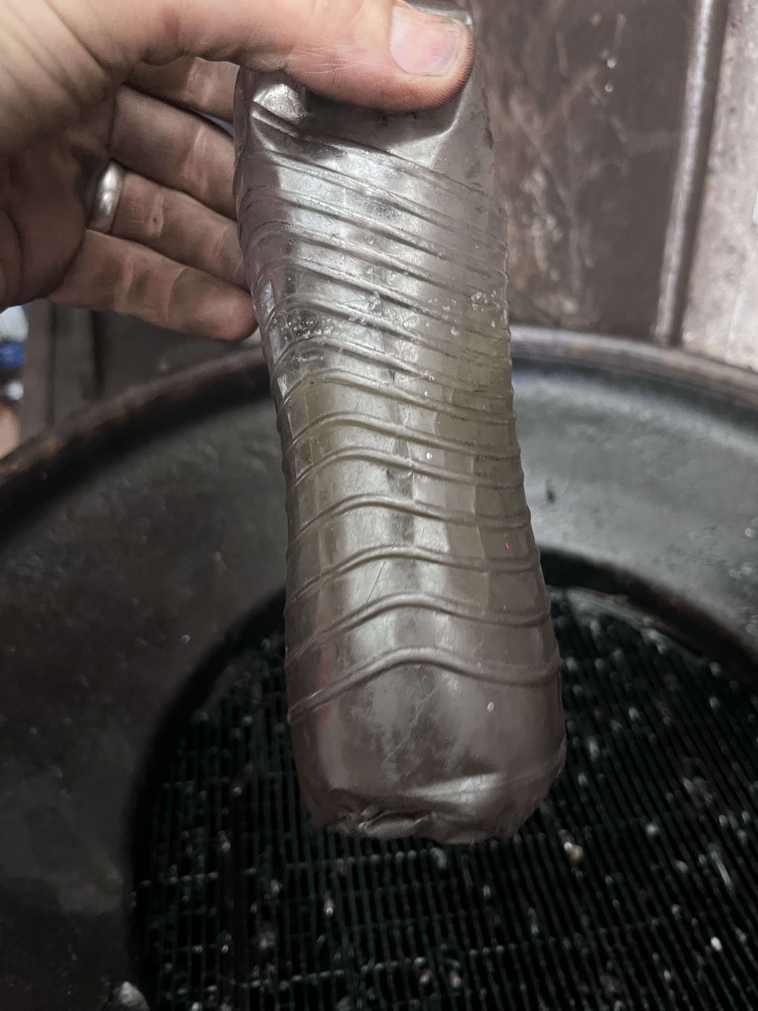

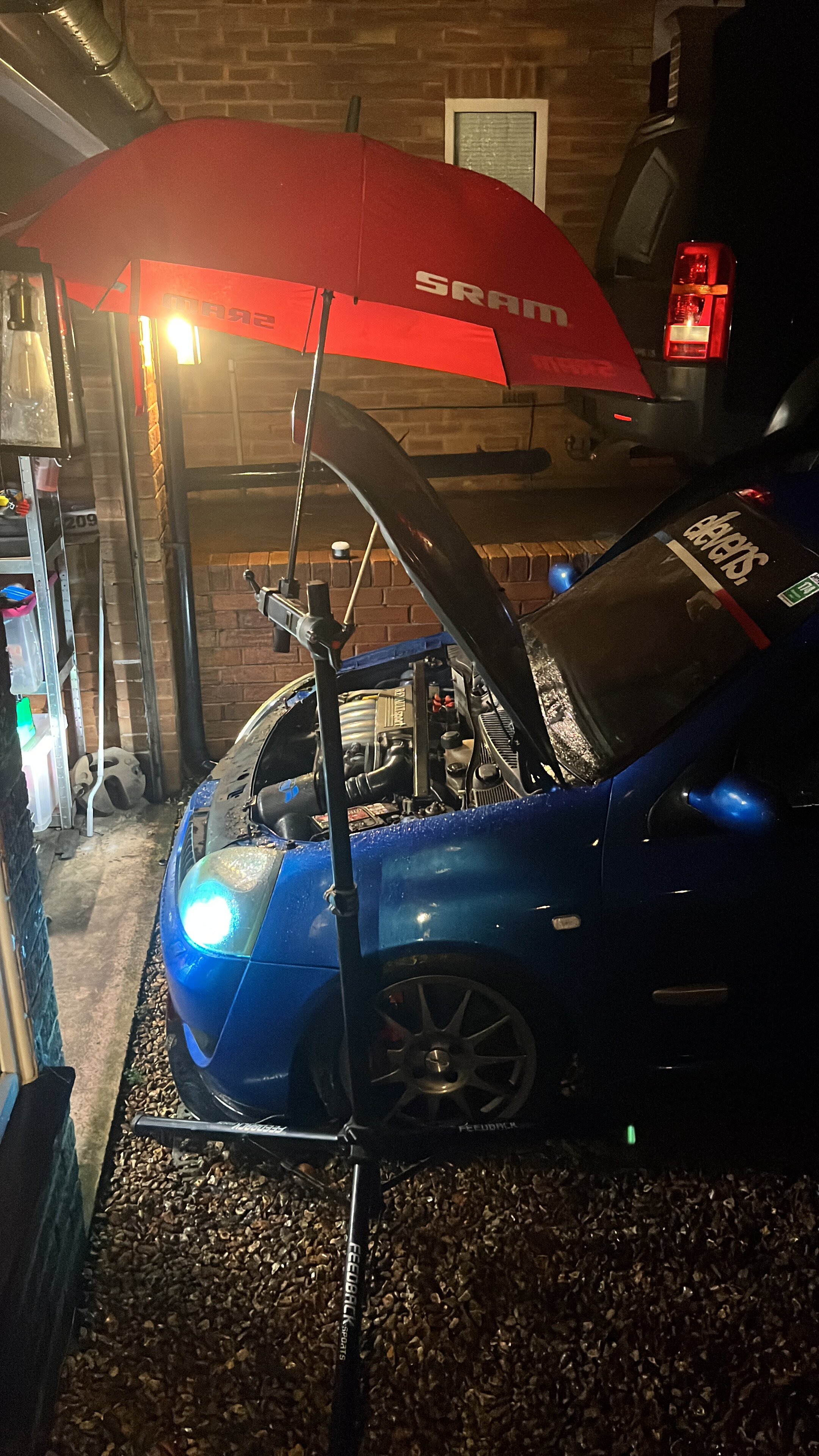

Then lunch… over the break the car developed an electrical issue and decided to stay in limp mode. The drive home was painful, but made it.
Over the next few days tried to figure out the problem. Cleaned all the connections (white plug near the ECU and all the fuse/ relays), changed the throttle pedal, but still had the issue. A lot of head scratching was had. A little time pressure as I wanted to get it right for another track day Saturday at Oulton Park.

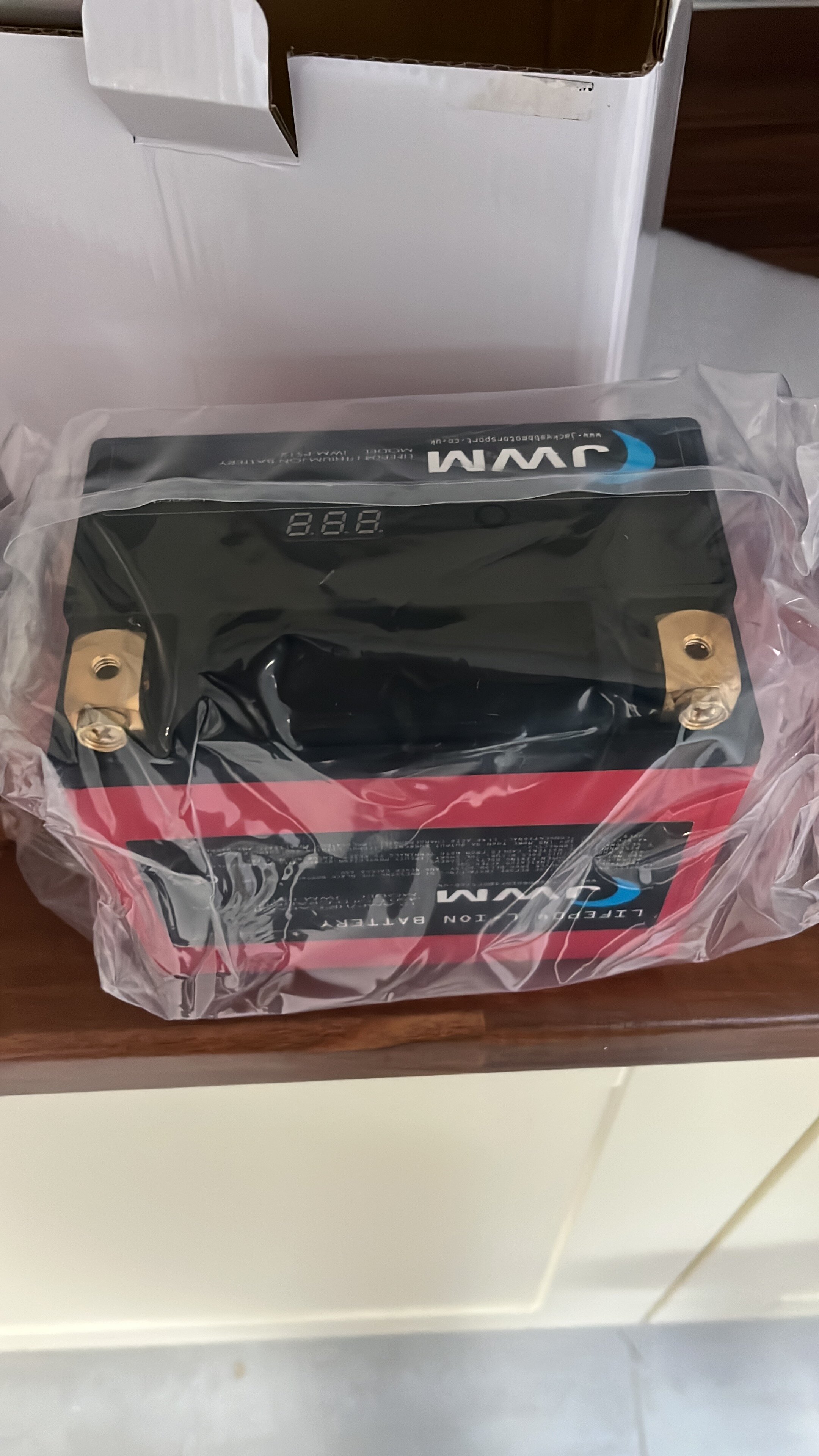

After a late night session we found a small leak in the battery. Borrowed a battery from a friend and hey presto, back in business.

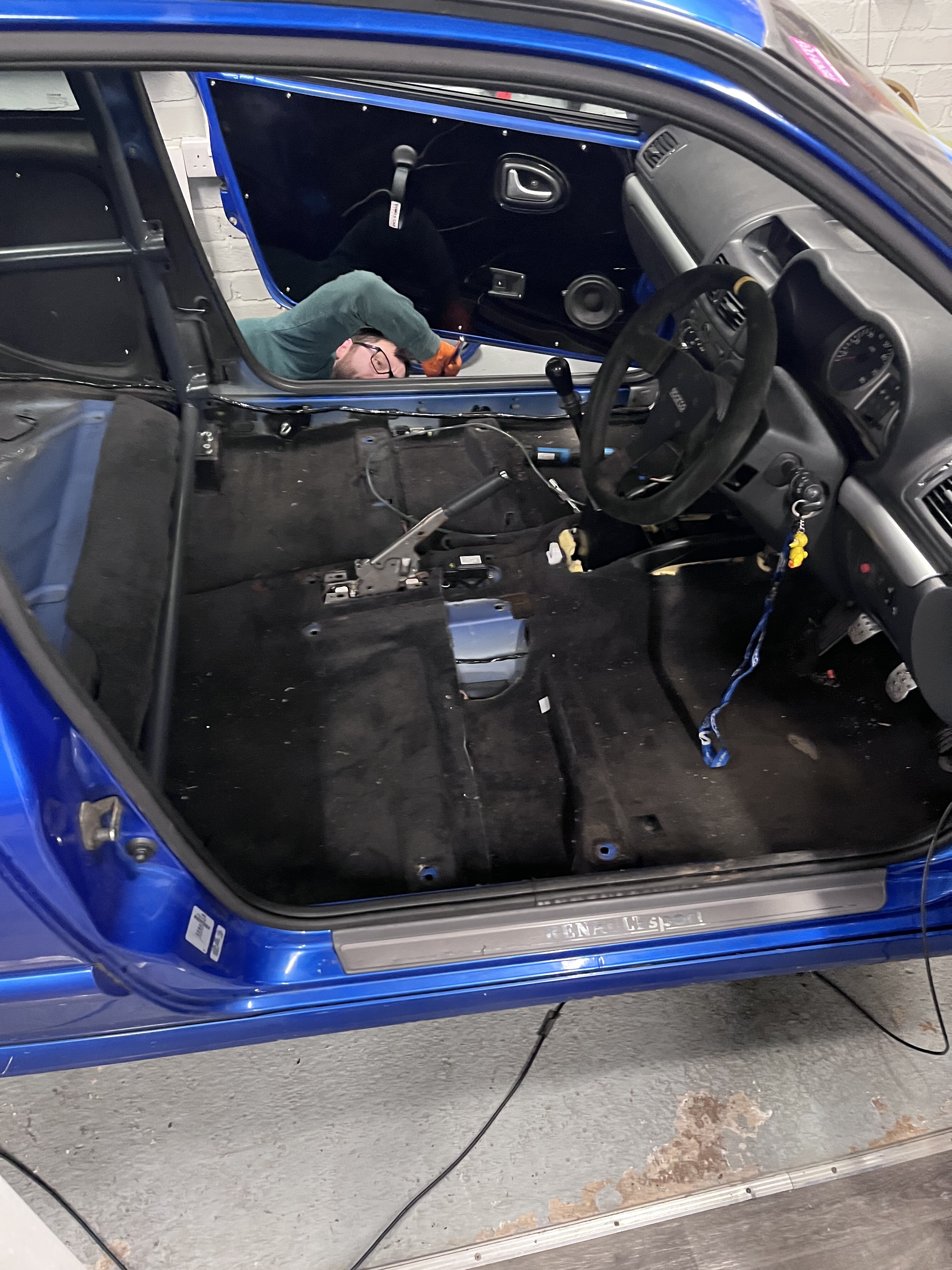

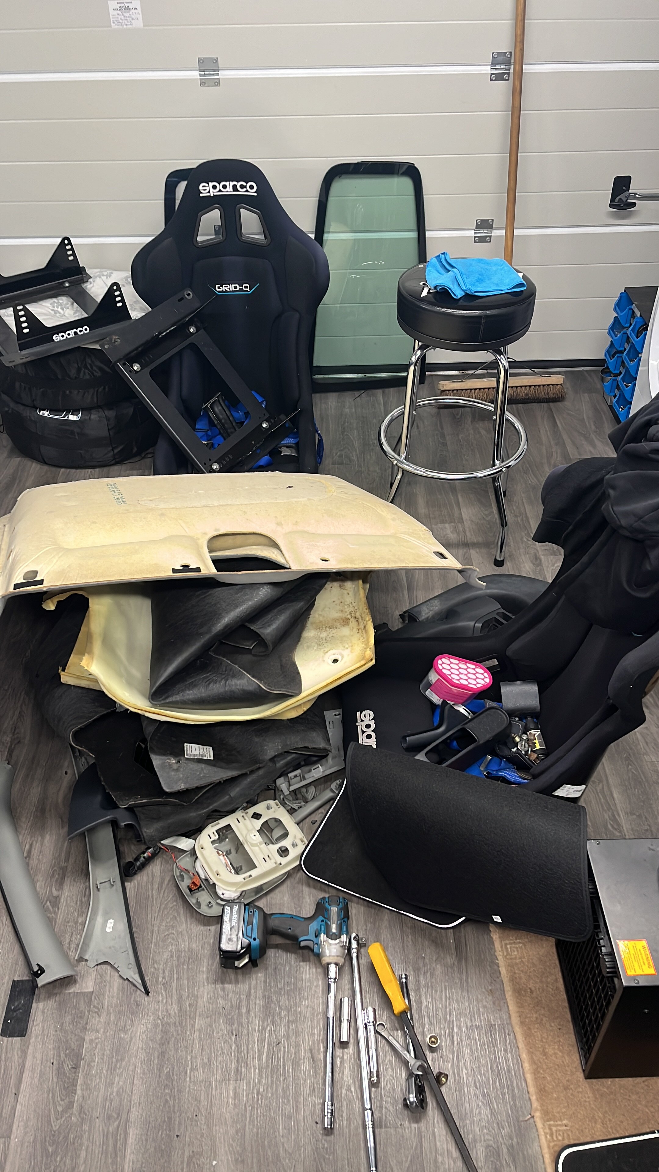

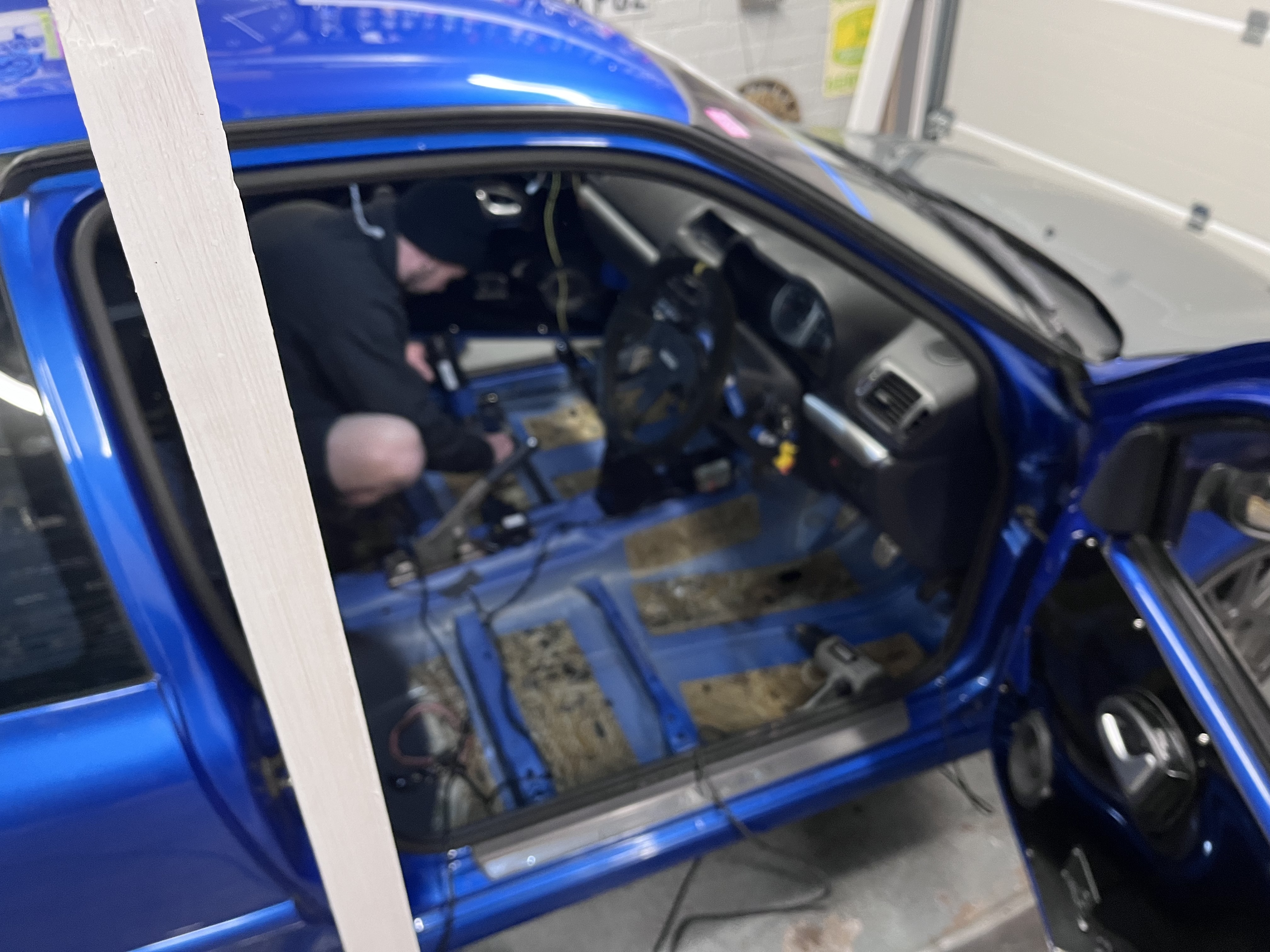

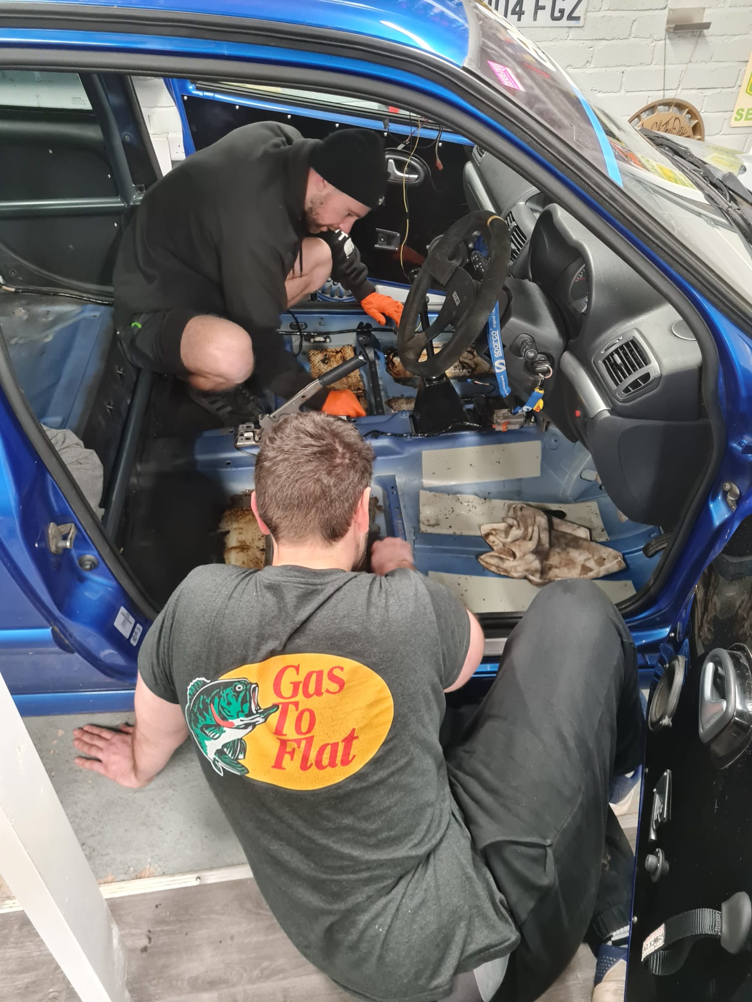

End of the track day year for me. As it’s now just a track day car it’s time to ruin the car and take some weight out of it.
- remove sound deadening
- remove the air con
- lightweight battery and kill switch
- remove carpets and headlining
- remove airbags
- chase some of the wiring back
- remove speakers and radio
- look to add a full roll cage (Fulcrum made the rear that I could add the front section)
- tidy up jacking points as they aren’t perfect.

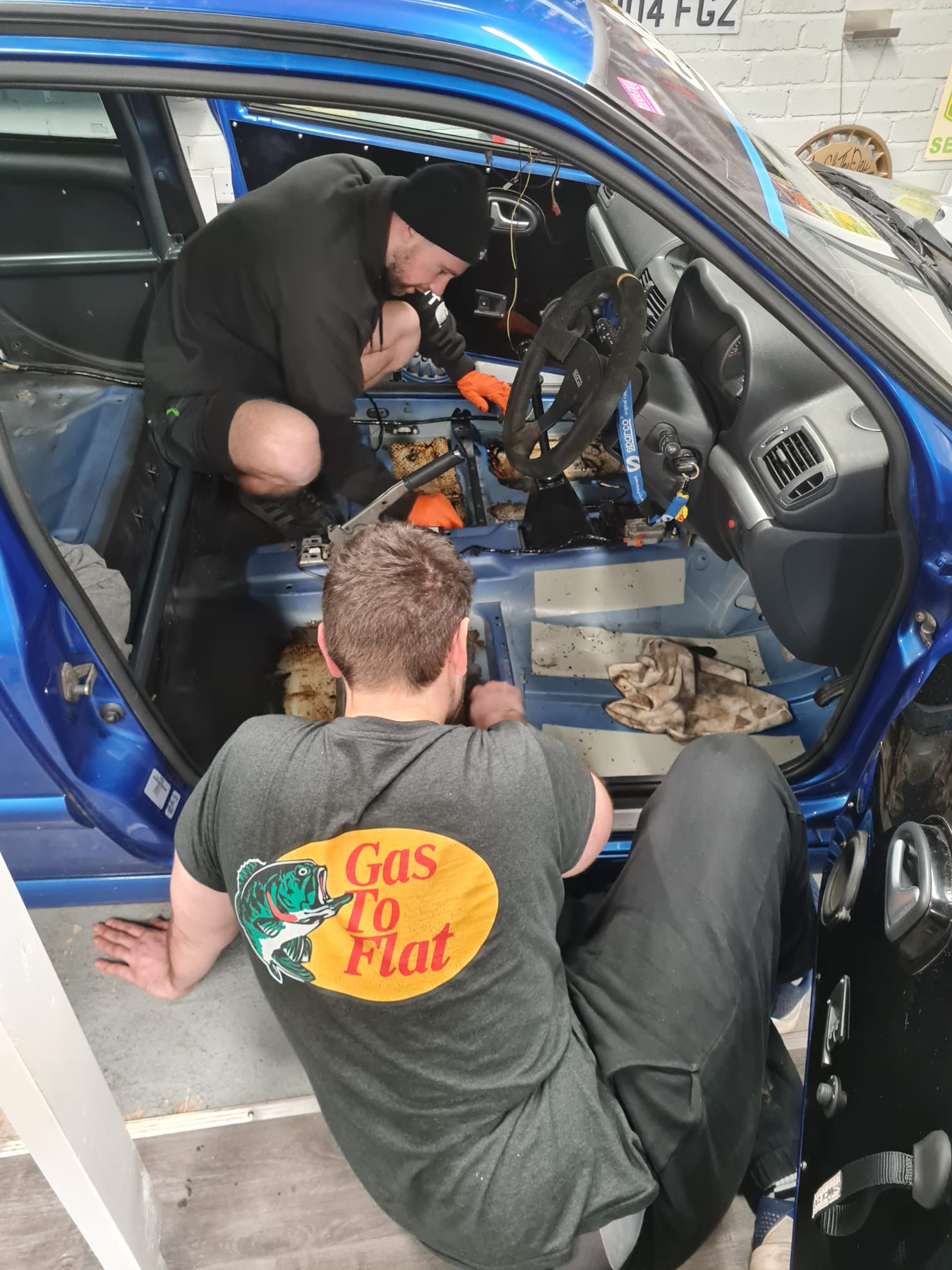

New years weight loss, time to ruin the Clio as a car.
Drilled out a few spot welds to remove some of the unwanted brackets, the removed a lot of plastics, sound deadening, head lining, carbon canister.
Also dropped out the passenger seat for now.
46kg removed in total. Still got a fair bit to go at too.

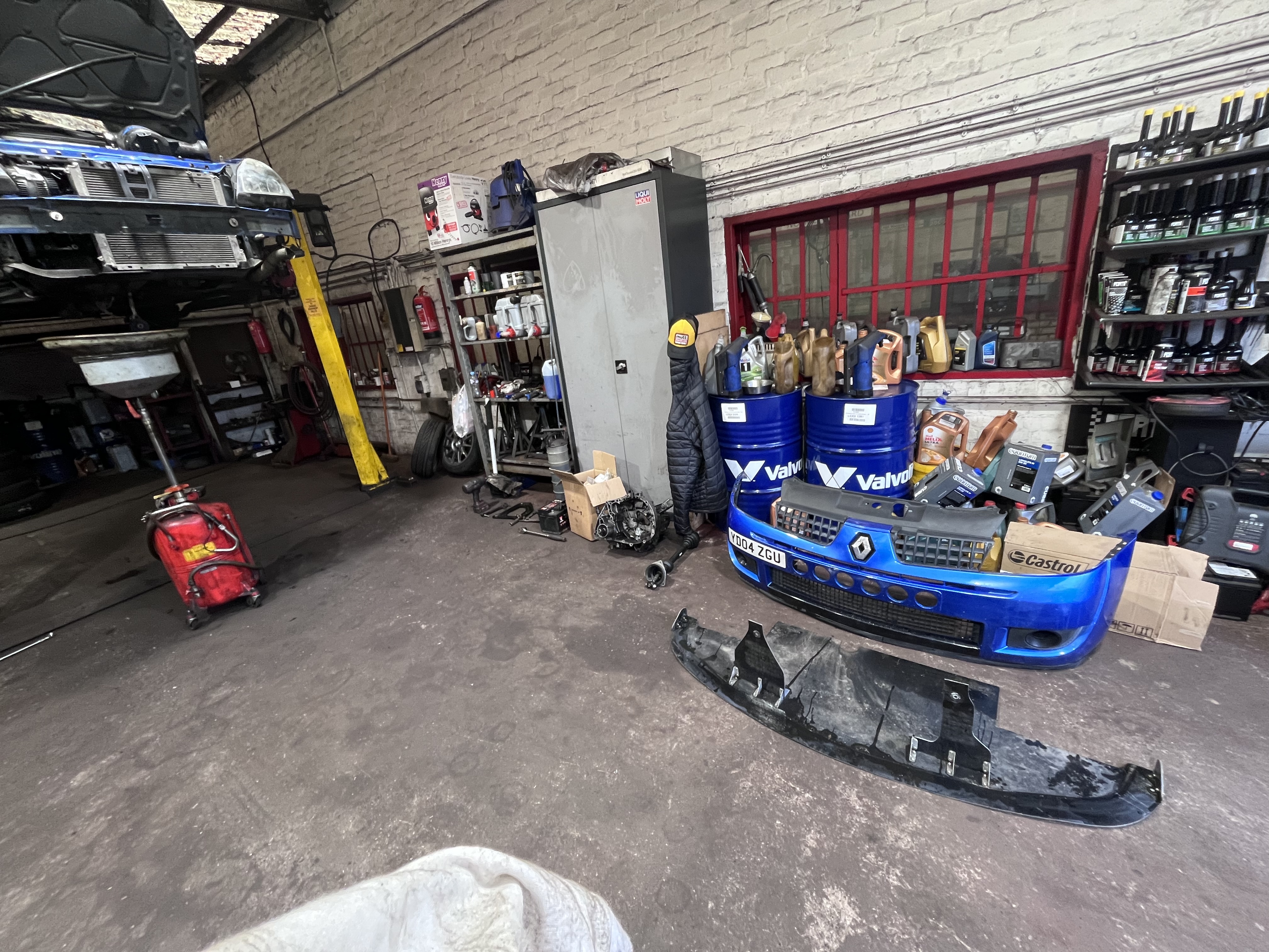

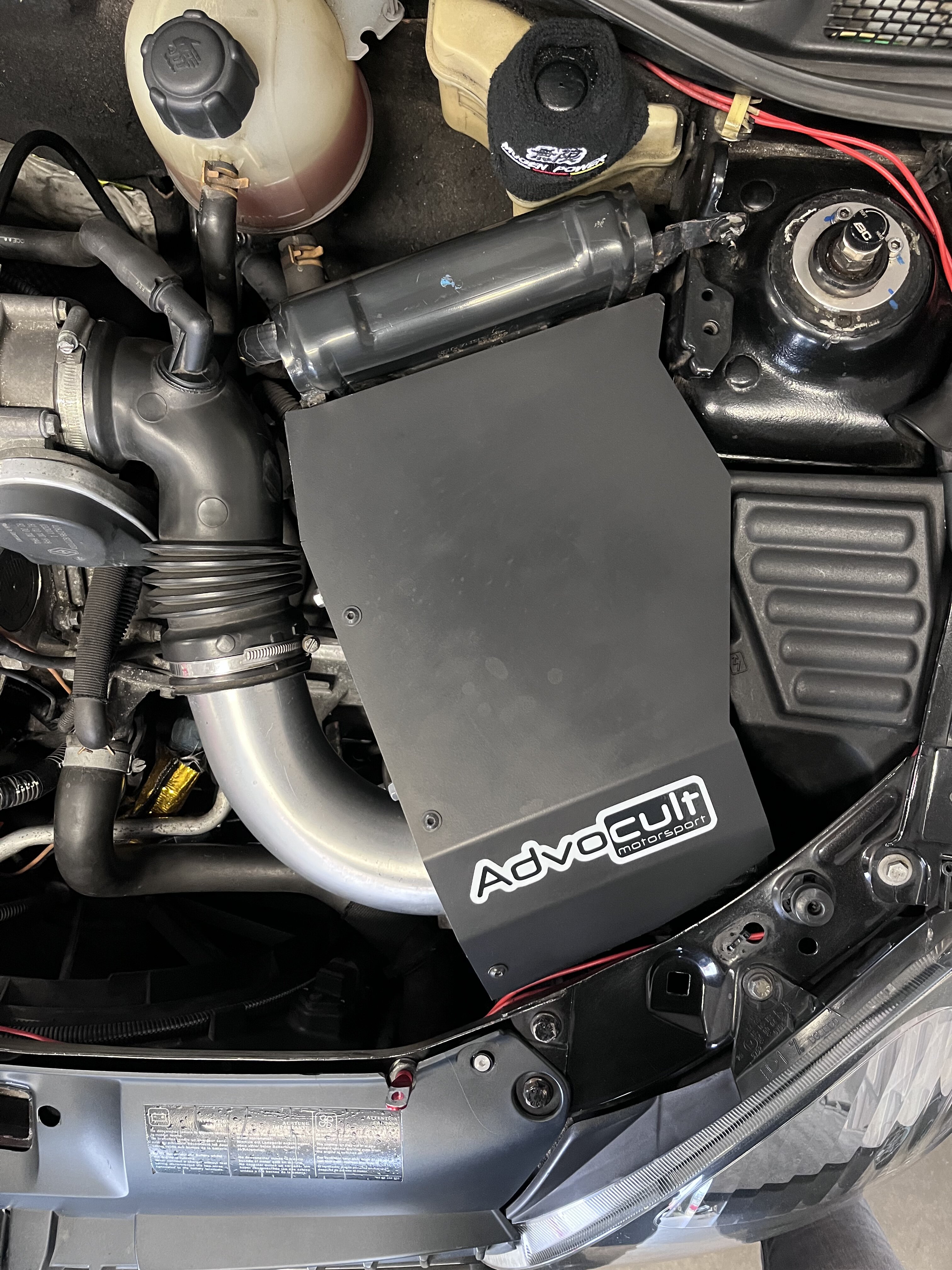

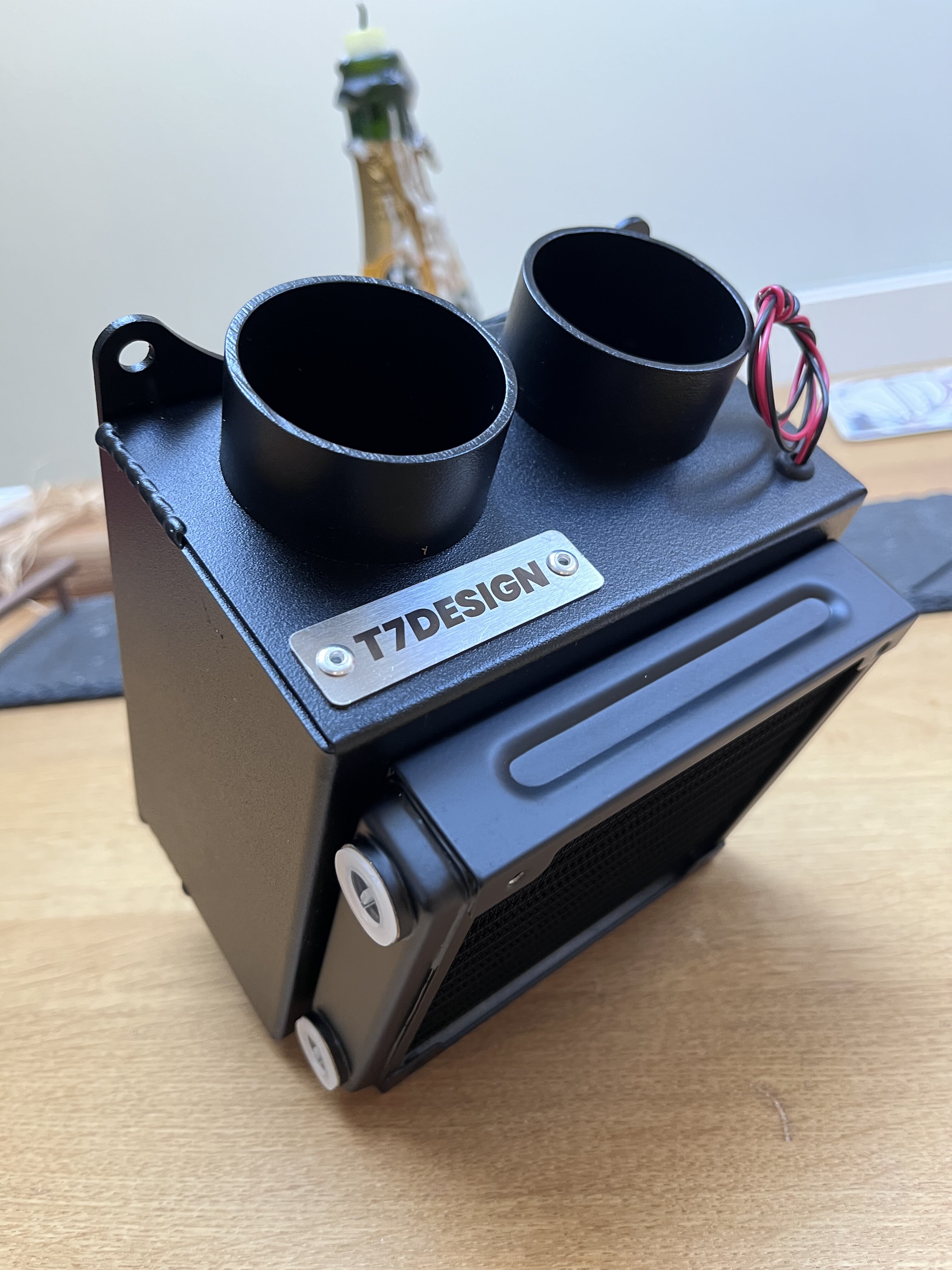

Next jobs, fit the New T7 mini heater from Advocult Motorsport (highly recommend them) and have a lightweight battery too to go in. When they go in will remove behind the dashboard and start trimming some of the wires where I don’t need them.
Tom at Advocult is also designing a mini dash pod for the Clio too, just finalising the design and working on the 3D prints.

I’ve started to do similar, I like what you’ve done with speakers in the door cards, I was contemplating track door cards but wanted to keep the speakers… now I know I can.
I was surprised how much weight there was in the rear plastics, speakers and carpet. Figure that was a good 15kgs or so!

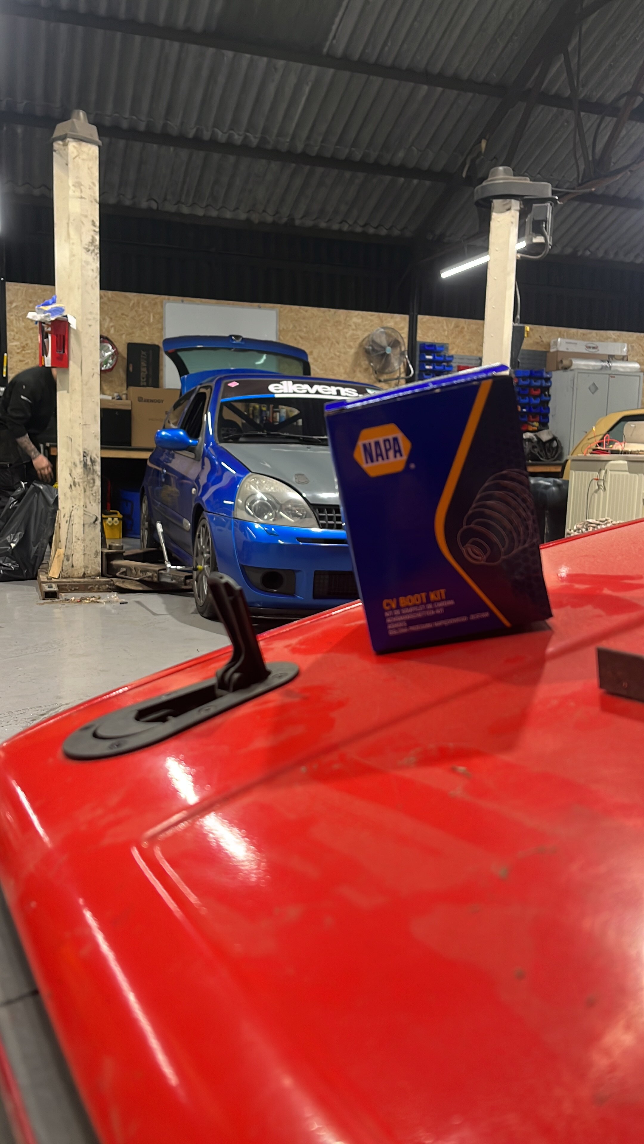

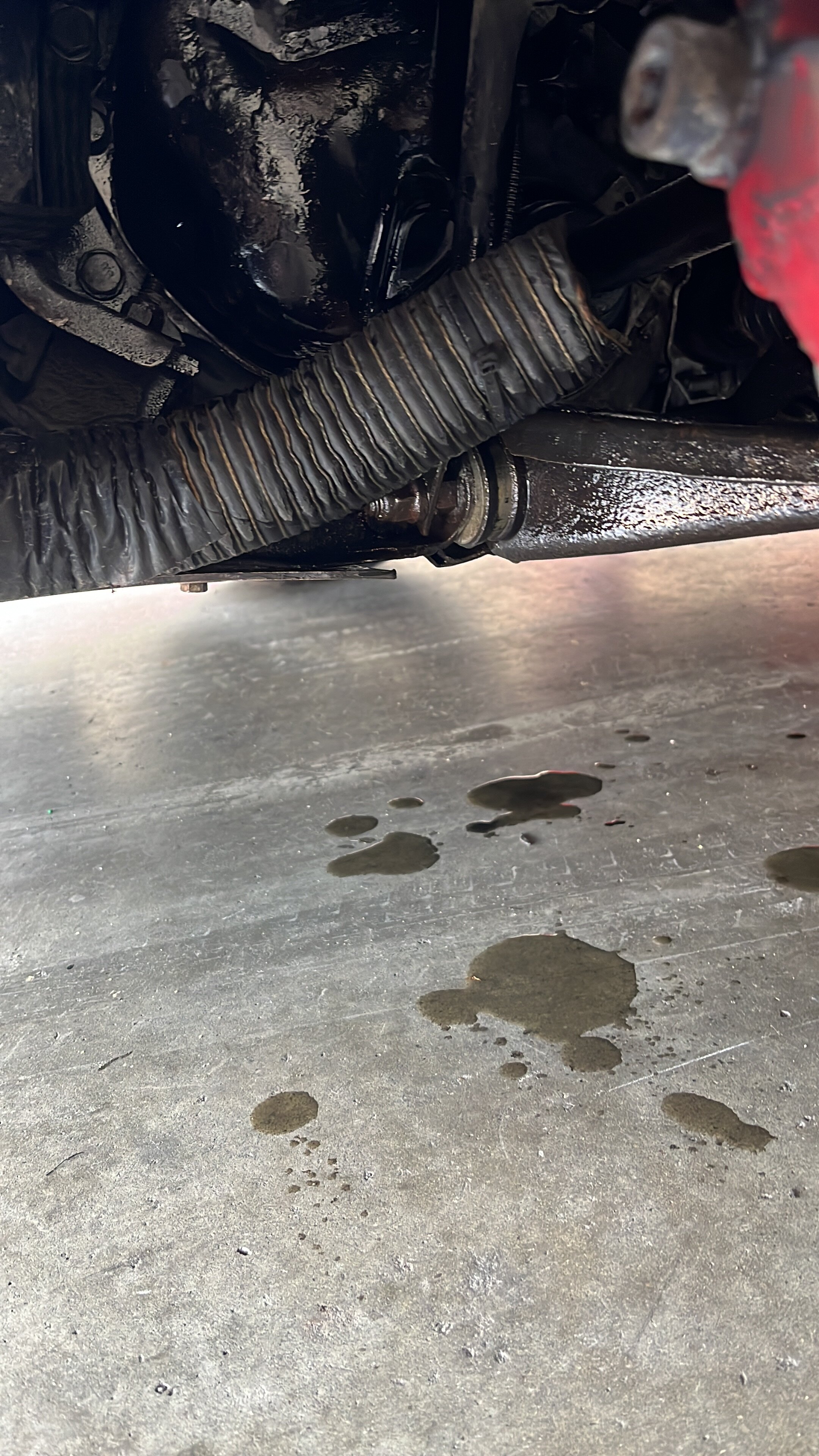

The Clio was faultless, until it decided that it didn’t need its CV outer boot- cue a greasy mess!

Also, mates car was also running this new battery cover. Looks lovely if you want one hit up Advocult Motorsport.
He’s also offering a quality marine ply front splitters for the clios. In development is a Dash Pod too.

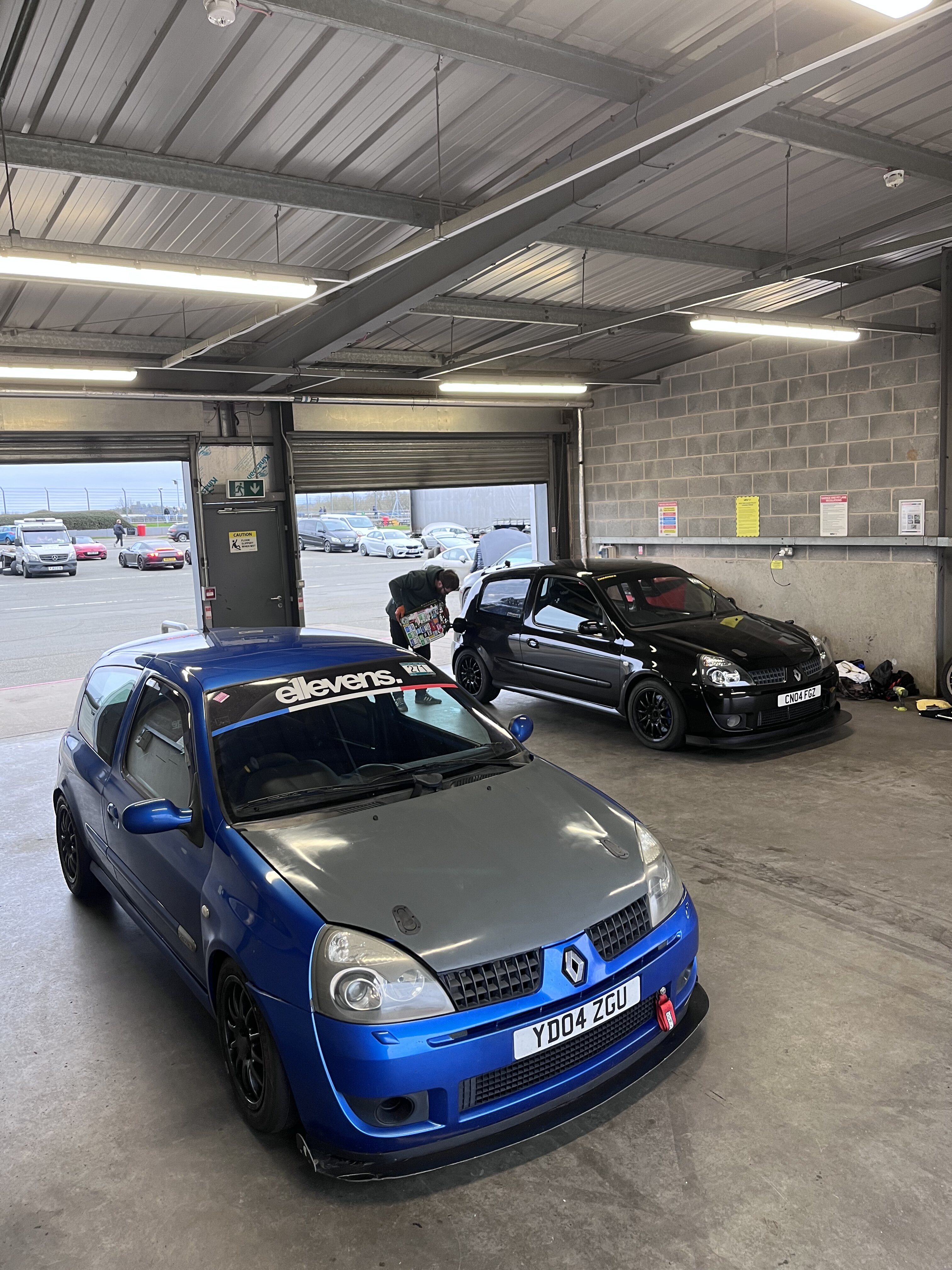

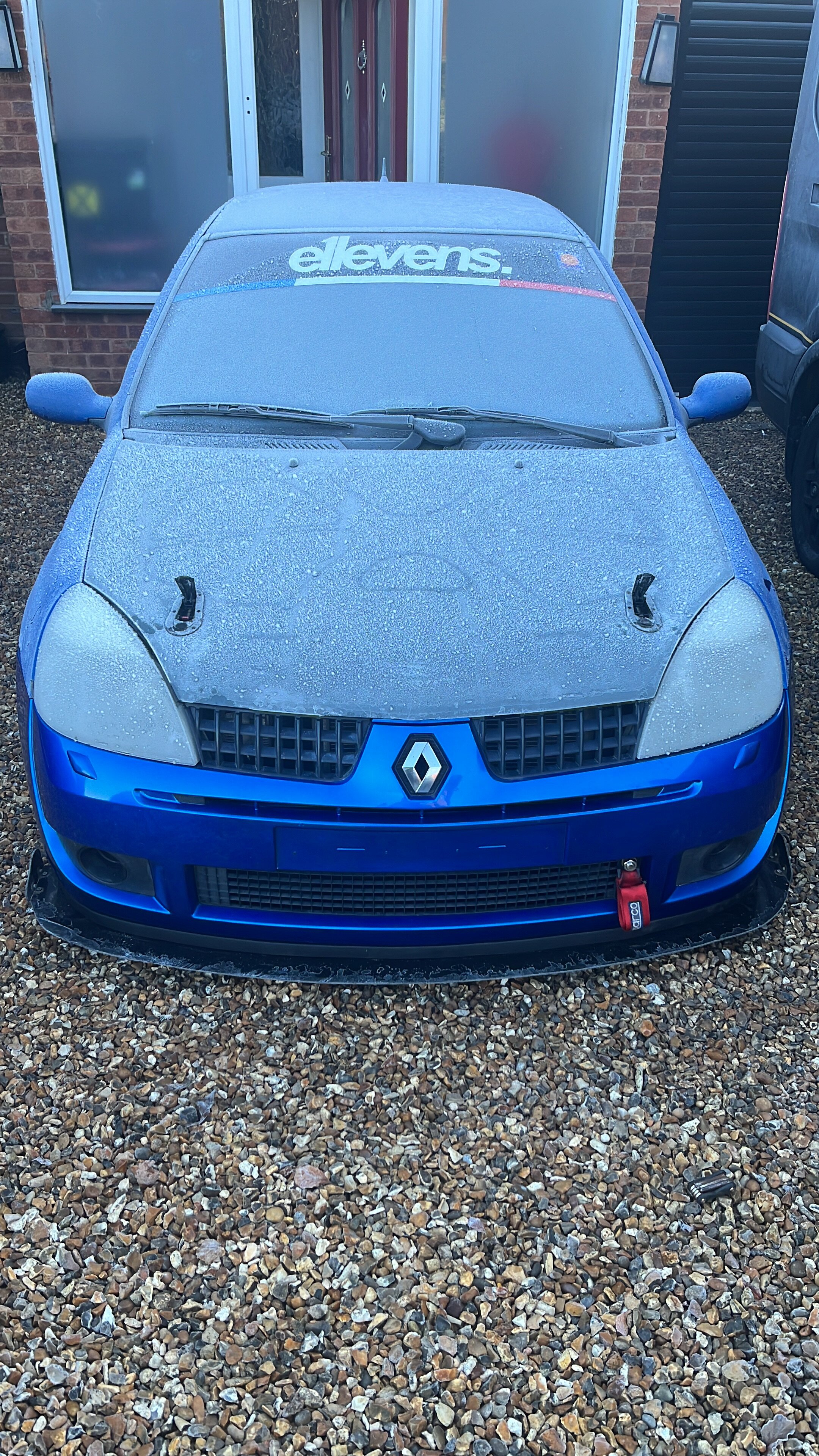

I've seen a few Clio's using front splitters combined with rear spoilers—namely Pro-Am and Frogjam—and I understand the potential benefits given they're highly developed race cars, especially the Frogjam car with 240 bhp.
Any downsides to having just the front splitter? More oversteer and instability at higher speeds?
Any upsides—front tyre grip and turn-in? Improved brake cooling? Or is it primarily for aesthetic appeal?
I suppose on a stock-engined Clio, where the speeds are relatively moderate, the imbalance might be less pronounced than on a 300-500 bhp time attack car.
If I’m honest, I can’t tell you for sure as I made a few changes when I fitted the splitter, probably a placebo effect, combined with a few other bits, but all the changes have made the car feel good to drive to me!
If it makes the car more on the nose and does anything to reduces mid corner understeer just a little bit, then I’m happy. What happens at the rear is fine as it just follows.
(Also I like the look with the splitter fitted and that’s good enough for me!)
Literally watched that last night and I was wondering whose it was. Looking to get a splitter just need to figure out if I can still get it on the trailer with it on the car.
Not taken it on track since, but Vs the other well known branded splitter I had on before, the build quality is next level.
I will try get some pictures, but the little brake diffusers are a little work of art.
So the clutch decided it didn’t like working before the last track outing. I had a new Helix motorsport clutch to fit, but not the time to fit it. Don’t was left to take the Fiat Panda 100hp instead for a few laps of Cadwell.
It’s not as fast, I definitely missed the Clio, but it was just as fun trying to haul the little thing around. 4 wheel drifts, understeer and just throwing it into corners. it’s a pretty capable car, with a little more power and a few handling tweaks it could be wild- but then I’ll have two track cars and a ruined commuter car.
Just missed getting to play with others as it was a tad slower than usual!
Still a fantastic day out. Now to fit the new clutch to the Clio before the next track outing end of the month.
