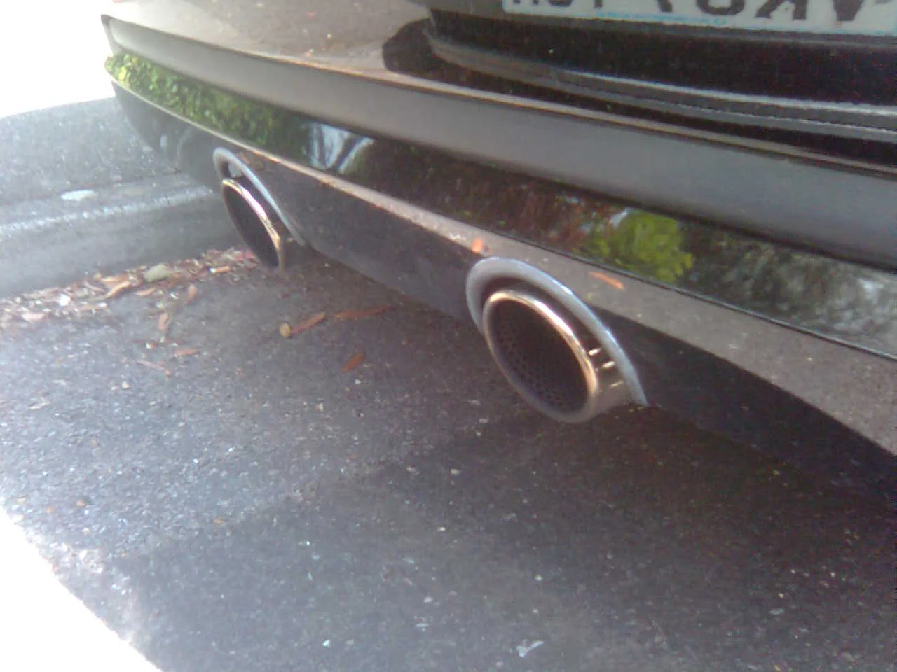

Got my Janspeed fitted by KTEC today and when I got back home i searched the forum to confirm how the slash cut version sits at the back, as I had a slight doubt when I first saw it fitted. Mine doesnt seem to stick out at all (see pic links below) and is under the black plastic lip.
Other peoples on the forum ( http://www.cliosport.net/forum/showthread.php?t=382300&highlight=janspeed ) seem to stick out and show the janspeed logo (which is what i want really!). Even the image on the KTEc website it seems to stick out ( http://www.k-tecracing.com/show_product.asp?id=1264&pic=2 )
Just wondered if anyone had any views on how it should sit?
I`ll give the Ktec guys a call on Monday and I`m sure they will sort it out to what it should be.

Its probally where they have pulled one of the sleeve joins too tight together. Will be an easy fix so just give them a call. Stupid that they gave it back to you like that it looks really wrong.

The rear exhaust mounts are adjustable on the body- you'll most likely find they are adjusted all the way forward. That combined with the slip join being inserted too far is most likely the cause of the tips being hidden.
Oh, you'll most likely find they'll be sticking out a lot further after you've been for a decent drive. The exhaust metal will expand a lot when it's hot.
Mine sticks out a bit not loads. But when hot!! stick out lots more. Exhaust sounds great, not too loud even with decat.

Seeing the KTEC guys tomorrow, to sort the fit out. Hopefully report back some good news tomorrow and get some better pics up.
I've fitted on to Has's car and think it should stick out a bit, although as its all sleeved joints and can have it how you want really. They should be able to sort it easily enough, although i'd be dissapointed they've left it like that in the first place as its obviously not right like that imo.

Had mine fitted today,just perfect.Really good fit,matches the cut out's very well.Not too loud just a little burble on tickover and low rev's.
Got them to fit it so it just stick's out from the bumper but there is loads of adjustment on the pipe.

Makes me laugh when its hot it sticks out another inch and you can see Janspeed written on top of the tailpipe.
