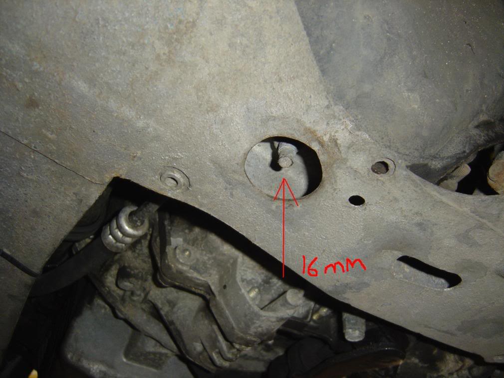

My Guide.
I wouldn't descirbe it as a "peice of p1ss", lol. But it's certinally do-able at home. You'll probably want 10 and 13mm ratchet spanners, for the exhaust studs and the rack pinch bolt. There shouldn't need to be any need to unbolt the rack, but make every effort not to stretch your pas pipes too far.
iirc there are 5 subframe bolts on a MK2
That's right. This is the front gearbox support isnt it?
