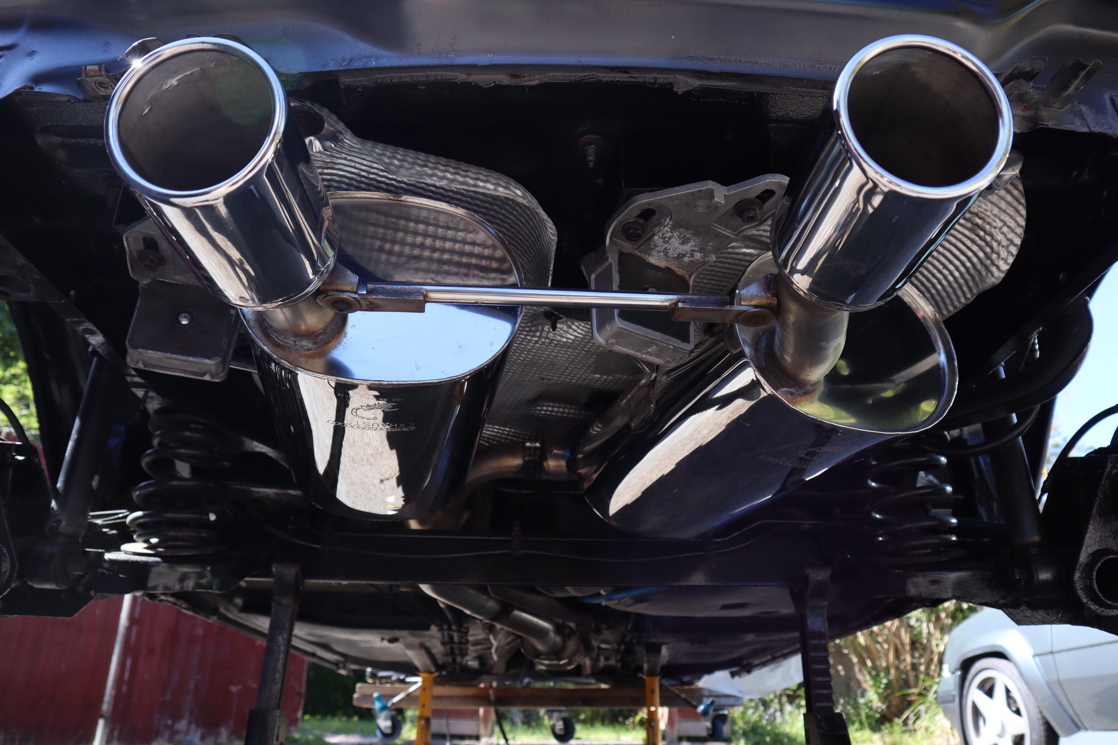

12 years ago or more maybe, I got some new hangers, taped off the back and filled them with high temp silicone.
cost £6 in silicone and they’re still on the car today.. I made 2 backs ups which are in the shed and never needed to fit them.
the scorpion 192 exhaust has been on there just as long and no damage to welds etc.
it’s not great pub ammo to brag about my cheap exhaust hangers, but I did have more beer money that night.

I did something similar 7 years ago and they're still on the car. I didn't tape them off, I just filled the holes in the rubber part from both sides.
  R5gtt, 182, volvo...
I polished the exhaust in 2020 lockdown, I might have finally swapped them out for other set as they look fresh..
