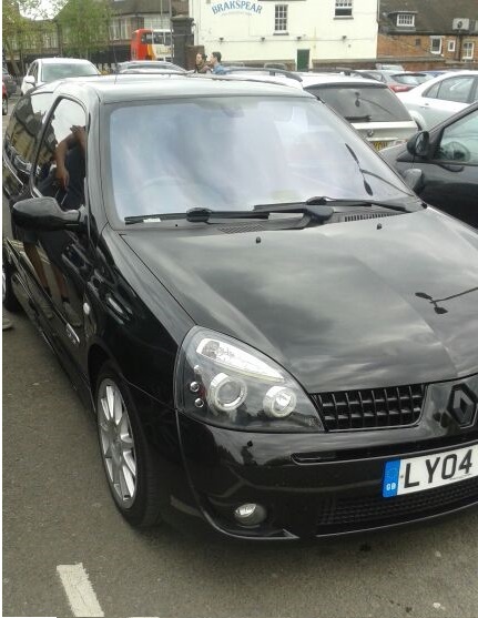

After a month of searching for the right one, I picked up a full fat 182 for £2000. It has full service history and so far so good as far as reliability goes.
Since i got it on friday I have already removed the tint from the front windows, removed the green vinyl wraps from various parts of the interior, removed the black wrap from the front badge, removed the non wired up start button and filled the whole with a rubber grommet, filled the headlight washer holes with rubber grommets and fitted a connects2 cable so that I can use my steering wheel controls with the aftermarket stereo fitted.

Those lights imo are s**t. Why on earth did the former keeper replace factory xenons with those things.

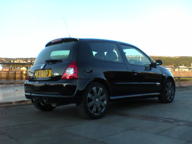

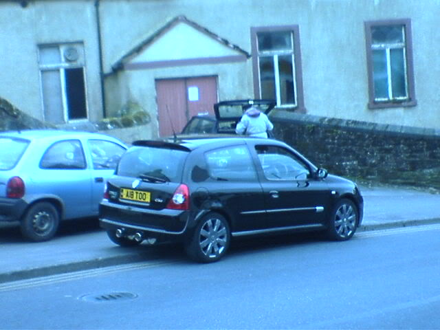

Got a bit more done today, the main job being the removal of the tints from the last 3 windows and removing the glue left over from doing it on the front two windows. I found that as long as I went slowly and kept the steam on it then whole time I was able to get the last 3 off without leaving any glue behind.
This is how it was looking part way through and below is the finished product.
After this, I fitted the last of the badges for the back and now the rear of the car looks like it should again.
