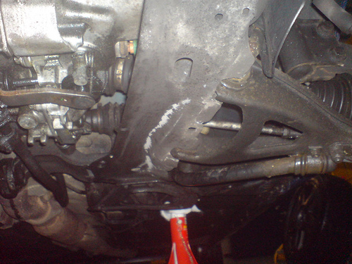

Anyway, had a look today, looks like sole victim was the subframe.
Here's the offending near side, you can easily see the crease where the paint's chipped off to show the silver colour below:

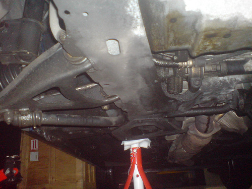

For comparison, the off side, which looks fine:

doesn't look like there's anything wrong with it mate, just a scratch? (they're galvanised metal, not painted)
have an alingment check done, if its ok don't worry about it
The near side wheel isn't pointing in quite the right direction anymore, the camber angle looks the opposite to what it should be, and it crabs along, so I'm sure something's up.
Is the underneath of the subframe the same both sides, i.e. should look flat? Because the near side one is not flat anymore, but quite kinked.
It's dirt that's cracked off, not paint then!
The subframes are pretty chunky things, from the picture looks like nothing too serious, double check everything, have a good look at the steering arms, they would be the weakest point, and most likely causing the misalignment.
When reattaching subframes, they dont just bolt on square everytime and can need some adjustment by wiggling trial and error, or if its not bad, by setting the tracking.
If you can avoid it prob best not to remove.
see if when the hand wheel is straight there are even gaps either side of the car to the rear and front of the roadwheel arches from the tyre.
both sides of the subframe shouls be the same. your wishbone mount positions may have moved a few mm.
hope you sort it!
if you have positive camber the wishbone mounts could well have moved towards the centre of the car. try getting some measurements off a solid reference point to compare both sides,see if u can find where it has moved. wont be much though.
You could have just knocked out your toe/camber? Only costs 45 for a full geo alignment. May be worth doing that before you start forking out for the expensive stuff :)
i did the same in mine and looks the same as how mine bent. is deff the subframe
