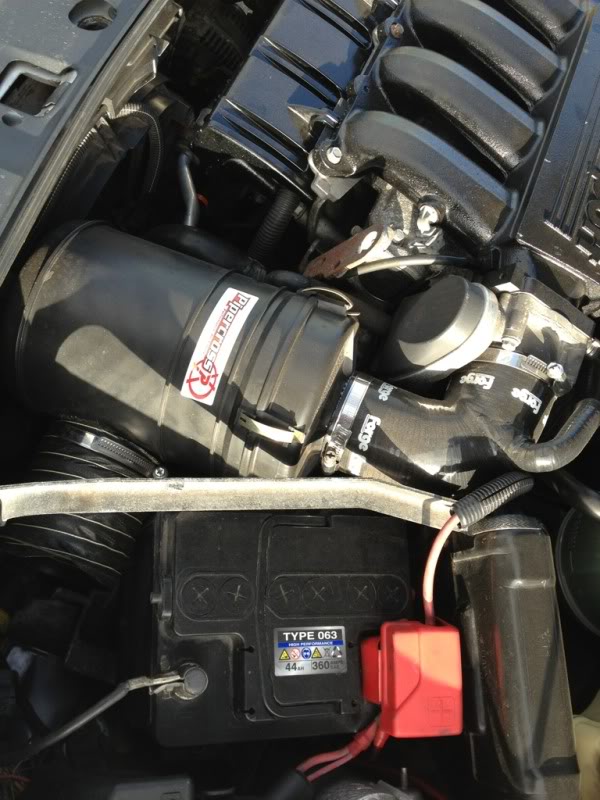

On the work computer so can't see the pic. I ran the espace V6 box with a 9" pipe coming off towards the back of the headlight. I tried no feed, a small feed to headlight and one down to the foglight, No feed and the filter felt hot as soon as I stopped, small feed seemed fine, foglight feed actually added a small resistriction according to the RR operator.
Mine just has a short bit of pipe to just behind the headlight and infront of the battery. Just a couple of inches. When i look at it it just seems it must be no better than a open filter unless alot of cold air rushes up behind the light.
Andz, make sure the feed from the fog isn't direct into the filter, works and breathes much better if it is just directed towards the filter and not the only source into it.
