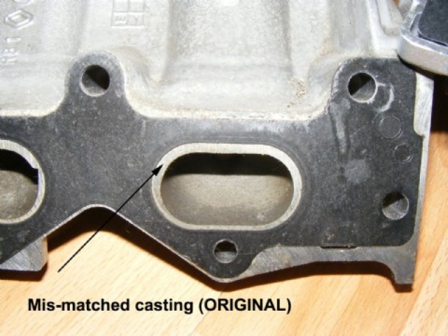

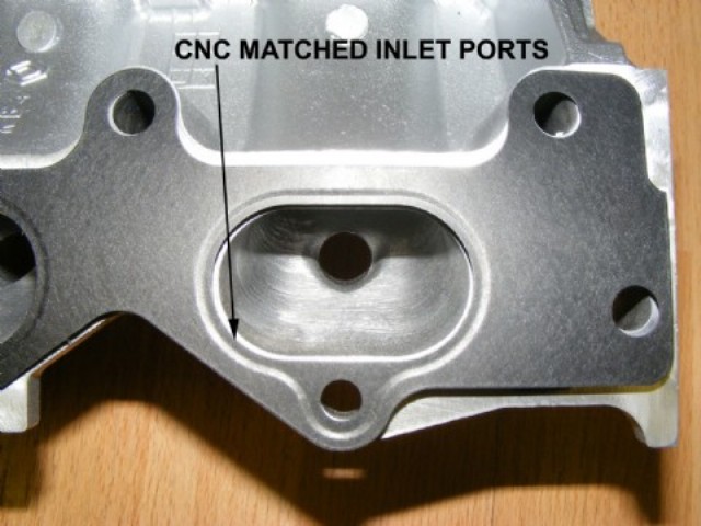

Right noob alert here!! I know this is an old thread but I don't understand what people mean by matching the inlets, I've only ever driven a 1983 mini before this year so this is my first "modern" car is it just the casting edges that get machined a away to give a better airflow? I am good with cars and all that just don't understand this thread? Thanks will
It's port matching the lower inlet manifold to the cylinder head.
Oh that's excellent I get it right away great pictures :smile: I can see how there is a performance gain better airflow etc! I think I better contact jamsport about this! Thanks alot :smile:
Those pictures are of the 172 manifold tho, and show the worse case scanario.
Casting was improved in the RS manifold fitted to later 172's and 182's.
Ohh cool, yeah mine fits into the later category I think haha, certainly worth looking at now I know roughly what it involves thanks for the info and replies

What sorta gains are there on those ported inlets for the 172? Don't you need to port the head too for the best results?
Totally depends on if you have the later RS stamped lower-manifold, it's better cast so offers little in the way of gains.
The earlier manifolds show some modest improvements.
I'm sure you would see better gains with head work, but the cost of doing that Vs slapping on some new manifolds is vastly different.
