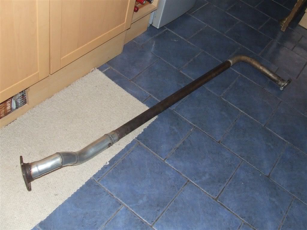

here's what i've ended up with:
It works, but I don't like it - a) because of having to use a solid dogbone and b) it's all one piece, meaning if any of it gets damaged it will be a ballache to fix!
My plan is to remove the solid dogbone and fit a standard one
I'm then going to get a new centre section (straight through again) and have it bolt on to a downpipe.
I want the downpipe to be similar to what I have now, but with more of an angle on the manifold flange to allow for the standard dogbone. I'm also going to fit a flexy section to it. hopefully this will fit and not knock!
I might also make a space for a cat... might make MOT easier...
Another thing worth doing is to weld on a nut to the side of the downpipe to fit your lambda in. this makes changing it in the future a doddle :cool:

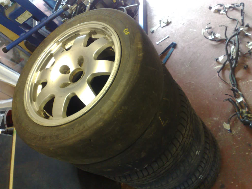

Original Mk1 Cup racer Speedlines, rumoured to be a lighter/stronger magnesium alloy than the standard Williams wheels. 4 wheels with road tyres, 1 wheel with a Dunlop slick, then he gave me another slick to I've got a pair of them

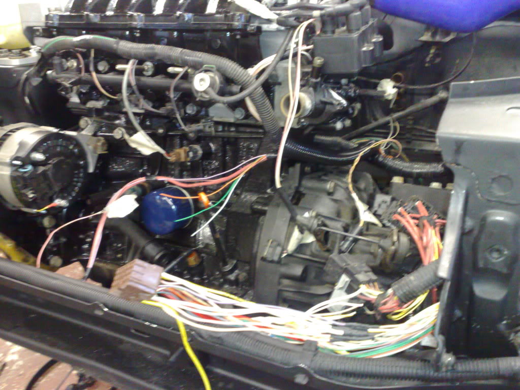

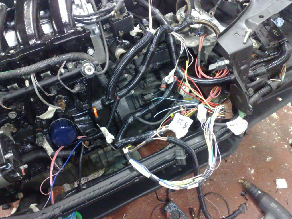

Then I FINALLY made a bit of progress with the engine loom. Been delaying it for a good while now so Im quite pleased with myself. Not done, but started. Crap photo, sorry.

Be interested to know the weight of them, as my 1st set of williams wheels im sure are lighter than the 2 sets i bought this week, not that you would ever know from driving on them
  BMW M5 & E36
I did notice some of yours were the Prima replica wheels. I'd imagine they weigh more than genuine speedline ones.
  clio 1.8 16v, civic vti
the highly technical way of weight measuring i used known to most as 'carrying them from the car to the garage' they all felt exactly the same, i knew that 4 of them were the prima ones, but as all i wanted was another set of 7x15's i wasnt worried about being genuine or not, they look the same lol

think the cups wheels weigh the same as a std willy wheel so that gonna be 7.2kg they are alot stronger tho. a prima replica was actually .1kg lighter than the official wheels being 7.1kg. this was from when someone had a set on Williams Clio and weighed them all
