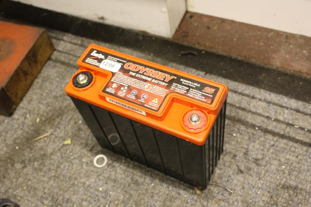

My new battery turned up at work on Friday. Odyssey Extreme Racing 25. 7kg and alot smaller than I was expecting

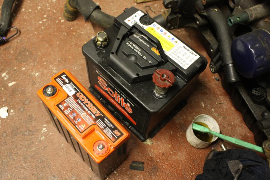

Size comparison to the standard battery (which weighs 12kg, thats another 5kg saved)

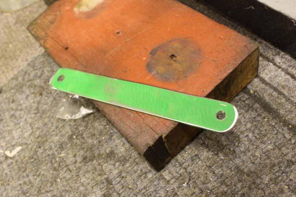

Made a strap up to hold it down

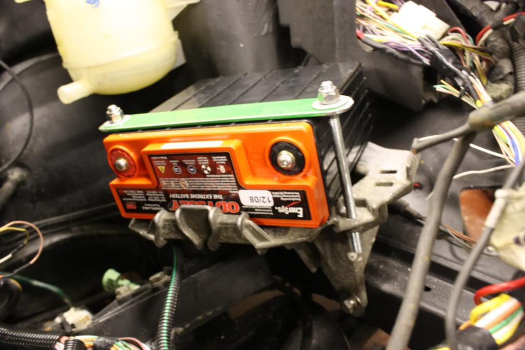

And it'll be sitting here. I originally planned to move it into the back, probably behind the passenger seat, but it keeps things simple leaving it there and being so small it quite easily sits underneath my filter

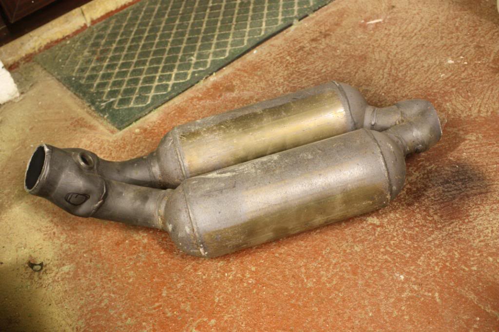

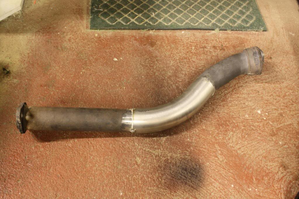

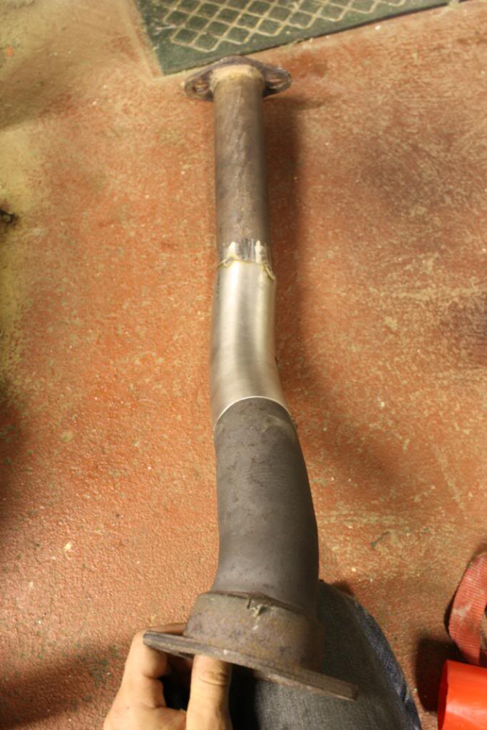

Had a bit of a setback with the downpipe the other night. I've got a 172 Ph1 'donor cat' - this splits into the 2 cat boxes before the downpipe becomes horizontal, unlike the ph2 cat which levels out before going into the cat. So this left me with a slight problem. I took a selection of bits to the local exhaust man and asked him to put them together as I explained. He didnt fancy it without having the car there - so I bought a 45deg bend off him and went home to have a bash. I've used the top flange of the ph1 cat, my new bend cut to suit, and then my old valver decat to mate up with the centre section. Will be going back to him to TIG it all together properly and add a port for my lambda sensor.
Ph1 172 donor

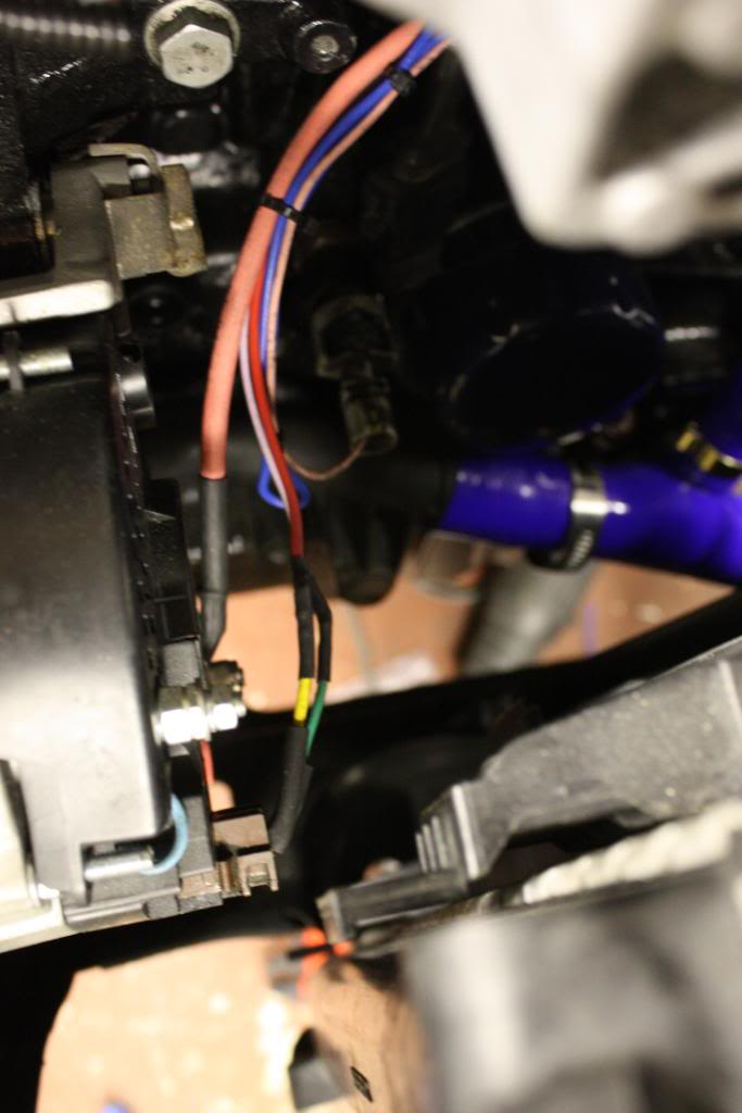

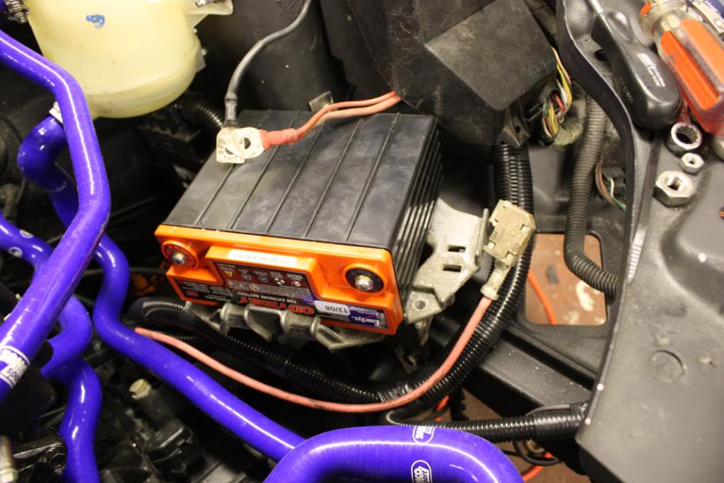

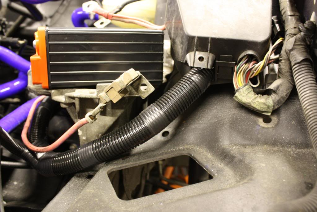

Also finished (I hope) wrapping the loom and making it look pretty. Got it all sat reasonably well and everything connects where it should. I've moved the ECU to sit against the inner wing under the washer bottle, as the battery is now where I originally planned on sitting the ECU.
Wrapped all the way into the fusebox
I had to run another wire into my alternator plug. This goes to an ignition live near the fusebox so meant I had to re-do most of the loom. This section of the loom isnt completely wrapped as I've not got a T piece yet for oil pressure sender/switch, so need to know where they are going to sit before I shorten and wrap the wires

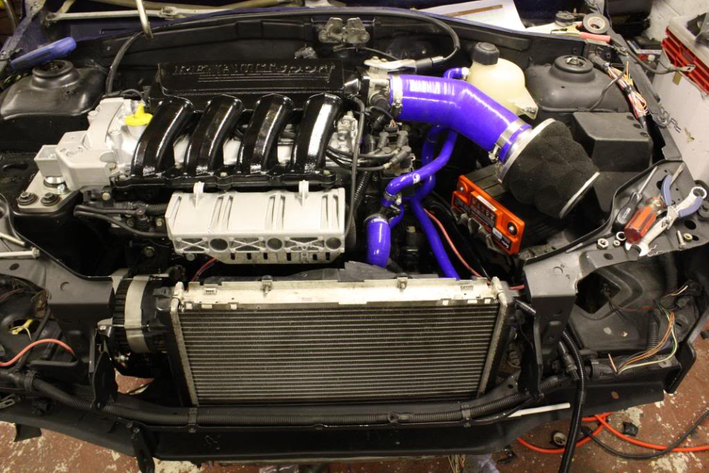

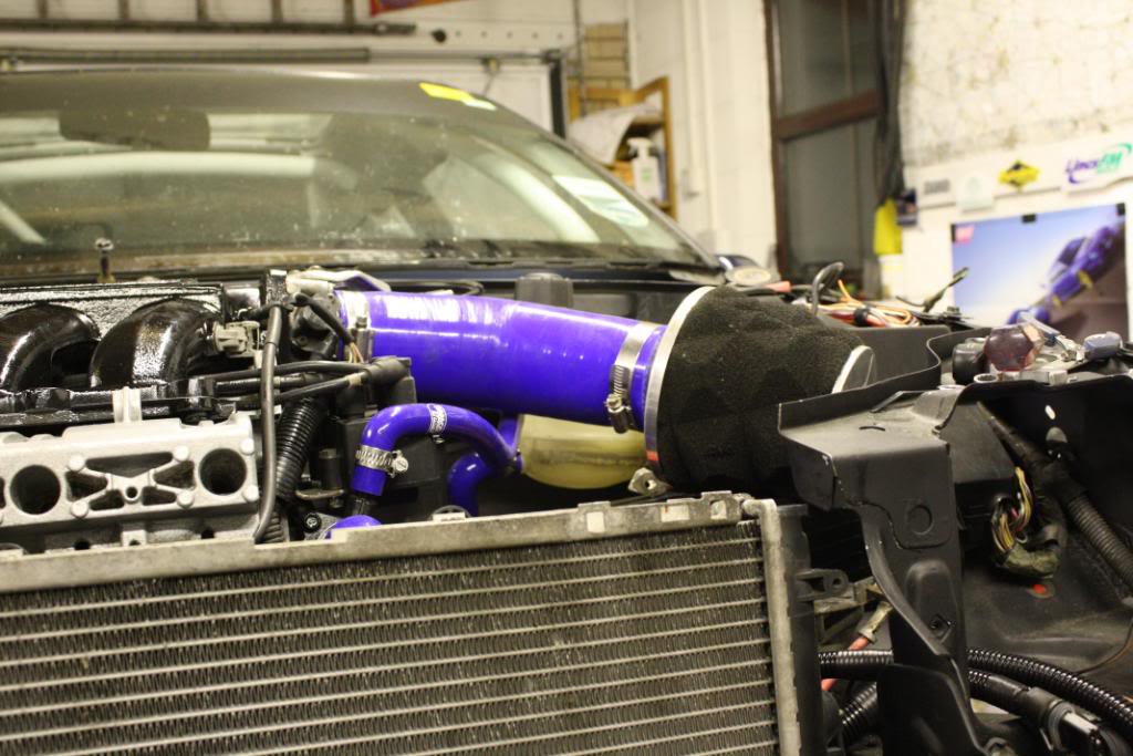

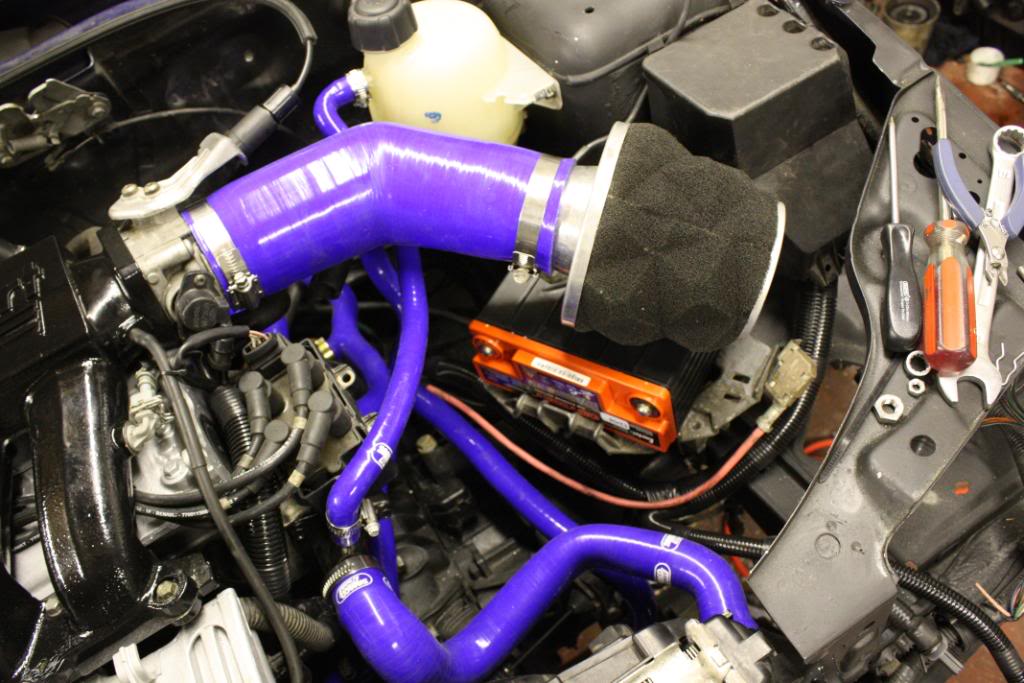

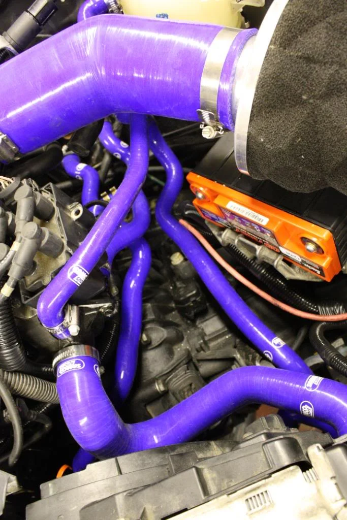

Brappppp induction setup sat over the top of the battery
Made a start to putting my Samco coolant hoses on. I had to shorten the thermostat to upper radiator hose slightly to allow for the smaller distance between the 2 compared to the engine being in a Mk2. Note- all hoses are blue, but for some reason look purple in my photos :S

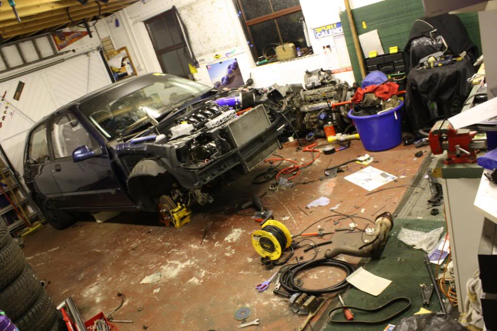

Current engine bay picture
Current state of garage picture
