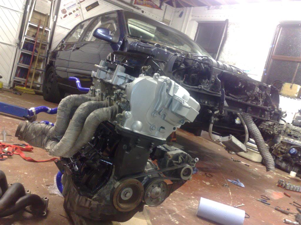

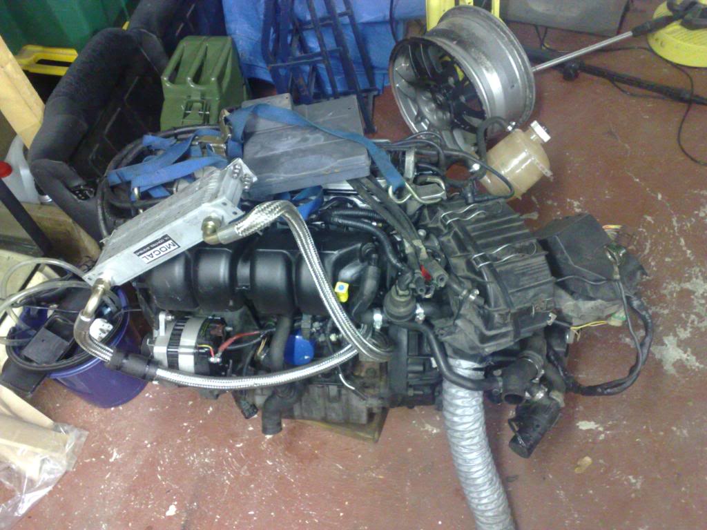

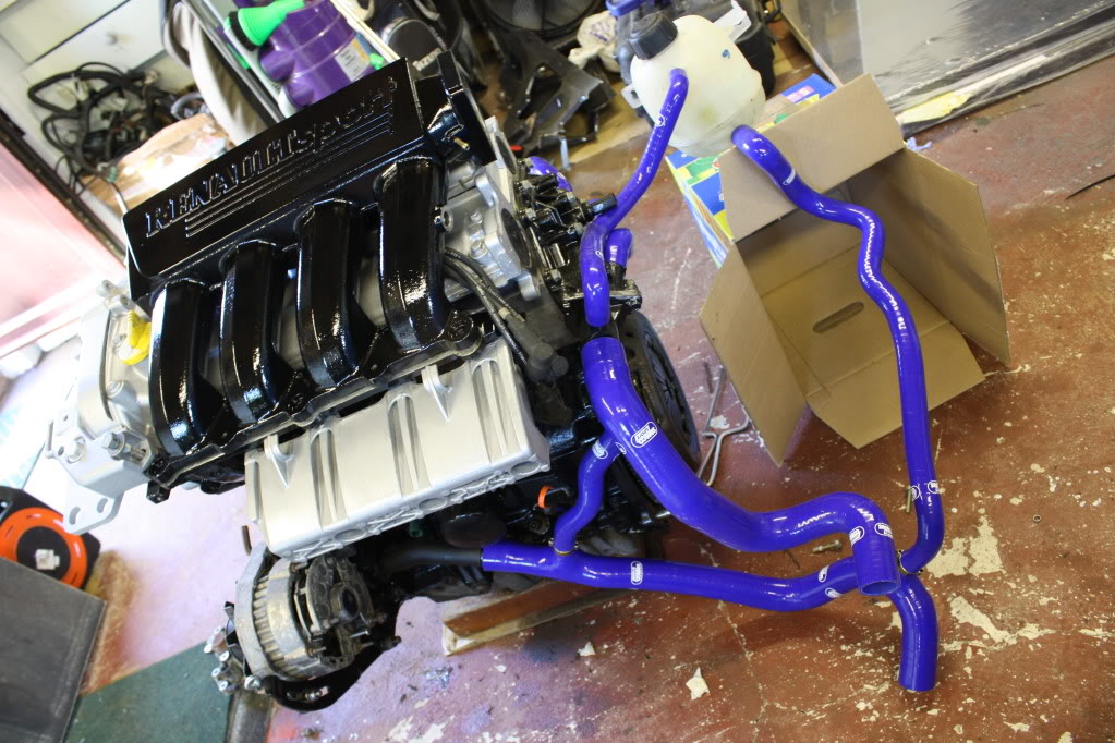

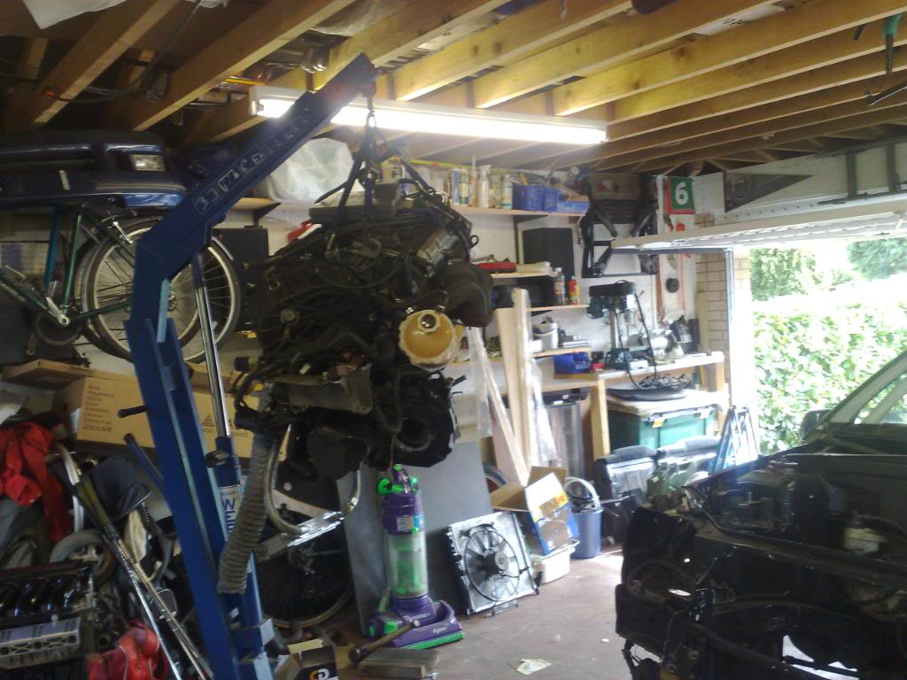

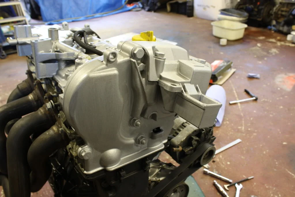

Spent a bit more time on the engine this afternoon. Coming along nicely.
Fitted and timed up a new Gates cambelt kit last Tuesday. Cheers f0xy.

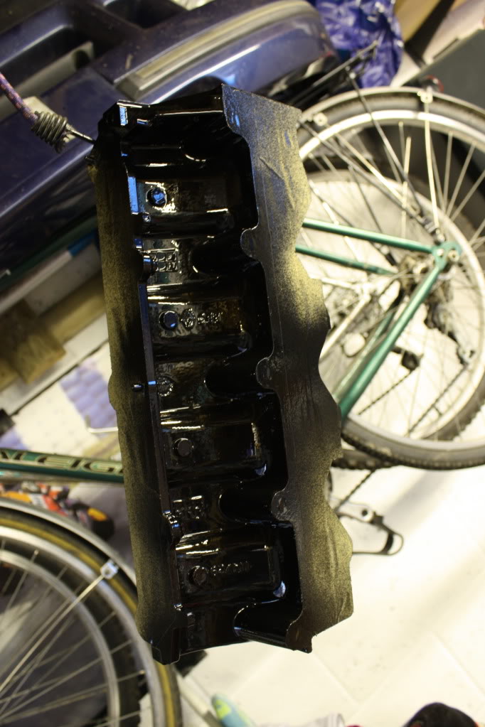

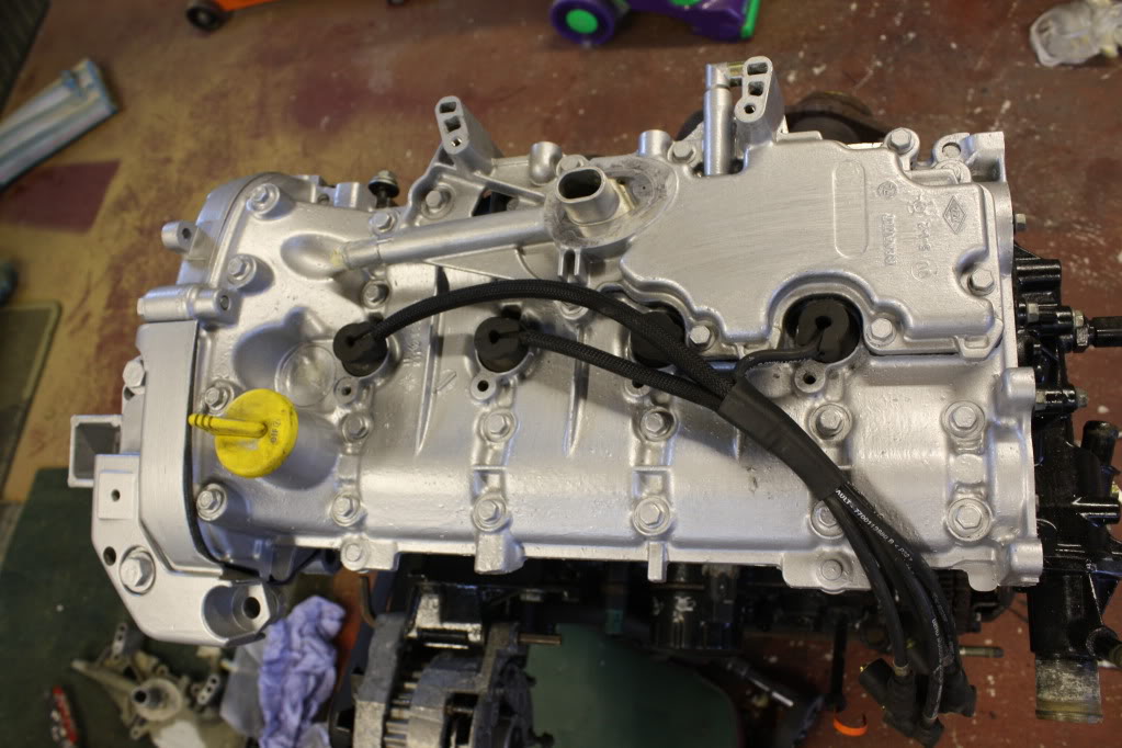

Whilst doing the belt, I had the rocker cover off and cleaned that up, then resealed to hopefully avoid any leaks. Painted it afterwards along with the breather.

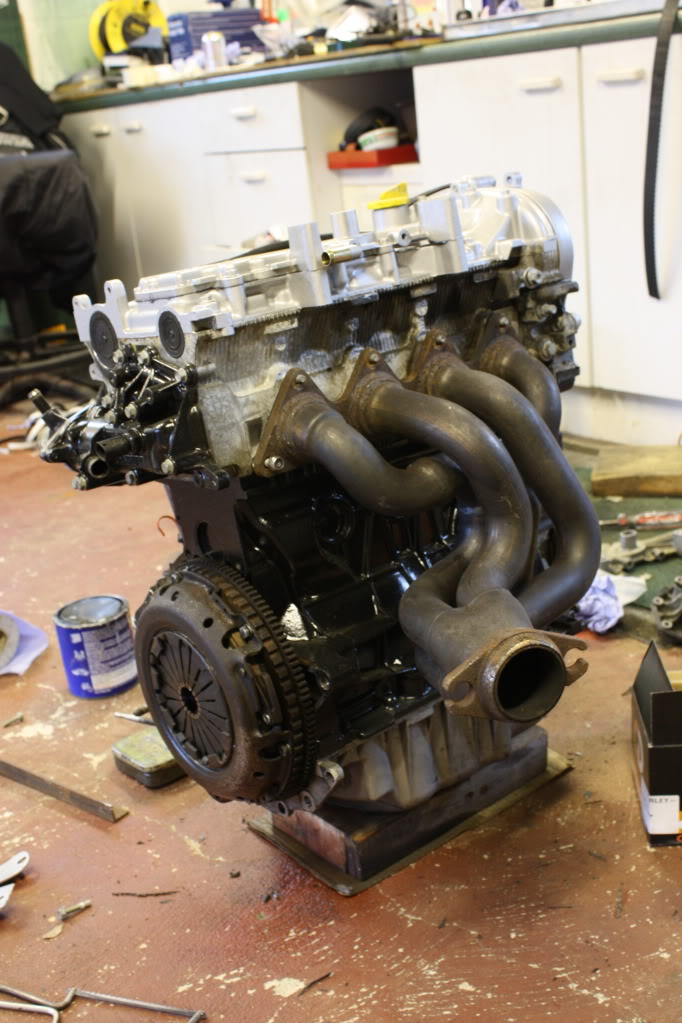

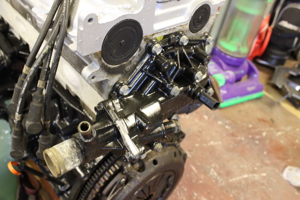

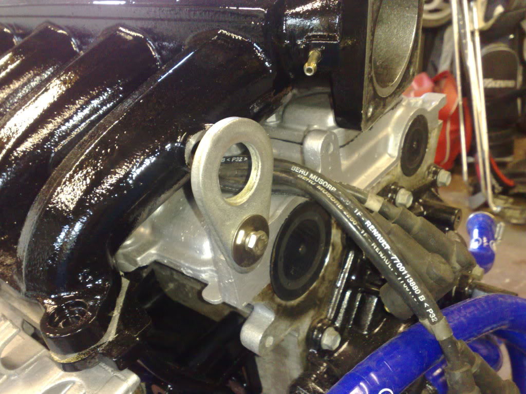

Black thermostat housing fitted

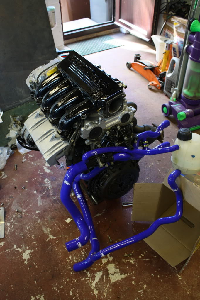

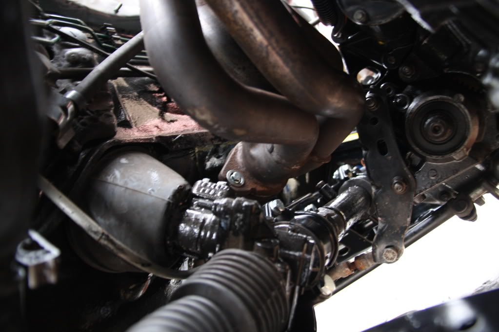

Exhaust manifold put on loosely for now, might either wrap it or get a wrapped one just yet

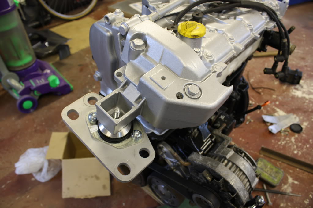

Cambelt cover and top mount painted and back on

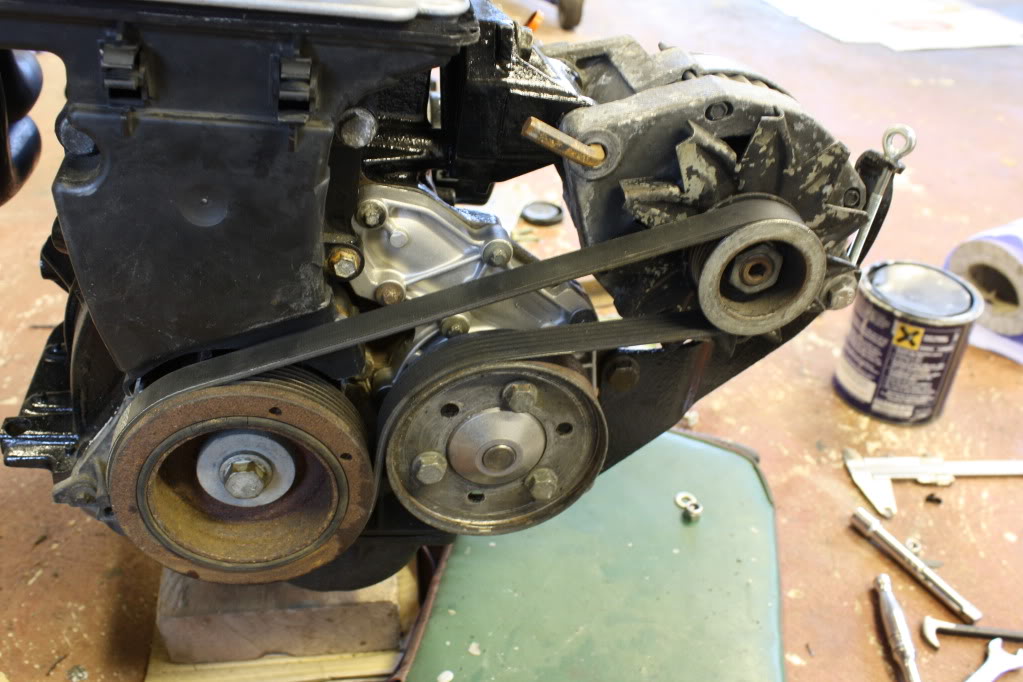

New waterpump fitted and auxillary setup sorted, nice and simple

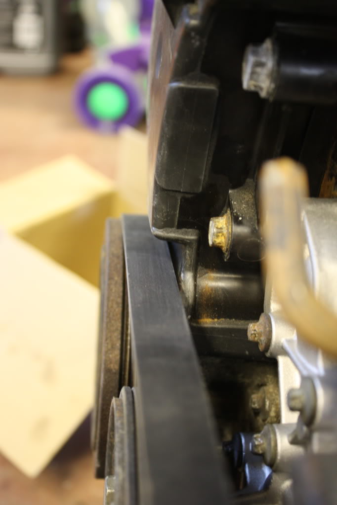

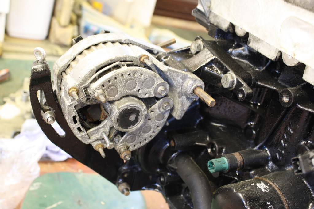

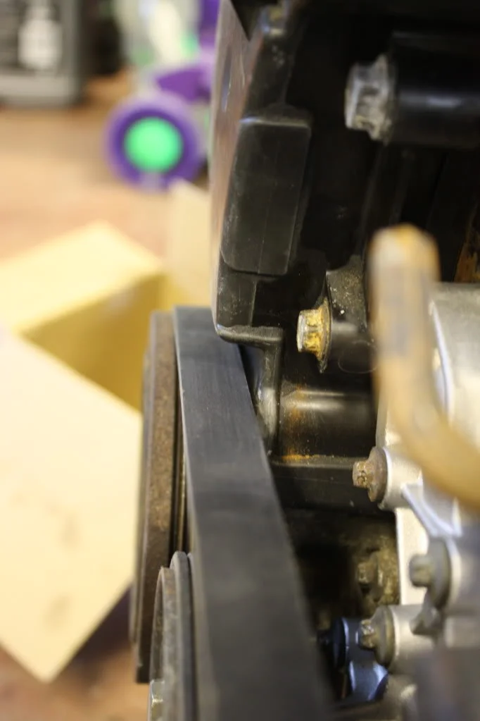

Needs a 5 rib alternator belt to avoid the plastic cambelt cover, as shown
Mk1 1.2 alternator brackets, nice and neat

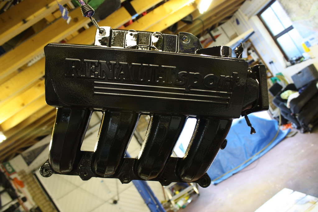

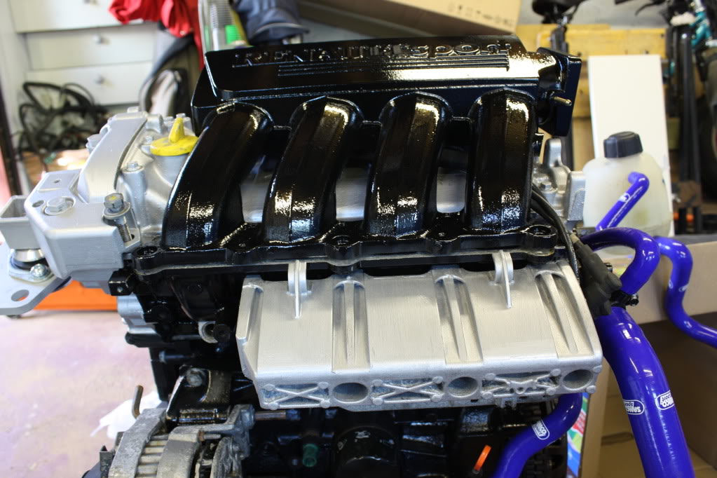

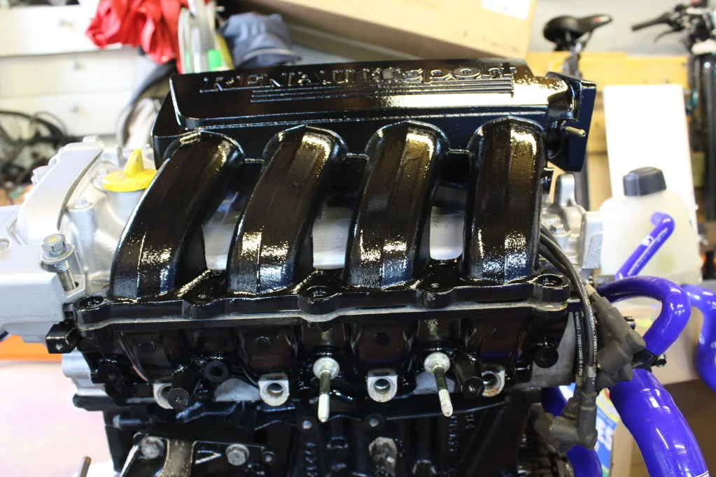

Inlets painted and currently drying. Will DIY match these when the paint is dry

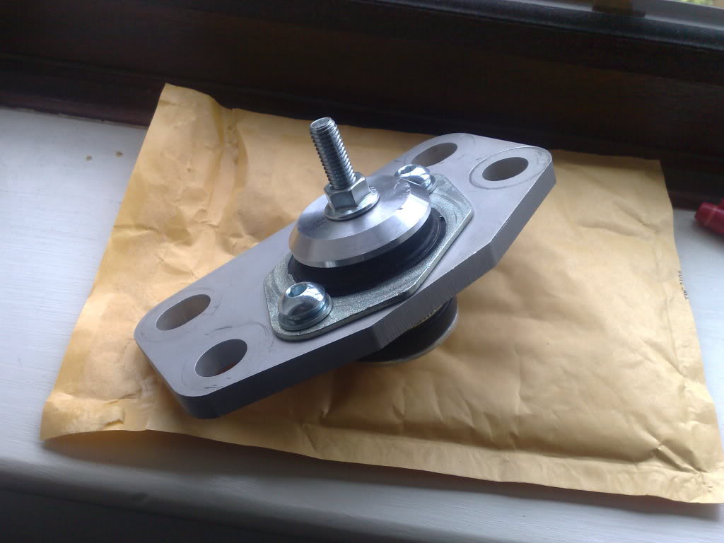

new mount test fitted
