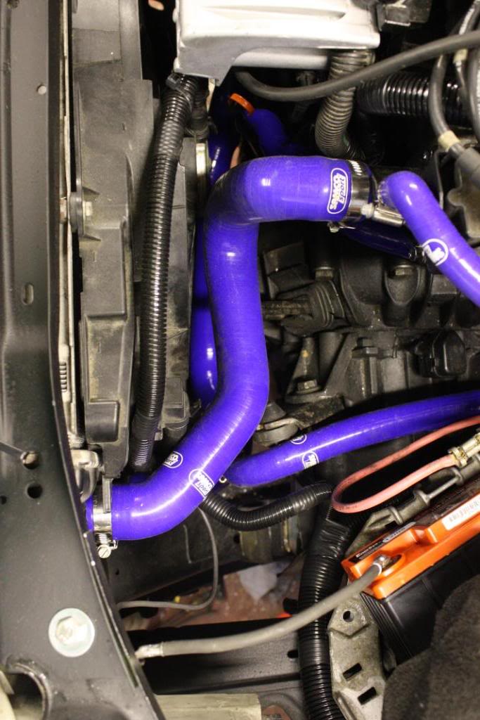

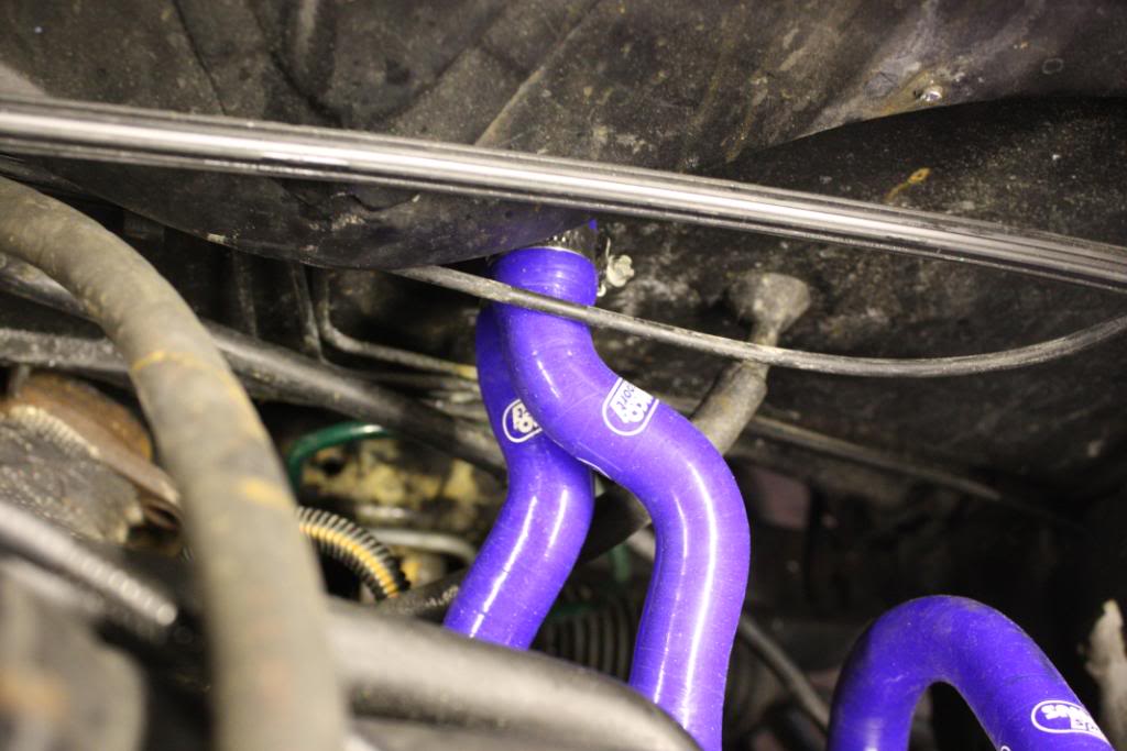

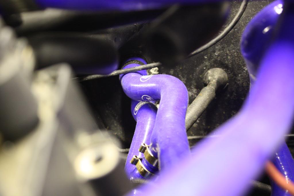

Carried on fitting my coolant pipes today. I'm using a Samco set made for a 172/182, so obviously theyre meant to go onto a Mk2 heater matrix. Well the 2 ports on a mk2 matrix are the same size, whereas on the Mk1 they are two different sizes. This meant that the Samco fitted my upper matrix port, but was too big for the lower port. Luckily the pipe itself is the right diameter and is just enlarged at the very end to suit the Mk2 port, so I was able to just cut the end away and push on the pipe. Sorted.

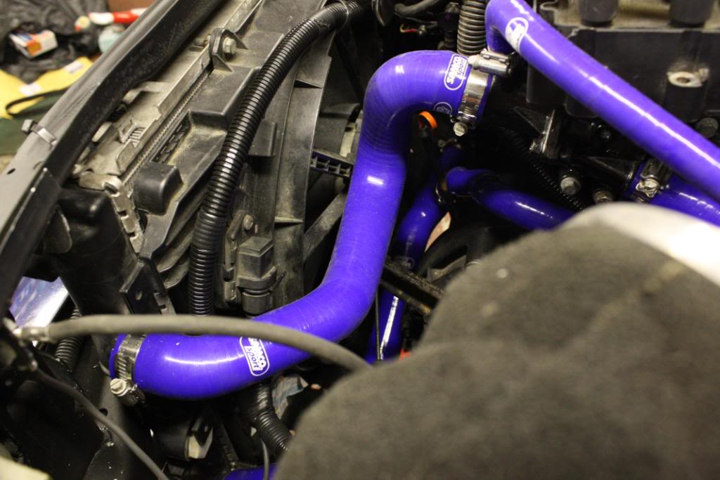

Top radiator hose which I shortened slightly

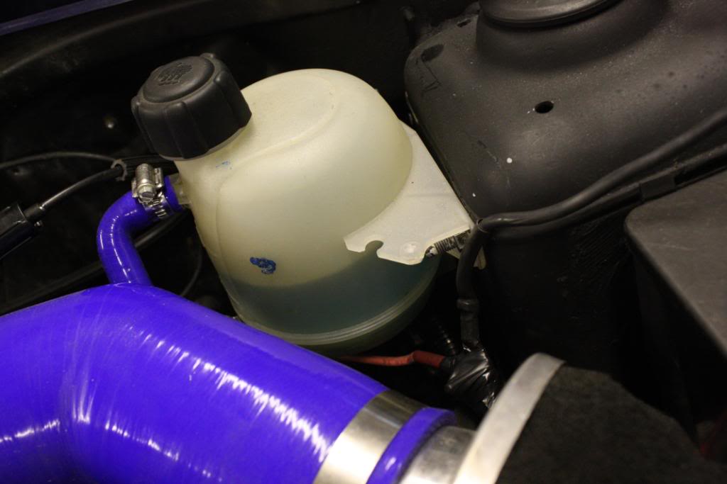

Coolant in and no leaks

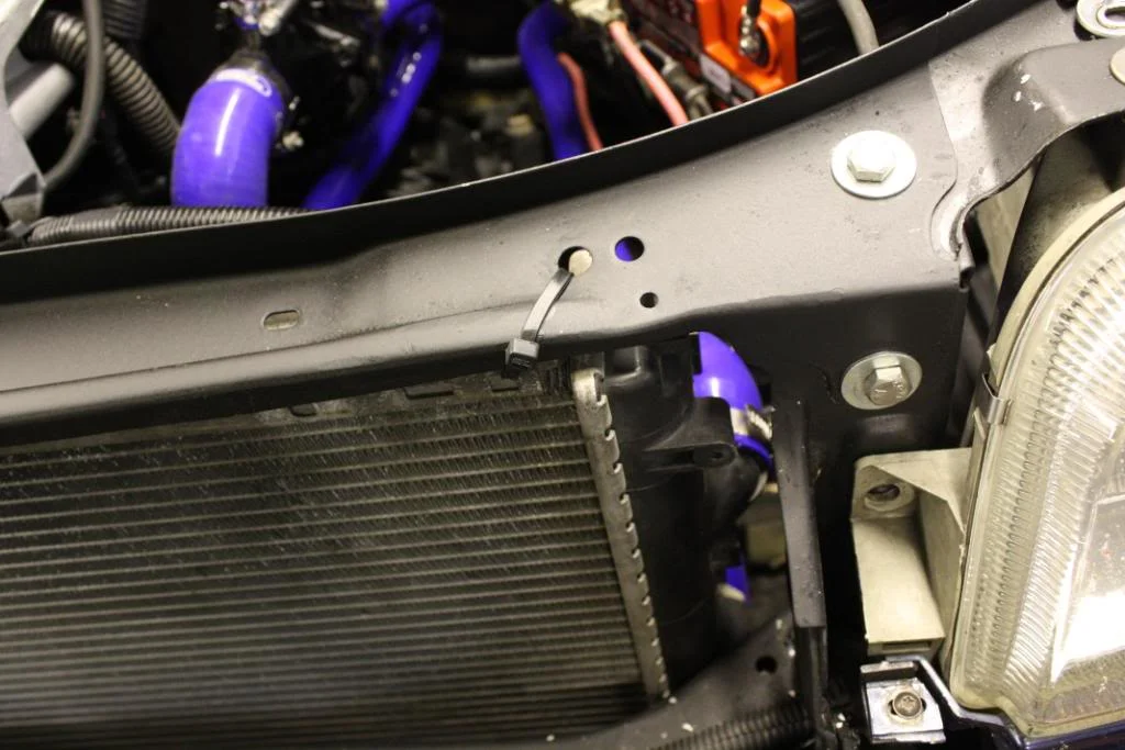

Centre slam panel section painted and bolted in. I had to drill through the existing panel and washer/nyloc on the inside. Radiator also fastened in using the finest RUR cable ties

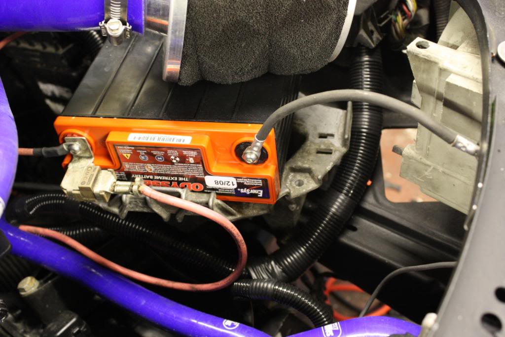

Sorted the wiring to the battery

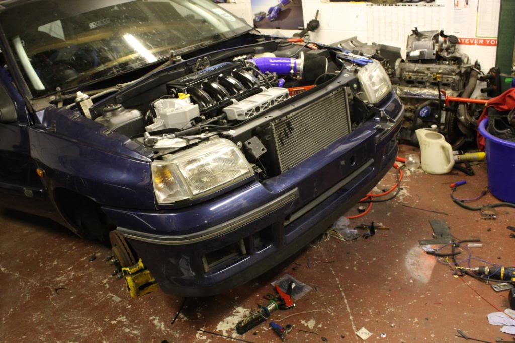

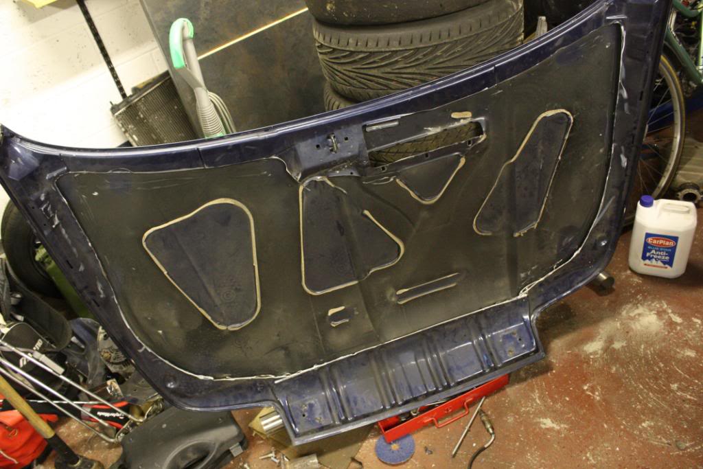

Cut out my bonnet

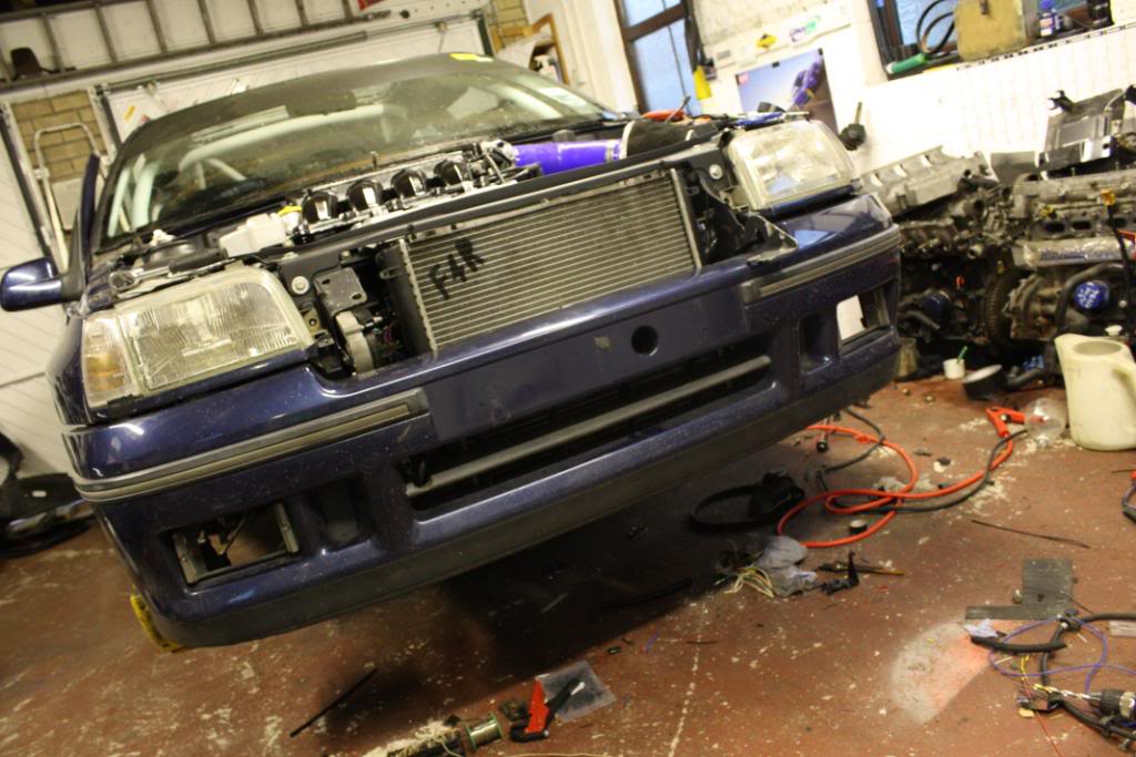

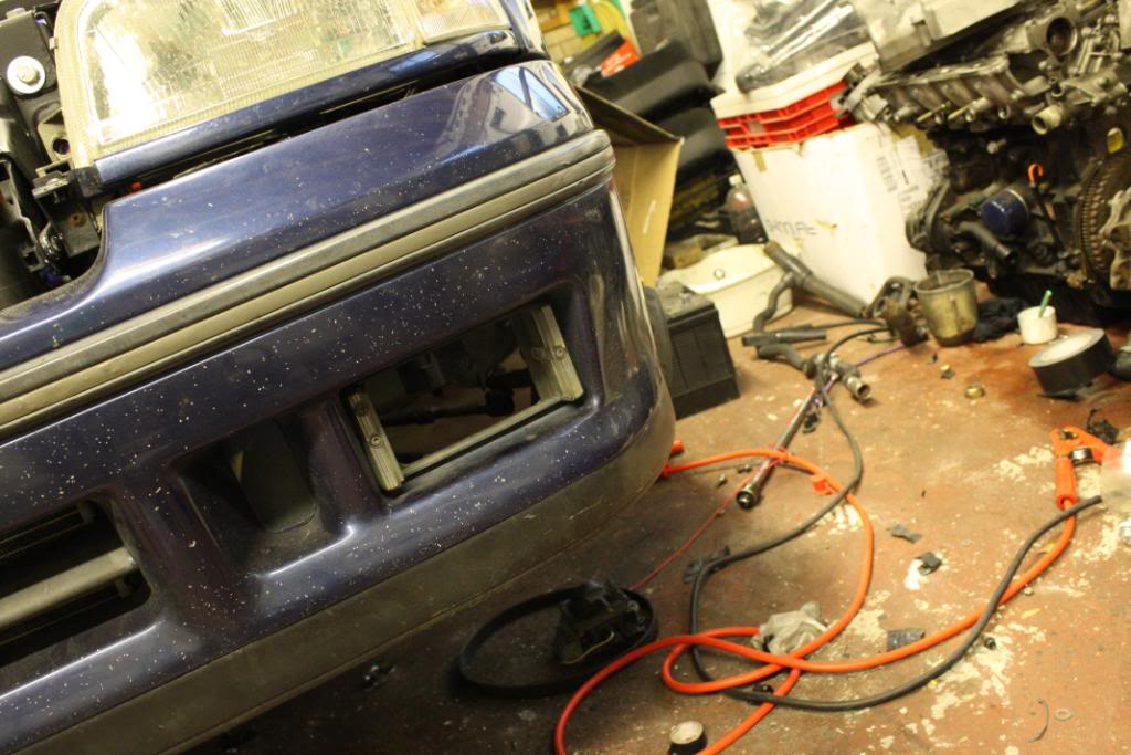

Put a few panels back on including newer front bumper from BRUN's old Ph1. Yes, I did get a bit carried away with the rattle cans and decided to stencil F4R onto the radiator.
Fog light screws were rounded so I just hammered the light itself out. Looks quite funky

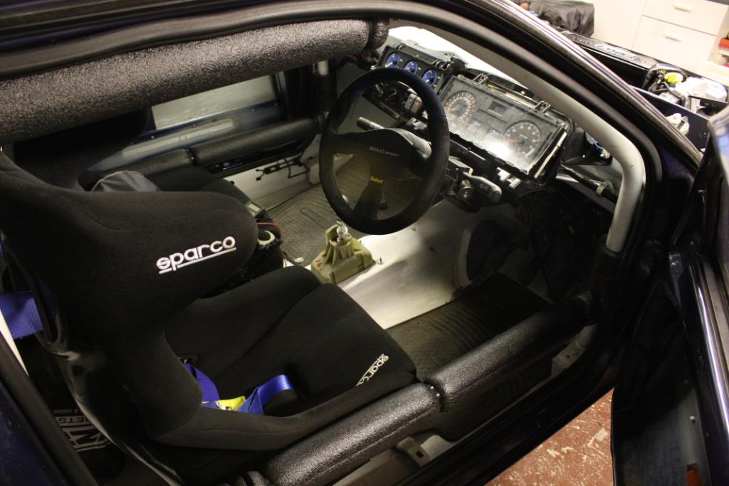

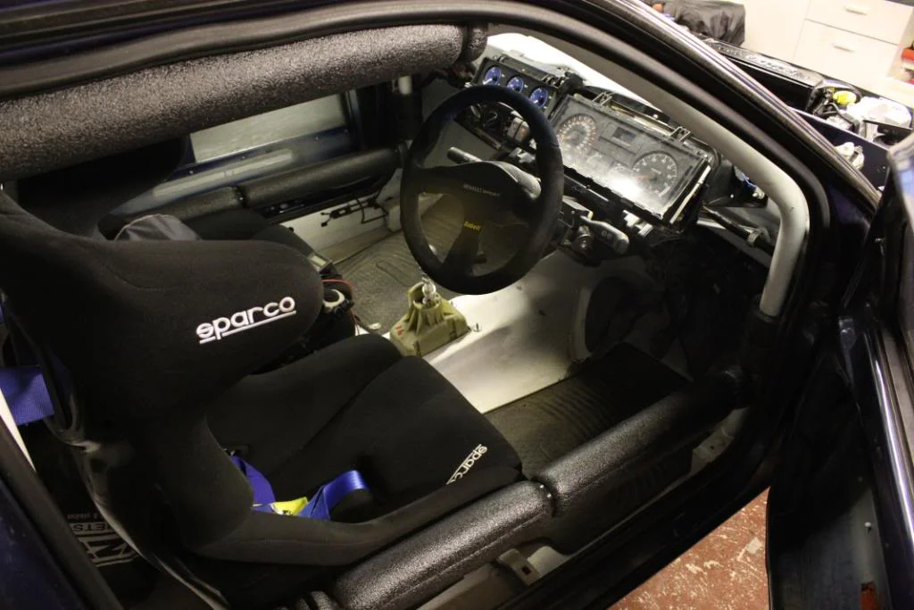

A quick reminder of what the inside looks like

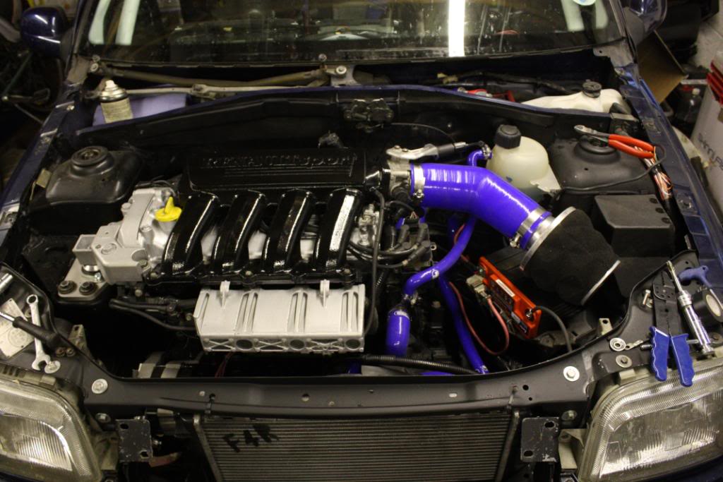

And todays engine bay to finish with :)
Oh, and it still starts and runs having chopped the loom about some since i last started it, phew. Under its own battery power now too.

Can you not get a TVR type filter? Longer and thinner and won't rest on the battery.

thats exactly where mine is (except on the other side)
best positioning! :D piece of piss to change!
Nice!!! Cable ties are the best tool ever.

Il give them a week before they snap, girly ties FTL ;)
Get some of them huge ones you had on there!
